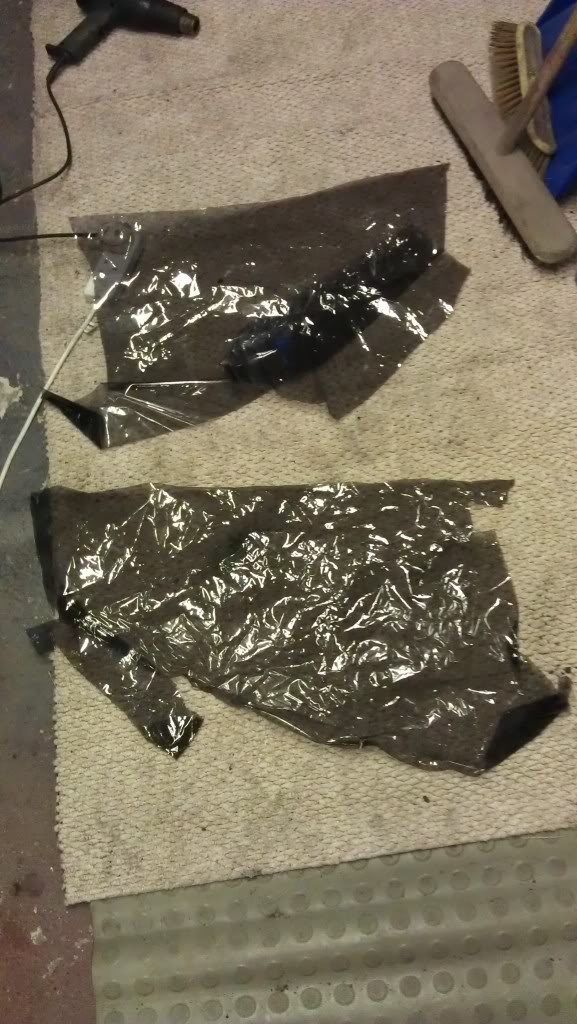

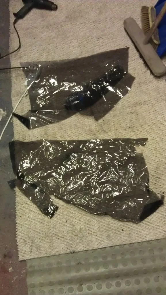

You may or may not have noticed, but the car had some light tints all round, not all that noticeable but dark enough. I don't mind them on the rear sides and rear window, but I definitely wanted them off the front 2. Not a job I was particularly looking forward to as I know what a mess it can leave. I heated them up slightly and they peeled off reasonably well but still left alot of the glue behind. Some Dodo Juice Supernatural (glue and tar remover) helped the job massively.
It was dark by the time I was done so heres the evidence:

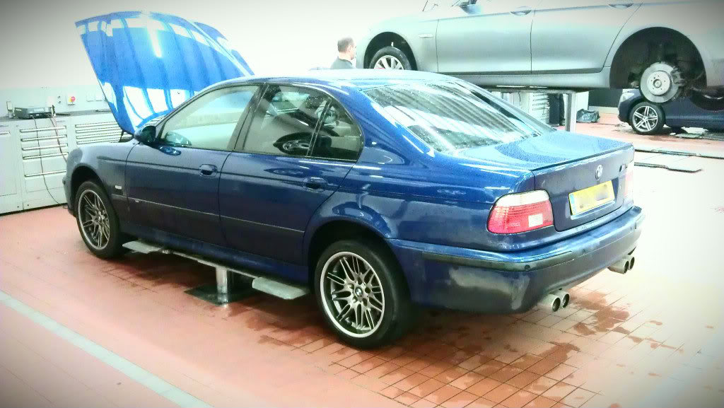

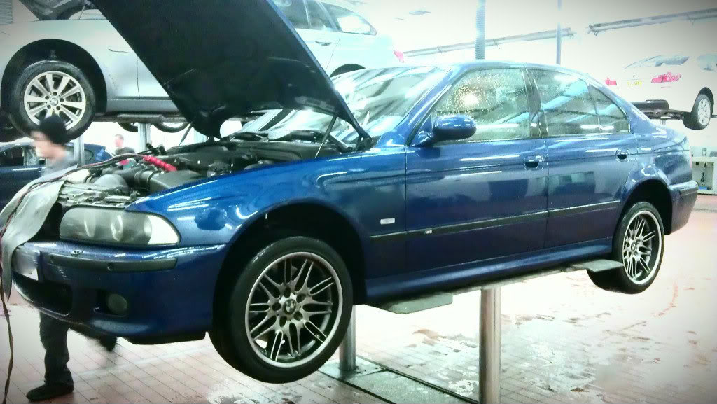

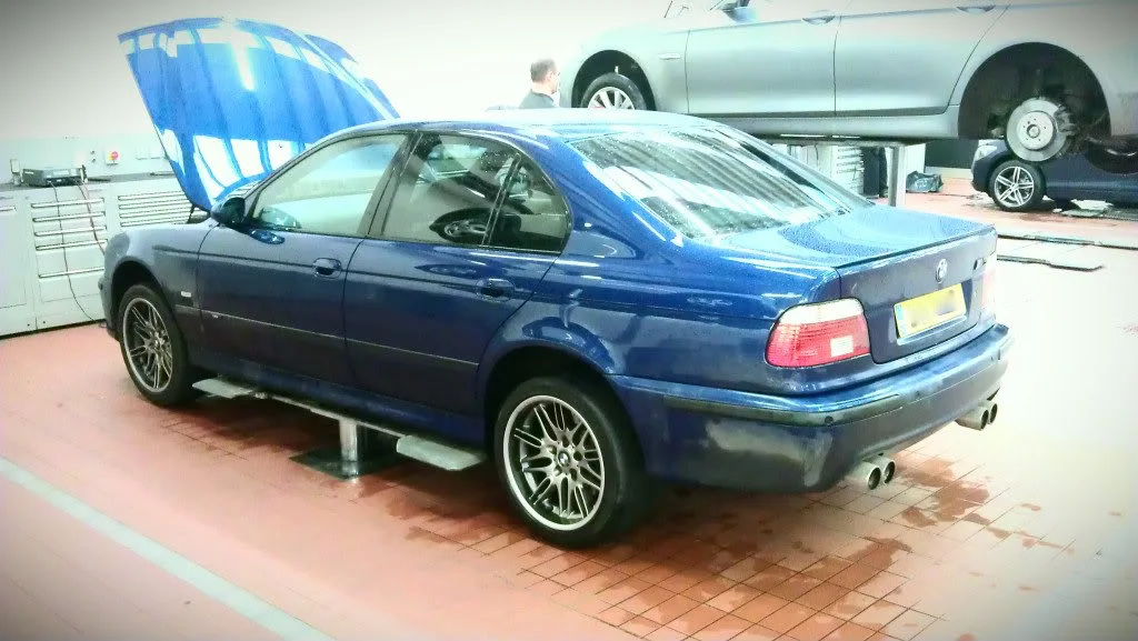

The only real fault with the car at present is a vibration under braking. From reading some of the M5 forums, this can be caused by various bushes or ball joints in the front end. The previous owner recently had the front control arms replaced to try and eliminate this but the vibration is still there.
Today I went to see a friend who conveniently works at BMW. We had the car in the air to give it a once over aswell as plug it in to check/clear any logged faults too. Nothing was apparently wrong that might cause the vibration, the usual suspects were checked and more new parts were found underneath that I wasn't aware of which was nice. Logical next step for me is to replace the front discs so I'm going to look into options for that shortly. Aside from that, the car was given a clean bill of health :)

Vibrating is warped discs. Common problem on the e39.
Not always, from reading about online, the control arm and/or thrust arm bushes are often the culprits amongst other things. Discs are pretty much dealer only as they're a floating design, proper ///M​ tax!
