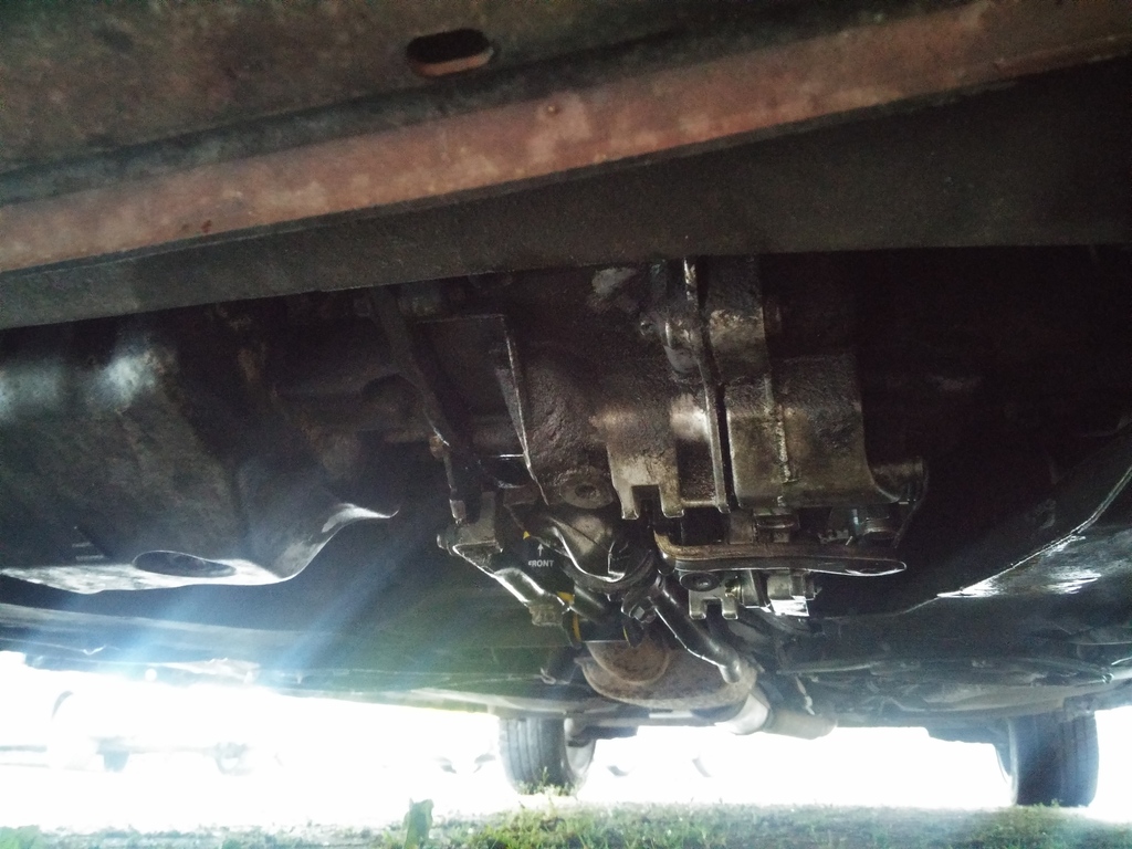

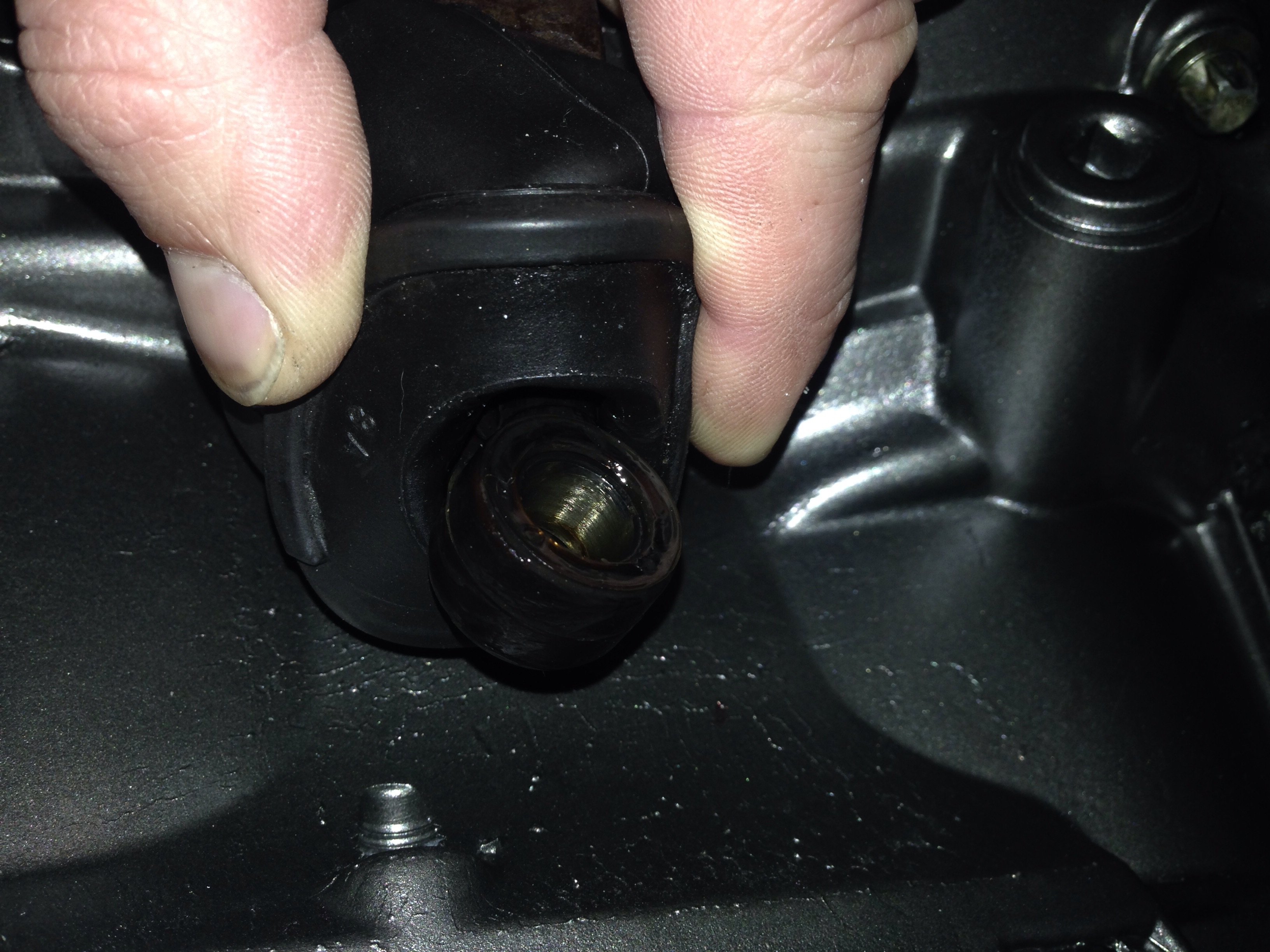

^^^ This is exactly what mine looks like underneath. I took it to the garage to price up new seals fitted and the mech said he thinks its my sump leaking? I said how seeing as its behind the gearbox(oil blows back when driving) mech said 'nah the oil from the sump rolls down to the lowest point???' He then said if you bring it back I will put it on ramp and run it for about hour and half to see what happens' Yeah right see ya!

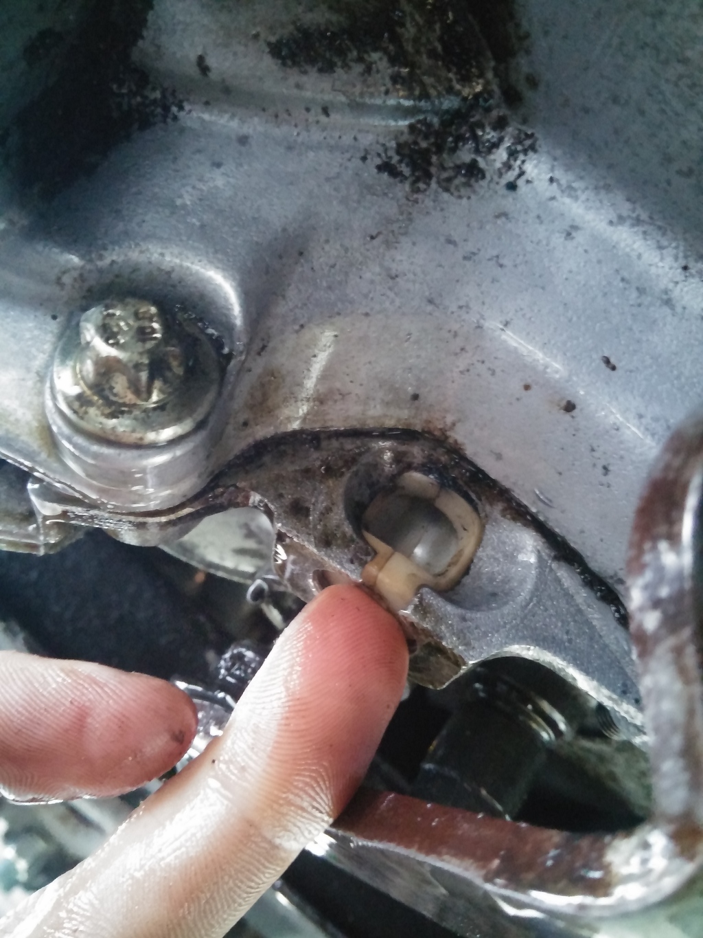

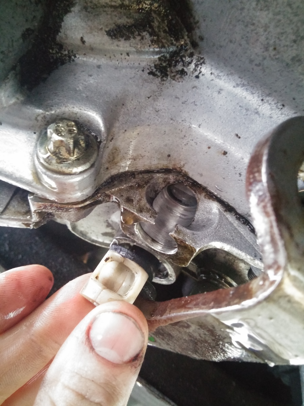

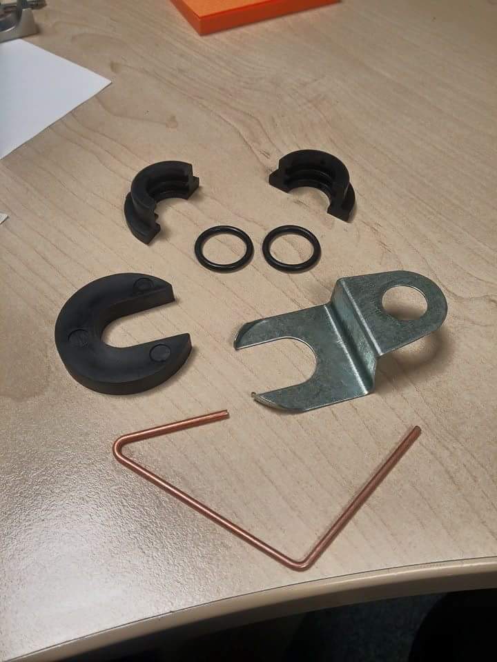

Okay. Fitted the TND fn10 kit from Mapco. It's easy to fit, but the gators etc on the selector lever are easy to tear so bear it in mind. I have to replace 1.
I followed the instructions as per the video.
Firstly I think a lot of people find the little white plastic insert to be the cause of their leak, I believe both my selector seal and bush leaked.
Here is the part in question
The black rubber seal on it was persished badly. Oil seemed to collect in the bush.
Anyway, I was in a bit of a pickle as I needed to drive home and put sealant above the bush, it seems to have stopped the leak so far.
I'm leaving the lower engine cover off to keep an eye on things
So far so good
Cheers
Josh

If you've got a leak coming from that bush and not the selector, you've got some issues mate. There's nowhere for the oil to leak from as it's just a recess that the bush sits in.
If you've got a leak coming from that bush and not the selector, you've got some issues mate. There's nowhere for the oil to leak from as it's just a recess that the bush sits in.[/QUOTE
Yeap I realised that afterwards. No issues, it's just oil seaping from the casing. It's a car that sat on a driveway for 2 years, a lot of dosed seals etc. I will just top it up, less I spend on it the better!
I have one of these to fit soon, so not a perfect fix then?
It just holds two O-rings in place to act as a new seal. How well you fit it and the quality of the rubber o-rings will decide how well it works.

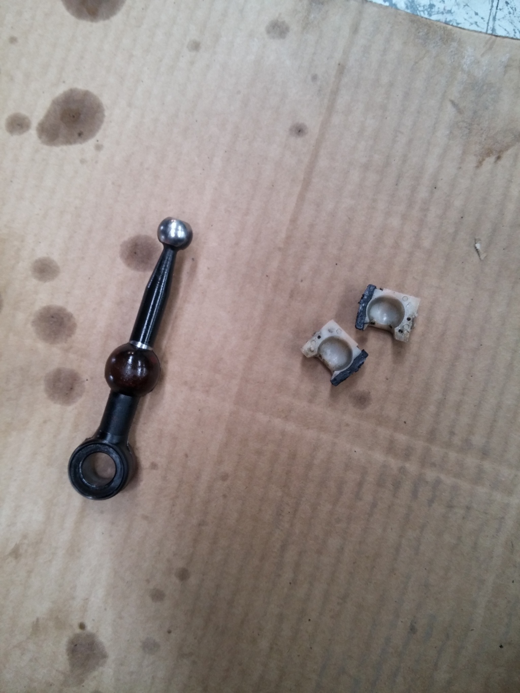

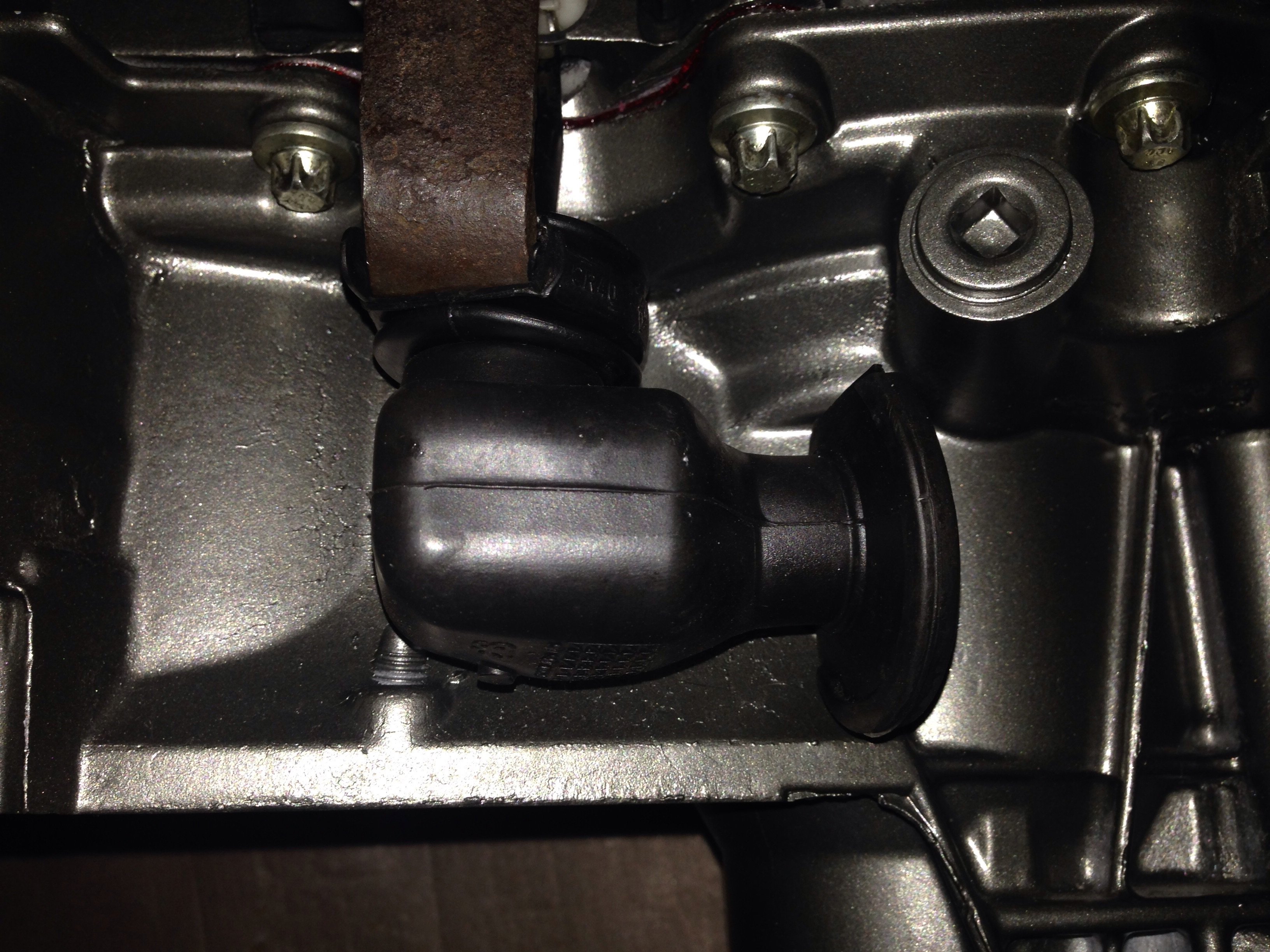

Do you know if that part, if it's worn, could lead to a wobbly gearstick? My ball and socket seemed fairly loose and i've got some awful side to side movements with th egearstick and thats with a yanoo stiff shift, new aprts etc :(
Do you know if that part, if it's worn, could lead to a wobbly gearstick? My ball and socket seemed fairly loose and i've got some awful side to side movements with th egearstick and thats with a yanoo stiff shift, new aprts etc 😧
Yeah that will definitely cause the gearstick to feel sloppy mate, but it won't cause the side to side movement. It could be the bush in the arm itself.
Here you go mate! View attachment 128164View attachment 128165 This fixes on to this:View attachment 128166and is hidden by this:View attachment 128167Your bush may well be knackered after all though!! I've just checked mine and it has play. Yet more parts to order from Renault!! Lol
Early type gear linkage alert. Let me know how you get on as mine has a little play due to being bone dry of grease. Later type linkage is noticeably different and the boot uses a cable tie. Couldn't figure out what I needed and got bored!
