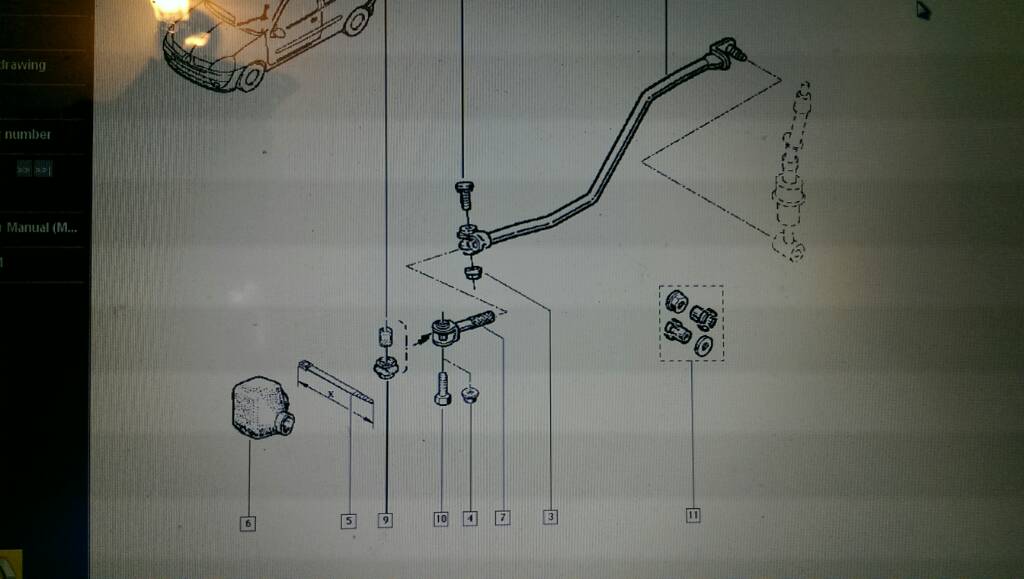

Cup gearbox so a 129 I think. I just want the bit with the pin as I replaced the linkage that fits into the nylon bush and the nylon bush but couldn't get a straight answer from Renault as to wether I would get the same parts as is on the car if I ordered number 7 which on this picture is quite different!
If I click on 7 I get an old 7 type part No. and a new 8200 type part number.
NorthloopCup
I'll hazard a guess that they're possibly universal or superceded by a better design. Give me all the numbers off your box and I'll have a word with my Renault man. He's s**t hot tbh. :up:

Just checked the bush you posted pics of and it does appear mine is wobbly! Very wobbly indeed so I assume that's where my play is coming from, are these parts expensive and where is the best place to get them from? Thanks!

Renault Wolverhampton is the place for the items you need mate, but I can't comment on the price of them as it's not something I've bought.
