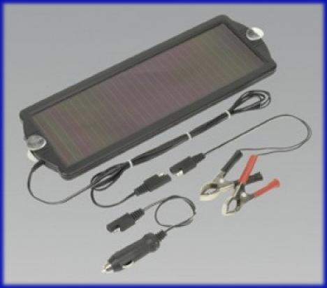

Buy a little solar powered battery charger, and leave it on the dash.
