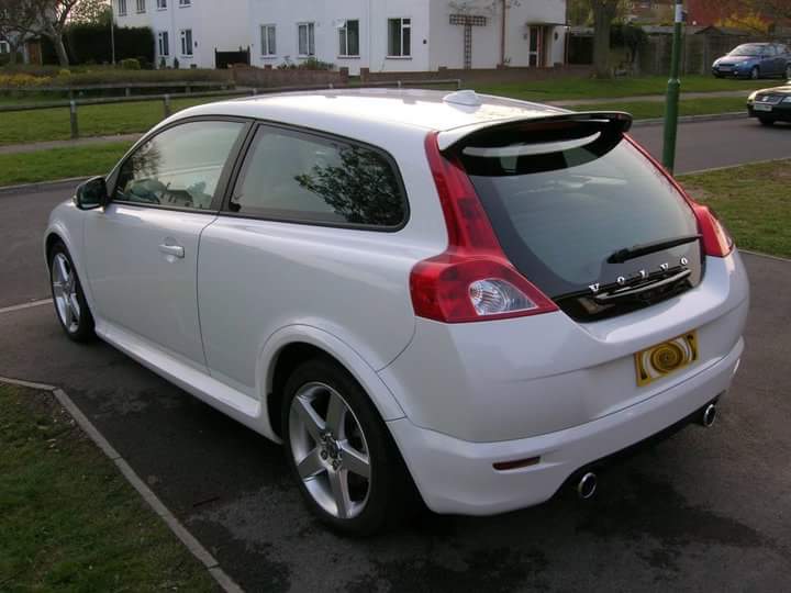

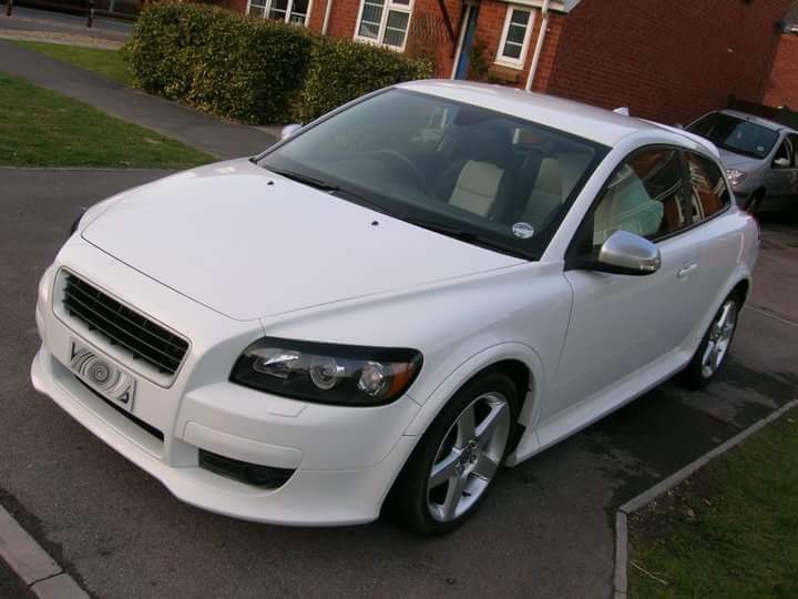

I had a short plate made up for my C30 (illegally spaced and with no markings) as my plate is only 5 digits (and one is 1 so even narrower.) I never had any issues in 2 years. I still have them but when offered up to the clio i choose not to fit as the clios recesses suited full width plates.
ETA, just remembered, i didn't have them made shorter, i made them shorter, sharp knife to score a few times them snapped them. Used a file to smooth the edges.
