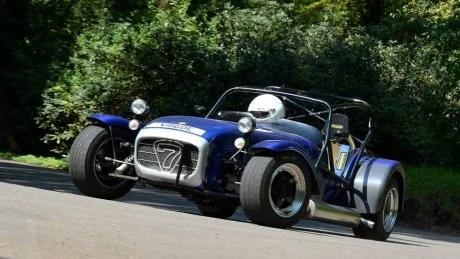

It was a natural progression to then go for a faster Caterham (a Superlight 'R' – pic below - carbon body bits hence the name 'super light') and of course then to dip my toe in the competition water with the Lotus Seven Club. I loved it, so to cut a long story short I developed the Superlight 'R' into a really fast car for competitions that was still road legal – and really, really scary on the road.
The video below was taken in 2014 at Castle Hillclimb in Cornwall (turn the sound up so you get the full effect of the 'K' series engine singing at 8,300 rpm):

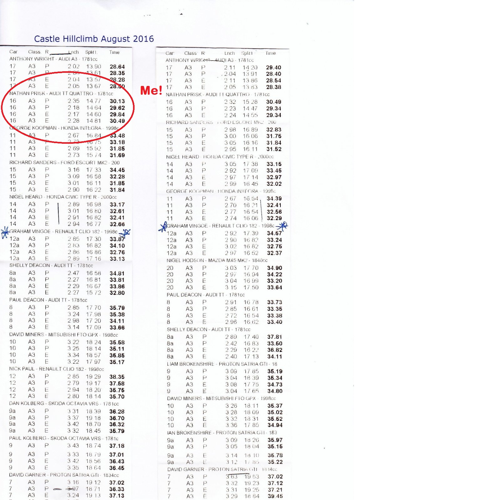

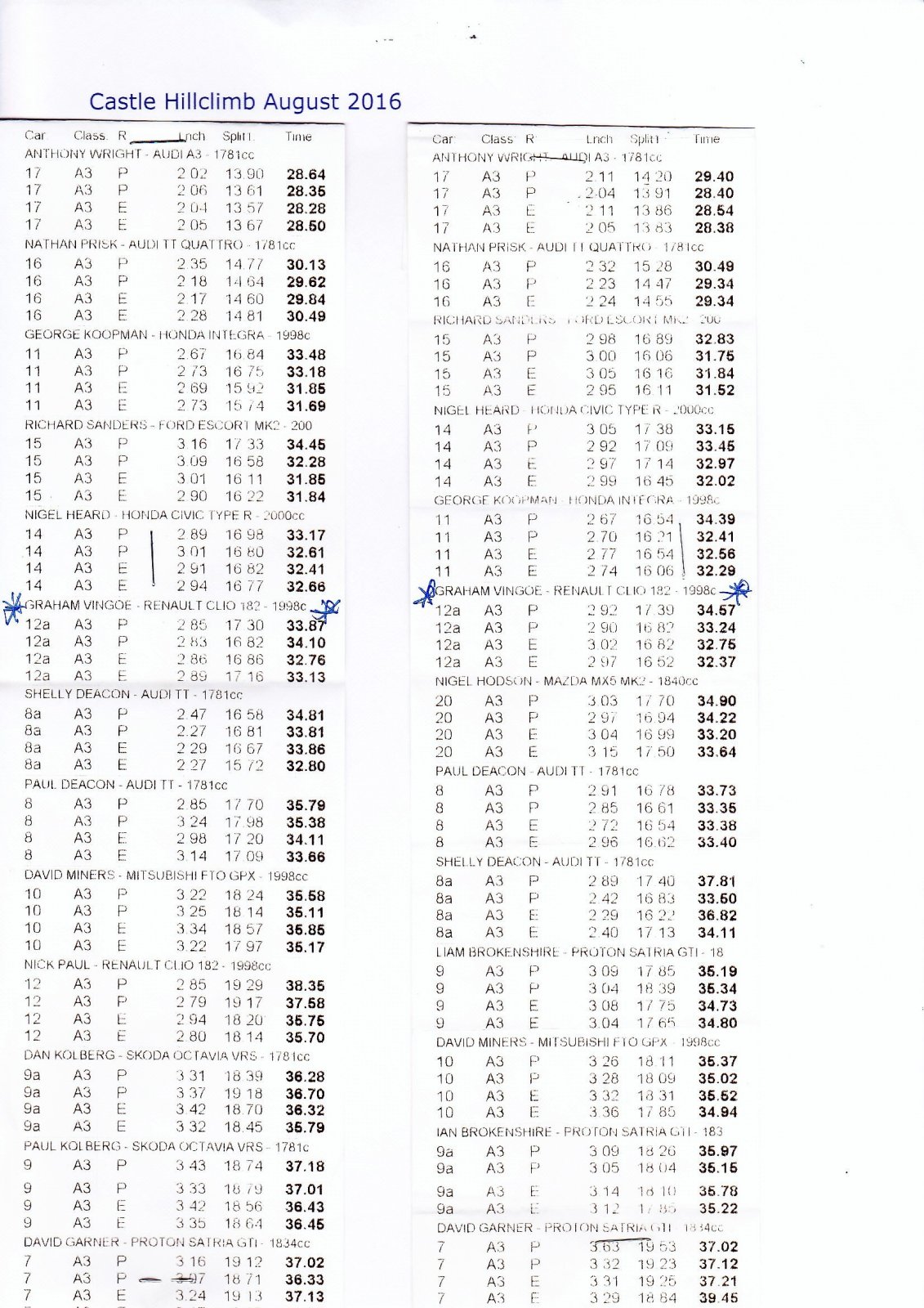

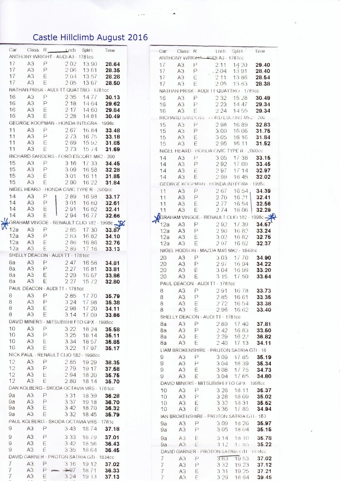

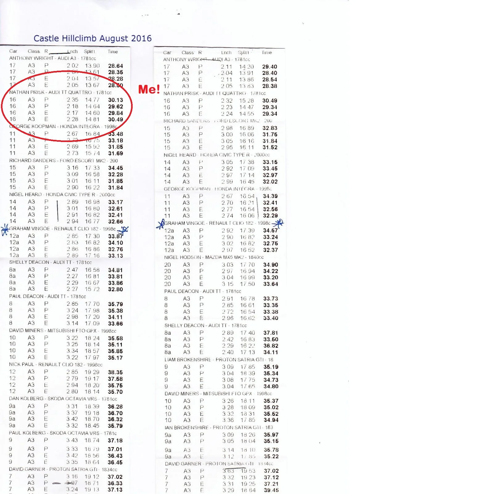

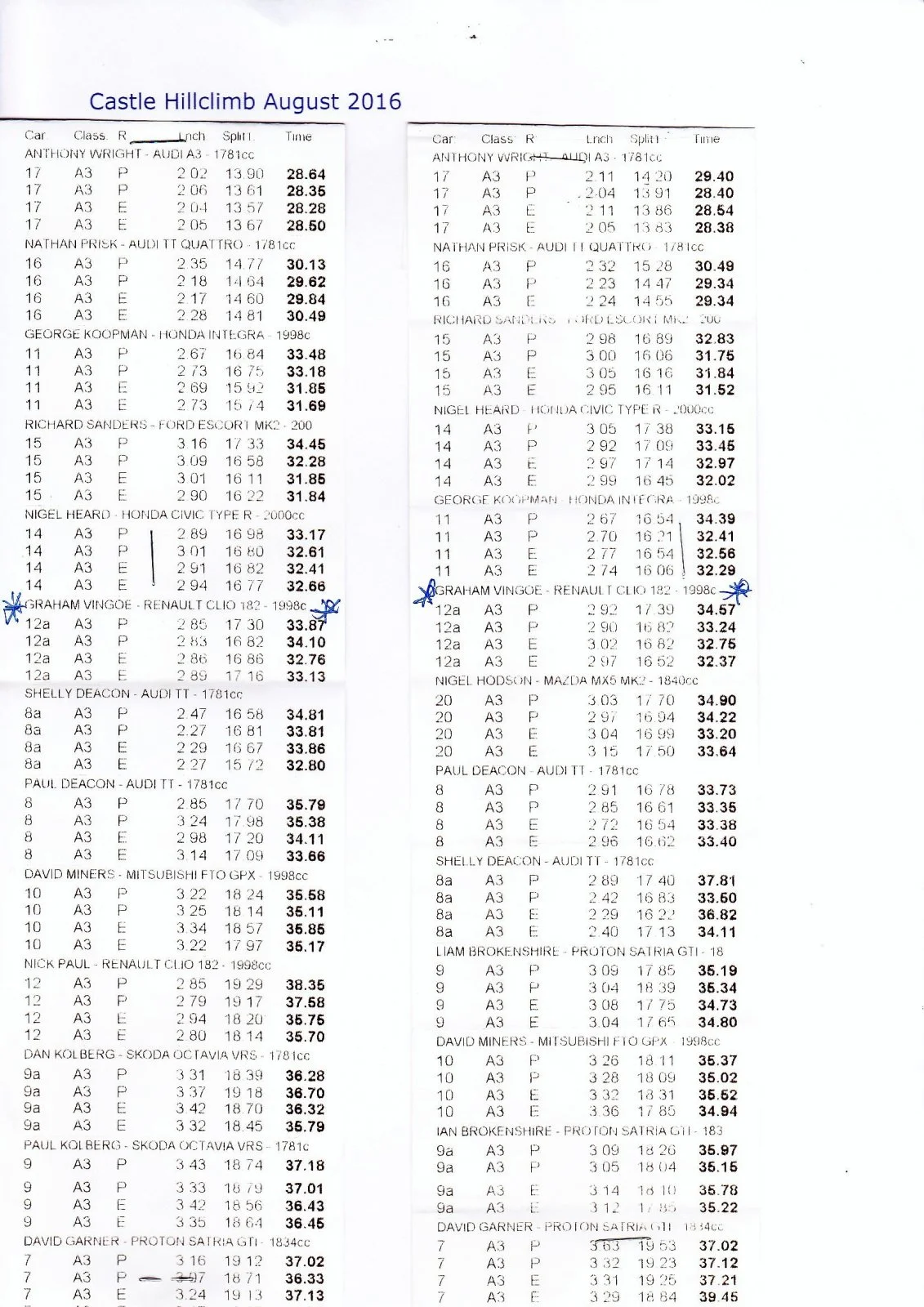

Post up the times for Castle :smile: in the Caterham v Clio v a nice Audi TT!!
Hi Nathan - hope you are well? How the Rally build going?
Just looked at one set of results for Castle - http://www.swtimekeeping.co.uk/Documents/SwtResultsFor150802.pdf
On that day I think 28.16 was my fastest time up Castle in my non-turbo, non 4 wheel drive Caterham - I think you did a 29.86 that day ? Were you running in 2 wheel drive mode? or was the turbo switched off? :-)
The Clio is still 'work in progress' ... LOL. My best result in the Clio last year was 3rd in Class (out of 13) at Manor Farm. First and second were turbo'ed, 4 wheel drive so I was very chuffed to get 3rd.
I can remember sitting in the start queue at Castle Hillclimb in the Clio ... listening to the cricket on the Alpine stereo with 6 speakers. Now that is CLASS !

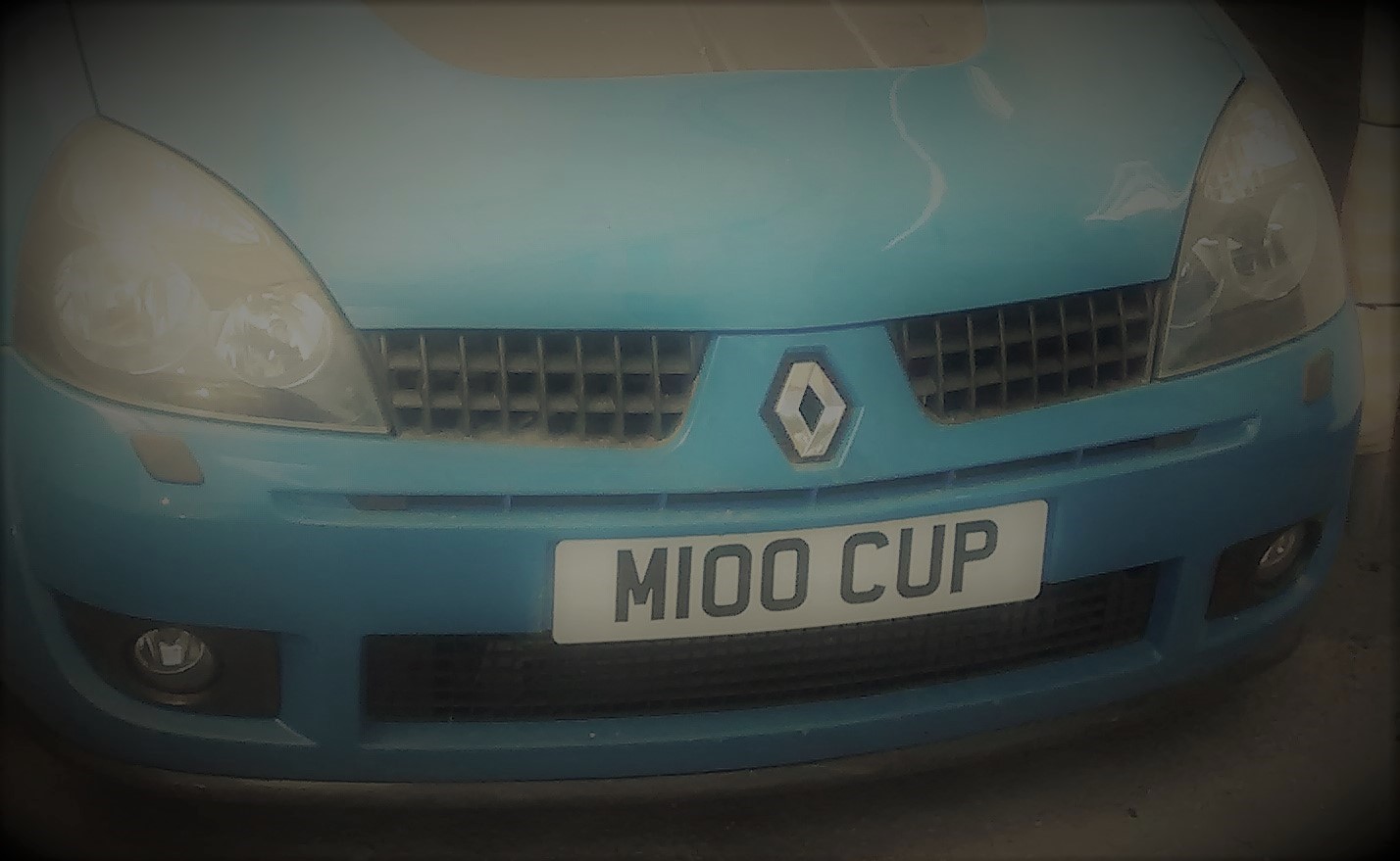

Pic of M100CUP under a layer of grime -

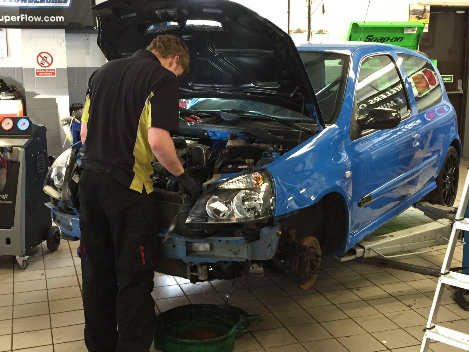

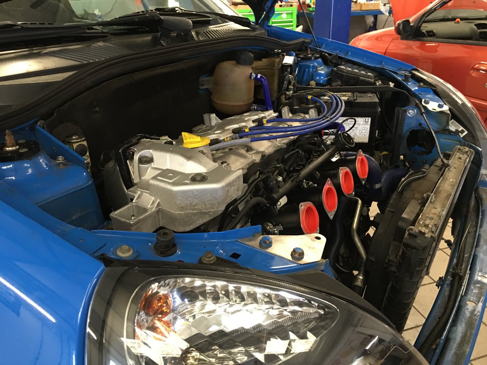

So the rebuild of M100CUP started in about May 2015. Each following Friday I would get an e-mail from Sean explaining the progress they had made and asking questions about options that I might like to consider. The photos below show the build and were part of the build documentation from K-Tec (provided by K-Tec on a memory stick at the end of the build – nice touch).

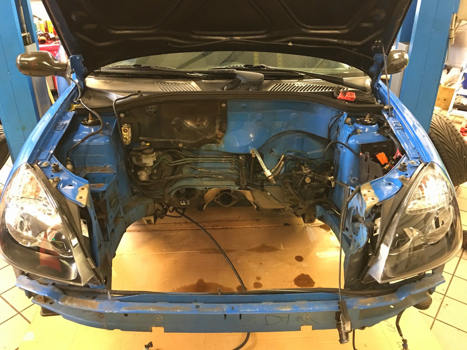

The old engine comes out -
The big hole left when the blown engine was removed ...

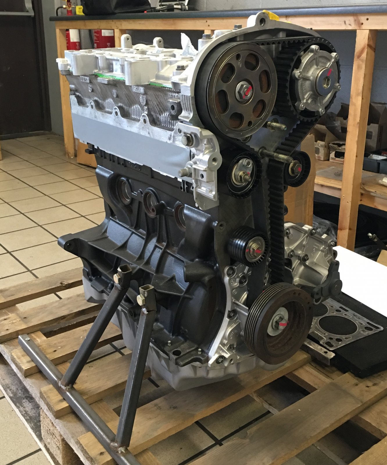

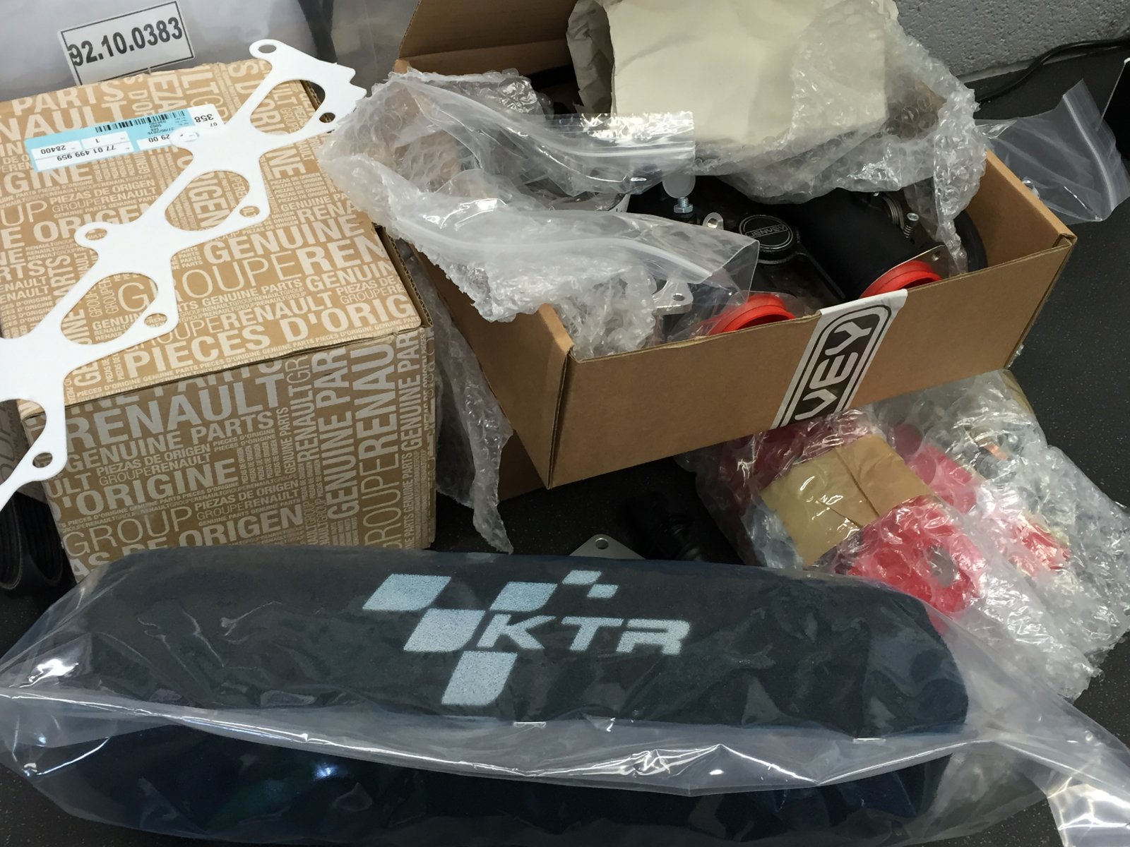

The new engine .... :-)
The goodies ready to go on .....
The new engine, clutch and gearbox back in place ....

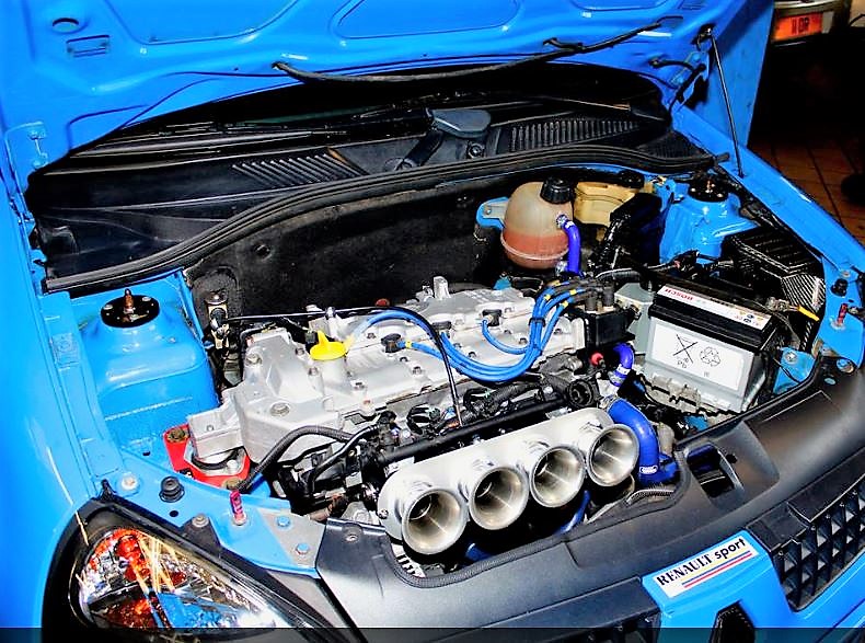

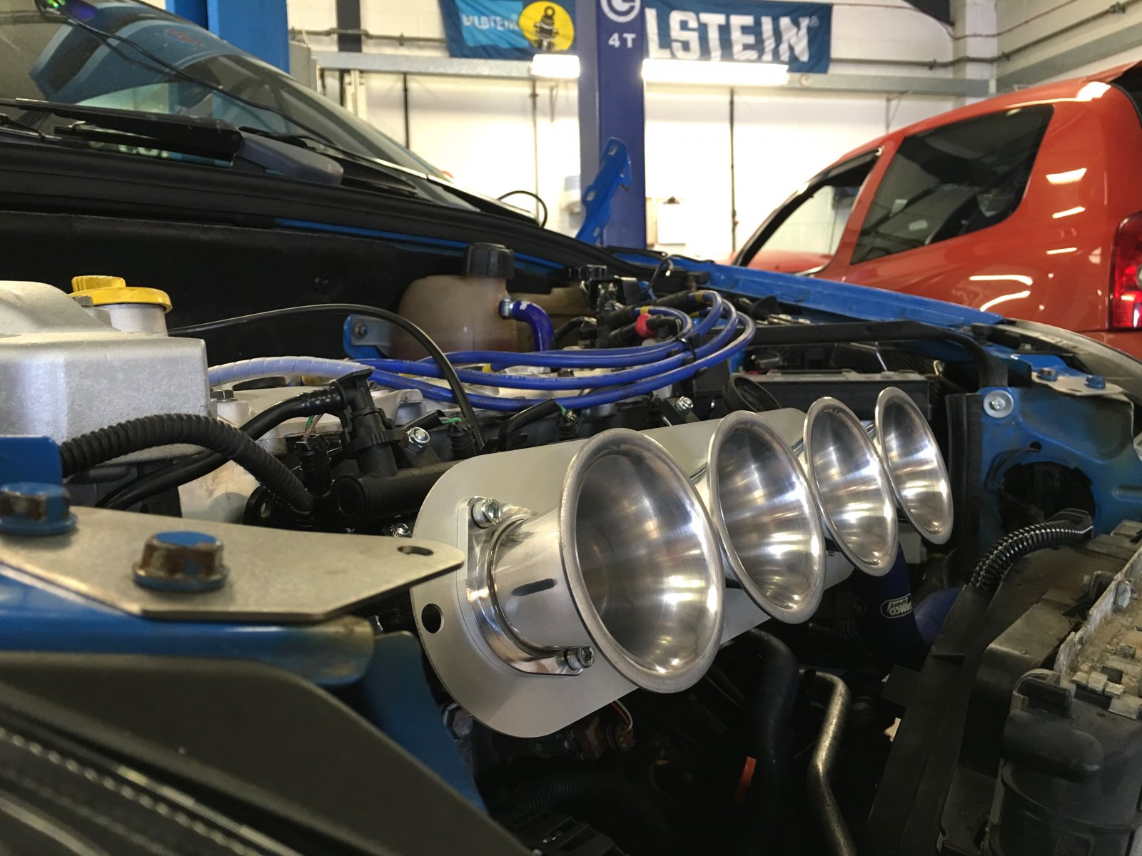

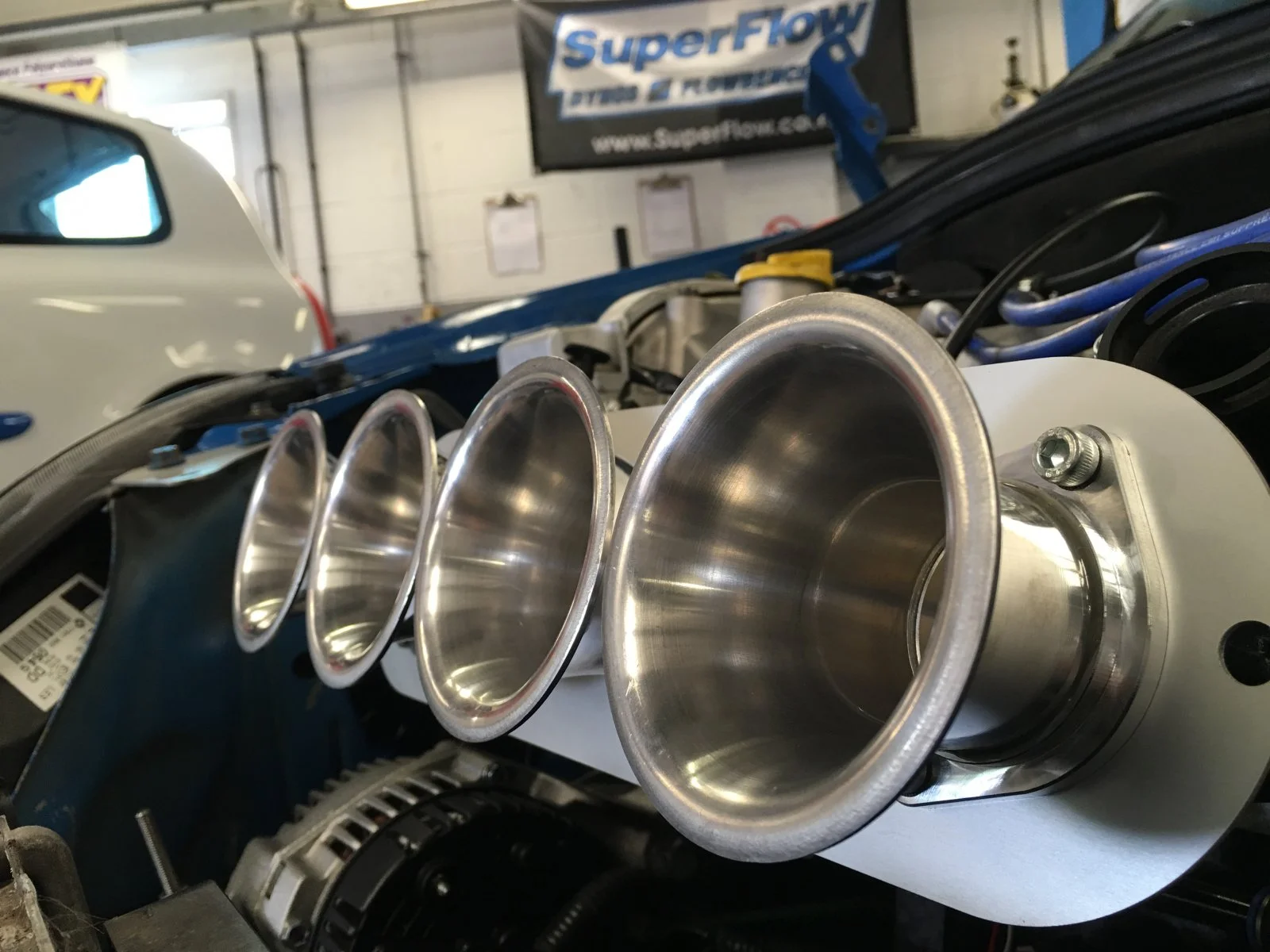

Throttle bodies and throttle cable fitted ....

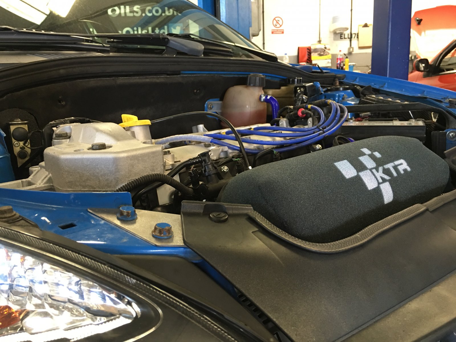

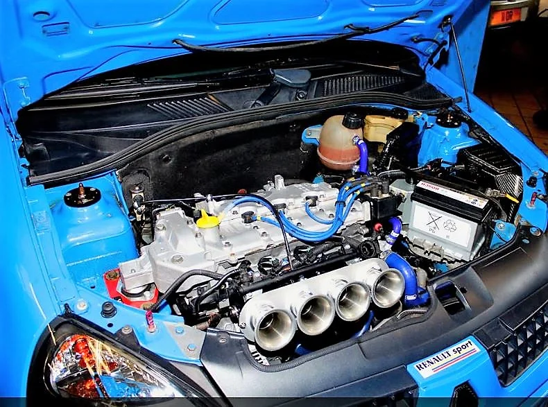

Air filter / trim fitted ....

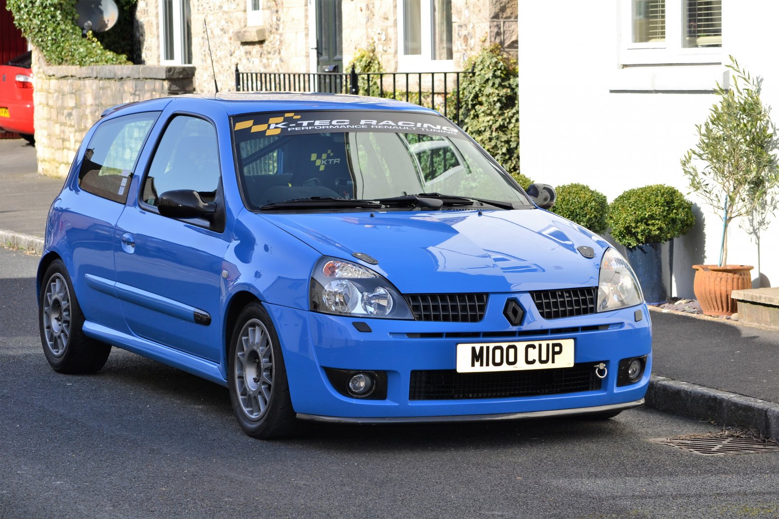

Chapter 2 Continued - I pick up the car:
What does it look like? - Incredible!
What does it drive like? - Incredible!
In Chapter 3 I will explain more about driving M100CUP and my first competitions in the Clio. Just to finish Chapter 2 off are the following photos of what the car looks like after the rebuild by K-Tec Racing:

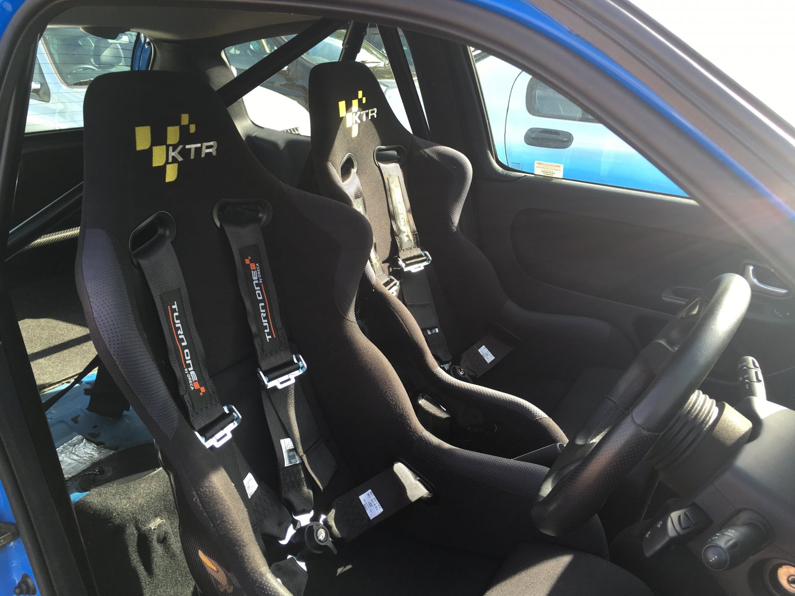

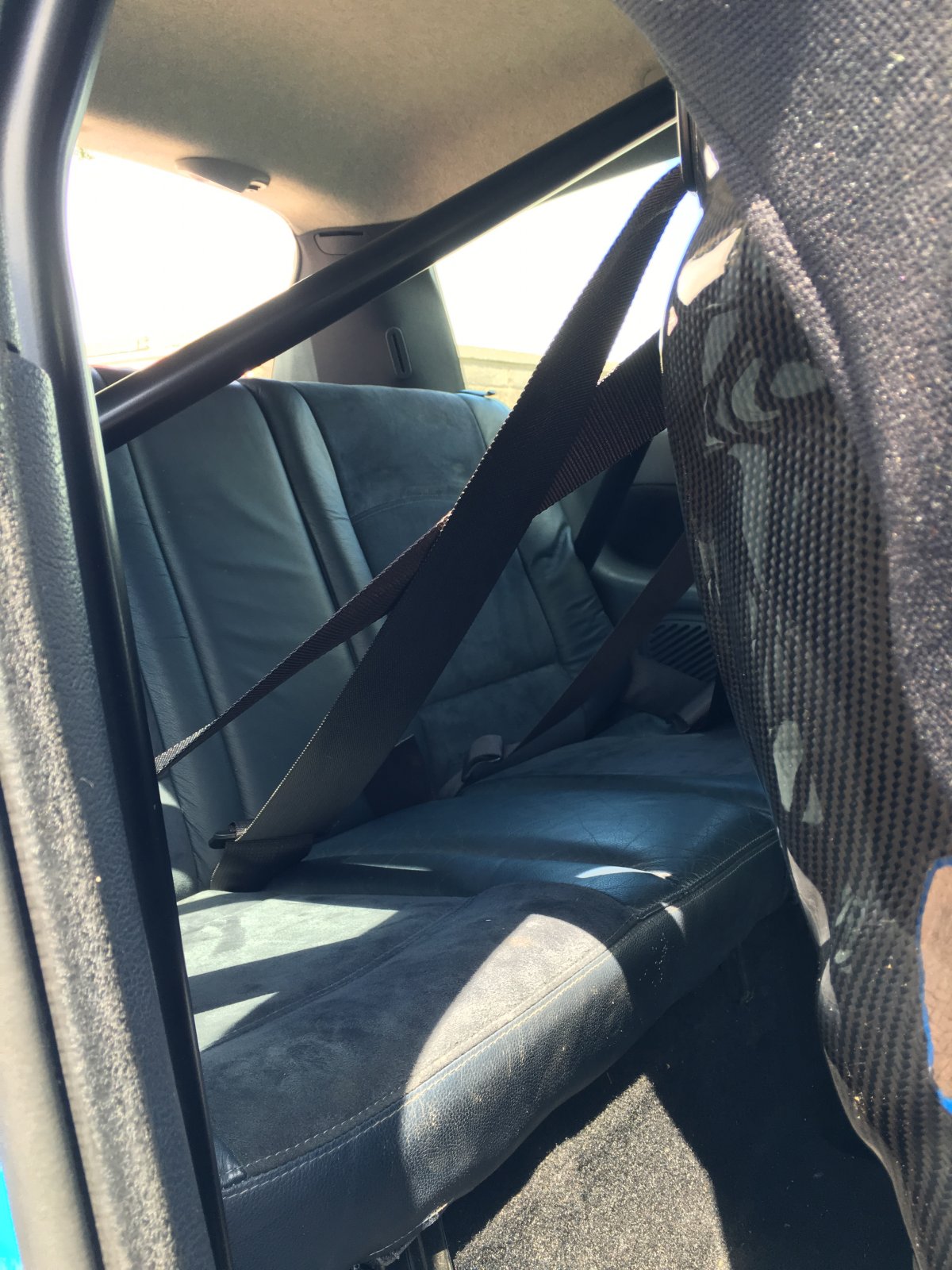

The interior with carbon seats, new harnesses and rear seat fitted -
Rear seat fitted (required by hillclimb regulations) - needed pruning to accommodate the rollbar and harnesses -

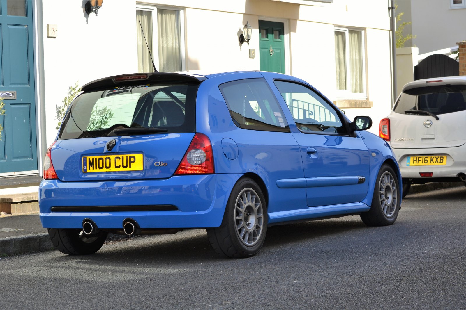

After a quick polish -

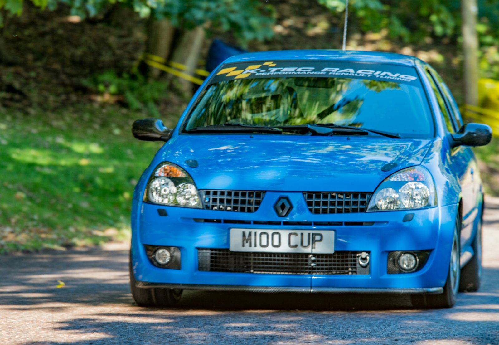

Chapter 3 - teaser - using it in anger .....
So that's the main part of the build completed ... In the next instalment I will look at the driving experience, what I love and what I hate about the Clio. Thanks for reading this far :-)

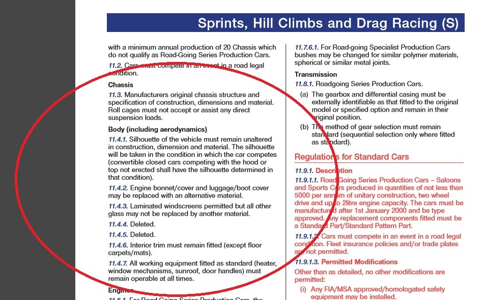

You may also come up against some opposition from other competitors regarding the front slam panel being missing when you start winning

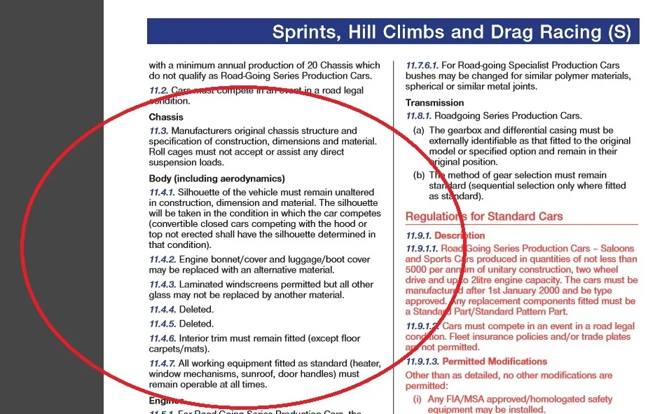

Good to know you need a backseat for hill climbing
For specialist road going you have to keep all the trim but are allowed to remove the carpets and replace the seats and steering wheel and can run semi racing tyres from the MSA 1b list. The new production class is even stricter and you have to leave the car basically as it came from the factory and run on road tyre (MSA 1a) (with some others rules as well for both classes)
Thanks,
What about a cage? I see graham has a rear cage. So I take it's a safety element?
A cage is an msa recommendation but is not mandatory. All you need is a car with yellow tape around the battery earth, a sticker showing the on/off for ignition, FIA race suit, helmet and gloves and a metal strut on front of car to break beam oh and msa non race licence which requires no test ARDS or bars.

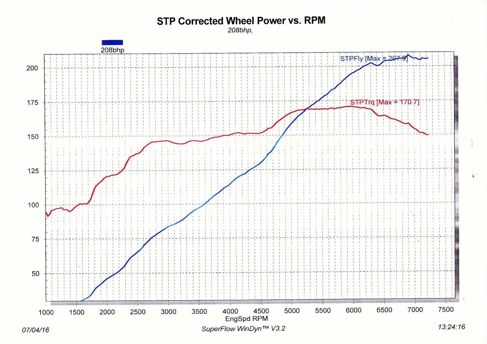

@Davyy asked about the power output – this is the video taken by K-Tec of the power run ( I always get nervous when I see this – just in case it goes 'pop')
Link to Face book video below -
And below is the actual Power Chart printout. I was a little bit disappointed as I was hoping for just over 210 BHP but it made 208 bhp on a new, tight engine .
Power Chart -
I picked the car up from K-Tec 4 days before my first event – Castle Hillclimb at Lostwithiel, Cornwall.
I packed the car up on the Friday morning with a little bit of apprehension – the furthest I'd driven the car was 10 miles and now I was driving it down into the wildest depths of Cornwall. I had the road works on the A30 to look forward to.... but it would be good to meet up with all the ASWMC crowd again (probably the friendliest championship in the UK? A lot of people with funny Cornish accents but nobodies perfect … lol). We normally have a nice meal on the Saturday night at the Globe Hotel, in Lostwithiel – instead of the 'Lager Louts' we are the 'Saga Louts'.
I didn't have to worry – the car performed beautifully all weekend. The trip down was busy – lots of holiday traffic on the M5 and A30 but the Clio was brilliant and plenty fast enough for pleasant and relaxed cruising. My results at the hillclimb were not brilliant - @Brushwood69 was miles faster than me in his superb Audi TT. I managed mid table as you can see below – so I was very happy for my first time out in the car.
Castle Hillclimb Results -

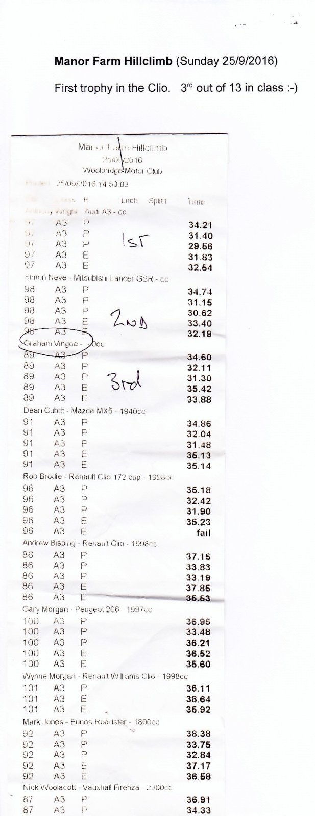

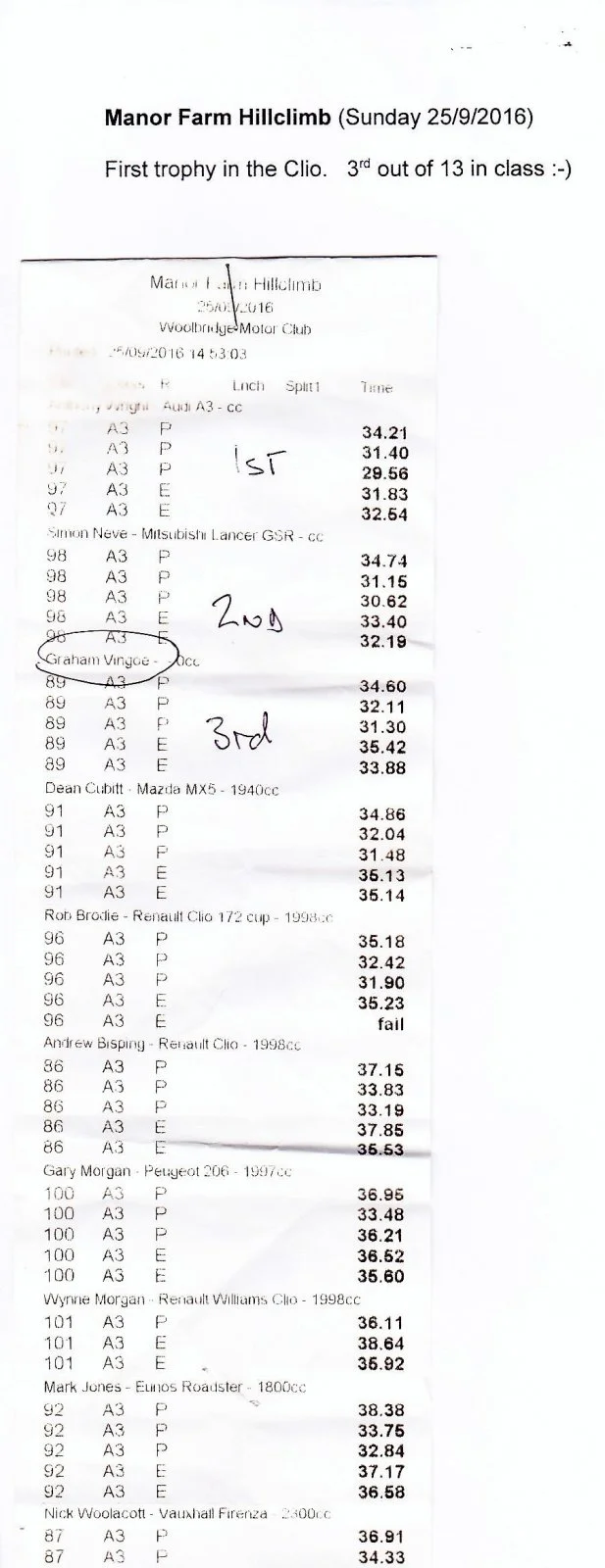

Manor Farm was my next event– damp and slippy but my best result in the Clio. 3rd in class out of 13 class entries!!! I have to say I think I got more fun out of that result than getting a class win in the Caterham. Perhaps I was now getting used to front wheel drive?
Great selection of cars in my class – including a very well prepared Vauxhall Firenza. Remember them?
Manor Farm results -

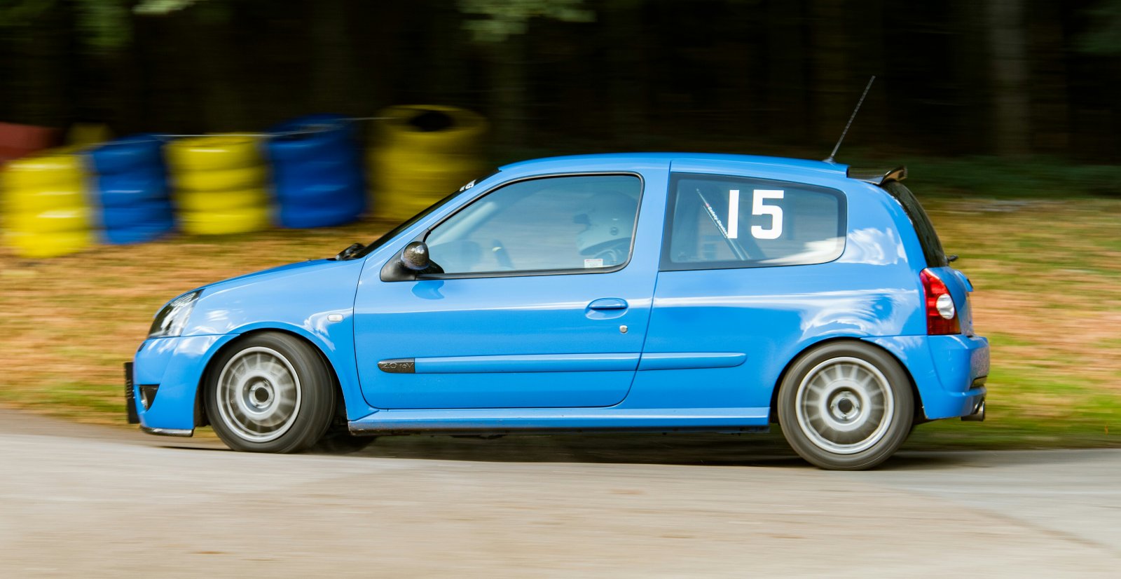

My final outing of 2016 was a late entry into Mamhead Hillclimb in Devon. Not good – some gear selection problems – more of that later but the photos were good.
Mamhead photos -

I would consider looking into lighter wheels and some AST suspension.
I thought that about the slam panel when I saw it too.
Lovely looking car though.
A great read, as Bash has said a gripper diff and higher final drive will make a big difference , more so than big power imho.
Another guy who may have already helped you is George Koopman, he ran a Trophy a few years back and we shared lots of info,well more him than me lol
The slam panel is tricky as you have Jenveys that sweep upwards so is pretty impossible to cover up. I used AT direct to head bodies but with short ram pipes made very little torque so ended up selling them.

Re the comments on the 'slam panel' having a wedge cut out to miss the throttle bodies - Looking at the 2017 Blue Book I don't think its a problem in the Series Production category for Sprints and Hillclimbs as I have not altered the 'silhouette'. I think 11.4.1 covers it:
Power Chart -
