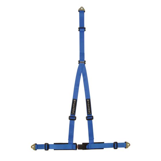

Also note that this type of harness (3 point below) is a complete no-no for any competition...… even 'road going' classes.

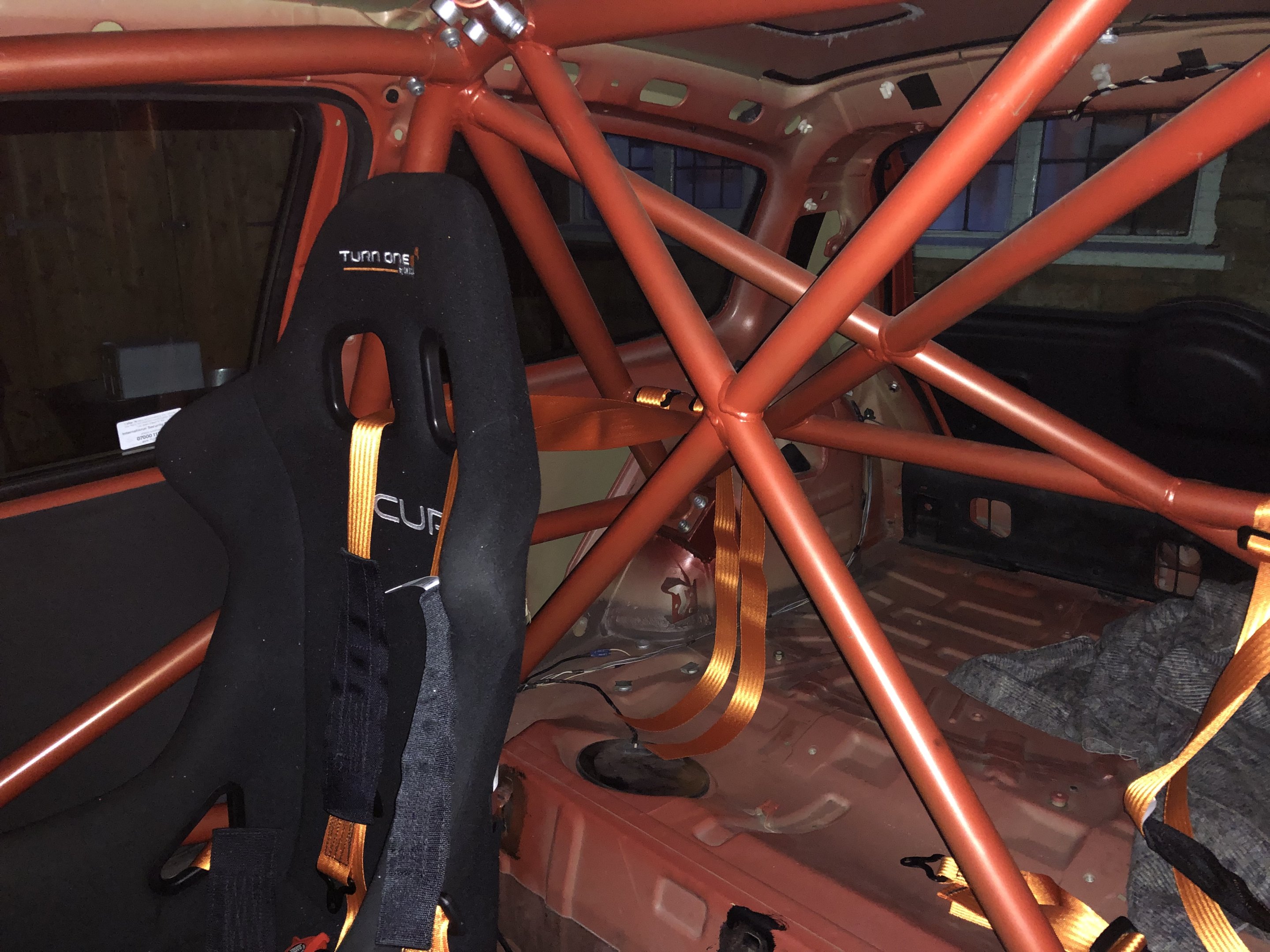

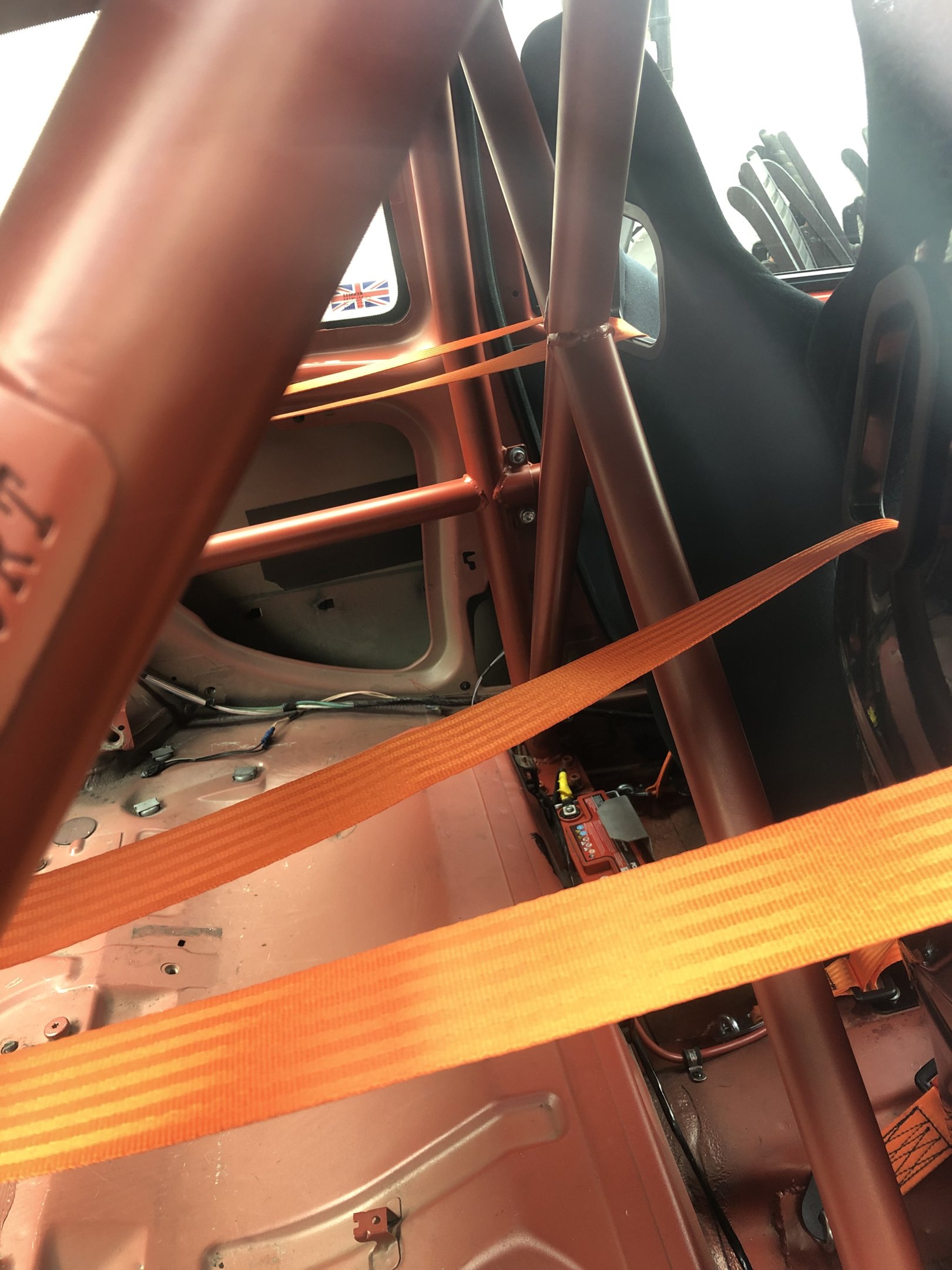

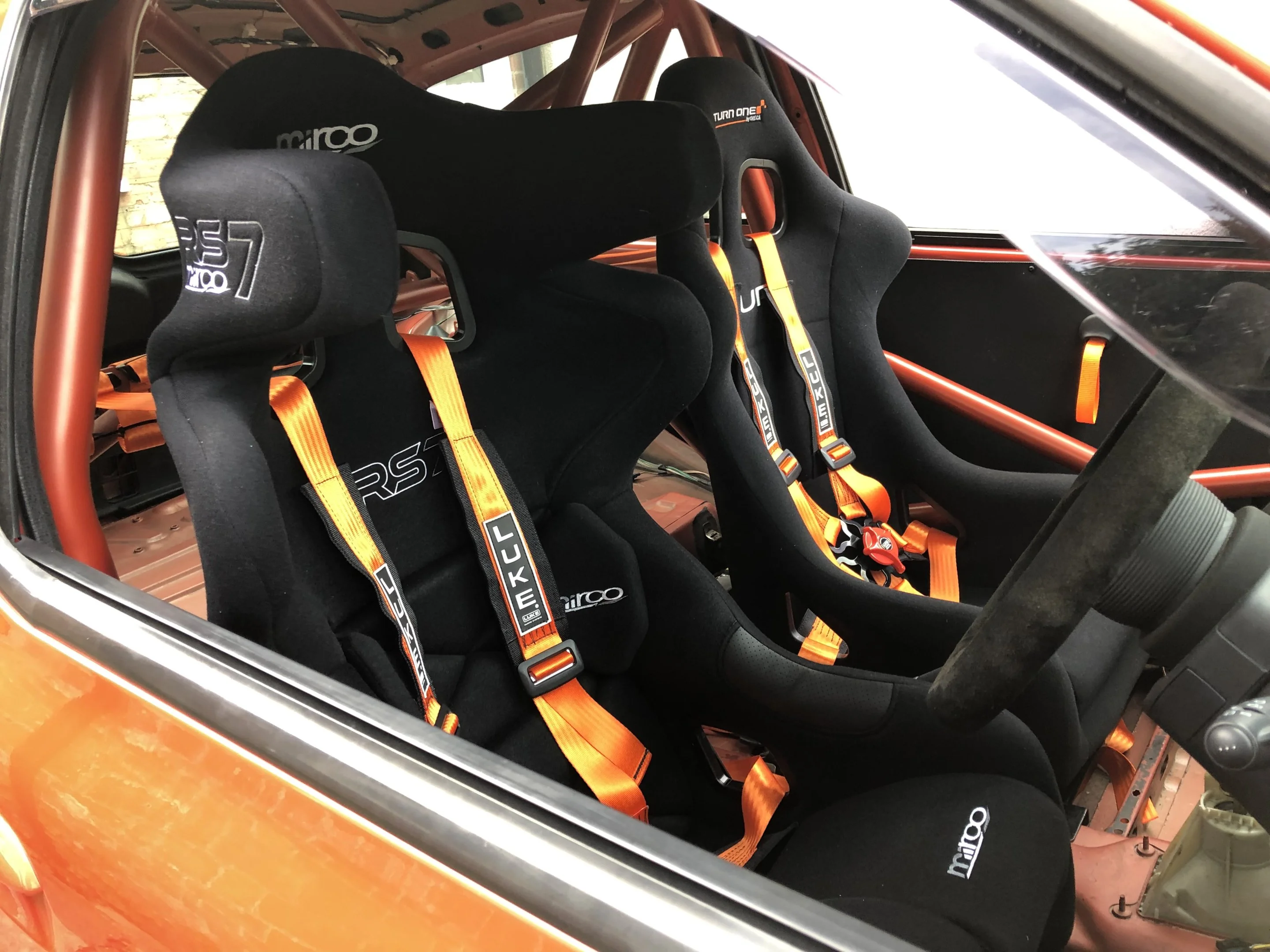

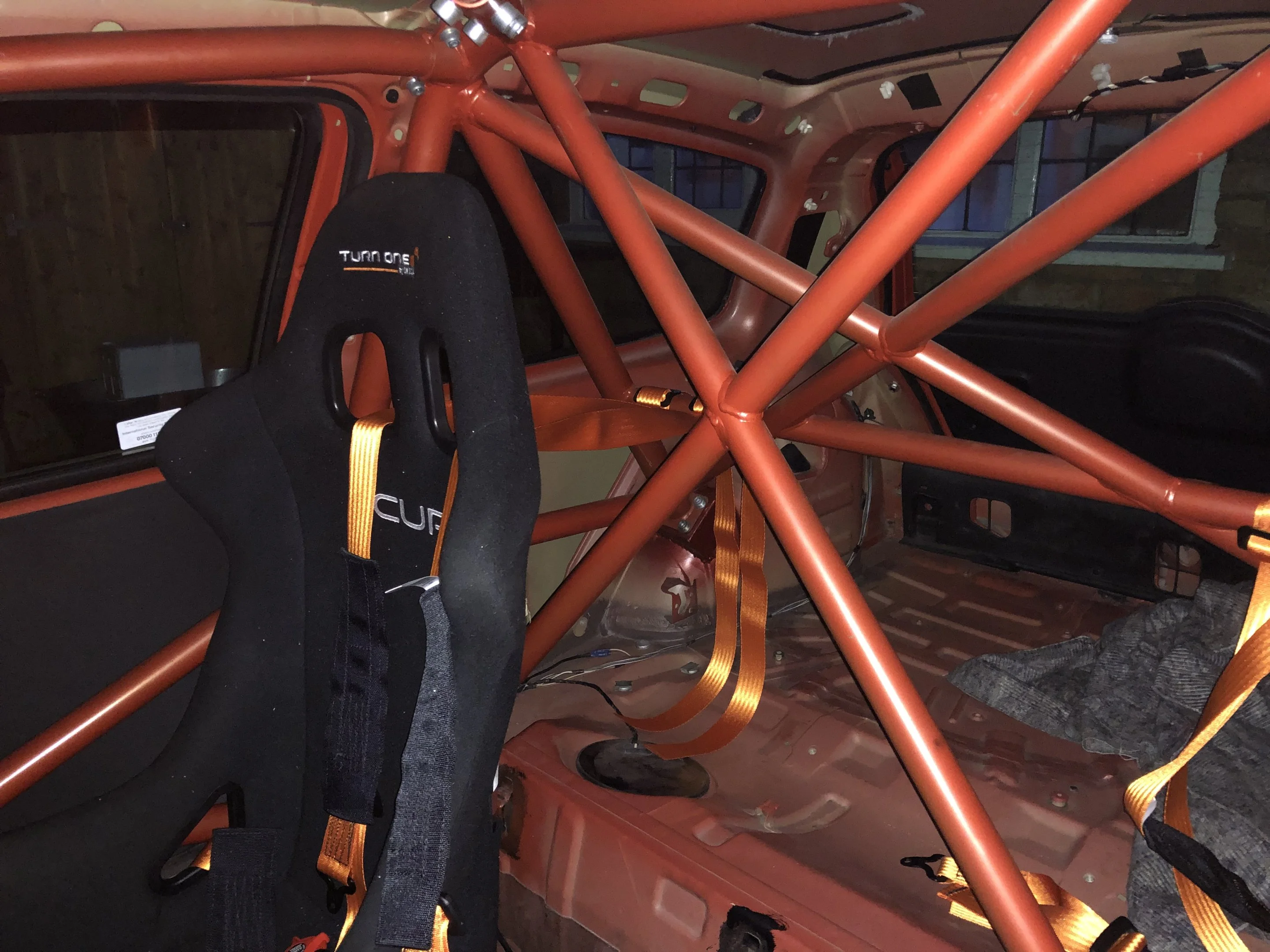

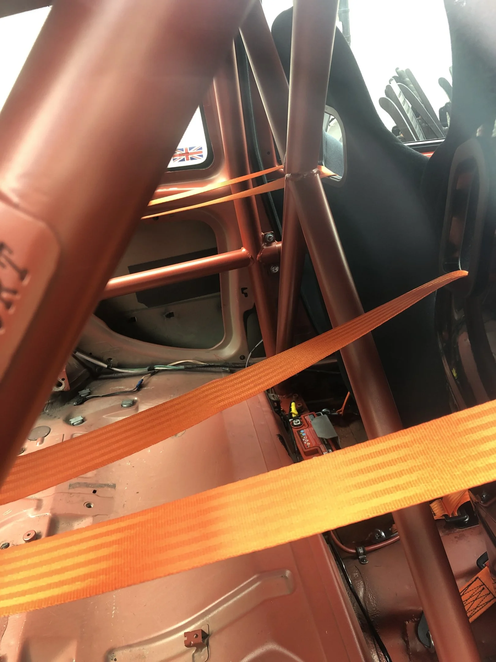

I have a MSA full cage with door bars and roof cross.
Battery moved inside the cabin behind the passenger seat so no lead acid
Fully stripped of all plastics but standard dash

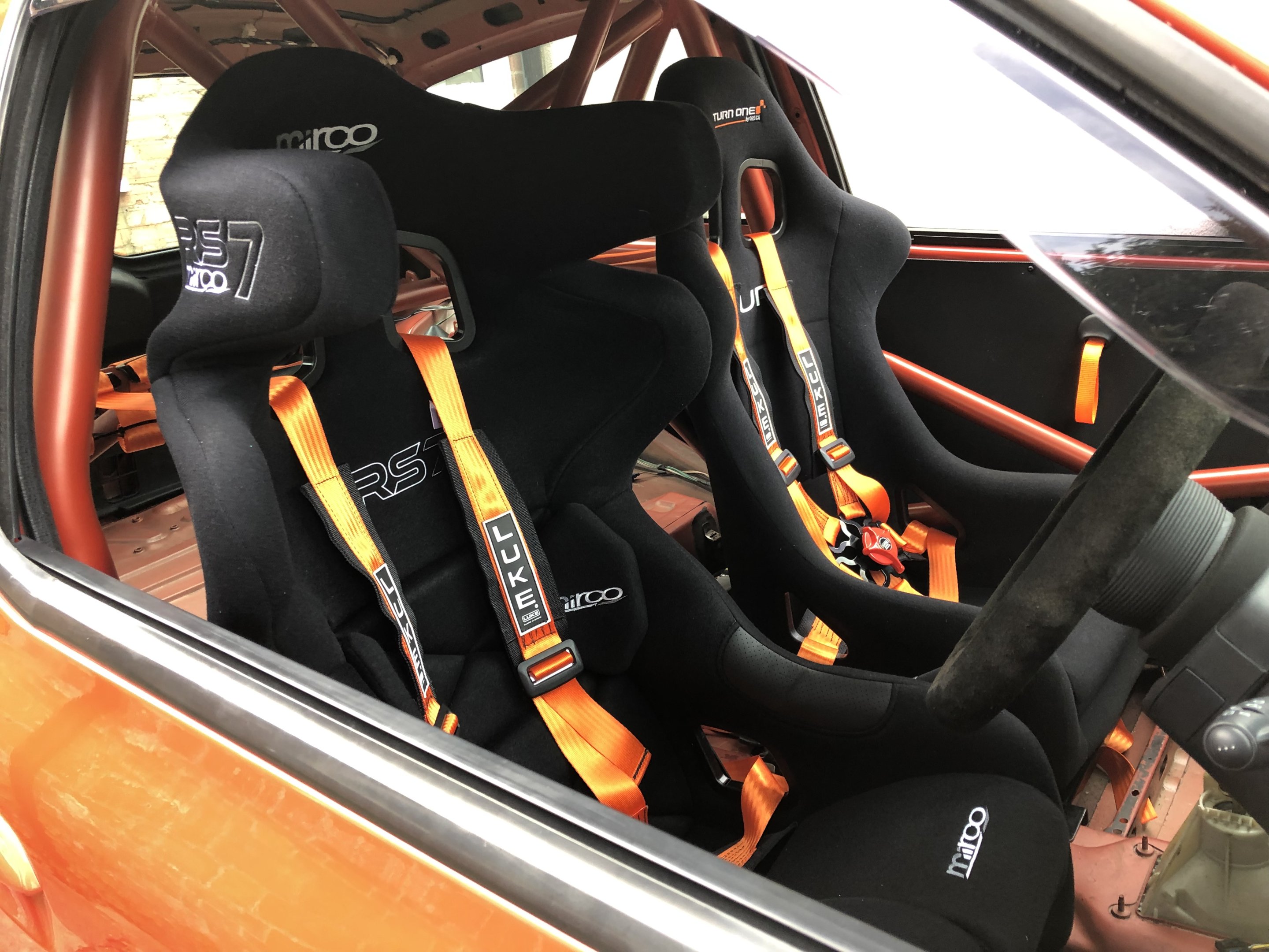

6 point harnesses
Lightweight door cards

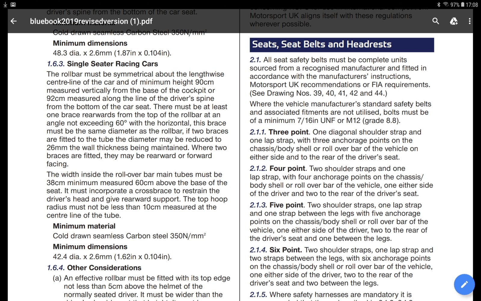

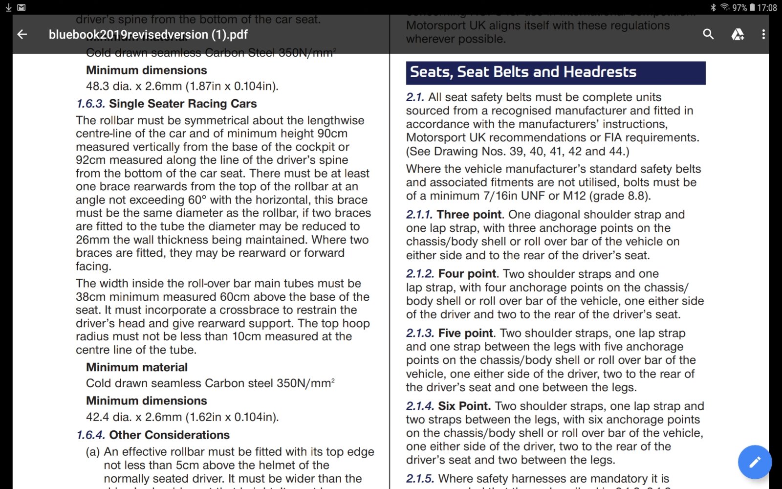

They don't comply with the Motorsport UK definition of a three point harness. Over the years I've seen a couple of cars excluded for having those types of harness....
Page 162 of the 2019 Blue Book. Sorry .....
No need to apologize, as I don't need to follow a rule book, I was just wondering if they were not to be considered safe, and what the reason might be. To my understanding, the blue book definition of a 3 point seatbelt is a seatbelt as original supplied by the car manufacterer.
