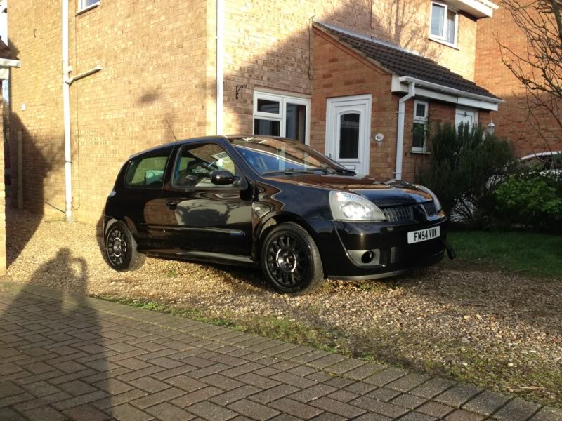

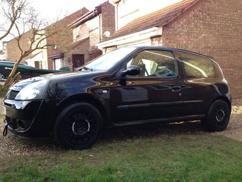

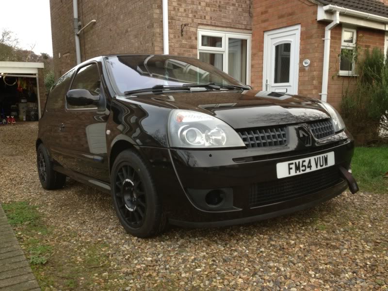

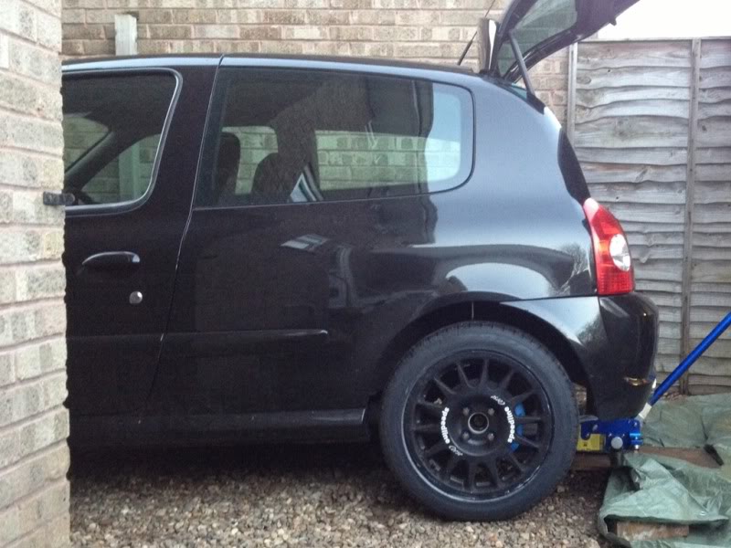

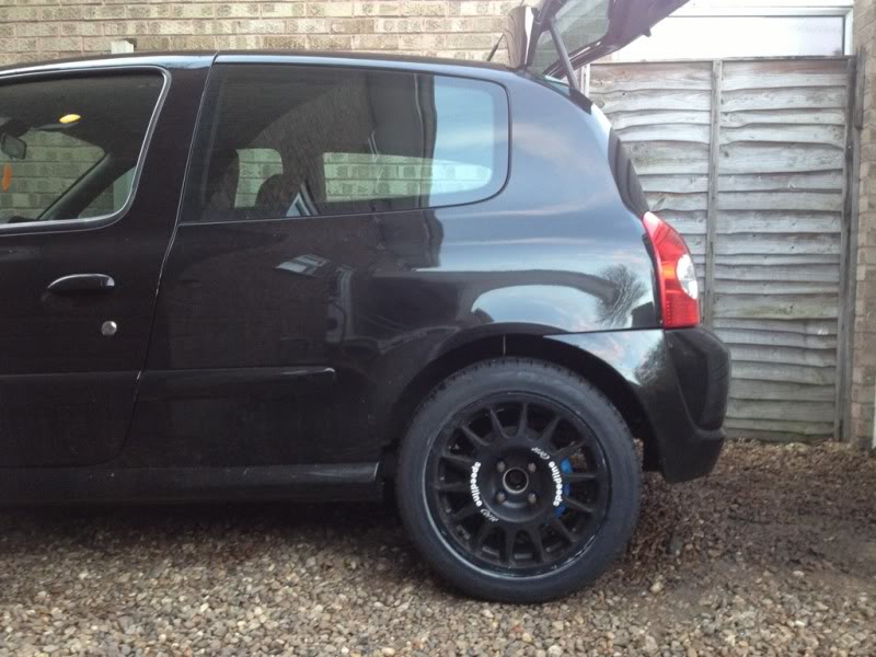

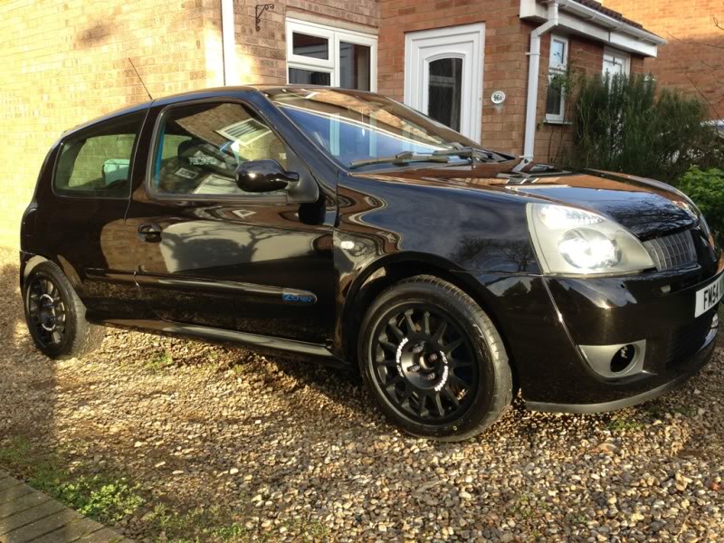

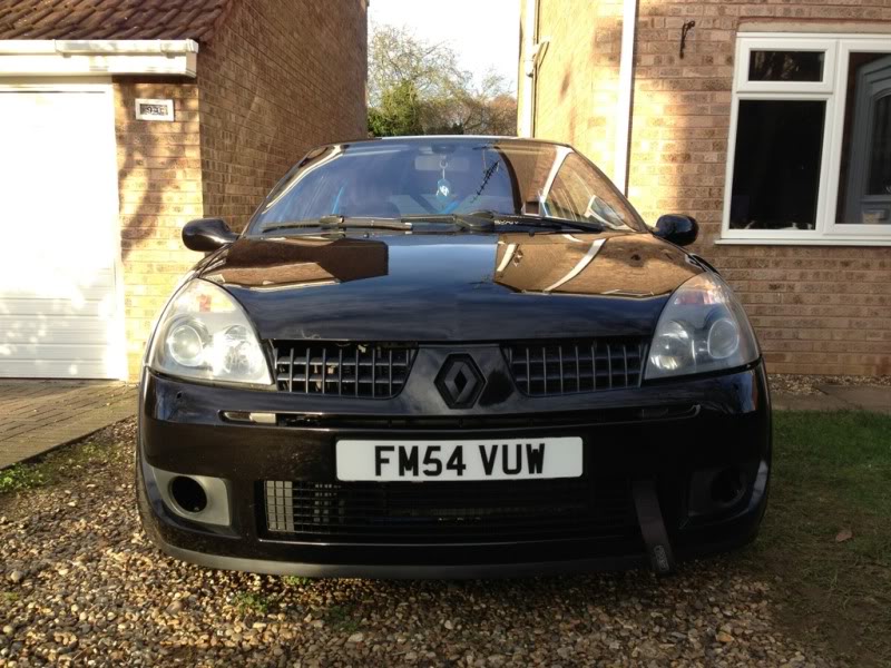

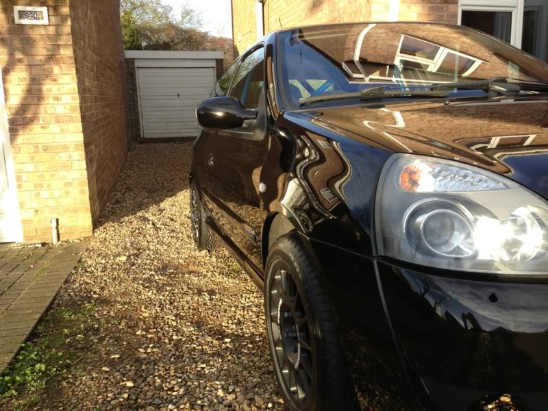

Little bit of an update. Well after fitting standard springs and shocks it became obvious, when you combine a mostly stripped interior, with standard shocks and springs and 15" wheels, it becomes a 4x4 lol So i thought i'd splash out on some Eibach Proline springs that were on ebay, and local to me so saved on the postage. They'd only done 700 miles, looked brand new so i was very happy with them although when i fitted the rears tonight the car actually looks higher, opinions please....
Before:
After:
I haven't fitted the fronts yet as this weekend i'm changing my wishbones, ball joints and track rod ends, at the same time hoping to cure my knocking. I also have an ABS sensor to fit too, so a good days work, considering my track rod ends as corroded to hell, any suggestions for help? lol
Oh yeah! hahaha
It'll drop about an inch or two with the handbrake off - it'll also settle another 3-5mm in the first week
When I first fitted my billies I set it where I wanted it and then a week later it was nearly scrubbing so I had to wind them back up a bit
  Trafic 140dci
Lol i feel pretty silly now, i did let the handbrake off and it did drop a bit :)
Lol I know you said your drive was a nightmare to get on and off, but come on.:)
Haha gonna have to get a picture of the end as it's pretty steep :p
Never forget when you fitted that arb upside down "lew that doesn't look right some how....." :p
She's looking good tho mate :D
Oh yeah, i done well i guess, no destructions to read, all guess work :p got there in the end though! :)
Thanks mate, by the time it's properly on the road it will almost be a new car :)

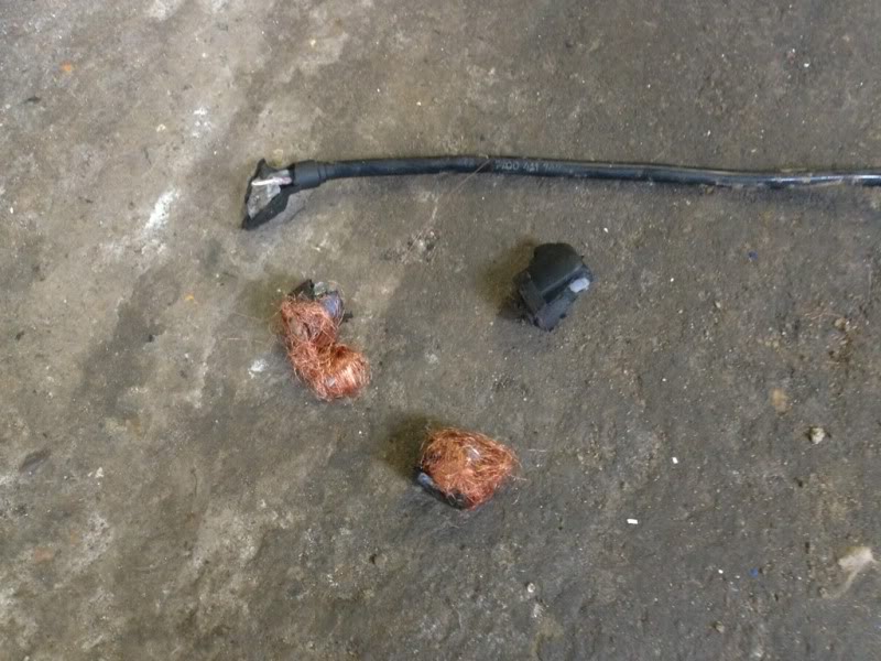

Been busy this weekend. So started off yesterday by changing the ABS sensor that's been playing up. Damn they are tight, ended up banging the s*it out of it with a hammer and wood chisel to brake it out lol. This is what was left of the old one once i got it out....
It was fair to say to say the corrosion had welded it in. I had to dremel away some of the corrosion to get the new sensor in. But that's all fitted and working now, which means for the first time in 6 months i have no warning lights on the dash :D

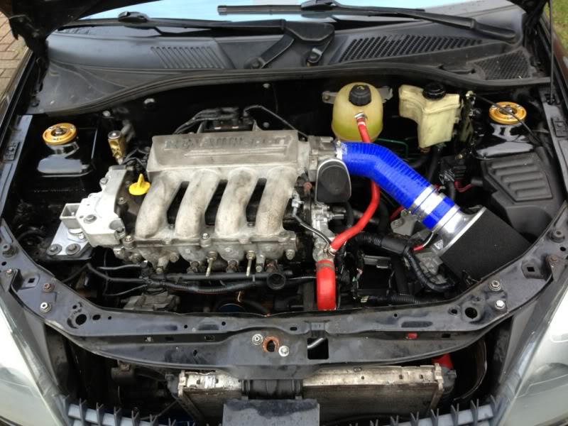

Engine bay could really do with some TLC, but saving that untill i have some VHT paint. Once that was done i gave the outside a quick wash down as the car looked like i had been 4x4ing then it started raining lol so never got the chance to dry it. Come back to it this morning now the rain had stopped and got some photo's before i started fitting the cage.

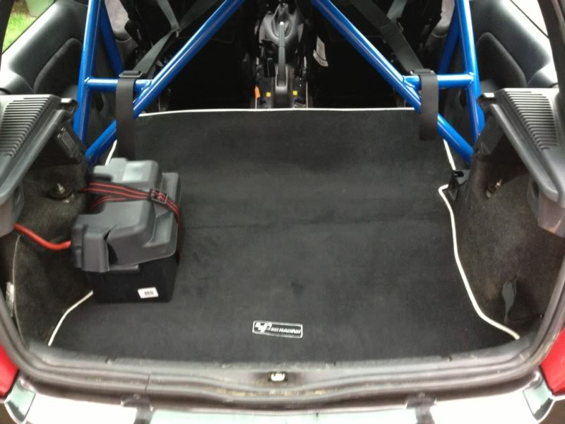

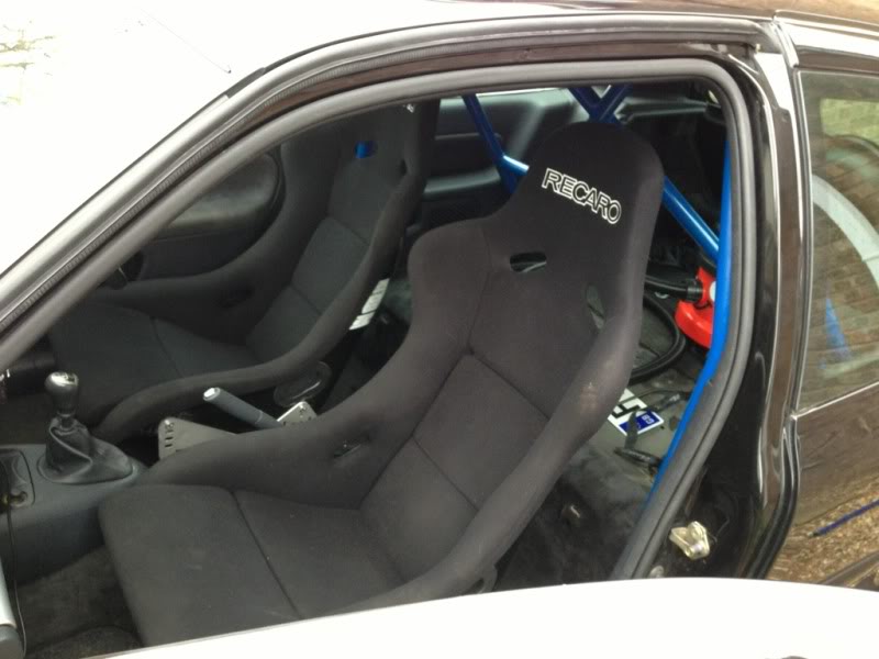

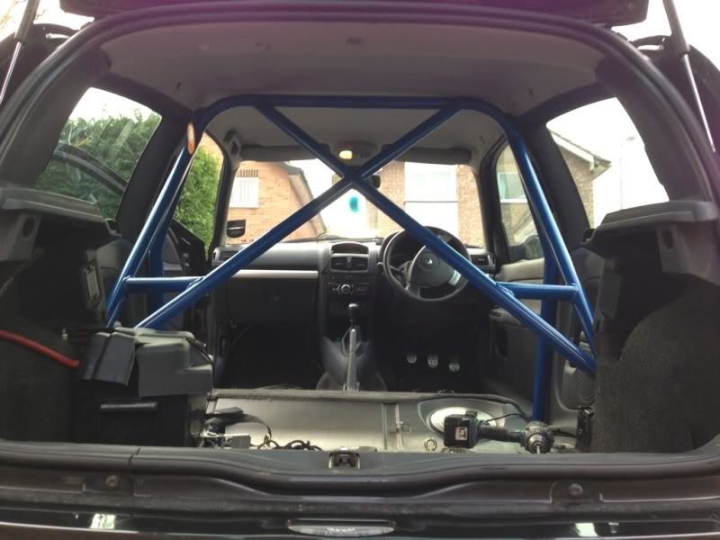

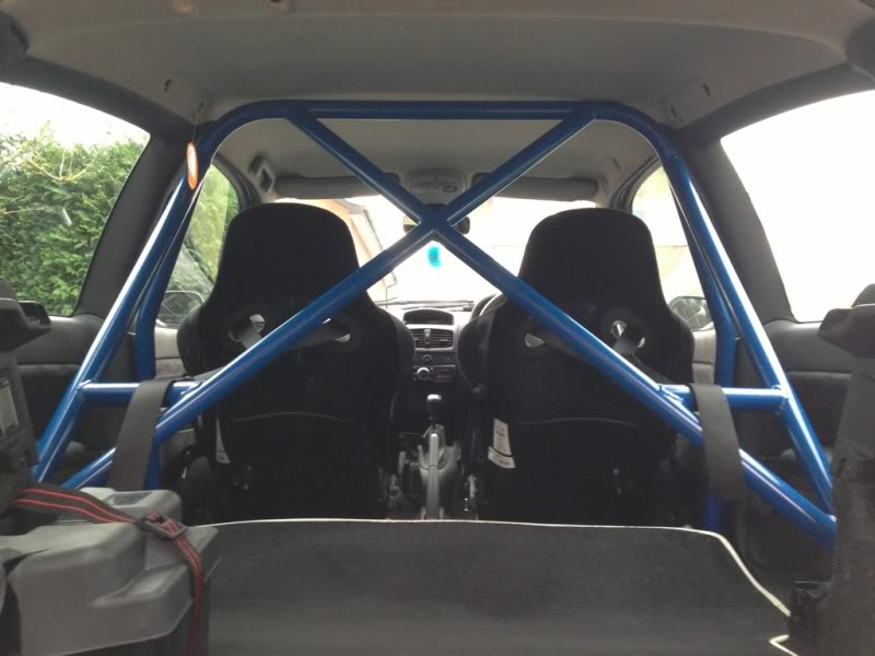

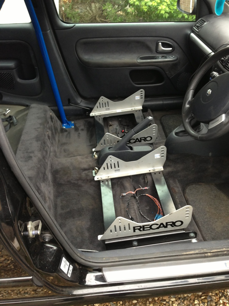

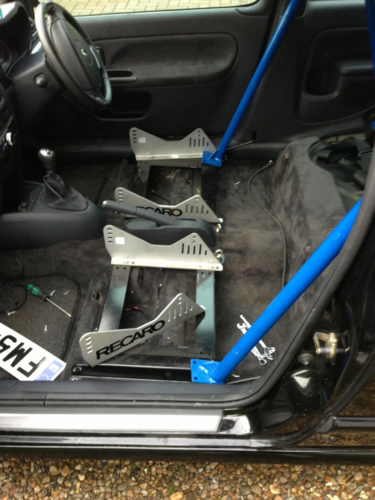

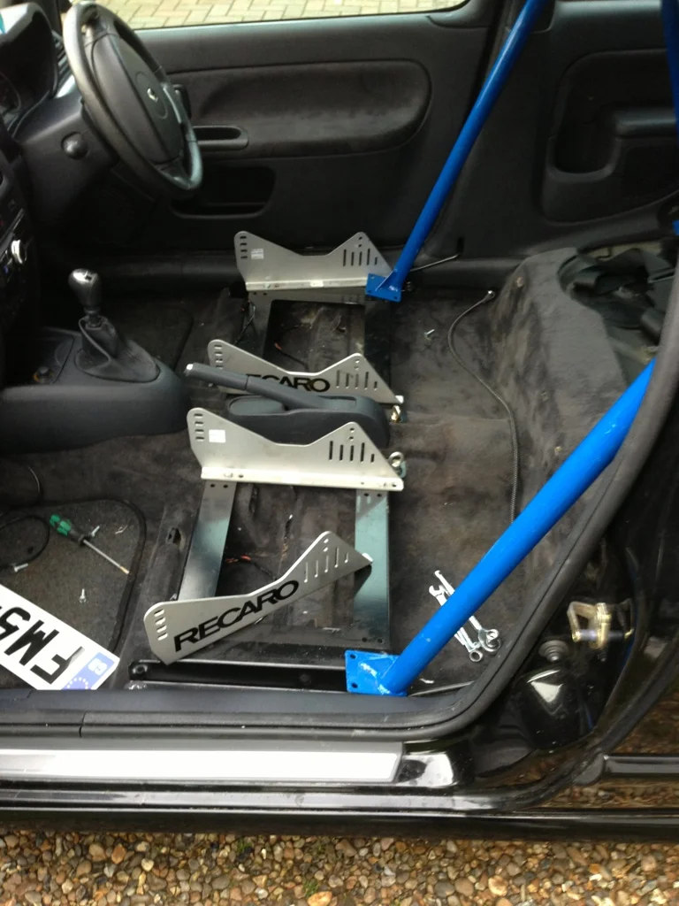

I then cracked on with fitting my half cage, i thought i'd try and be cleaver and just remove the seats off the side mounts and leave the subframes in (hate going under car..) but i soon realised the cage was that tight it wasn't going to be that easy...
So the subframes had to come out anyway. I then wiggled the cage in, i must say it's a perfect fit, very happy, with all the interior plastics and head liner still in it was dead tight, got it in and into position.
Fixed it down with M8 (i think 8.5mm drill bit was dead tight with these) high tensile nuts and bolts. Subframes back in, quick hoover around...
Seats in...
Harnesses on the new harness bar.
K-tec boot mat put in place, couldn't use this before as the harness' were fitted to the floor, much neater inside the car now.

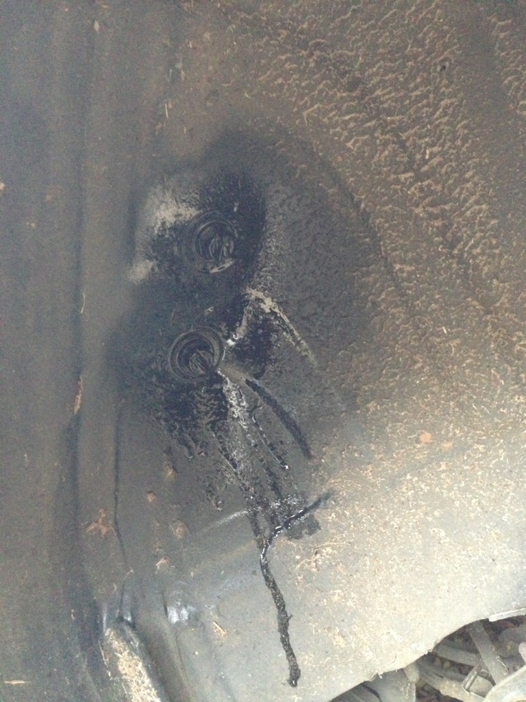

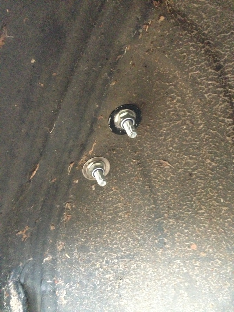

I then trimmed the bolts down under the car and sprayed black to prevent corrosion, will use proper under body sealer at some point but this was just to do for now. I intended on using the strengthening plates on the rear archs but they needed bending the fit this just seemed a much easier way with some big washers. I'm not too fussed as i doubt the car will ever see any track action.
More to come soon :)

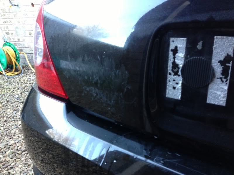

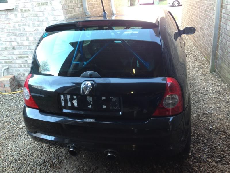

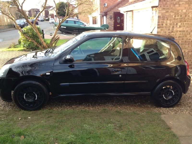

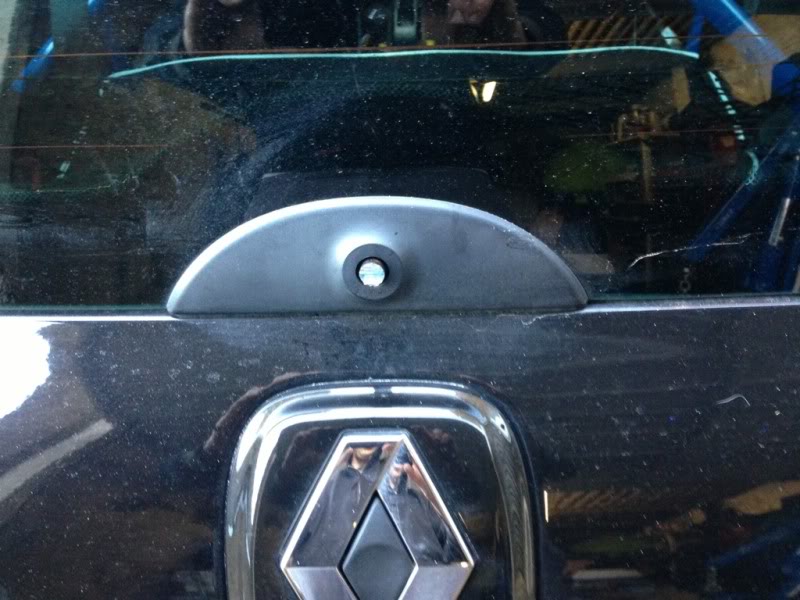

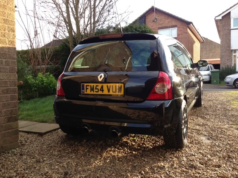

Done a bit more today, started by de wipering the rear, done it the lazy way by taking hack saw to it lol:
Then i removed my RenaultSport badge:
I then took the inside panel off the bootlid, removed the wiper motor and then pushed the Clio badge out. I then cleaned off from behind the badges and fitted a grommet to my wiper surround. The boot lid is looking alot better IMO would like one of them RS badges to go over the old Clio holes but don't have one yet.
I then gave the car a good wash, good hand polish and applied some AG HD wax and some tyre shine, i'm very pleased with how the car has come up, as I'm no detailing expert.

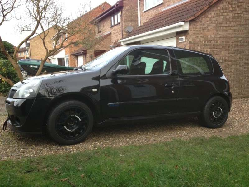

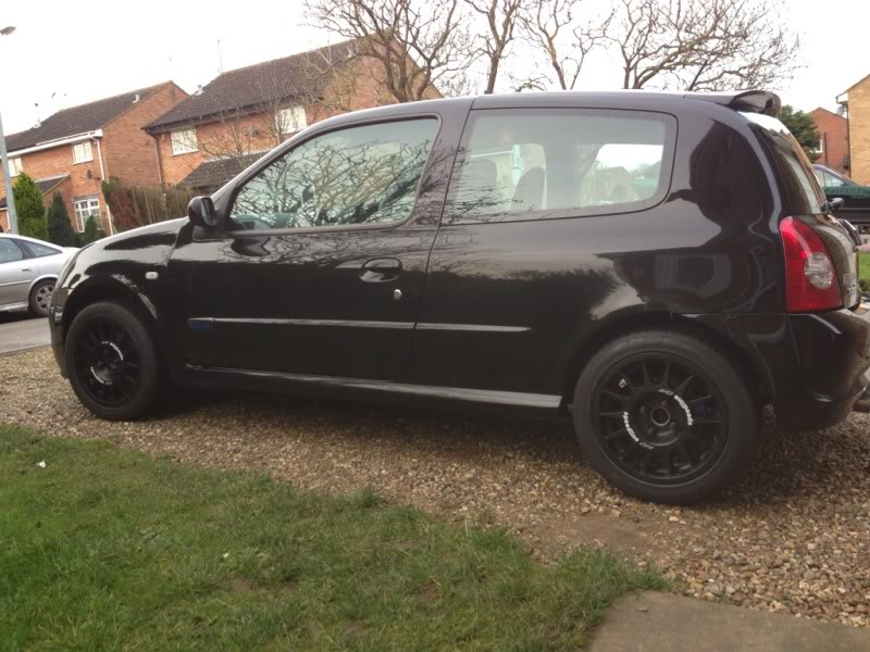

What's going on with the 4x4 stance lewis? Thought you had some uber fancy AST's or have they gone the journey?
  Trafic 140dci
I had alot of fancy things that have all gone due to house buy. Had an awesome stance when it was on the coilies. Standard shocks, eibach's and 15" wheels leaves me looking like a 4x4.
