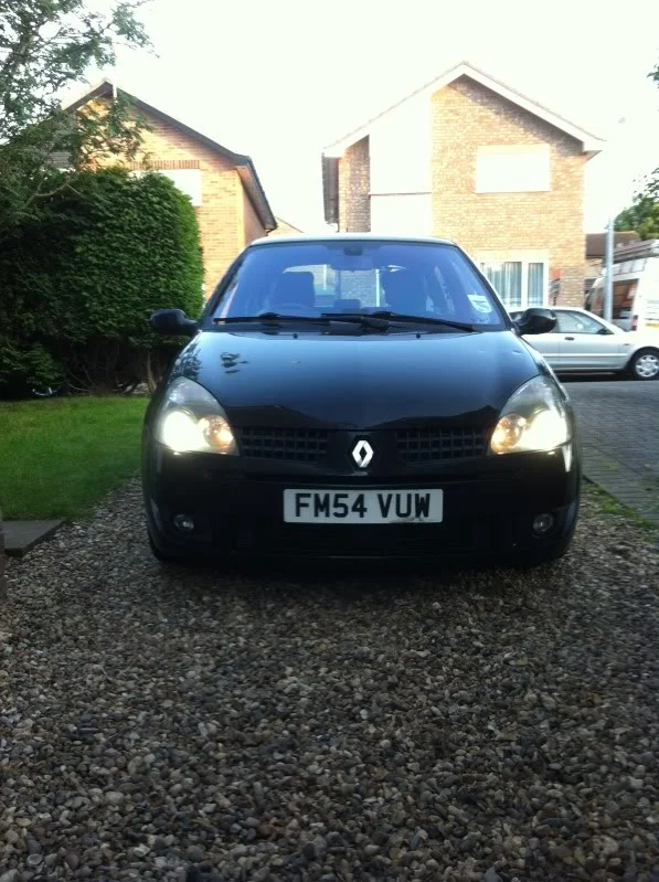

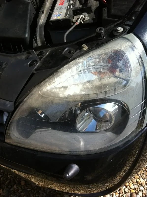

He dropped the car off to me Tuesday, and this is how it was upon arrival:

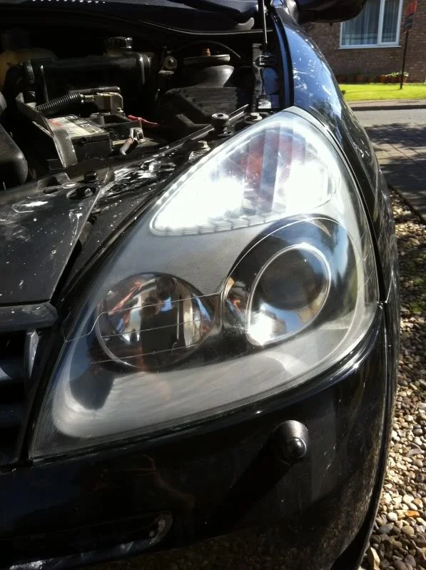

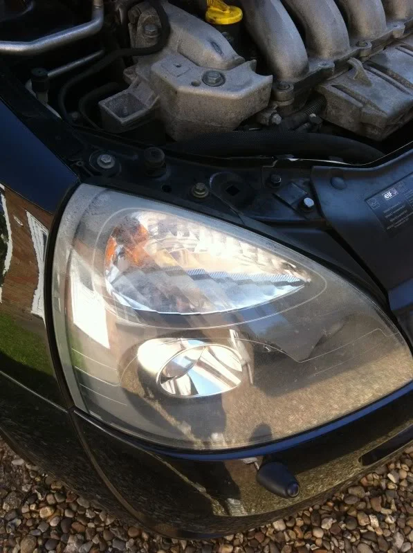

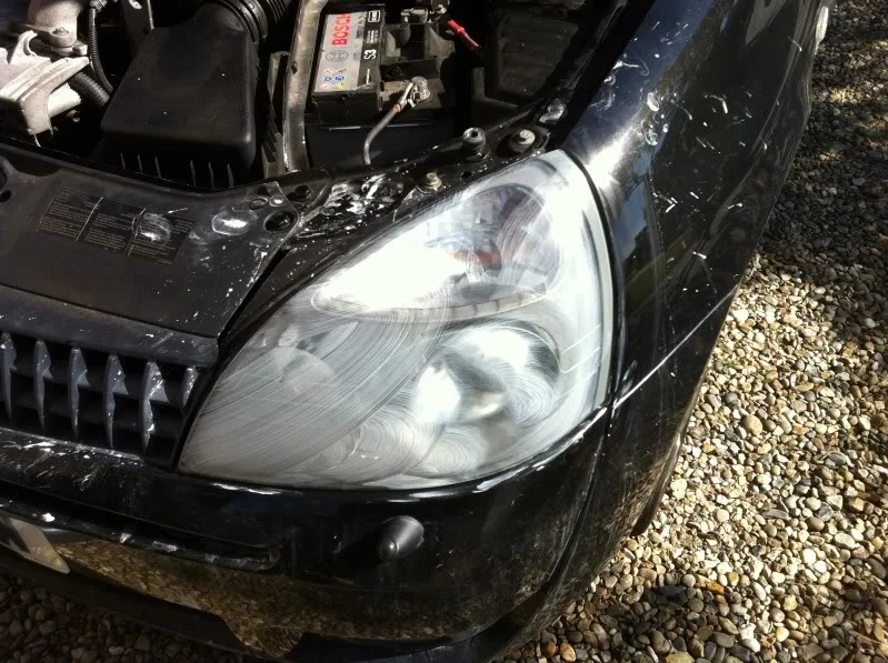

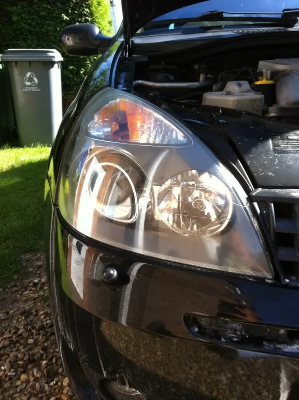

I started on it Wednesday, first job was a headlight refurb, IMO they need doing again, but i hate tedious time consuming jobs like this lol:

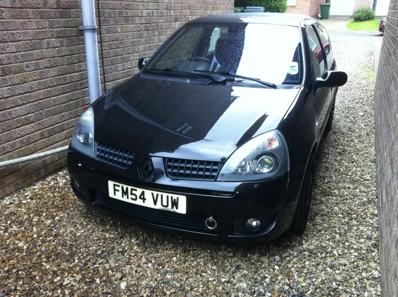

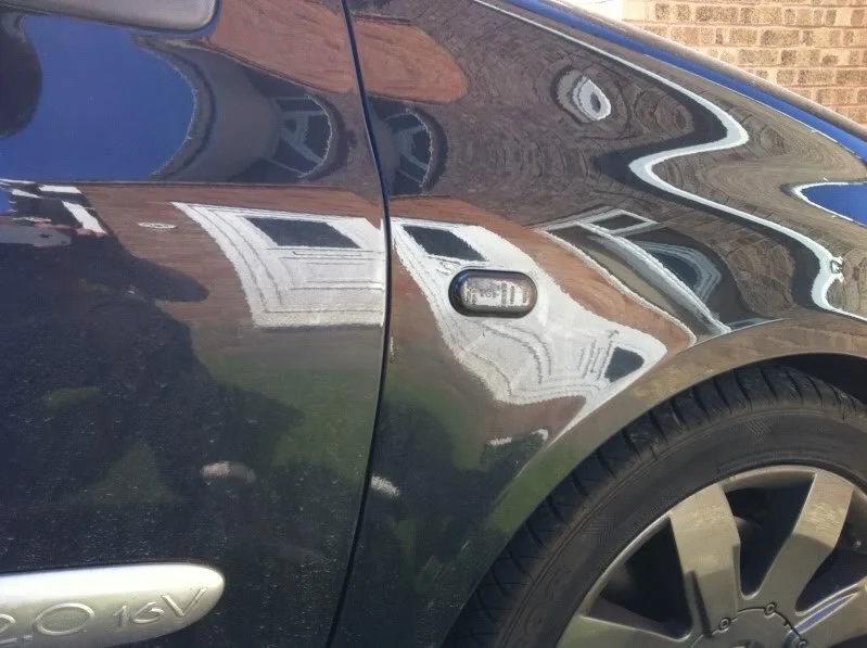

I then changed the smoked side repeaters for some clear ones that were supplied:

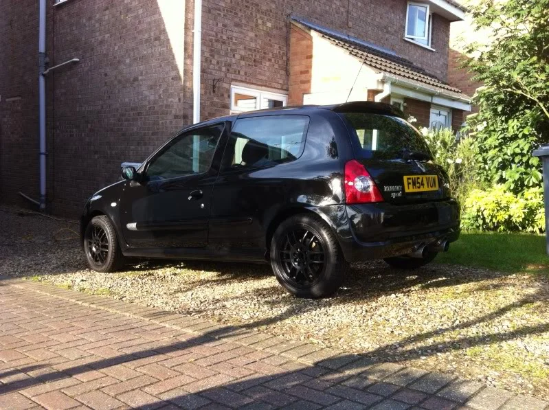

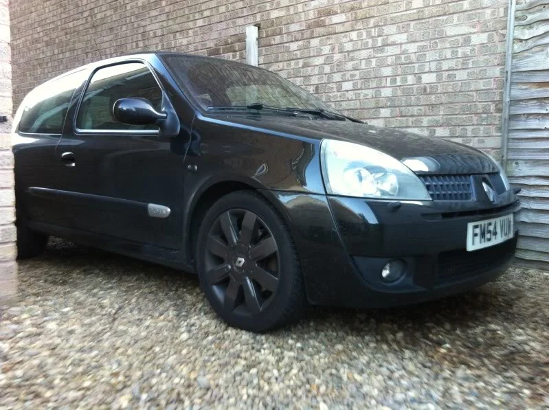

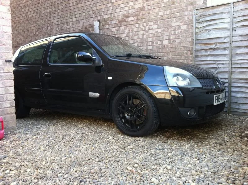

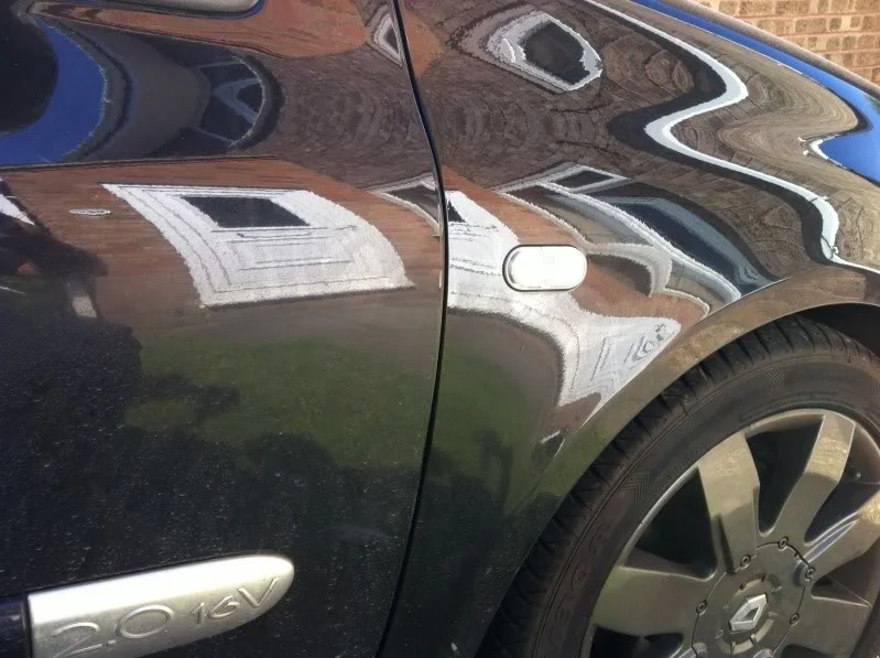

I then gave the car a well needed clean and fitted my OZ F1's :)
Tow eye and Satin Black front diamond fitted:

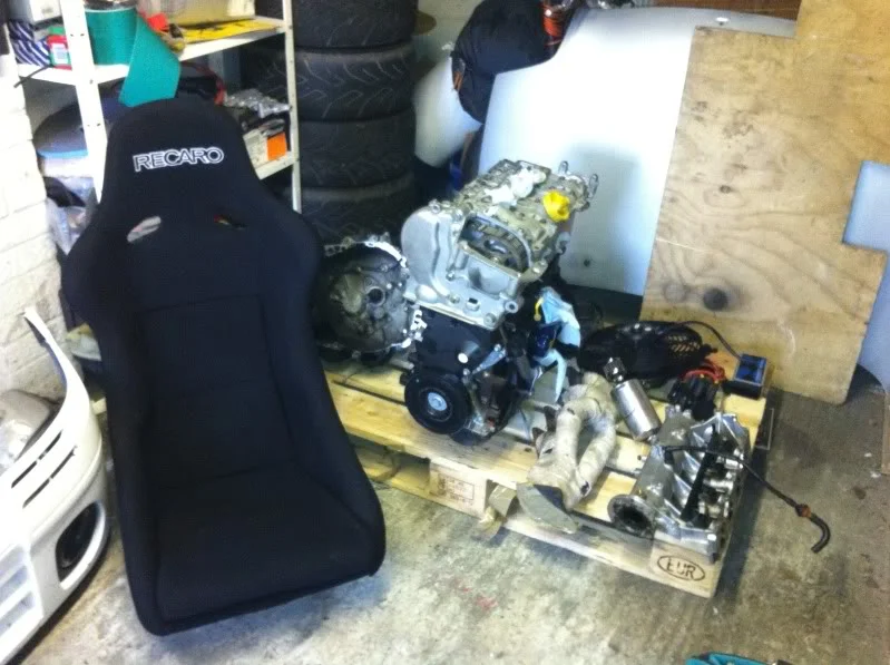

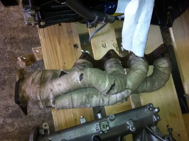

Custom Manifold:

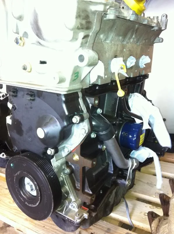

All my goodies from old car sorted now ready to go on when engine is fitted:
That's it for now :) Engine will be ready to go in as soon as i get the following parts:

Was the custom manifold made from a cut up and welded up 172 manifold? That's what I'm considdering doing.
Where is the oil return for the turbo on your block?
Should be a good project this.
Yeah that's all it is should give lots of clearance on brake lines and turbo should sit just below coolant bottle by the looks of things :)
No isea tbh haven't looked properly. Haha got nothing on yours, that's lovelly :)
How did you get on with the loom? Were you able to use much of the 172 loom then just add the extra required sensors? What ECU are you running?
Sorry to bug you with loads of questions :)

My oil return is to the sump but is non standard.
The loom is custom too for an adaptronic ecu. Need an additional coolant temp sensor but as I'm going piggy back the other sensors will all be off the OE management.

Not wanting to rain on your parade mate, but I'm not sure that manifold will work in a Clio bay. If your willing to bin the ABS unit off you might be able to squeeze it in but it's certainly not going to be a straight forward fit and you'll need a custom downpipe.
  Trafic 140dci
Re: Boosted BlackGold Project - F4rT content.
It's from Andyrg, he's been there, done it and got the t-shirt on this conversion. So I have no doubt it will be fine.
The custom down pipe isn't a problem at all, and if the abs has to go it will be a pain as its another job, but I'm not to bothered about that :) I'm more worried about it fouling on the coolant header tank, as I wouldn't know where I could move that to tbh.
IMO I think it's going to be a better solution to moving brake lines/turbo being mm's away from brake lines :)
I think k-tek's turbo 182 has a similar manifold to this?

I'm afraid Stevesprobably right, Andy didn't use this manifold on Red phase 1. This manifold was built for a Renault 5 conversion, I should know as I was there when I built it. Thats not to say it wont fit but you may need to move things around and you'll certainly need a custom downpipe!

Looking forward to seeing this done, I to am with stevie h on this one, there is not a lot of room and I binned the idea of a four branch manifold due to the abs unit, with turbo, 4 branch and downpipe there is not a lot of room, taking into account of under bonnet temps etc all the best with the conversion *subscribed* :)

If its the same manifold that he had on the engine when it was in my Mk1 liquid yellow shell before he swapped to the m2 shell then he used a pedal box to avoid issues with the brake servo etc IIRC

Been in a meggy 255 is nowhere as awesome as F4RT in the clio, I went out in one before i did my conversion, the power is amazing so smooth and hardly no lag if done properly. Andy is a great guy and helped me sort mine last year :) If you need any help or photos etc on bit mate let me know.
For manifold ive got the standard 225 then fully custom downpipe, i can get a picture if you need??
Depends if you wanna run abs still, ive got rid of mine and i run fully stand alone on adaptronic :)

He only bought the manifold last week Chip, and it's never been anywhere near his yellow or red clio :S

Not the same one then, just knew that was the same engine he had in it, hence I said "IF" with my reply, I wasnt saying it was the case mate so thanks for clarifying that it wasnt.

Andy used the OE manifold, but the downpipe fouled the servo. In the yellow clio he used a pedal box, in the red one he mounted the servo in the passenger side of the bulk head.
Good info, should be useful to a few people :)
The MWM conversion on my turbo clio uses a custom downpipe to allow retention of the standard servo, but the turbo does sit fairly close to the brake lines as the OP mentions (not had any problems on mine though, even when used hard on track, but I have mapped it conservatively so it doesnt get as hot as if you were chasing numbers)

I use a ceramic coated down pipe so that should help the temps on the very close master cylinder. Brake lines are behind some nimbus so and aren't actually that close so should be fine.

Been working on mine today and had a good look for where your manifold could run but can't quite picture what route the down pipe can take. Will be keeping a close eye on this one!
If you go the cast manifold route let me know if you need any help with the brake issues.
