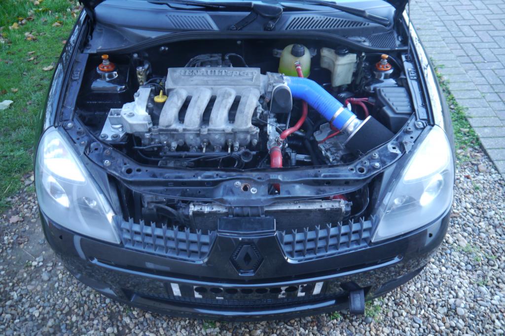

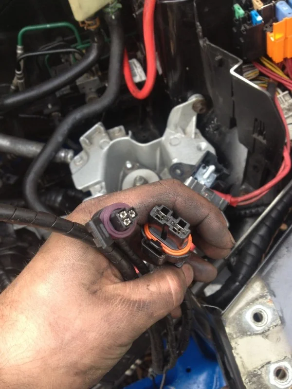

So last night i dropped my engine in and today set about plumbing it back in, but had no end of problems, main one being so long since i took it out i've forgotten where wires go :eek: anyway these are the problems i'm having:

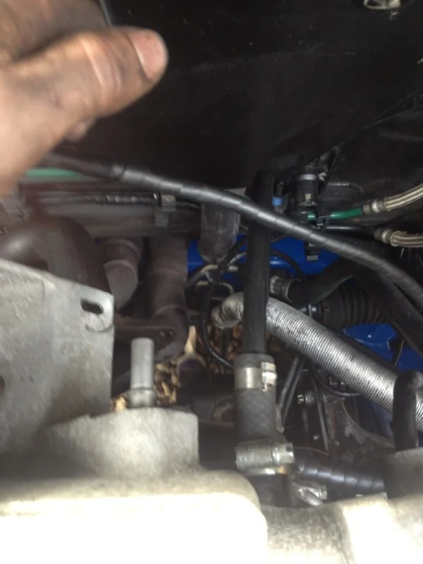

So first i have this one, was near my rad fan plugs.
Then it came to brake vac, there seemed to be 2 places it could go on back of the plenum, have i put it in the right one? Whats the other one for?

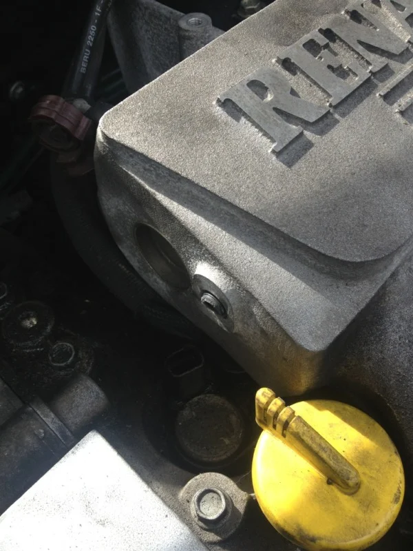

Then i noticed what i think was a sensor in the side of the plenum had snapped off, what sensor was it?

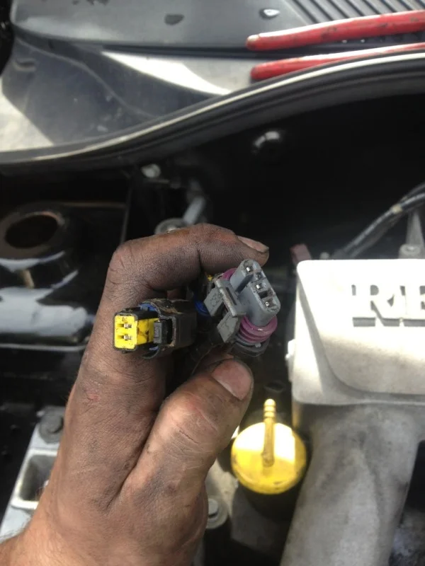

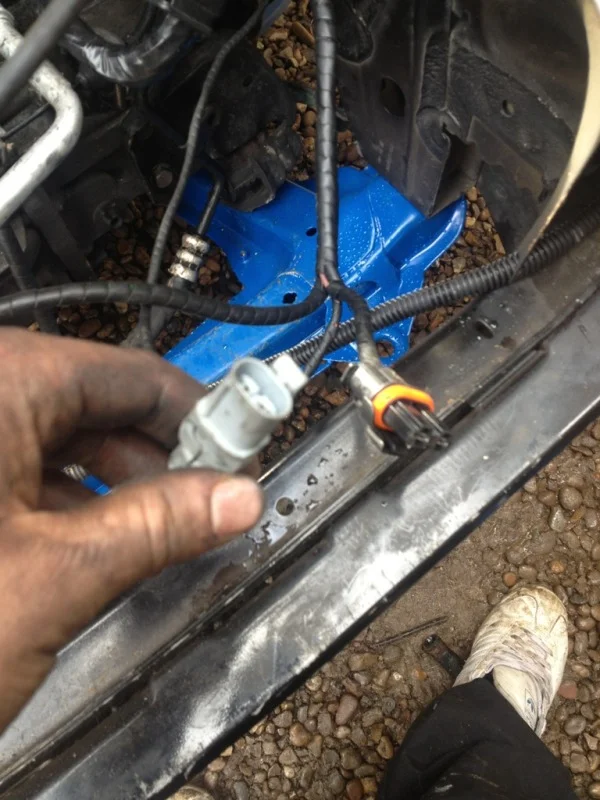

I know the orange big plug is for the fan but what is the 3 pin purple triangle one for?

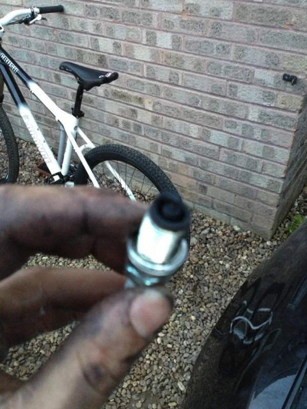

Tried running it anyway, ran shortly then cut out, plugs are very black and sooty.
There was also these, the small one on the left there are 2 identical, i know one goes into the top of the rocker cover (think that is VVT sensor) where does the other one and 3 pin plug go? (maybe one goes on that broken sensor on inlet plenum)
Hope someone can help :)

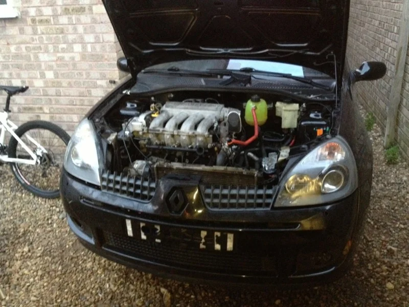

Car is begining to get back to being together :) I know the coolant bottle is well over filled but as soon as the thermostat opens it will soon go down before someone says something ;)

They male all the plugs different so they only mate with 1 socket. Just look at each and they will become clear.

first connector looks like it connects to p.a.s sensor in the pipe work.
that pipe is connected to the right place. the other one is for the carbon canister which i know you've deleted. ( your need to block this up otherwise your loose mani pressure and the engine will rev its tits up wen you have it running. probably didnt do it because you've snapped you mani pressure sensor)
senor that has snapped is inlet manifold pressure senor. im pretty sure you can use one of any of the 1*2's
the connector with three pins looks like its the one for the aircon pump.
and the other connector looks like its for fan maybe.
and the last three in your hand look to be inlet mani pressure senor, dephaser solenoid valve sensor and camshaft position sensor.

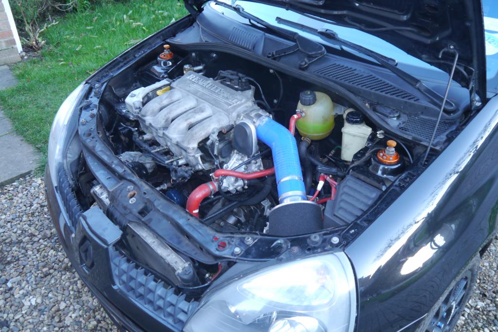

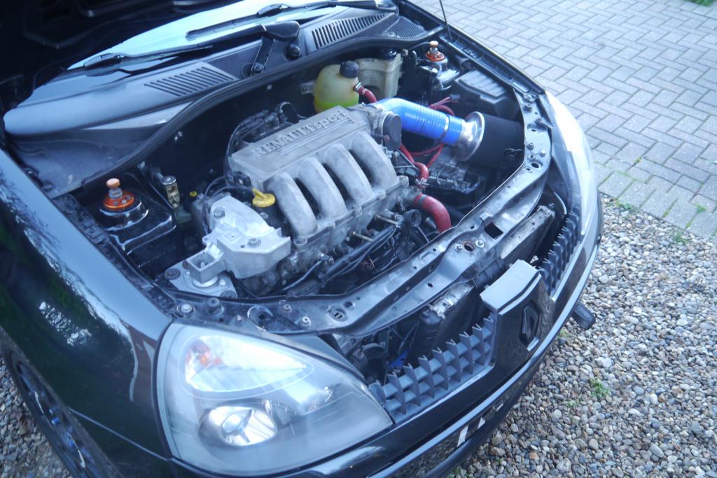

I have also made a custom induction kit, sounds nice, i'm hoping to knock up an aluminium heat deflector to go between airfilter and engine to try and keep it a bit cooler. I also fitted my forge hoses that i had left from my ph1. Gave the car a good clean today too as i had nothing else to do. With a bit of luck, next Sunday i should be able to take it for a spin :)
