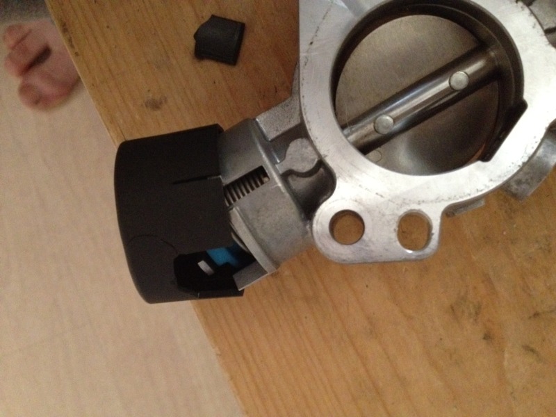

Firstly, i picked up a cheap Meg 225 TB, planning on using this and a fly by wire throttle pedal to be different to the other conversions that have all been cable throttle. But this plastic bit broke off in the post, does anyone know if it really matters?

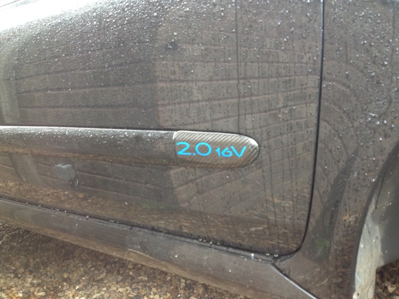

Also got some shiney carbon bullets :)

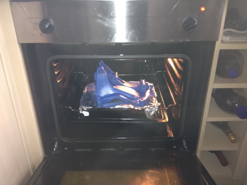

Finally, picked up an alternator bracket, off a Trafic van so sprayed it up and baked it in the oven :)

I funnily enough last week ordered a set of the carbon bullets too!

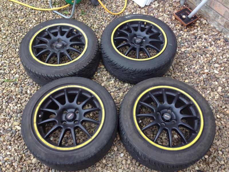

Picked up a little bargain today... A set of Team Dynamic Pro Race 1.2's for £140 :) Going to get them sprayed bright blue for track work. Then get my 2118's refurbed in Anthracite and use them on the road :)

Lovely alloys, I'd love a set but can't find any going for a good price.

It doesn't matter about the broken plastic cap on your TB :)

love pro races, such a light wheel aswell. and rare to get them in the earlier model with the coloured rim lip. car looks great mate, and good read.
I've been searching for some cheap for months... I'm very tight, especially with wheels lol.
Nice one! That's a relief as they ain't cheap!
Didn't realise they were rare? Shame they have been kurbed and need a refurb, can't say i'm a fan of the painted rim lip, but i do love the pro race wheels :) They were my favorite wheels on my Cup, regret selling them, but needed too, to fund my 2118's & A048's i got for track work (and still have but will now become road wheels)

Have you always been from Norfolk Lewis? as in the throttle body pic featuring your toes they arent webbed :p
I wasnt aware you were selling the engine, thought it was a maybe :(

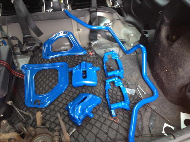

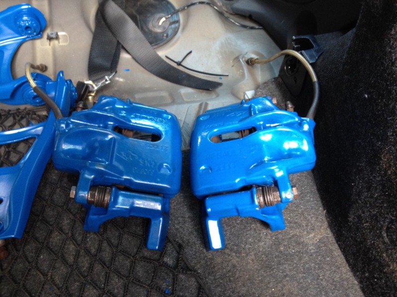

FINALLY i have my parts back from the powdercoaters :D
Few of the bits:
Brakes re-assembled:

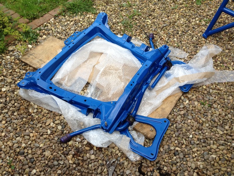

Started putting the subframe back together:

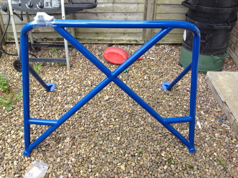

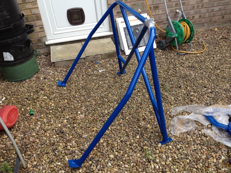

Roll cage:

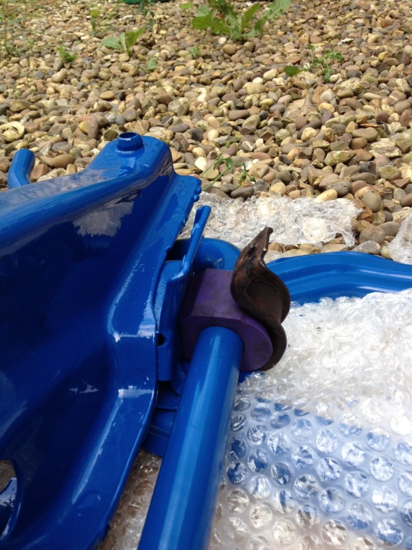

3 problems though, firstly, bolting the the ARB bushes back to the subframe, i can't seem to pull them close enough to get a bolt through to do them up, what am i doing wrong?

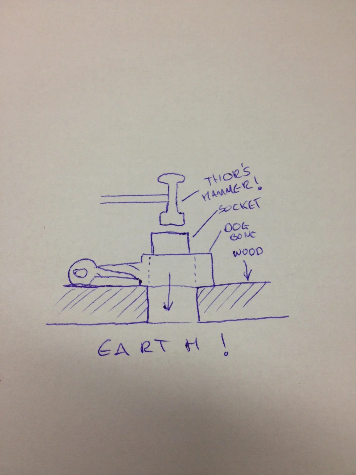

Secondly, how do you change the dogbone bush's to powerflex ones? got the new ones just can't figure out how to get the old ones out?

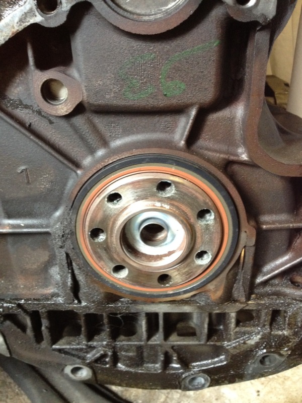

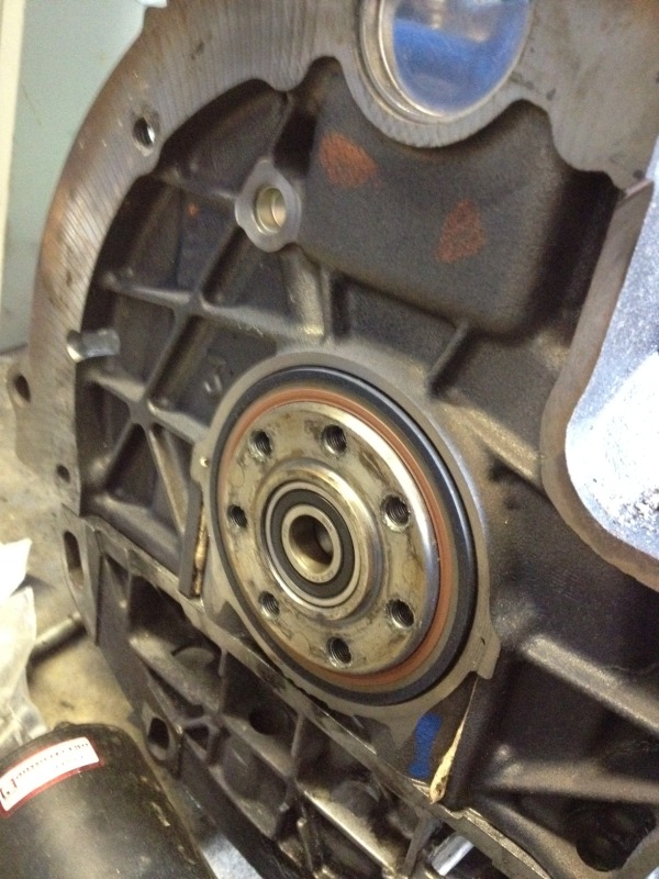

Thirdly, when putting my flywheel back on the 182 engine i noticed it didn't have a bearing on the end of the crank like my 225 engine. See pictures:
225 engine.
182 engine.
Is this right? If not i guess i'll need a bearing, could this also be why the old clutch was slipping and show's signs of extreme heat? Could my flywheel be buckled from this?

Dog bone mount... Just clamp it in a vice and knock the old bush out with a hammer

In regards to your arb bracket...........You need bigger muscles Lewis;)
They are a struggle on your own so I would recommend a second body to lend a hand with a big pry bar etc

I did mine with fire.

Or you can you use longer bolts for the ARB bush brackets if you're really struggling to clamp them down.
There should be a bearing on the crank too.
  BMW M135i
Re: Boosted BlackGold Project - F4rT content.
ND0 has a longer input shaft and is setup for the crank bearing, can't say i've seen a JB/JC using one before hence why you don't have one.

yea those brackets are a pain, i used two set of mole grips clamped it down.. jobs a goodun

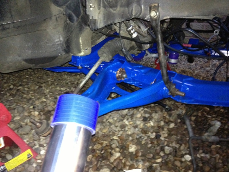

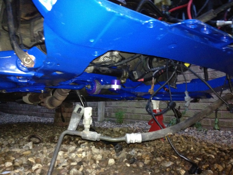

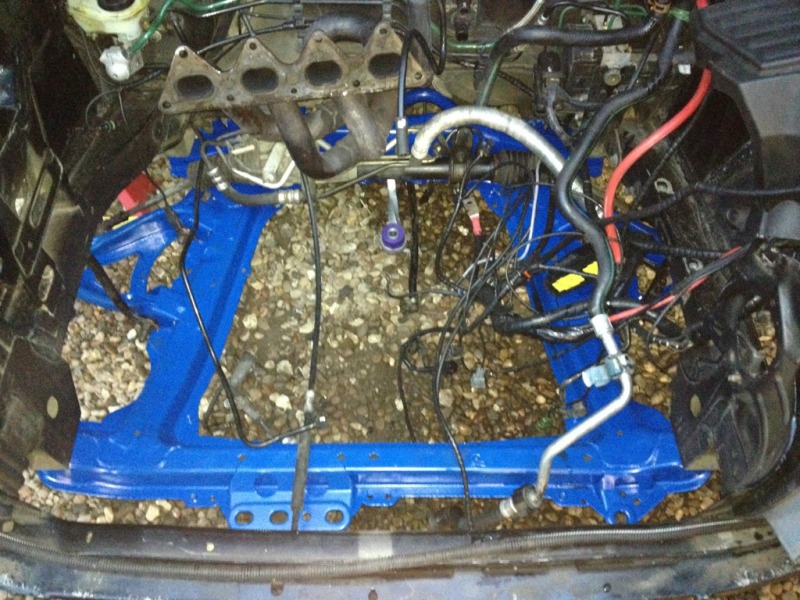

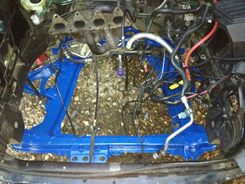

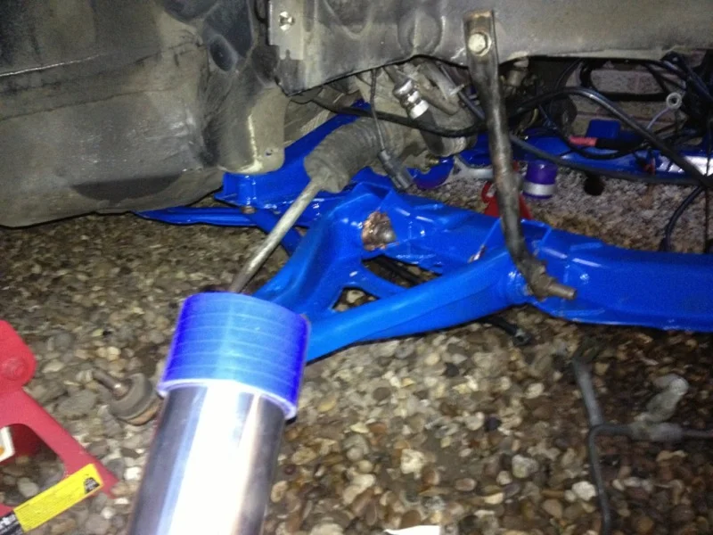

So my plan was to hopefully get the subframe built, back on and engine re-fitted this weekend. But then i got offered 2 good days work for saturday and sunday which i couldn't refuse. This being said i need the car running for the 28th for a local meet, so need to try and do what i can in the evenings. Tonight i planned to just rebuild my subframe, but got really stuck in and within only about an hour i'd built it and refitted it. Here are the photo's:
I'm very happy with the colour match, please ignore the metal pipe, for my Pikey Motorsport BTCC tech induction kit... Coming soon!
If i can get home before 4 tomorrow night, i'll get the engine dropped in, if not i'll give the subframe a good clean as it got a bit grubby tonight.
