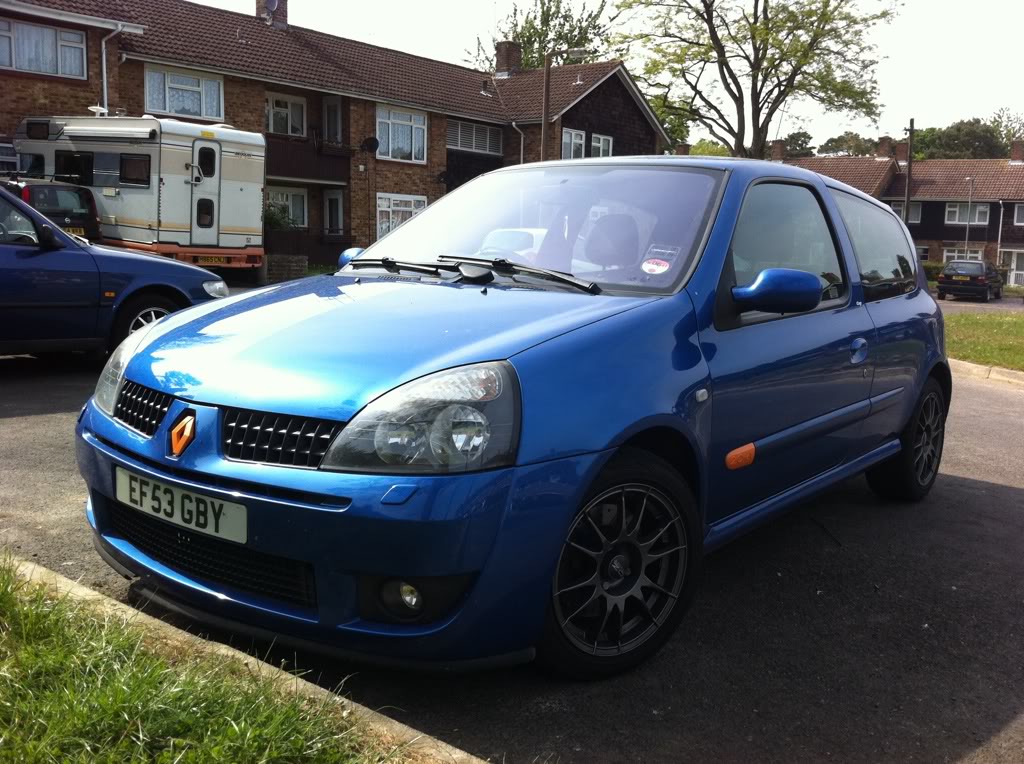

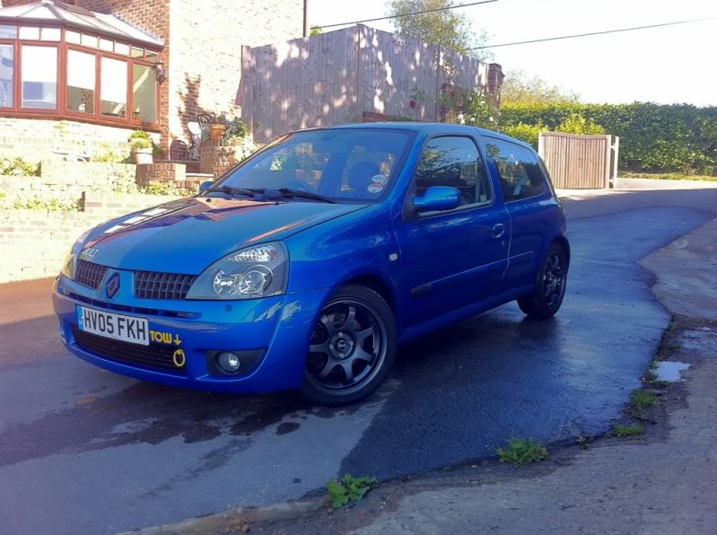

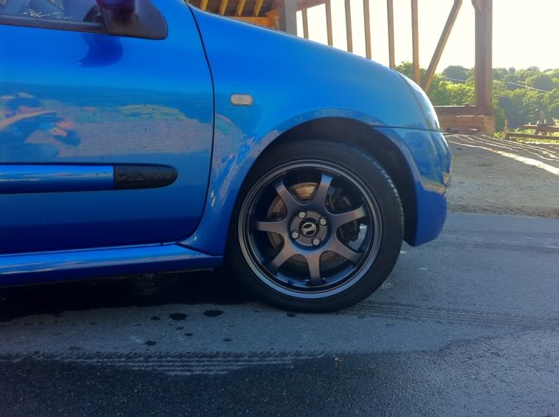

I use Ultralite Atecs, They are 43mm offset and standard is 45. 16" and cost about 115 each. They weigh about 6kg and are very strong.
I noticed the difference straight away, the steering response became much quicker, took a bit of getting used to lol
Brakes: Get brembo HC disks, Ferrodo DS2500 pads, Braided hoses and some decent fluid.
Wheels: O.Z Ultraleggeras are among the lightest.... About the lightest wheels you'll find without spending more than the car's worth.
