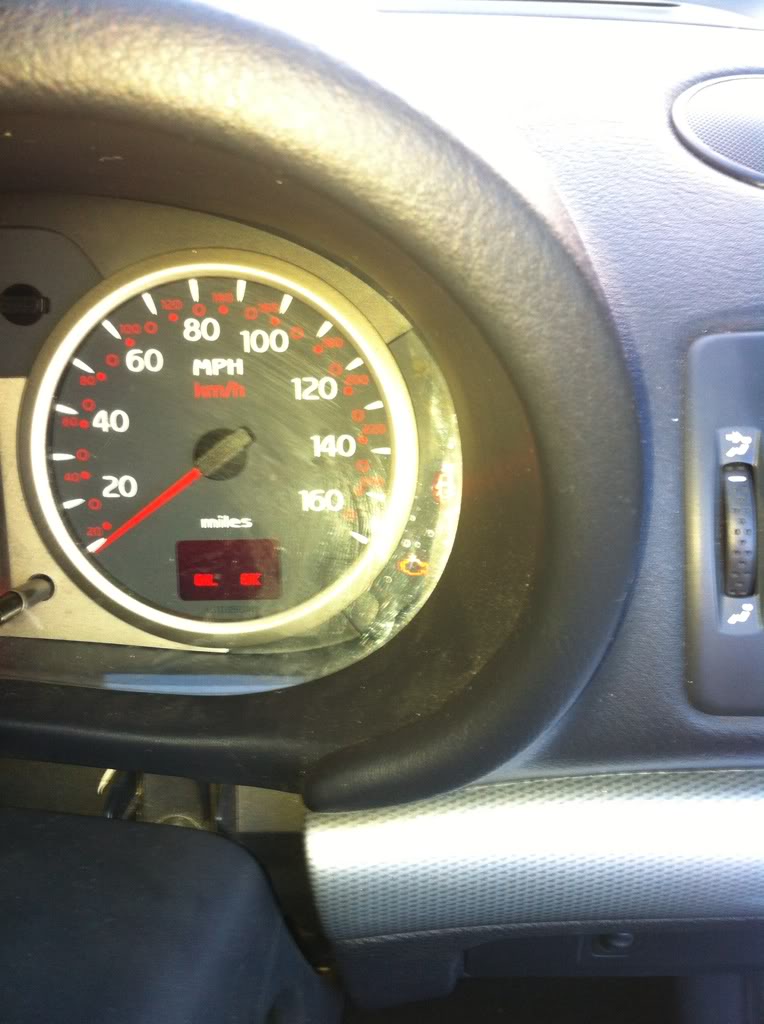

hi guys driving to work this morning and i switch the button on for the screen de-mist and then on the dash i get a light which is like a hearbeat monitor with wires on it no power going to the car knocked the engine of and works again then couple of miles it comes on again then oil pressure warning comes any have'nt checked the oil as of yet but will check it later any ideas on potential problems

Is it a box with a line going through it that looks like a heartbeat? It says injection system. Hope that is some help.
Have you hooked the car up to a code reader yet?

i kno a good autoelectrician mate yea its that light mate it only come on when i went to de mist the windscreen any ideas on what it could be my auto electrcian mentioned something about a throttle body whatever that is might just garage it for a bit until i get the money to get whatever is wrong sorted
well upon reading on here it looks like it is the emmisoin warning light soem say faulty lamba sensor clean it throttle body spark plugs where is the lamba sensor found is it in the engine bay same as spark plugs sorry with questions total noob here
I dont think its the lamda sensor personally. I had mine give up, the engine management light came on and my car was underpowered, but still ran. A faulty lamda sensor wont cut your engine out (as far as I know, I may be wrong). Your car has 2 lamda sensors. One before your catalytic converter (on the exhaust) on the engine side and one after the cat. The one after the cat wont affect the running of your car in any way, it just measures emmisions. The one before the cat affects your car. Does your mate have a code reader? It will read any faults
that have come up on your car, it will help pinpoint the problem.
only lights taht come on was those mate no stop or serv light im just at a loss on what to do i will speak to him later on he had it on a code reader before when i took the alarm out just getting me down now but that is cars for you lol
What does that symbol mean then mate as some say toxic fumes warning other oil pressure warning checked oil all ok there car seems to be running fine at moment.
Its not toxic fumes or oil pressure, the symbol means your cars onboard computer has registered a fault. The only way you can find out what that fault is, is by plugging a
