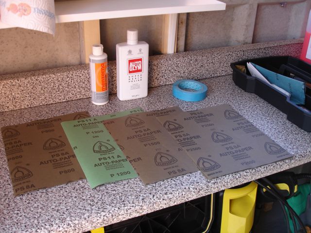

Armed with various grades of sandpaper. Menz Power Finish, AG SRP and plenty of tape.

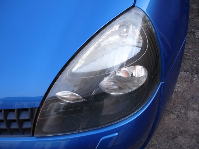

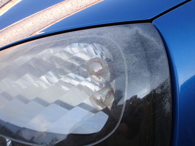

Off side, plenty of damage!
Same light, another angle

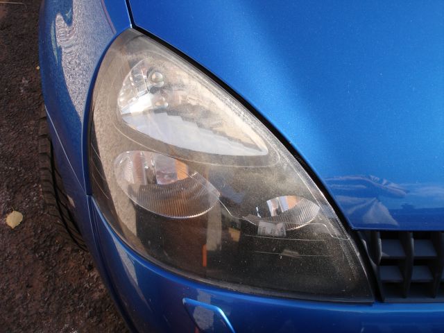

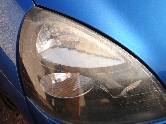

On side just as bad!
On side again.

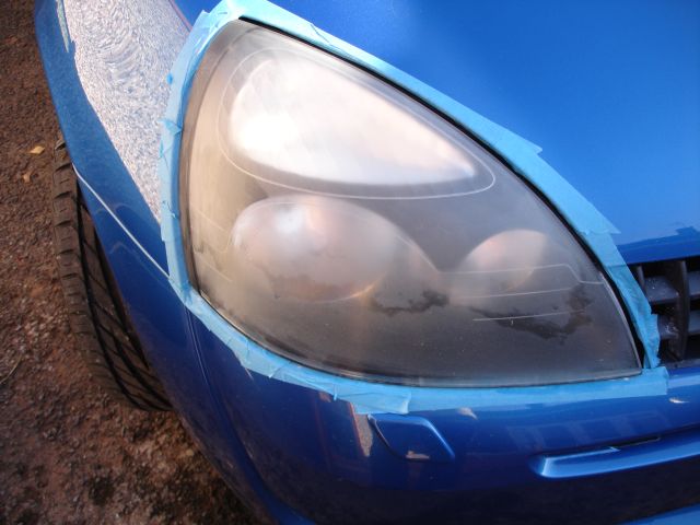

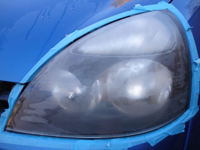

After a bit of sanding, most of the scratches removed and a nice bit of hazing now to sort out.

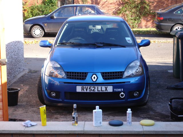

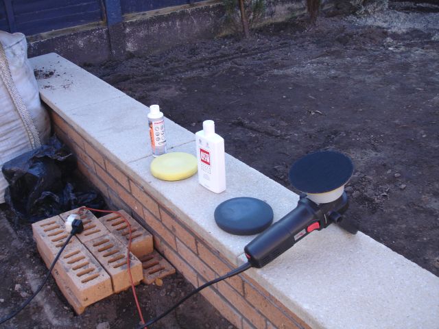

My weapon of choice, the DAS6

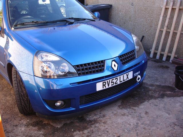

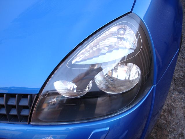

Final pic of a job well done :)

In terms of the lights it's pretty straightforward to be honest, what you need is a few different grades of sandpaper, 600,800 and 1000 are probably the best combination. You can go to 2000 if you like (and are prepared to put the effort in, i didn't) You need to apply the sandpaper with lots of water, literally soak the sandpaper in water and keep it wet as you use it. Start with the most harsh sandpaper, the 600 (the lower you go the harsher it is, you can go the other way till u get to about 2500 which feels like paper! You don't need anything that fine though).
So yea, its best to tape up the area around the lights so you don't accidentally scratch the paintwork! Masking tape is fine for this. You can buy detailing tape which is blue but basically the same thing.
Use the wet paper and start sanding, till the scratches are gone, if there are any really deep ones it may be best to leave these as you could be in danger of sanding too far and ruining the light, the light will go all hazy and there will be white looking paste coming from the lights, this is normal, this is where you need the other 2 sandpapers, do the same again and it will get pretty smooth by the time you done it with the 1000 grit. It will of course look really hazy.
This is where the polish comes in, the polish I used is Menz Power Finish which is a heavy cut polish, by this I mean it strips back the top layer of the paint (or plastic in this case), so the hazy layer is removed by the polish leaving the nice and shiny layer underneath. :) There are many types of cutting polish, the Power Finish is one of the more aggressive ones out there, Menz generally needs a machine polisher to work properly though, there are however stuff designed to work well by hand, you'll need a foam applicator pad and something like scratch X (some people say rubbing compound can work too but i find the finish not quite as good). I'd get scratch X if i was doing it by hand, be prepared for a good 10-15 mins of hard rubbing by hand tho.
Once that's done you will want to use something like AG SRP (Auto Glym Super Resin Polish), this is another polish but it doesn't remove layers like the Menz stuff, this polish instead has fillers in, these will fill in any imprefections in the finish and also give it more of a glossy look.
You may then add a layer of protection such as wax/sealant or even mr sheen apparently!
