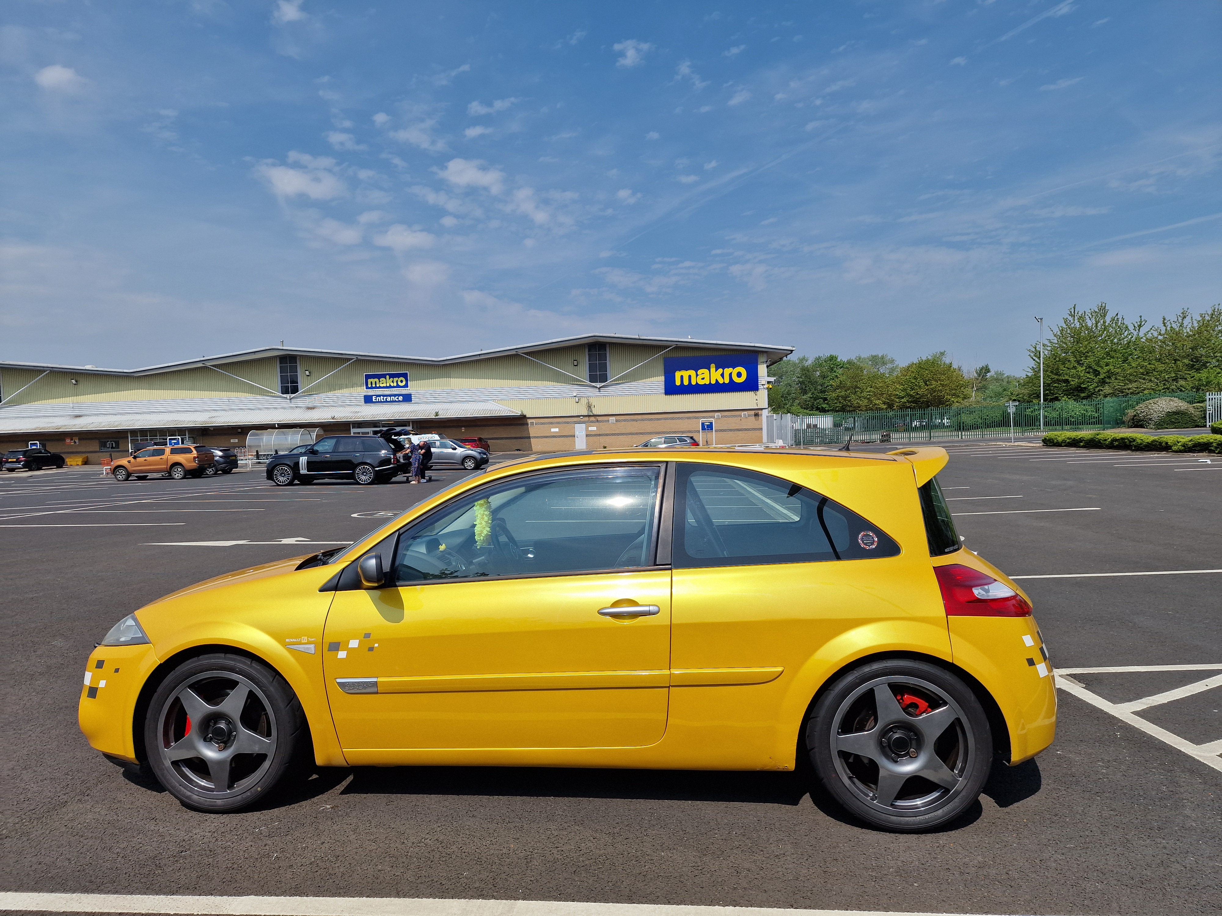

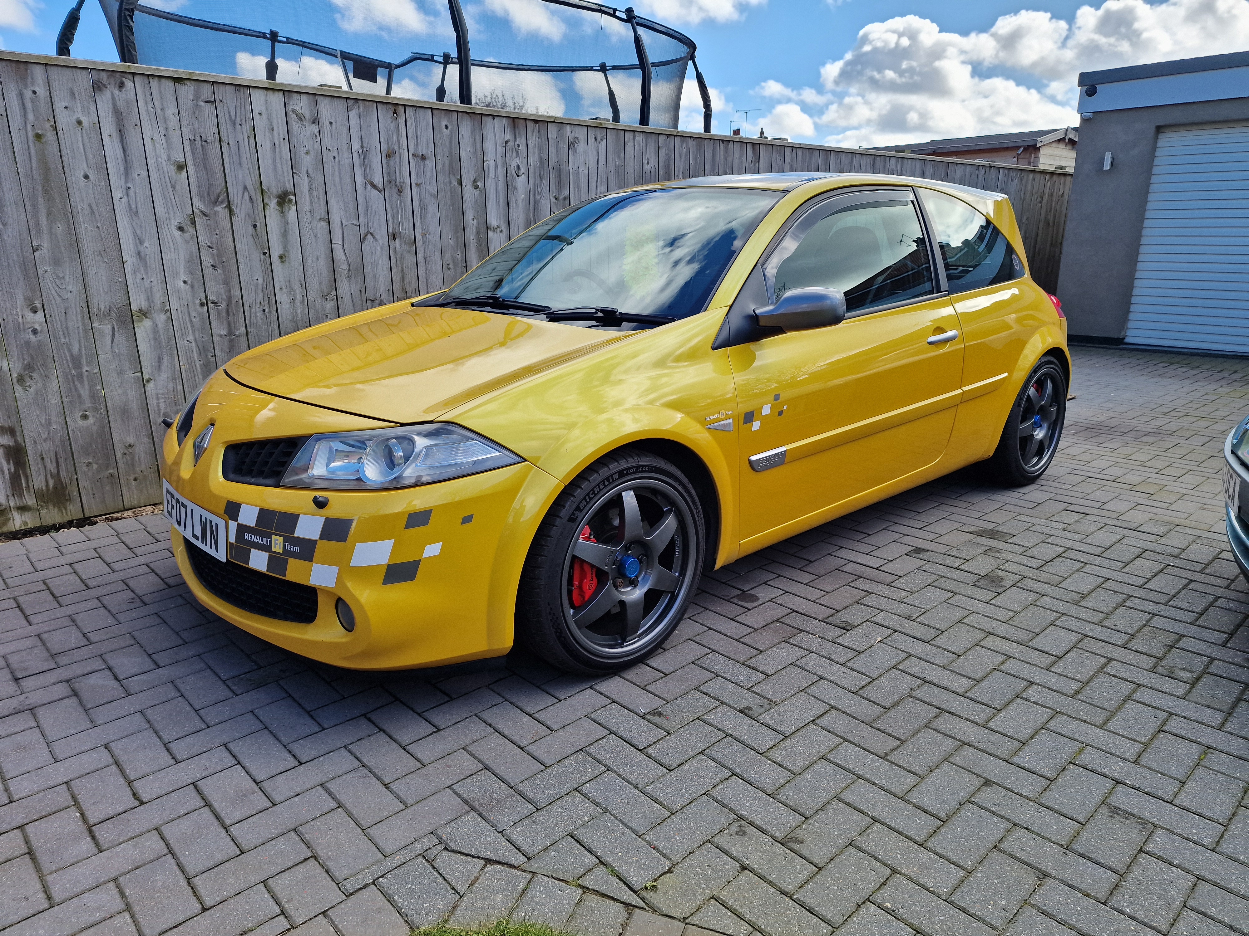

Enjoying it. Run to Whitby last Sat with some fun on the b roads.
Later on that evening a Bm ix1 xdrive30 ev thing was pushing me on local dual carriageway. I managed to pull a couple of car lengths on it in 3rd gear easy enough to basically get it off my arse as its led headlamps were blinding me and called it a day at that. First ev ive had pushing me.
Also plenty of room for shopping.
Seems to be returning around 30mpg mixed driving so pretty decent on stock injectors..im used to horrendous fuel consumption in these so its nice to not be at the fuel pump every 2 mins.

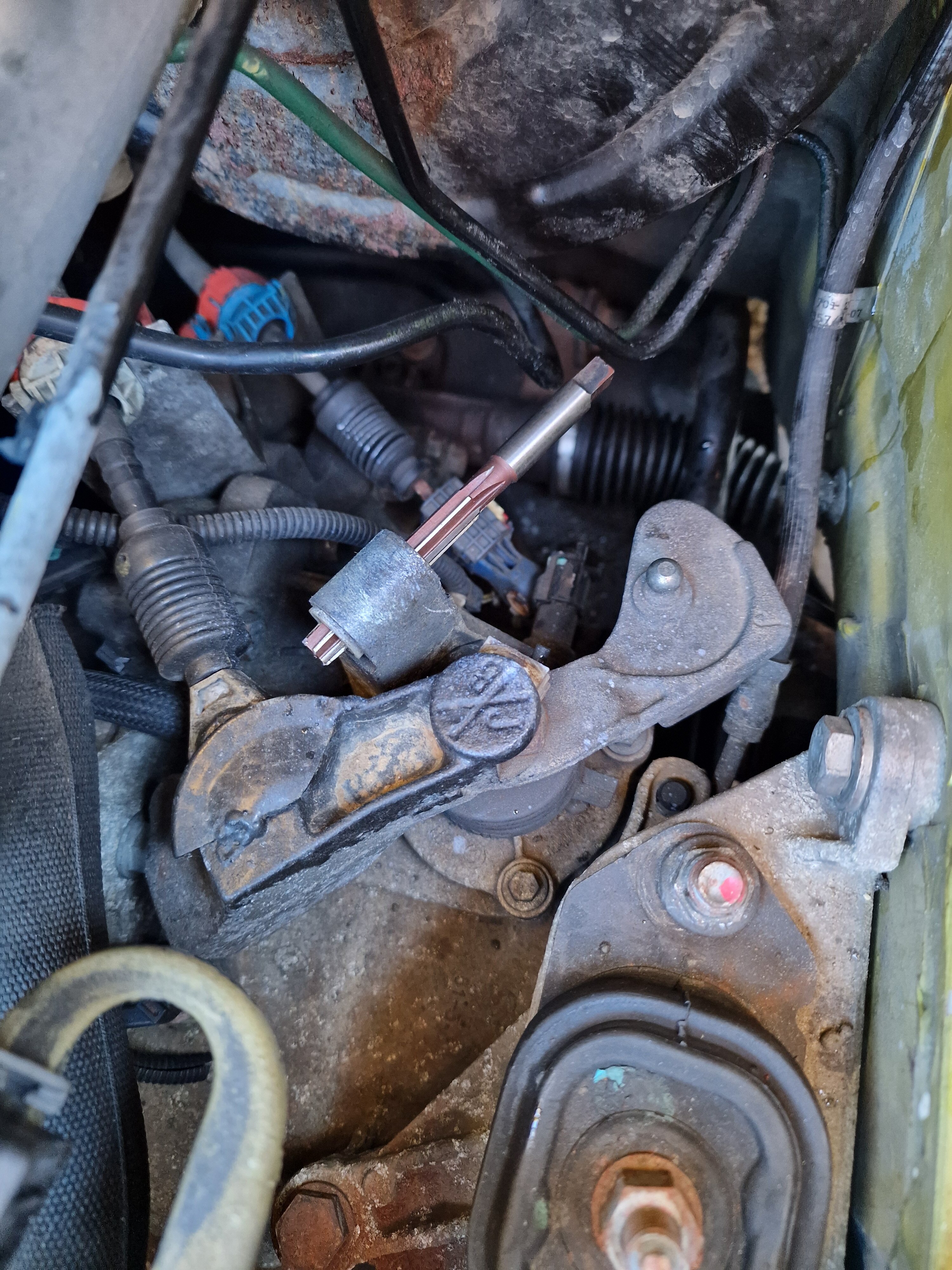

Gearstick was doing the usual megane thing, tight across the gate so harder to get gears. No stranger to this as sorted it on the blue meg years ago, the bushes in the selector expand a bit with heat and need reaming out and a bit of lube. Had to do it in situ thanks to the previous bodger welding a plate over the gear cable!
Reem
Was tempted to lob the plate off and change the cable as i have a new cable in stock for the trophy, but turned a blind eye for now as it works, and had it done and dusted in 20 mins. Its working spot on now and no missing or selecting wrong gears.

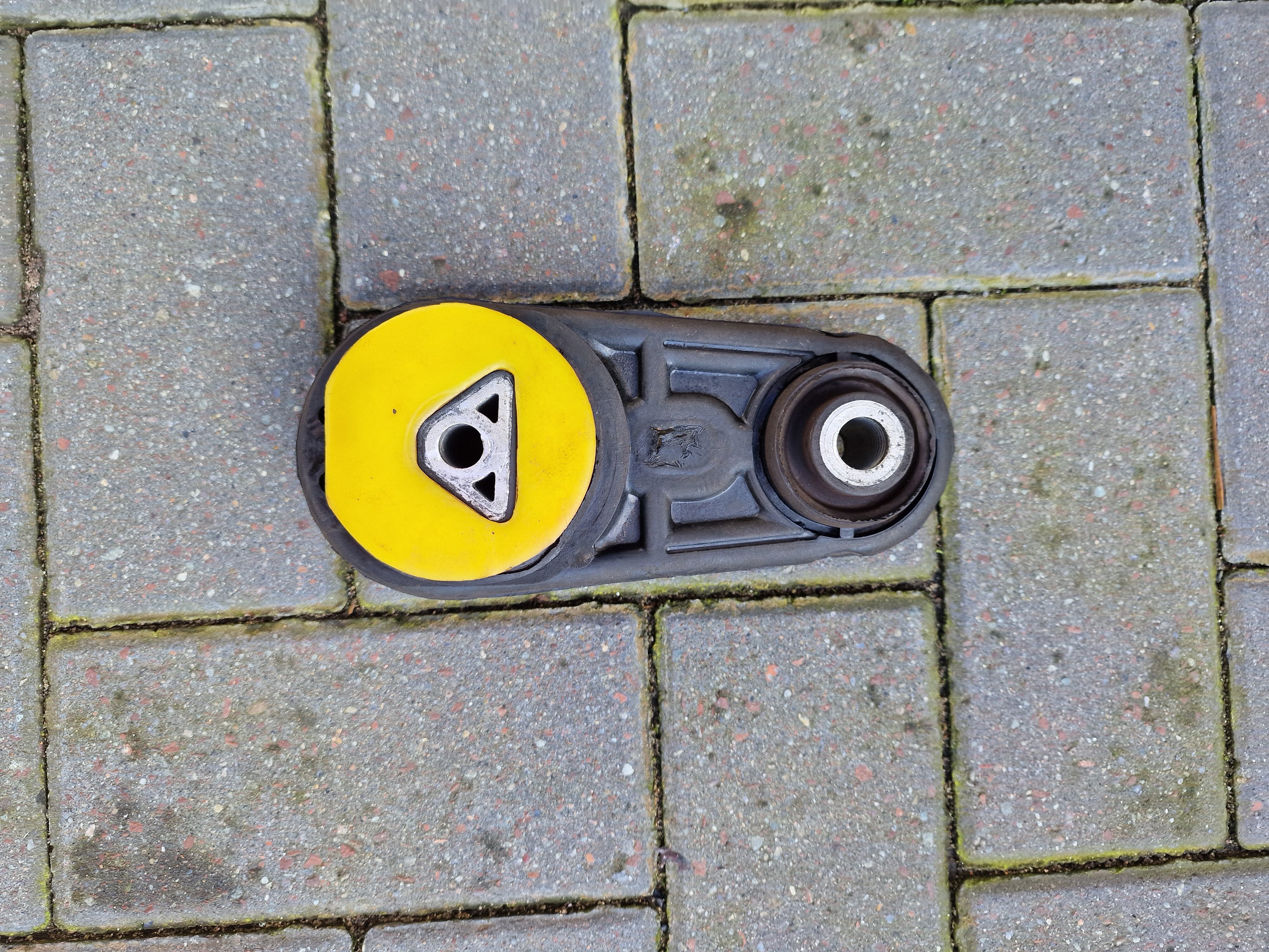

Picked up a cheap 2nd hand powerflex insert for the lower torque mount. Simple remove, pop in and refit, in theory. Took a bit of lube and persuasion with vice/deadblow hammer but done in half hour or so.
Mucho deadblow action later.
The insert works nice. No extra vibration on idle and engine movement reduced. Decent for £15.

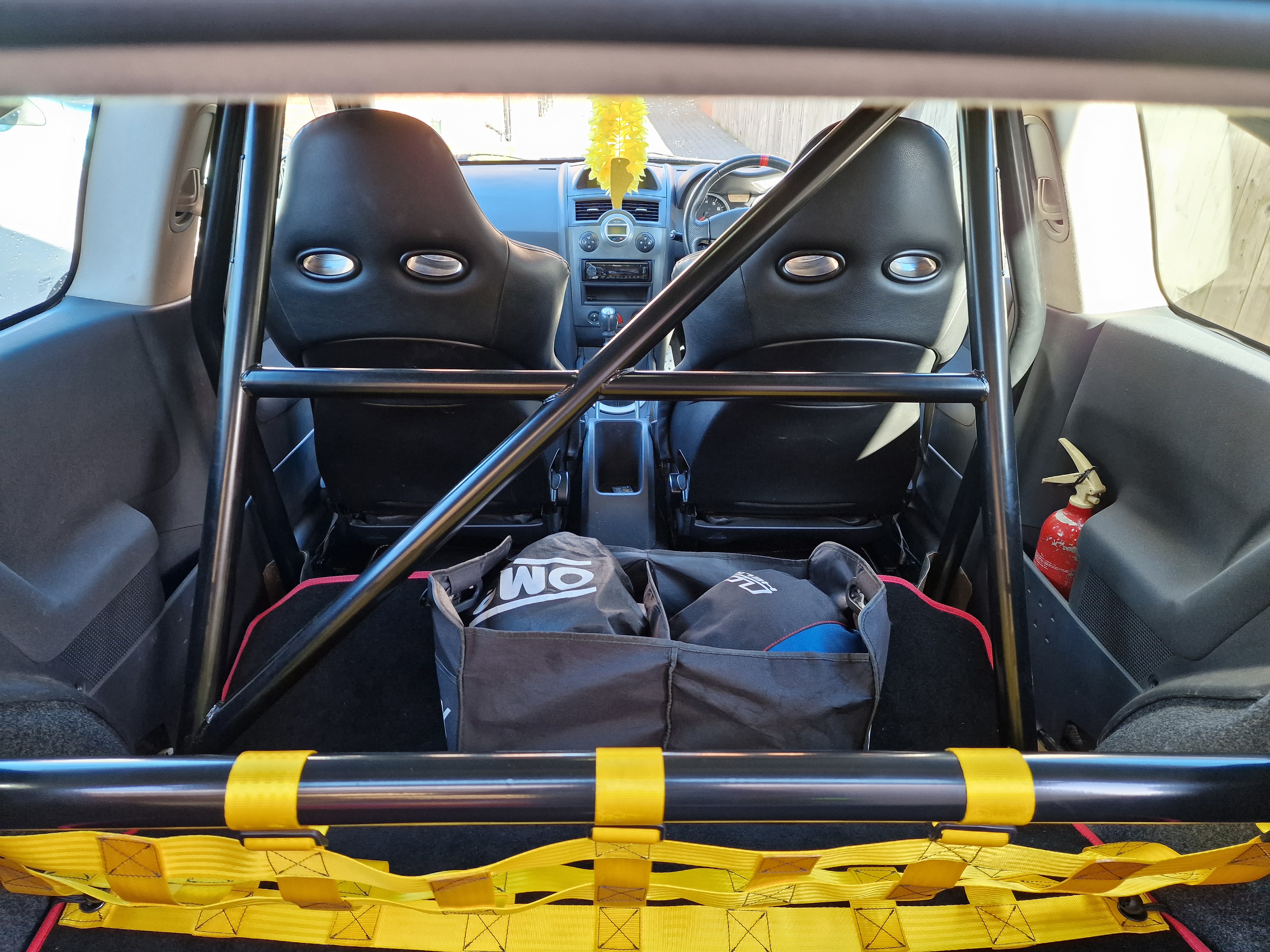

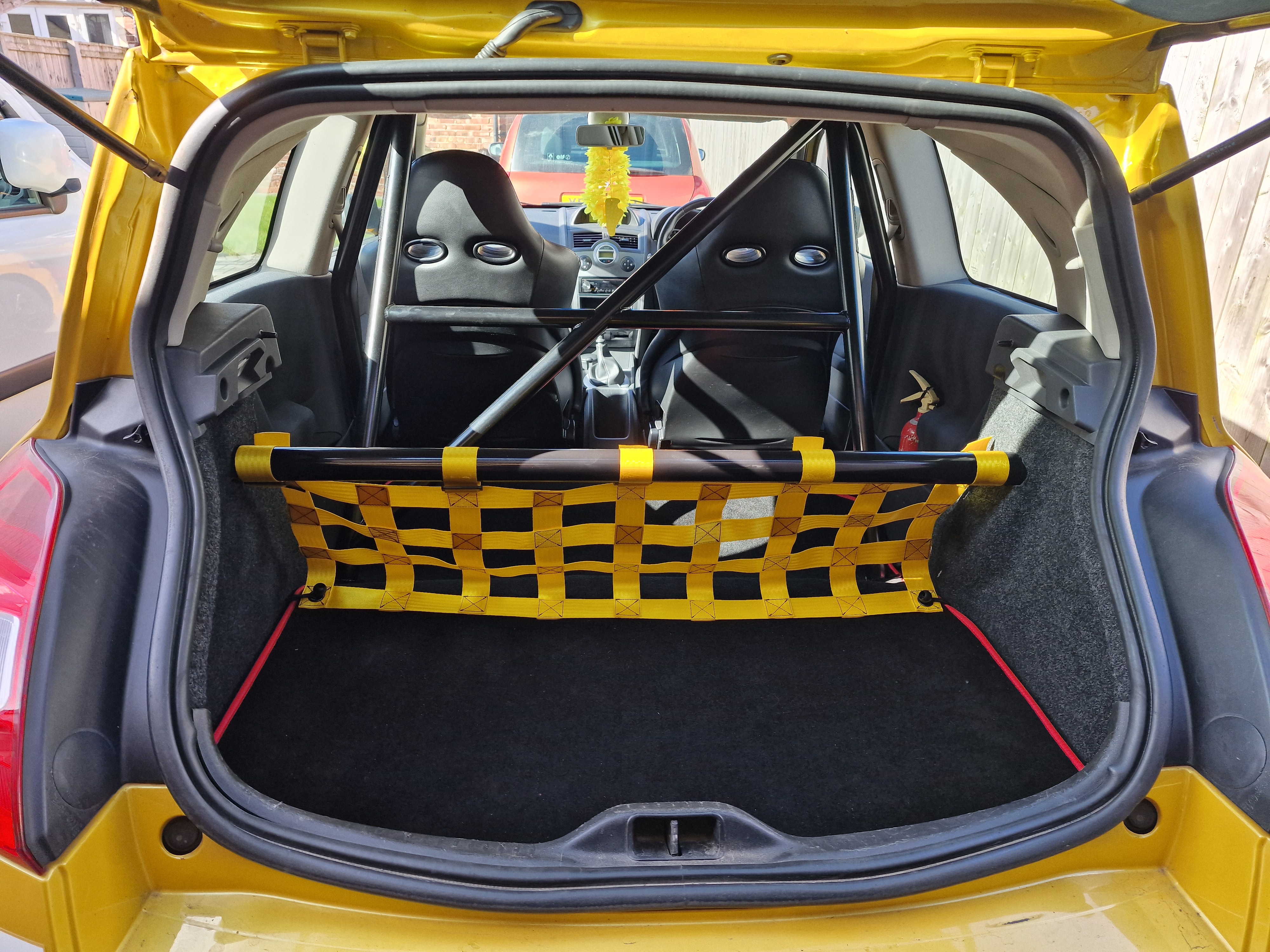

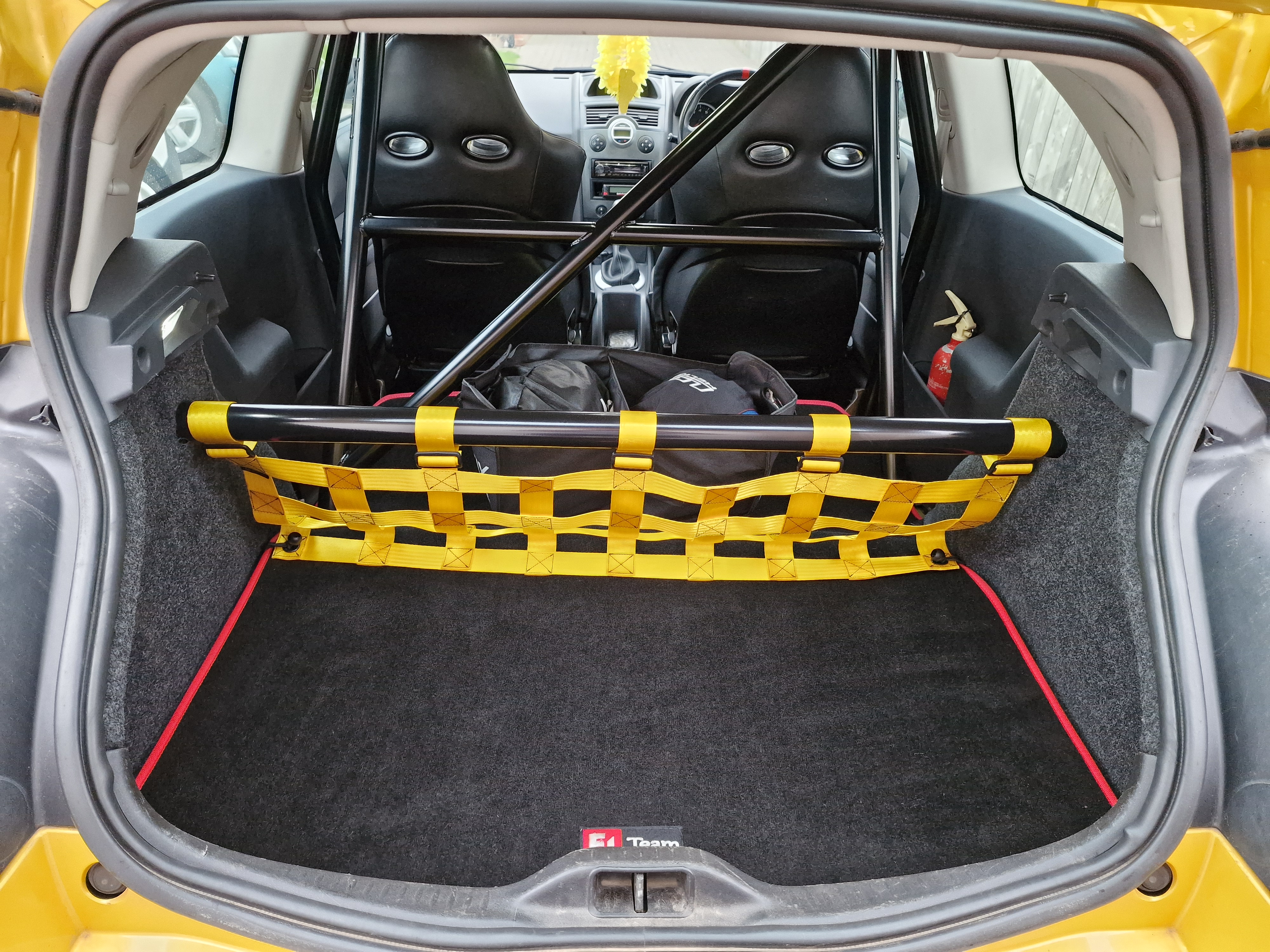

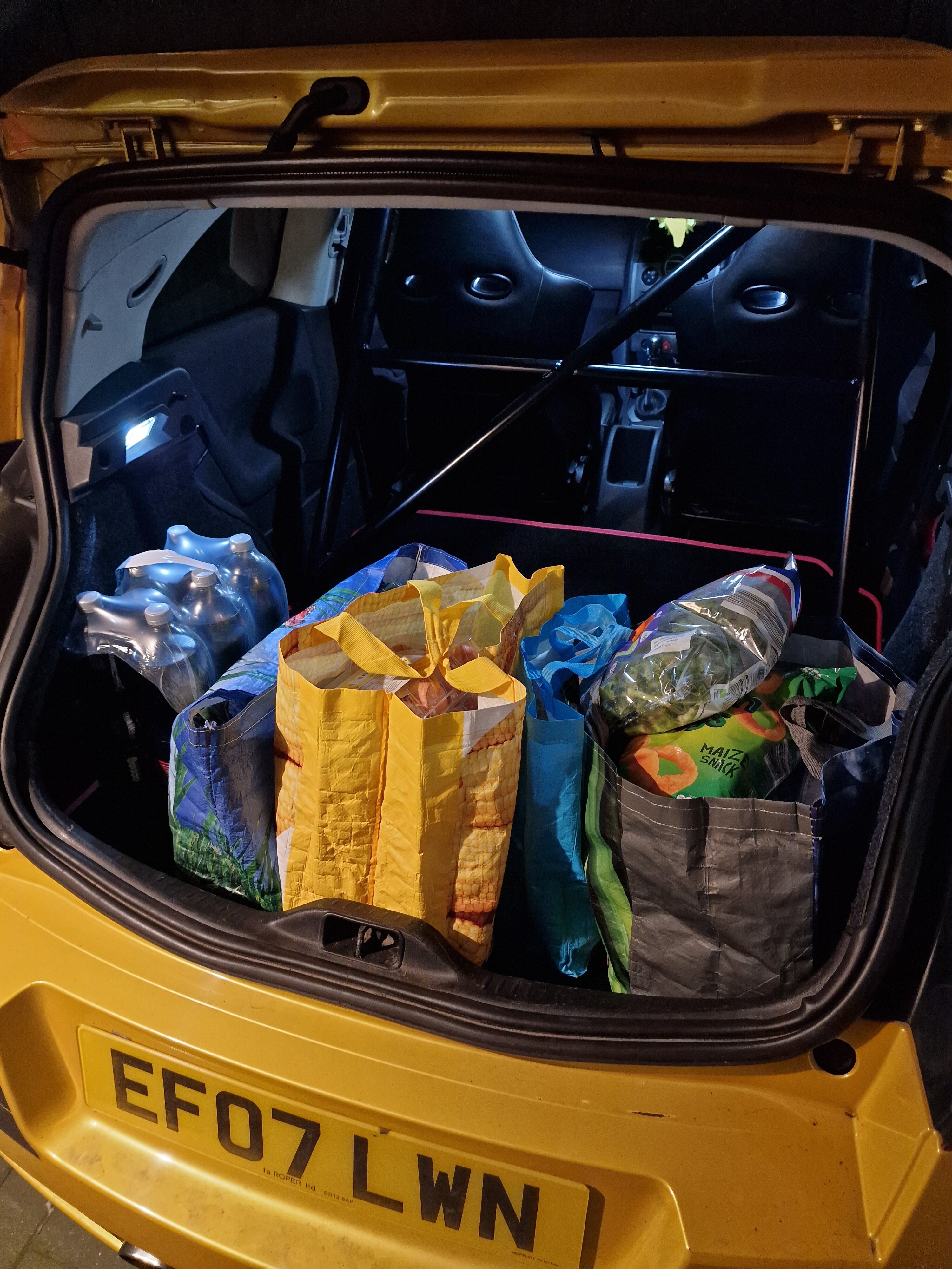

To continue with the clubsport feel ive added a D7r rear strut brace and Jp Clubsport net to the rear.
Keeping the shopping in place.
Ill get the comps back on it soon.

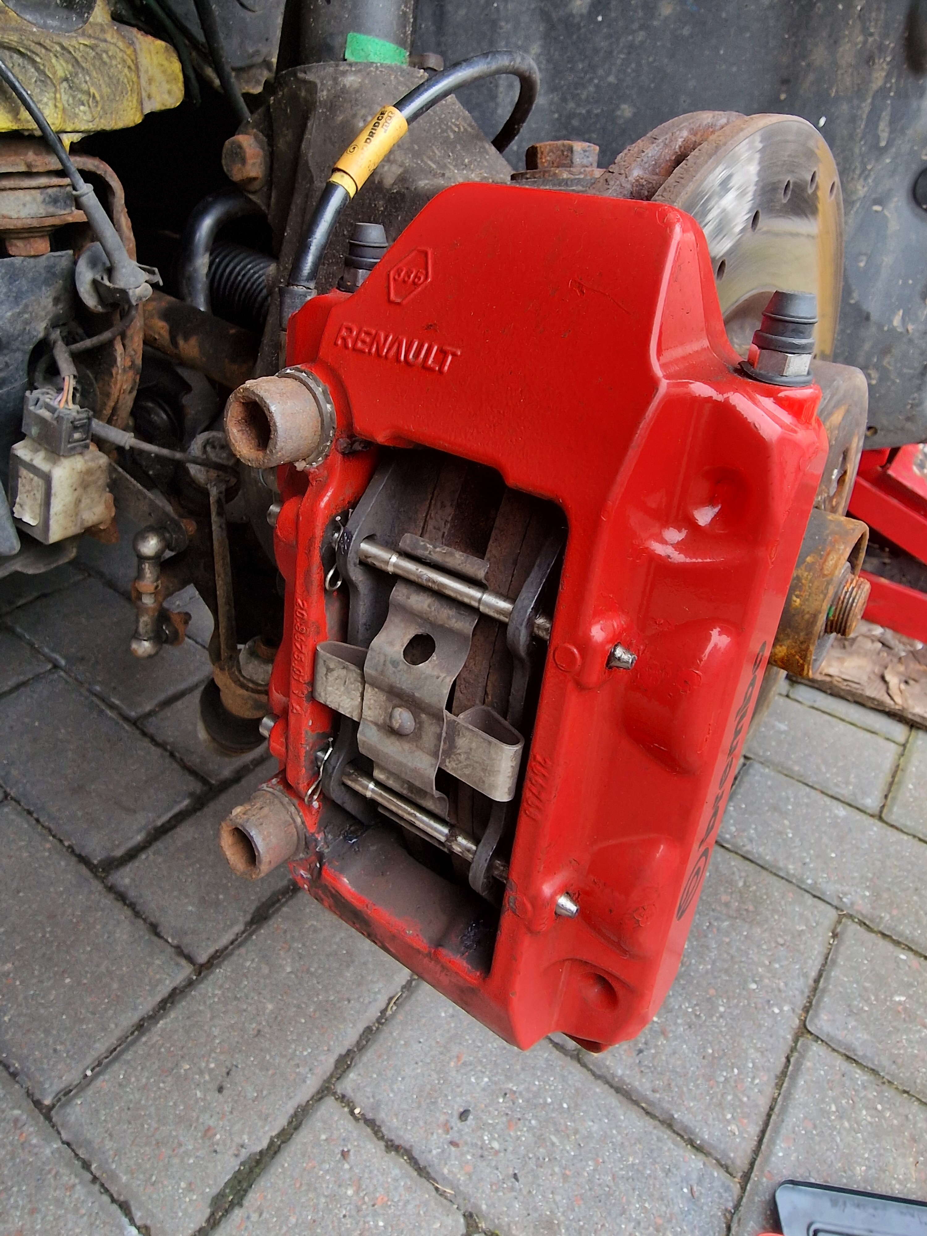

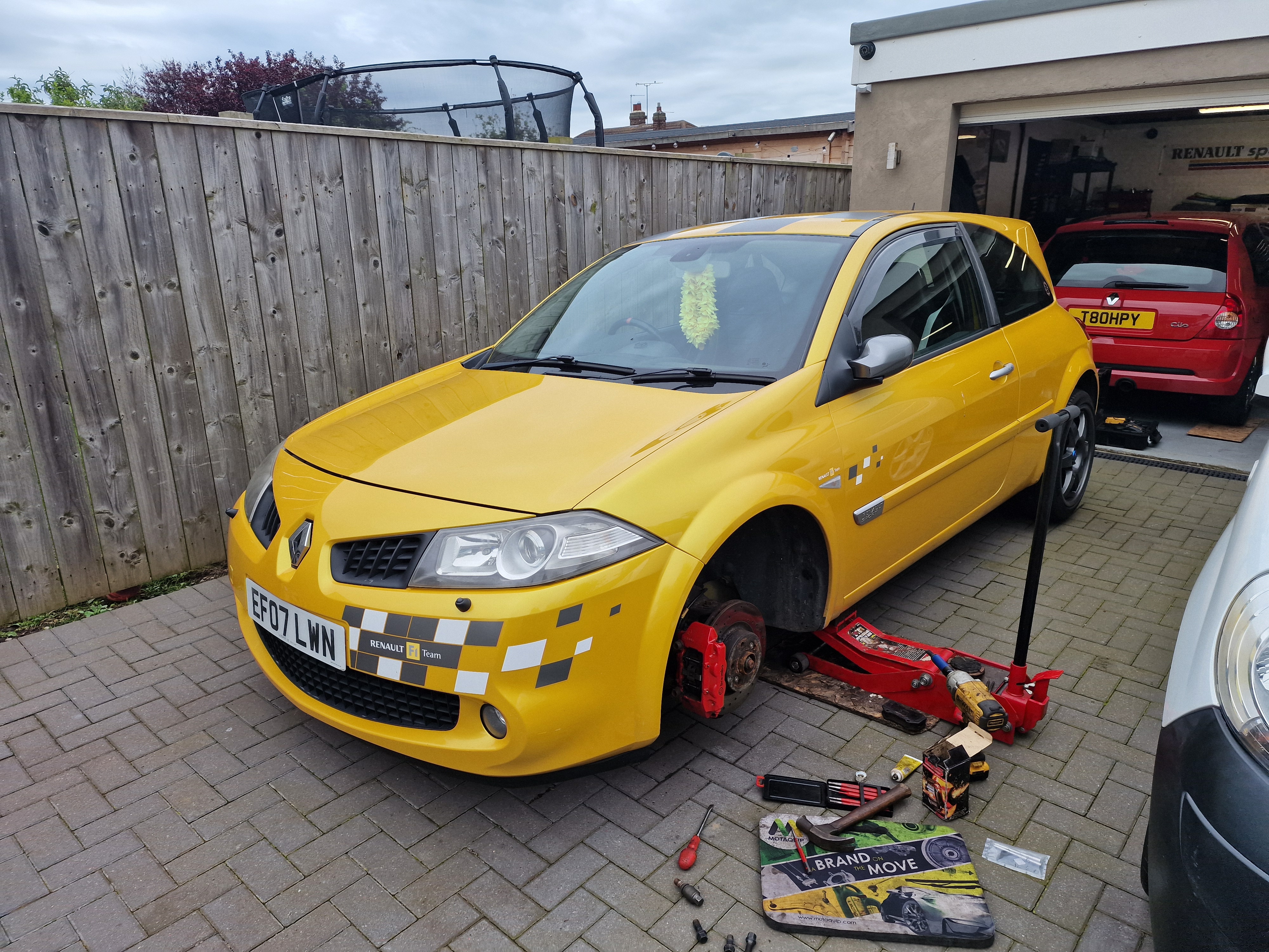

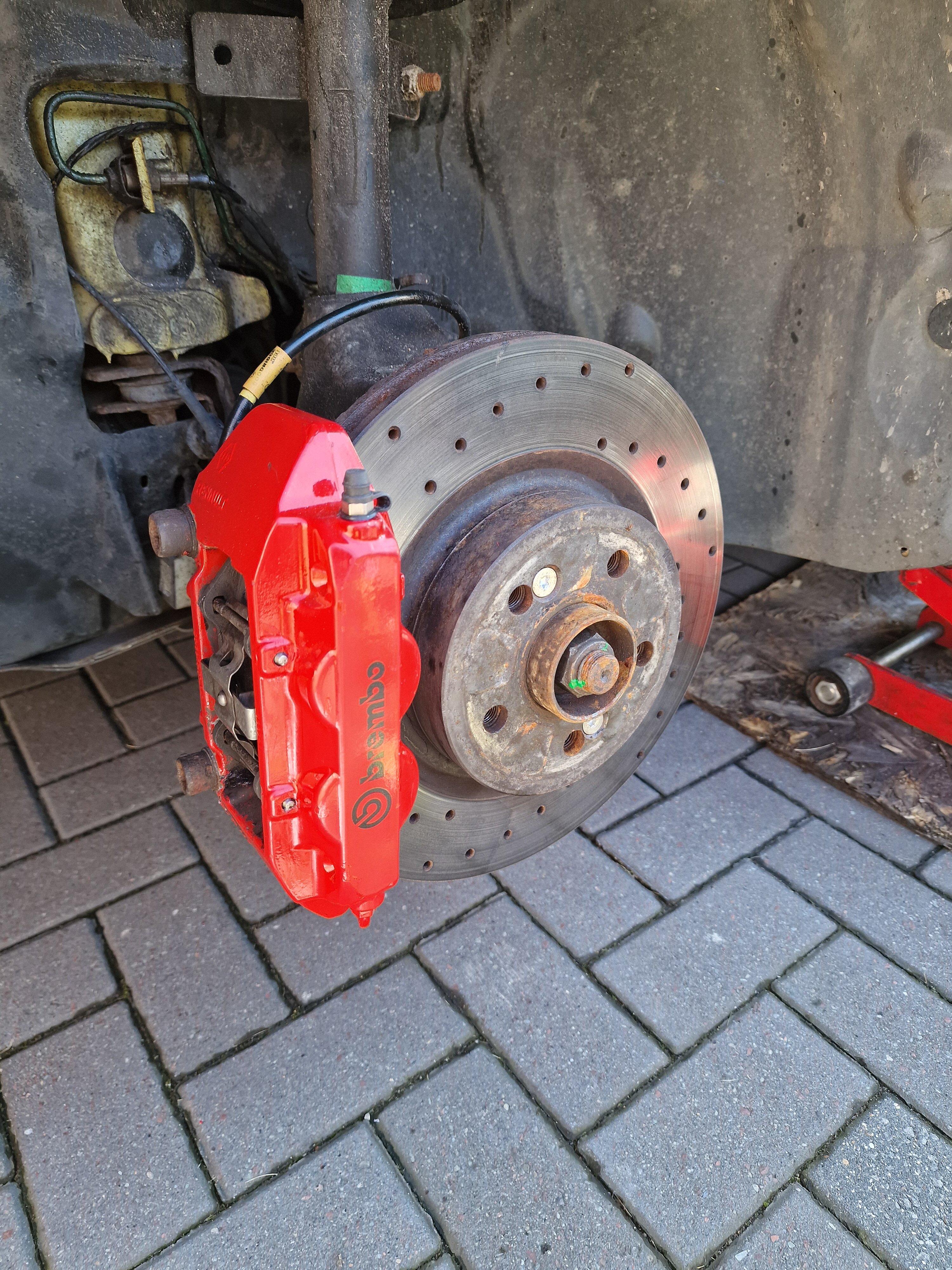

Finally flushed the brake fluid on Thursday. Ive been putting this off for ages as the bleed nipples on the brembos were solid when i tried a while back.
I managed to break 3 of them loose - using my induction heater, quenching with plus gas and tightening/loosening them. Final one broke loose then nipped and snapped as anticipated :cautious:
Id planned for this in advance and had a good used set of brembo calipers in stock so fitted them.
Good used calipers fitted.
Flushed brake fluid through with Motul Rbf600 and also flushed clutch hydraulics a load of old shite fluid came out of the clutch. Also fitted ferodo ds1.11 front pads in prep for some track work.
Massive improvement to pedal feel - brakes are super sharp, confident that they will stop and withstand hard track use as used the same setup with great results previously.
On removal of the old brembo calipers, I also noted they had a couple of tight pistons so due a rebuild, so did not turn out too bad in the end.

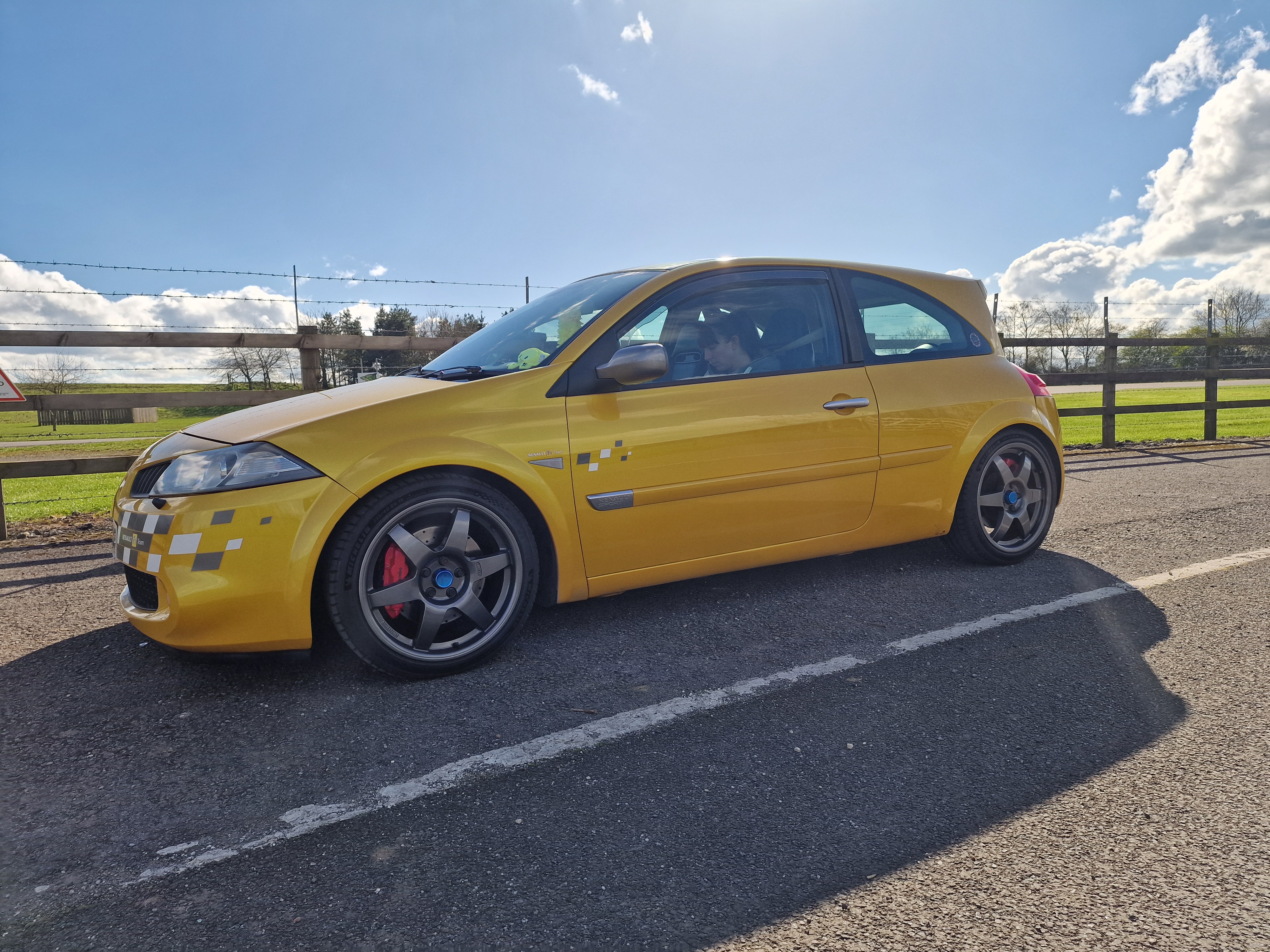

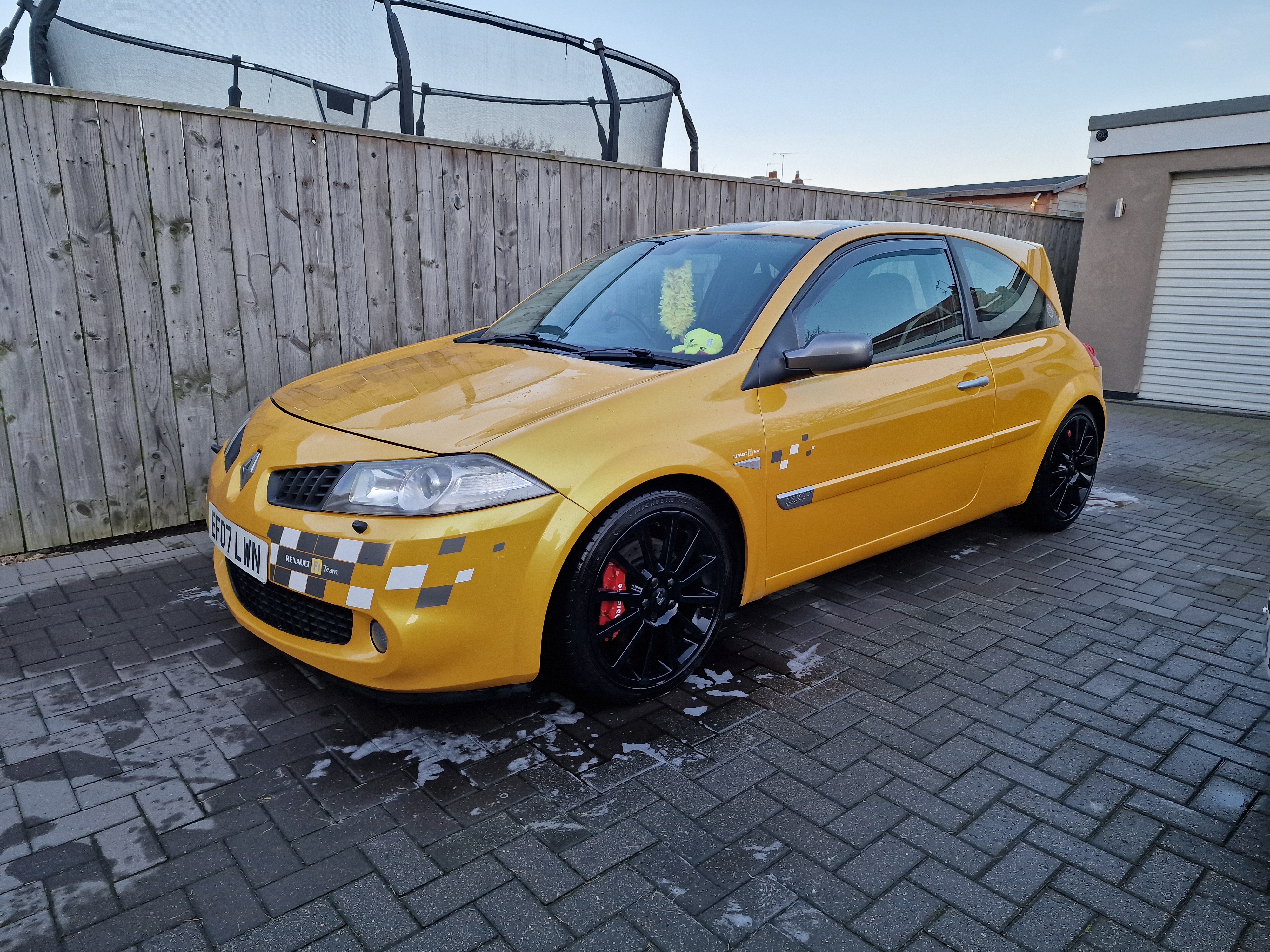

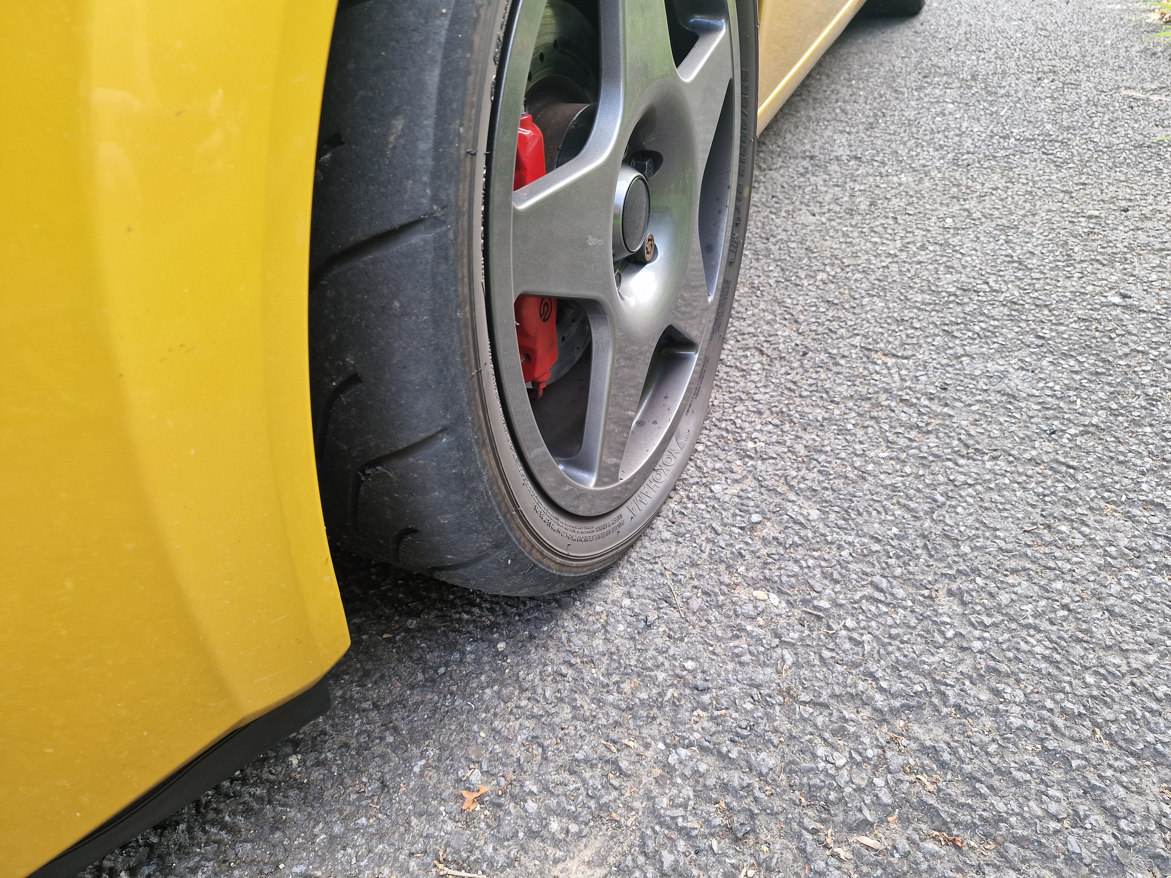

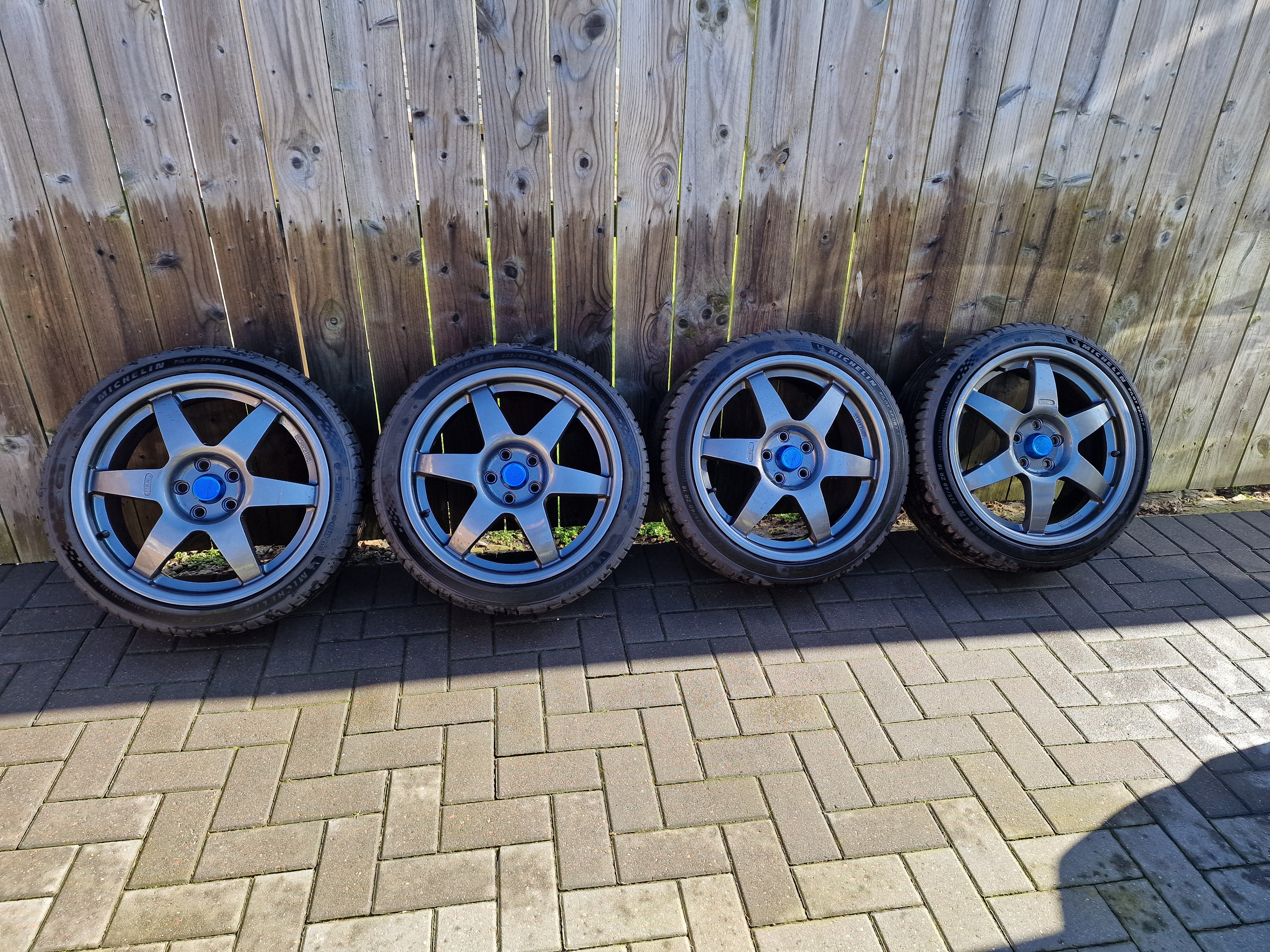

As weather is good got the compomotive mo6 back out to refit.
Quick clean.
Fitted.

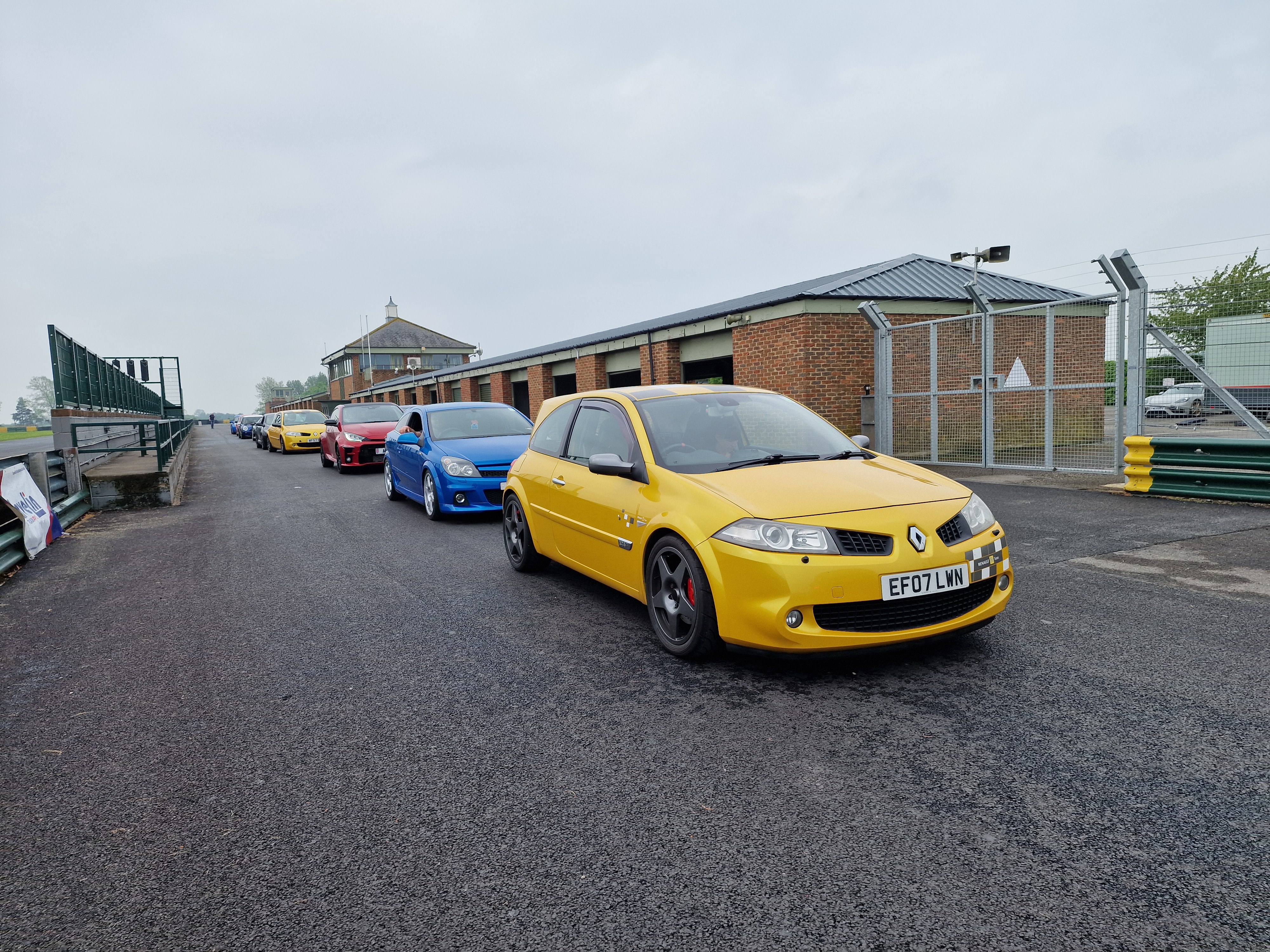

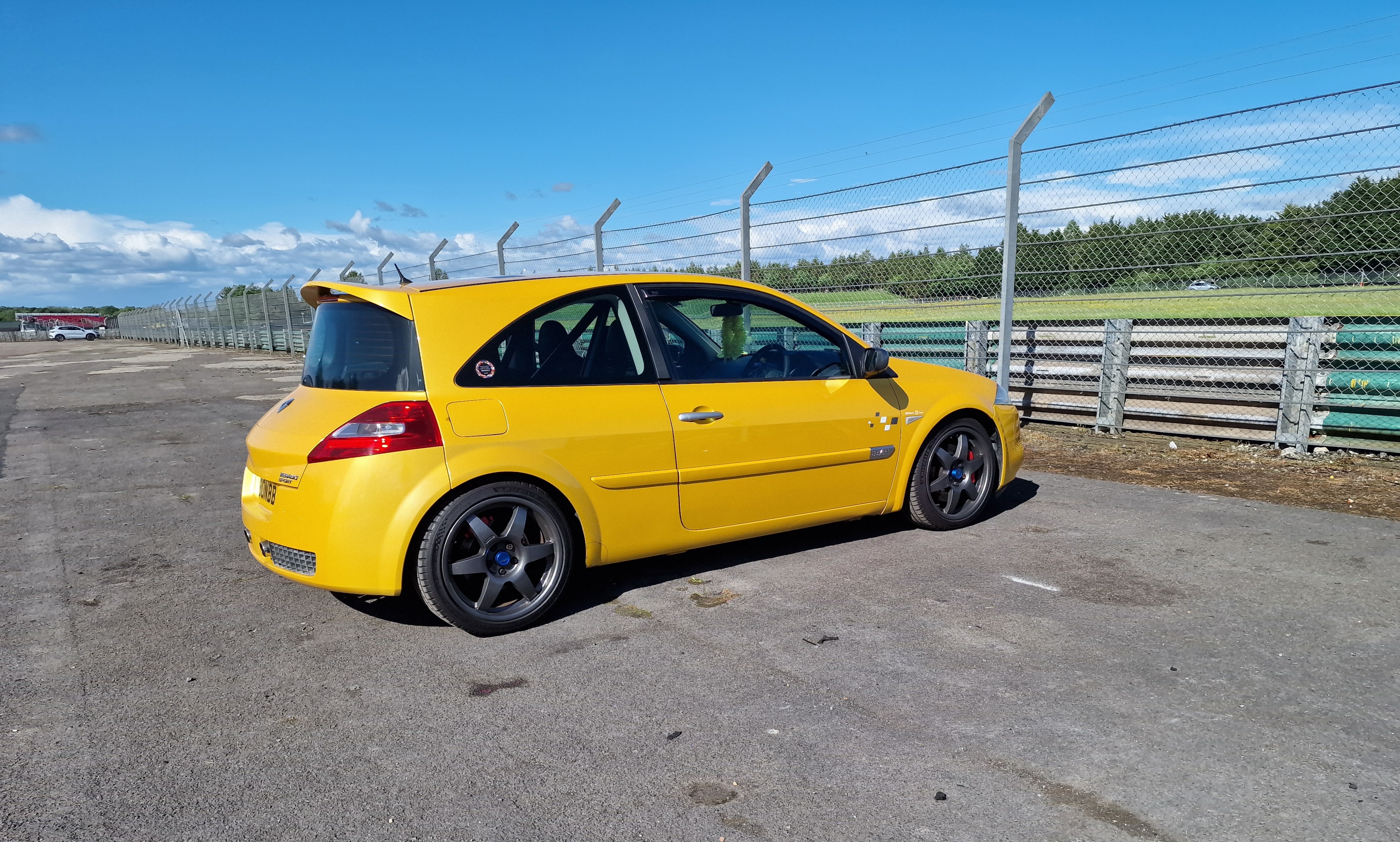

Popped down to Croft on Friday..was going to try and get on for PM session but looked super busy/red flags so rain checked it. Had a good catch up with @Mr Underhill and ended up blasting around a few b roads near Ripon on the way back.
Lids in the back ready for track action.
Croft. Next time.
Mot due early April..dont anticipate any issues so will get that sorted then booked up for some trackdays.
Quick clean.View attachment 1686284
Fitted.View attachment 1686288

The wheels do look amazing.

Cheers all (y) Feel like i have got to a point with it where im pretty happy with it, use and maintain.
I love the way it looks on the compomotives. I fancy trying my white set on it at some point to see how it sits on them.

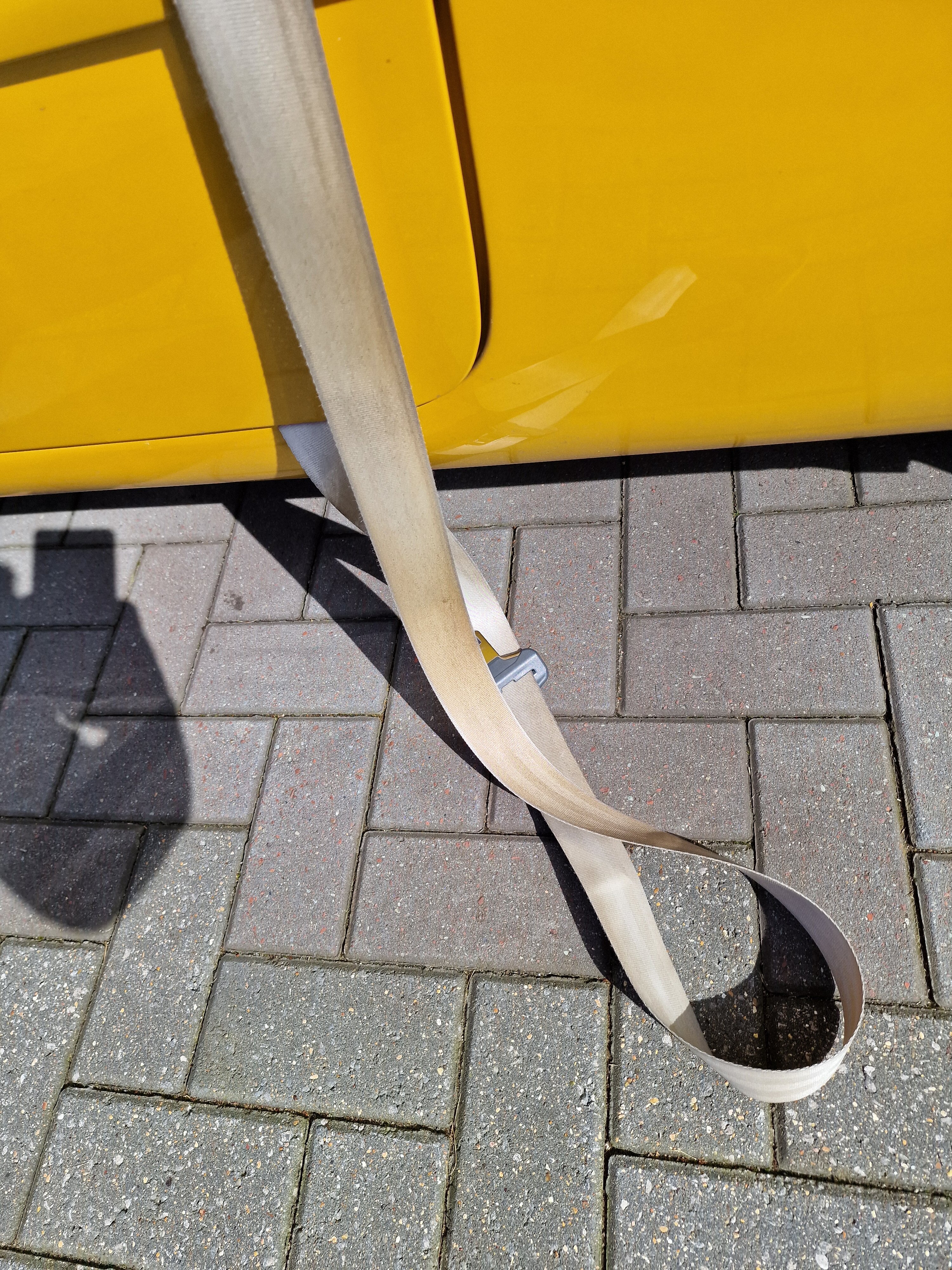

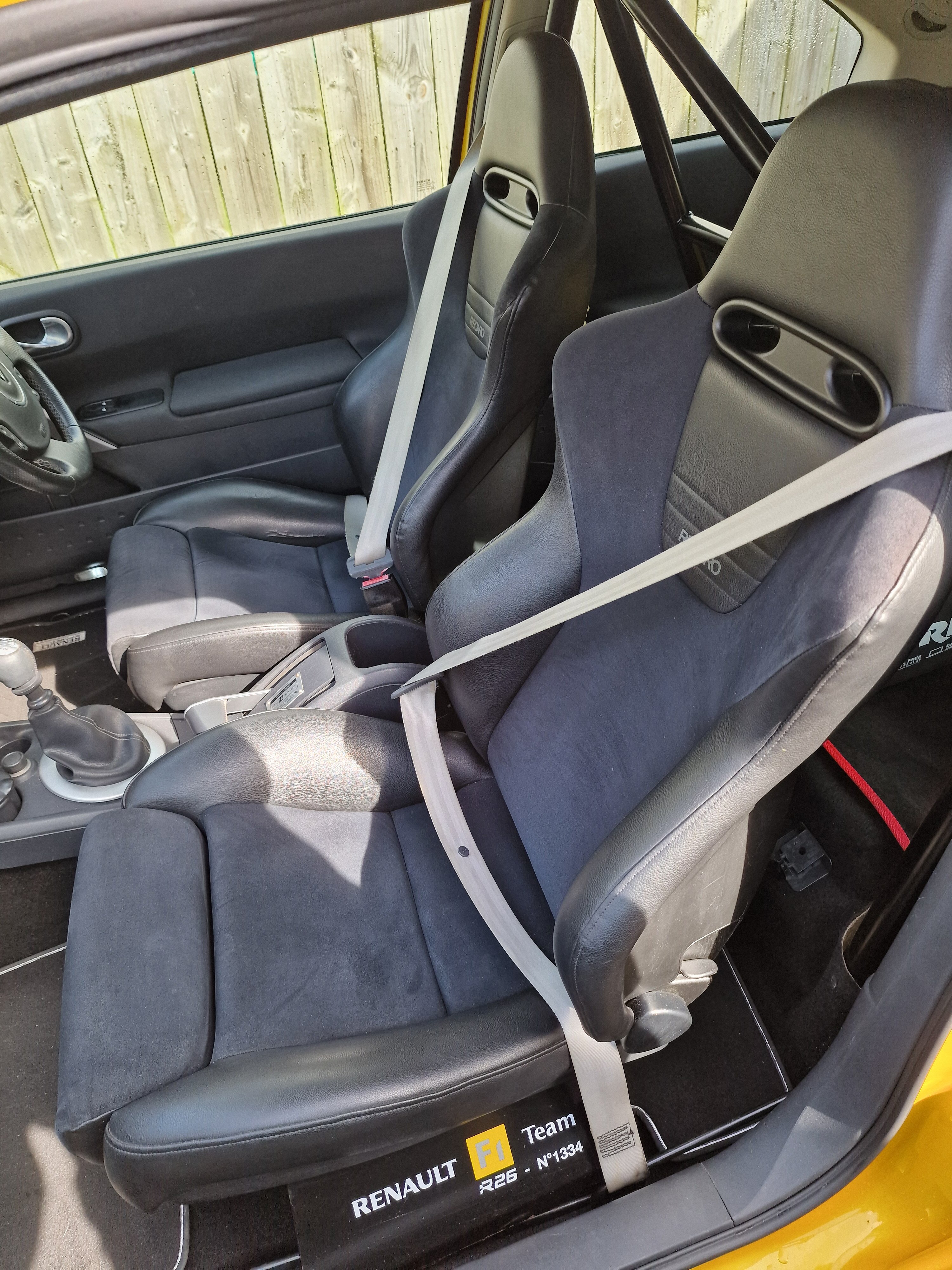

Had spare half hour so cleaned up the seatbelts..they were super grotty and retracting pretty slow.
Mixed up a bucket of vanish oxy action and got the drill brush out. Quick soak in the bucket and buzz over with the brush.
Before - drivers belt was even worse was black
After - much better
Unfortunately they still retract quite slow but was worth a shot.
