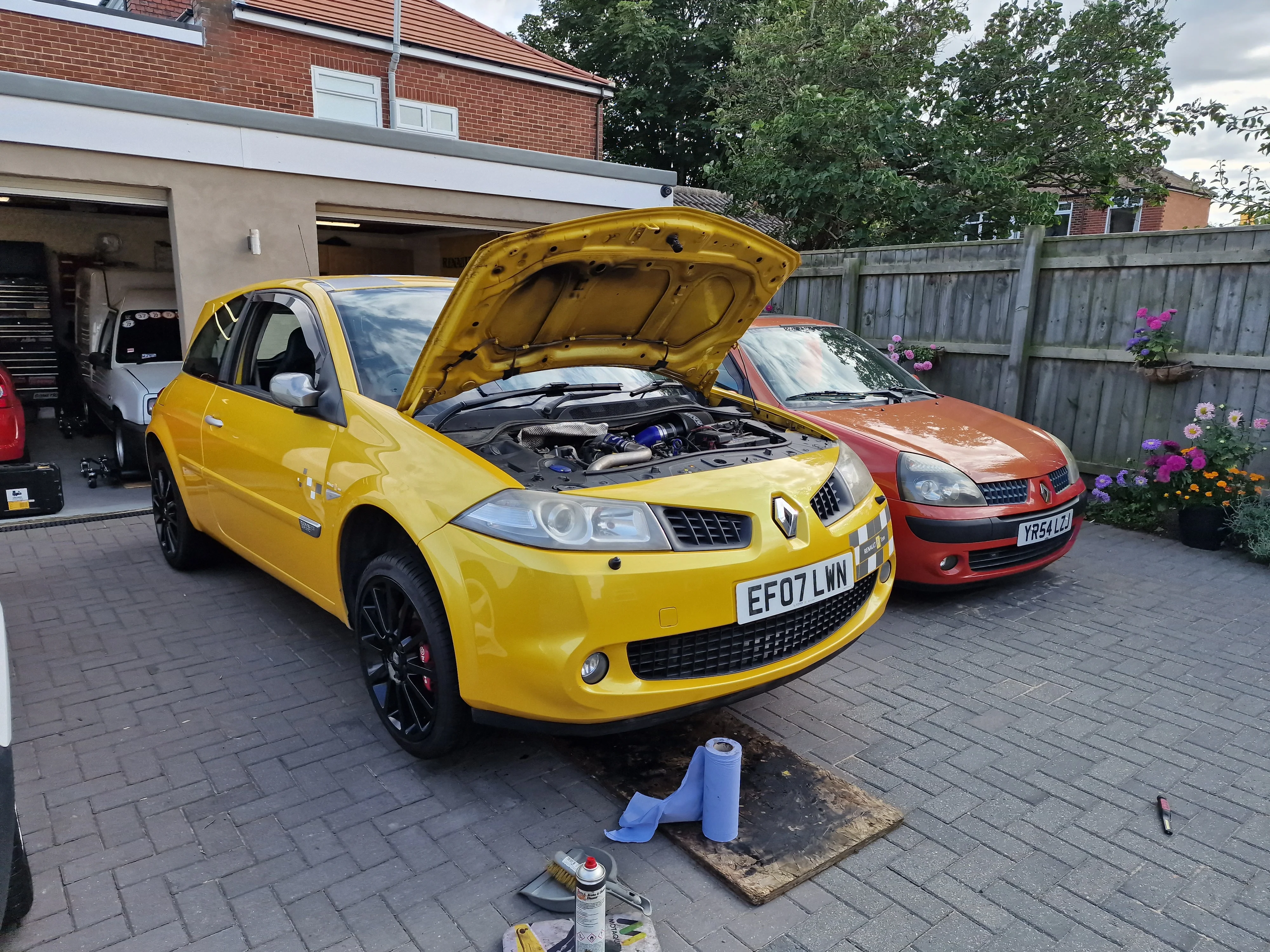

Bumblebee 2 featuring LY R26
Brigsy
Car  T.Turbo
Here we go again.

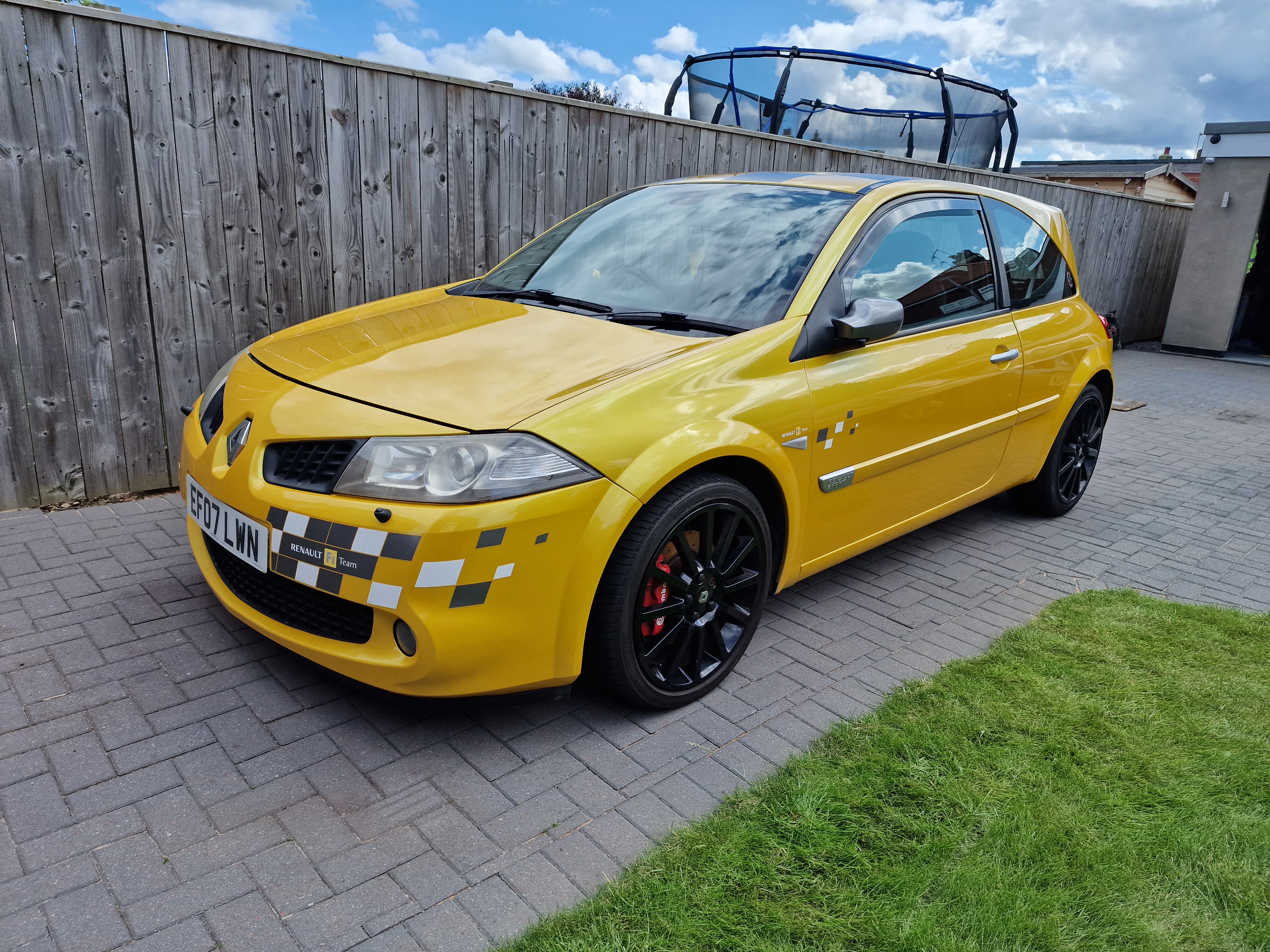

Got a random message off a lad i knew from years ago asking if i wanted to buy a car just before i went on hol. Initially said no, but because im an idiot i cannot just say no and a few beers in the sun in Turkey im asking for more info.
Was a bit of a slow starter after initial contact but ended up viewing a week ago and picking up last Sat.
Meet Bumblee2. Leggy on the mileage but cleans up ok..cheap, needs tlc.
Snag list is pretty big as i repeat cheap.
A quick once over reveals even after fixing a few bits
All front suspension needs refresh including hub bearings.

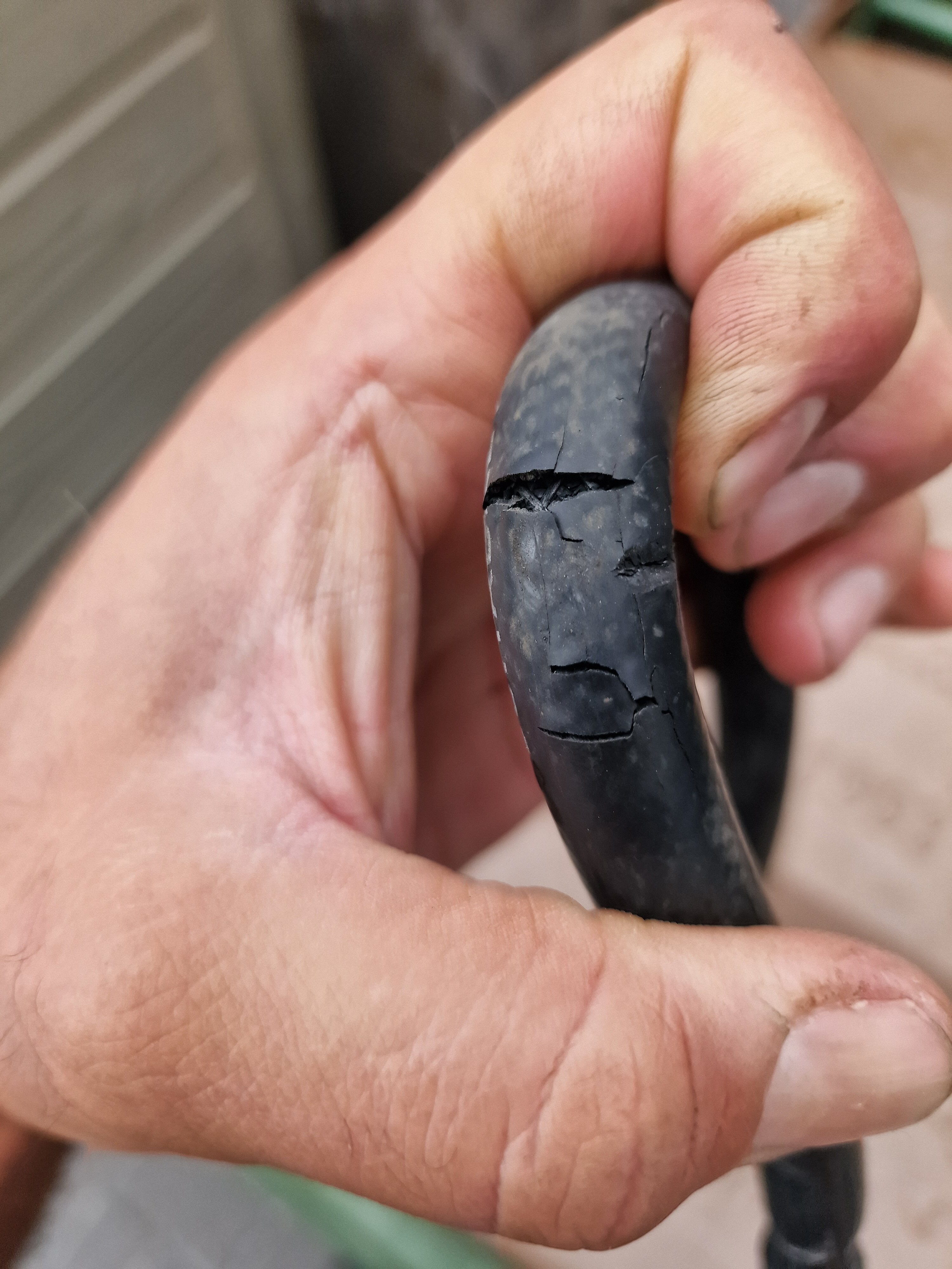

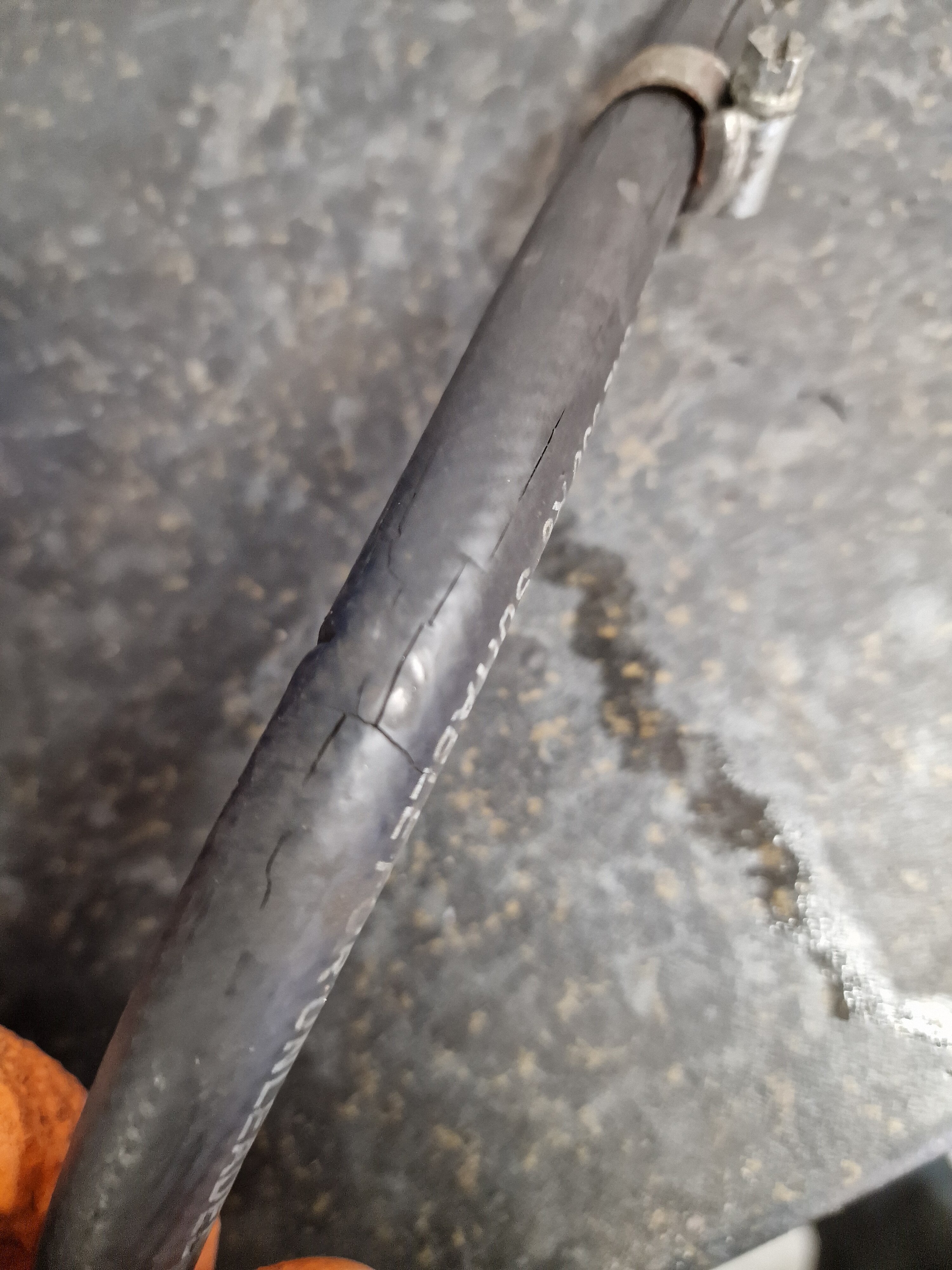

Fuel hose (cracked all over where its been replaced in the past)

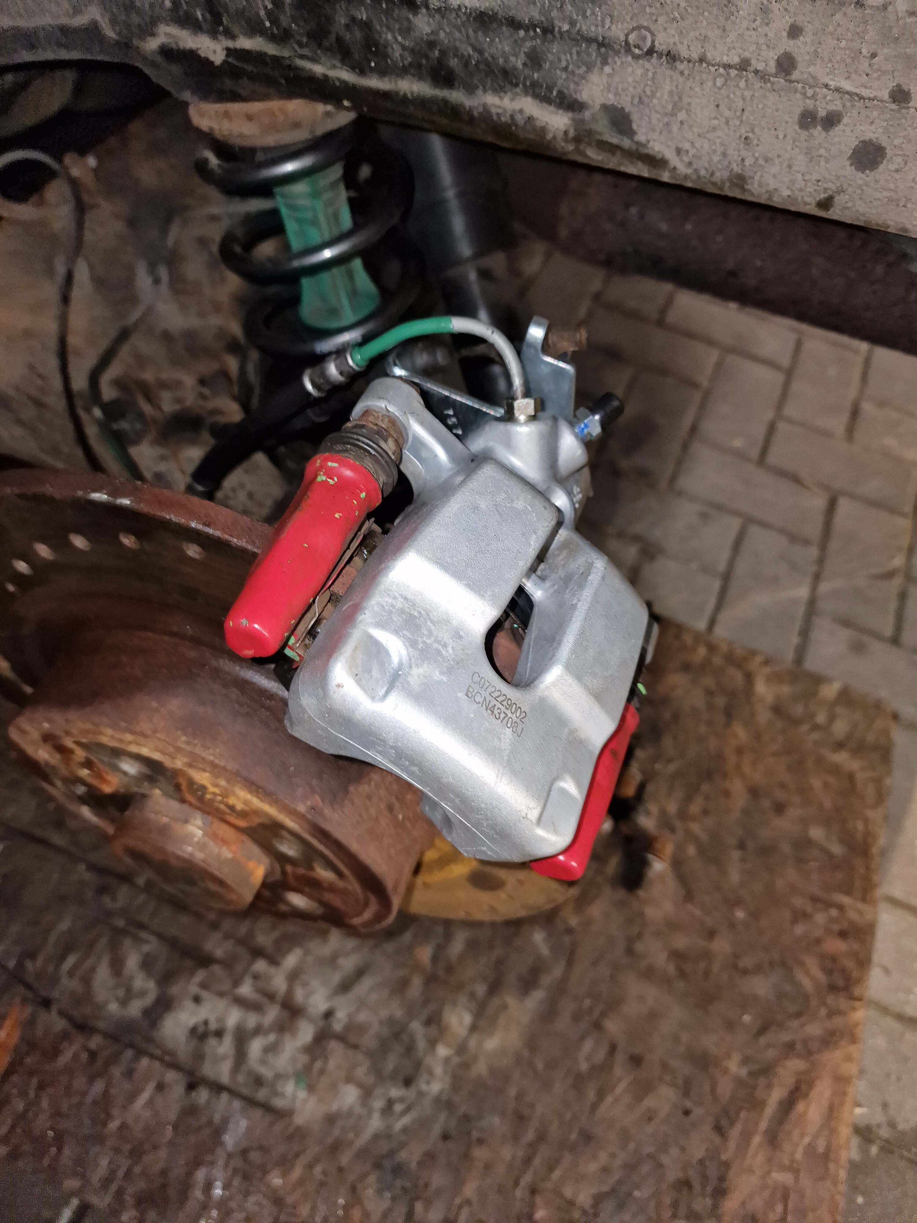

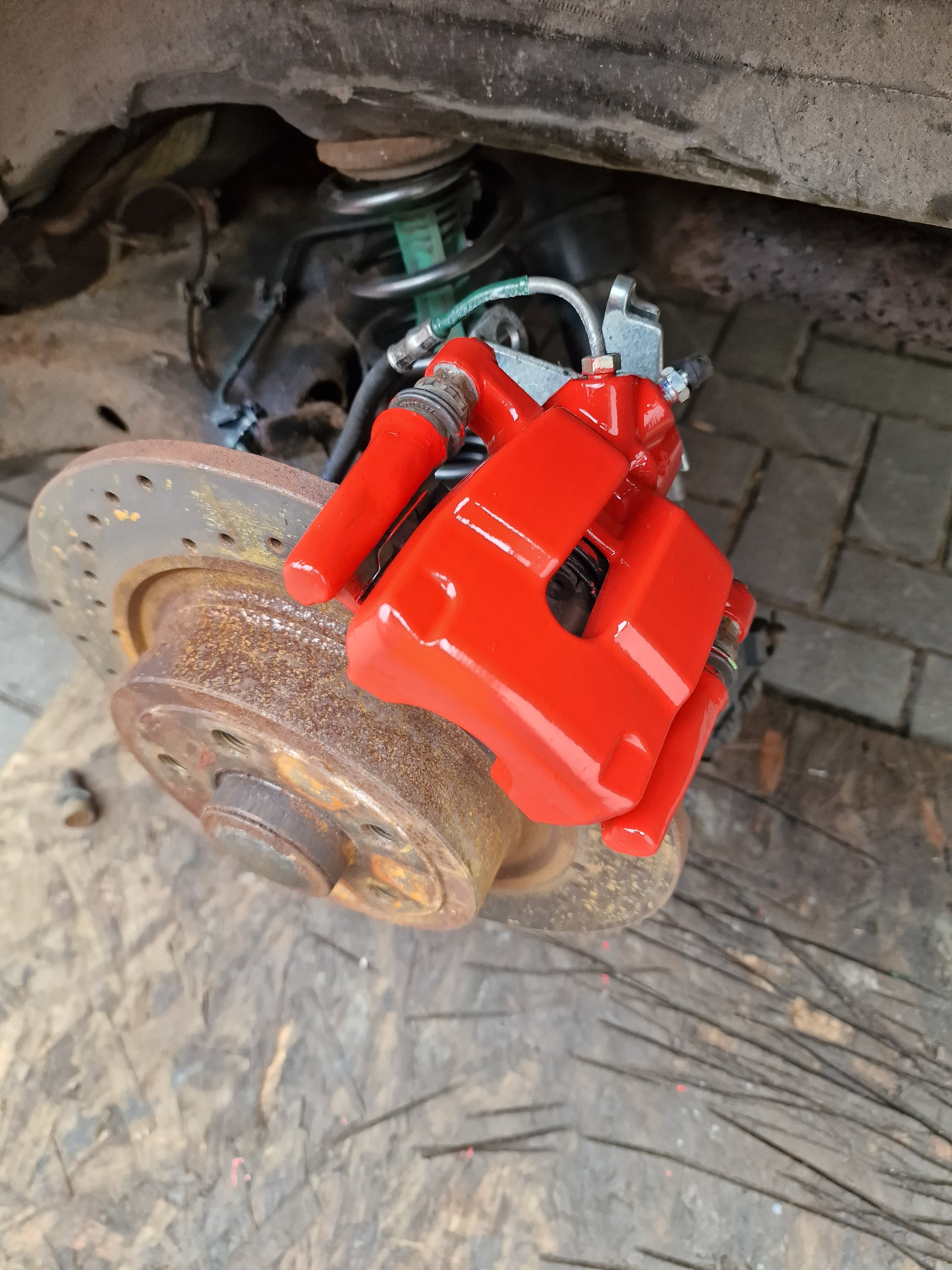

Rear passenger caliper (binding)

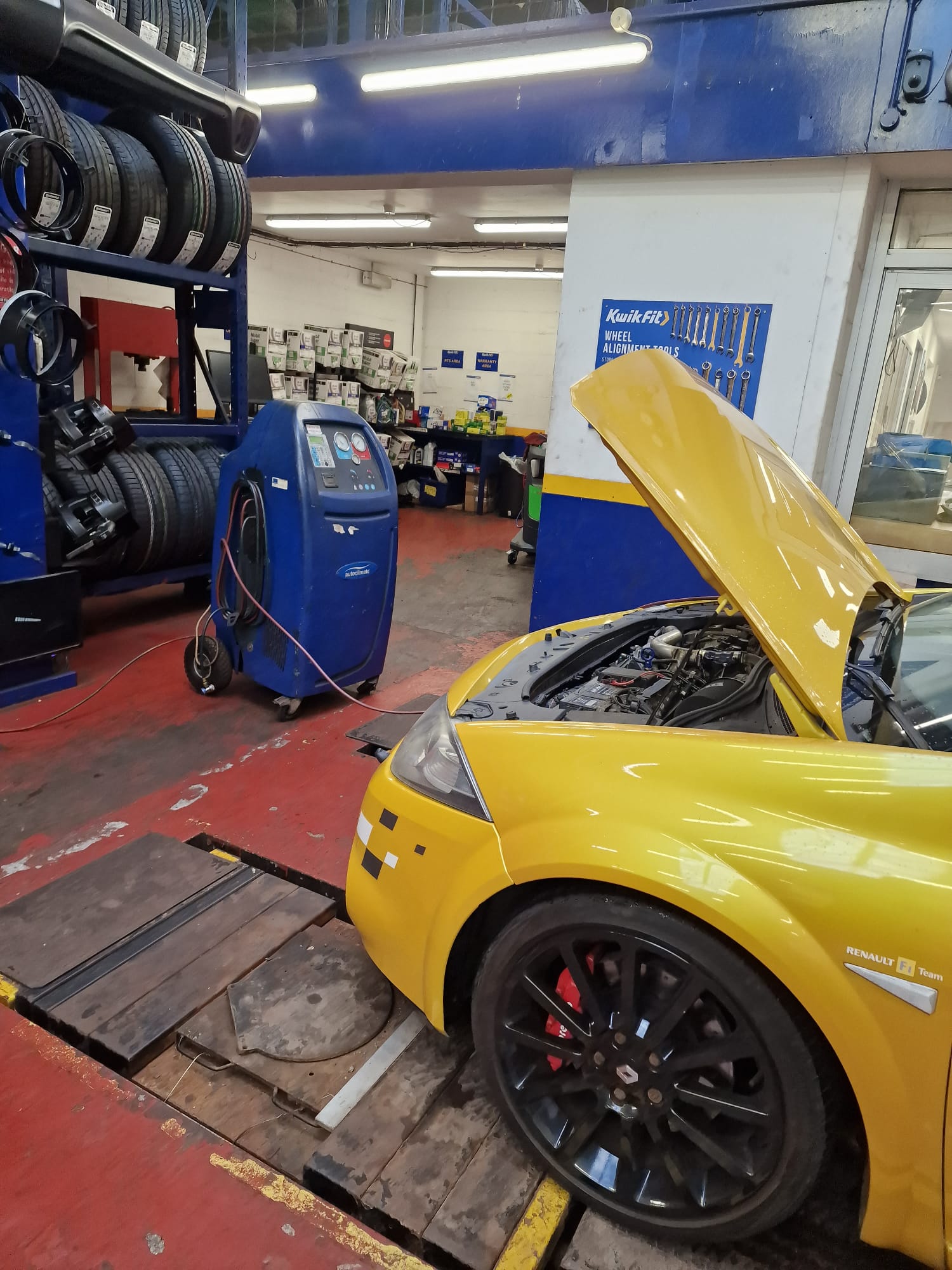

Aircon regas

On the plus side
Recent engine with 80k on/belts done

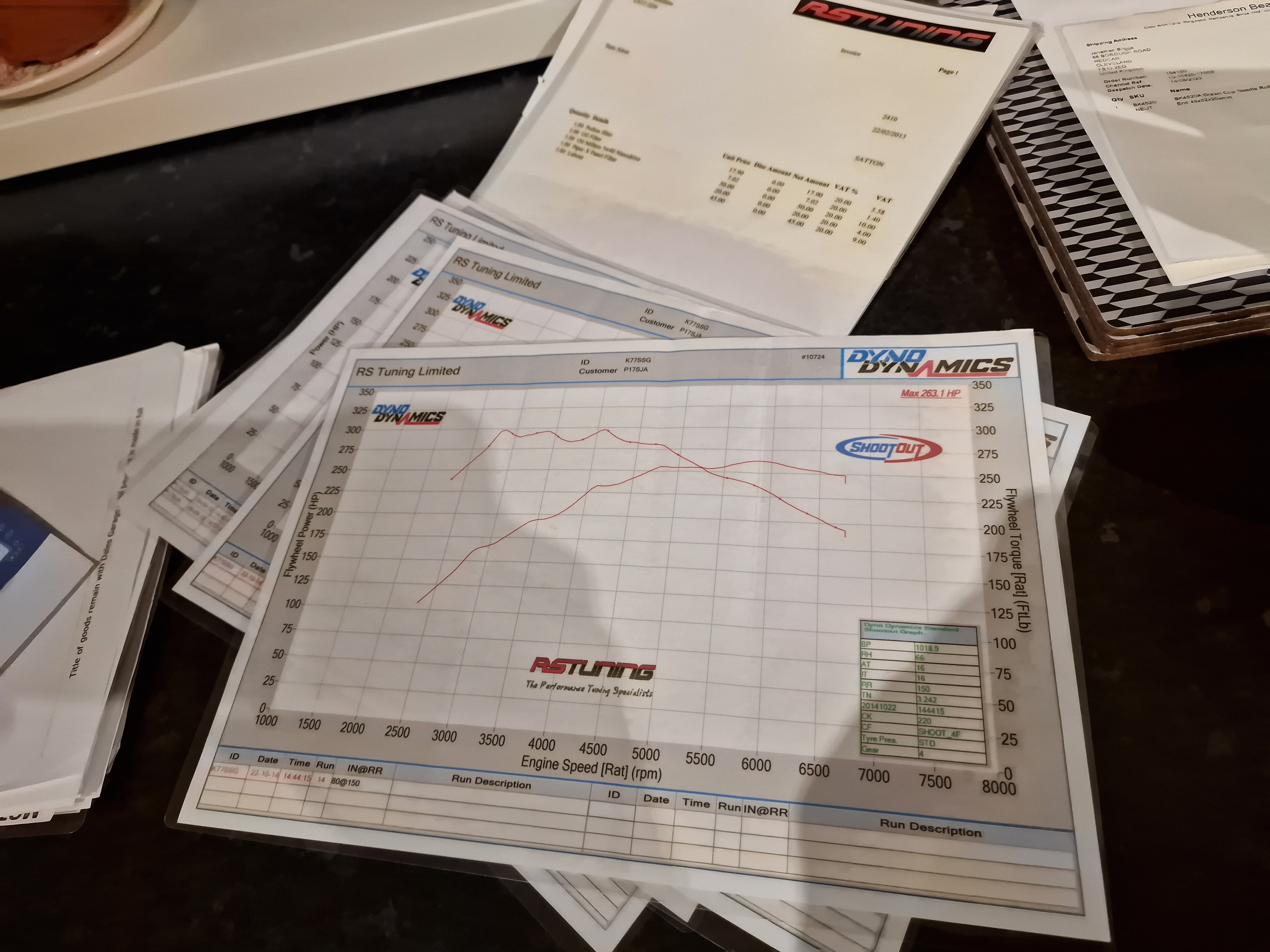

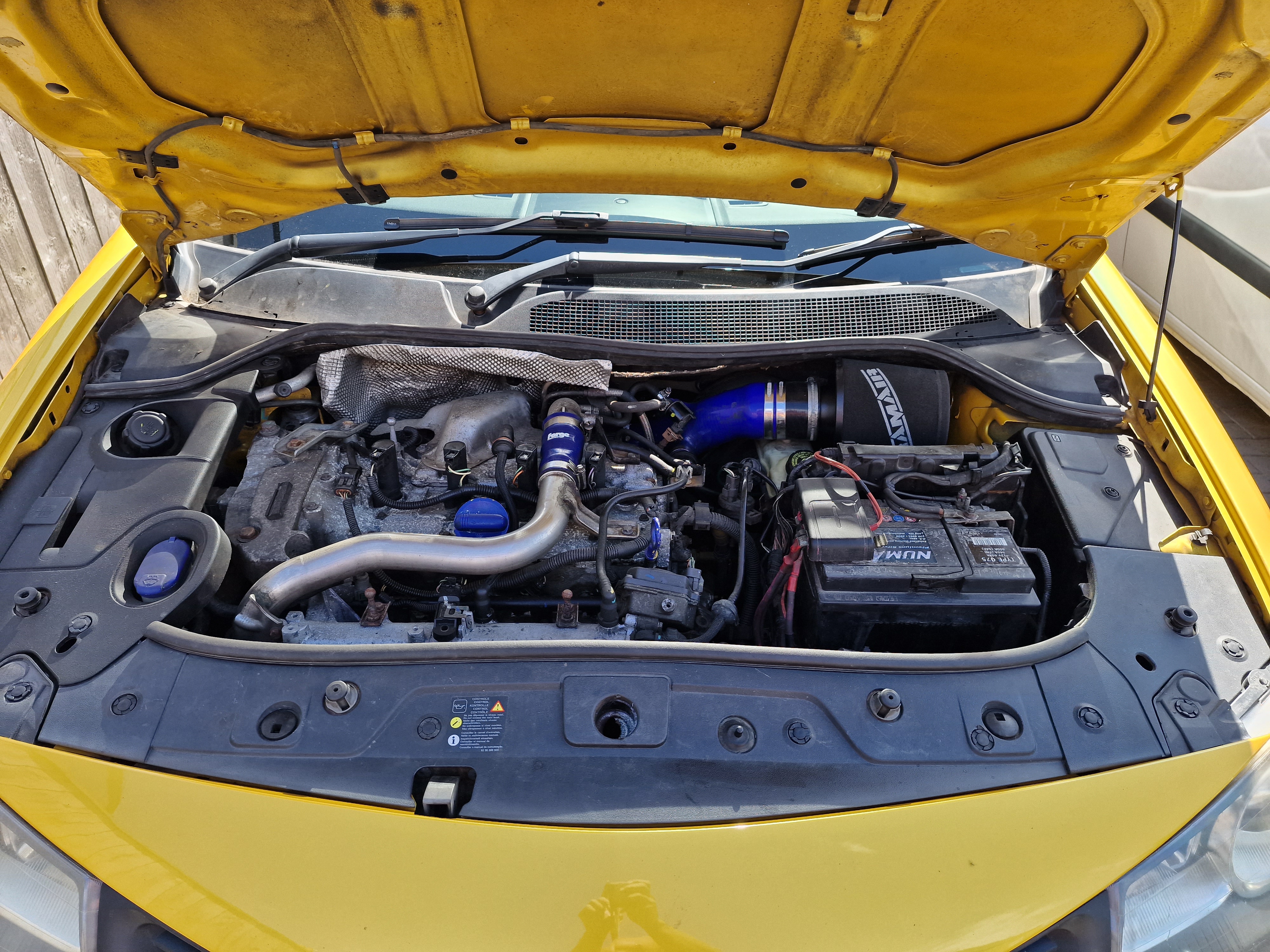

Decat, alloy intercooler and back box delete, cone airfilter, mapped by rstuning
Decent amount of mot
Cleans up ok
I have a ton of parts in stock so should be able to turn this around pretty fast.
Should be alright for a bit of trackday fun.

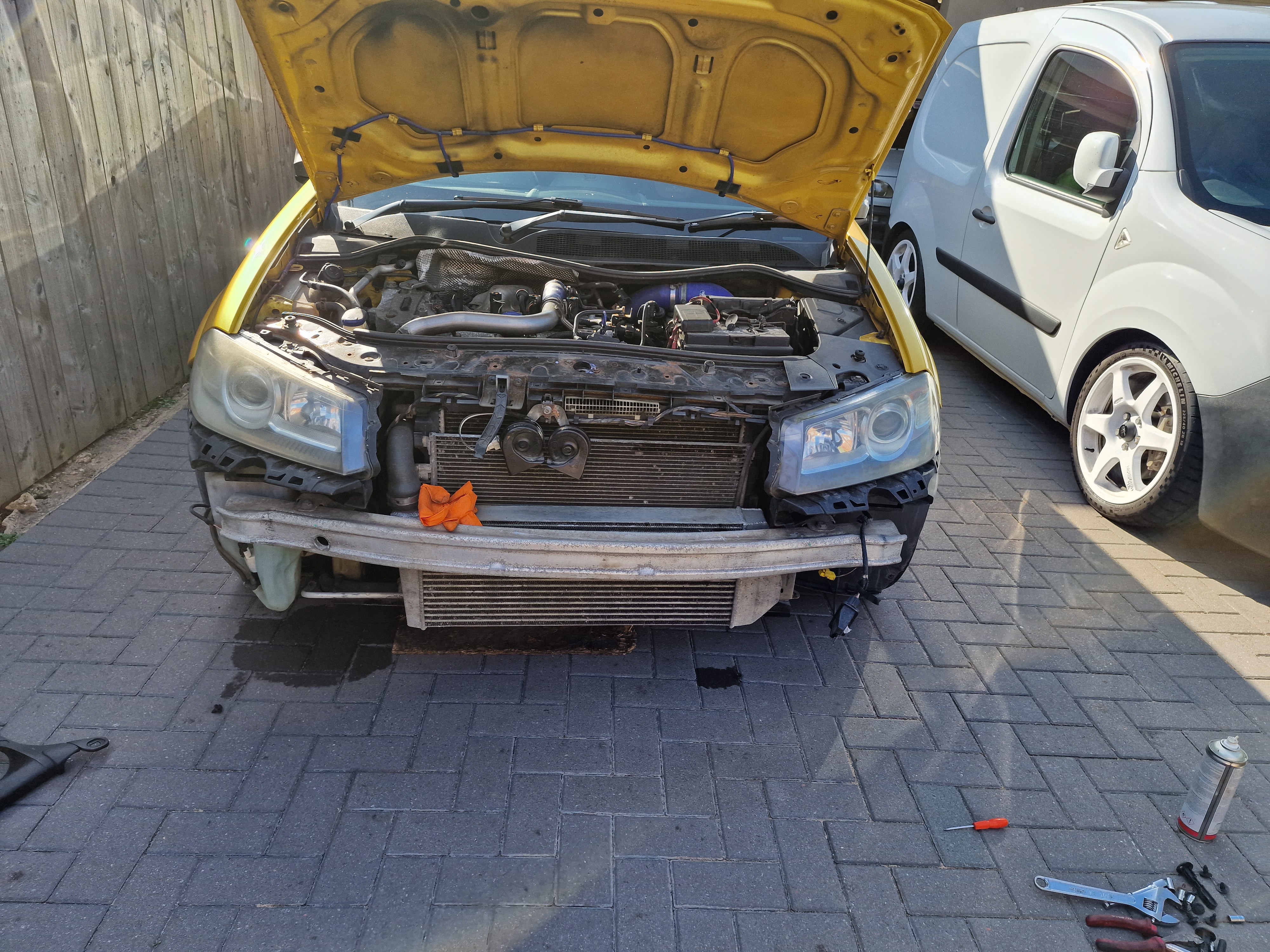

Bonnet wouldnt open without a 2 man job and bumper was badly fitted/ziptie special. Whipped front end off and adjusted bonnet stops etc.

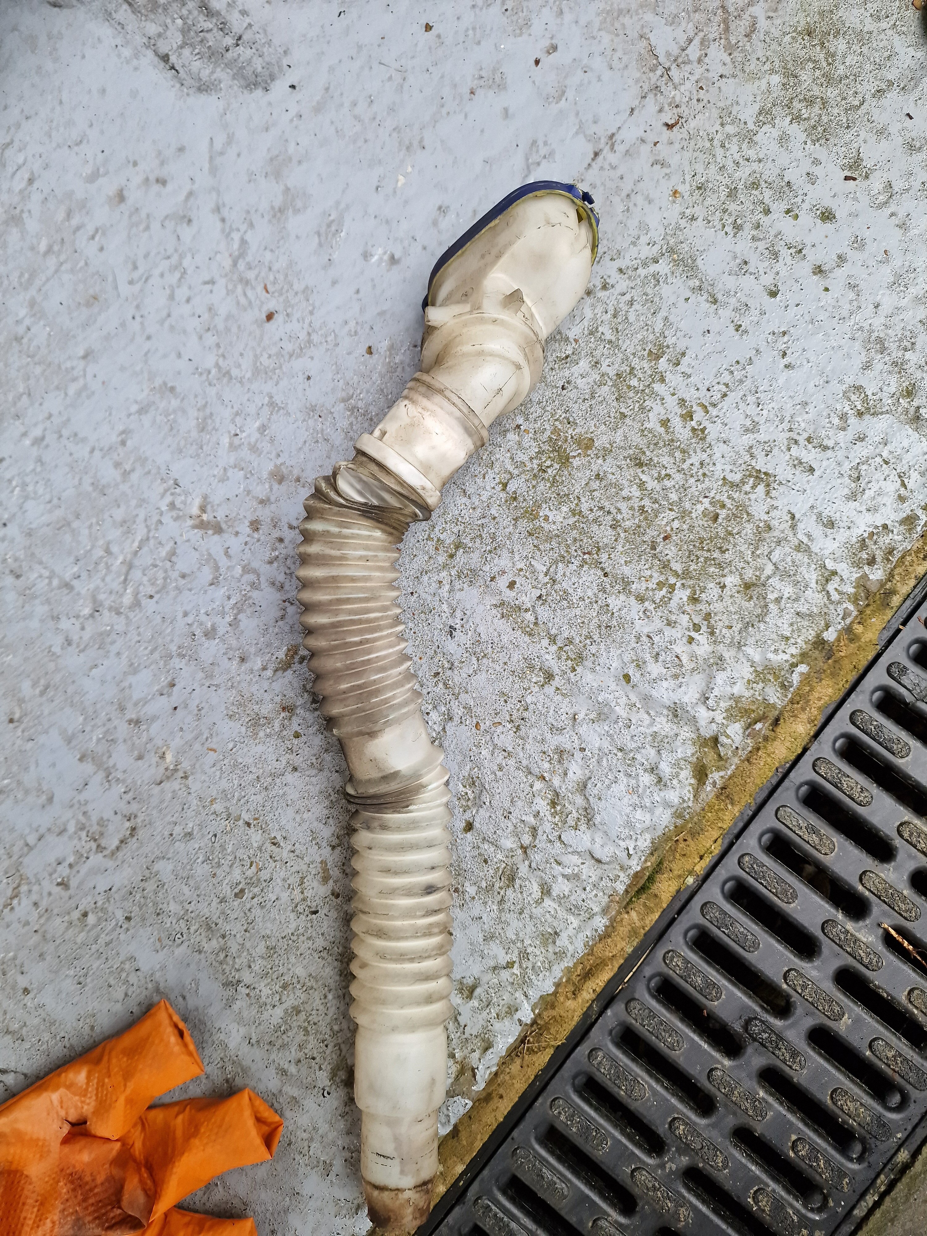

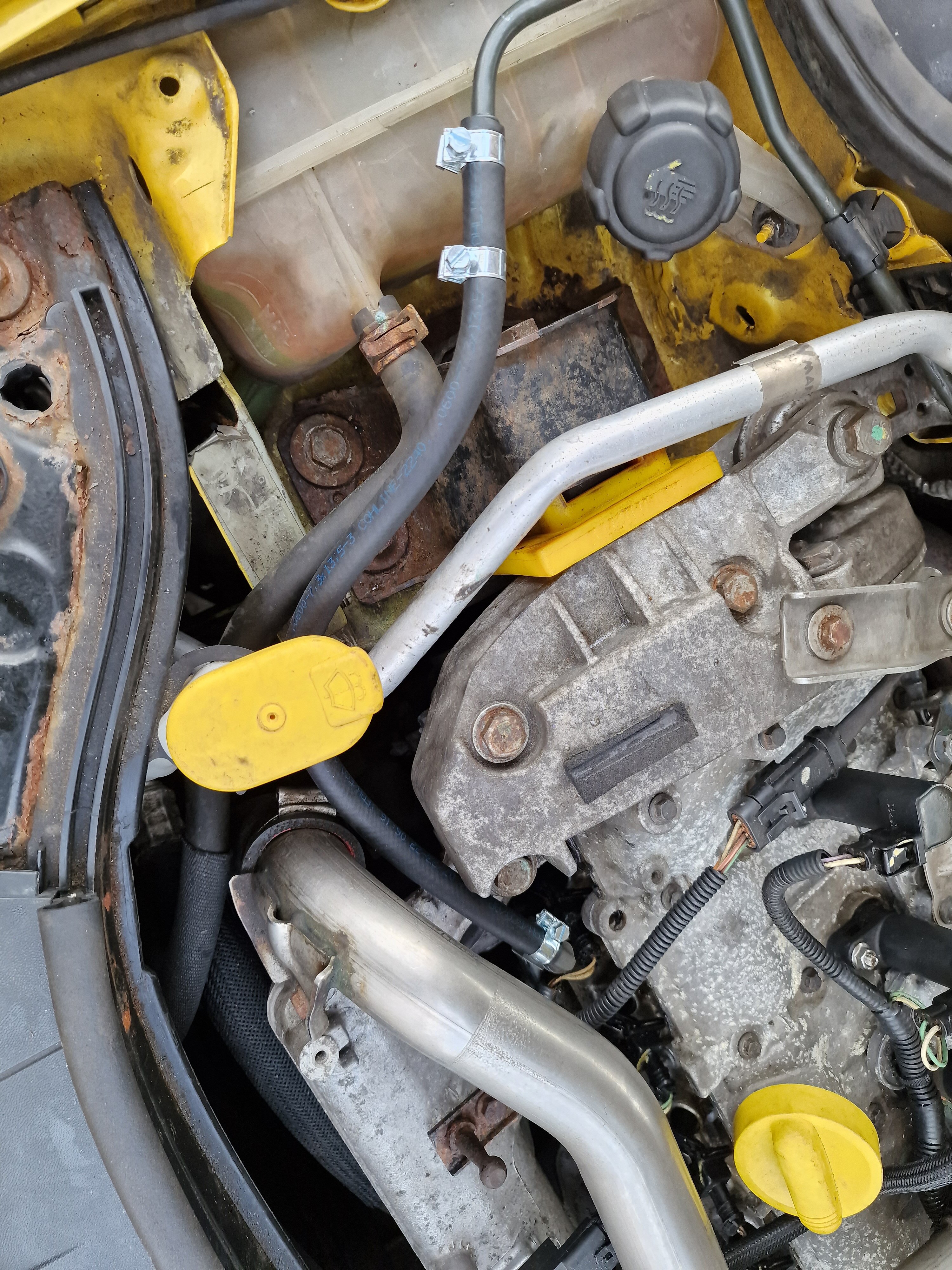

Note washer fluid pissing out when filled and alloy intercooler poss forge.

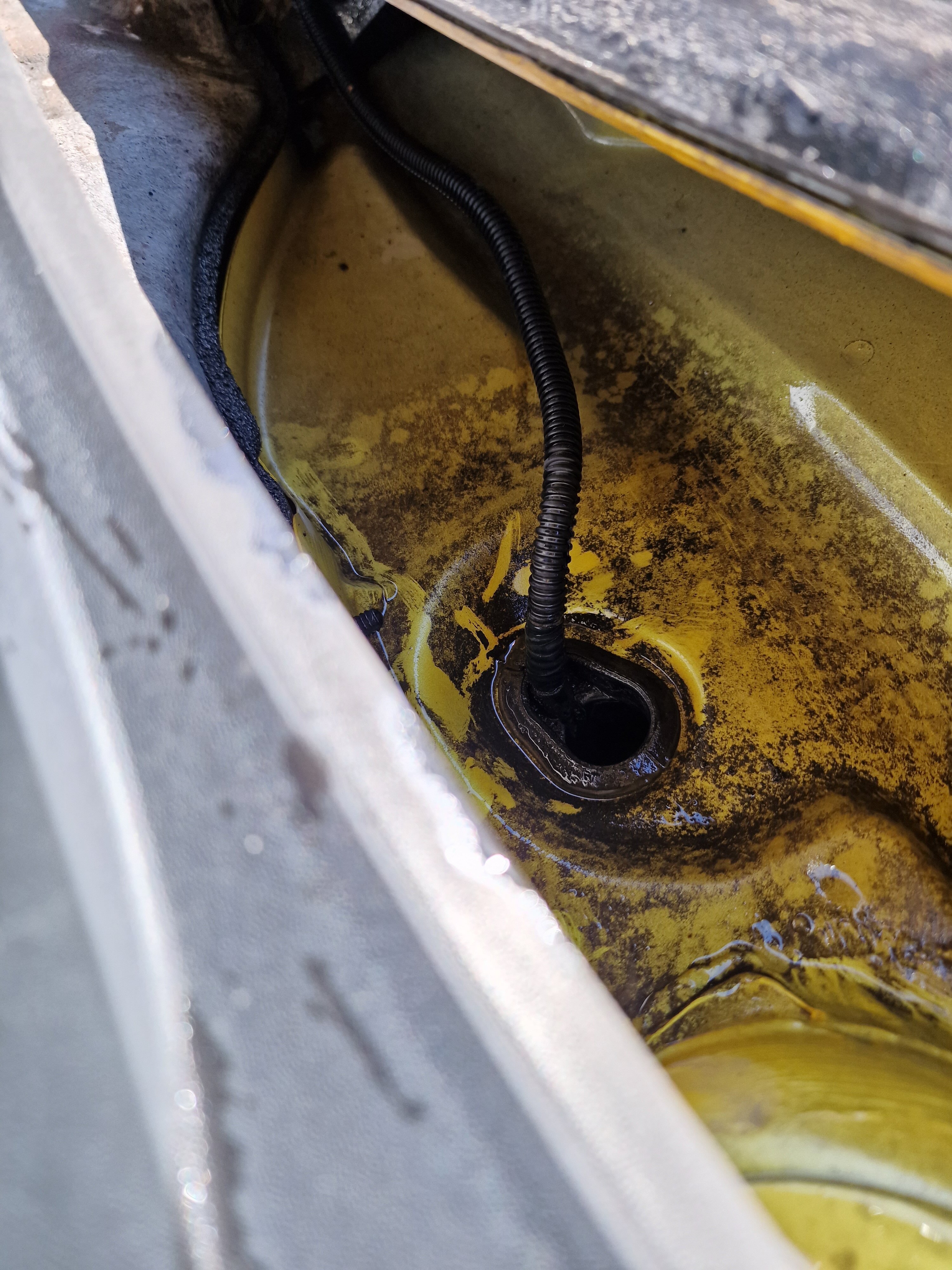

Scuttle had a pond in it so unblocked the drains.

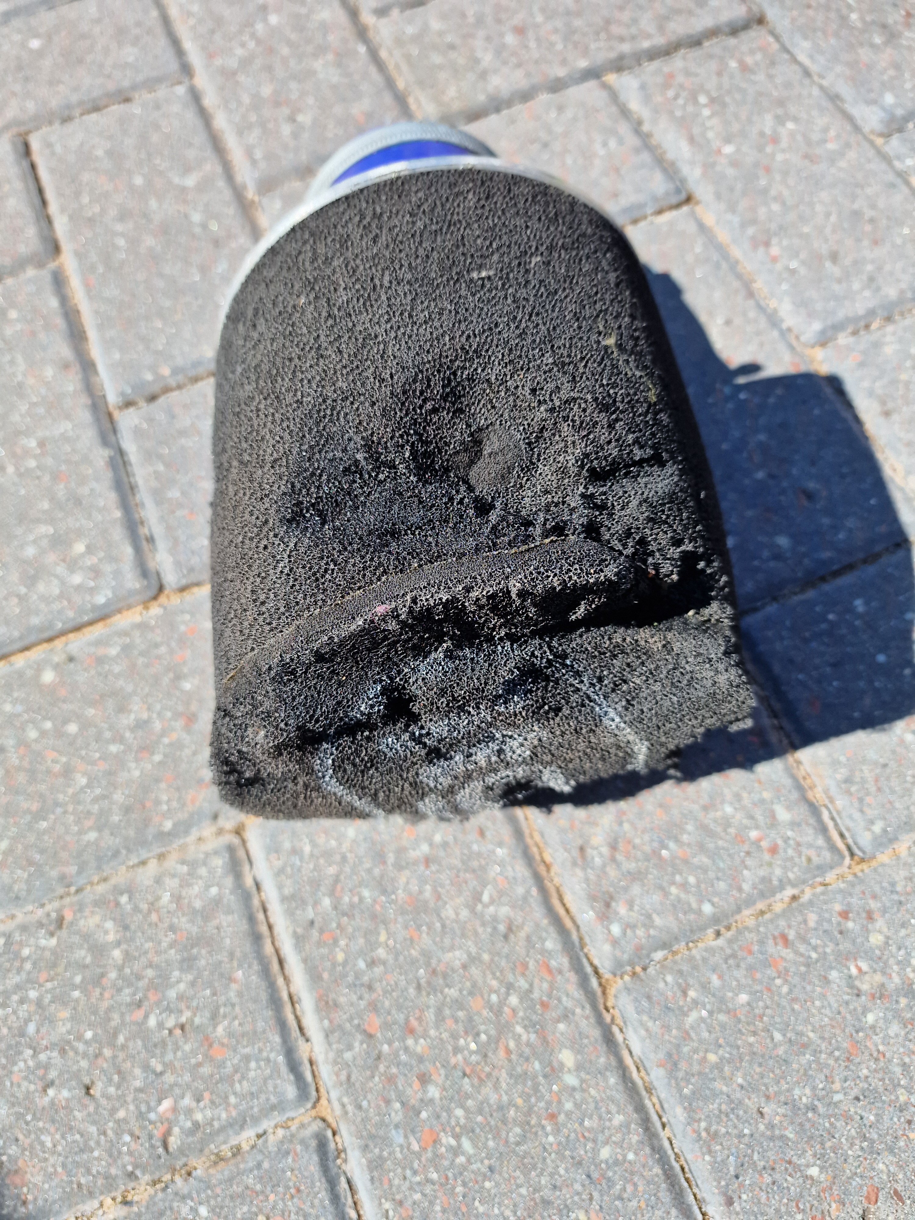

Took airfilter out for a look, knackered as it was rubbing on gear selector. Ive replaced it for a ramair i had off the Kangoo.

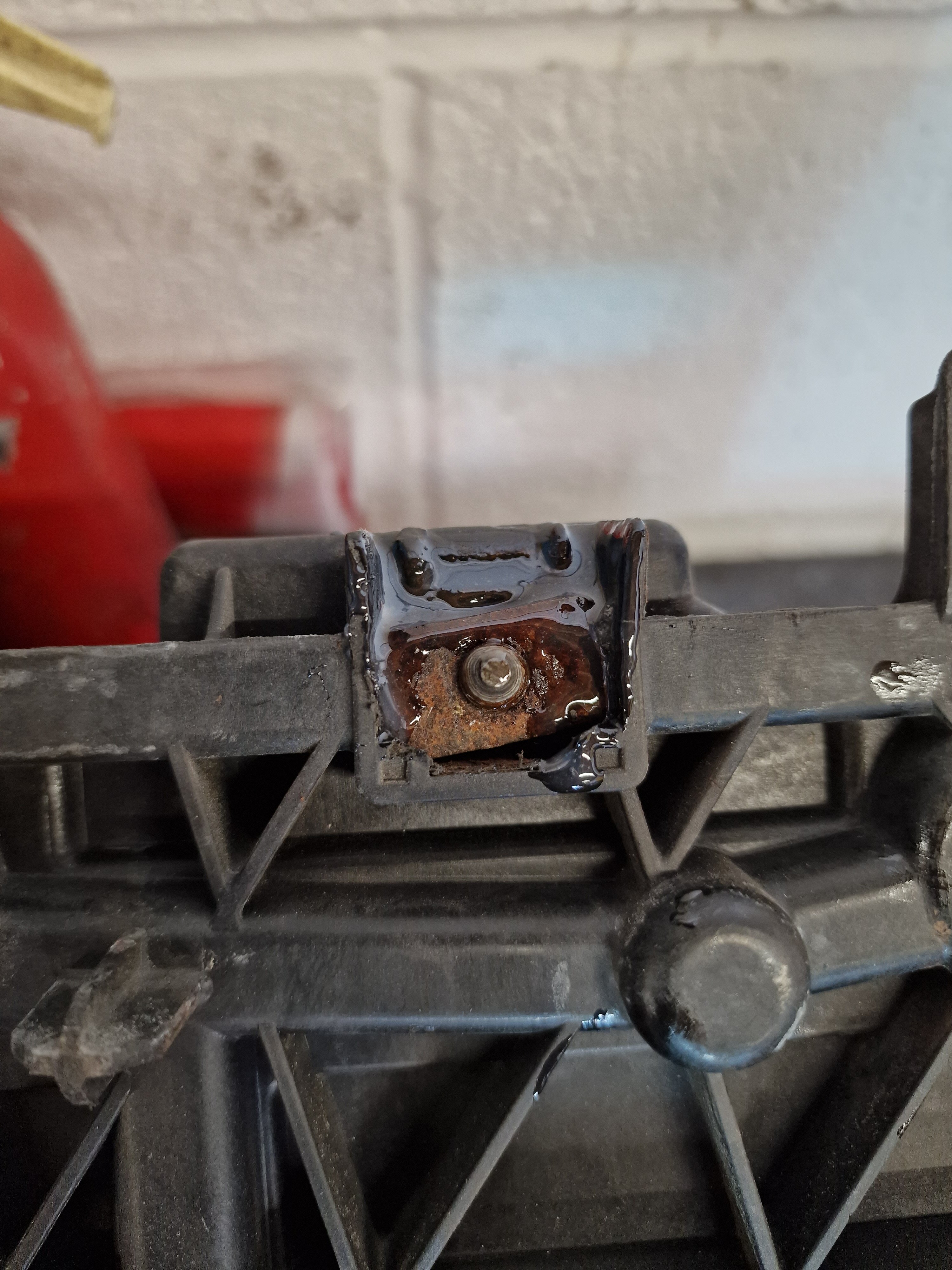

Battery tray clamp was knackered as they all are. Epoxy resined the fitting in

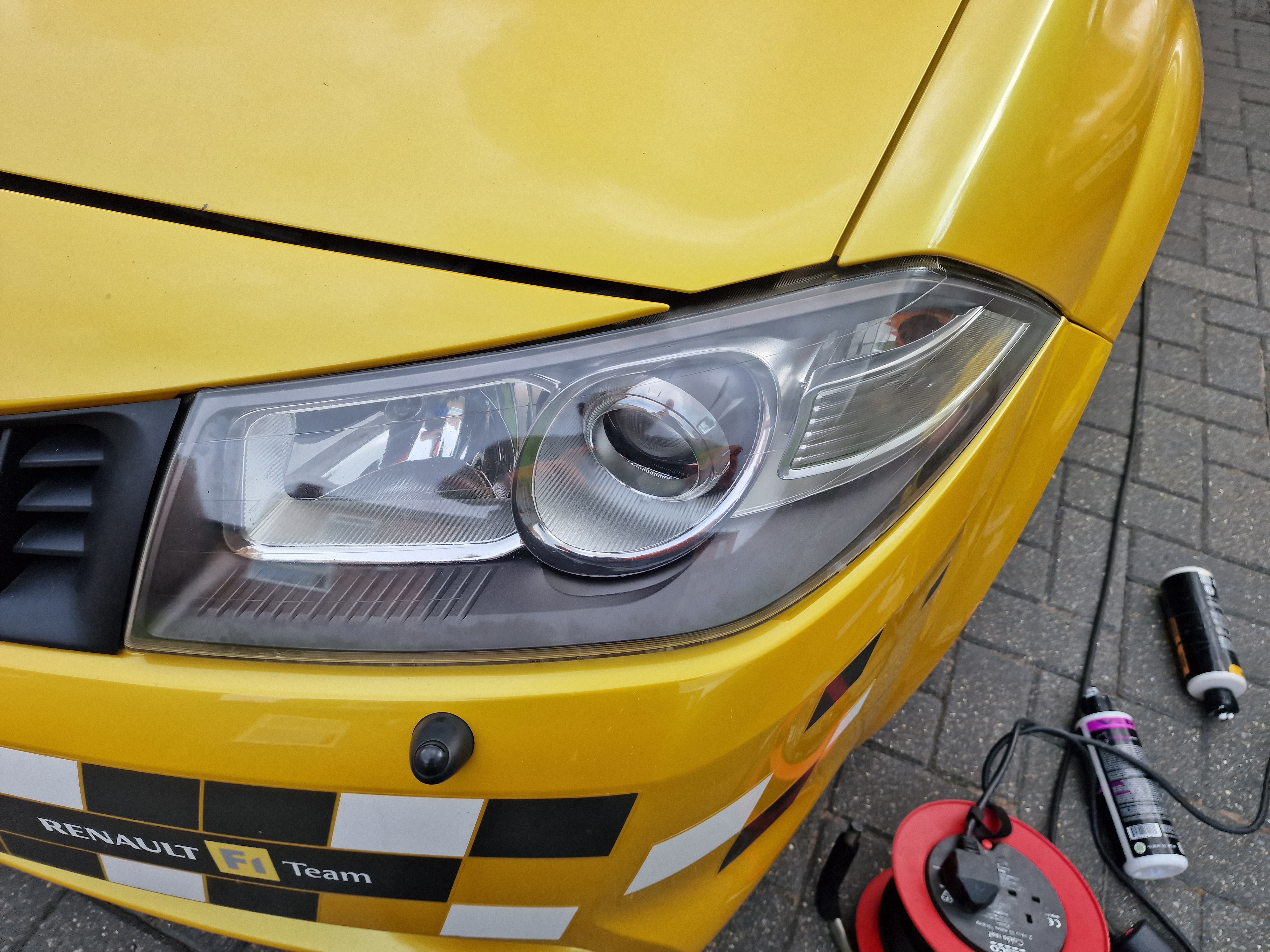

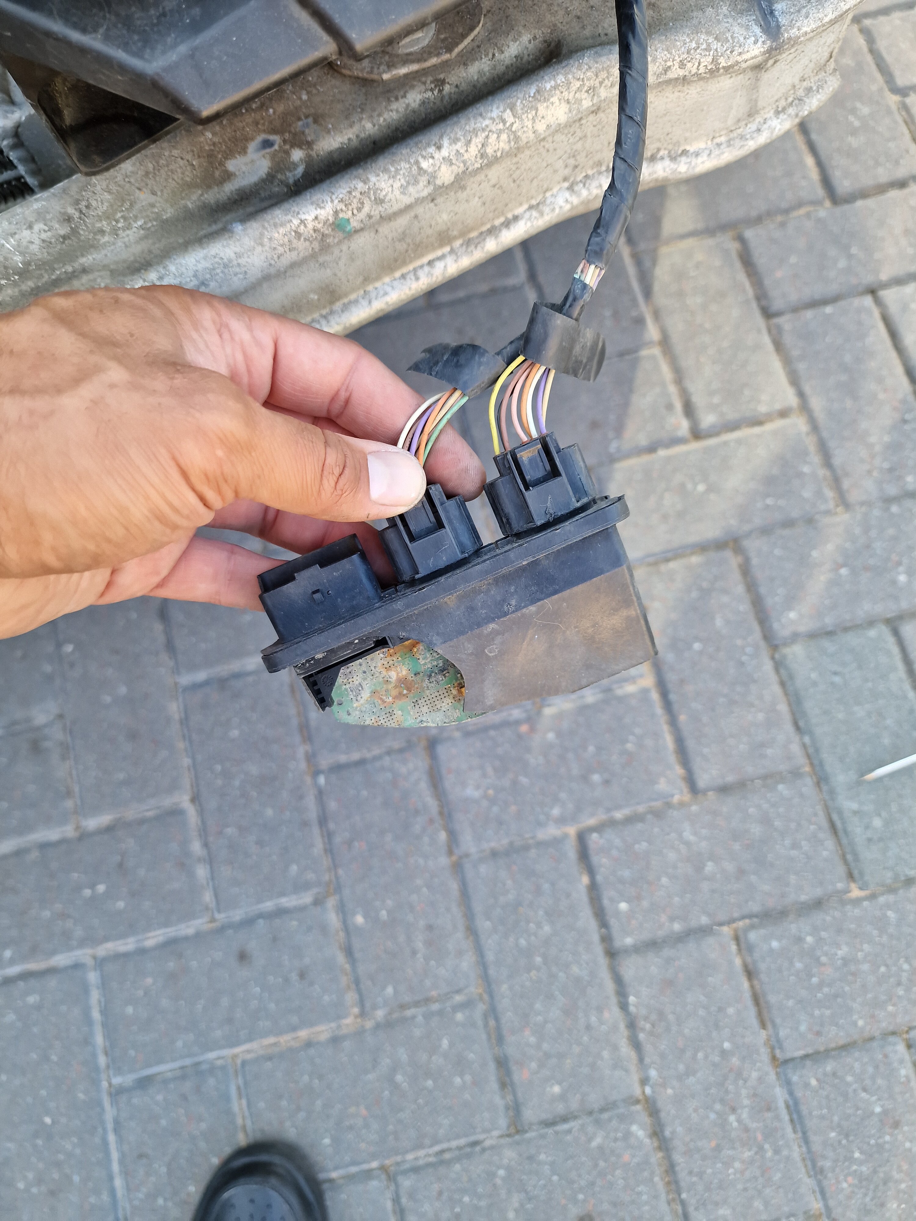

Xenon control box has seen better days.

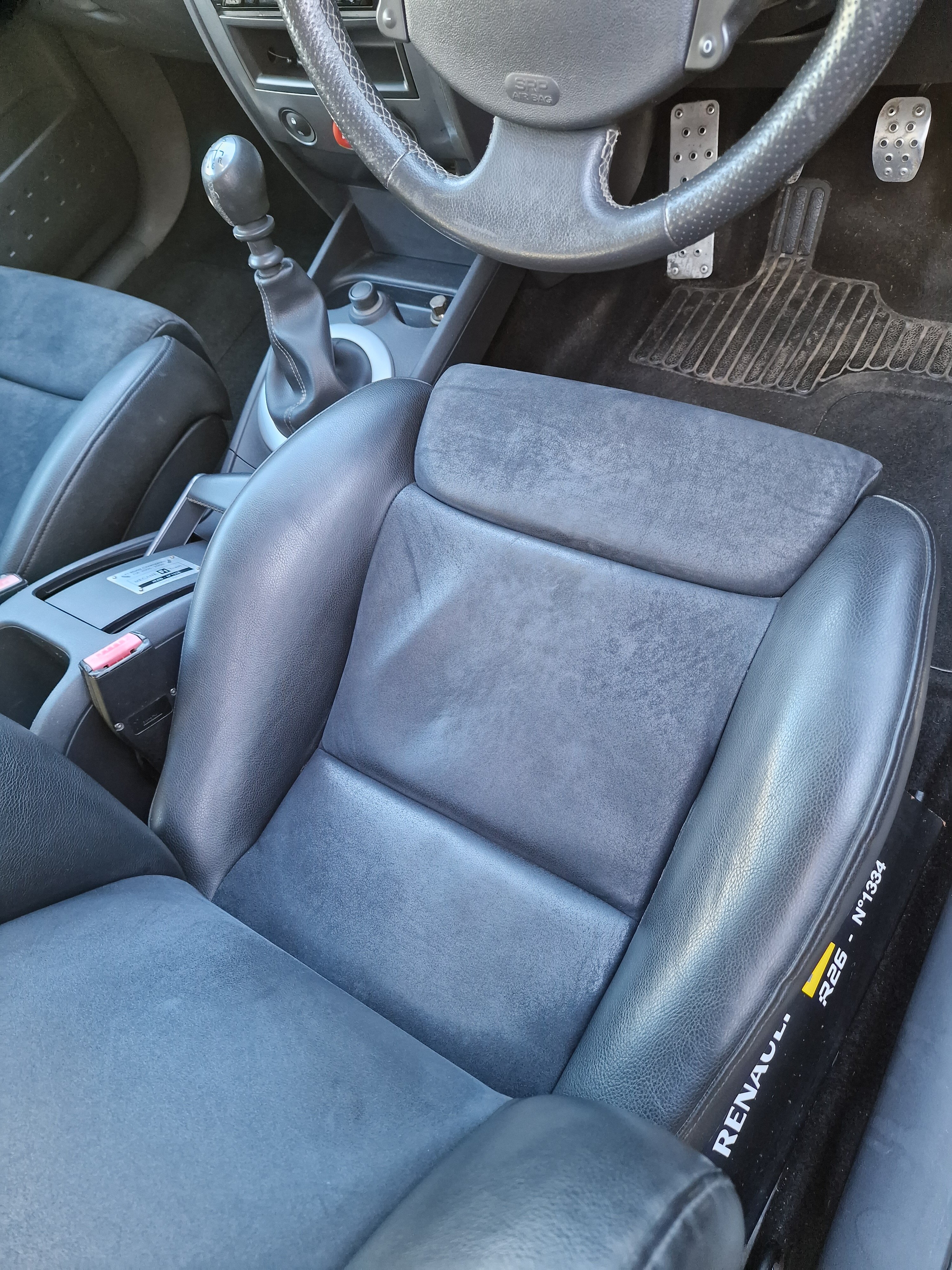

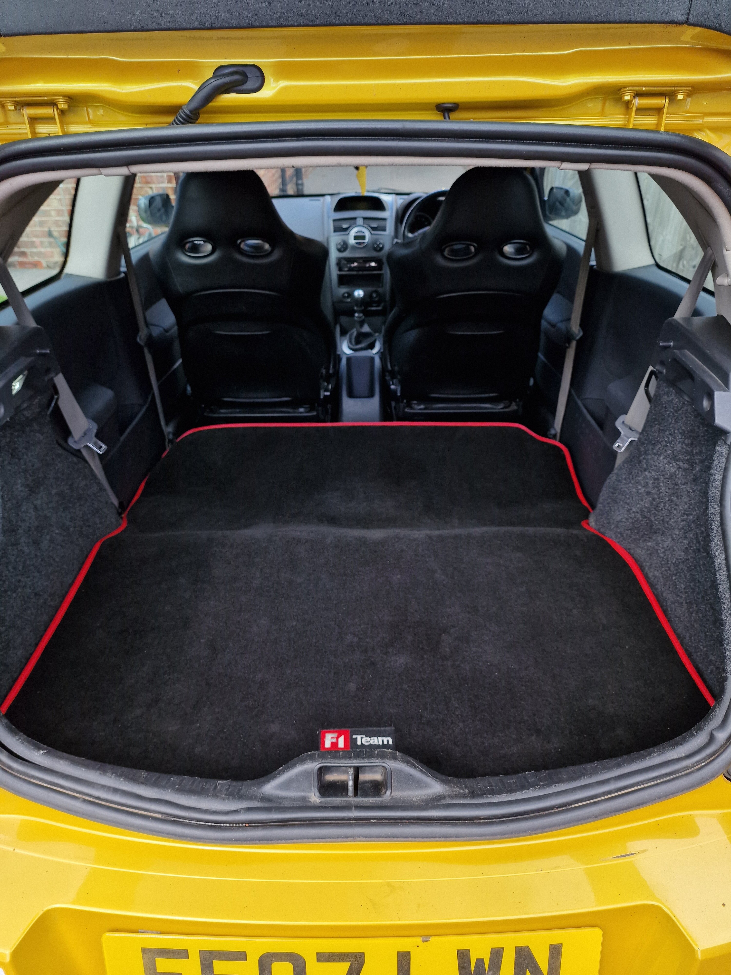

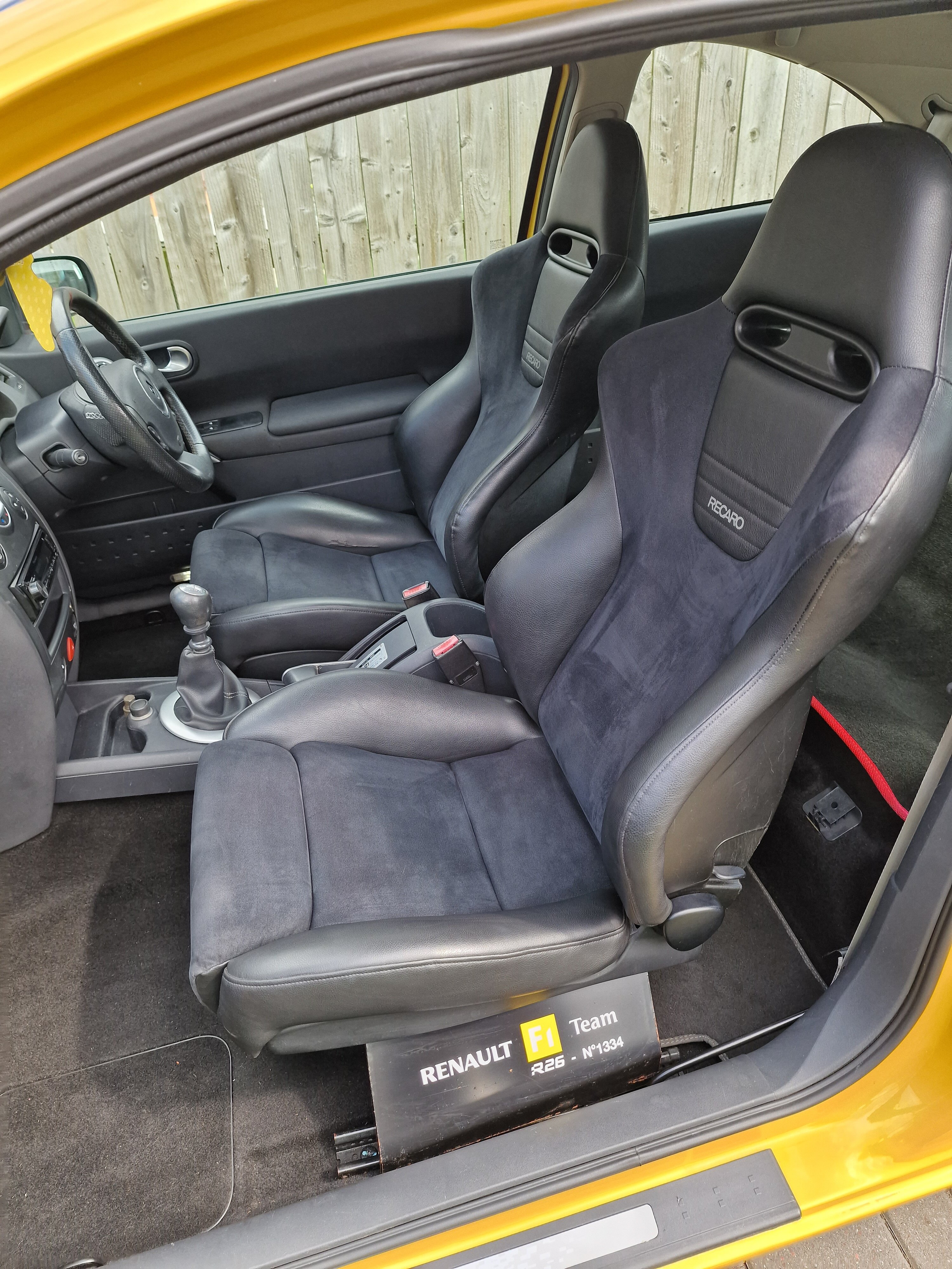

Cleaned 131ks worth of fart and grot off the recaros.
Before - shiney
After a mild soap mist and scrub with soft brush/wiped clean with microfibre. Not bad.
Took airfilter out for a look, knackered as it was rubbing on gear selector. Ive replaced it for a ramair i had off the Kangoo.View attachment 1657203View attachment 1657204

Battery tray clamp was knackered as they all are. Epoxy resined the fitting in View attachment 1657205
Xenon control box has seen better days.View attachment 1657206
Before - shineyView attachment 1657207
After a mild soap mist and scrub with soft brush/wiped clean with microfibre. Not bad.View attachment 1657208

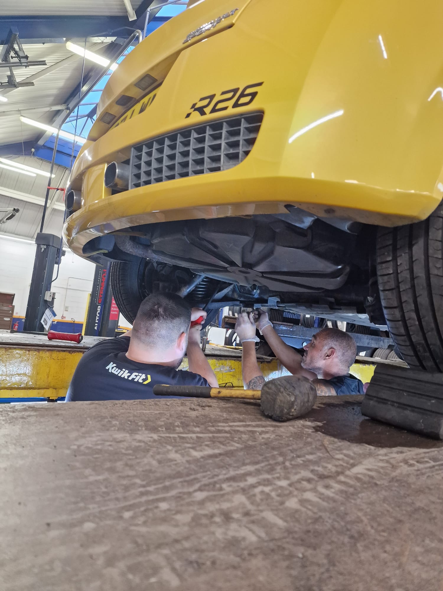

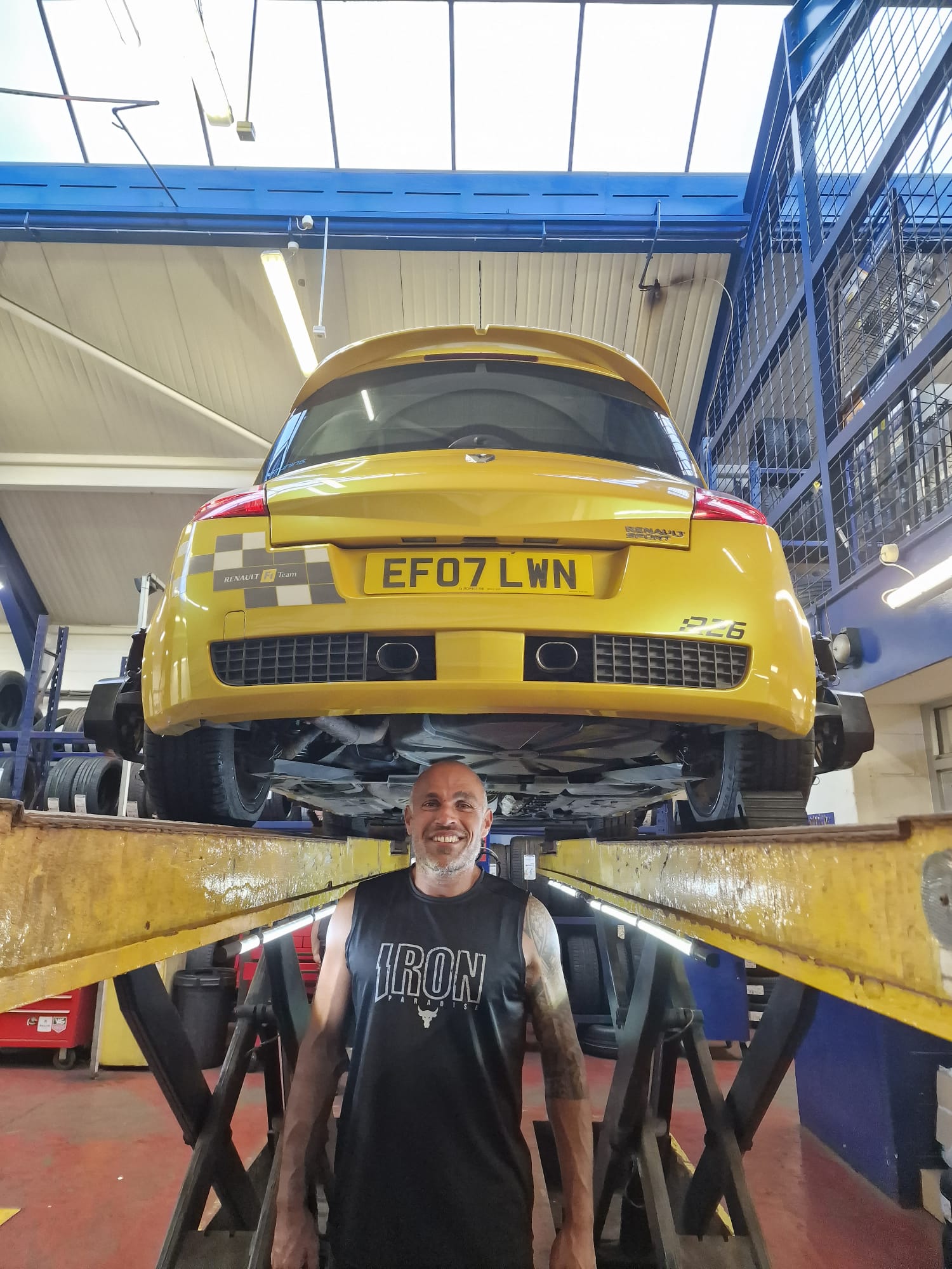

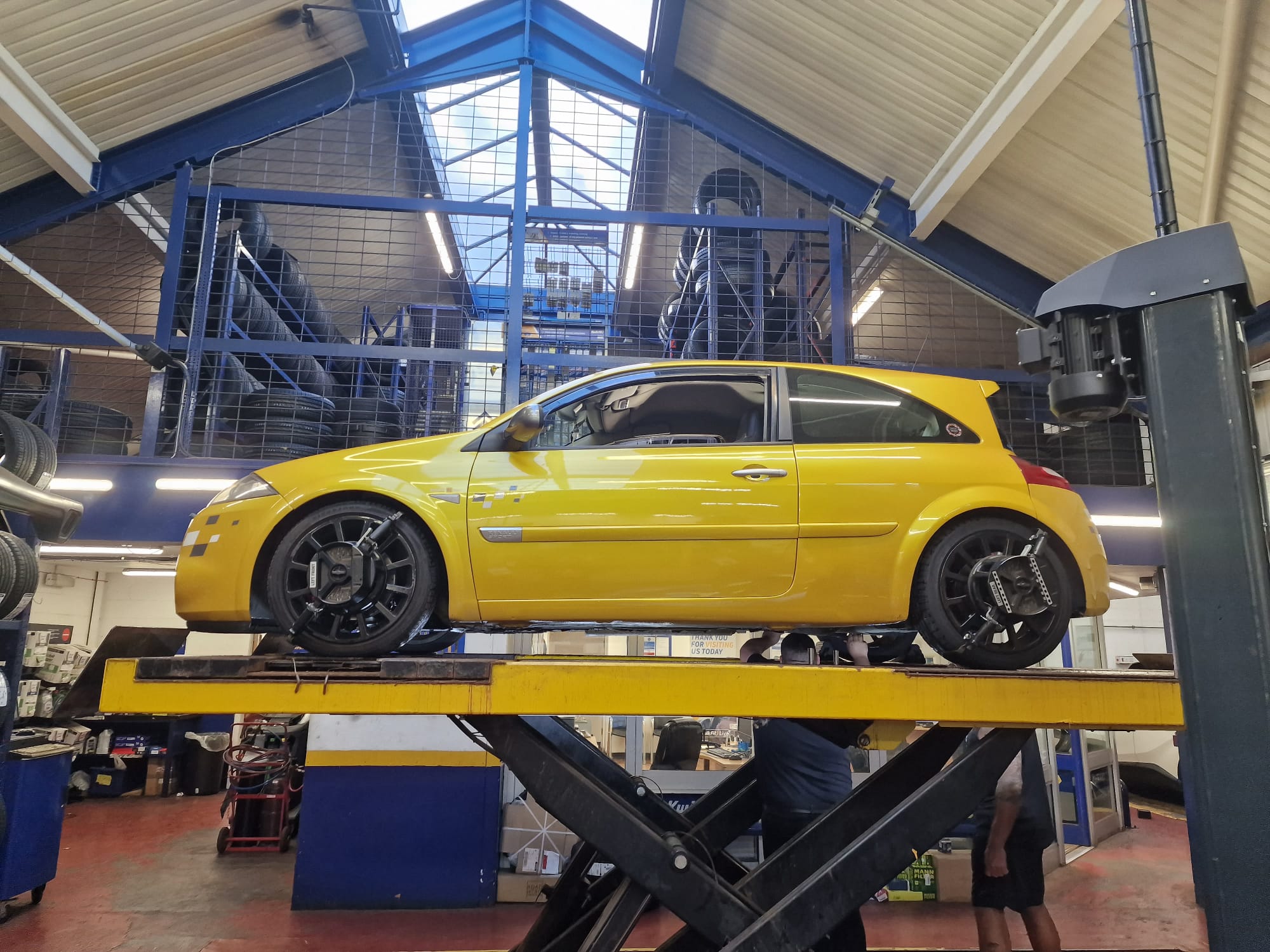

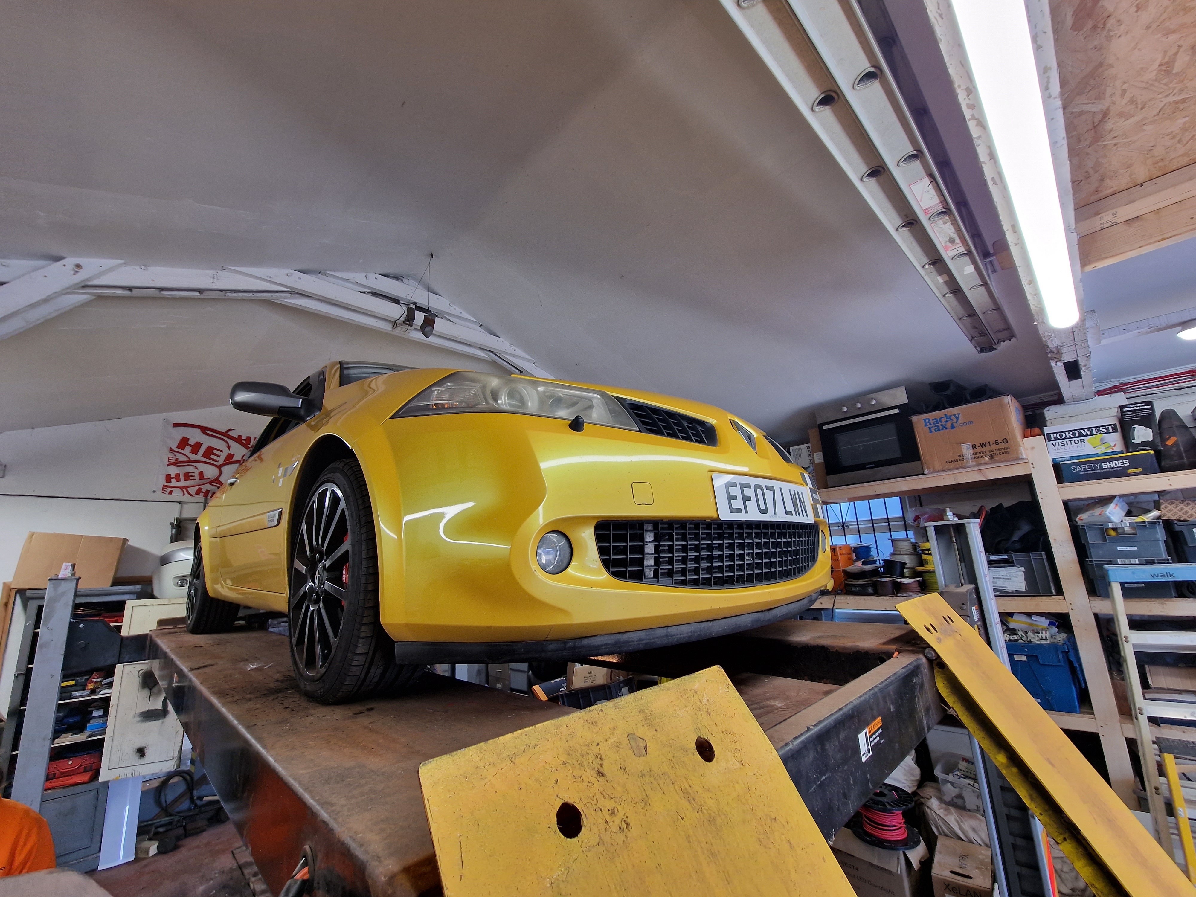

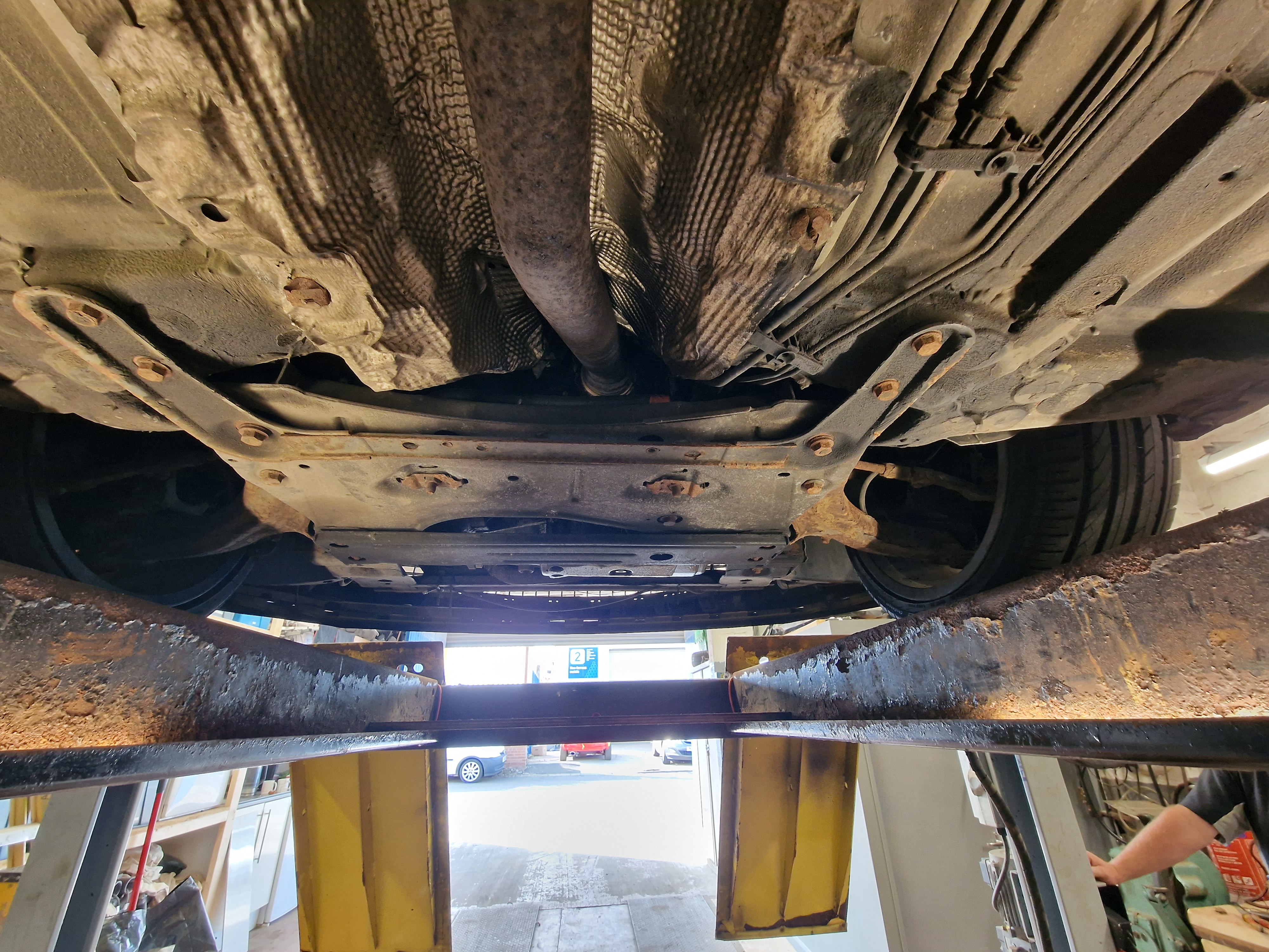

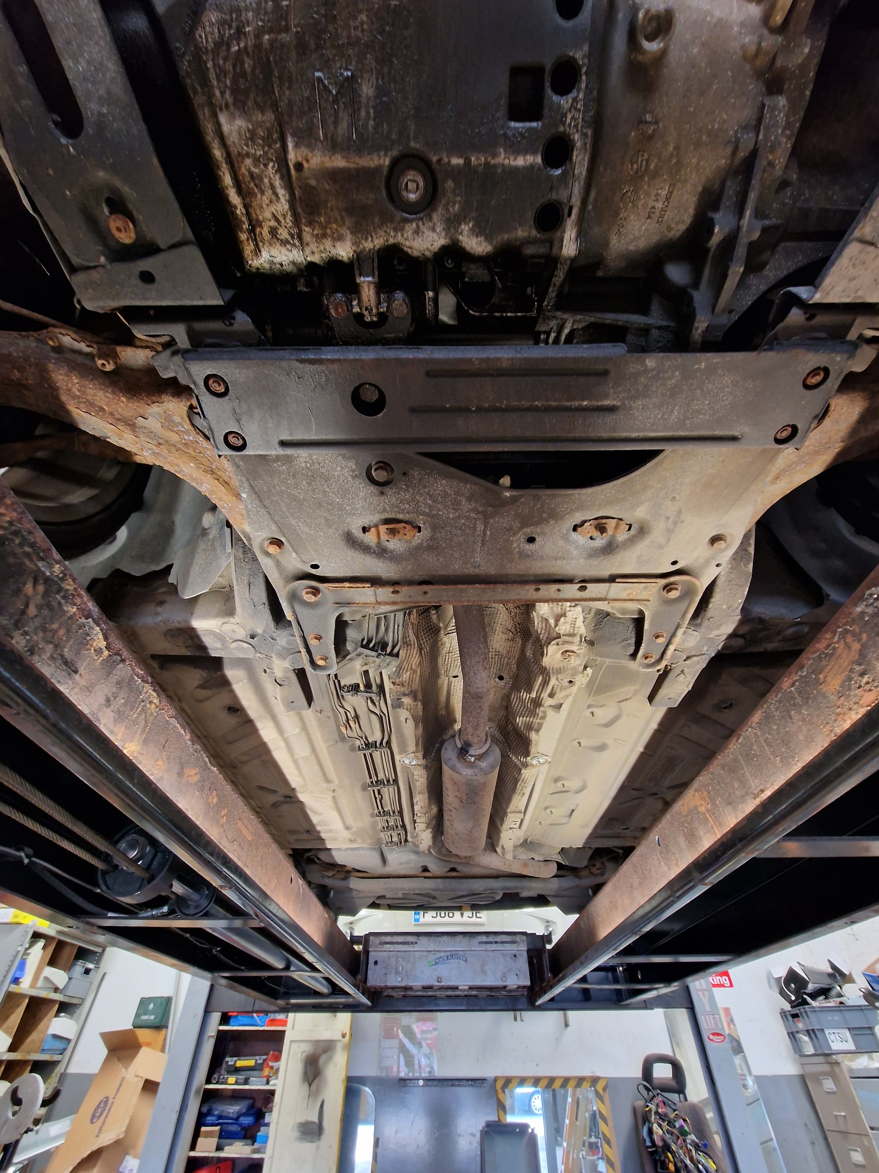

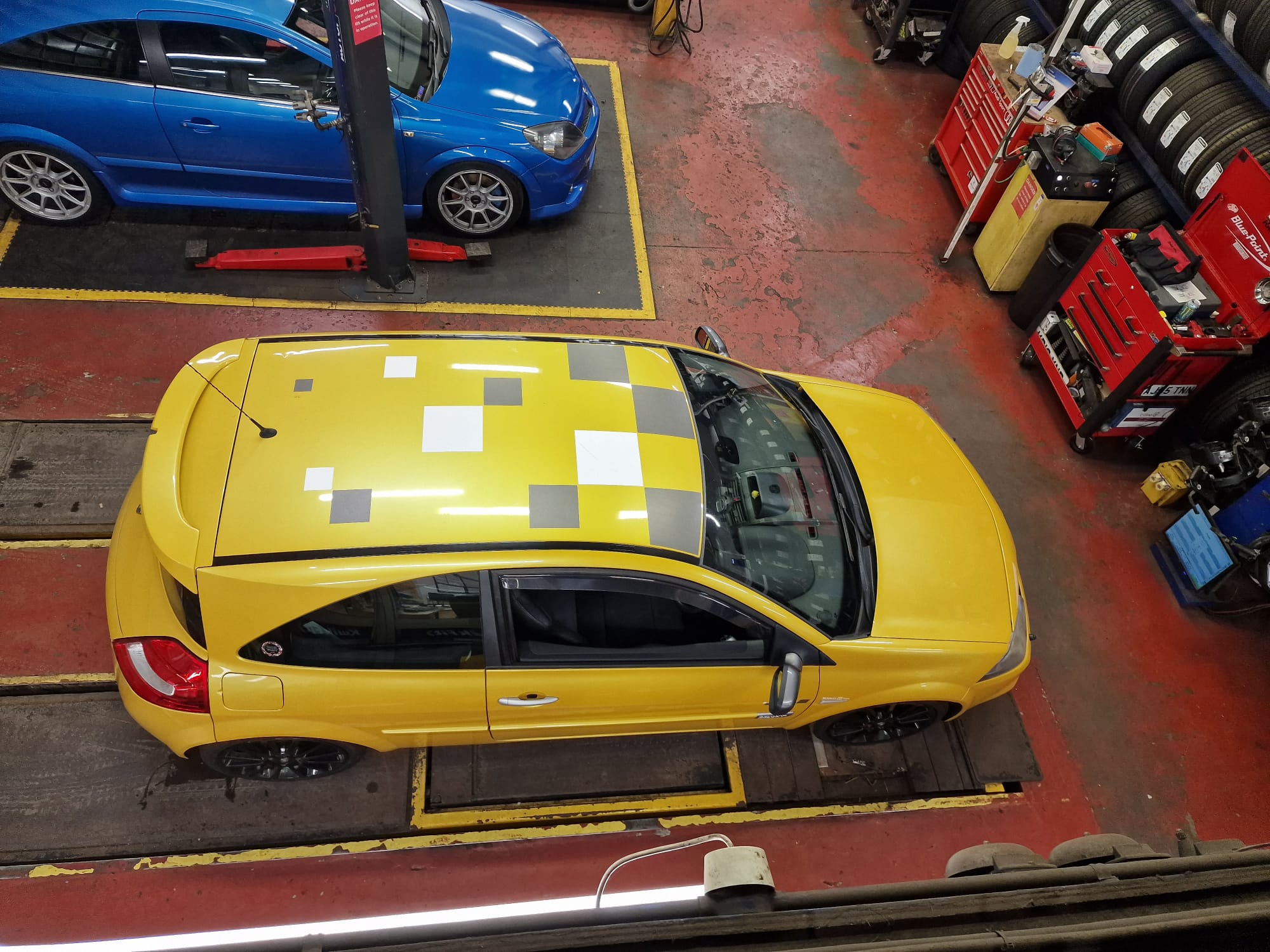

On way home i took it to my mates to get it on the 4 poster for a good look to see the damage. Id had a quick look underneath but its good to get it up in the air.
Floor looks good.

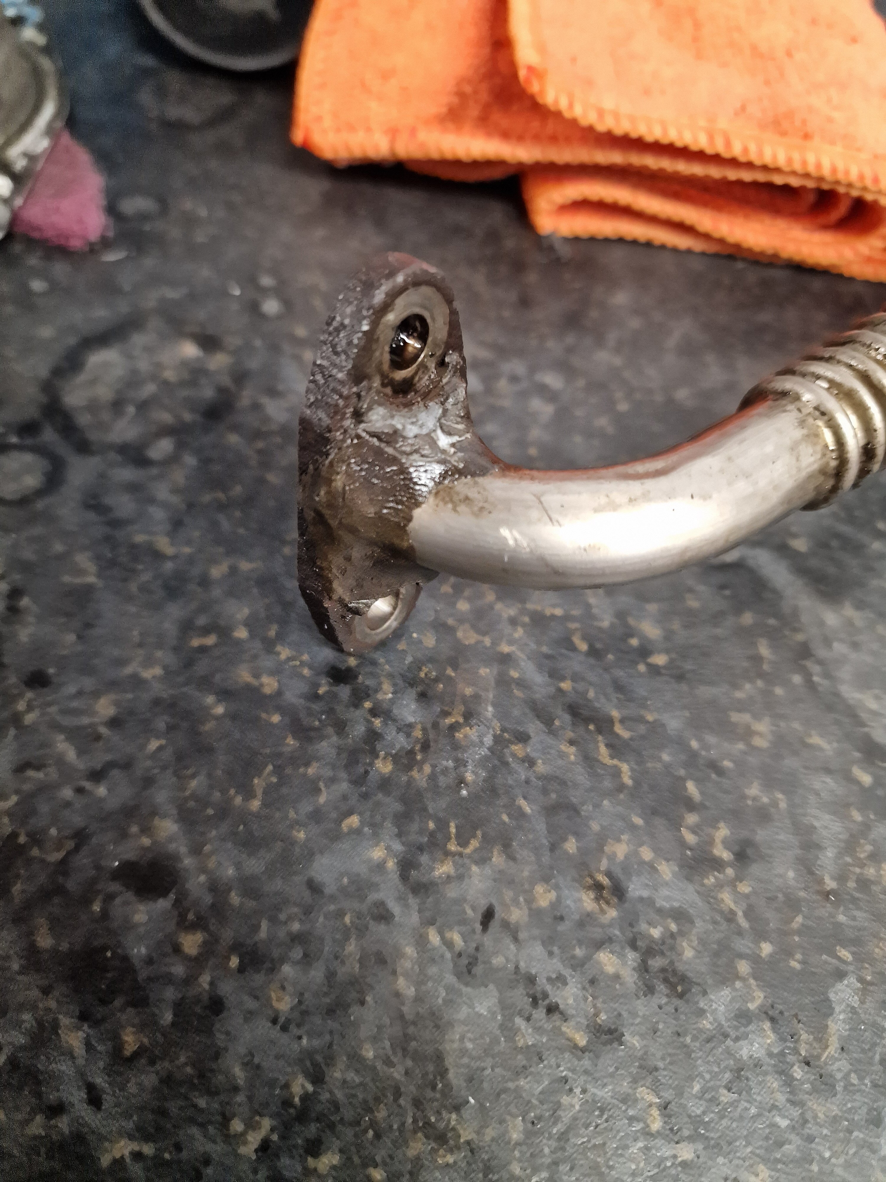

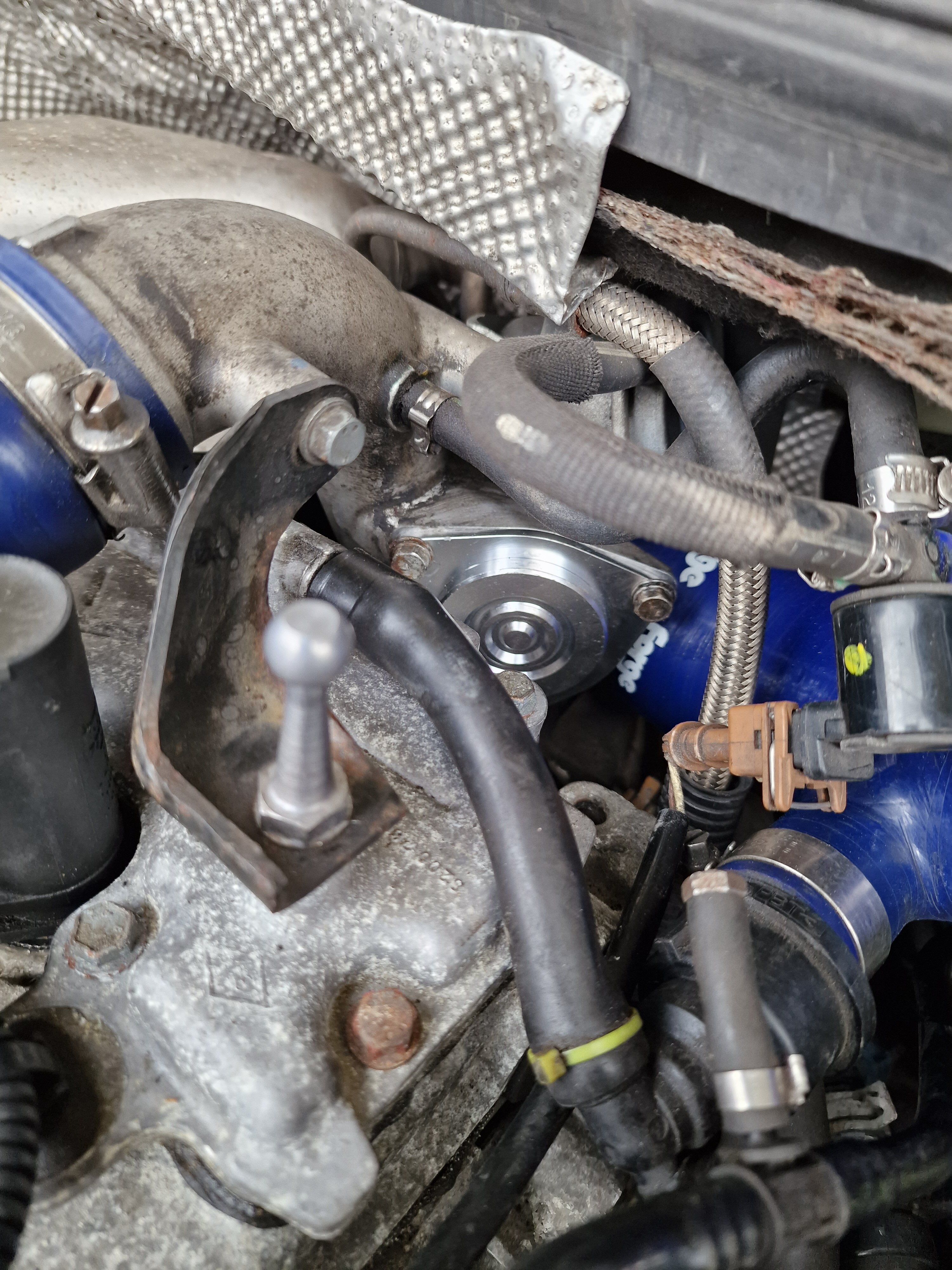

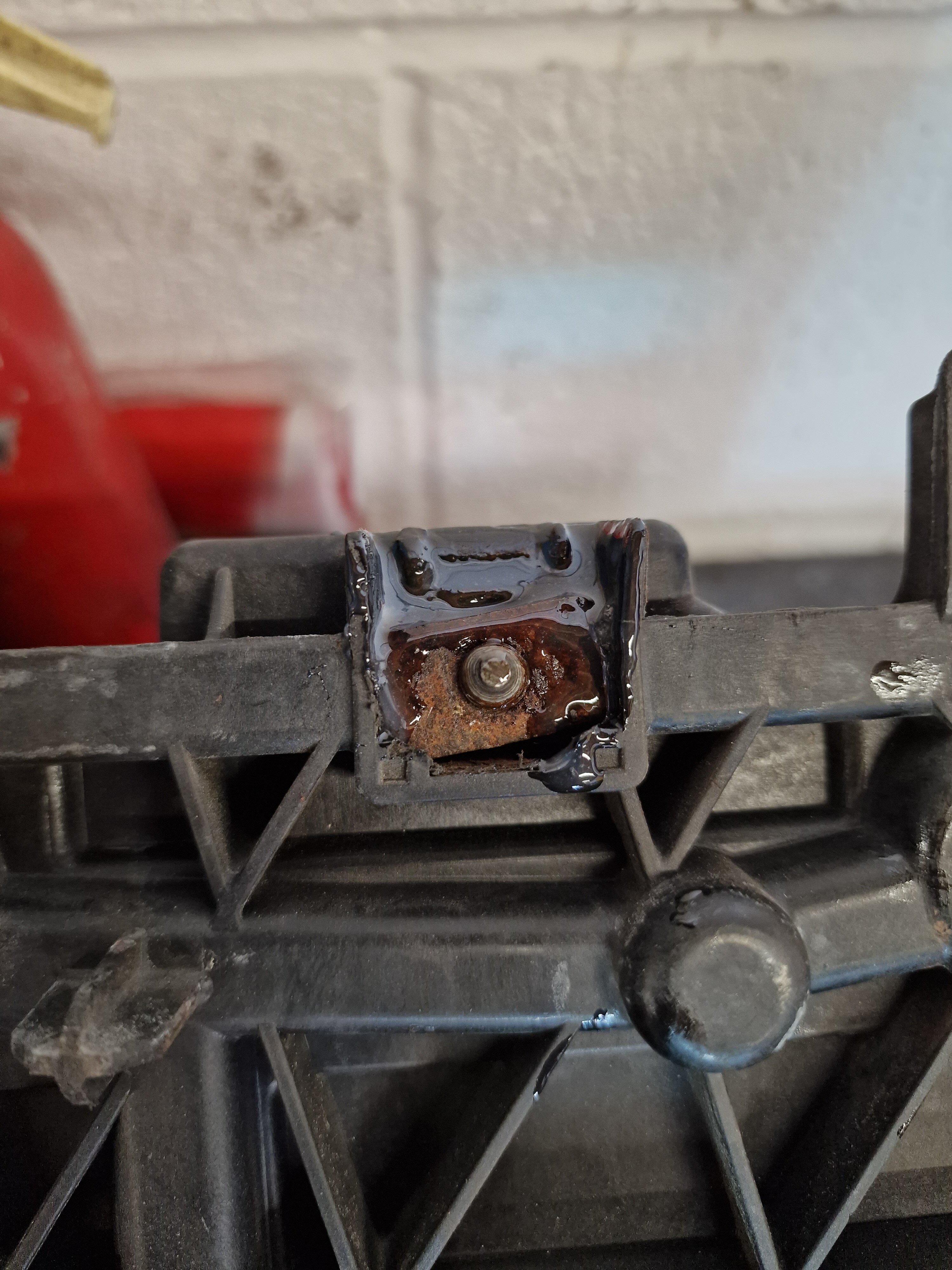

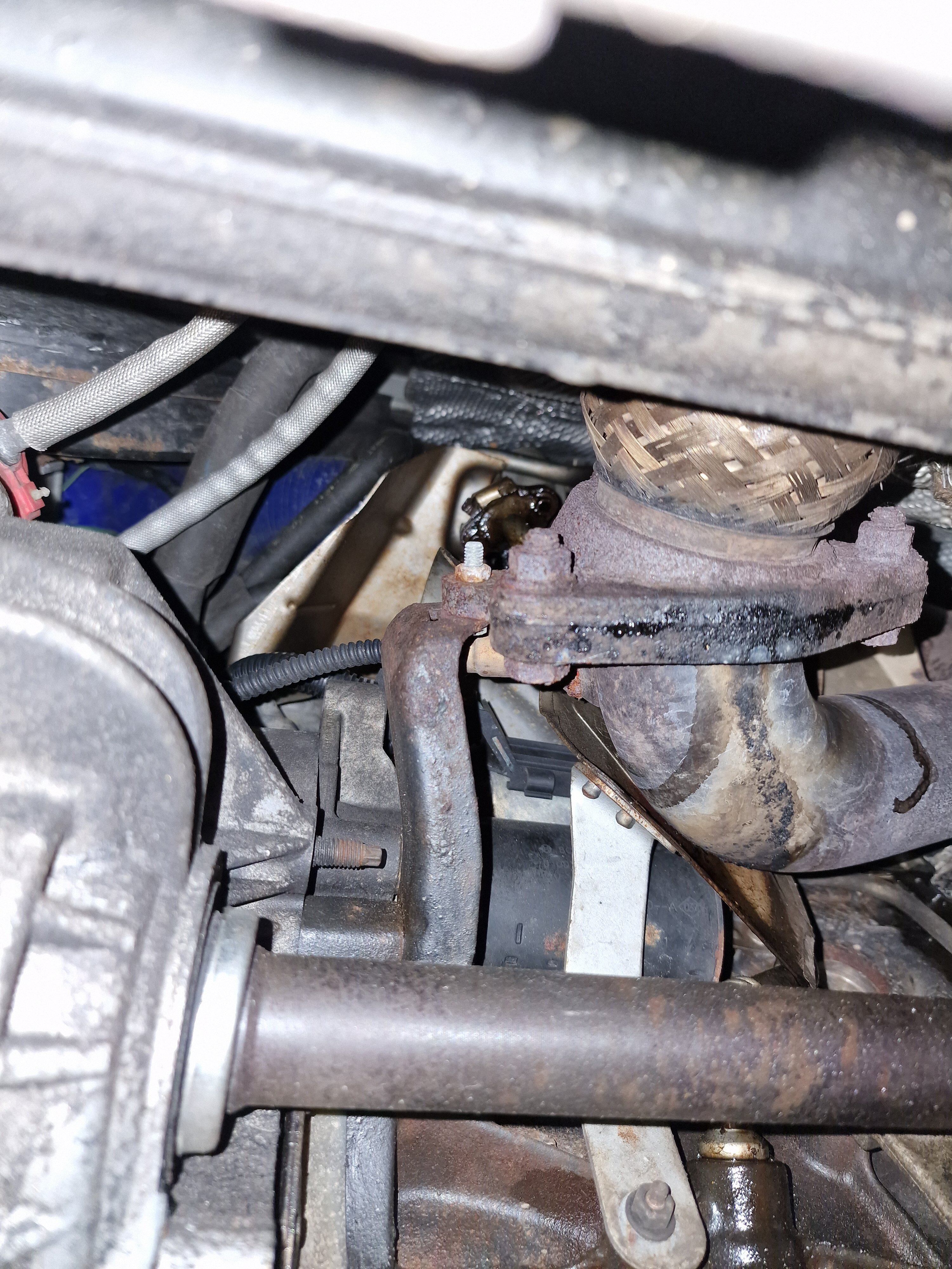

Turbo oil return is leaking/looks like its been bodged with chemi metal. Whiffs of oil.

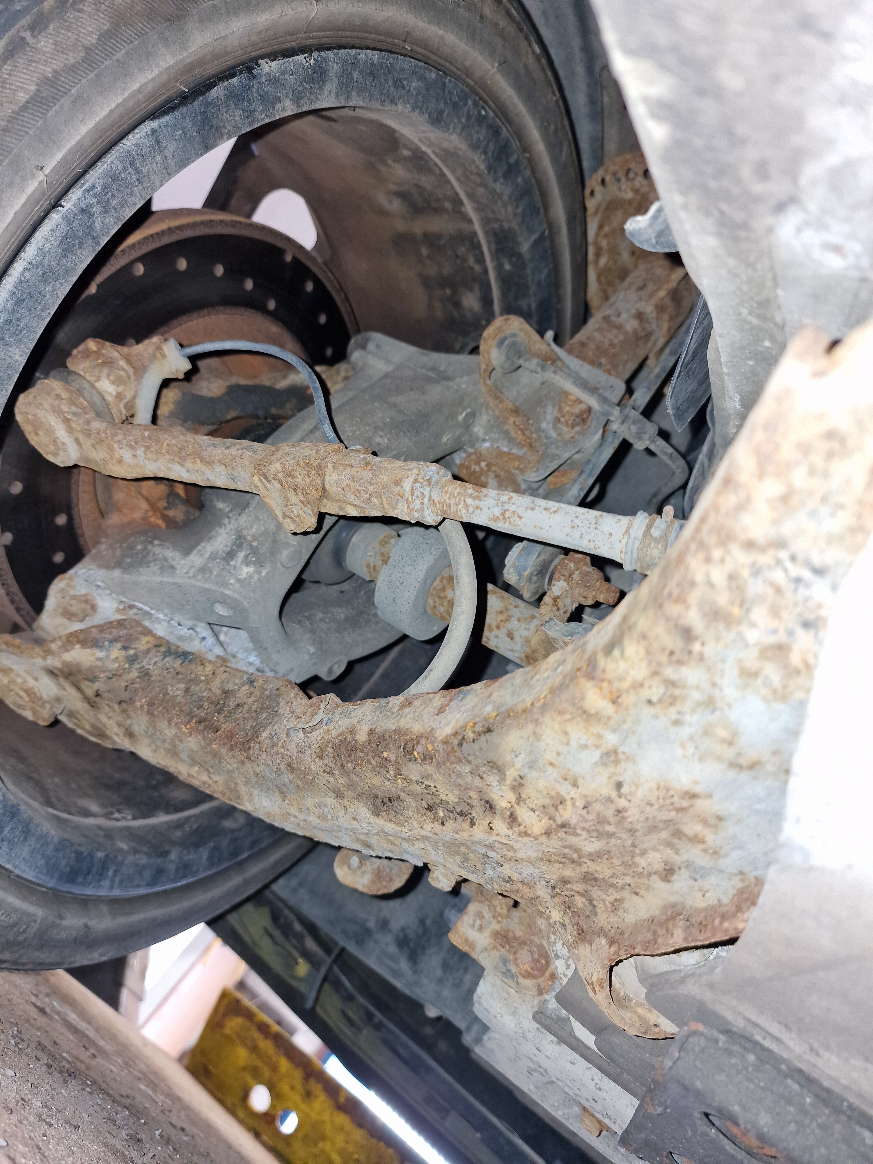

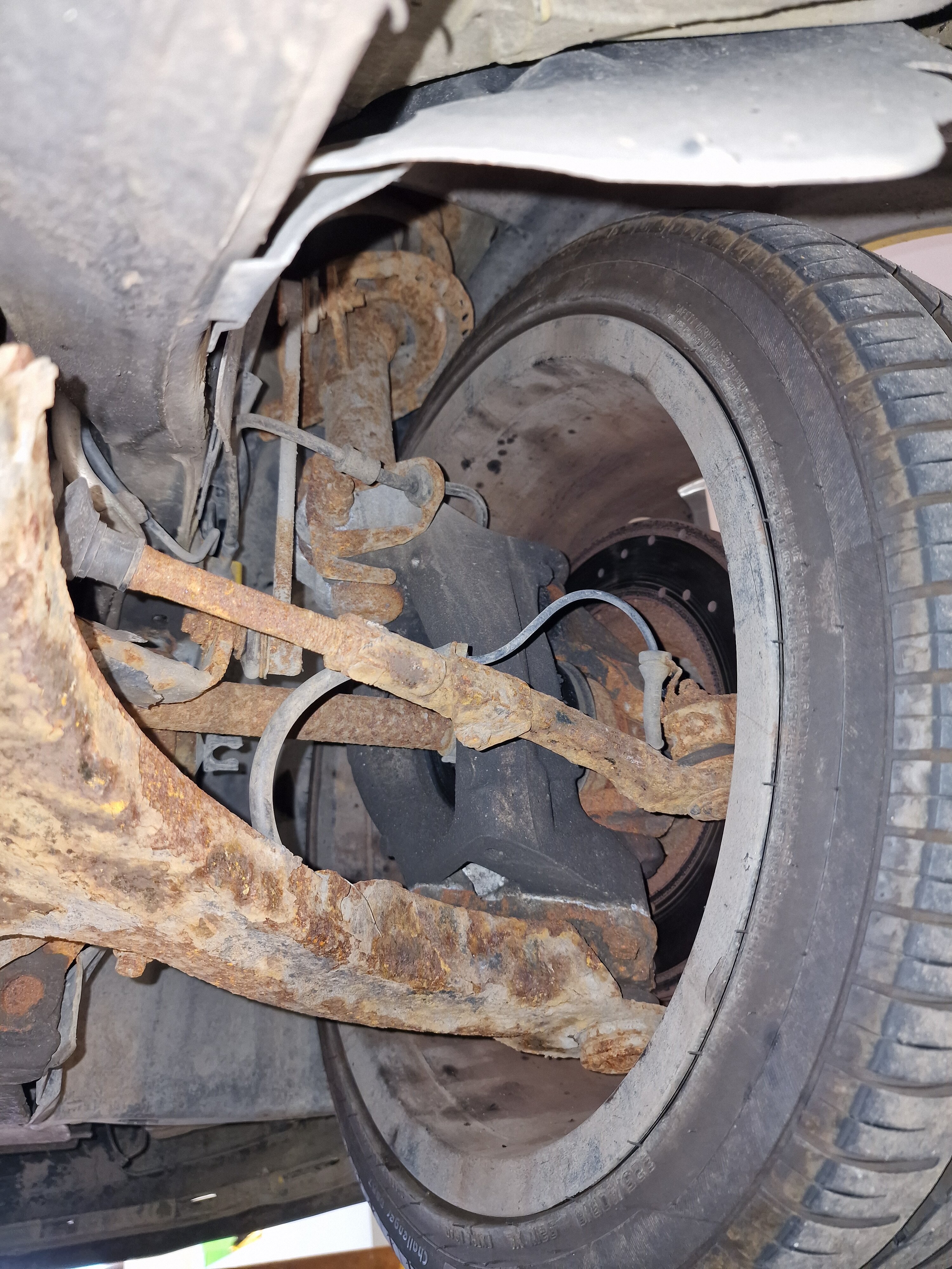

Suspension looks like its been in the sea. Apparantly this has had new shocks on it a few years ago, i dont believe a word of that. Look like original to me
I plan on replacing all of it so thats a non issue, its all shagged.

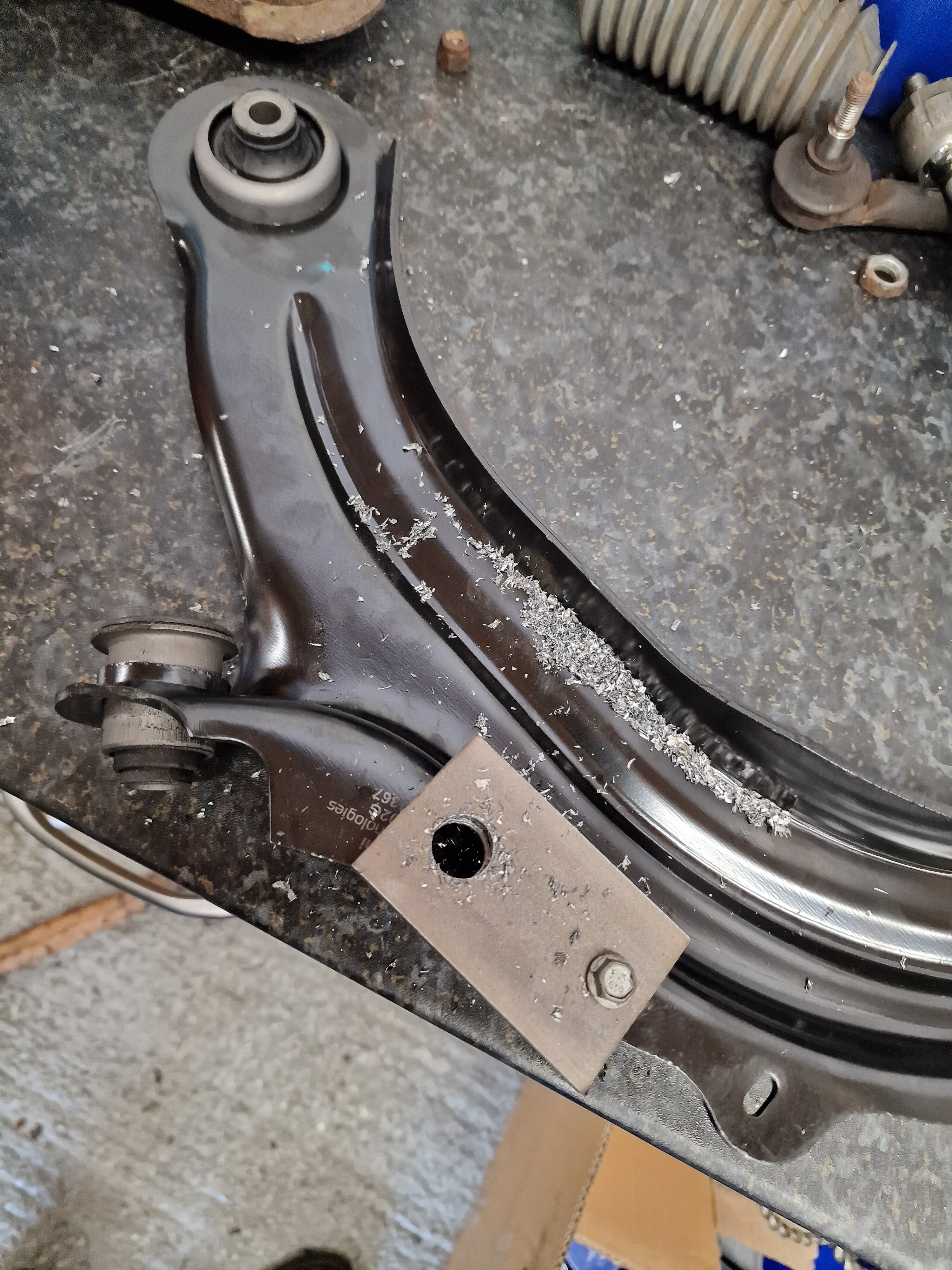

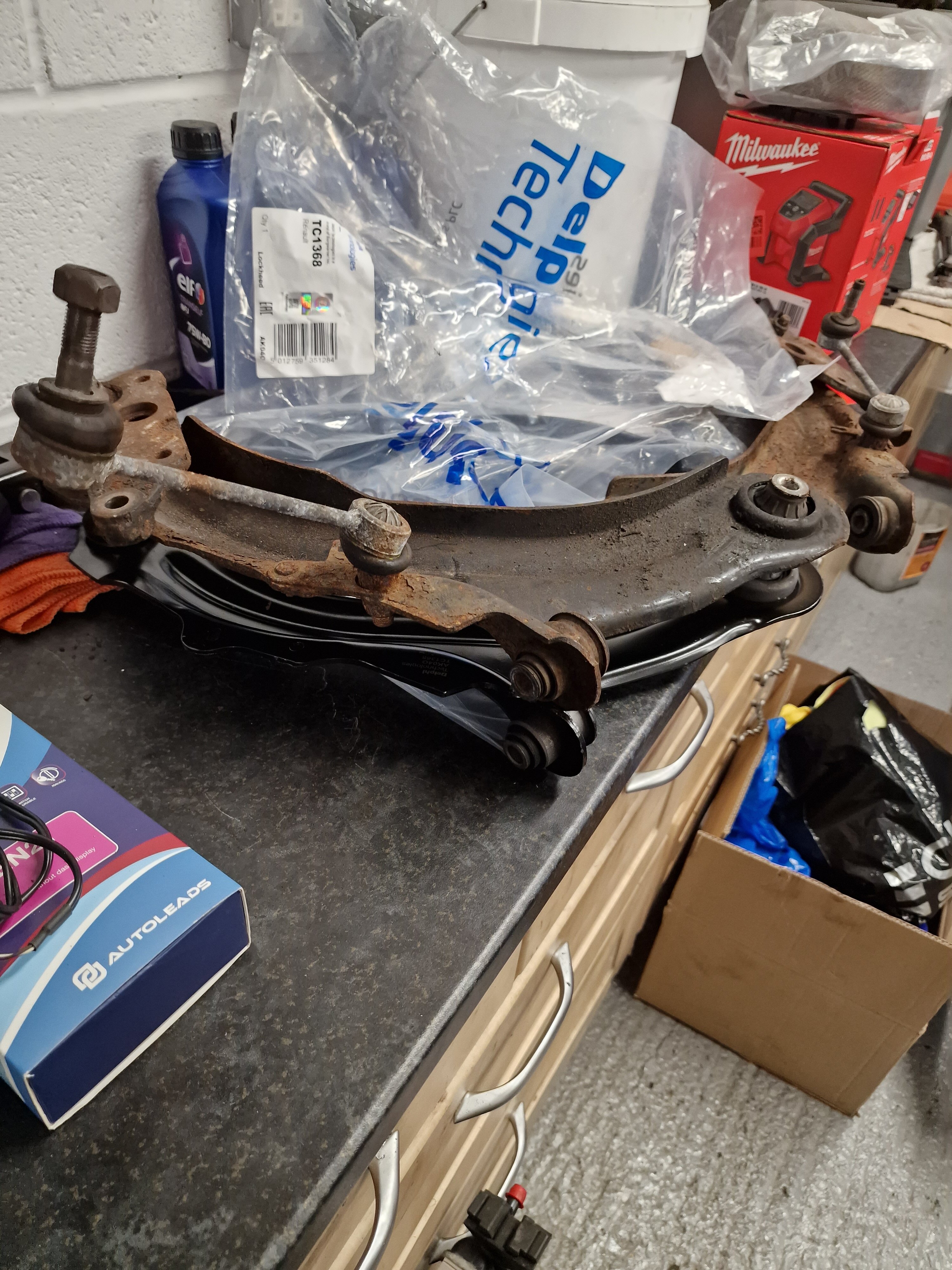

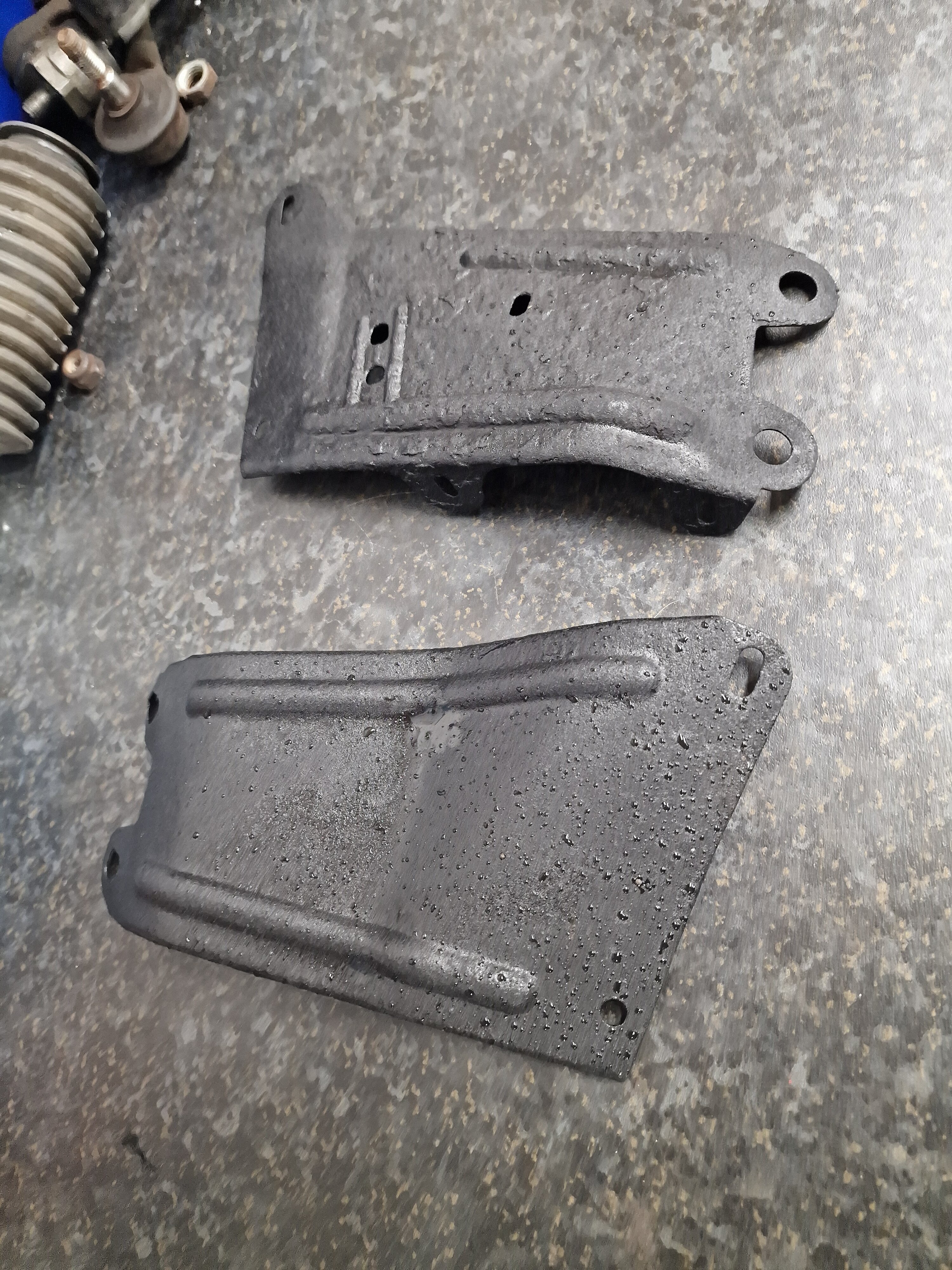

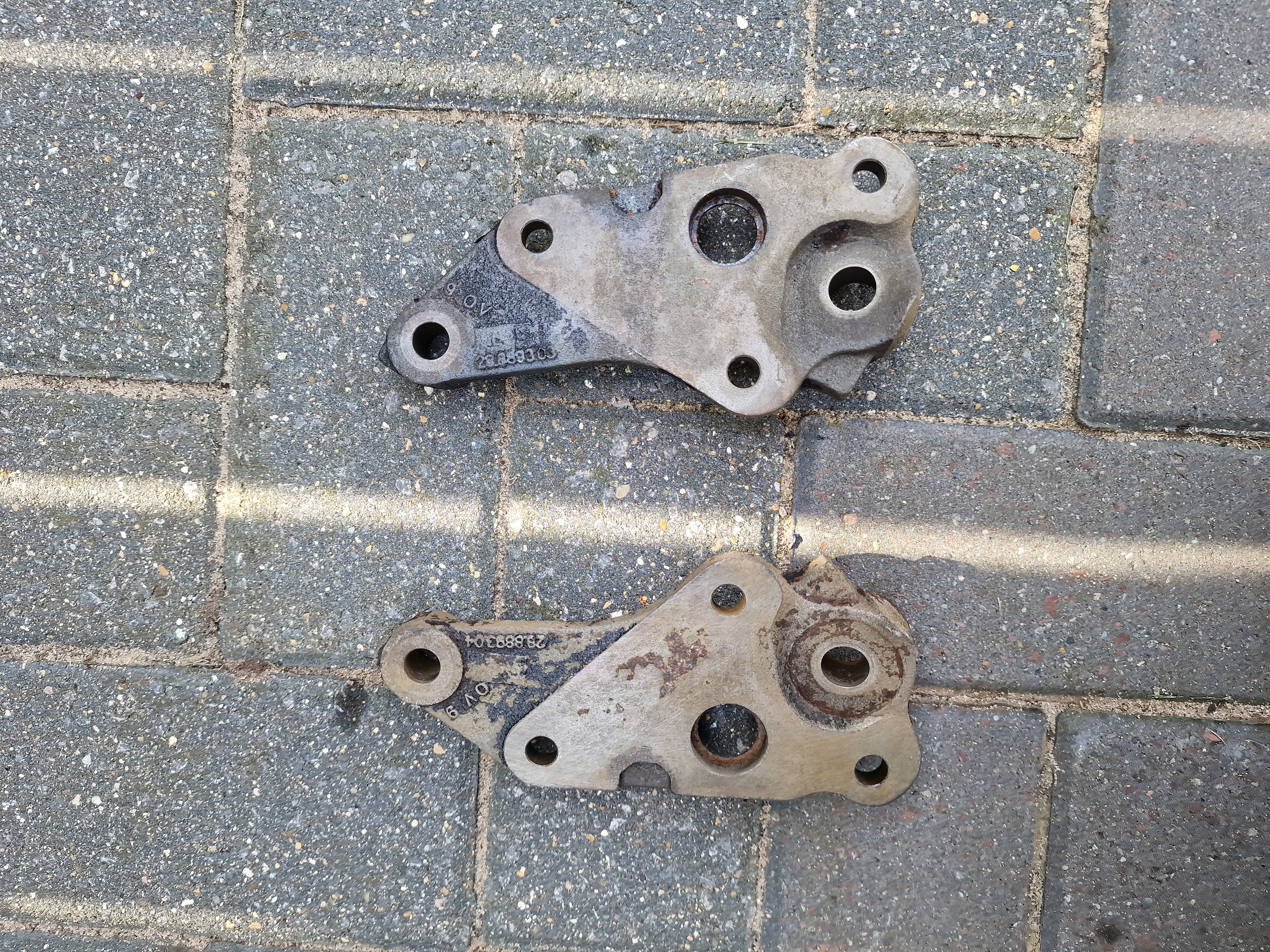

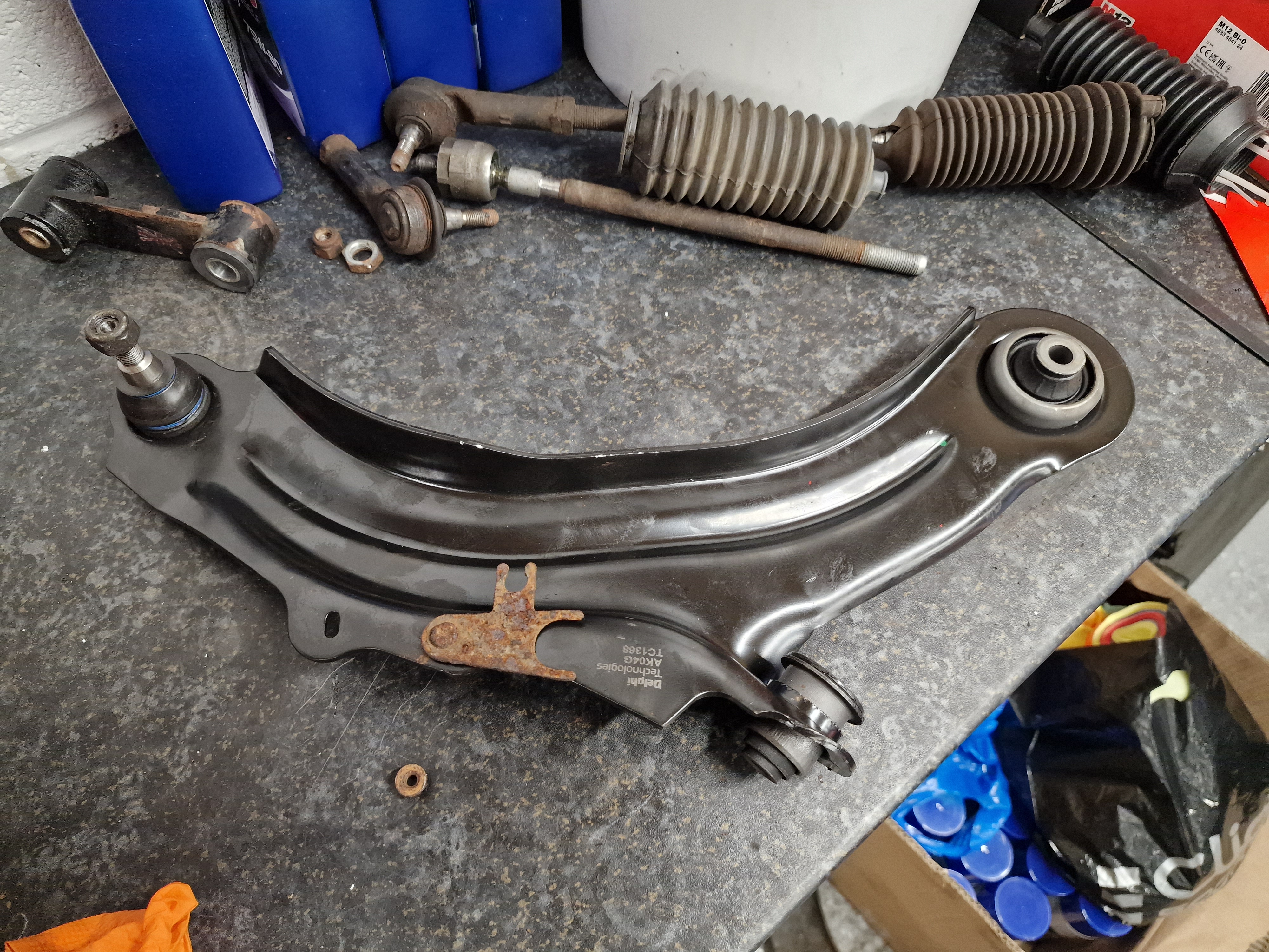

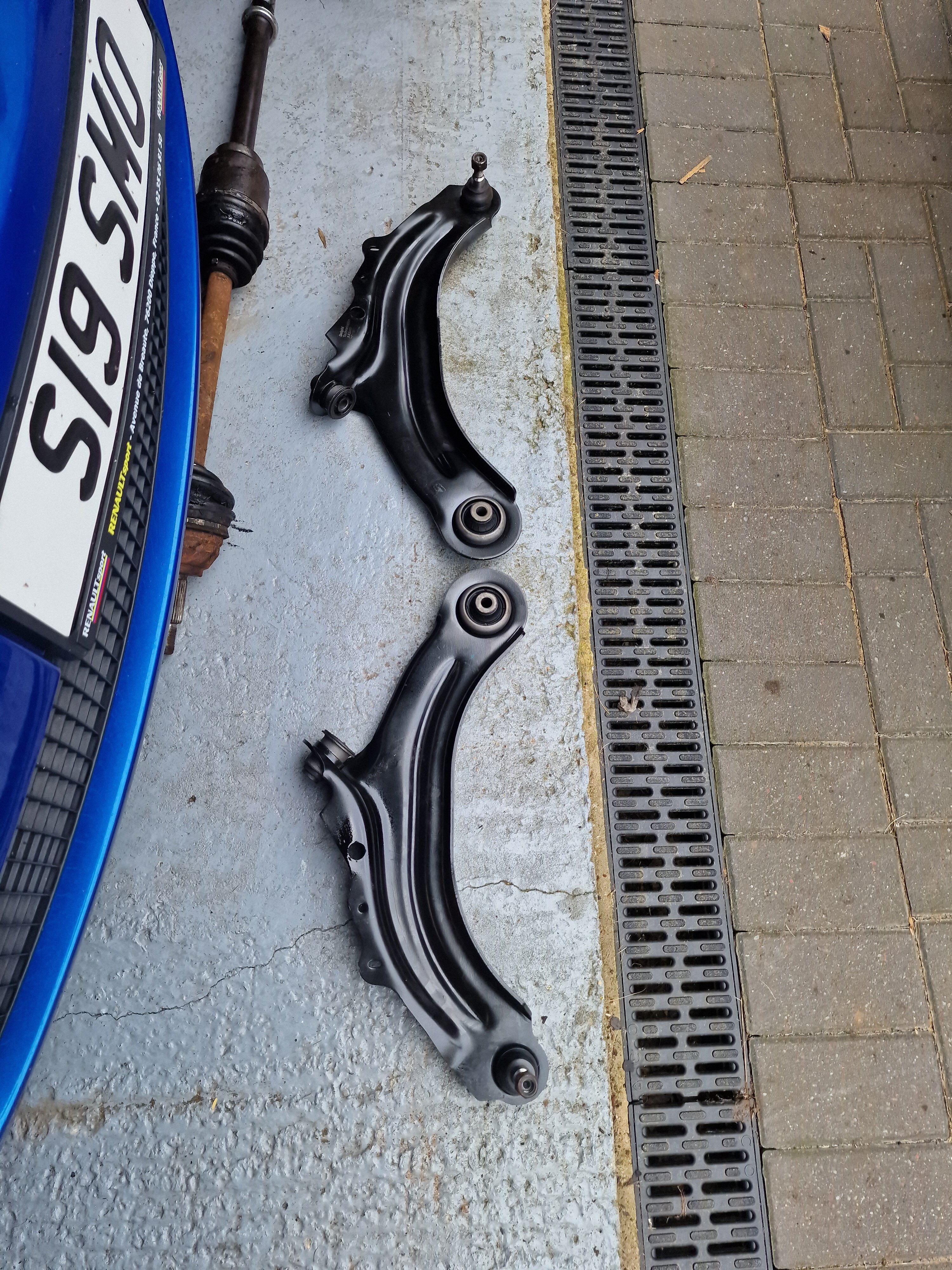

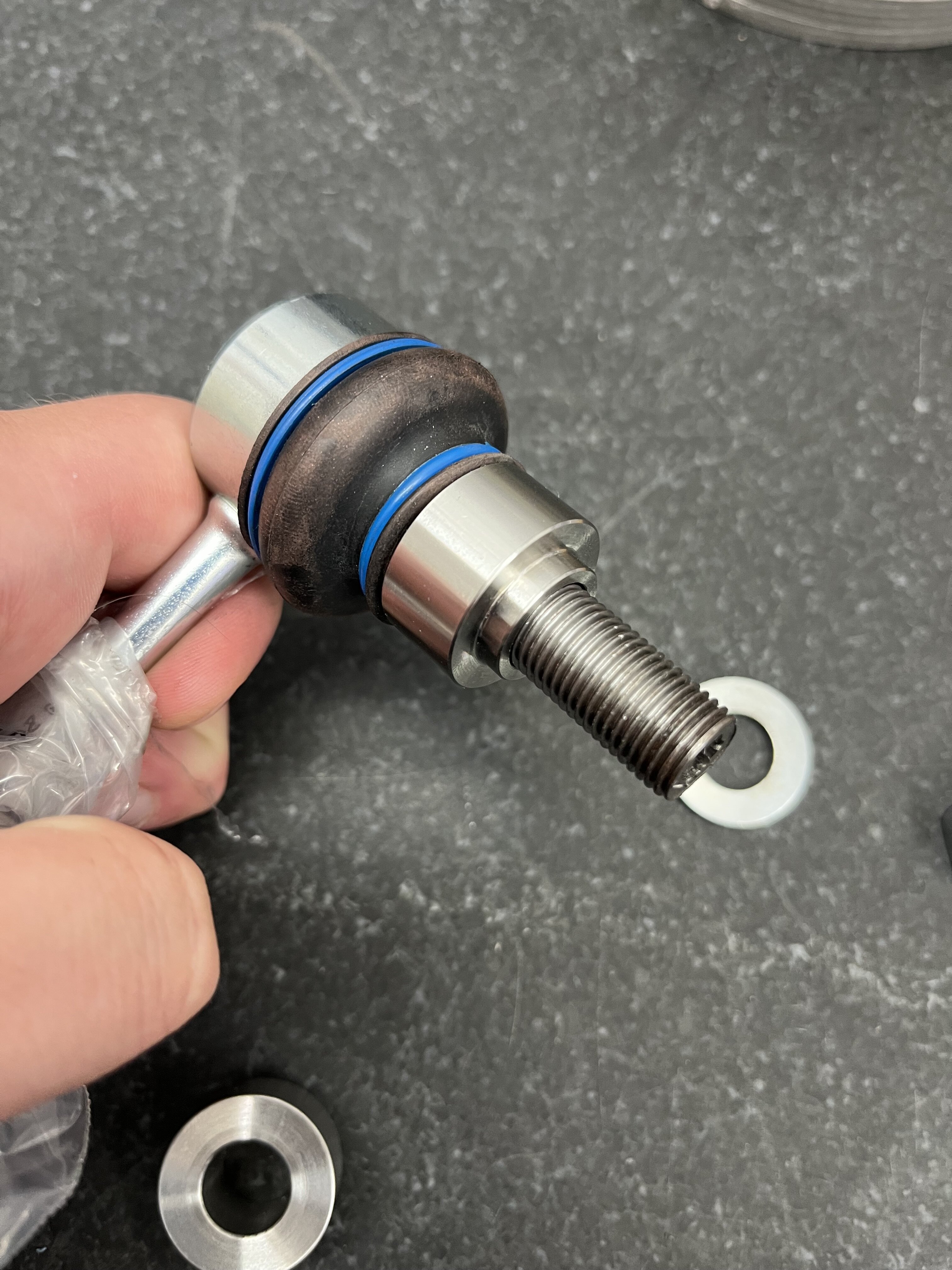

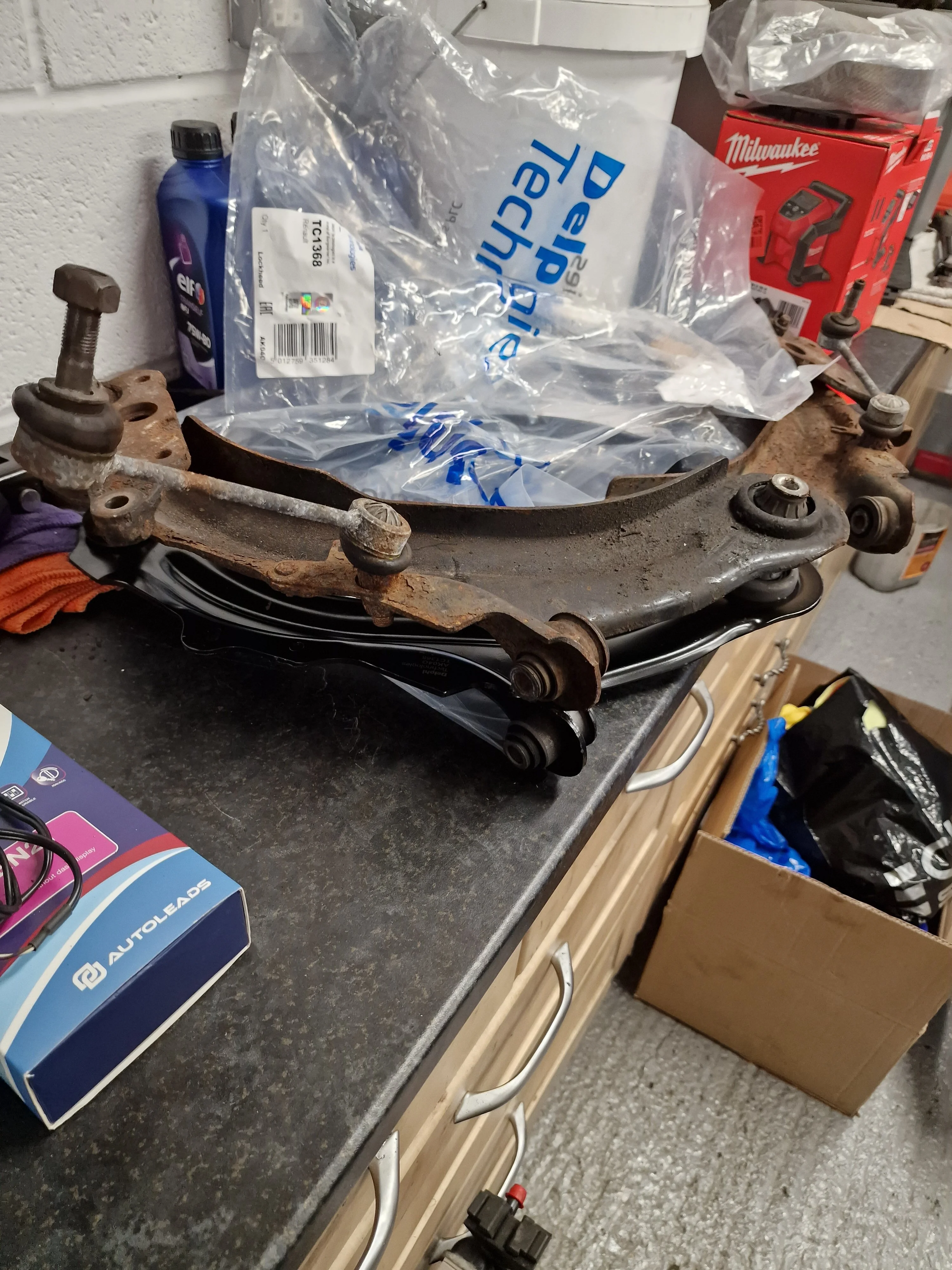

Meg2 RS lower arms are NLA..there is some expensive remanufactured arms on ebay £300 a set.
I had my suspicions these were modified lower spec as the pressing looks identical to rs apart from no hole for the anti rotation link.

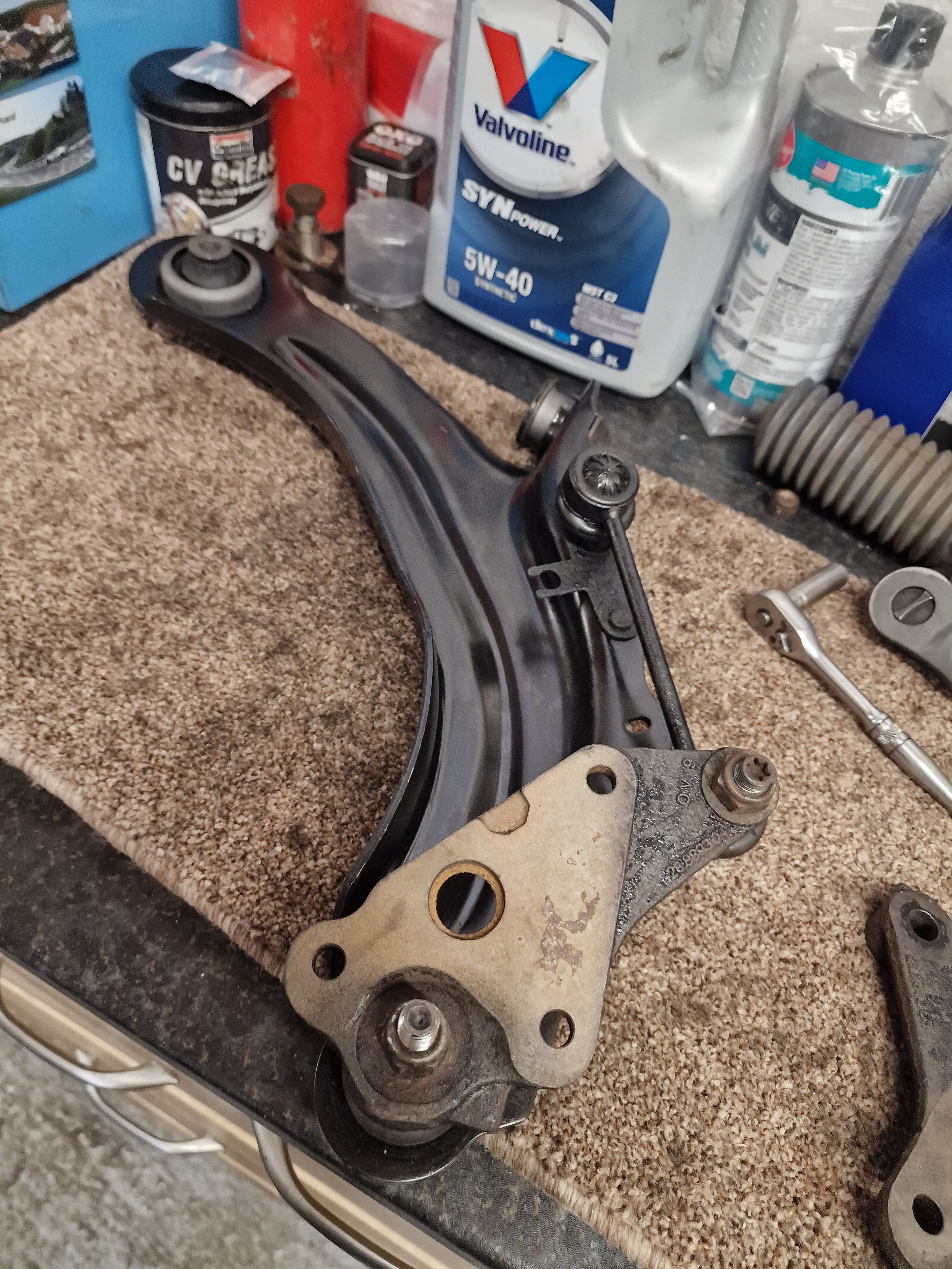

I bought a pair of quality Delphi lower arms for 2.0 meg2 on a whim £28 a side to compare.
Yep identical apart from incorrect balljoint/no anti rotation link hole
Pressed the incorrect balljoint out and pressed in a Delphi espace 2.0 balljoint which is identical to oem.
Yep that will go and miles better than refurbing rusty as feck oem arms.

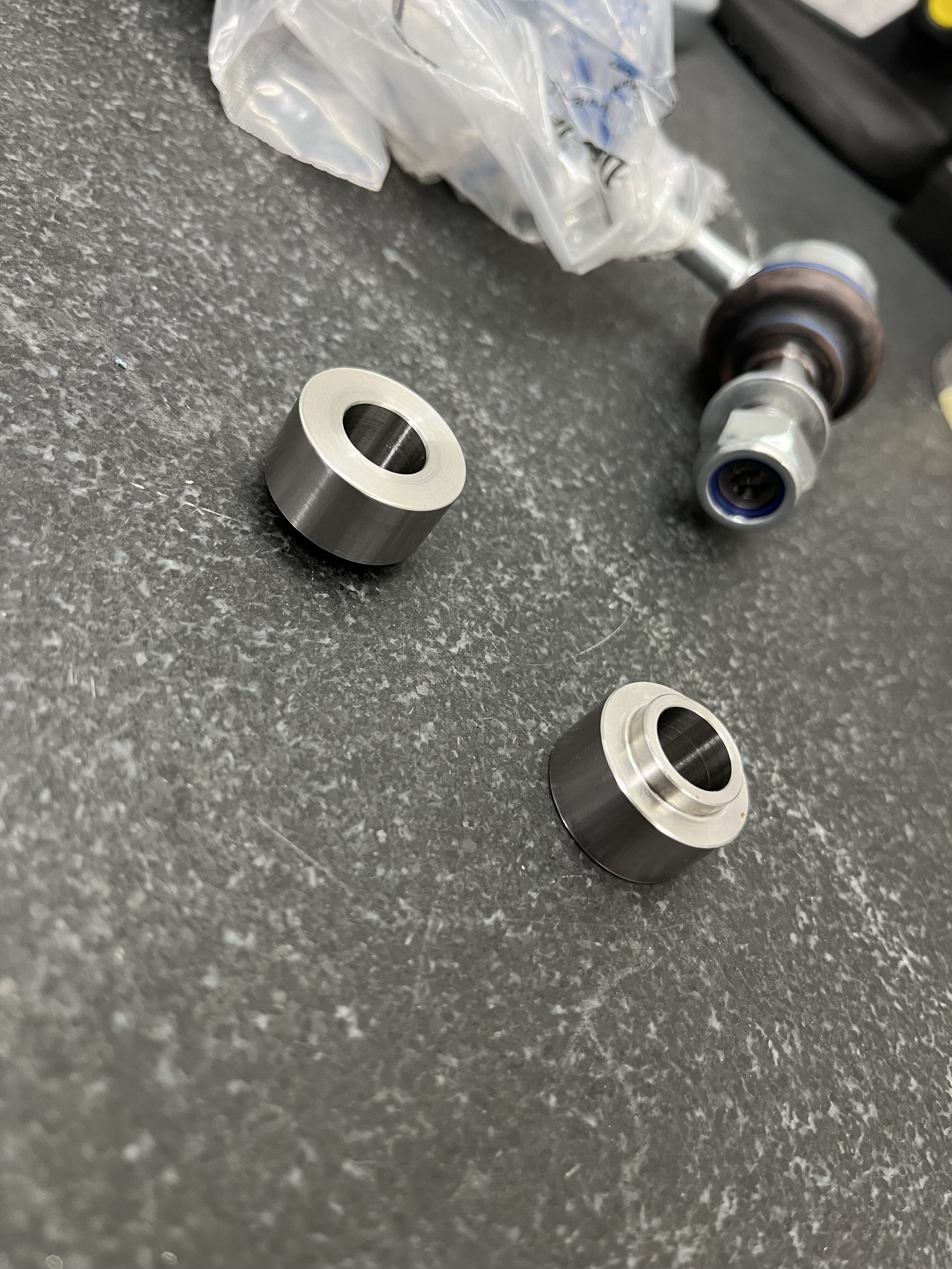

Just need to make a jig to drill the anti rotation link hole.
Thanks for reading!!

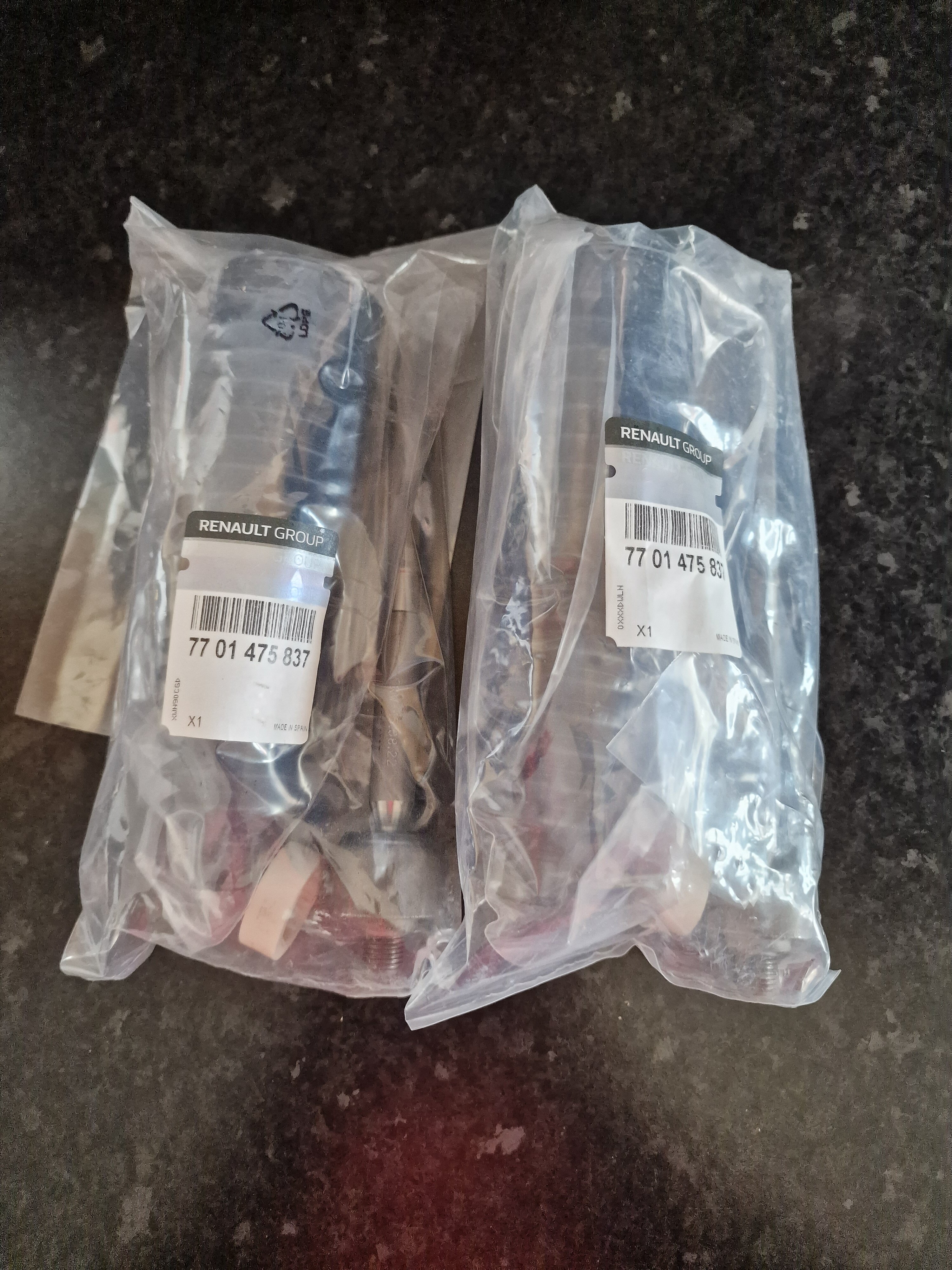

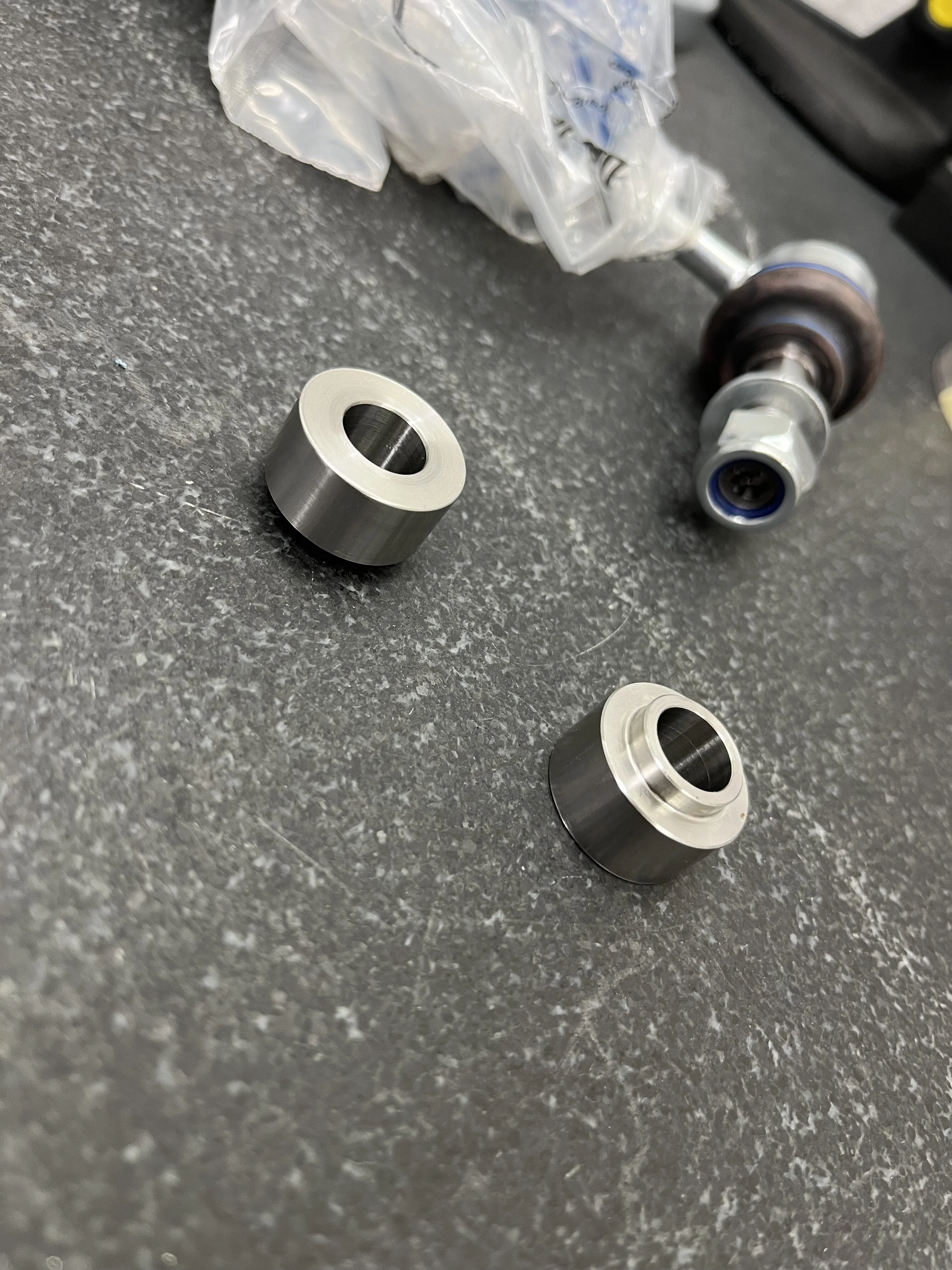

If you need some anti rotation spacers that usually come pressed in the lower arms then give me a shout mate and I’ll sort you some out.
Also didn’t know lower arms aren’t made anymore. Mine don’t look bad but need a refresh so might get them off over winter and get them cleaned and powder coated
Cheers mate i will absolutely take a pair of them if thats ok. Everything on this looks like its been in the sea!
As far as im aware lower arms for 225/26 are nla and have been for a while. Not a problem with pov spec arms available and easily modded.

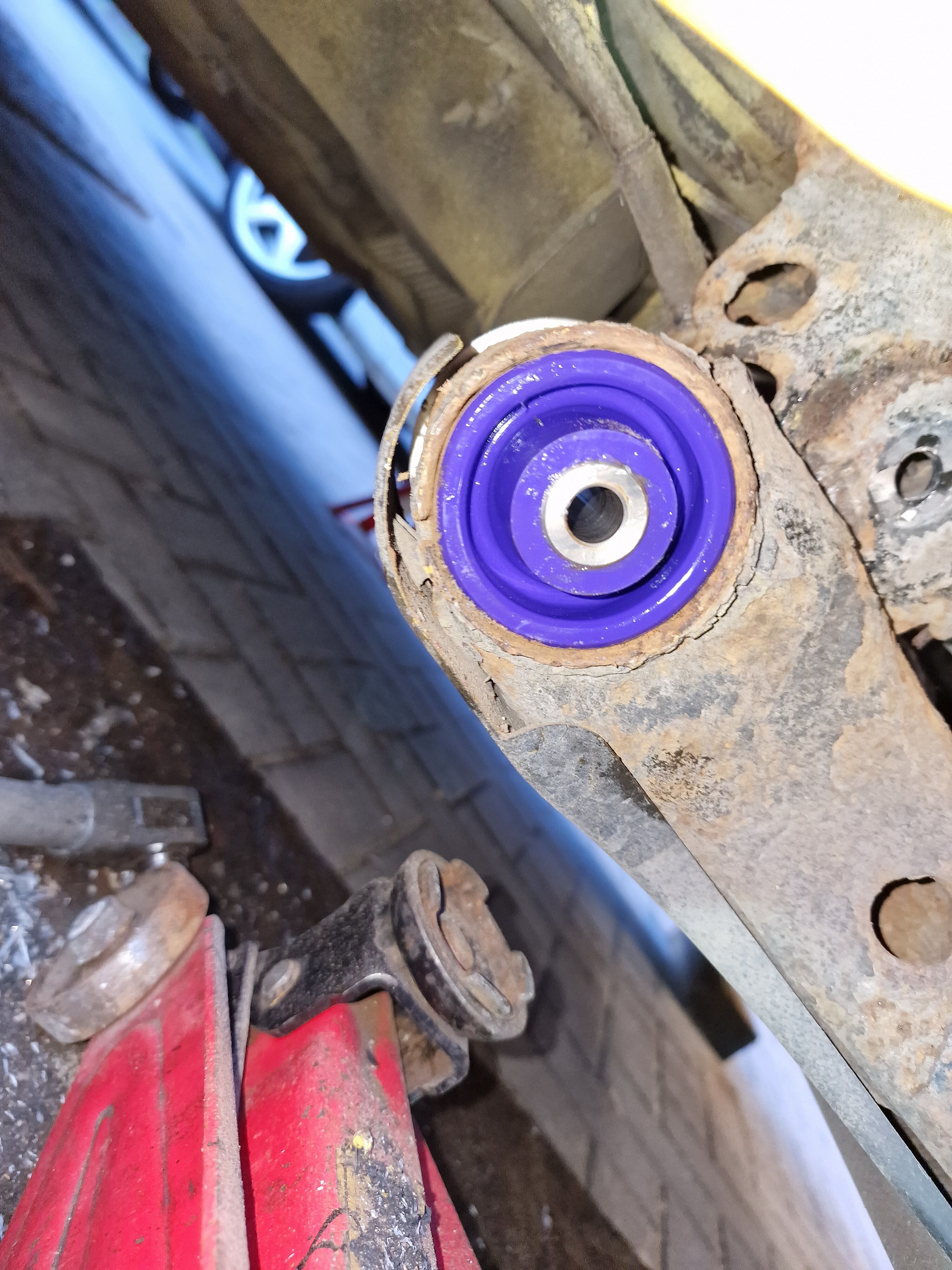

Recommend the vibratechnics rear arm bushes if your refurbing. They are great, run them on the kangoo with powerflex black fronts.
They are made from 316 stainless so have very good corrosive properties. I’ll get some knocked up for you next week and get them out to you.
I’ve just picked up an R26 box with LSD as mines just a boggo 225 for little money so that’s the next thing to get in but over the winter I’ll give the front a refresh after adding the ASTs to the mix which have been brilliant. The front end doesn’t feel bad at all but more peace of mind.
Cheers mate appreciated, stainless will be spot on.

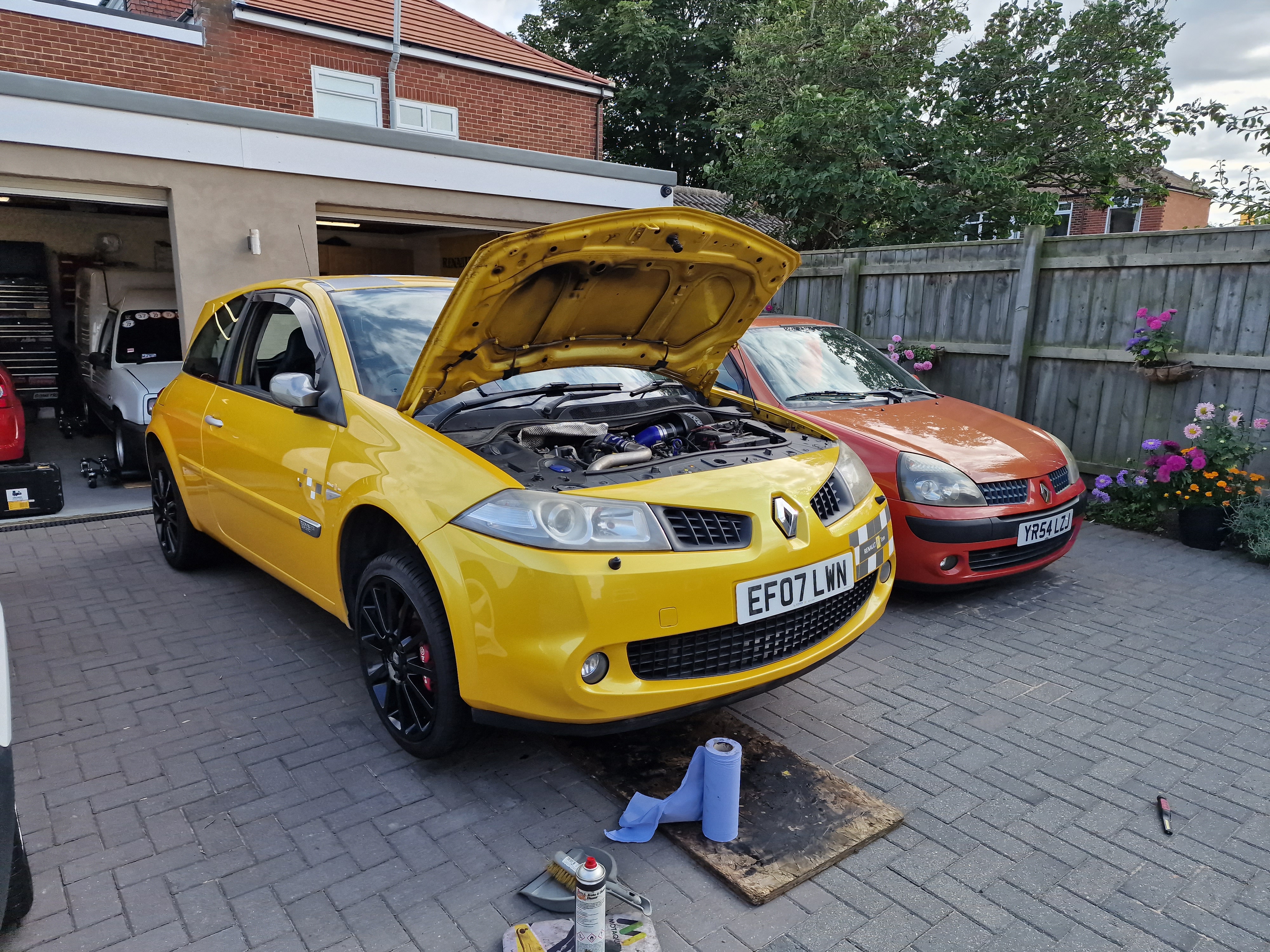

Couple of small updates

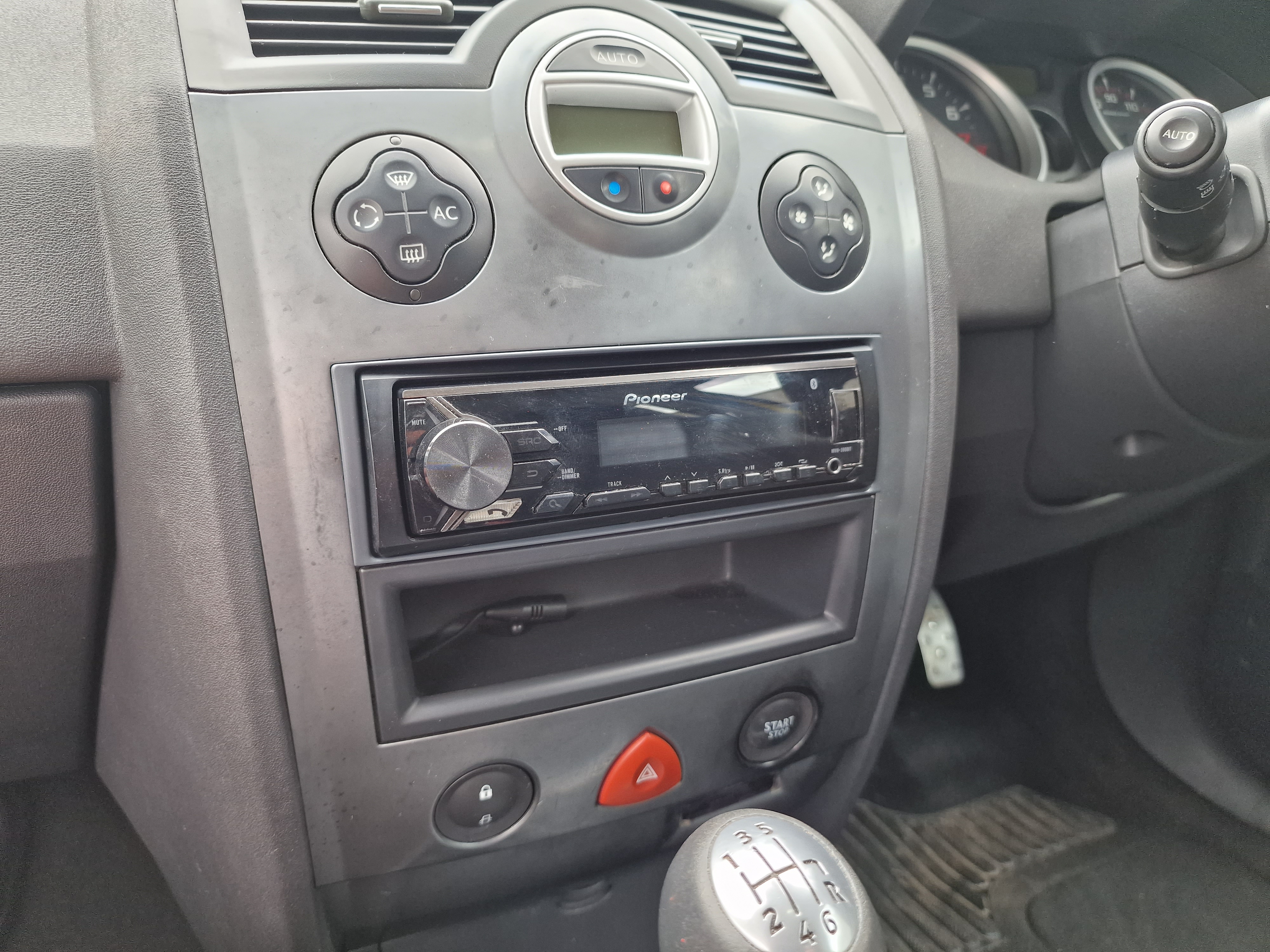

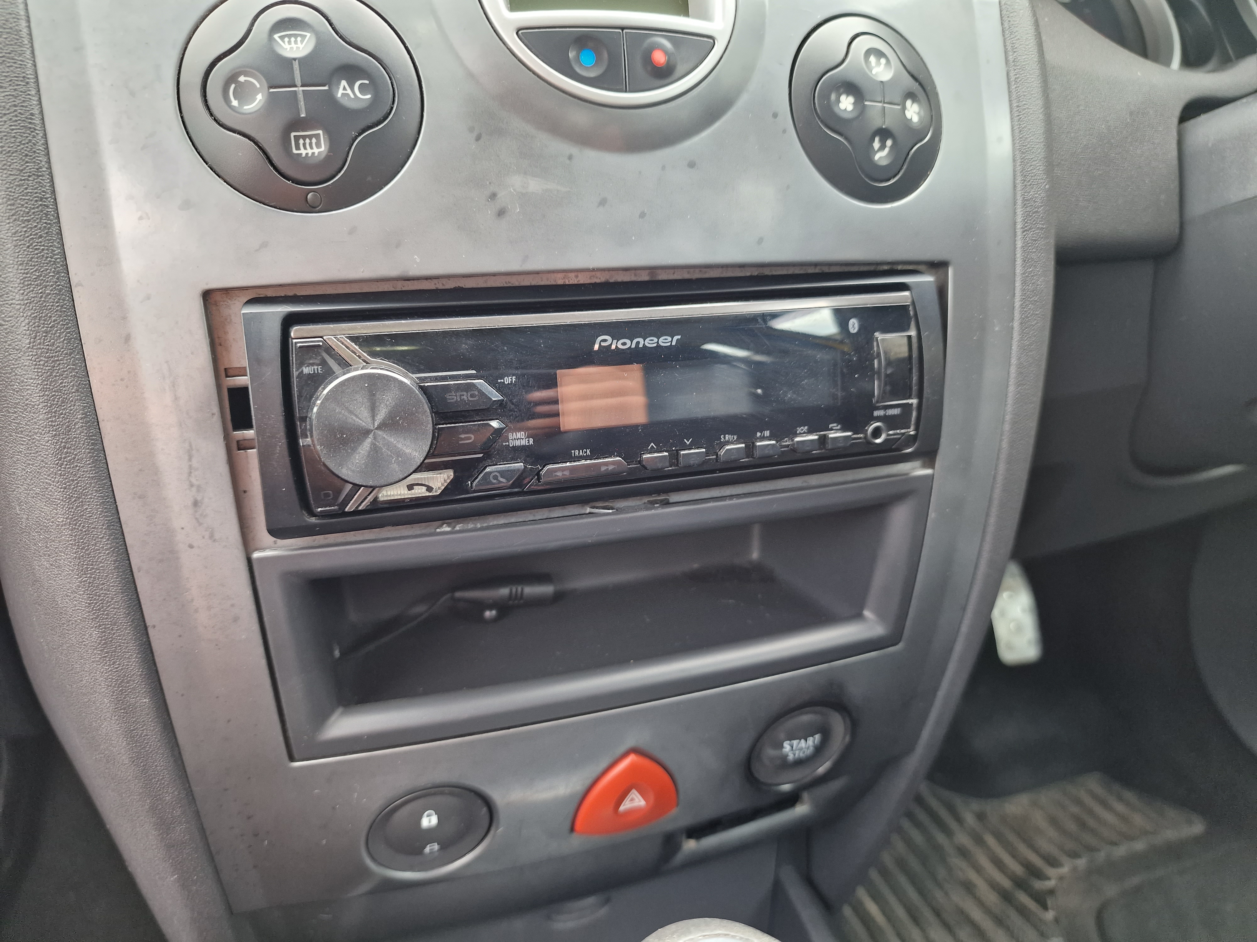

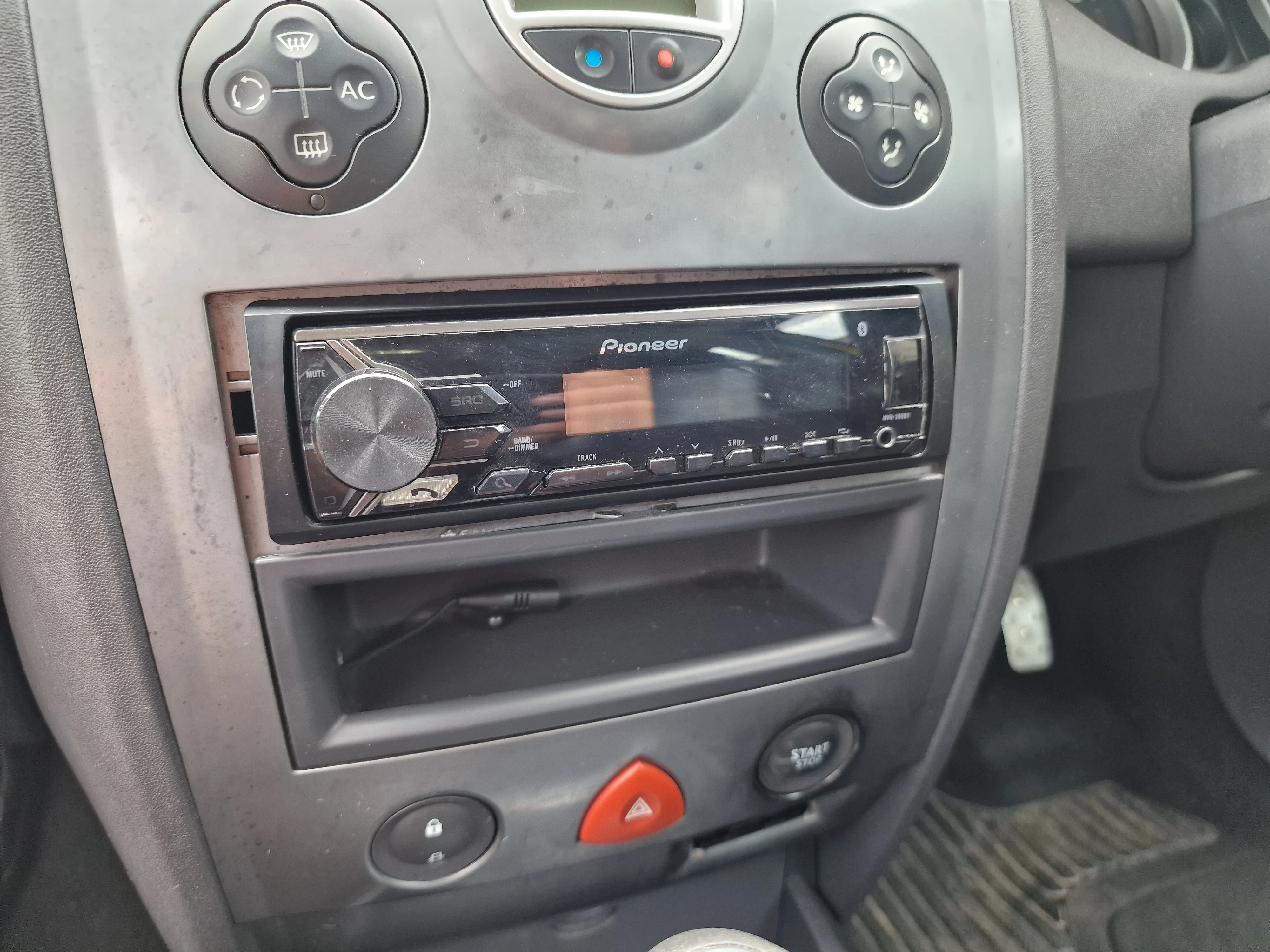

Stereo had no surround around it and looked crap.
£5 trim to tidy it up.
The silver centre part of the dash still looks a bit shite. Might get a new one or paint it up at some point.

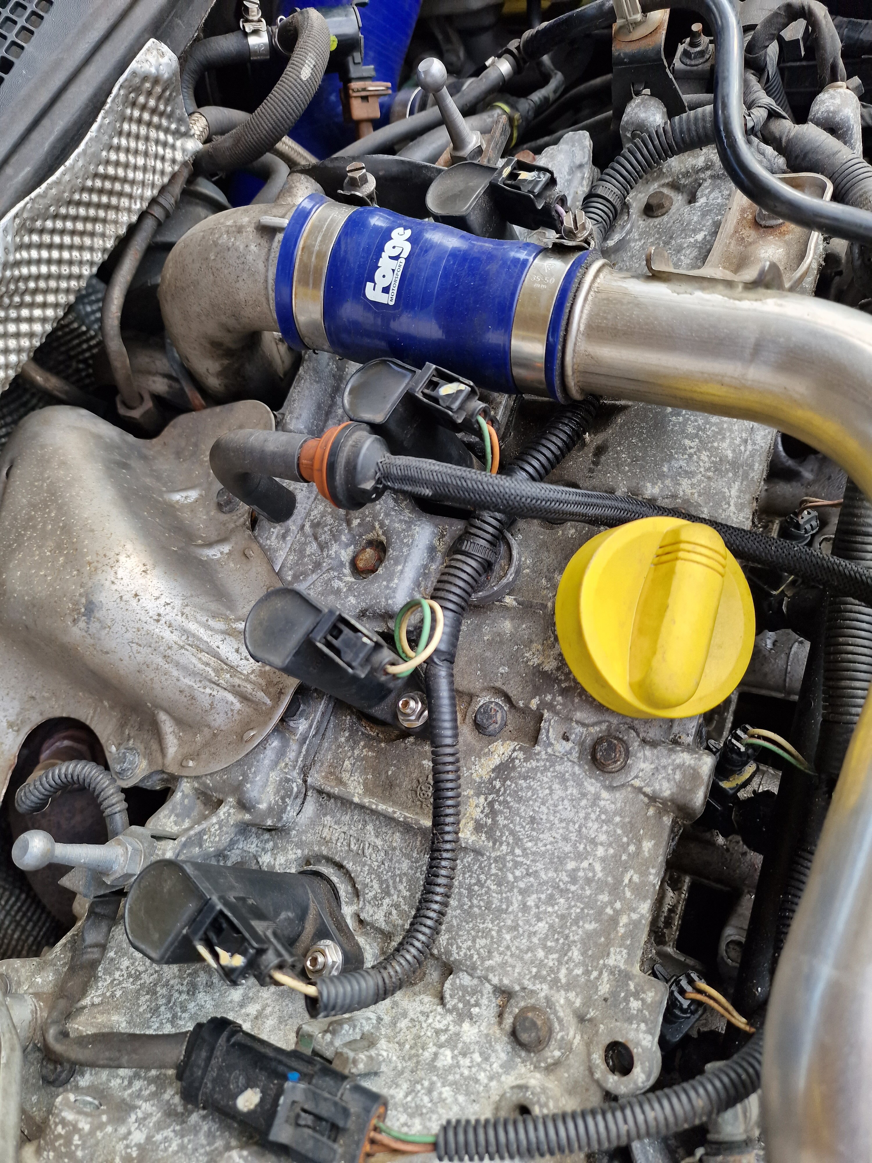

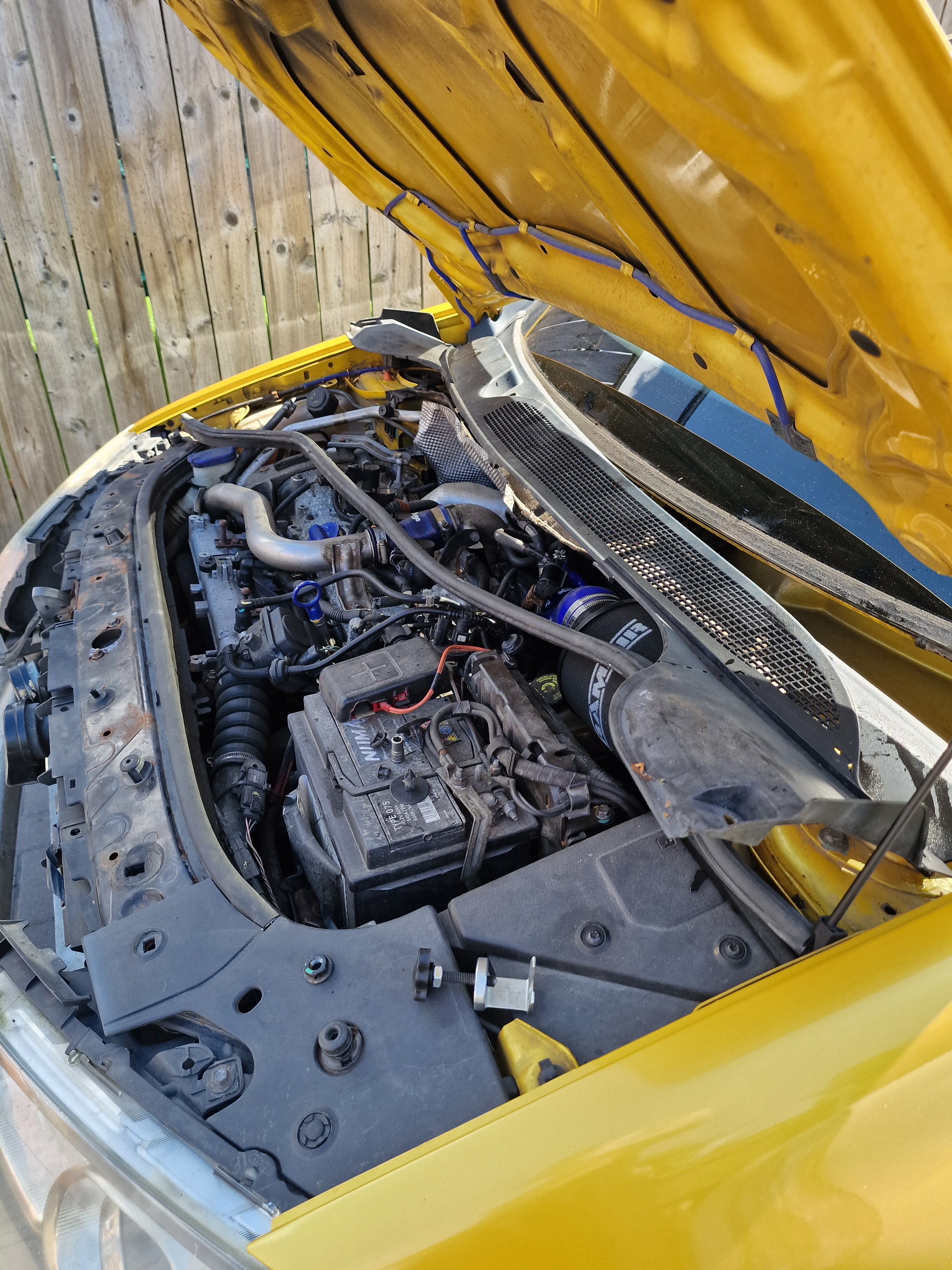

Coilpack studs and nuts fitted. Coil number 4 had no bolt in it initially suprised it was not misfiring. £6 stainless 40mm m6 stud and nut kit from ebay, threadlocked in so no future issues. Also renewed seals on coilpacks with the £8 ali express coilpack seal kit, no pics as working fast between work. Bit of silicone grease on them to stop future issues.

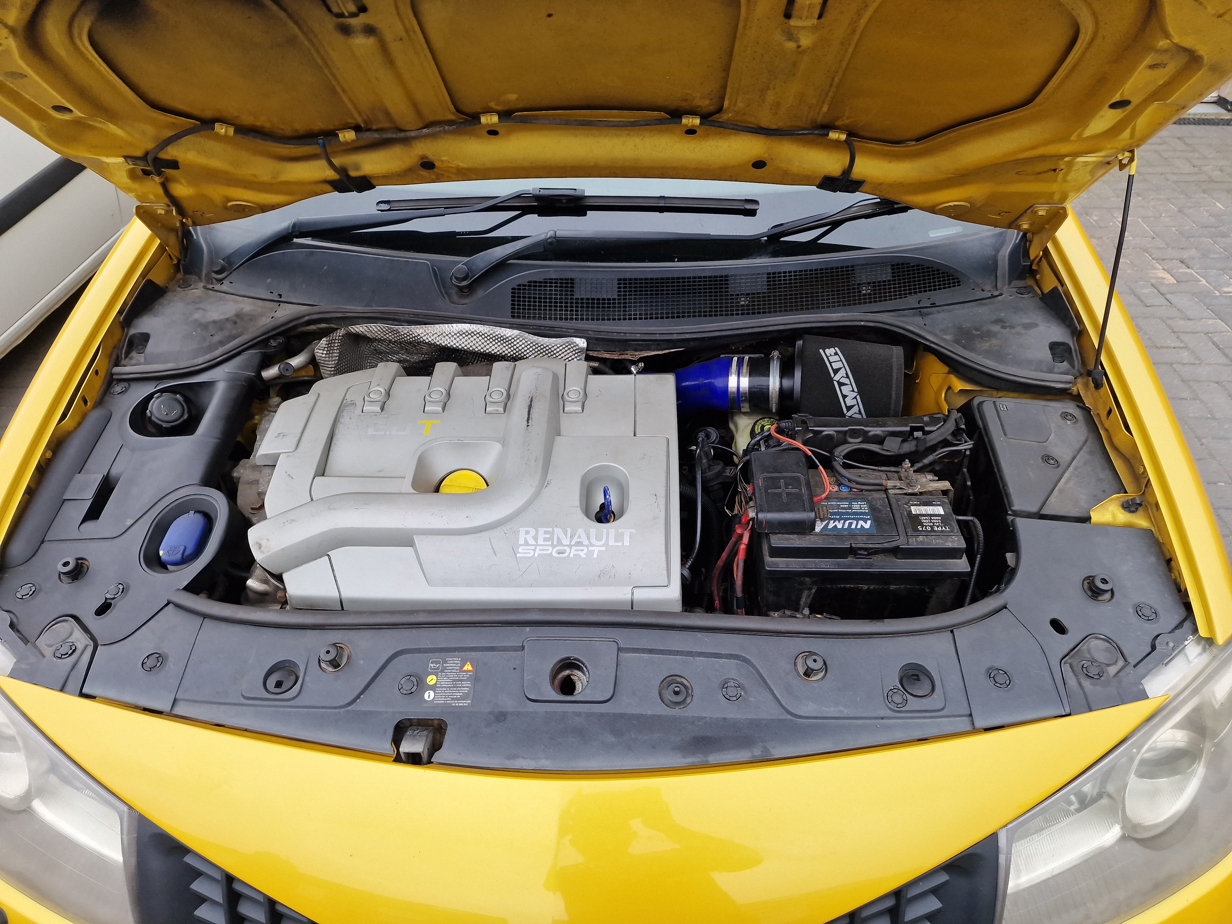

Will keep my eye out for an oem engine cover for it as no show winner under here.
Also removed the stock recirc valve for a blanking plate as i hate the oem whoosh with a cone filter. Had a spare half hour today so cracked on, these can be a bit of a t**t to do in situ as access is tight and easy to drop the bolts so expected it to take a while. Anyway the stars aligned and 9 mins later its on. New record!

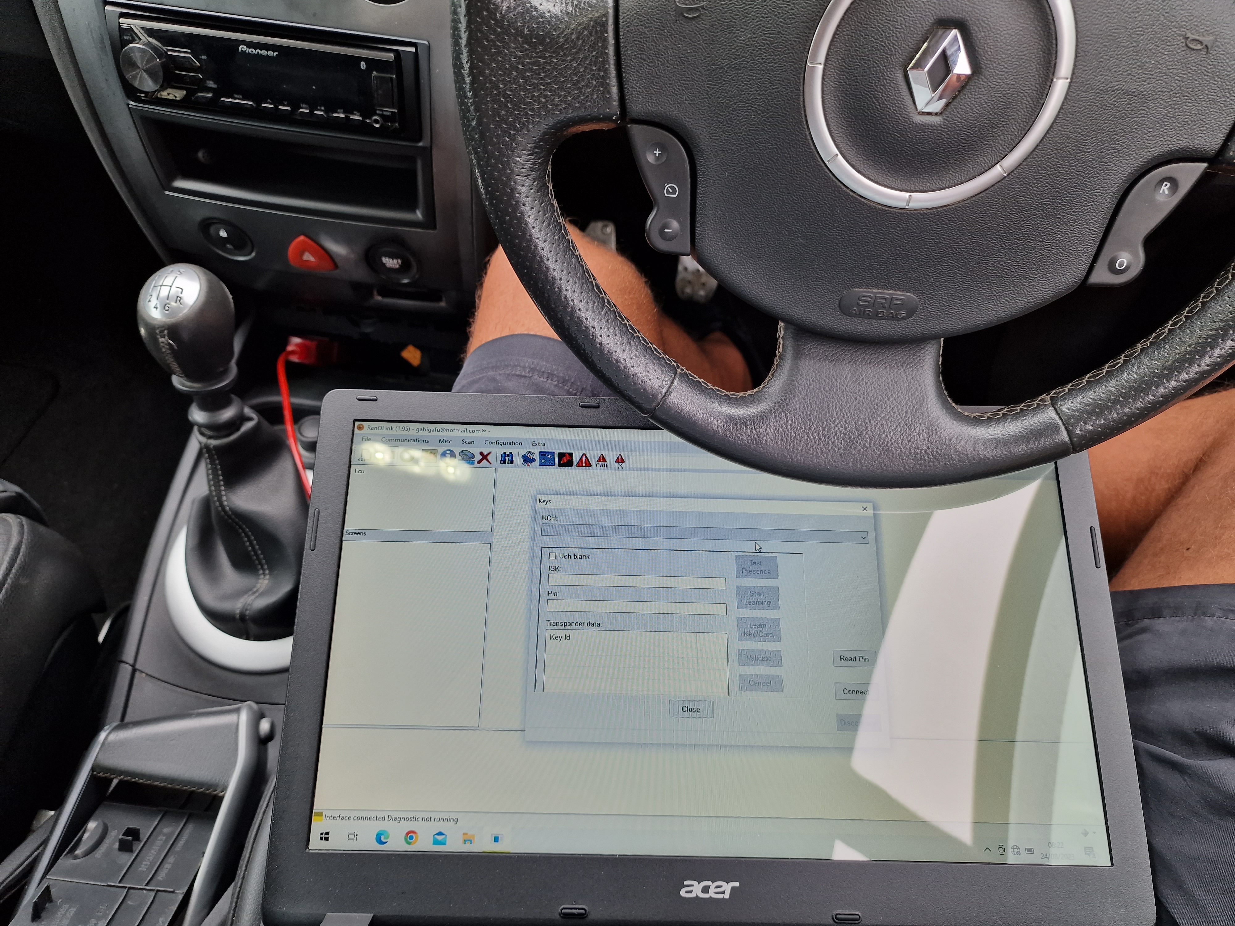

Its also got one working key and a spare that does the ign only not the doors and both are well worn. After @Clio_fool asked me about keycard coding i had a shot as i have a couple of spare meg keys. I can do them and its easy however needs to be a virgin uncoded key as not possible to recode used unless you strip it down and replace the chip for a virgin one.
Renolink in action.

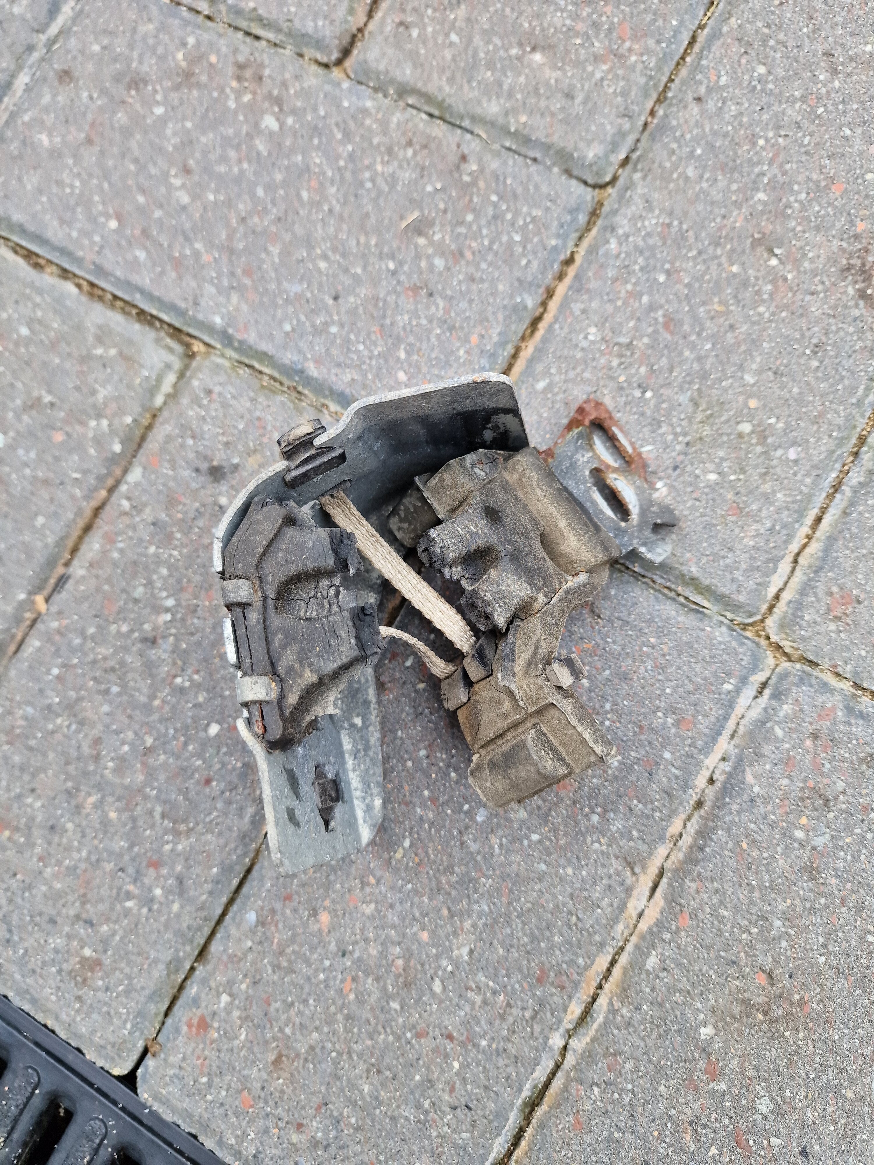

Exhaust was hanging low and noted the middle rubber had snapped. Had a gen renault centre hanger in stock that i bought years ago for the blue meg but did not use so fitted that.
Front exhaust clamp was loose too and blowing. Repositioned the clamp and tightened up, the centre silencer is nicely tucked up in the tunnel now. Did wonder why it caught a speedbump at stock rideheight when i drove it home.
Fired up to check for blows. All good.

I've got some Forge solid boost pipes, Forge actuator with a new N75 valve and a 3" Blueflame exhaust kicking about I think. Let me know if you need them.

Oil leak fixed. Nice chemi metal bodge done by somebody in the past. New return fitted.

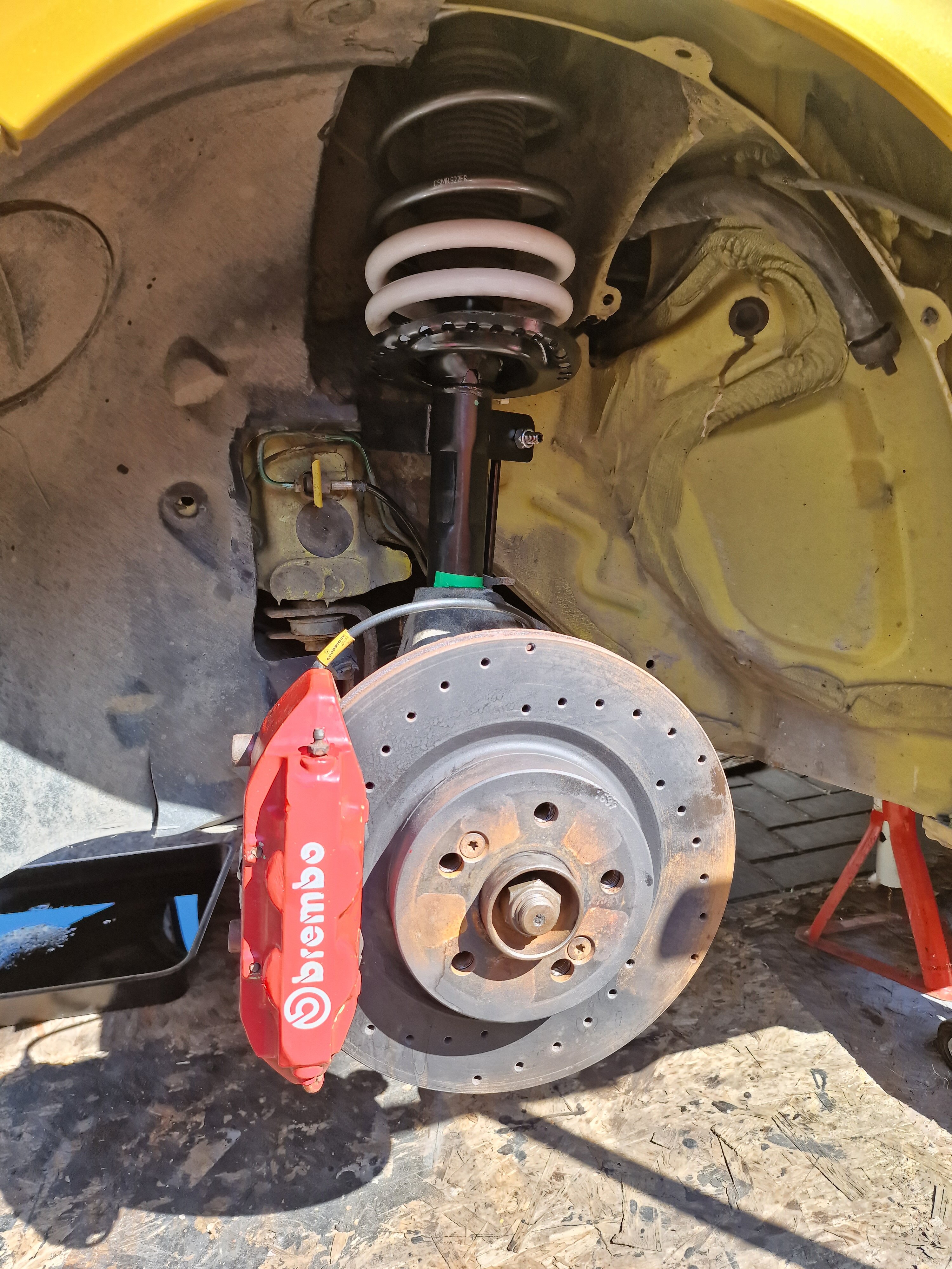

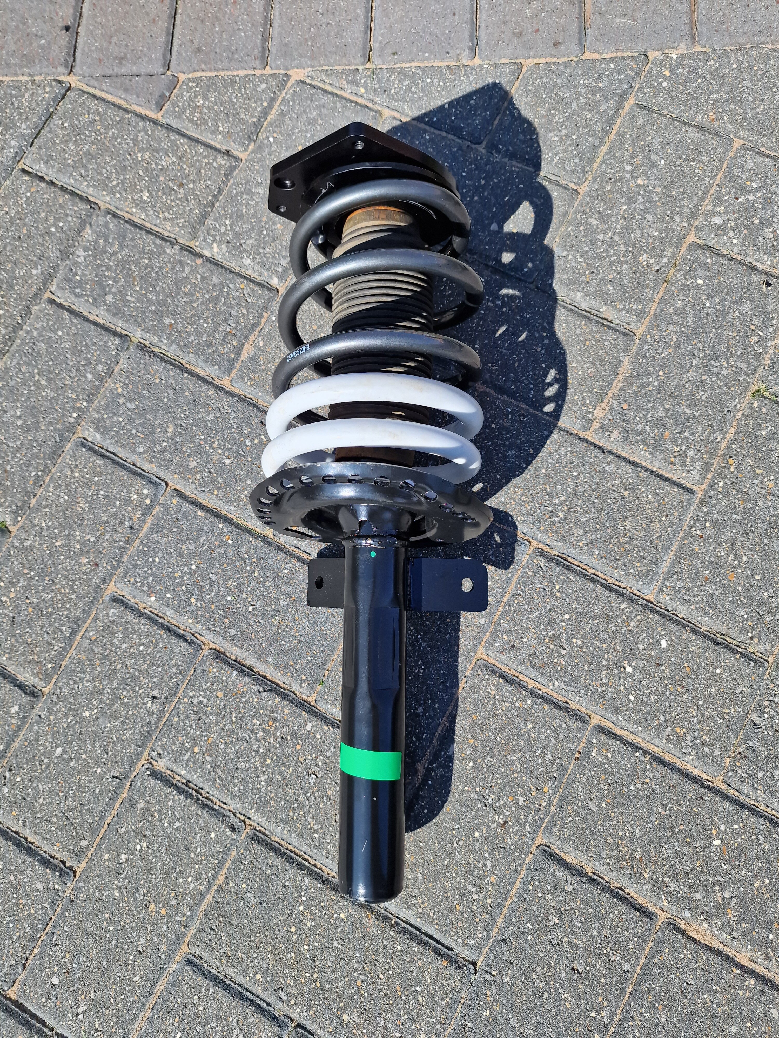

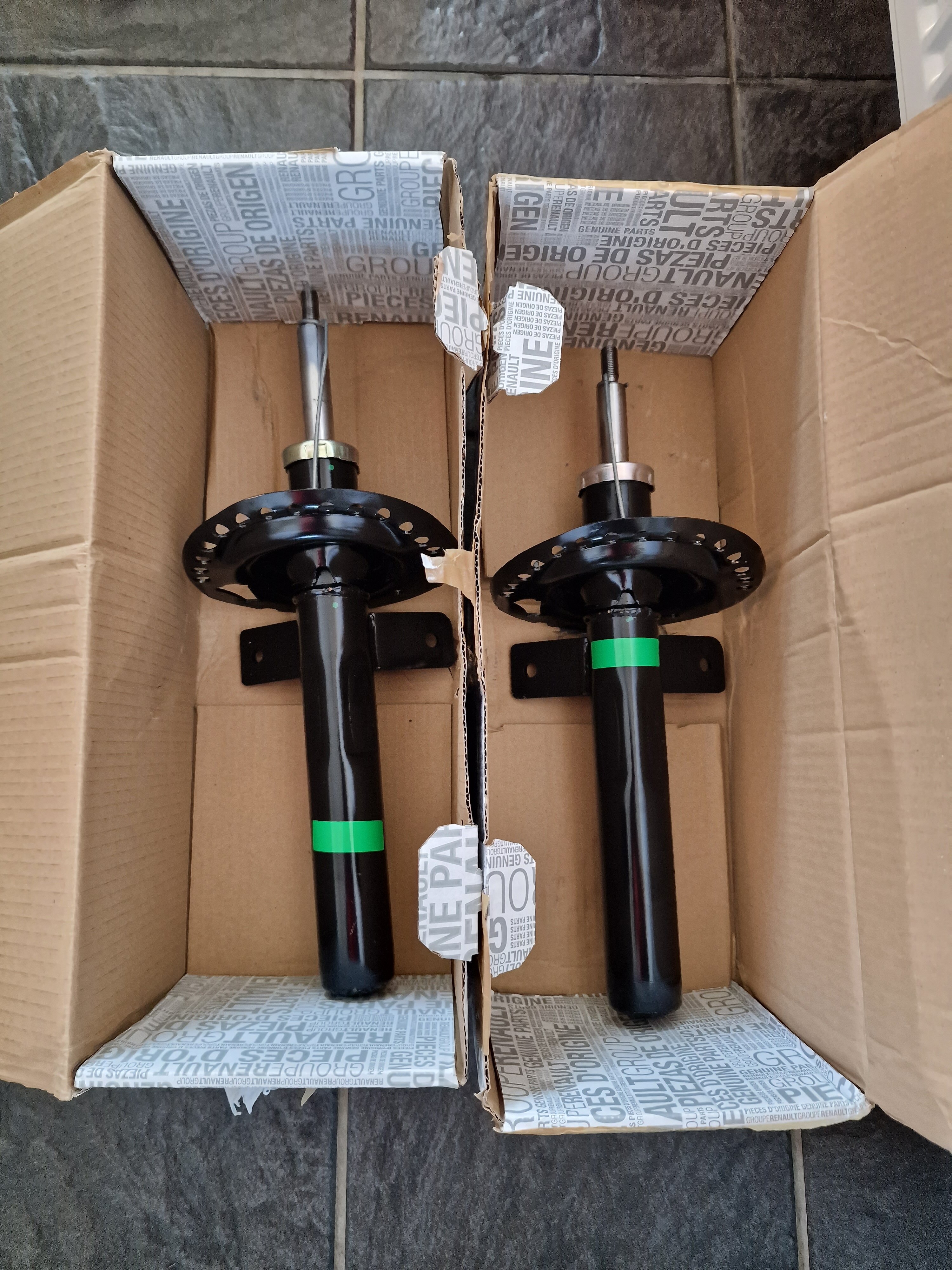

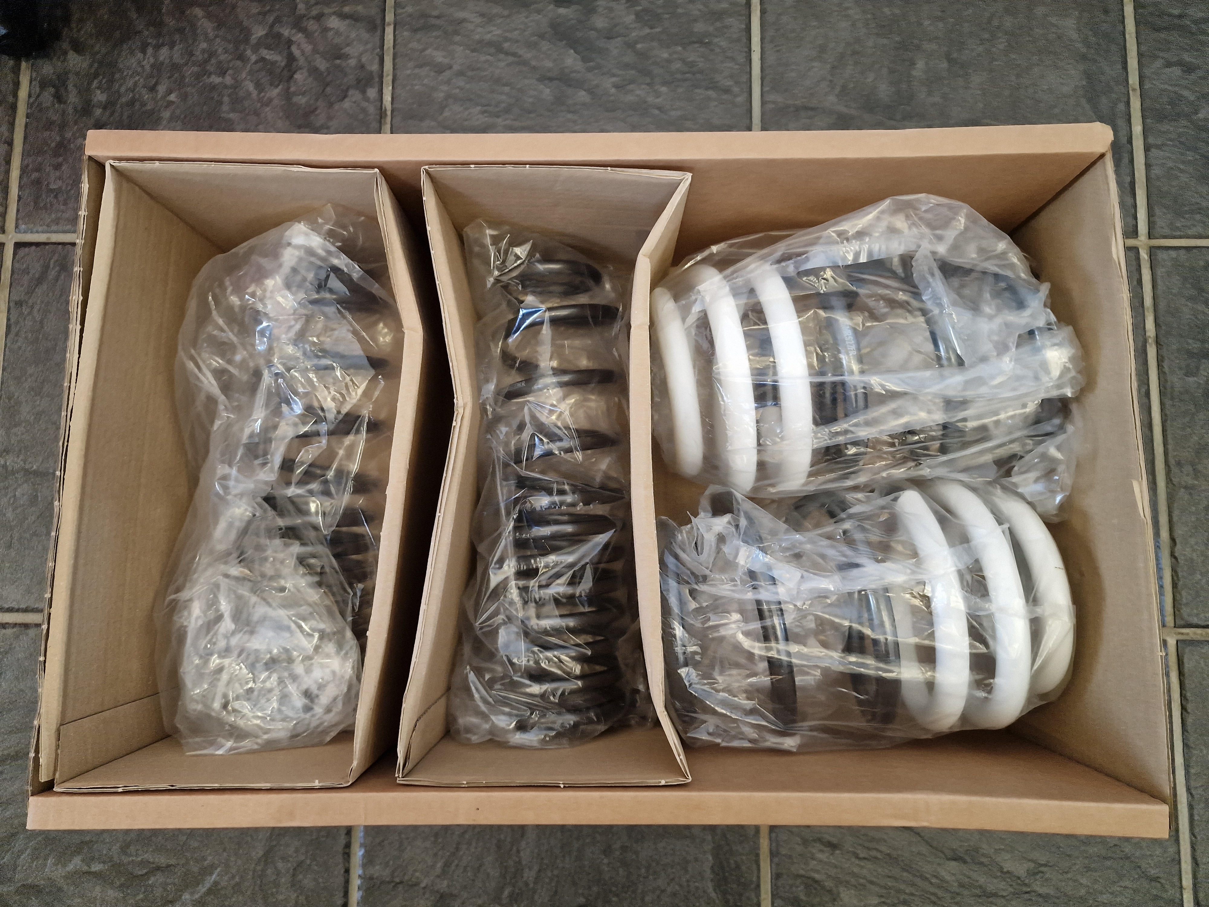

Goodies started arriving last week. Cooksport springs, oem ren r26 front shocks, oem ren tie rods. Also have new drop links, new delphi trackrod ends, new lower arms etc not pictured.

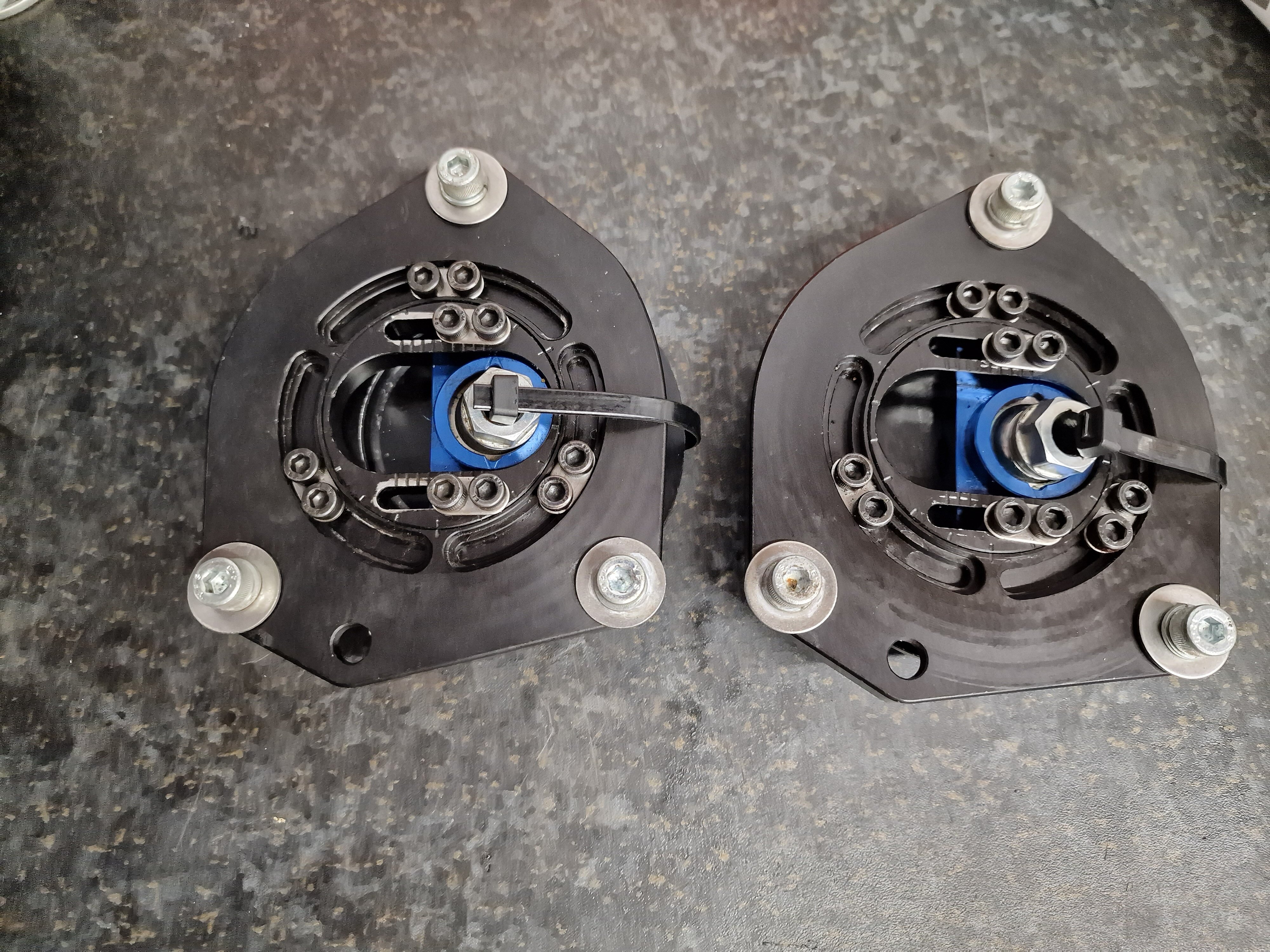

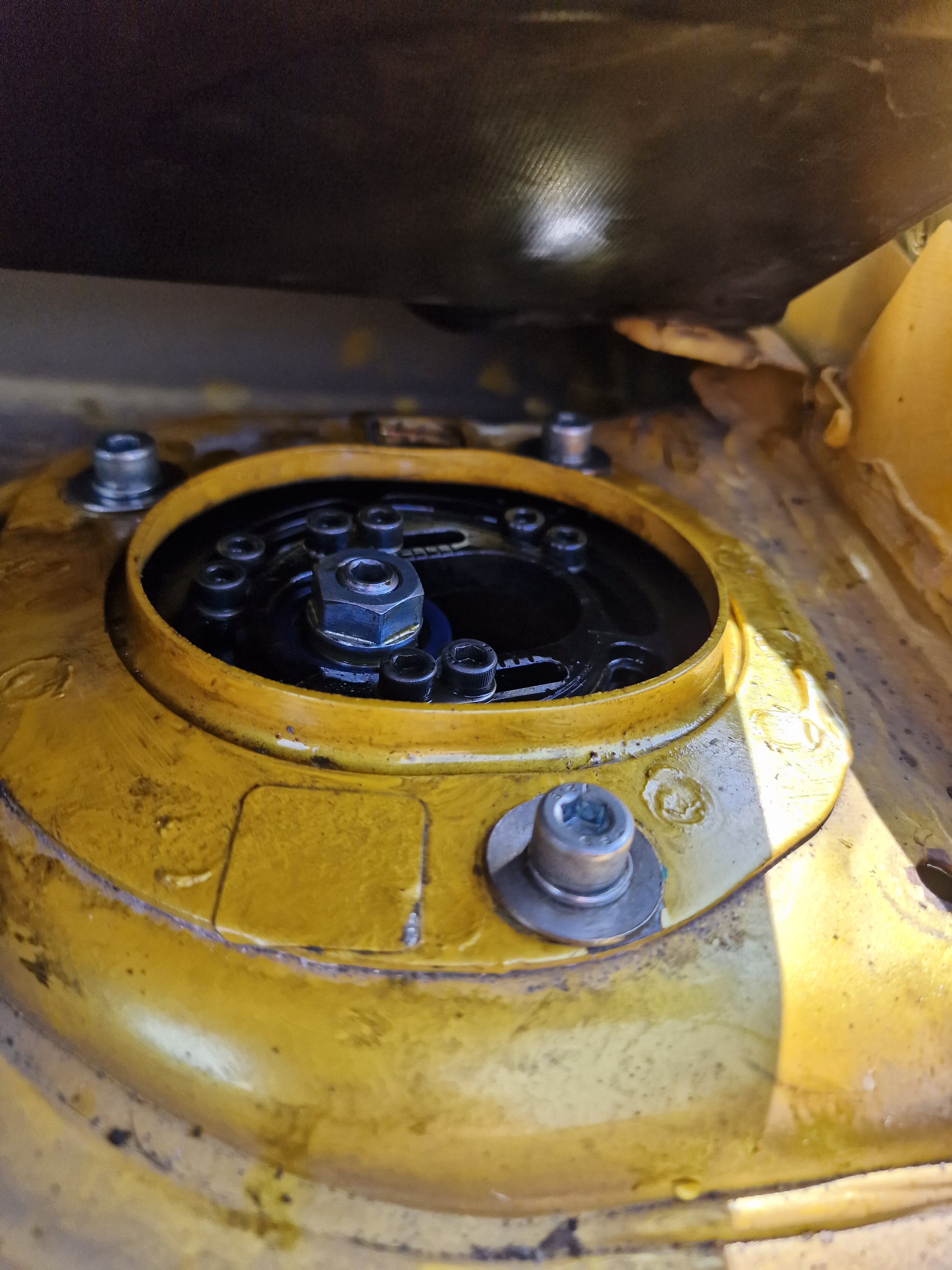

Dug the compbrake adjustable top mounts out that i bought for blue 225 ages ago but couldnt be arsed to fit.
Engine cover from @Ian_R

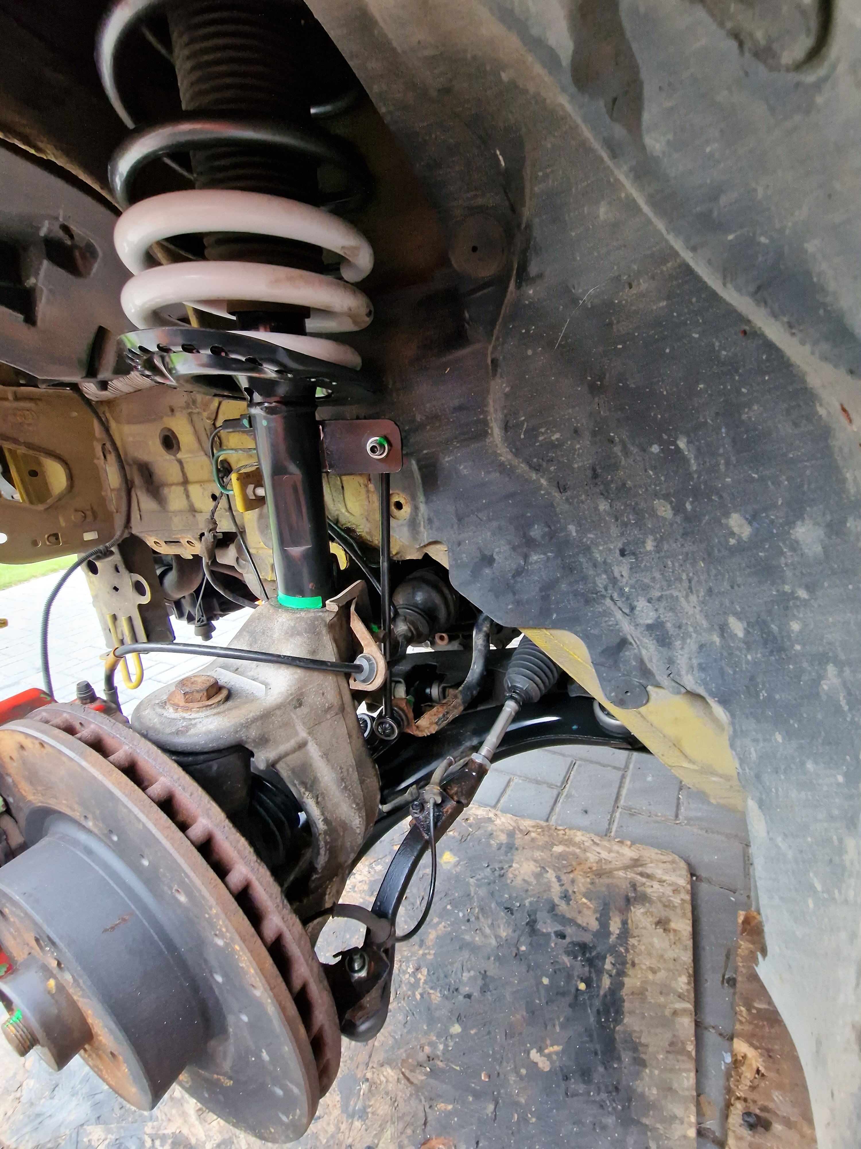

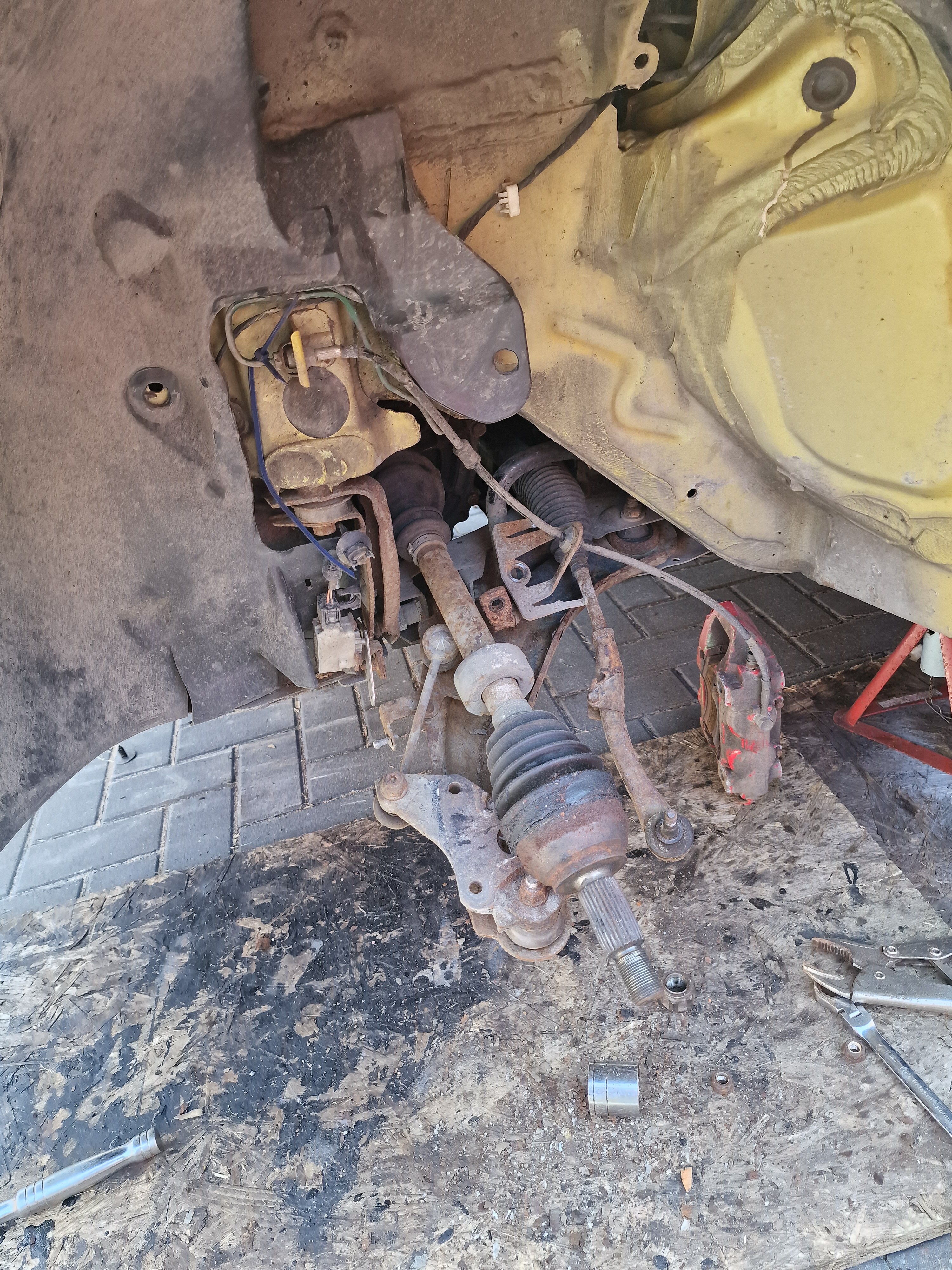

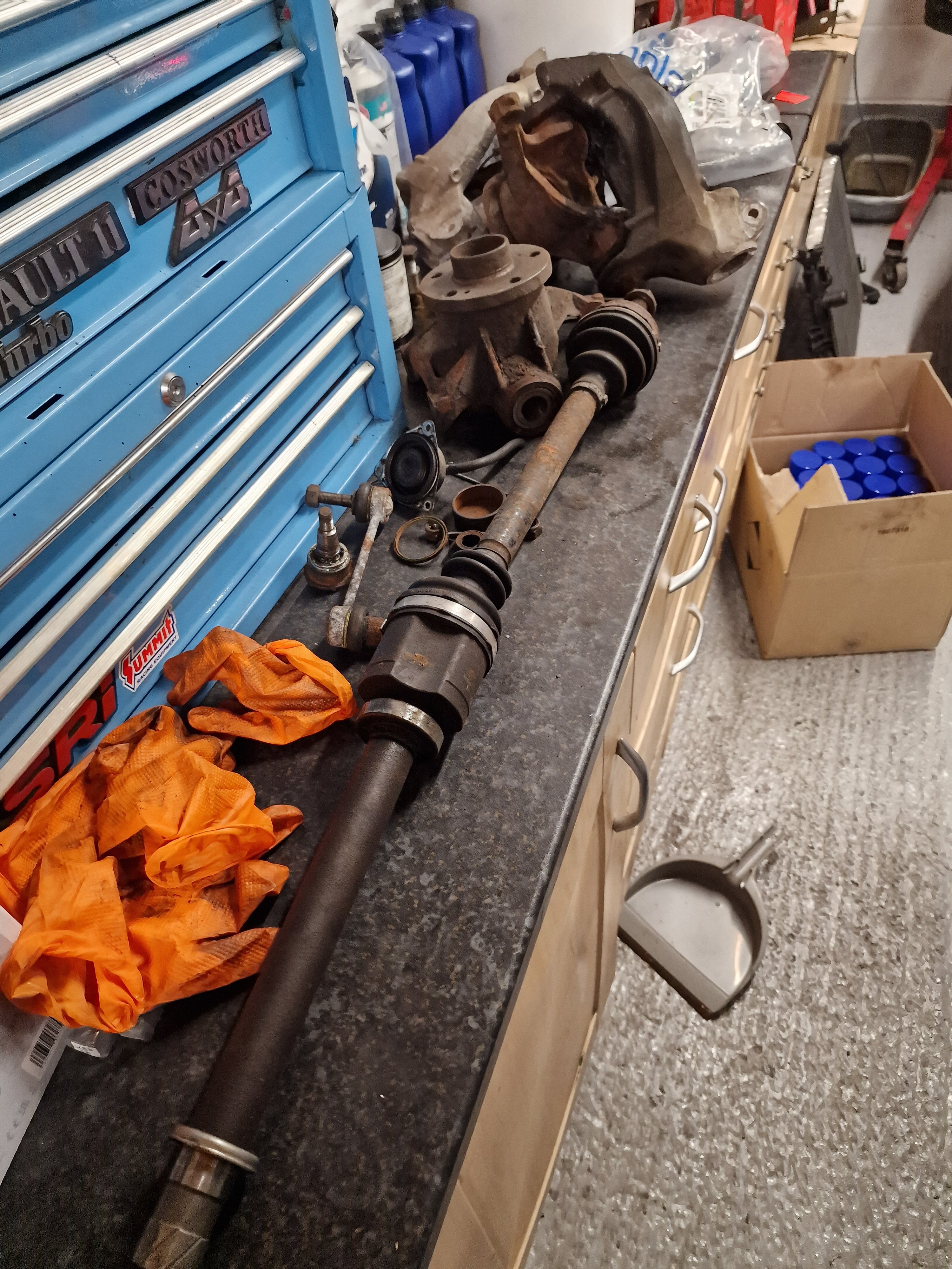

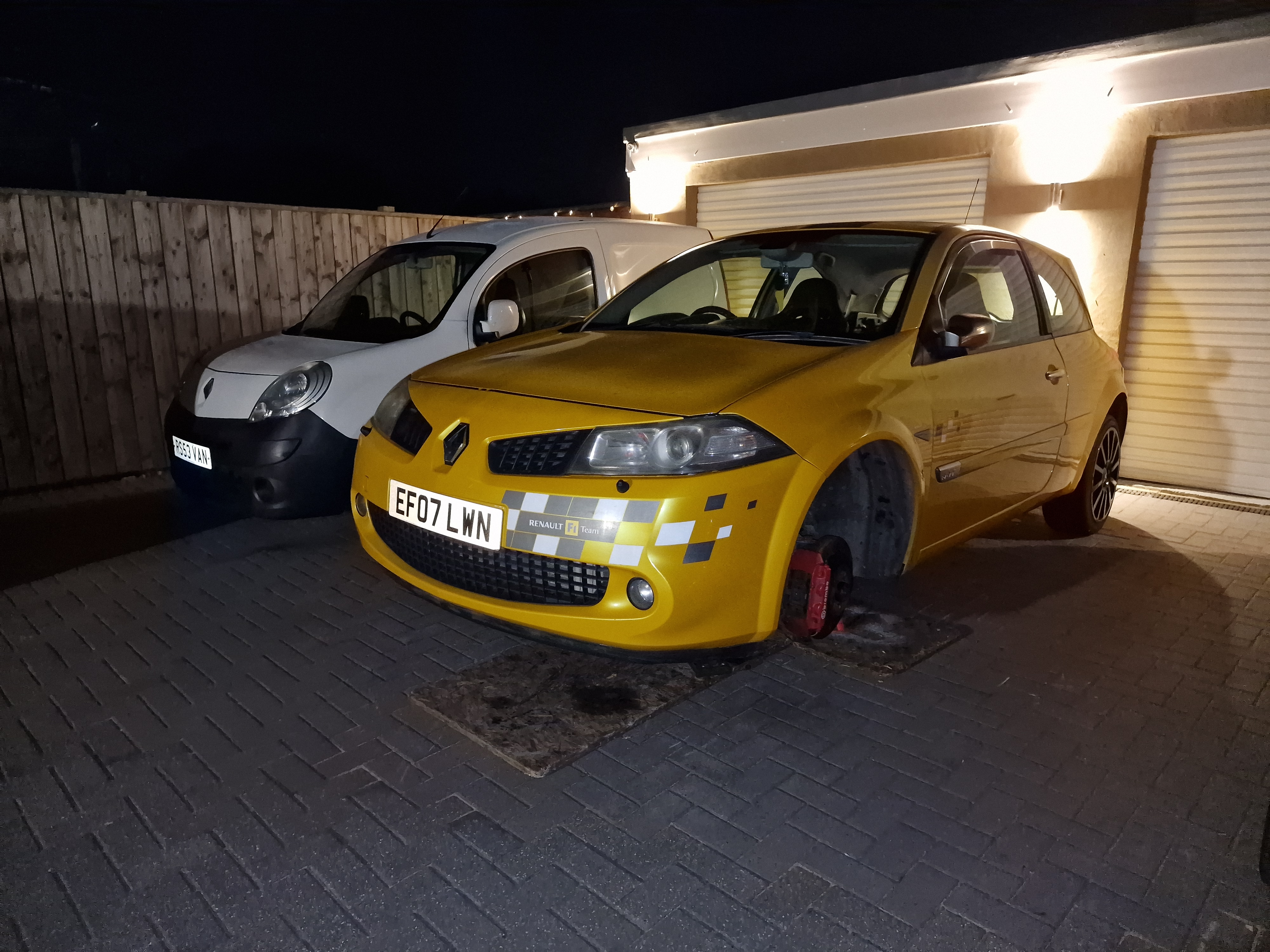

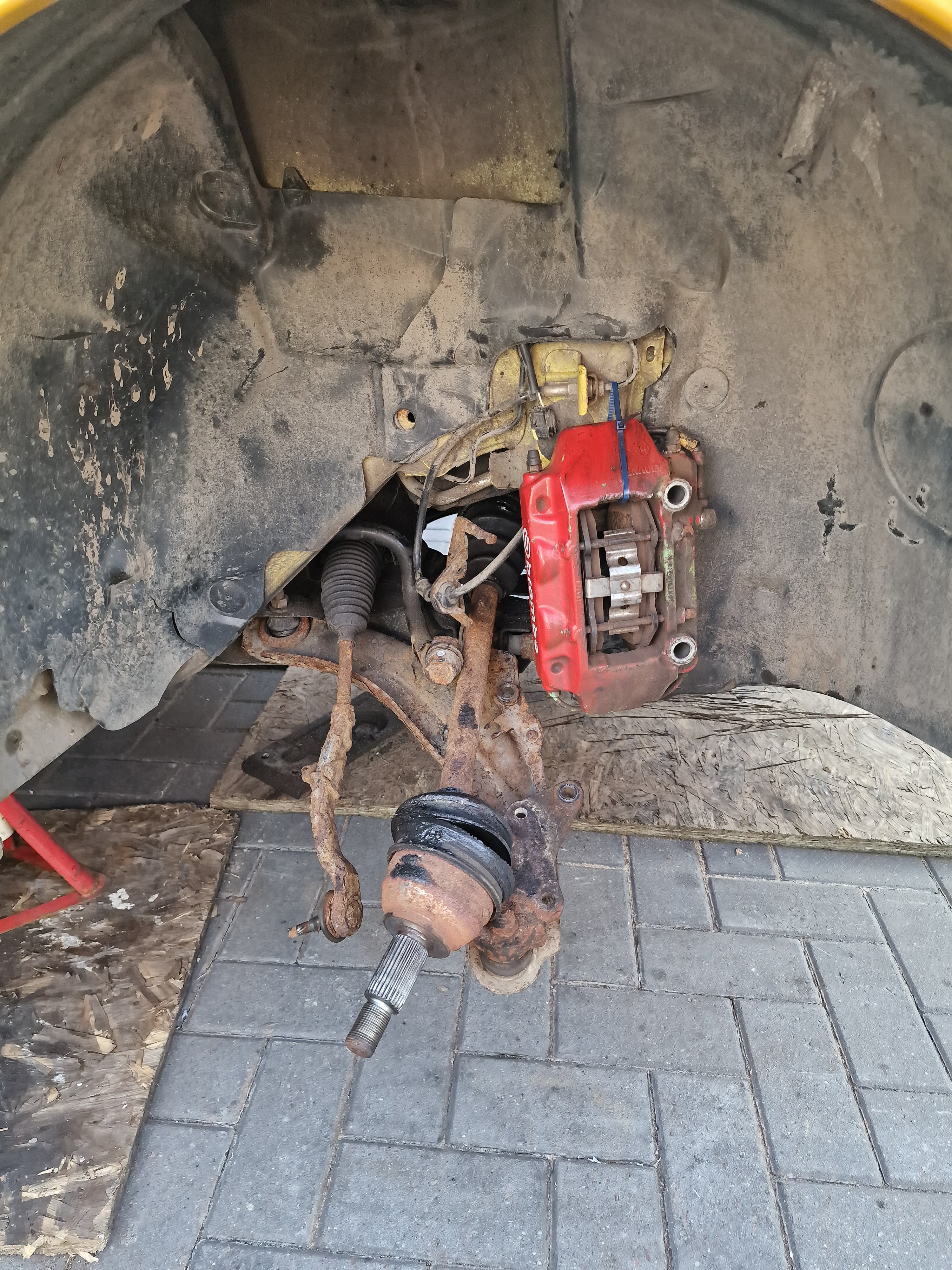

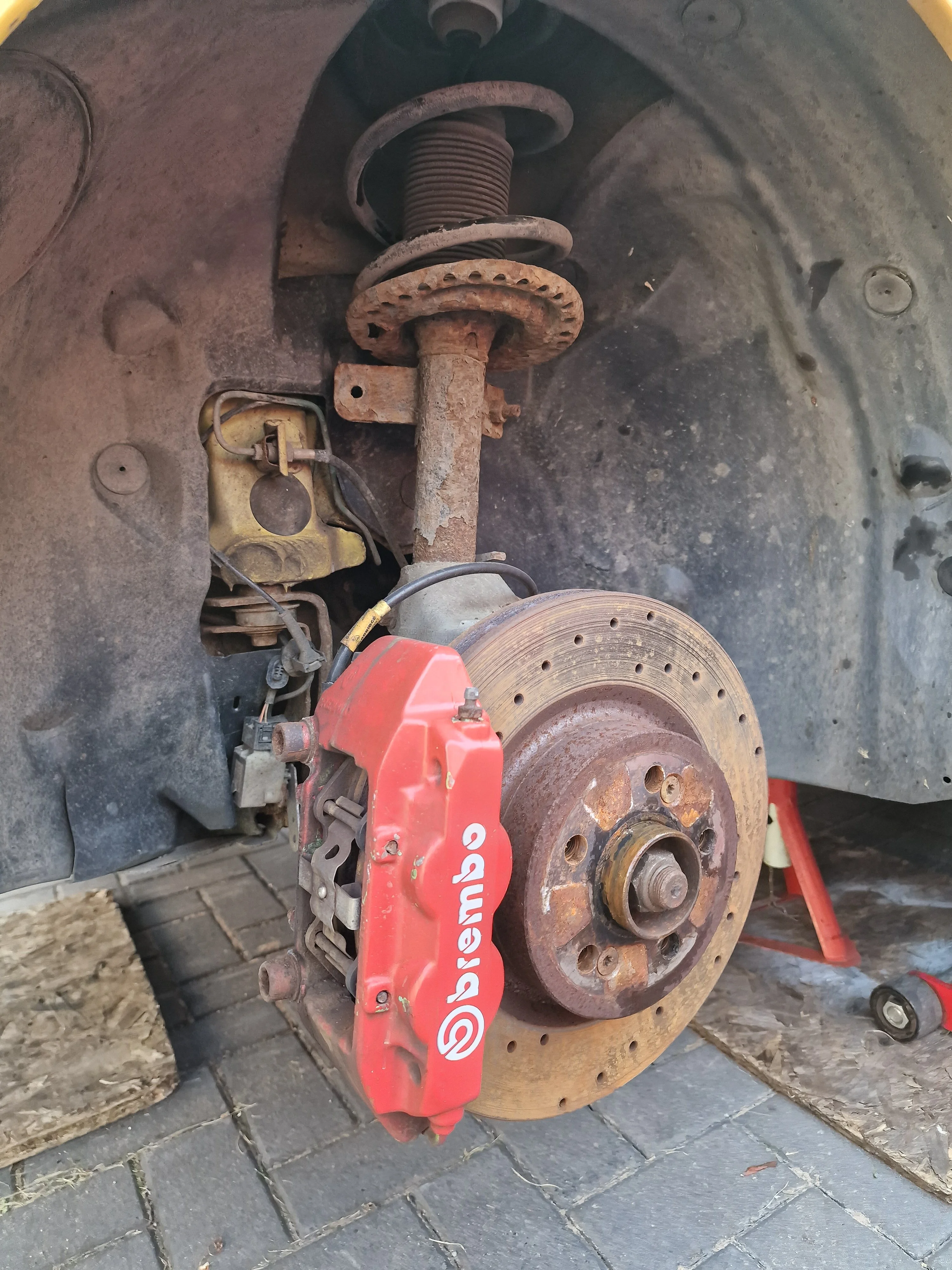

Started last Sunday. Passneger side first. Overall this side was OK no play but well worn.
Very rusty
All binned, will drop subframe to change arms and rack later lets get top done.

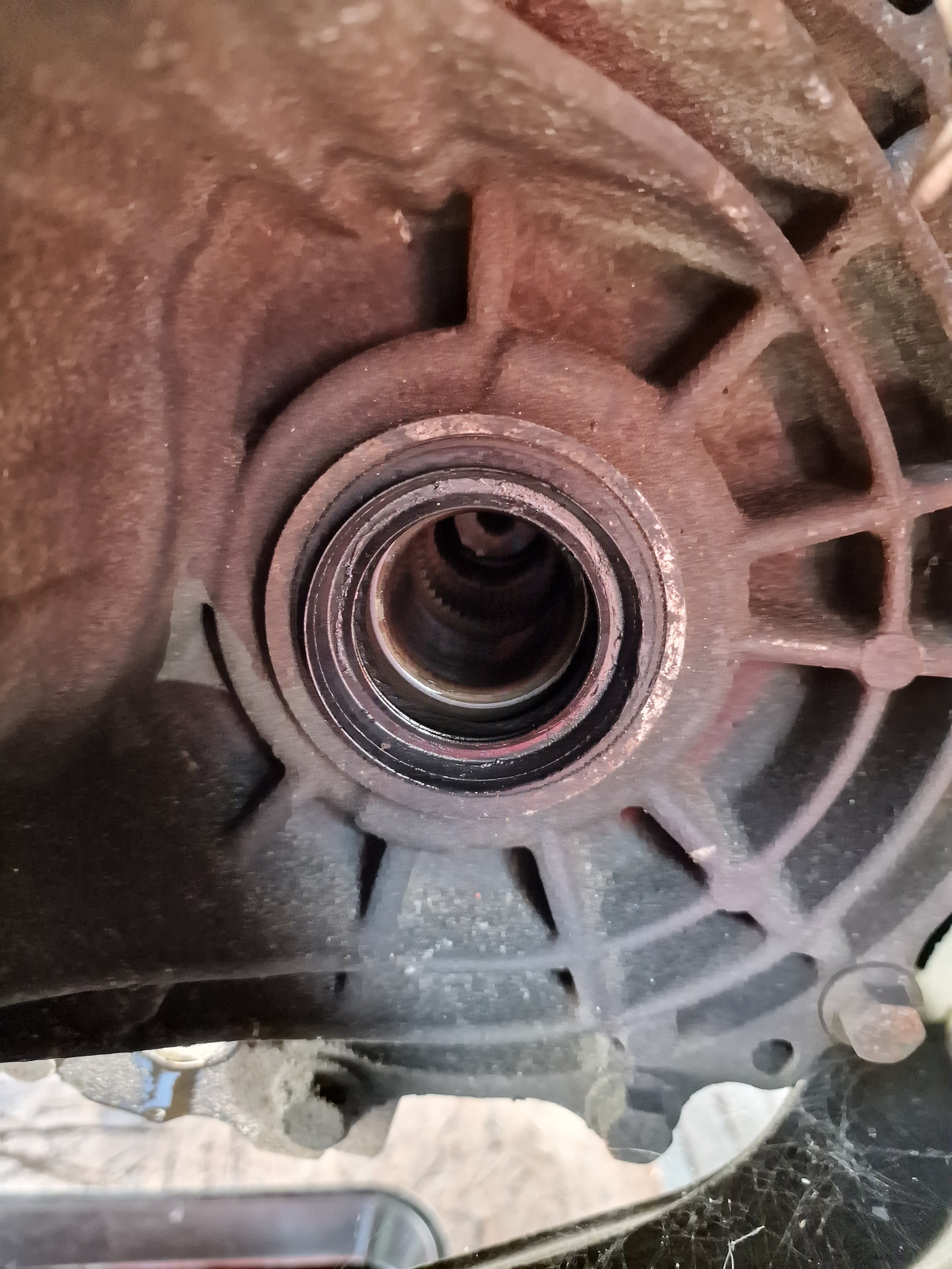

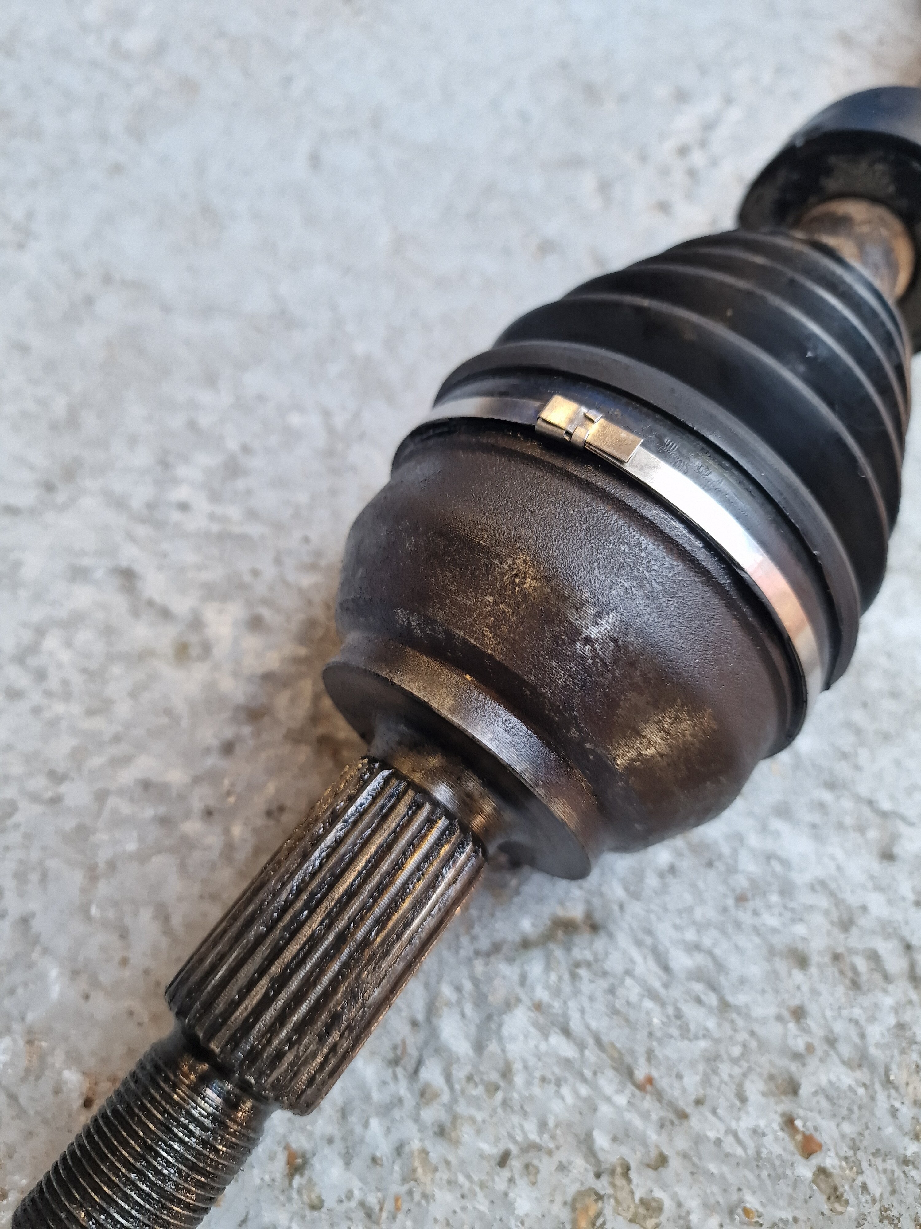

Note cv grease. No boot clip. Moved cv joint and it fell off as no retaining clip on shaft. So dropped gear oil and fitted new clip/knocked cv on. New band style.cv boot clip to clear hub.
Checked its not lost its lsd with engine change - lsd present and correct.

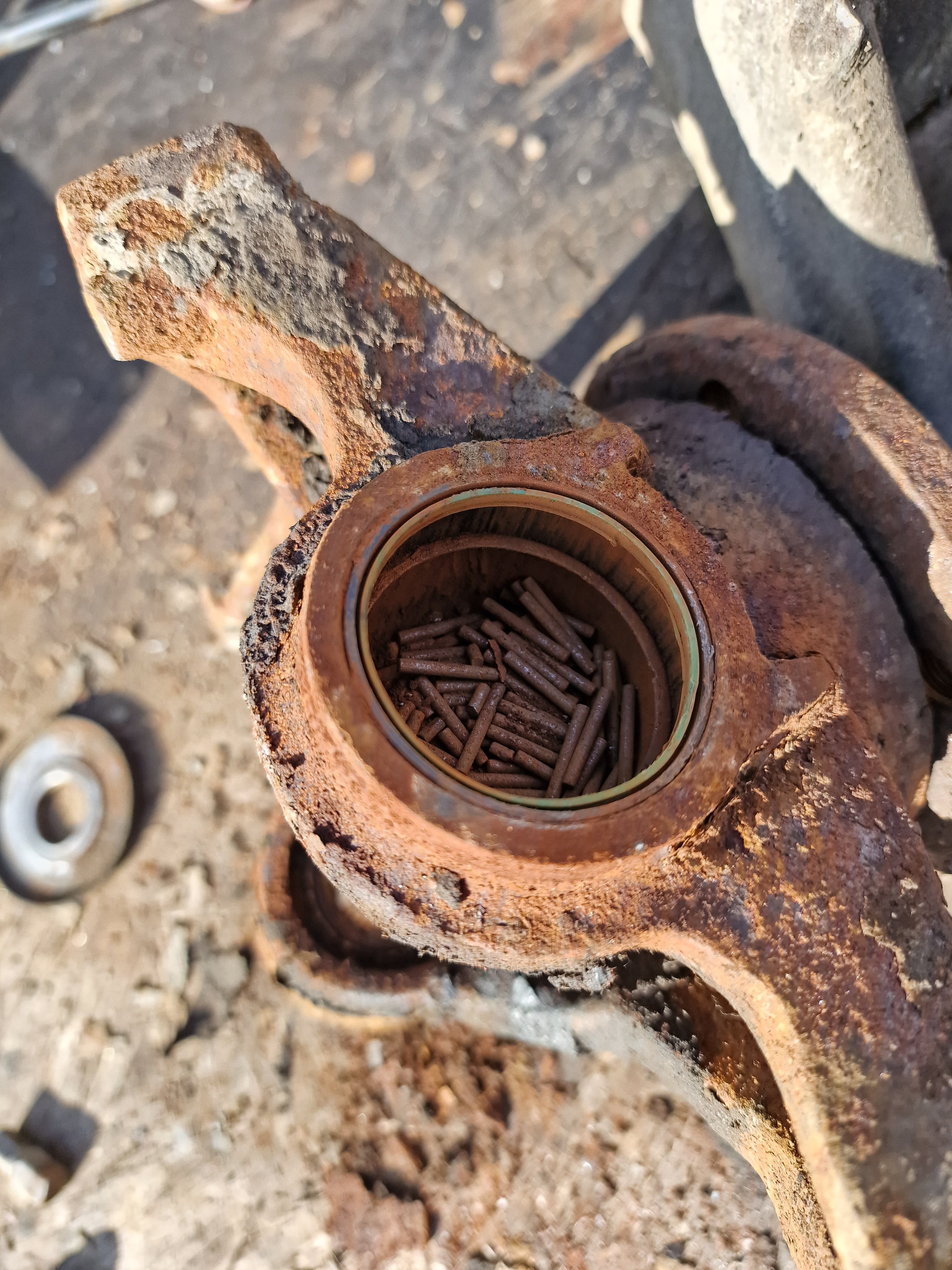

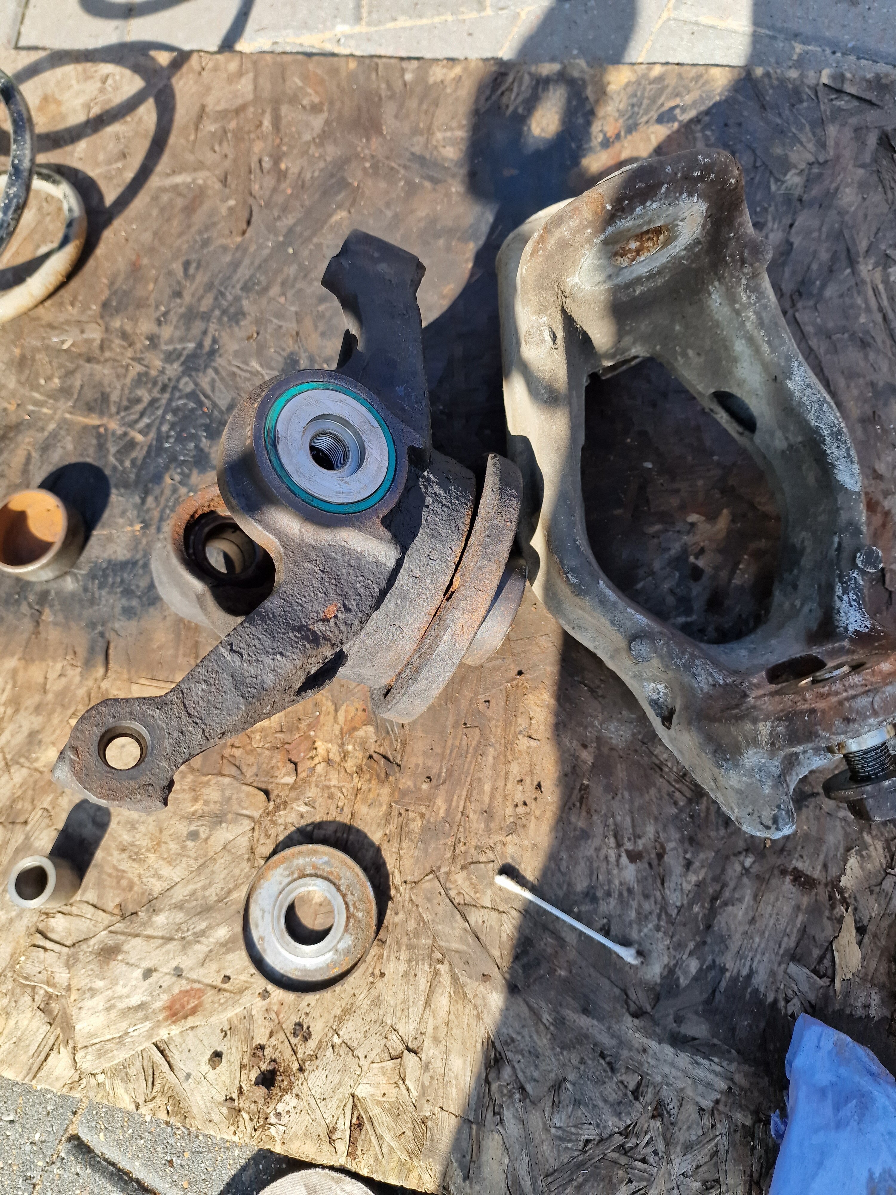

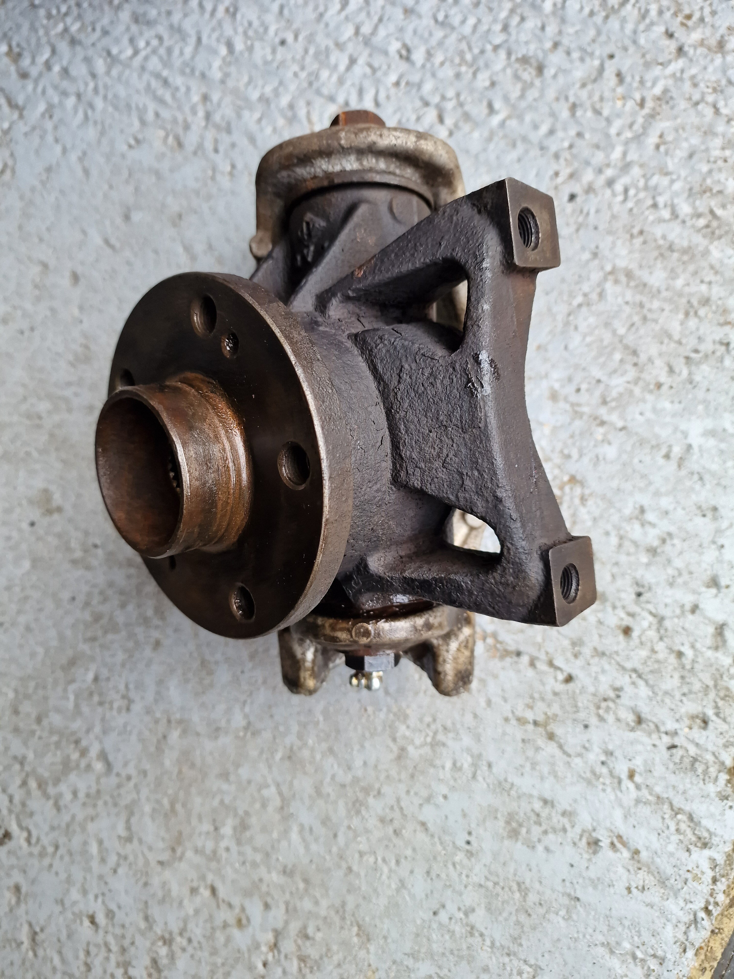

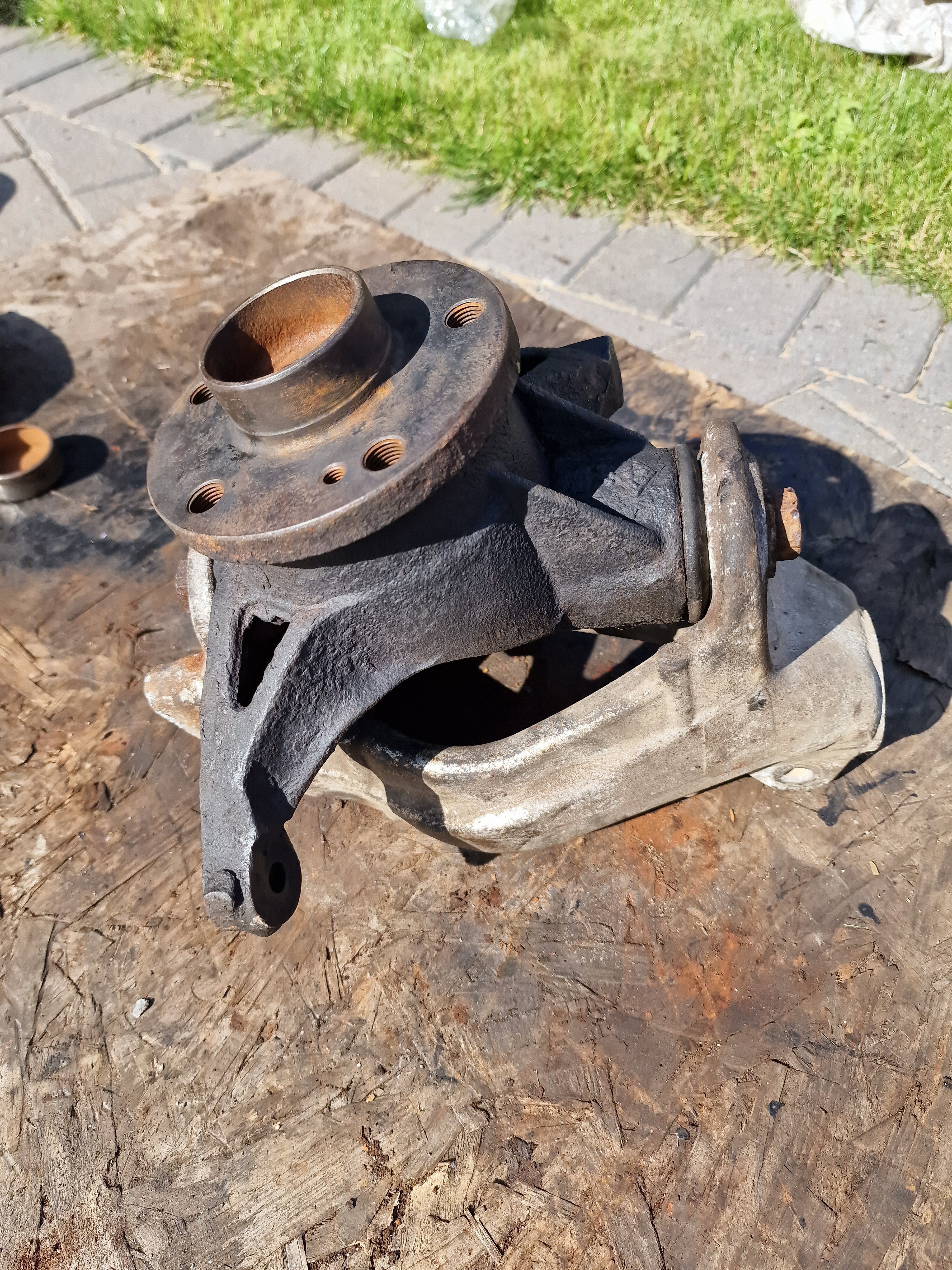

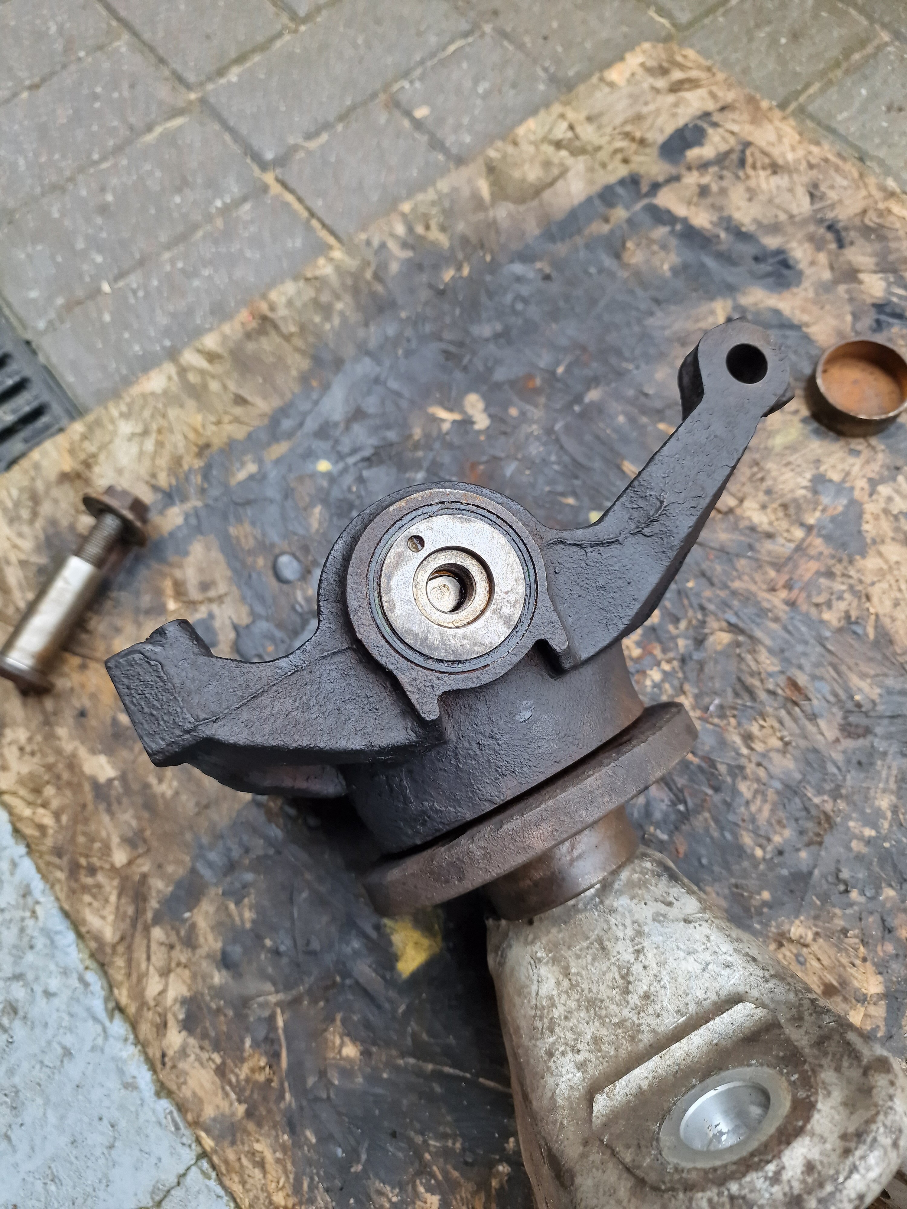

Hub stripped..suprisingly not seized but swivel rough.
Quick wire brush and slap on some paint, new swivel installed.
Rebuilt.

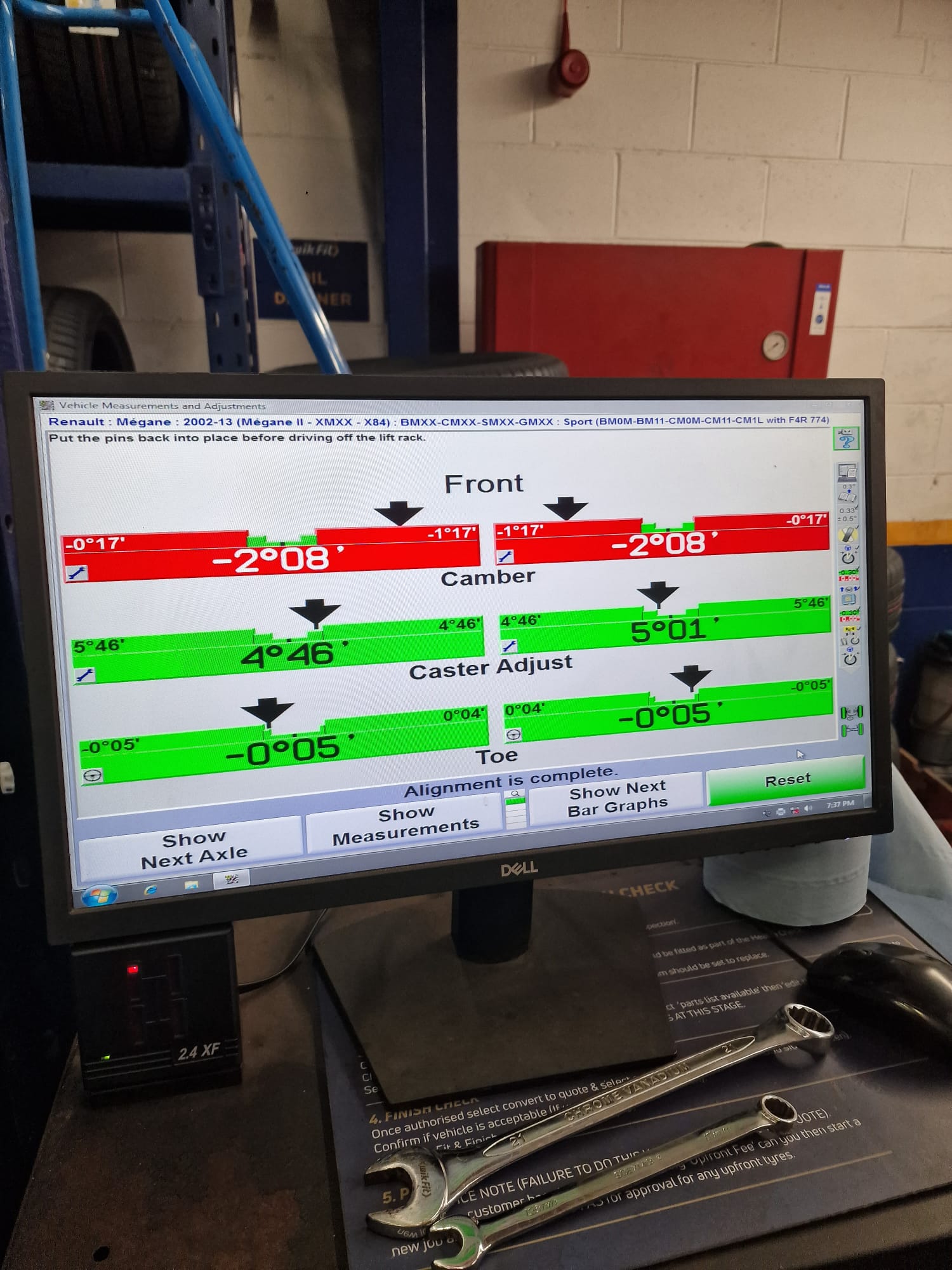

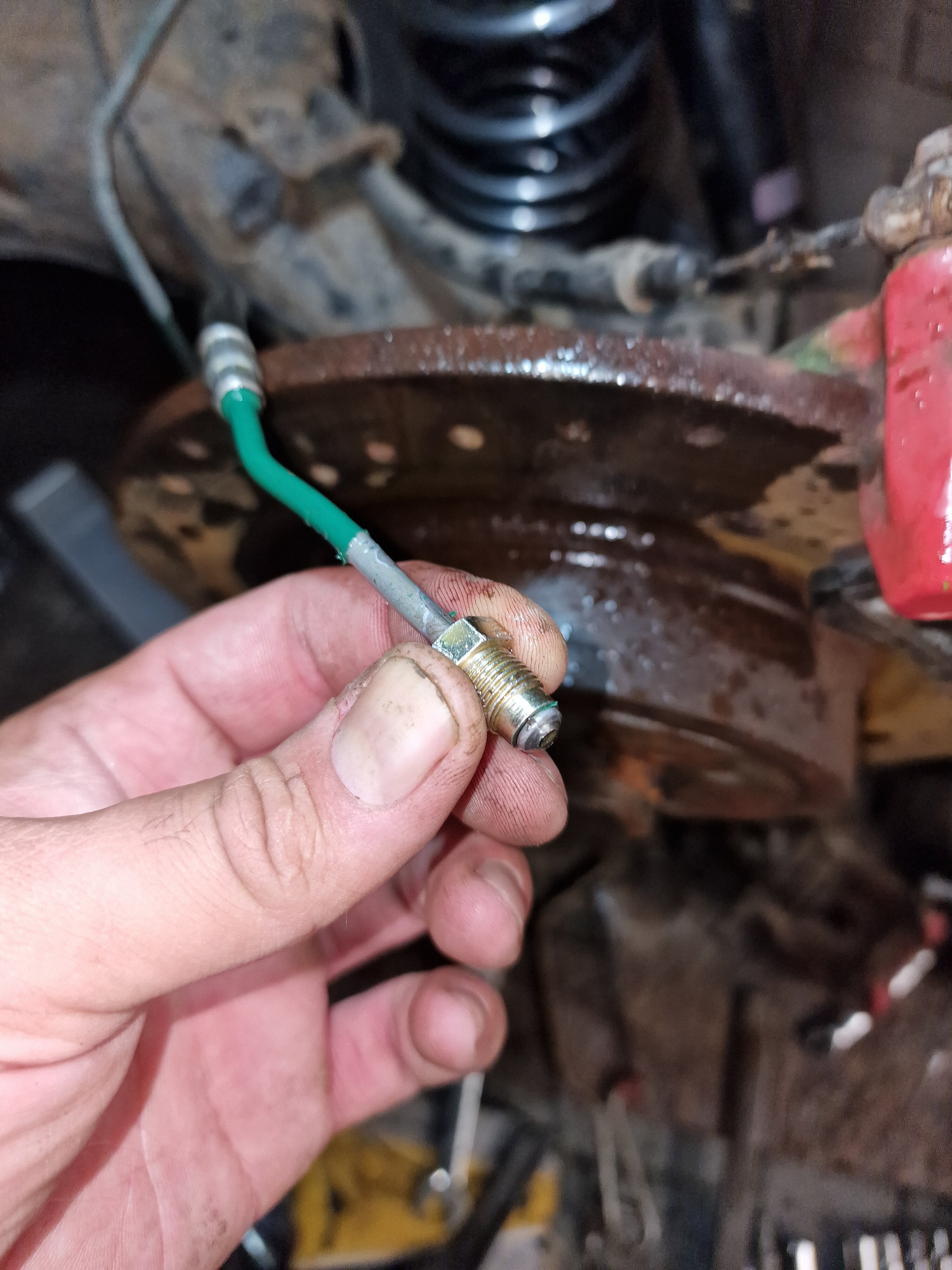

New shocks, cooksport springs and compbrake top mounts fitted. Retained oem bump stops and dust covers off the original shocks.
Fitted.
See how much neggy camber i can get with these.

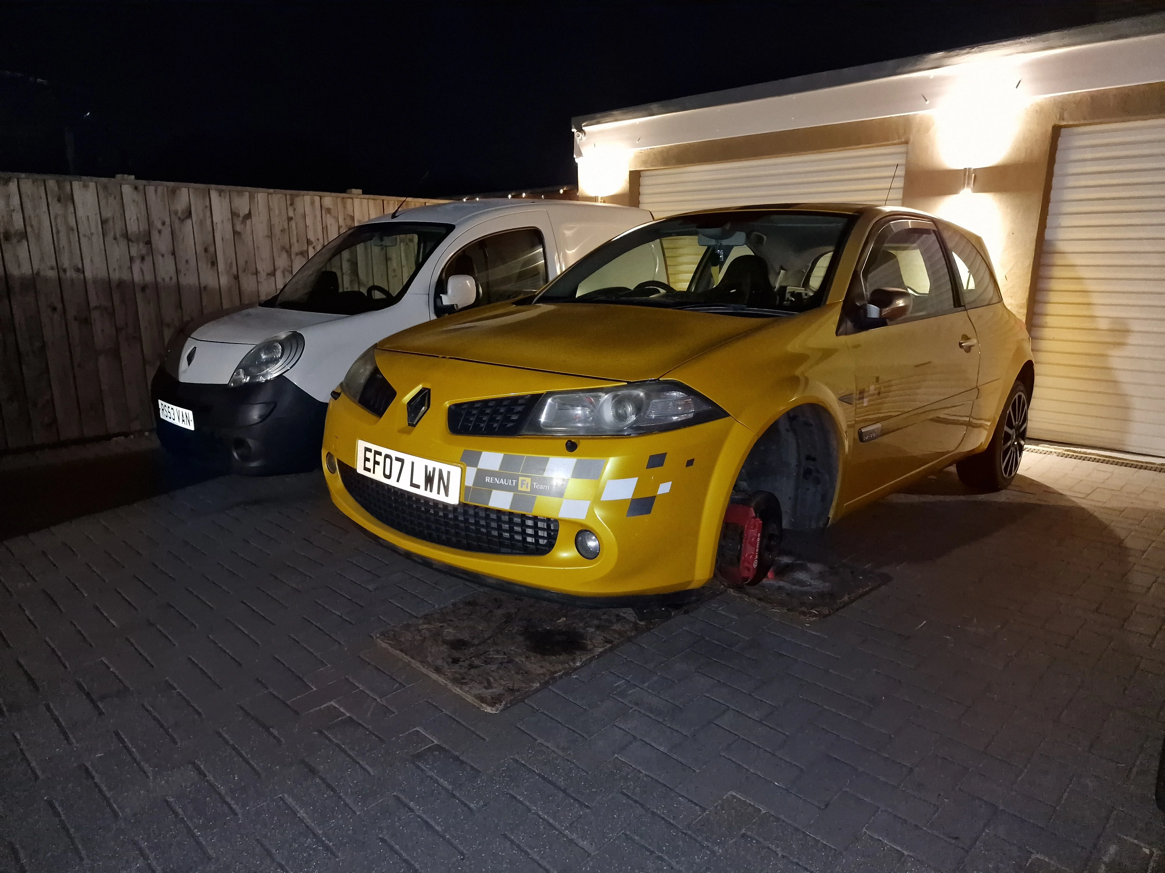

Passenger side took me about 2.5 hours after pissing about with the driveshaft.

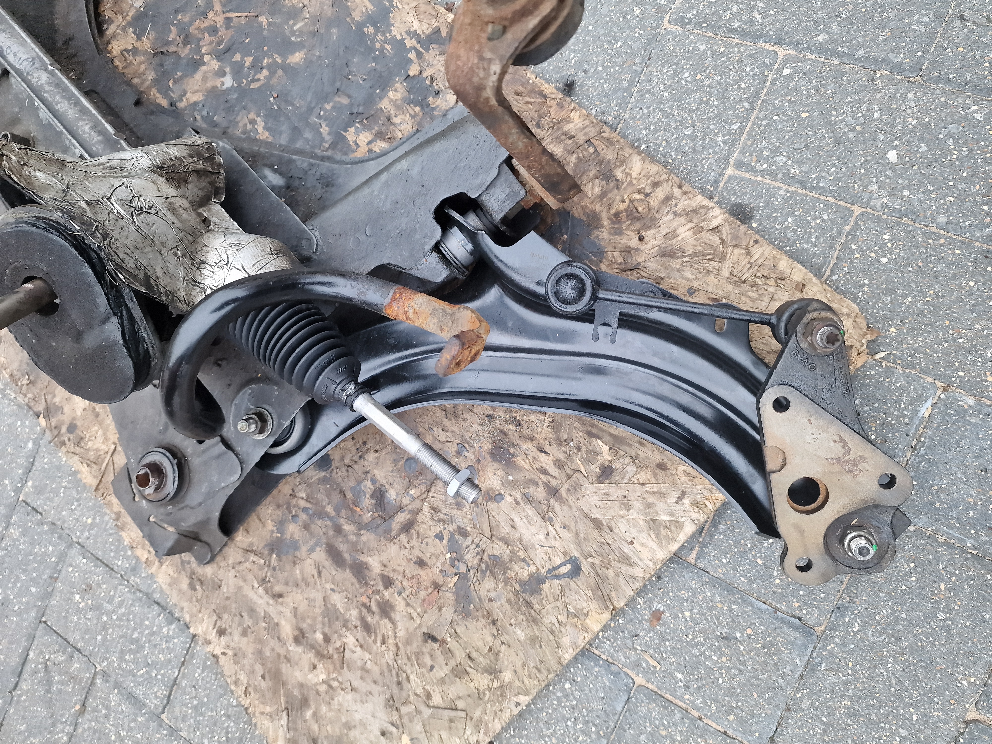

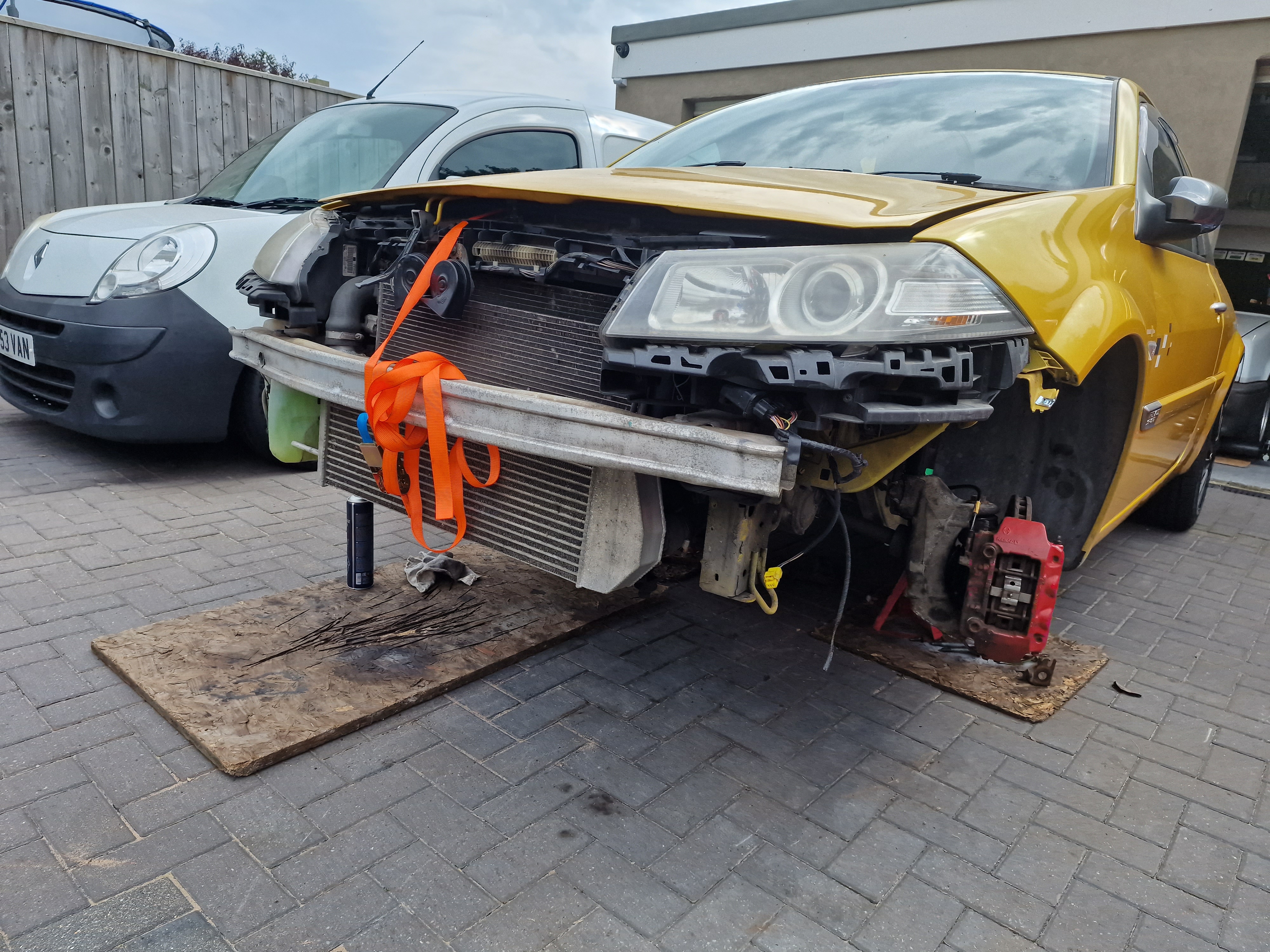

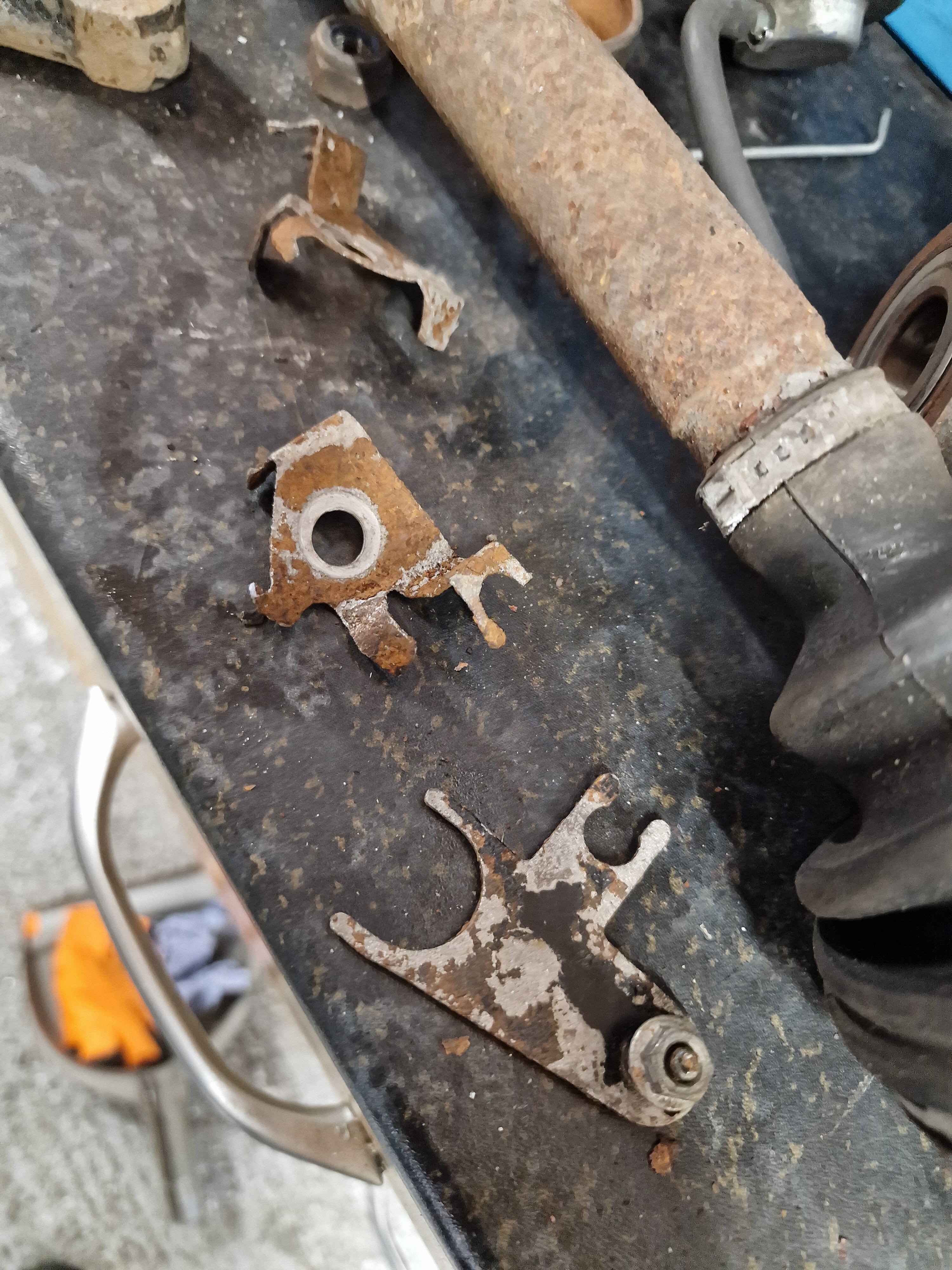

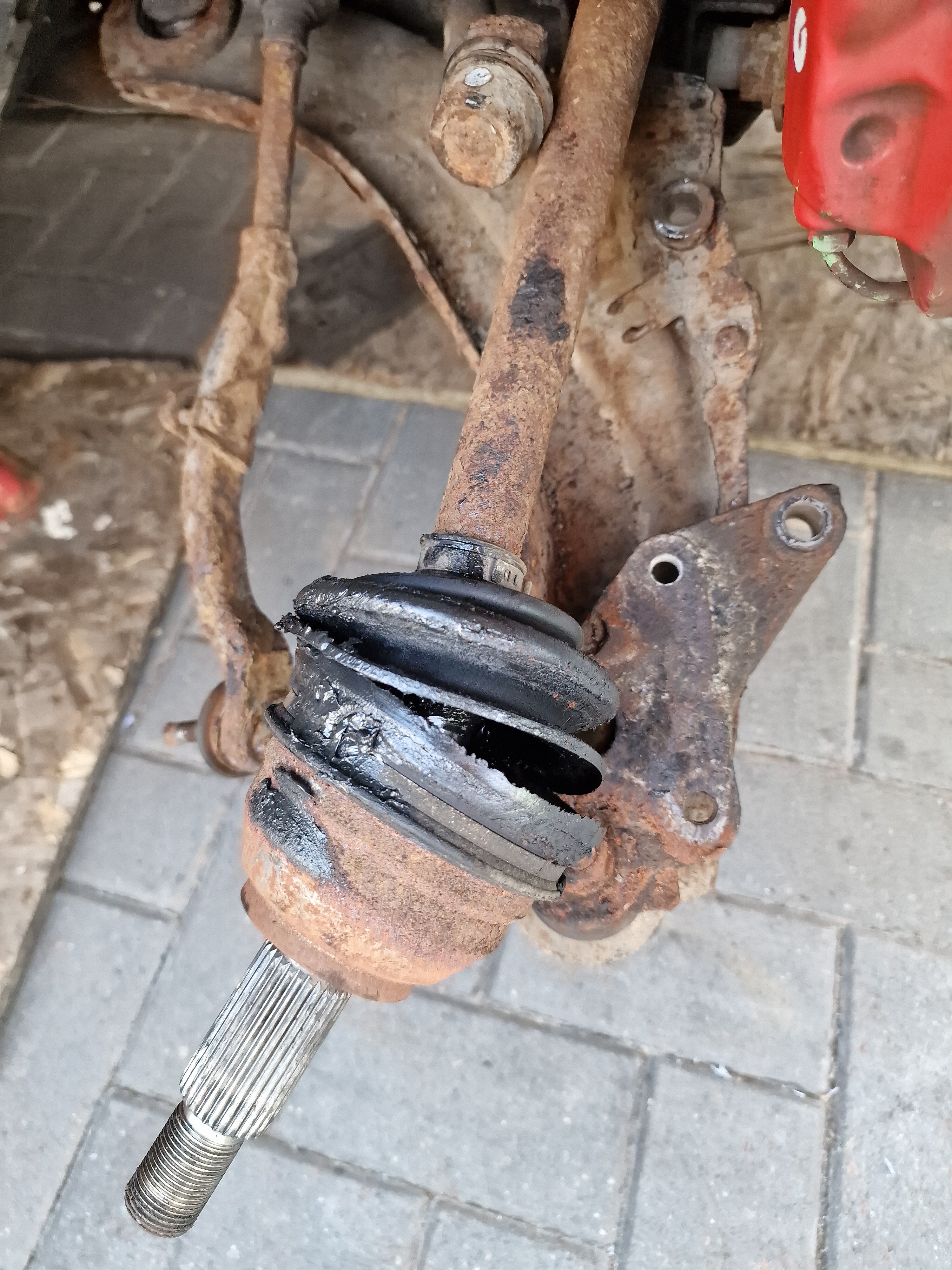

Started drivers side. Everything fooked and proving hard work. Both cv boots shot, anti rotation link shot, droplink shot, balljoint shot, play in wheel bearing, tie rod and outer shot, bushes shot. Nothing salvageable.
Had to even bin the alloy upright as the threads pulled out of the bolts holding balljoint plate on due to corrosion. I could timesert it but no point when good used available.
Losing the will to live at this point so give up for the day, it had to get worse before it gets better.

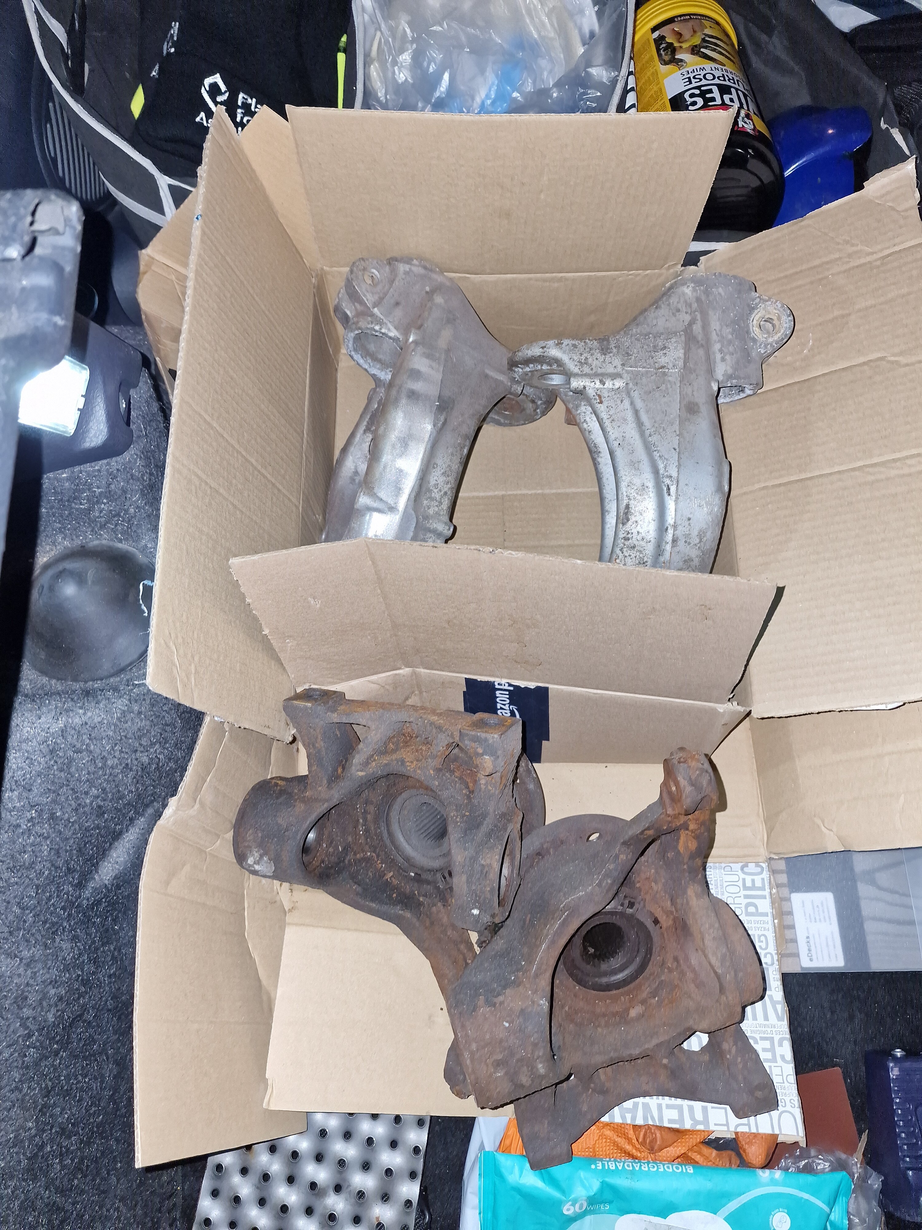

Sniped a pair of hubs off fb marketplace in South Shields approx 45 mins away. Collected Sunday night.
Good used o/s driveshaft in stock to save boot replacement.

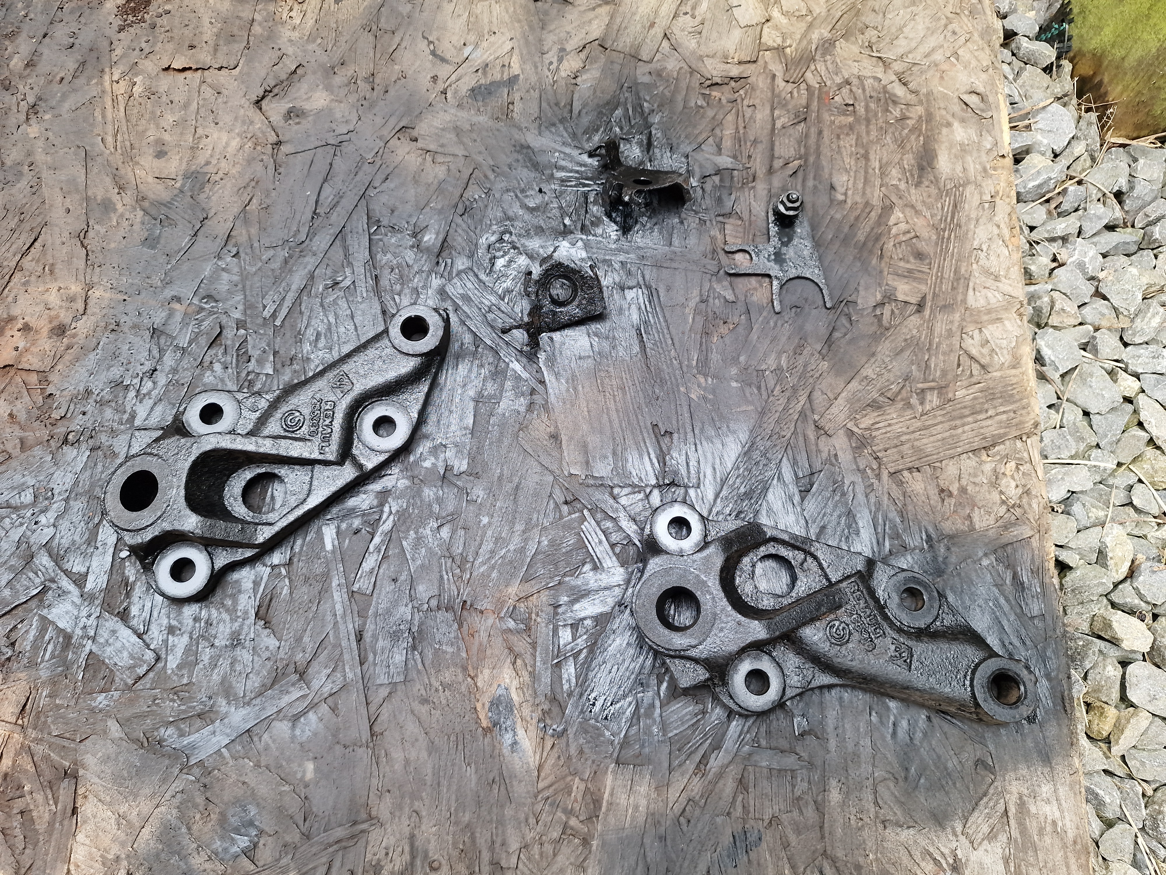

Current state of play. Swept 3x shovel full of rust up!
Speaking of rust ive been derusting. Citric acid and water mix.
Looking good. Not concours so just getting the thick off and a quick coat of spray.
Hopefully get drivers side boxed off soon and subframe off and done at the weekend.

I reckon these are the original suspension bits. Shocks seemed to work ok too but i couldnt fit new springs to them. Luckily its just bolt on rusty parts floorpan looks great.
Managed an hr today.

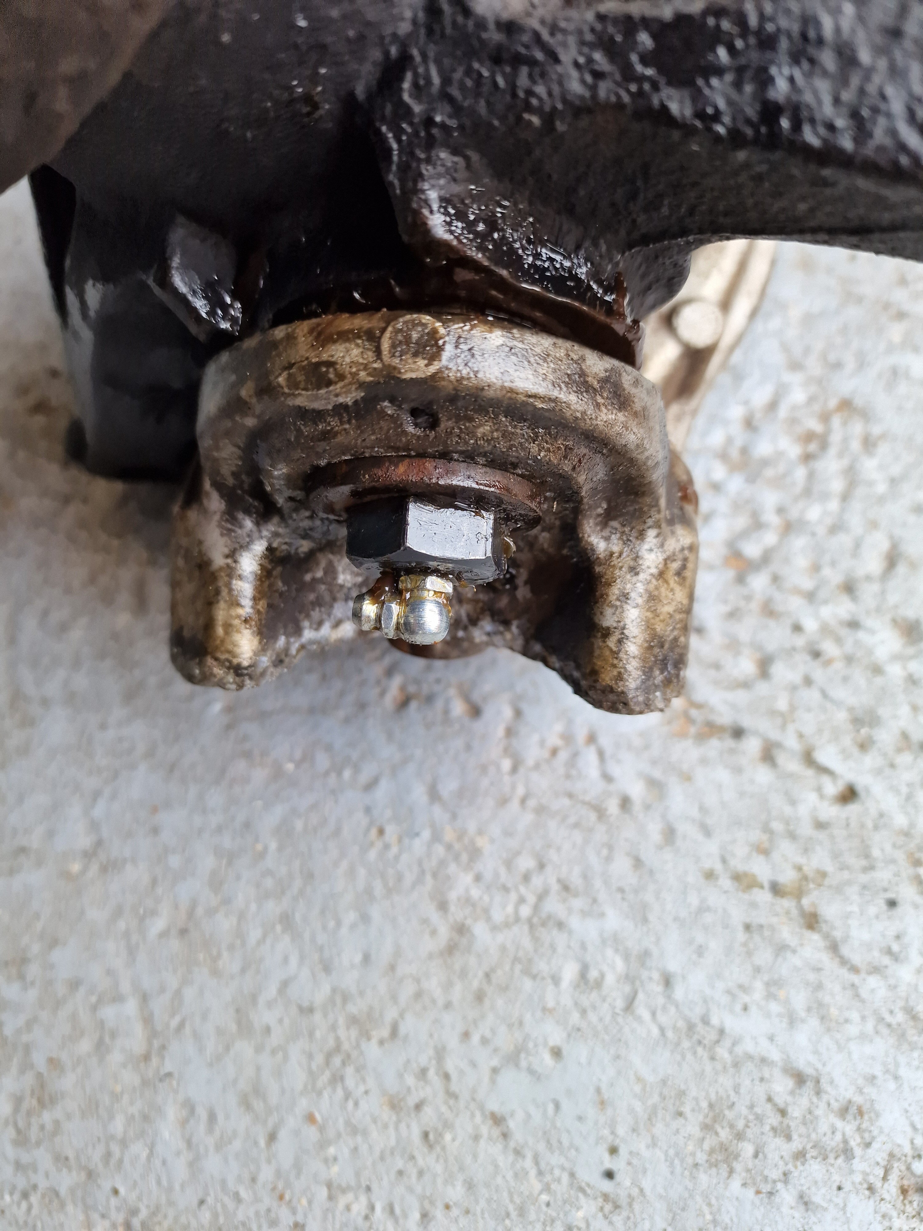

Built up the new drivers hub with new swivel bearing. The insert was reused as in ok condition.
Quick lick of paint.
Grease bolts fitted. These are a great bit of kit and make maintenance easy, The swivel bearings arent really sealed properly so the grease gets washed out. Fitted them to all of mine.

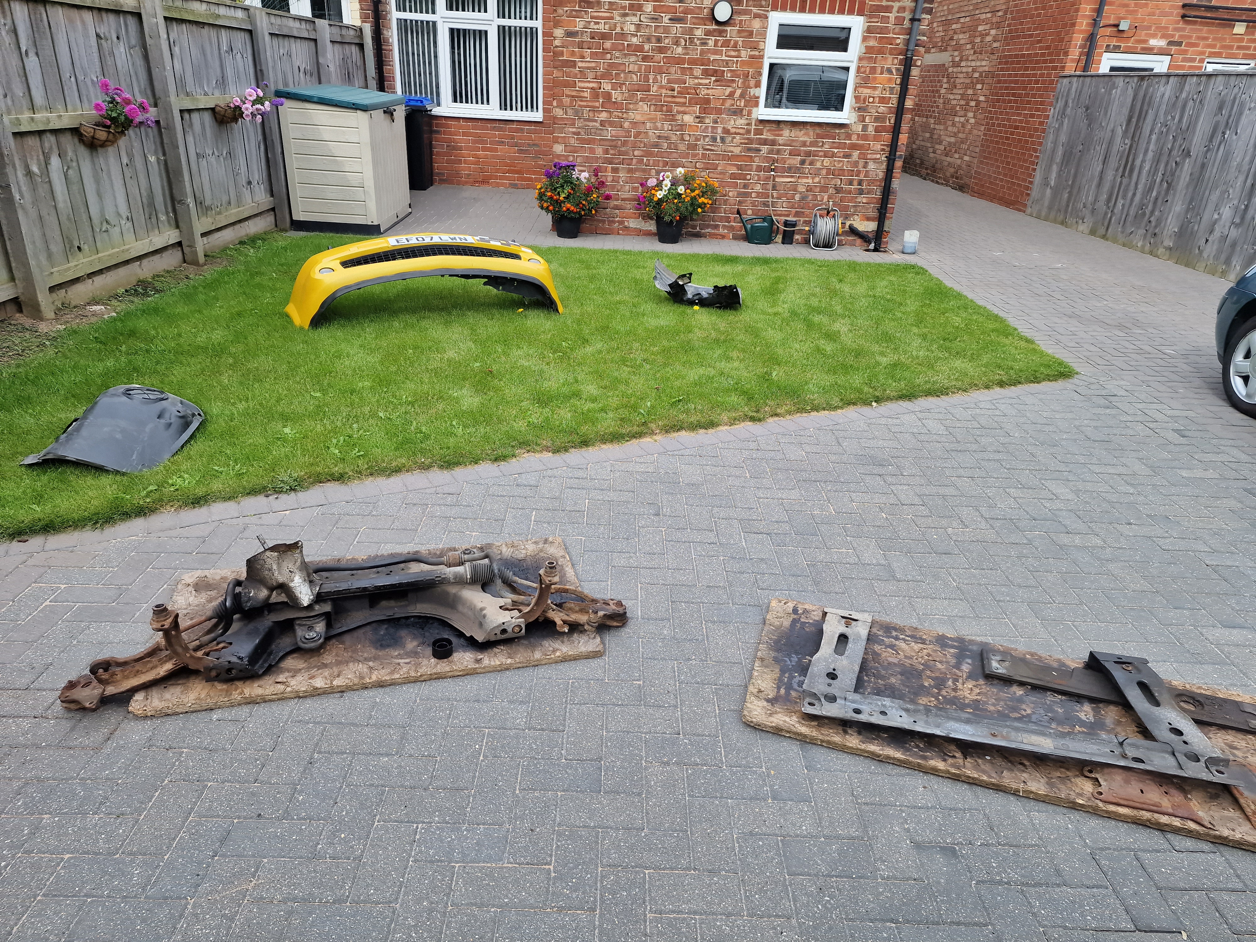

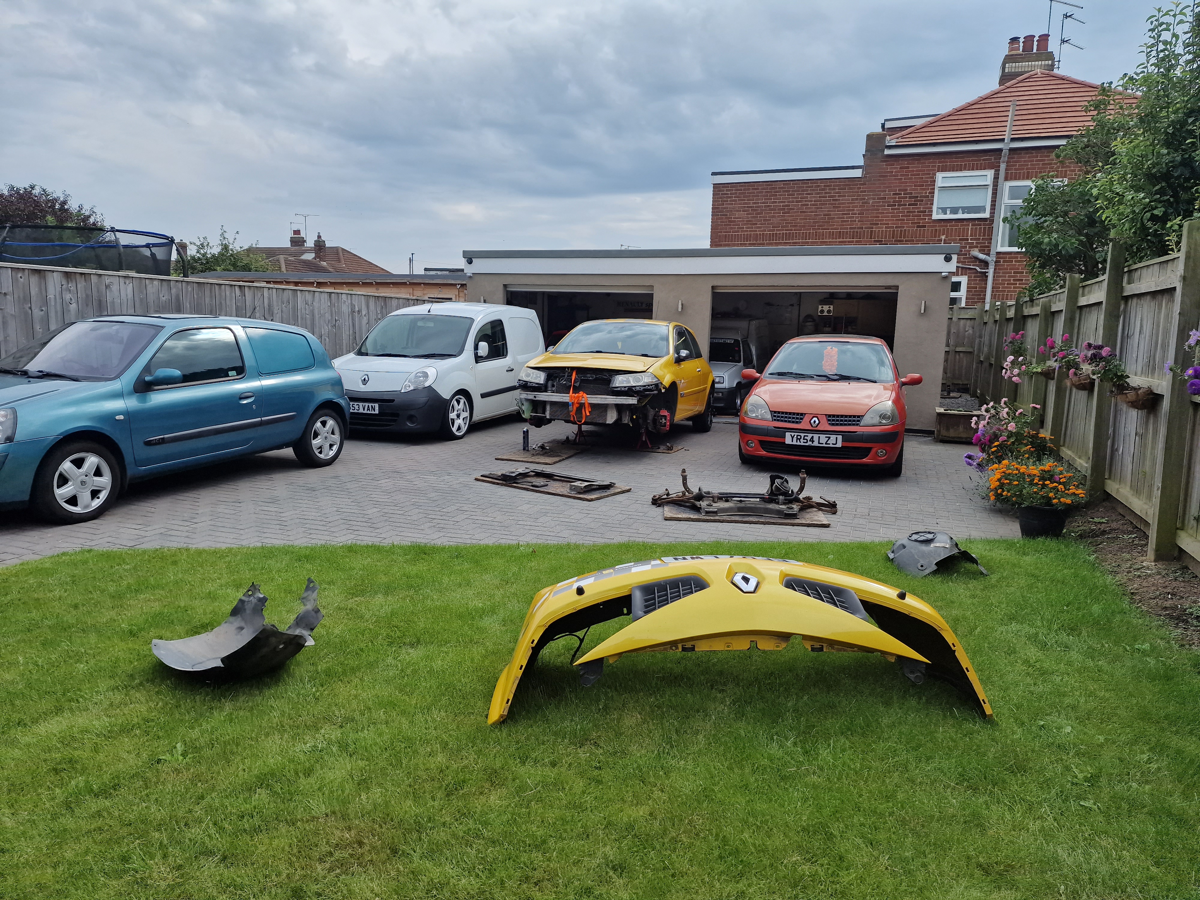

Updates
Had a good day on the hovercar yesterday as named by @SteveC_1879 :LOL:

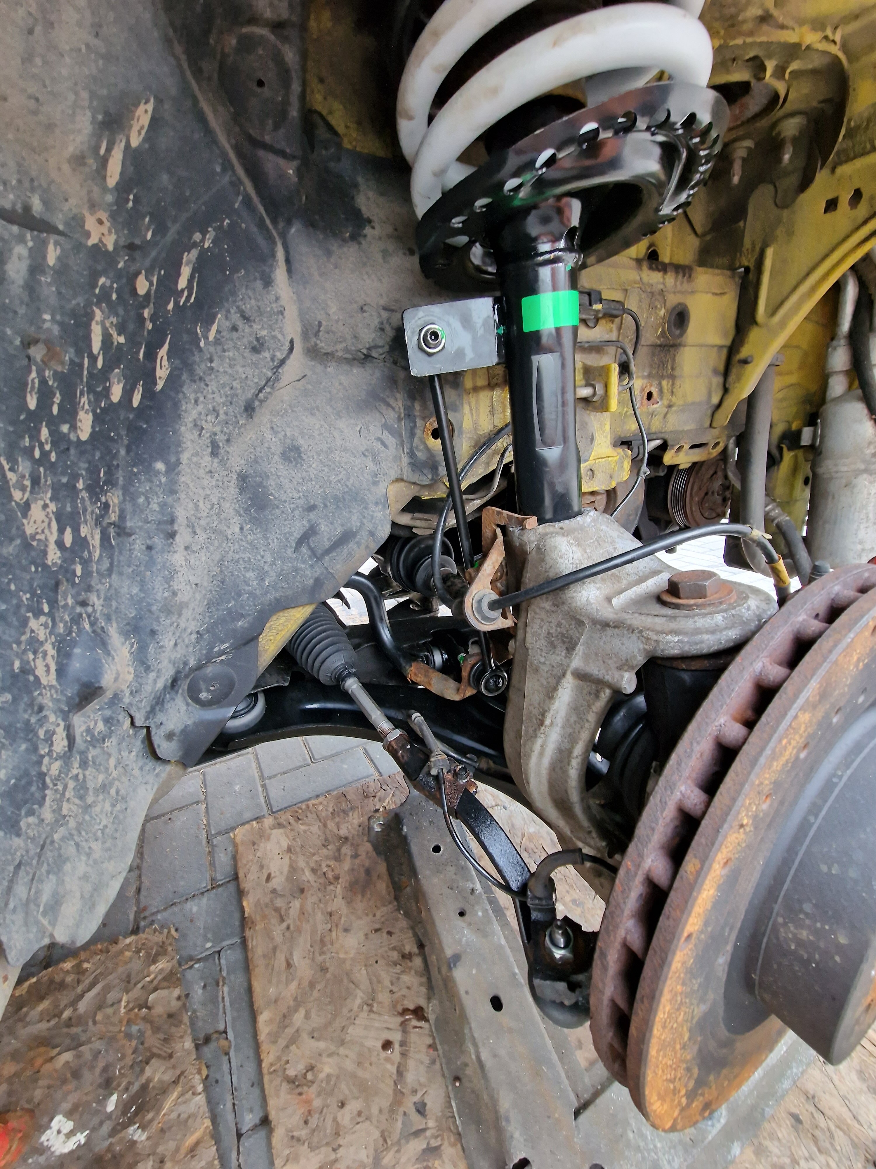

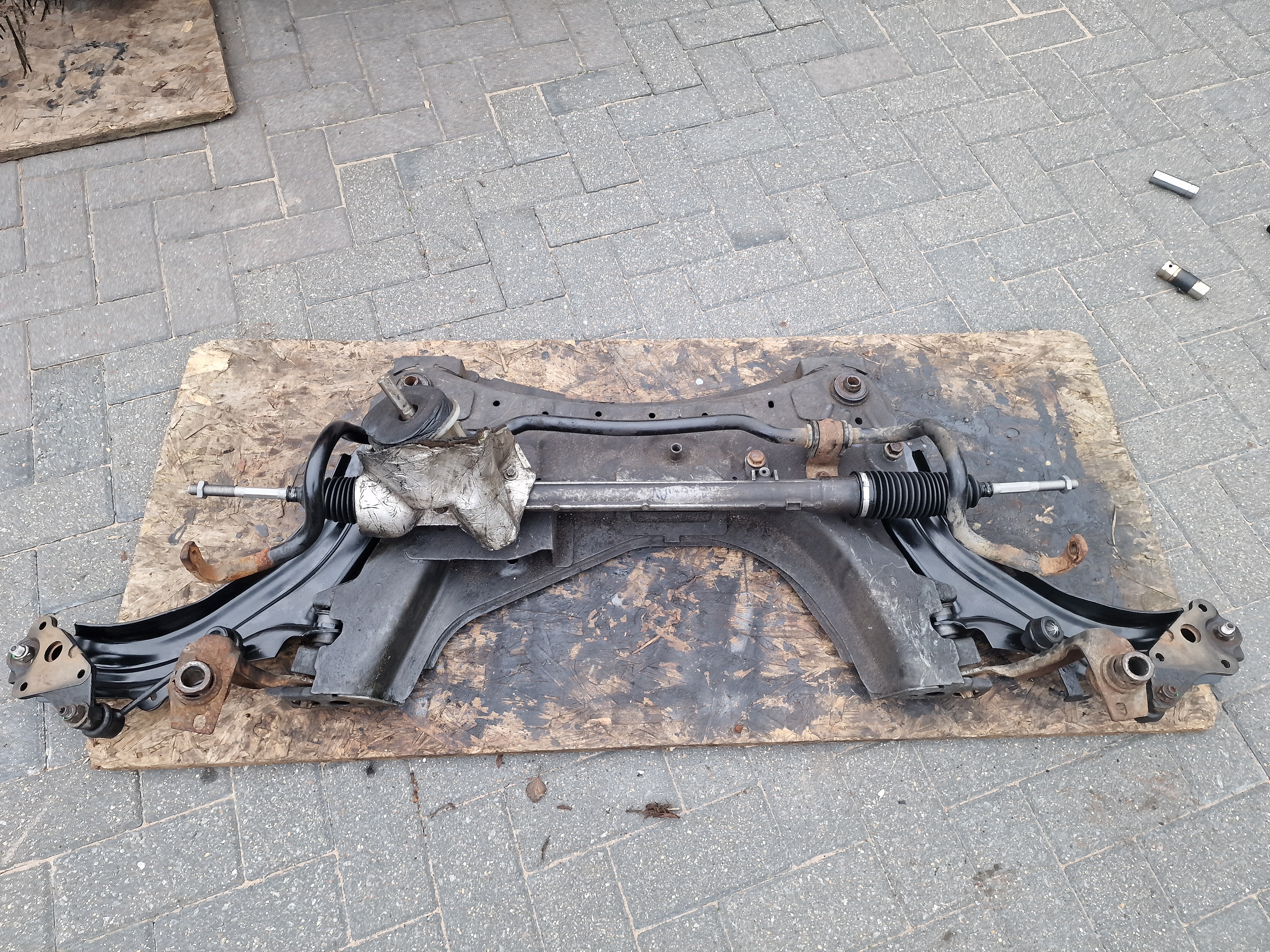

First job was to fit drivers side strut and hub. Then get stuck in and get the subframe off.
Gear all over.
Subframe area did not reveal any nasties. Can see people have been here before as the bolts werent particularly tight.
Needed to finish off my modified lower arms to continue the rebuild. Going back to earlier posts i am using quality aftermarket delphi lower arms off a povo spec as oem ren arms for rs are NLA.
The pressing is more or less identical but needs the balljoint changing for 2.0 espace, and a 16mm hole drilling for the anti rotation link.
I done some measuring on the spare used arms i have in stock and made a simple jig out of a piece of 50x5mm steel i had lying about so the drill would not wonder off target.
Easy work with cutting fluid. Bit of black rattle can on the drilled holes.
Balljoint plate and anti rotation link fitted and torqued to spec.
I then dug out a lower mileage subframe and steering rack off the red r26 i broke ages ago. Subframe was bare so had to swap arb and fixings over. Fitted new oem renault inner tie rods and torqued all the fixings to spec.
The subframe support brackets were looking terrible, absolutely rotten as per 90% of megane 2 are. Wirebrushed fcuk out of them, bilt hamber hydrate 80 then a coat of bedliner paint. They will last a bit longer but if i get chance of a better pair will prob change them. I know one side is NLA.
I managed to get the subframe on and torqued up, hub balljoint plate bolts refitted and driveshafts torqued then the torrential rain started.
Just trackrod ends to fit, change rad for good used that i have in stock, refit radiator subframe, fill gear oil up and it should be back on its wheels.
Then the rear to do.

Got trackrod ends on through week and refitted abs sensors/cable holders.
Everthing new
Lower dogbone mount was kaputt so renewed. Ive alson fitred yellow powerflex insert to top engine mount. Checked cambelt whilst there and its got a newish gates belt on. But might change that soon so i know its right.
Moved onto rear next.
Powerflex rear beam bushes fitted.

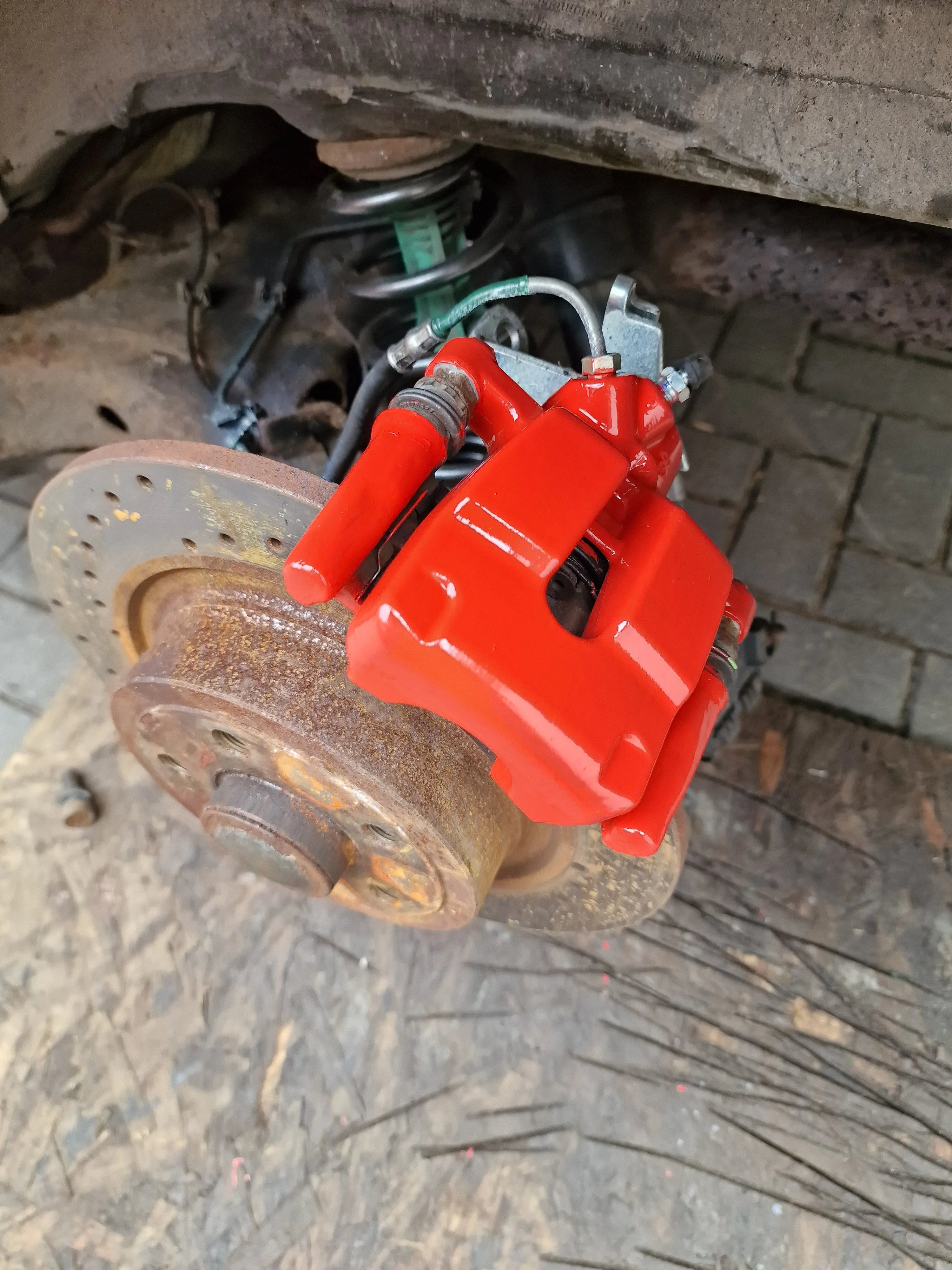

Rear passenger side caliper was sticking. Changed for a new caliper - needs painting red to match. Pipe fitting was stuck and got it off but new caliper was in wrong orientation when fitted.
Ended up cutting the union off, new one on and flared the pipe in situ. Plenty on the pipe to allow this.
Fitted
Refitted handbrake cable, bled and handbrake mech is still sticking..old caliper werent grear but i dont think it was at fault fully. New cable ordered, need to investigate condition of guide tube as they love to rust out causing issues like this.
Got it back on its wheels and taken for test run.
Sits nice on the cooksport springs.
Test drive went well, drives great. Geo a mile out as expected.
Forgot to say had a carry on with the radiator. Rad was leaking so changed it for used oem that i had in stock. Id done due dilligence and filled it with water to check for leaks and it didnt appear to leak? Flushed cooling system throughly and a load of shite came out. Filled with coolant and a fountain of type d comes out of one of the top bars on the rad!!
Dug out the aftermarket meg rad i used on the kangoo and fitted that and filled with type d and bled. Leak free. Id like oem rad ideally so will try and sniff a new one out.
Took it in for geo yesterday. Was miles out as expected, interestingly thrust angle was a mile out so we slackened rear beam bolts off and adjusted it to get it right.
action shot
Compbrake mounts work nice on oem dampers/cooksport springs. Max of -2deg negative camber and slightly more positive castor. Ten mins of toe out overall.
Birds eye view
Works again and drives great like a good r26 should. Happy Brigsy

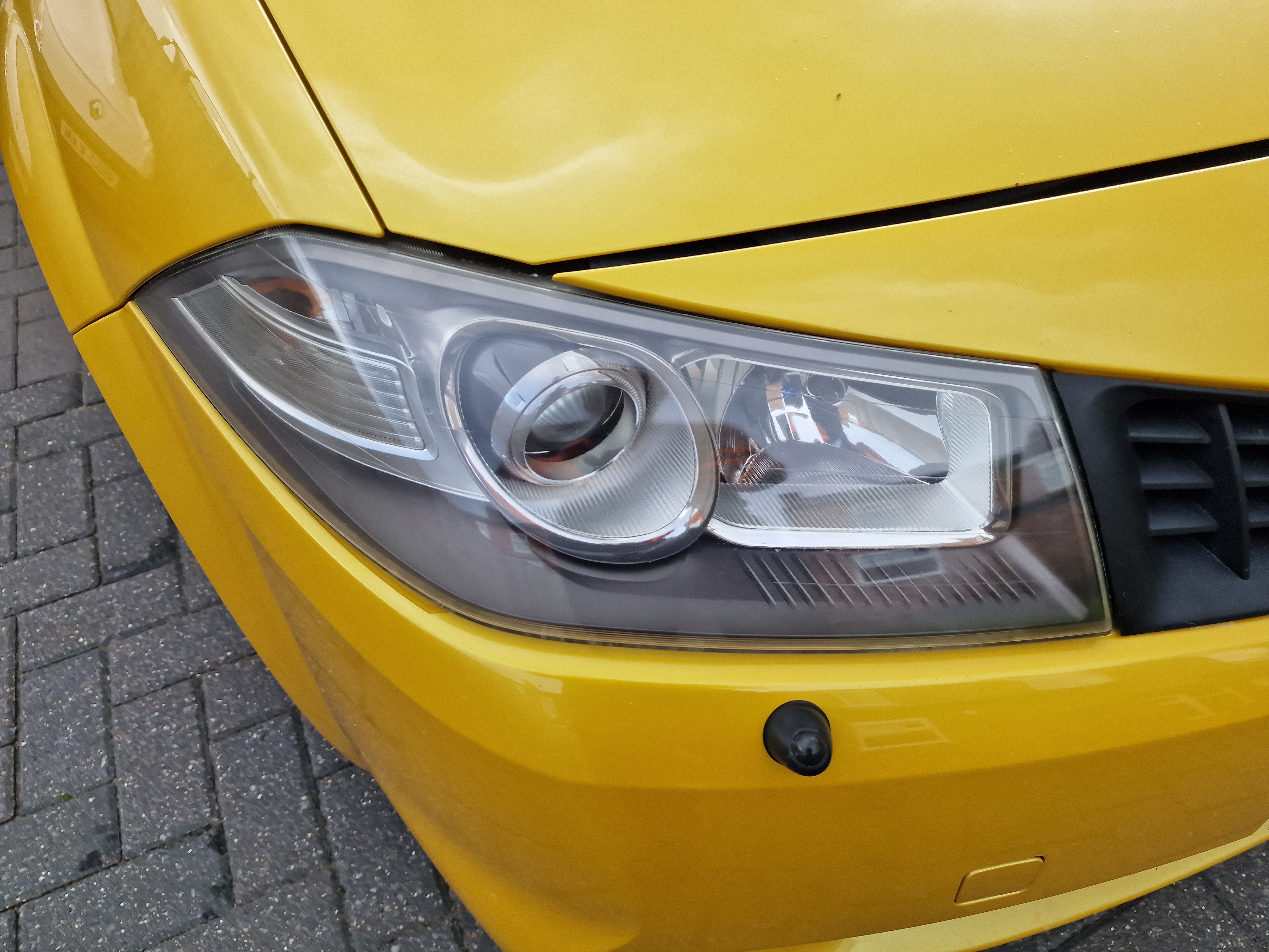

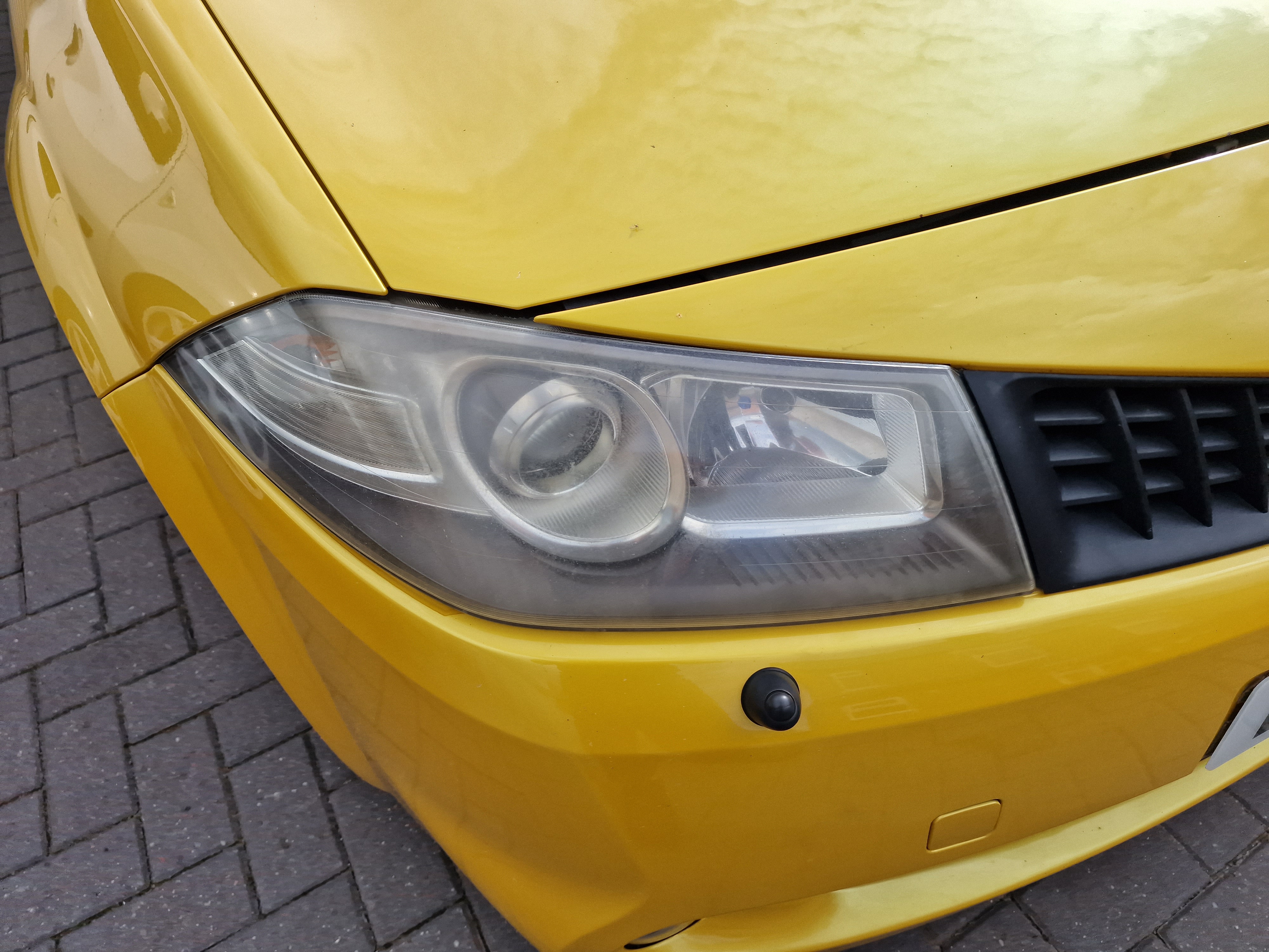

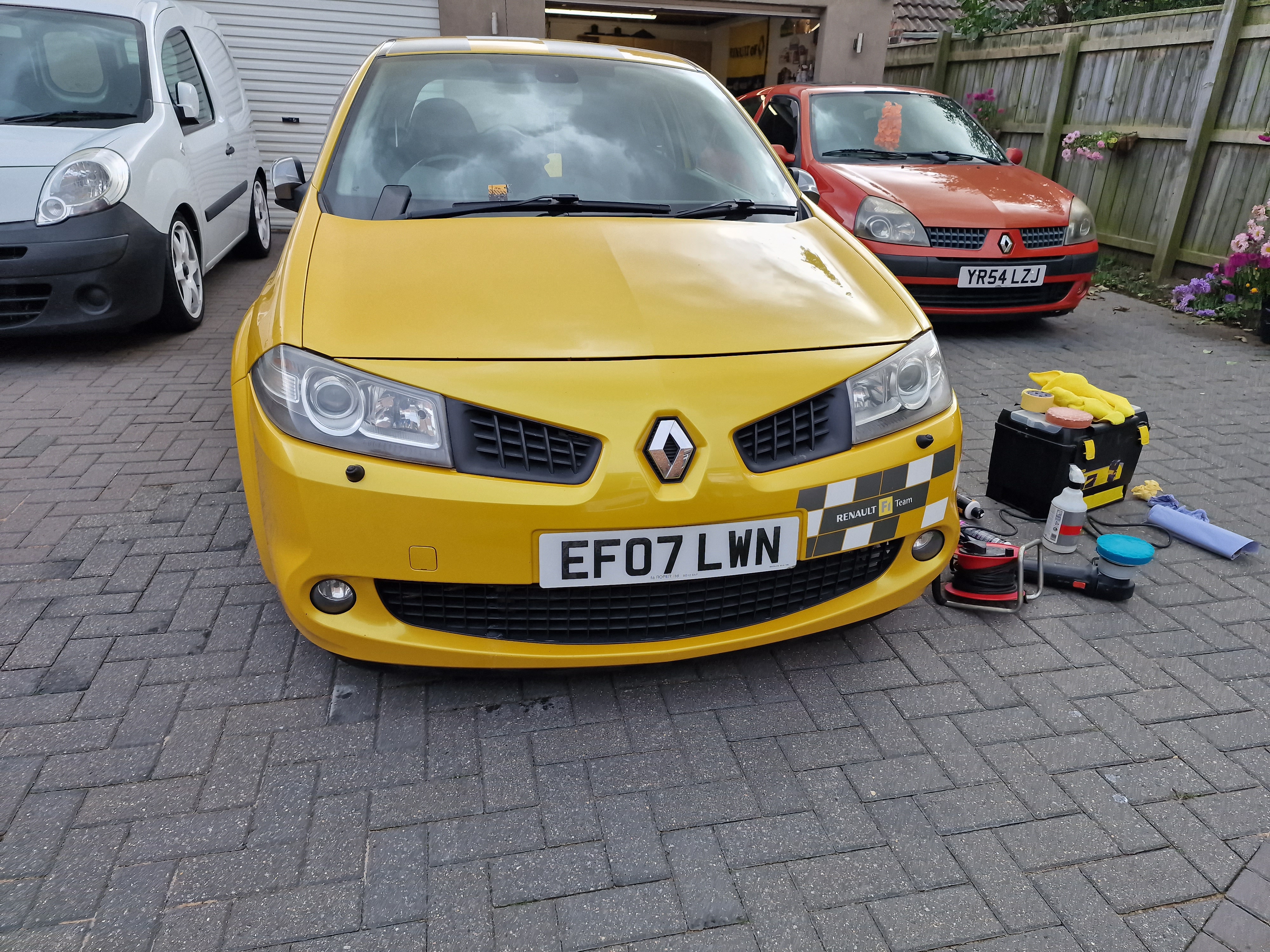

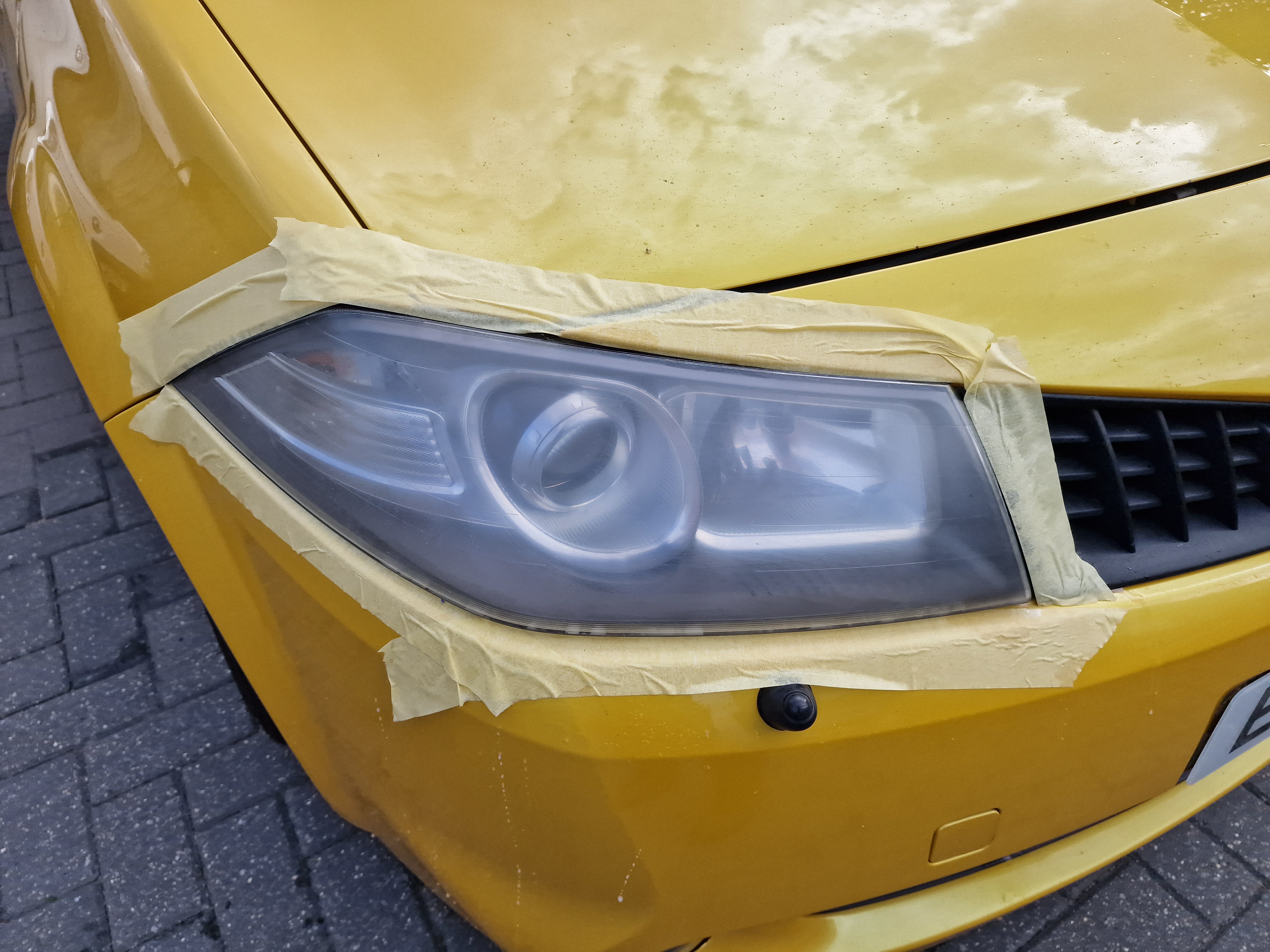

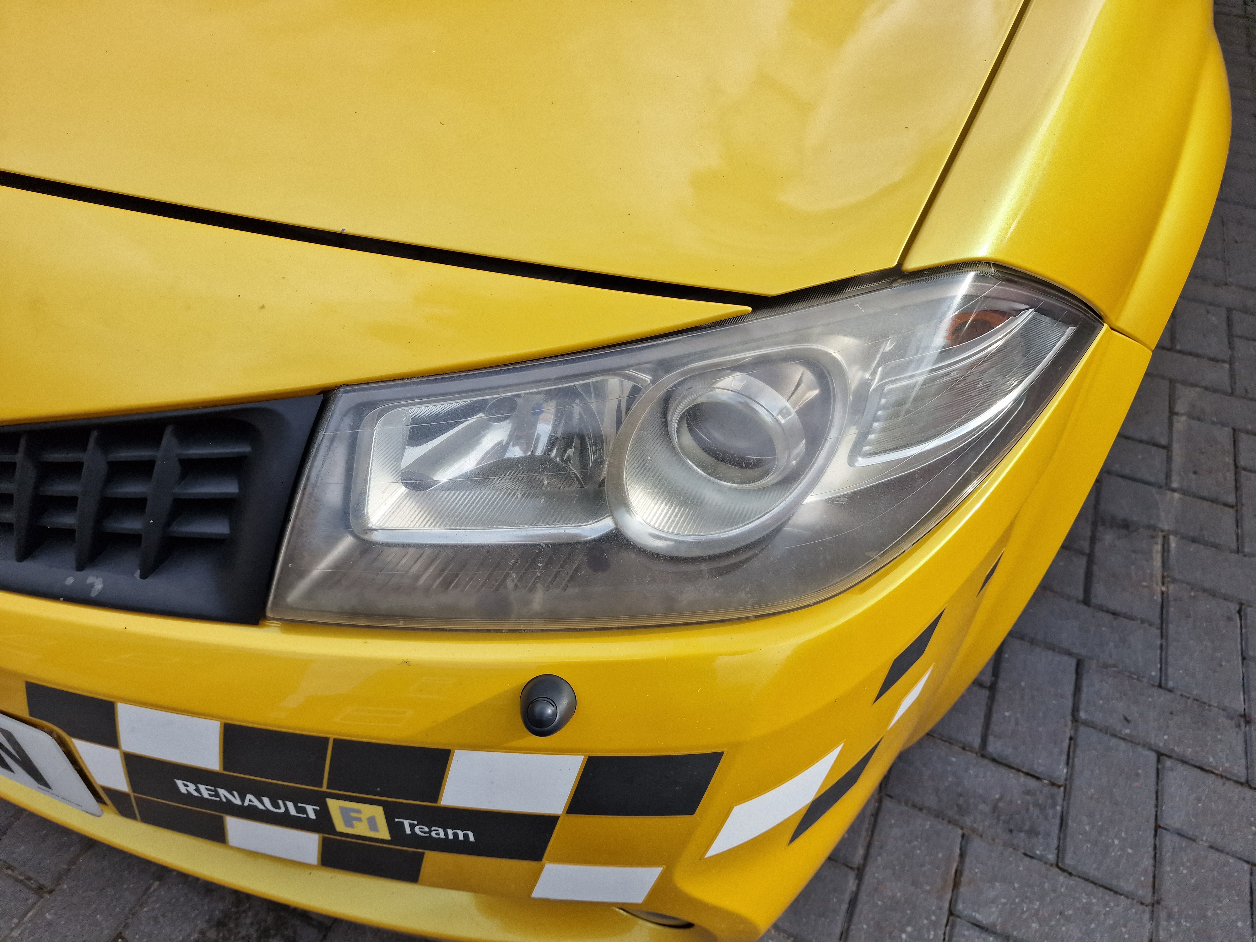

Snuck an hr in this afternoon. Headlamps were looking a bit cloudy so give them some tlc.
Before
Mid way after wet sand
After a few passes with the DA.
Pissed down straight after finishing so not coated them yet, ill do that tomorrow.

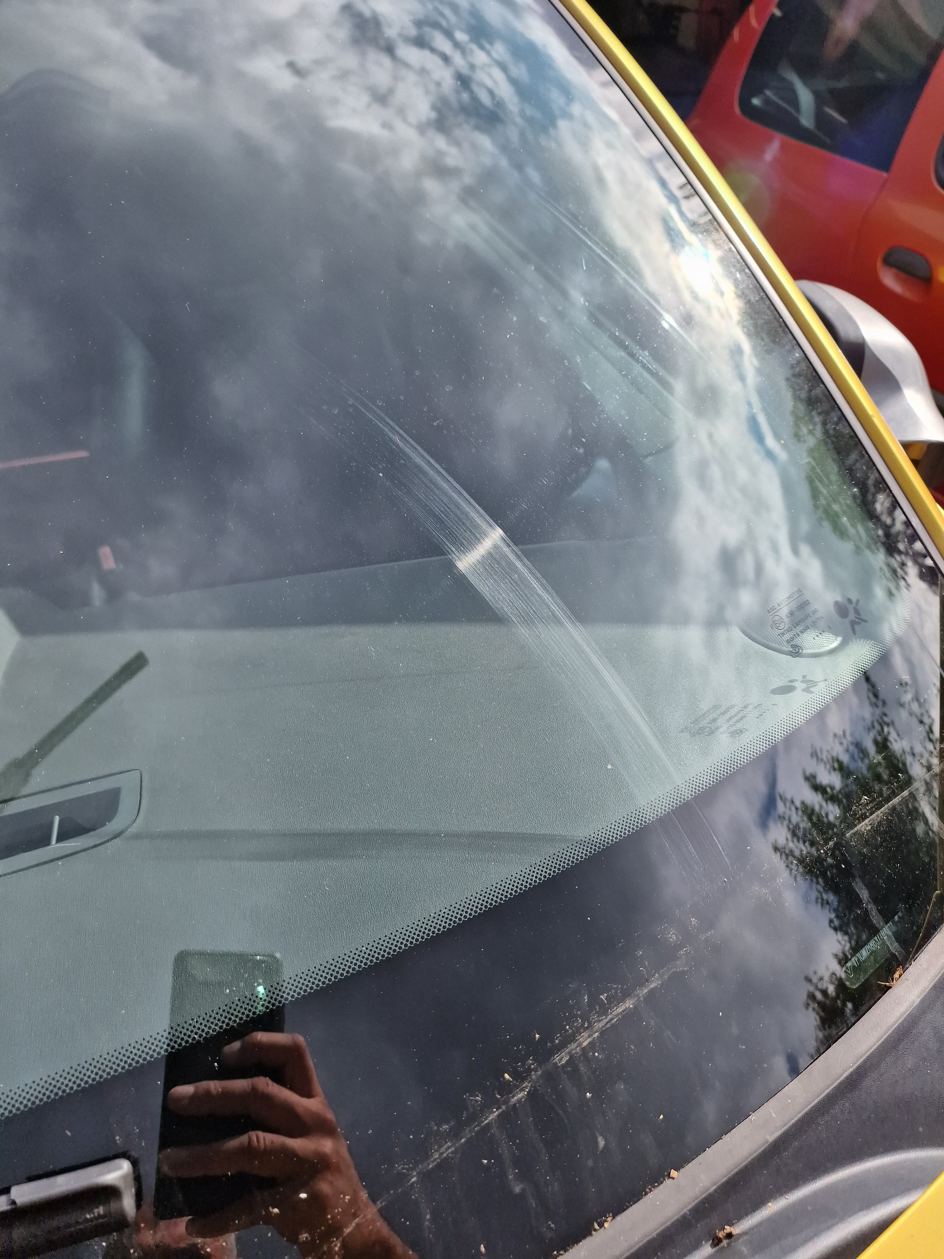

Also the last fuckwit who fitted the wipers bent the arm somehow so it was rubbing the windscreen. Ive bent arm back and replaced wipers but damage to screen is done.
Ive wet sanded the screen and tried an agressive cut/few passes with the da. Its slightly better but not great. Not sure if ill have to accept it as it is or get screen replaced.
A few years ago it would have got a clout with the hammer and insurance claim. Ive already got a windscreen claim logged from a few year ago as its declarable now so cant go that route again sadly.
Its not the end of the world though i can tolerate it for now.

Sat update.
After being awaken at 730am by the postie knocking on the door with car parts decided to do a bit.

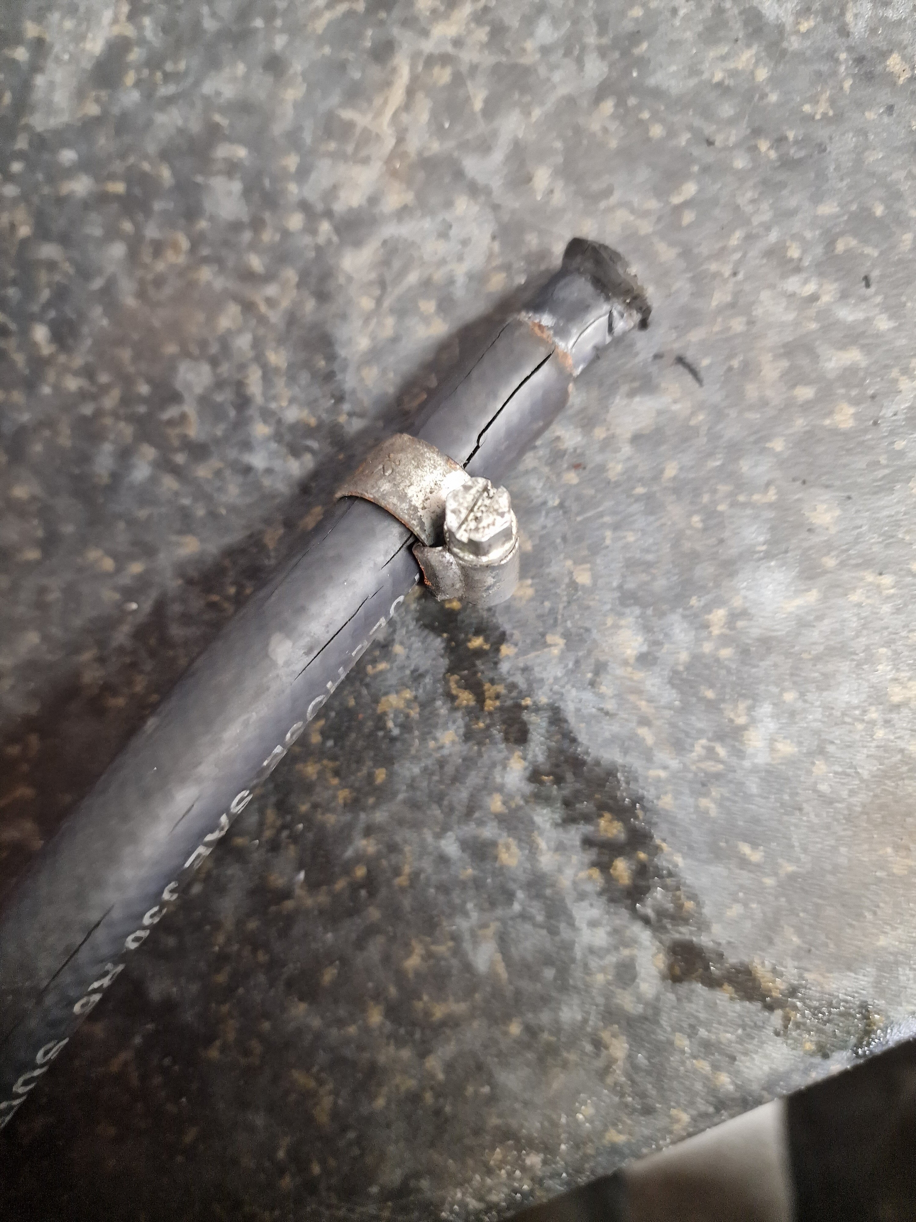

First job - fuel hose. The short bit of plastic pipe from fuel rail to metal section had been replaced in the past for rubber, common repair for meg when original plastic pipe fails.
Id noticed that the rubber hose had degraded and was cracked all over. Not shocked to see this as the quality of rubber fuel hose currently is very hit and miss.
Fire hazard waiting to happen.
Replaced with quality Cohline 2240 R9 spec fuel hose. From reading its good stuff and lasts. Not cheap for what it is either!
Also replaced washer bottle filler neck as it had split causing more to go on the floor than in the washer bottle.

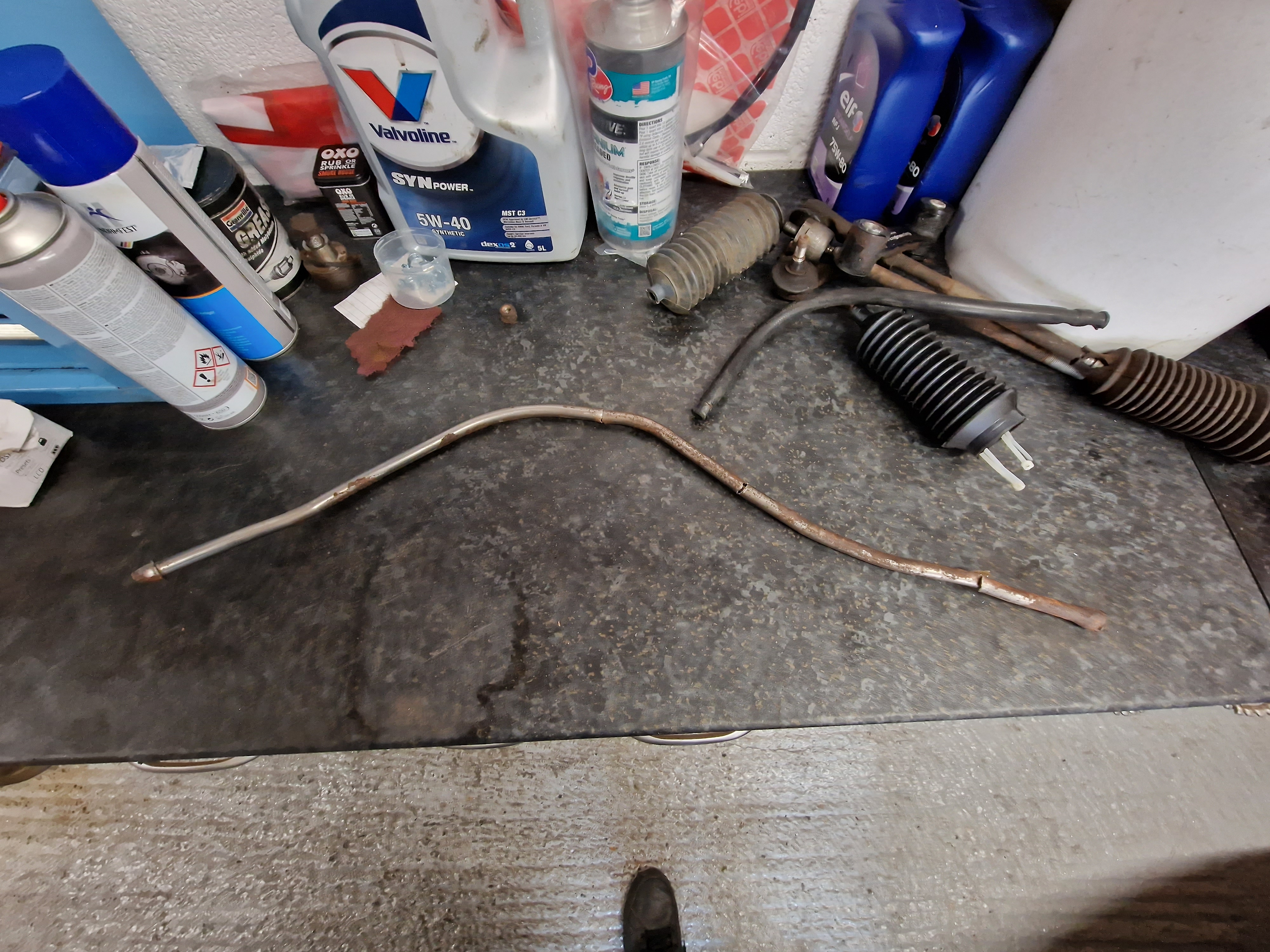

Next job was replace passenger side handbrake cable as it was sticking on with use. Easy job half hour? Pulled it and it just jammed straight up solid in the guide tube, as its rotten internally.
Que removing some interior to access it and braying fcuk out of the cable which snapped the guide tube. Guide tube is NLA so itll be a breaker job or make one.
Painted new rear caliper with Hammerite. Not a bad match.
Im going to get some alloy pipe and see if i can make a guide tube even if only temporary fix.
