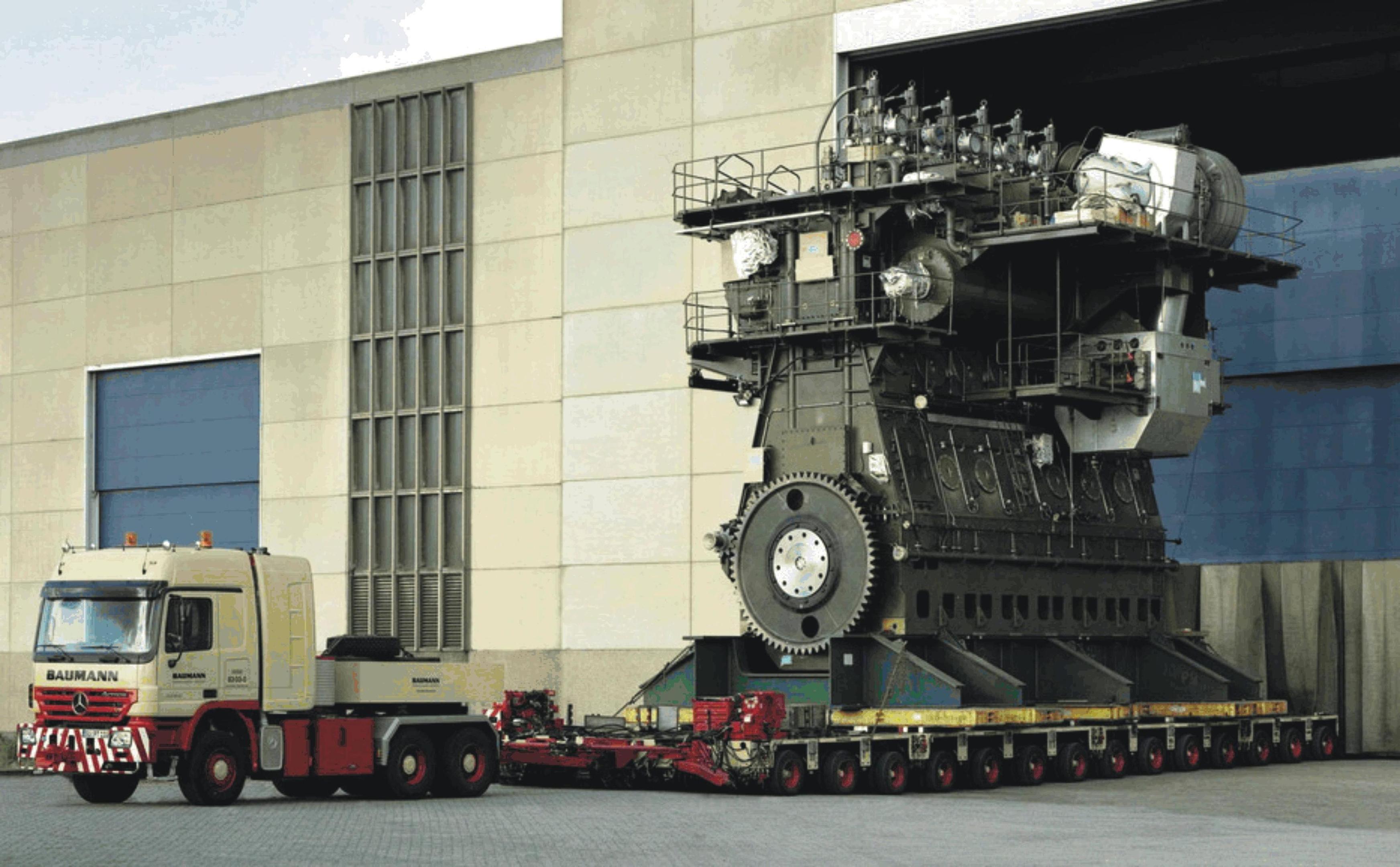

Sorry for being stupid but which meapgane is this getting shoe horned in?
bozothenutter
now this is a turbo...
looks like it is compound too.....:p
Wärtsilä-Sulzer RTA96-C

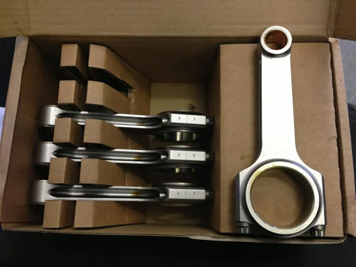

Rods arrived today. Made by Farndon strong enough for 250hp per cylinder minimum!
  182/RS2/ Turbo/Mk1
Fair old difference then going from 1.55 to 1.66
Still not amazing for mega high rpm, but obviously unless you start making the block taller you are just so constrained by the space renault have given you, so I think thats good considering.
What size bore are you going for?
I assume you wont want to be doing 84mm just cause of losing too much material out of the block so will stick at 83mm?
Or are you going to liner it so you can get away with a little more capacity?
