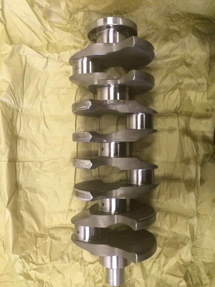

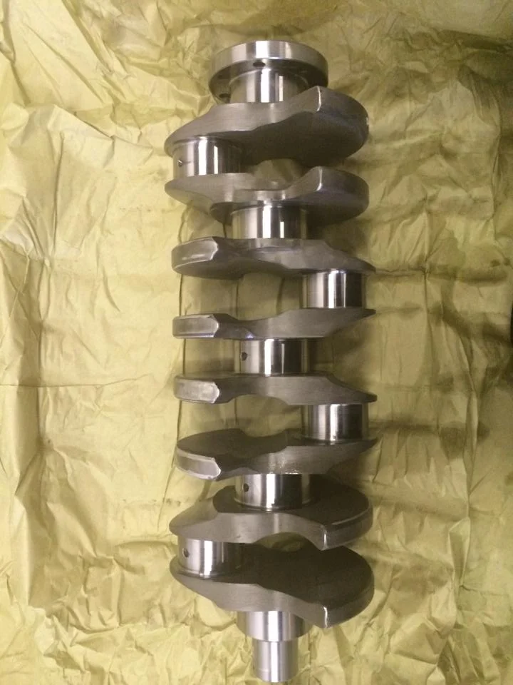

Crank is here at last!
Waiting for the block to come back and need to go collect the diff so I can have a sleeve made.
