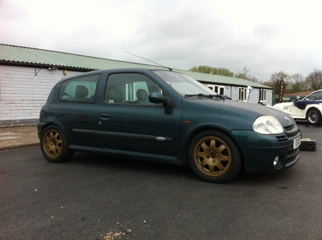

Picture of offending killer wheels of almost death....
