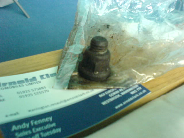

Driving home last night I heard a big 'clang'. Was pretty loud, at first I thought some c**t had thrown something at the car so I got out had a look round but no one to be seen and no apparent damage to the car, so just headed home. Anyway this morning I saw this lying on the ramp up to my drive. I quite 'geekily' recognised what it was straight away. Checked what I thought it was off the car and low and behold...It was missing!
Medal for the first person to guess what it is/where it's from!
^Bingo!
James and Stokoe

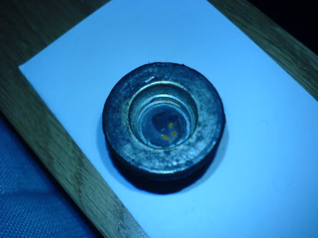

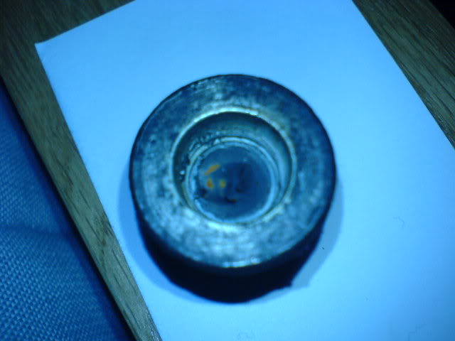

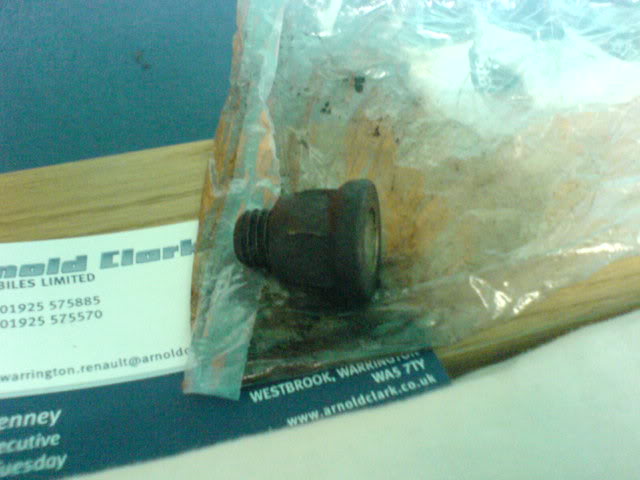

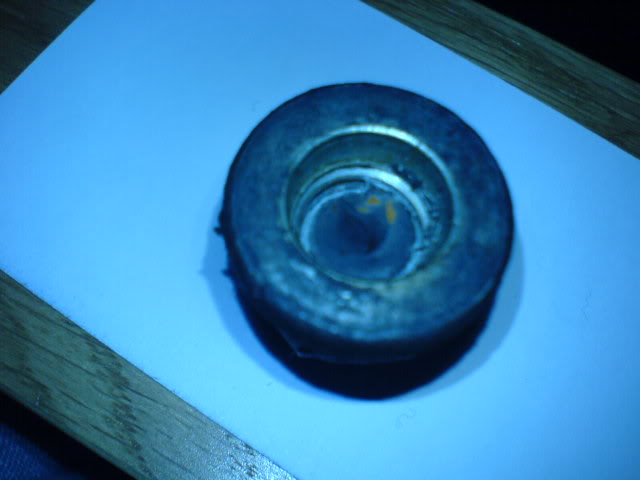

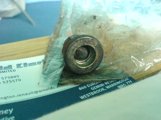

Completley sheared off, in half, inside the nut.

Any chance of a more detailed picture of the end of the bolt and the bit in the nut from the looks it looks like its got somehting in the bolt.
It might be the bolt was done totightetly I've cracked them before now when I torque them up above normal torque.
Could well of done it too tight I suppose. The bolt thread has sheared halfway inside the nut. The car has been lowered for around 2-3 months and it's only just happend now. 'tis strange!
Best pics I can do at the min with cam phone.
well the rust shows that the fracture has been happening for a while, and that it didnt break in one movement. My monies on over torquing as edde suggests.
Yep, that's what I thought with the specs of rust, must have been split and gradually deteriorated. Didn't notice the rust until I took those pics and the flash had lit them up, hard to see otherwise.
