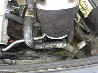

Hi, just after opinions on this
Pulled up at work the other day and noticed a little bit steam coming from the front grille. Opend it up to find what looks like coolant dried all over this pipe as if its been blown onto it. I can only presume its come from the top of the radiator? The fluid level has dropped a little but is still inbetween the max and min values. I have been driving about and it doesnt seem to have happend again. Any ideas?
Regards
I've heard of the fan blades warping and rubbing on the radiator fins, check for that? X
This. The fan mounting unit warps over time and brings the tips of the fan blades into the rad. Only needs to scrub off a mm or two and it's got a hole
Thanks folks, ill take a look tha morra. If it is the case a new radiator and fan yea? Typical, feckin MOT next couple of weeks haha
regards
Pretty much. You could get a new rad and shave some plastic off the fan housing but probably not worth the effort when you can pick one unit up pretty cheap. I've got a fan and radiator from renparts that I didn't need if you're interested. Used but genuine and leak tested etc before delivery
Doesn't seem to have happend again, strange, I will too it up when my coolant arrives and keep an eye on it. Is it a radiator with aircon u have?
regards
No worries. It did have but I used the condenser for my car. Didn't need the test but try wouldn't split it
Check your thermostat seal too. They can leak if a non genuine one has been used, and then drip over the block and plastics/pipes
