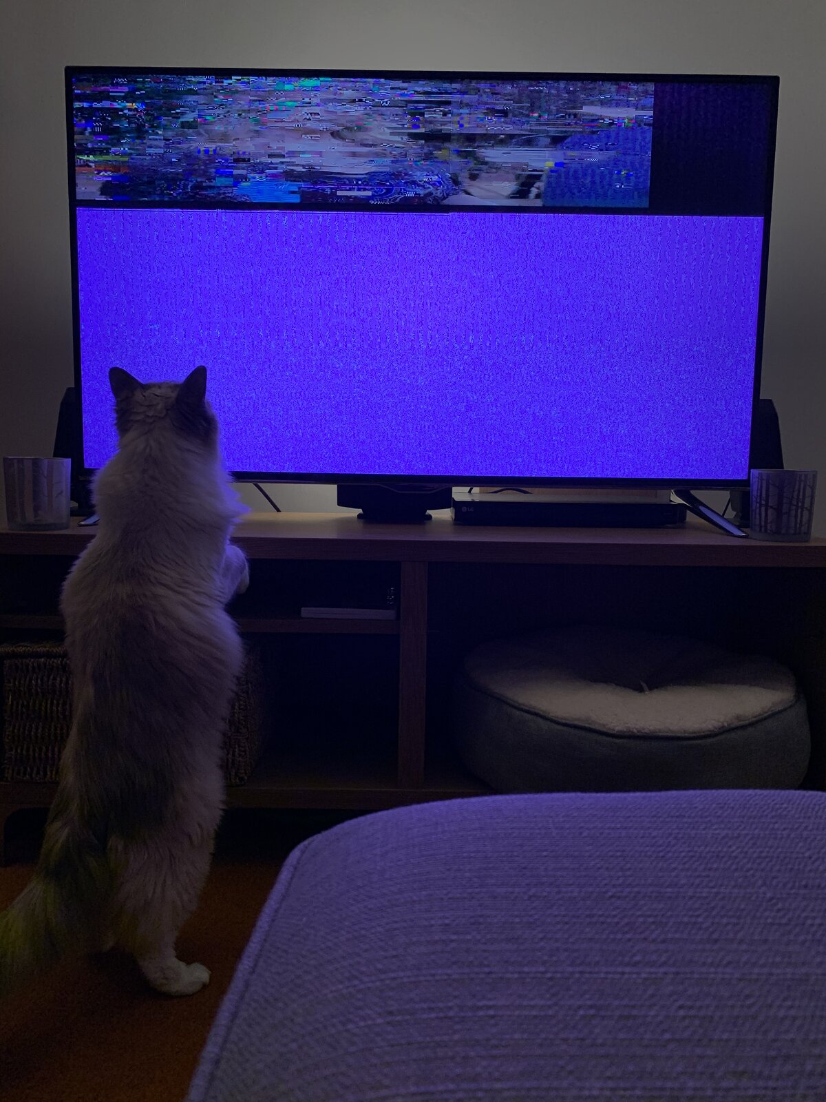

I’m probably being a dumb girl here but I’m gonna admit I’m a bit stumped.
I’ve got freeview built into my tv and yesterday it said I needed to retune to get new channels or something, so I did this using the automatic channel scan.
Upon completion all I got was a completely messed up screen
Did another scan and got actual channels this time but have lost all BBC channels...
I've done yet another scan but still no luck
Does anyone have any suggestions?

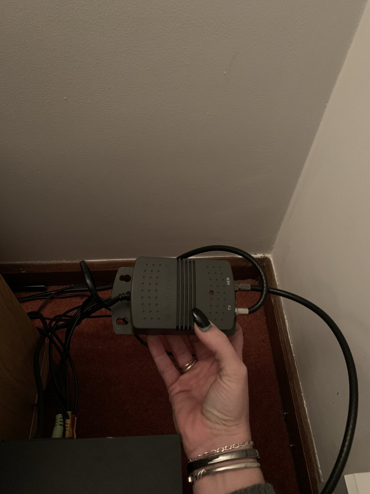

Think I’ve found the problem!
I’m not entirely sure but I’m sure this light should be on... I’ve unplugged it and nothing changed 🤷🏼‍♀️

Turned out the amplifier had died. Since I’ve had a new one it’s been good as gold.

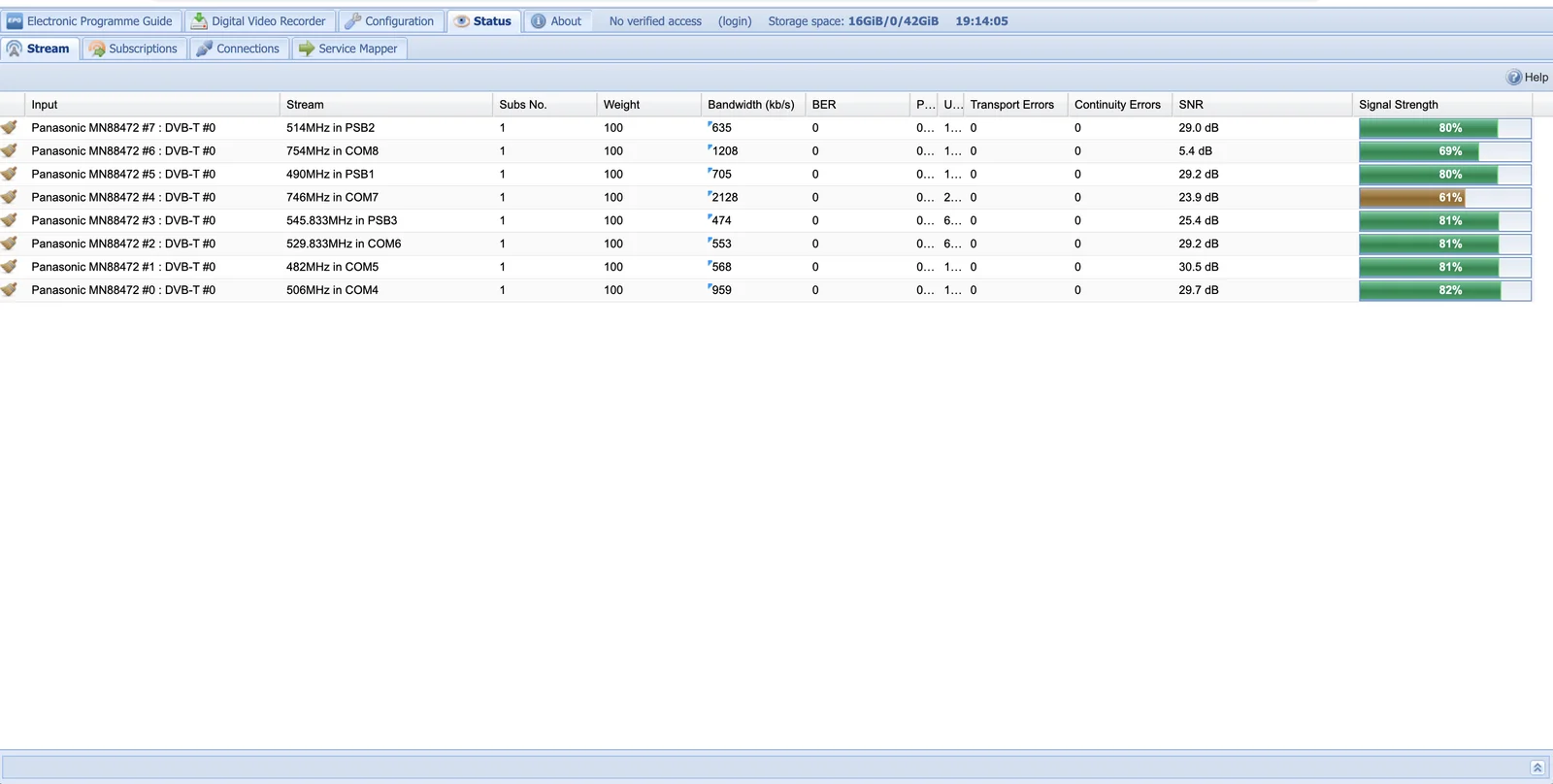

Heres a screenshot from my TVheadend server, it has 9 tuners in it (one for each MUX), although I'm running a test kernel I build the other day where I limited the number of tuners to 8, so I've dropped the LTV MUX. Could technically record every single freeview channel at once!
