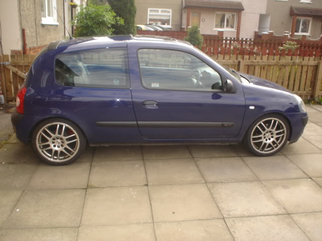

this is my dynamique on 17"s and dropped on FK coilovers. approx 70mm front 80mm rear :)

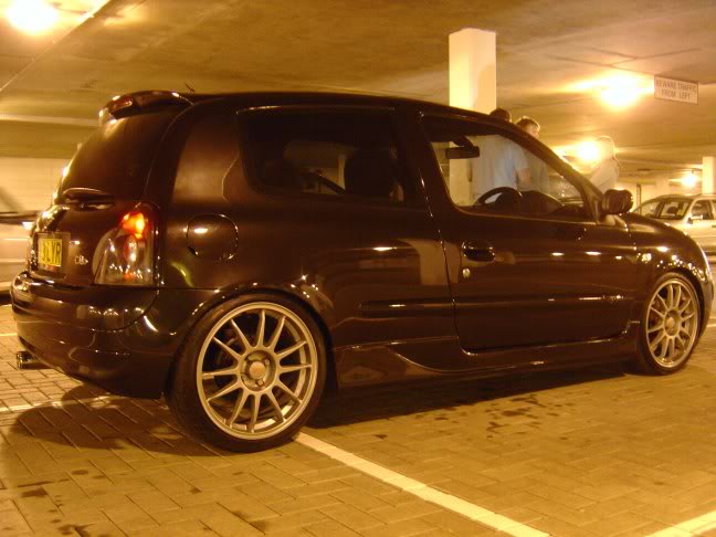

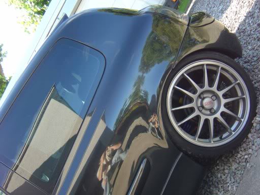

on my 172 clio the best offset i found was ET42 - no rubbing at all and lowered bout 50mm
not sure about a non sport model though - PM Fred he will know - im pretty sure ET42 would be best for you as well as it is the back that causes problems more than the front - the front is easy to fix if it rubs anywhere just by removing part of the inner arch but at theback it rubs against the outer arch if you have lower than ET40 offset

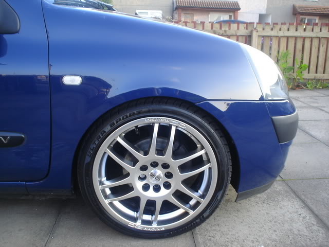

Mine is lowered -60mm on 17's and there is only rubbing at full lock.
