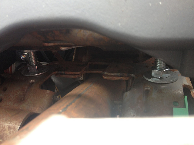

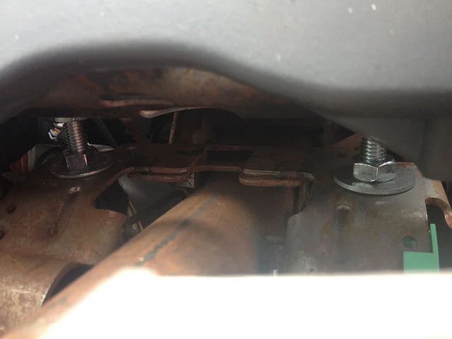

Having dropped my seat to a proper height with Jon Foz's excellent seatframes, i need to drop my wheel aswell.
I have dropped it about 1cm by putting washers on the bolts that hold the wheel up, but I need more and can't get it by using more washers as due to the angle the bolt(even a longer one) won't fit.
anybody solve this?
green
  Hi comp phase 1
I did this mod a couple of years ago..pretty sure I used 100mm m8 bolts, didn't have to elongate holes either and I only changed the front two bolts.
Untitled by Andrew Greenwood, on Flickr
