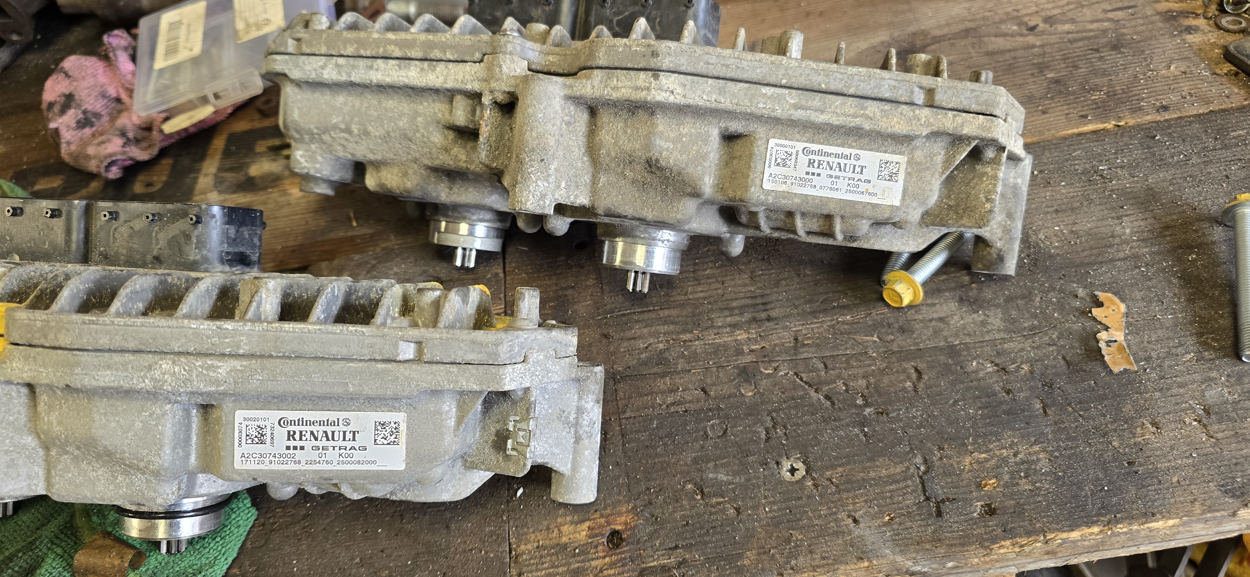

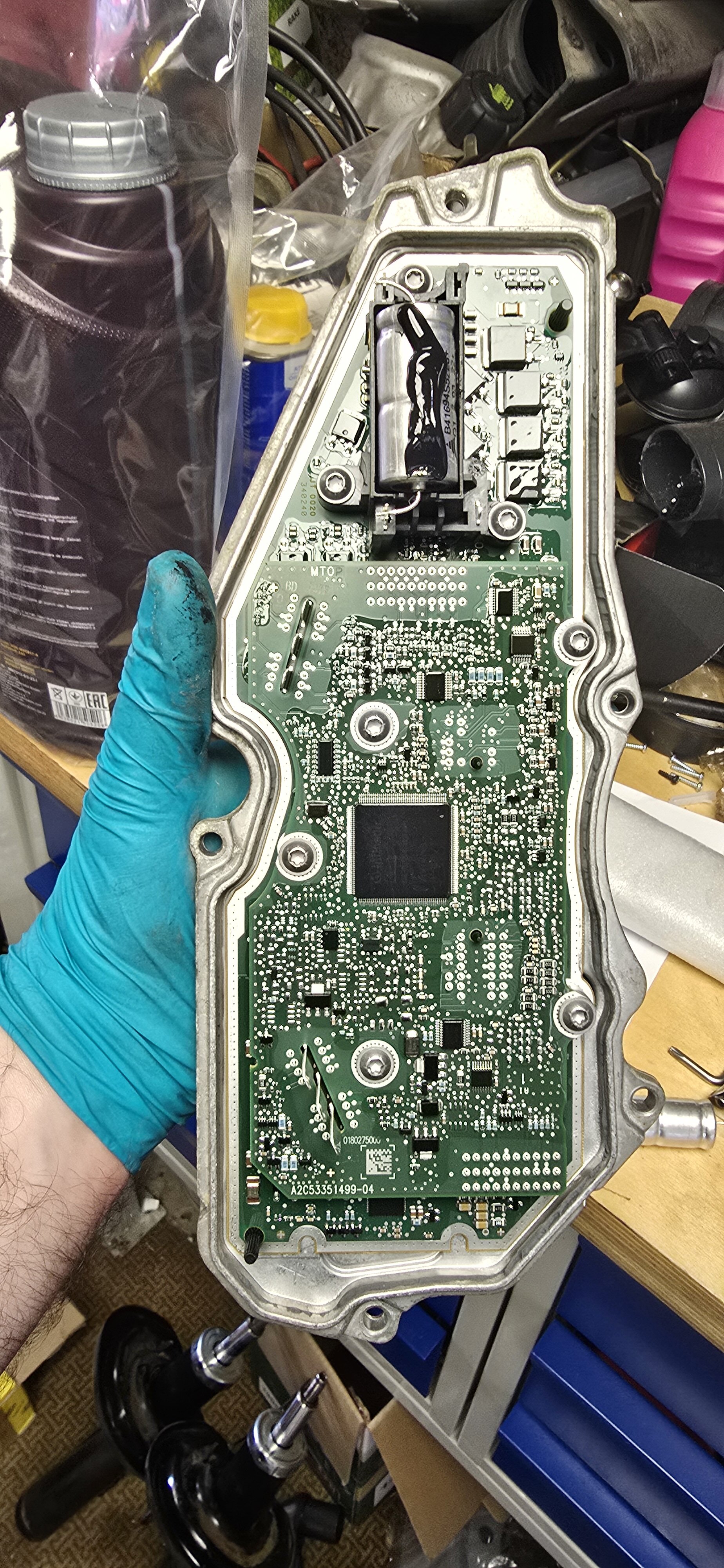

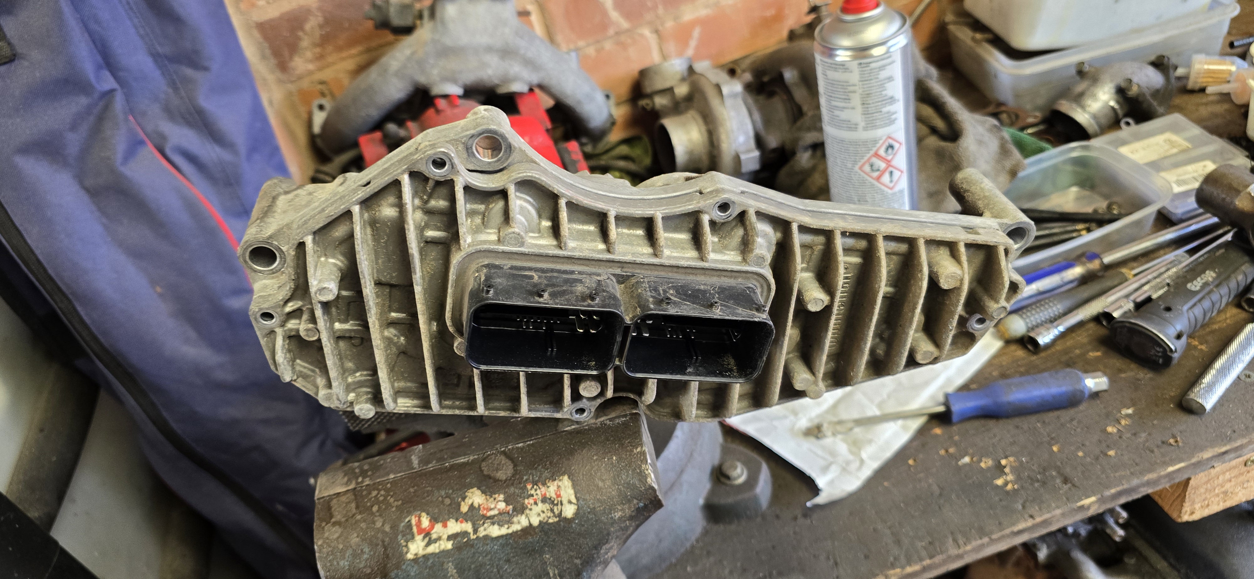

So I did the above, I went ahead and swapped the TCU this afternoon. Really easy job to do tbf.
and then it went for bad (though fine for 150miles) to worse.
Though the car initially showed no faults, as soon as I started to drive I noticed it showed D (for drive) instead of the actual gear..... then it swapped a few gears and dropped into limp. Looks like the TCU is for a lesser version even though it looked externally the same.

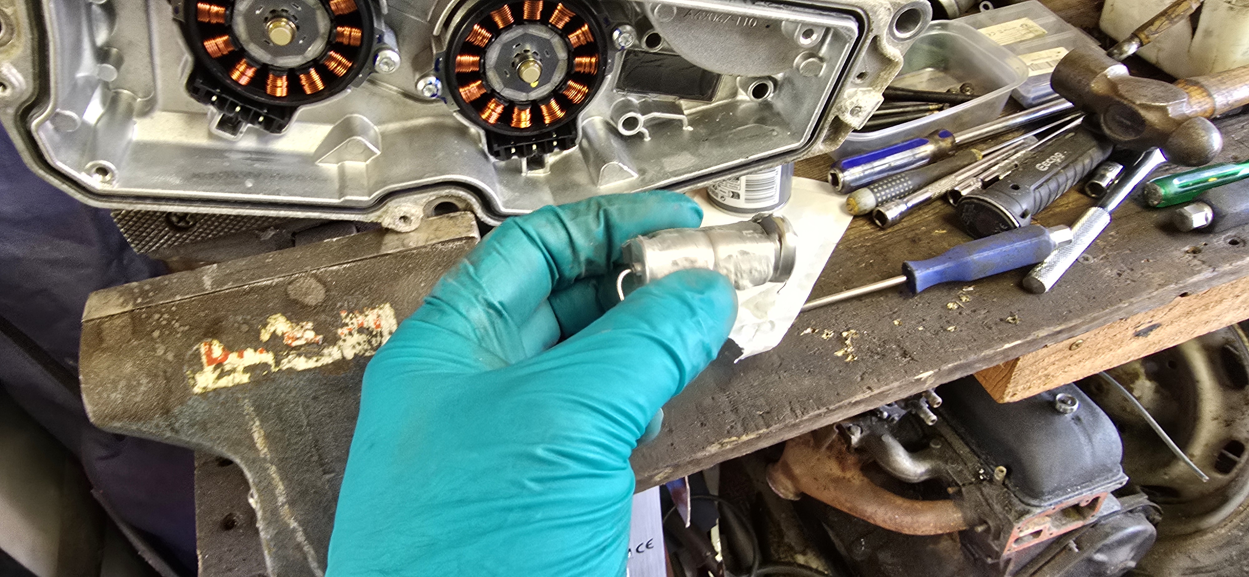

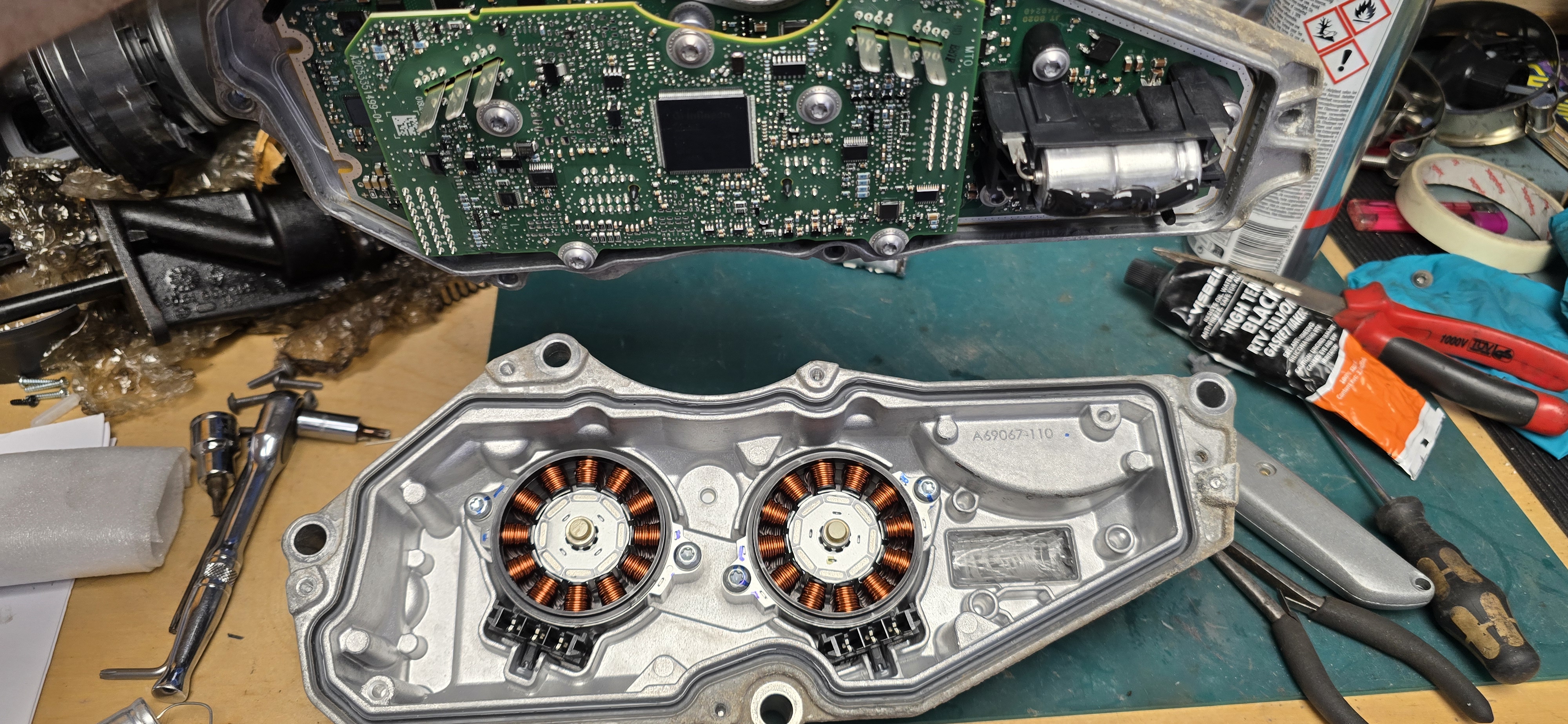

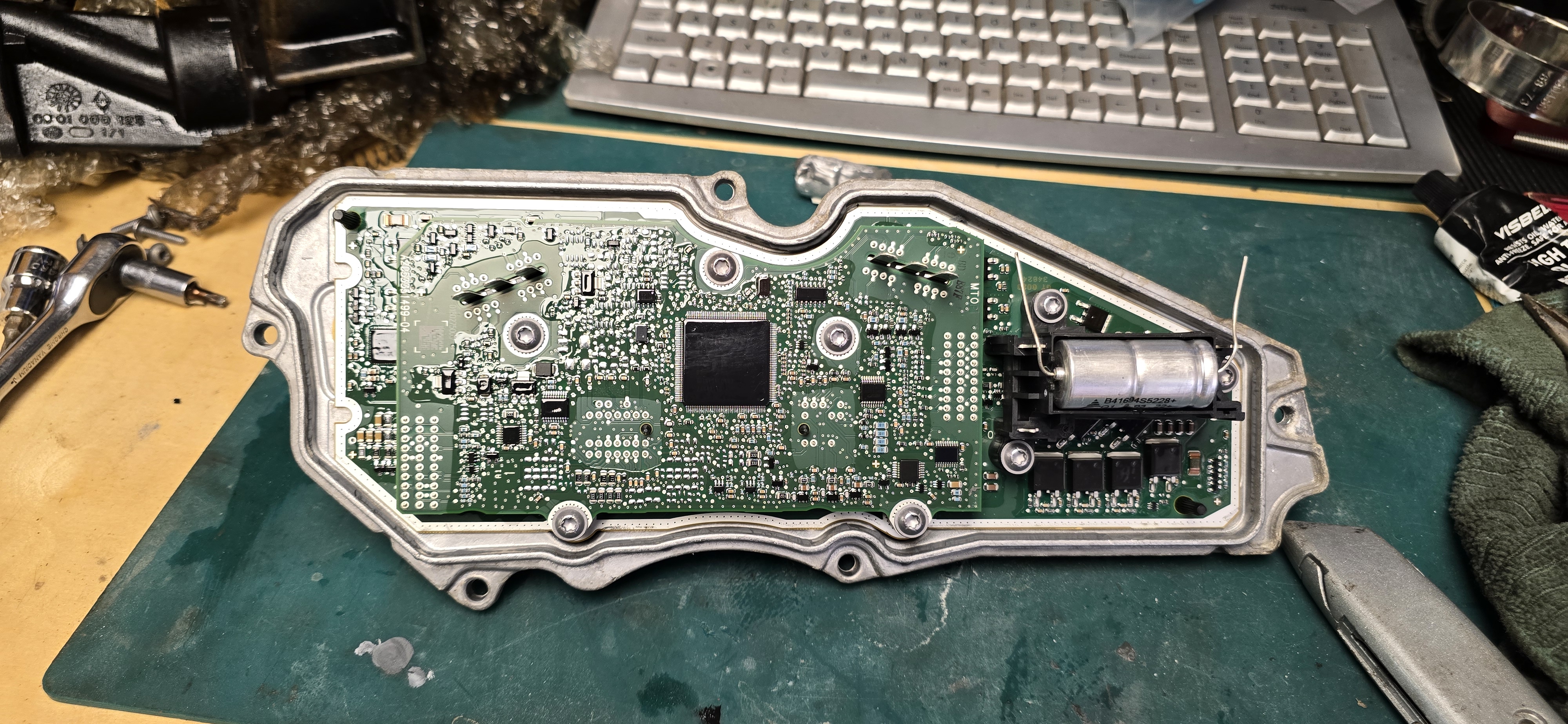

So what to do.... might as well separate the original TCU and fit a new capacitor (y)
Swapped it in, reset everything and took it for a test drive. All good so far, but that said it was already behaving.... not sure if its a placebo effect but the shift feels a lot cleaner and when in sport mode its banging through nicely. Will see how it plays out and if I can get a refund on the china town TCU.

Why are we thinking the capacitors are the culprits? Where has that thinking come from?
Adey.
Its been mentioned by someone else who had a similar issue, changed them out and cured it. Its also noted by the ford folk as an issue (they run a visibly the same tcu and similar getrag box)
The capacitors are used to jump the voltage to around 40v from 12v for shifting of the gears as far as im aware. They do die with age and with heat.

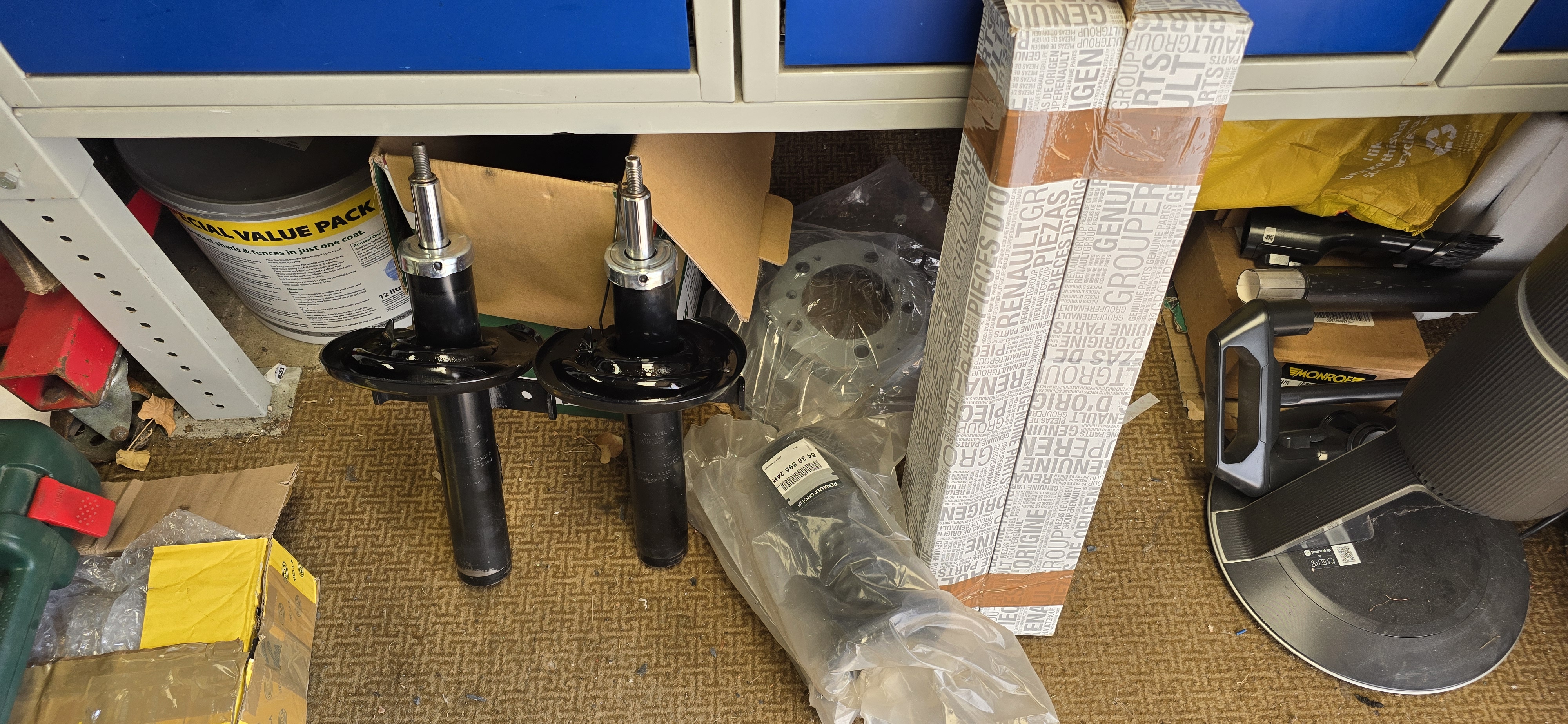

Not sure if I mentioned before in the thread but I bagged some trophy front shocks with 3k on them and around a year old. Decided to order up some matching trophy rear shocks through Kam Racing so will be giving the suspension a little refresh. Its on Cooksport springs on the original, now 114k old cup shocks. Should tighten things up a little all being well (y)
There are 3 factory setups available that I can tell, Standard, Cup and Trophy, all with different part numbers

And whilst I was at it I cracked on and fitted the trophy shocks all round. They are defo shorter front and rear, had to lift everything up to get them bolted in. Not driven on them yet but the car is very firm when I try to rock it.

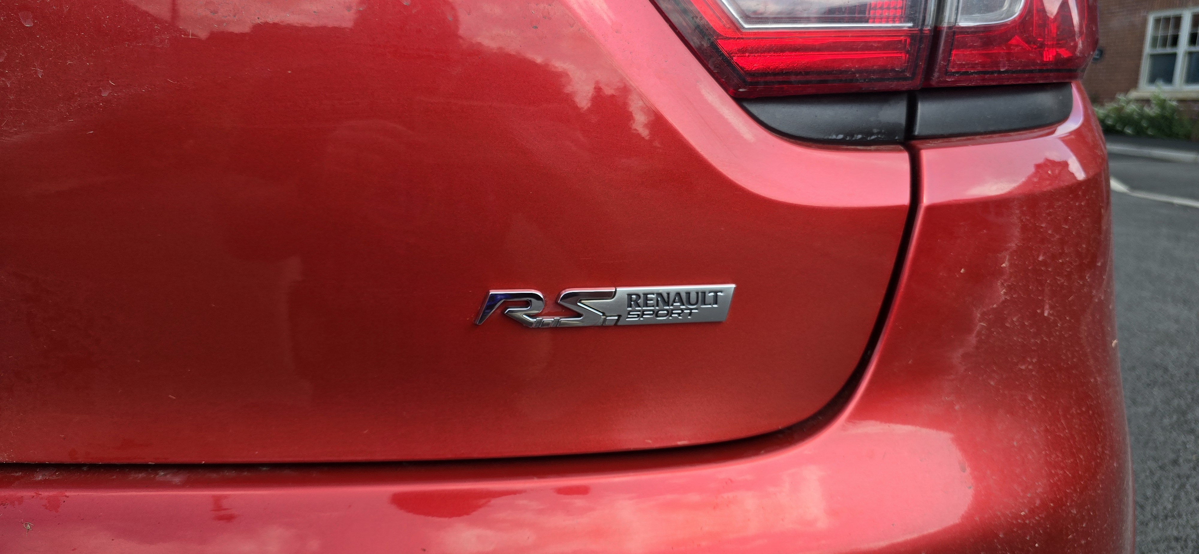

Took delivery of some badge covers (plus a few extras, thanks Paul) from @paul b of Diamond performance 👏
Excuse how dirty the rest of the car is. Straight out to clean the old badges and on with the covers 👌🏻 just need to whip the "Clio" off next and possibly get a black rs badge.
  Clio Mk4 RS 200 EDC
Black badges look great. Got round to sorting mine out recently too and getting rid of the Clio certainly cleans up the look.

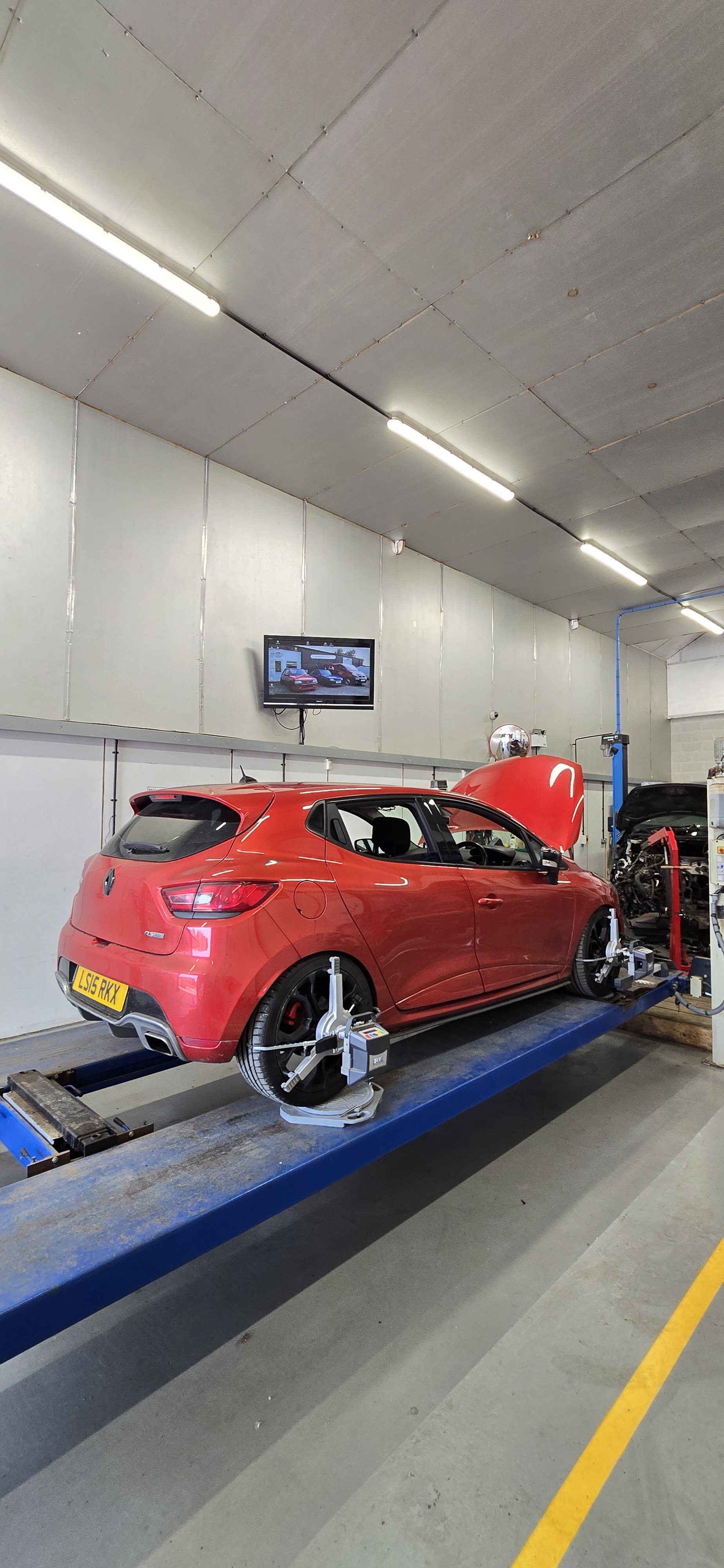

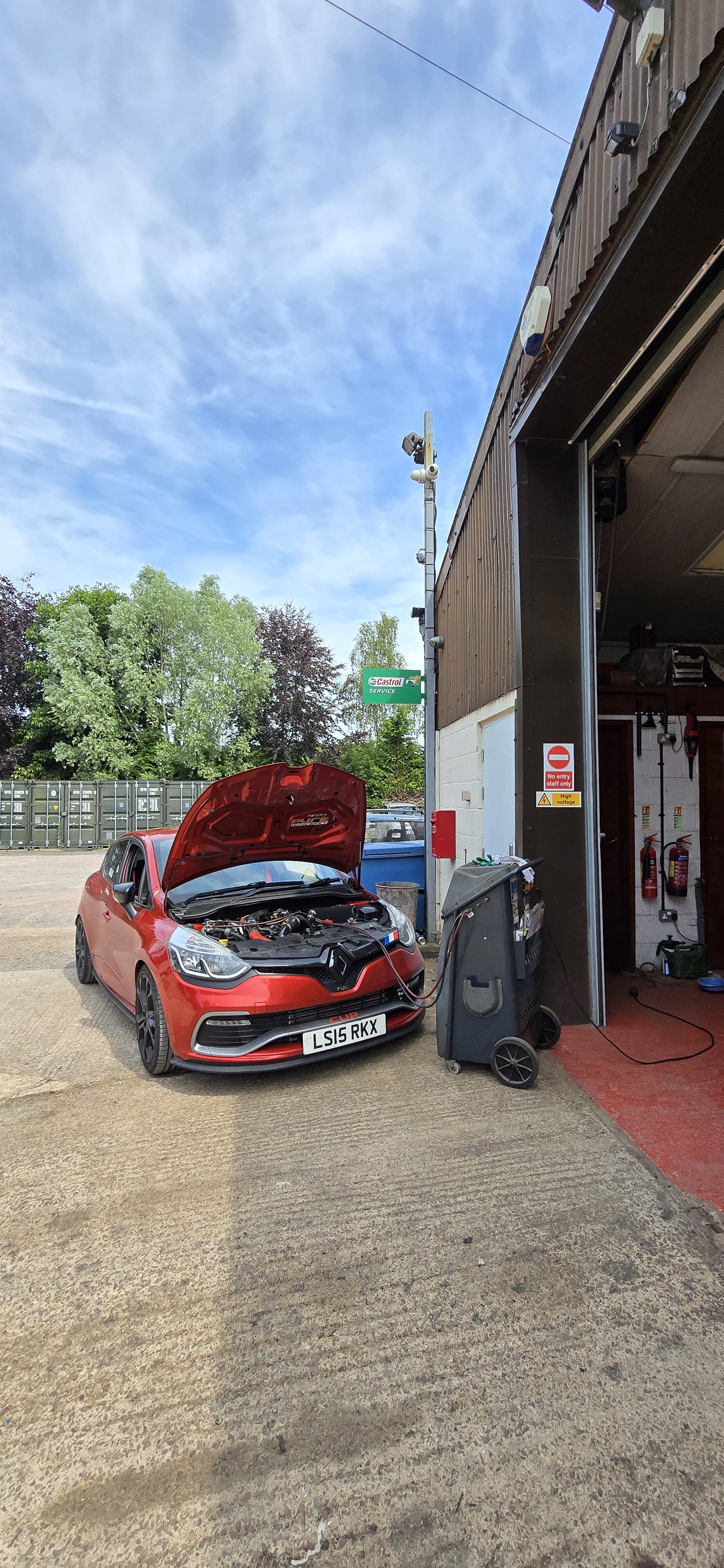

AC has been a little lacking recently so took it in for a top up. Whilst there I got it up on the ramps and did some alignment, tried to balance up the castor but have ended up with a difference side to side, might look into new wishbones in the future but cant really feel it, 2.1deg of neg camber dialled in up front and a little toe out each side. Feels very nice on the road. Rear needs a tweak as one side has a degree more of comber though very even on the toe, again cant really feel it but id like the rear to match either side.
all in all it feels nice and ready for some fun

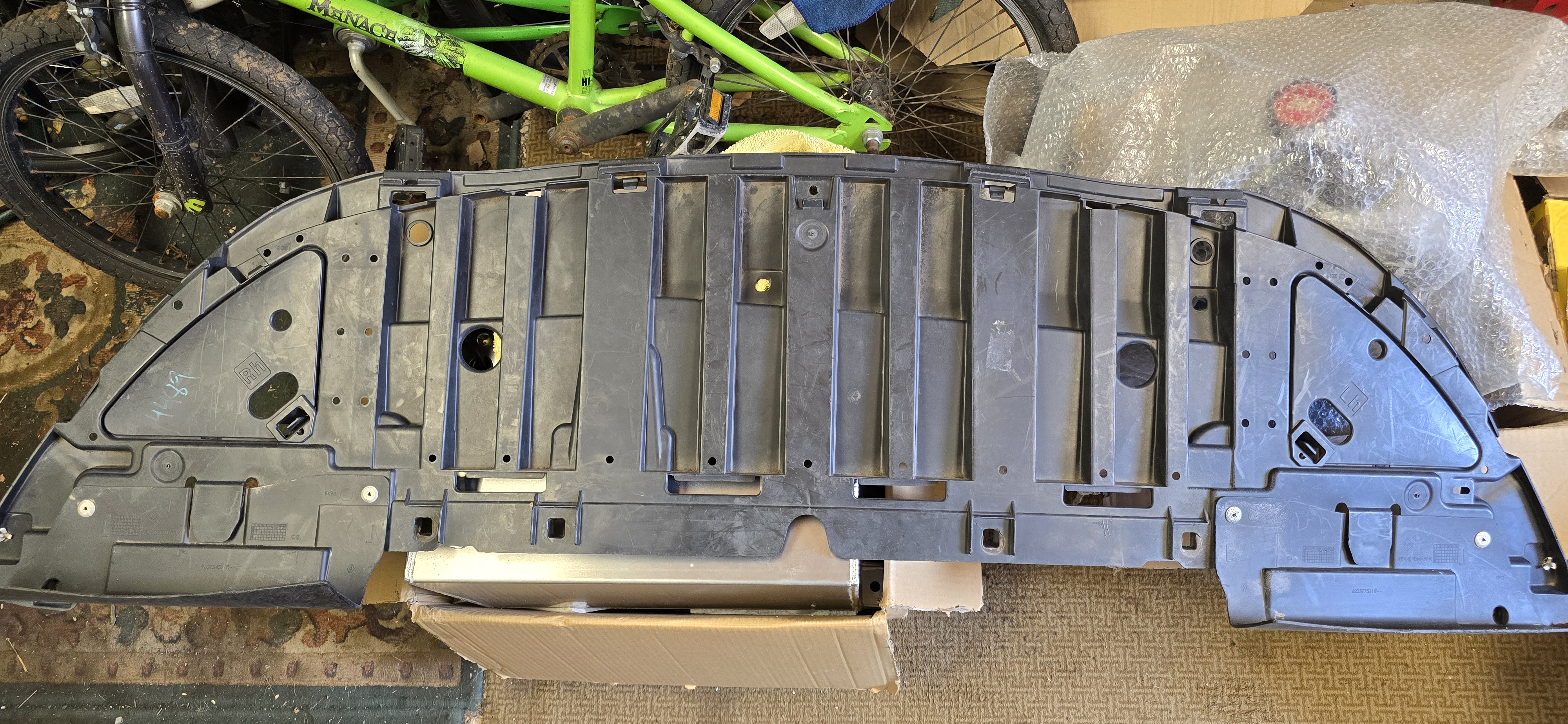

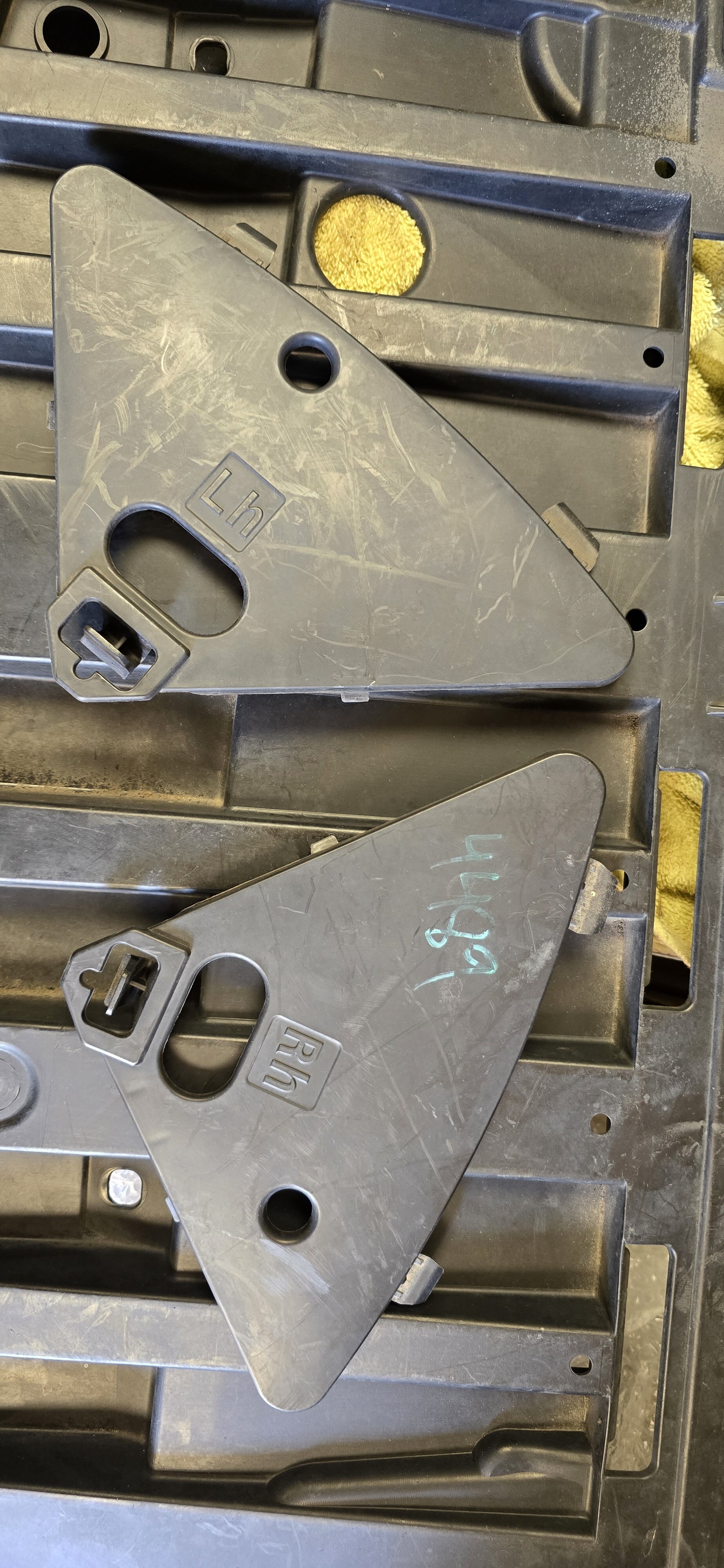

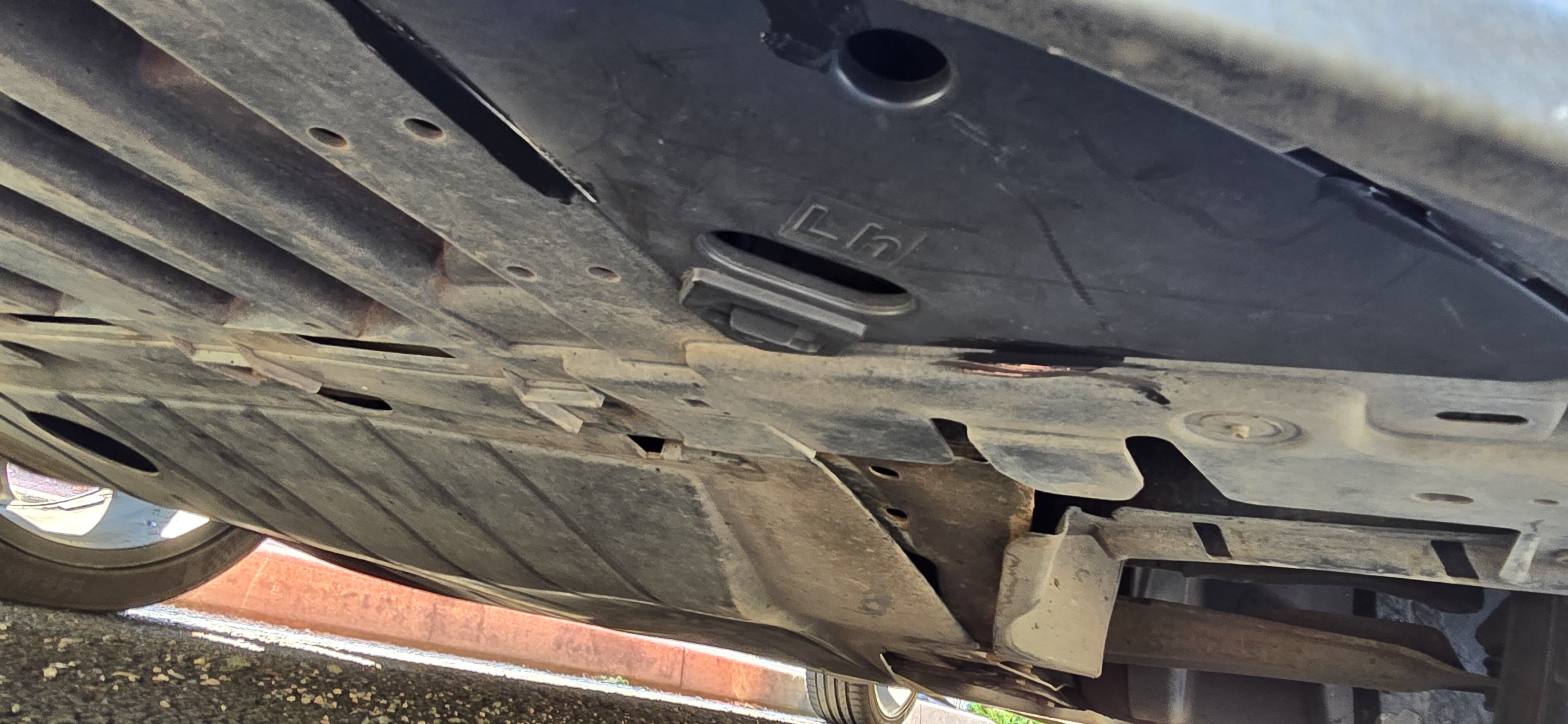

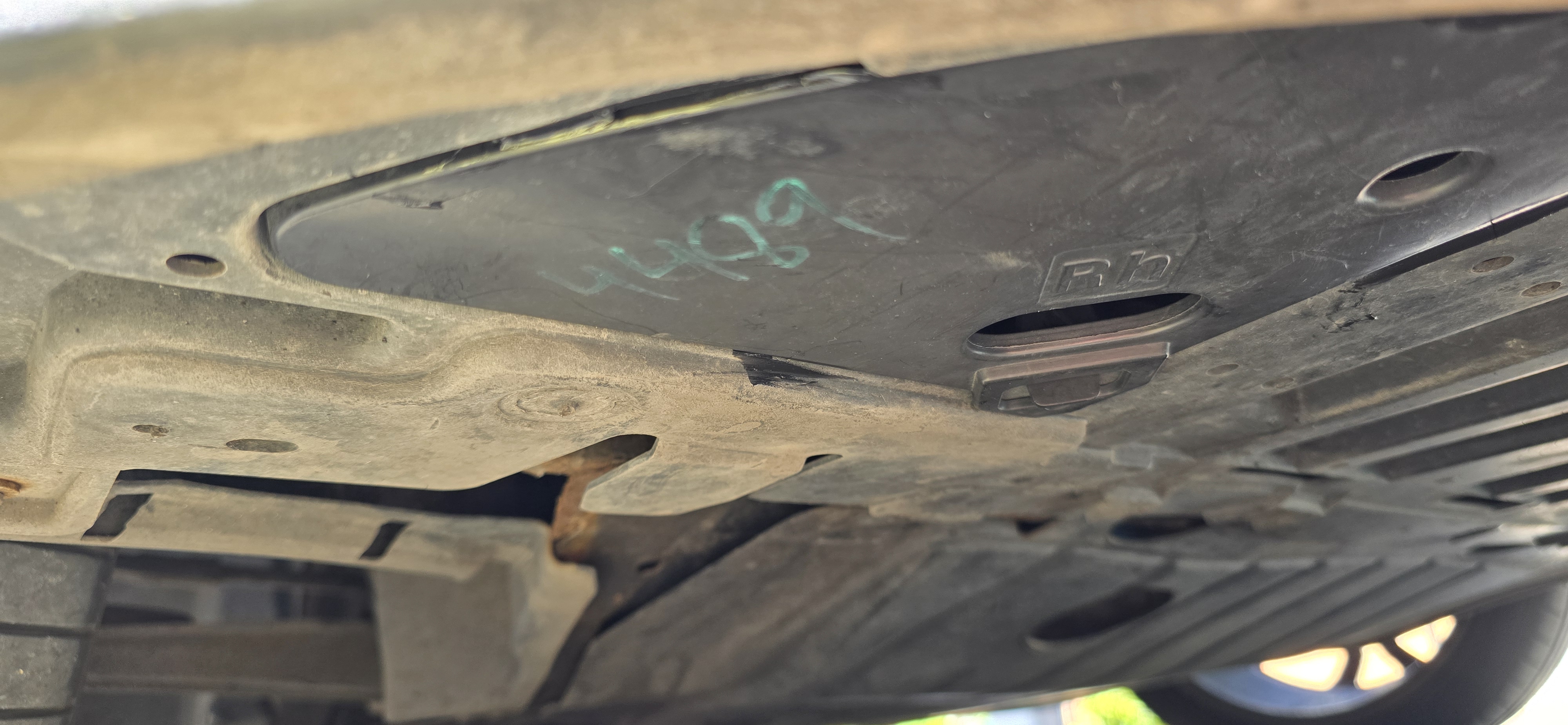

Finally found a front lower panel with both inspection hatches in. Lots of the RS' are missing them, though they are held in pretty well. Added some RTV to try and keep them in place and slapped them onto the Clio. Should, all being well, aid cooling some more as it completely closes off the rad area. Simple things for simple minds.

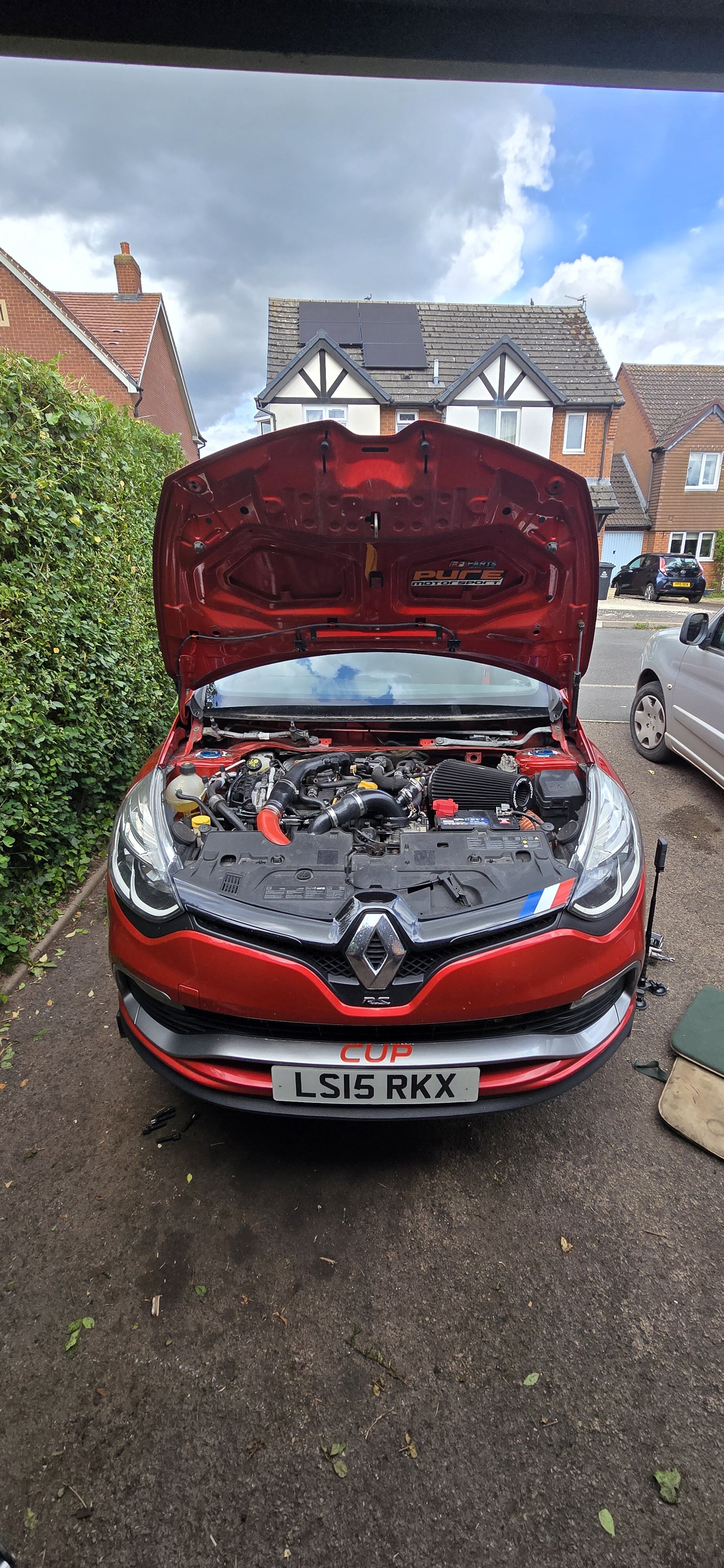

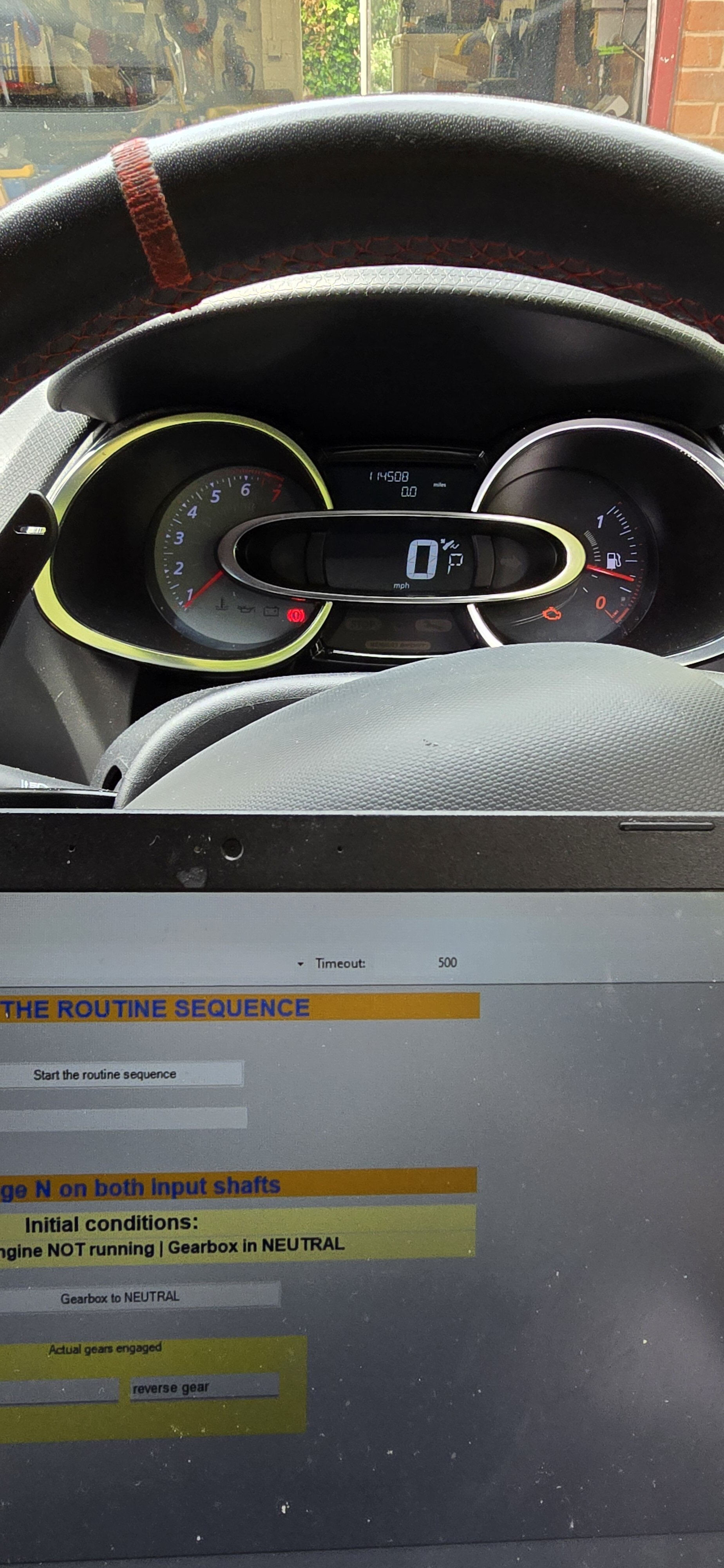

So woke up early, car drove fine, set off at lunch time and it seemed a little sluggish but covered 75ish miles (temp getting up)
started it about 30 min ago, full blown wobbly and not engaging anything, both shift drum actuators not finding position (very hot outside, car saying 34!)
I had a look at the live data and the amperage for the shift drum current was all over the shop when not doing anything and the positions were shooting all over the place too. You can hear when they try and find home and even forcing a position reset using the diag wouldn't make them play ball. Defo a temp related issue in my mind.
Anyway, I had an mot booked for tomorrow which I will have to cancel and hopefully rebook. All being well I can swap out the TCU from the trophy bits when that turns up and get it going again early next week. Will have to bust out the R8 for some more daily duties...

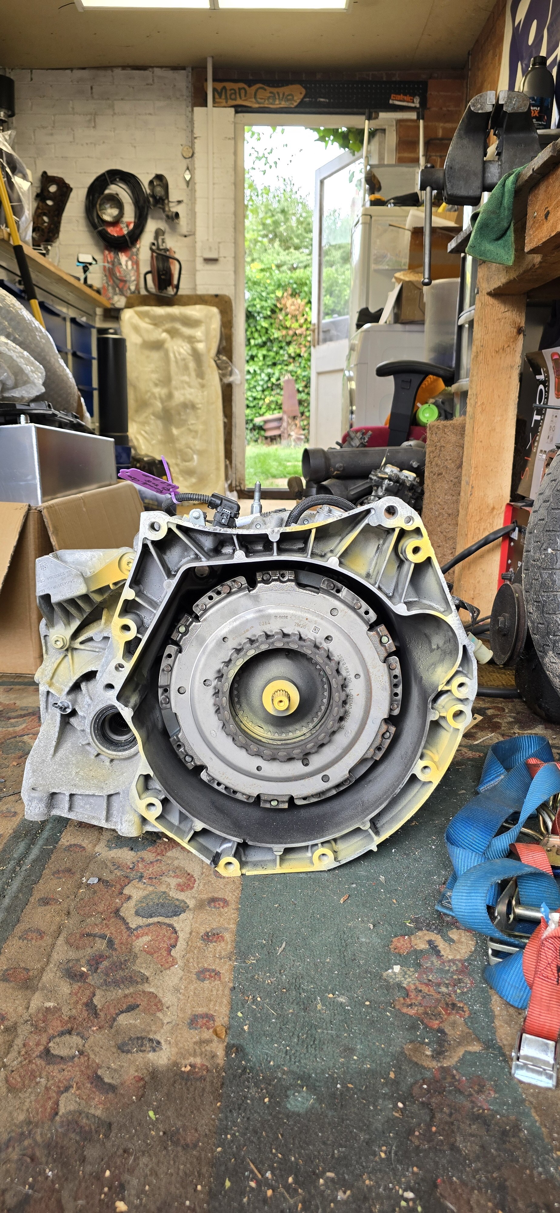

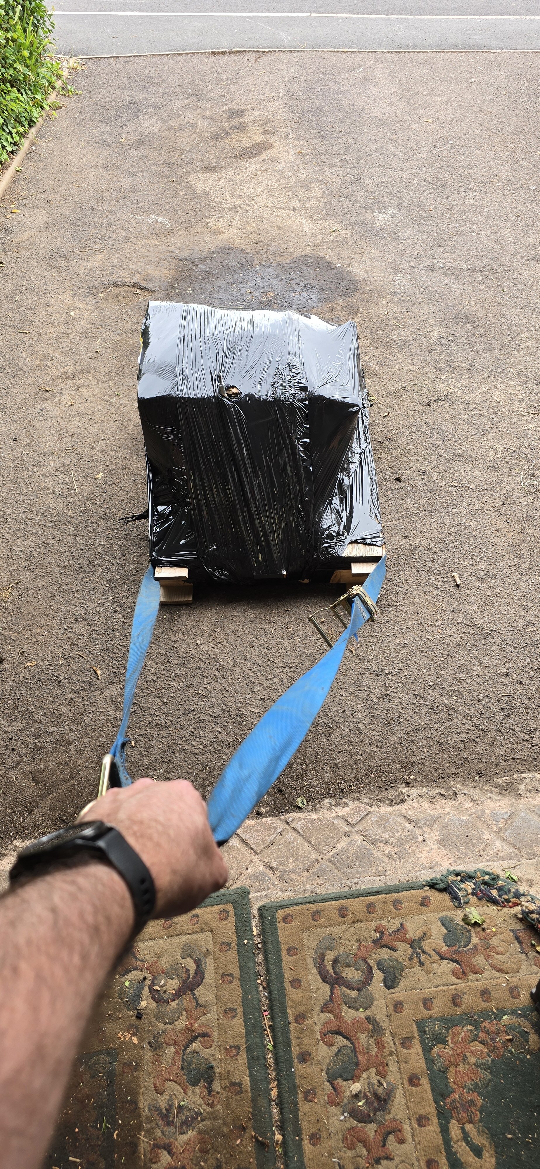

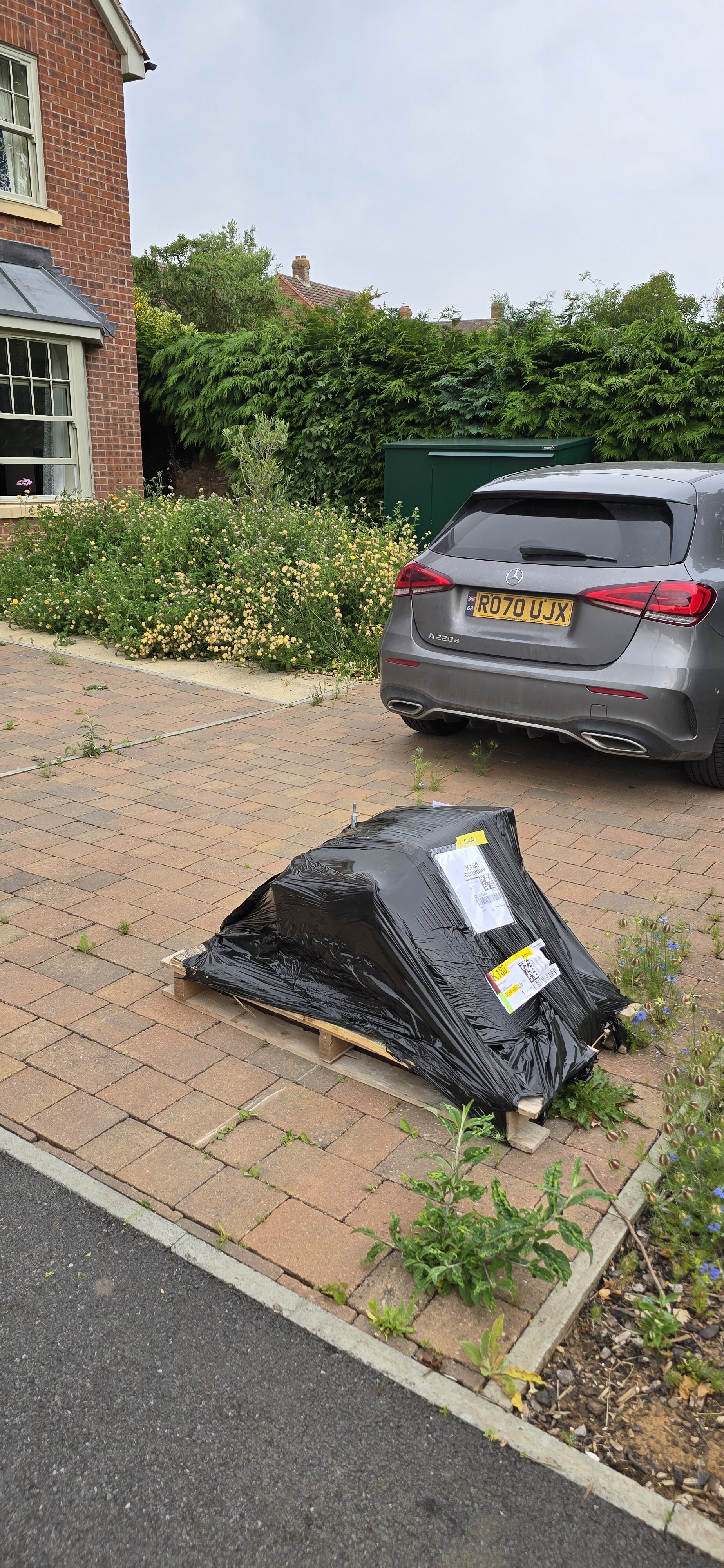

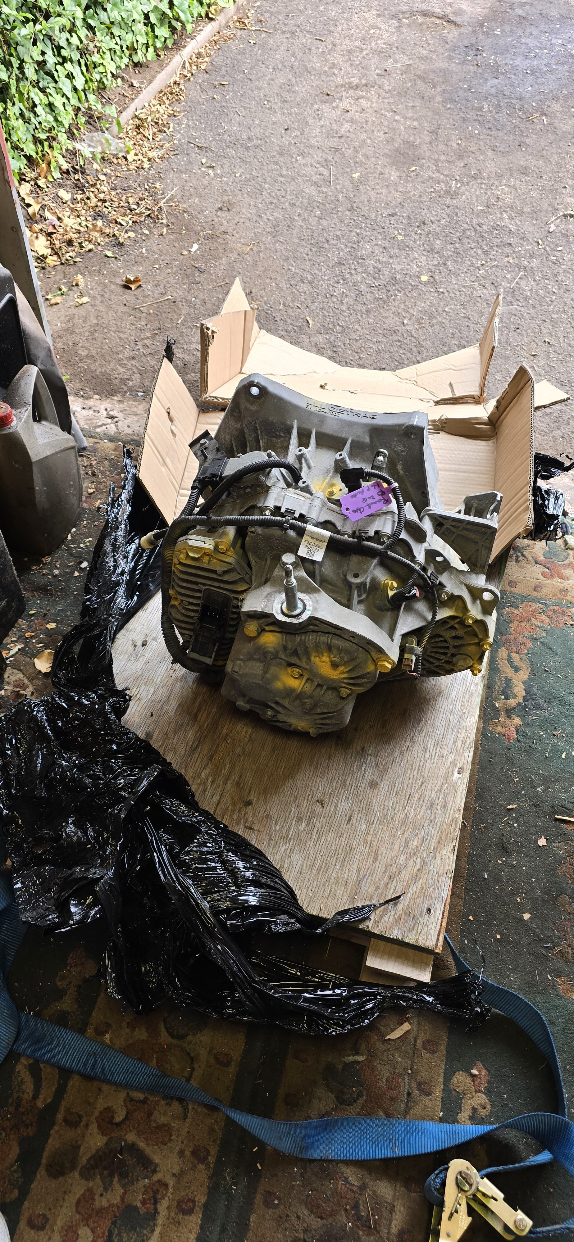

Gearbox was delivered today, on the wrong driveway further around the cul-de-sac. dragged that thing back to my garage lol.
Its a later box and TCU from a 2018 trophy, so say on 30ish k. TCU whipped off and slapped onto the Clio. Reset everything along with the counter on the dash. Lets see how long it goes for, fingers crossed its all good.
Feels ok on a short test drive and everything is talking to each other fine, the only thing to note is TCU's internal temp is showing at 8000+ lol.

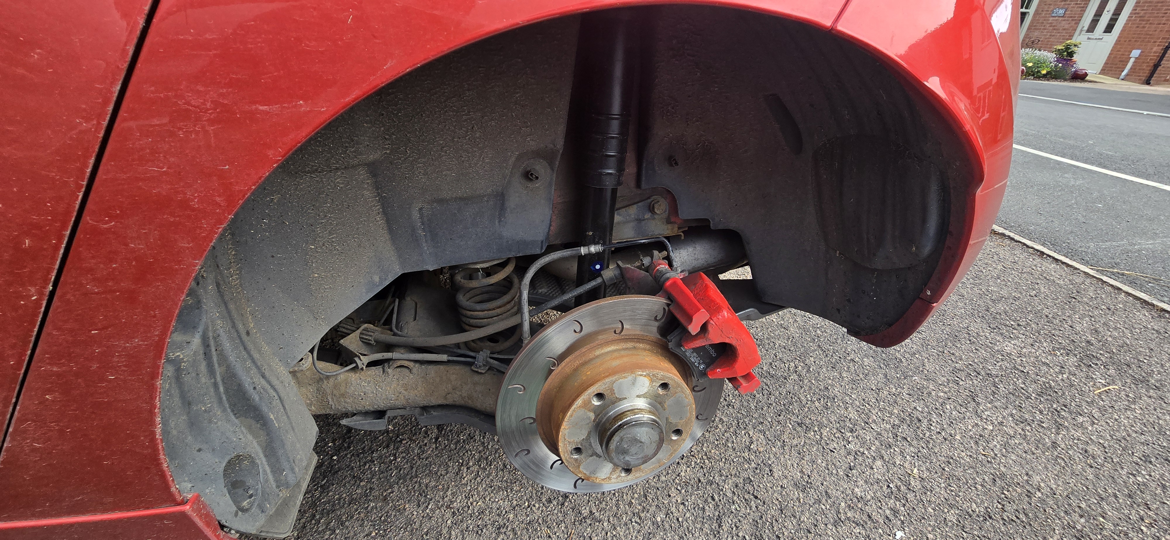

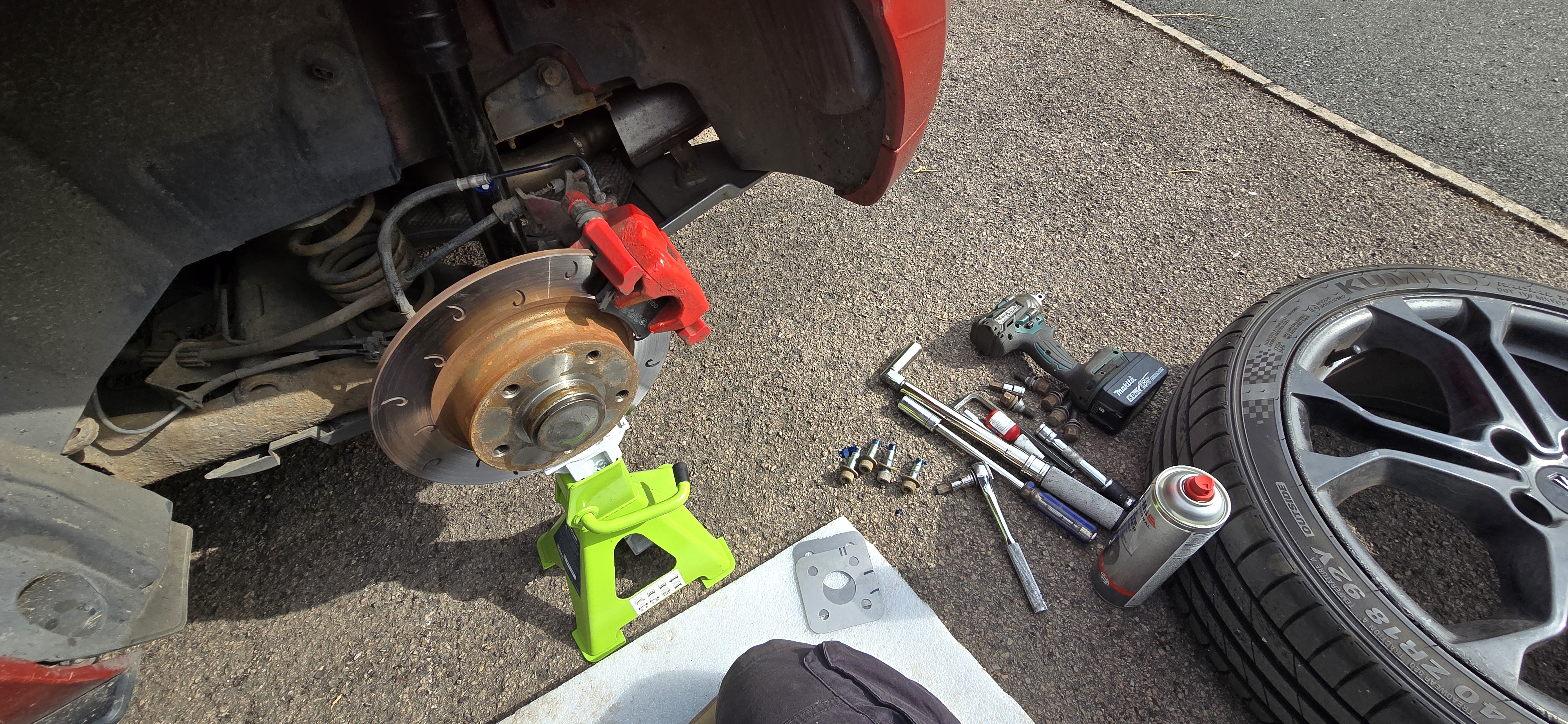

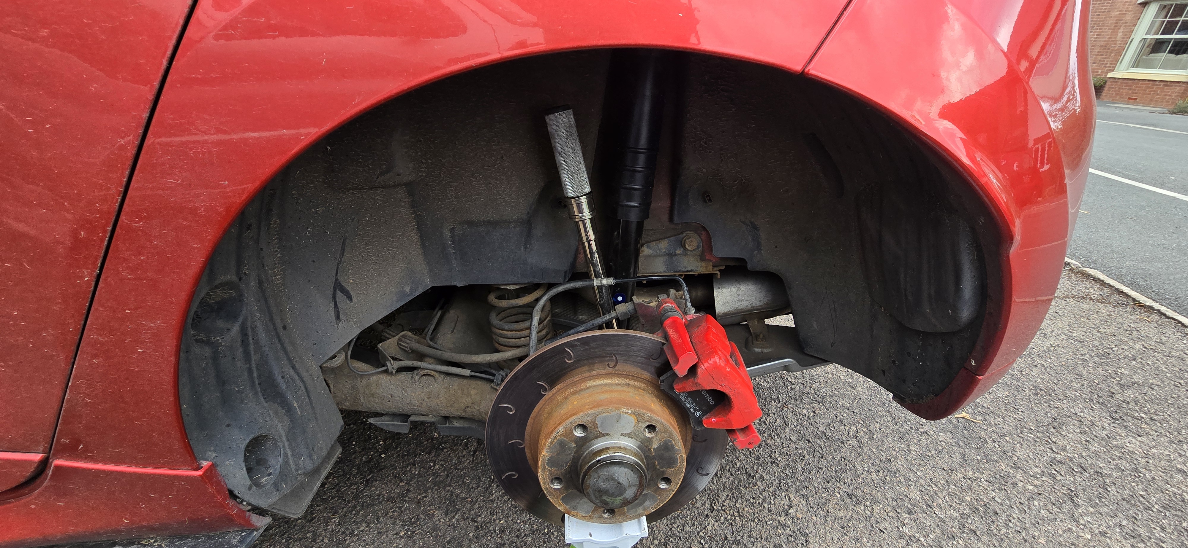

Anyway on to more tweaks, removed the rear hub and fitted up some pure motorsport shims. 1 degree camber and a .1 to toe it back out, adding camber generally increases toe in. Won't know for sure where it's at until I get it back on the alignment kit but should be close side to side now
