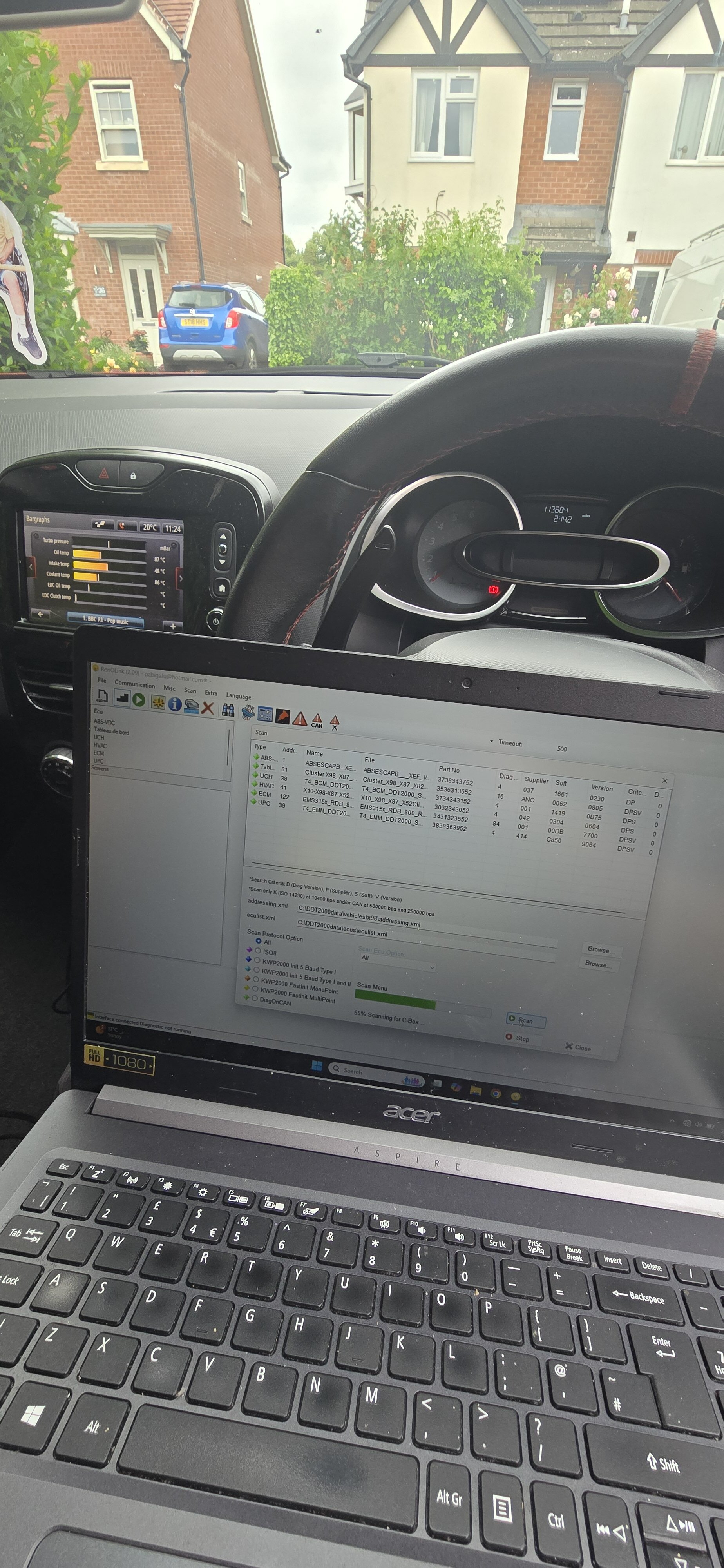

@Adey. I notice that you have the
Vgate Vlinker cable. I know from you video that is working as you manage to connect to the Renolink but It has the different chip and not the PIC18F25K80 recommended for that. I bought a cable but it doesn't work... Do you think the Vgate cable what you have will work with ddt4all and connect to the car without any problems as I do not have the Renault software?​
oh sweet, did you get RS monitor back on there?
Yes it was already there. Don't know what I did but the radio have all settings stored. I write them again in MFD but nothing... I did all again and nothing. Than I went to Audio settings Radio2012 and click the write there and it all come alive... But no sound 🤦‍♂️ check the settings again,hard reset, disconnect battery still no sound. The last thing I could try was disconnect the Powerbox 65.4 amp as I remember when I fitted that had same/similar issue and disconnecting it from the unit behind glovebox and connecting again did work so lock the car, went home for about 10min to get tools ,drink something and when I went back to the car start the engine to move car it started to work 😁 So all good in the end

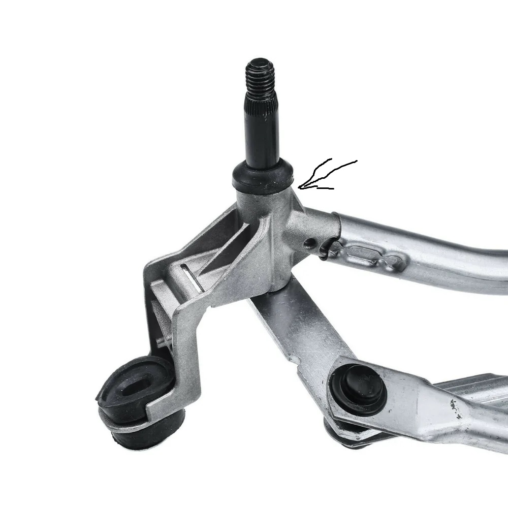

good thing you guys clean it under there (y) . the wiper mechanism sometimes gets stuck due to rust and moisture , then its almost solid and cant move . doesnt happen many times but can happen on clio 4 (and is fixable with some time invisted). atleast it hasnt got the clio 3 problem getting play on the mechanism and damaging your bonnet.

good thing you guys clean it under there (y) . the wiper mechanism sometimes gets stuck due to rust and moisture , then its almost solid and cant move . doesnt happen many times but can happen on clio 4 (and is fixable with some time invisted). atleast it hasnt got the clio 3 problem getting play on the mechanism and damaging your bonnet.View attachment 1737865
Mine seized on mine, as you say they get stuck solid and snap. Relatively easy and quite cheap to replace though so not the end of the world.
normally they only snap if you ( the person) accindently breaks by trying to lose it up. if had them even when the motor stops working (eventually burn out) but not break.. so first for me hearing that (y) . if the mechanism break you can throw it away, but if mechanism is still one piece it is fixable . can make a guide for interested (eventough it isnt rocketscience , and some cleaver people here)

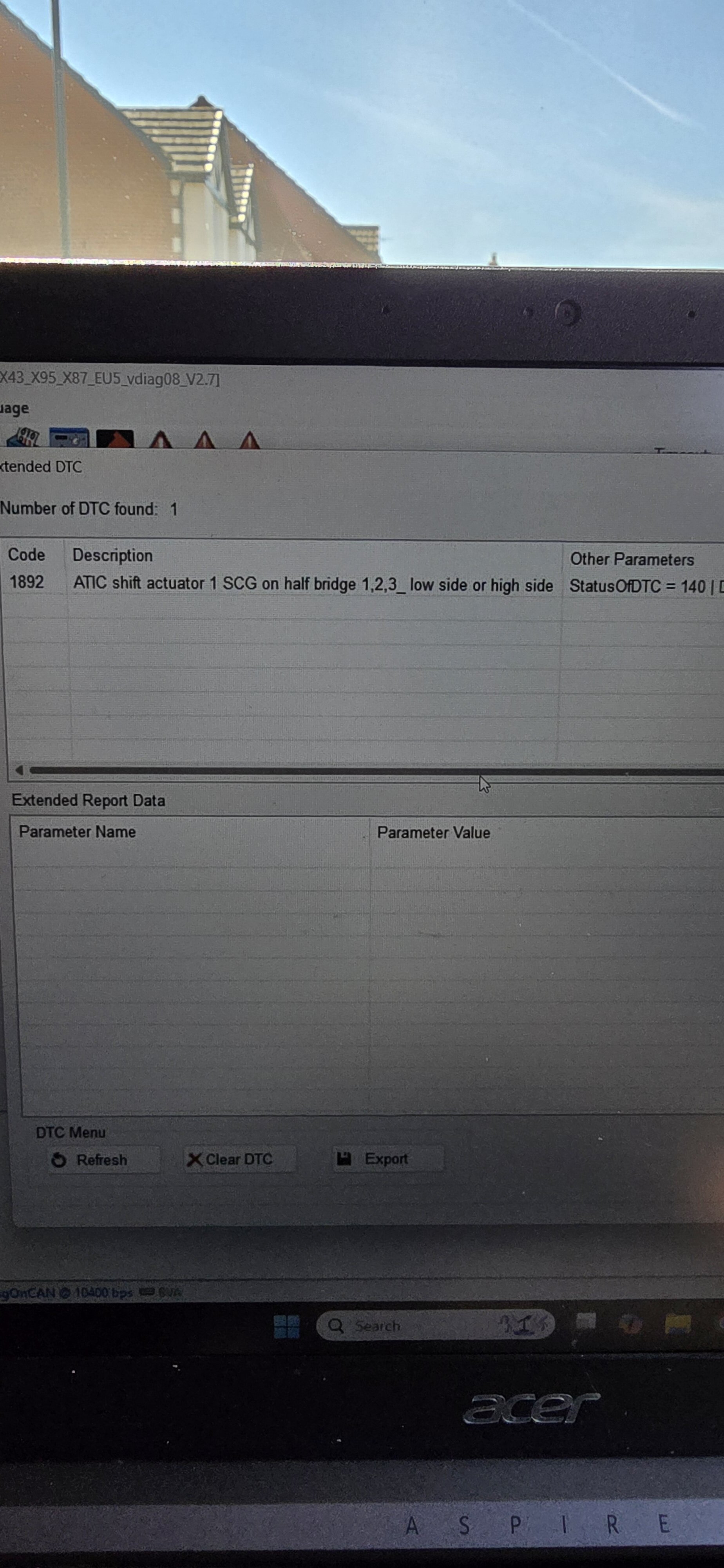

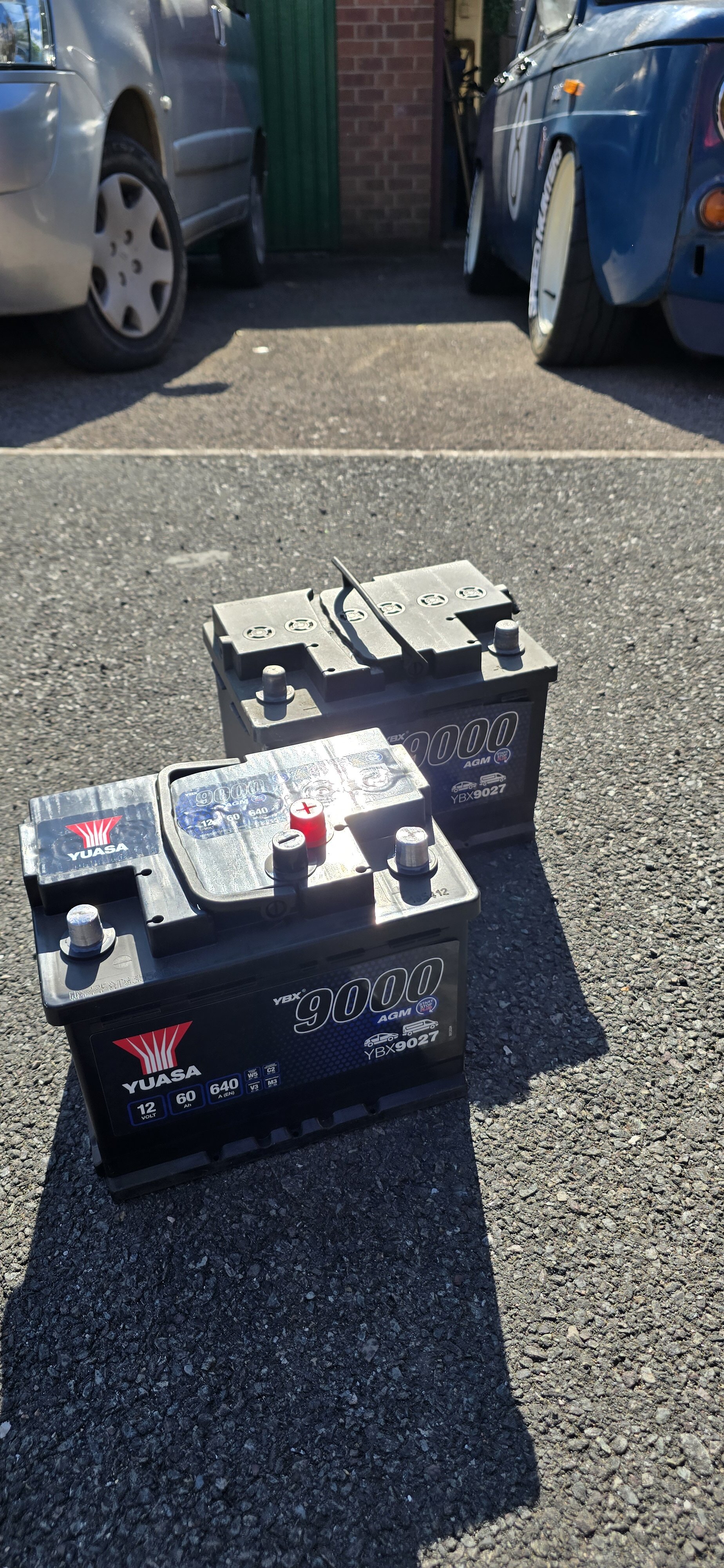

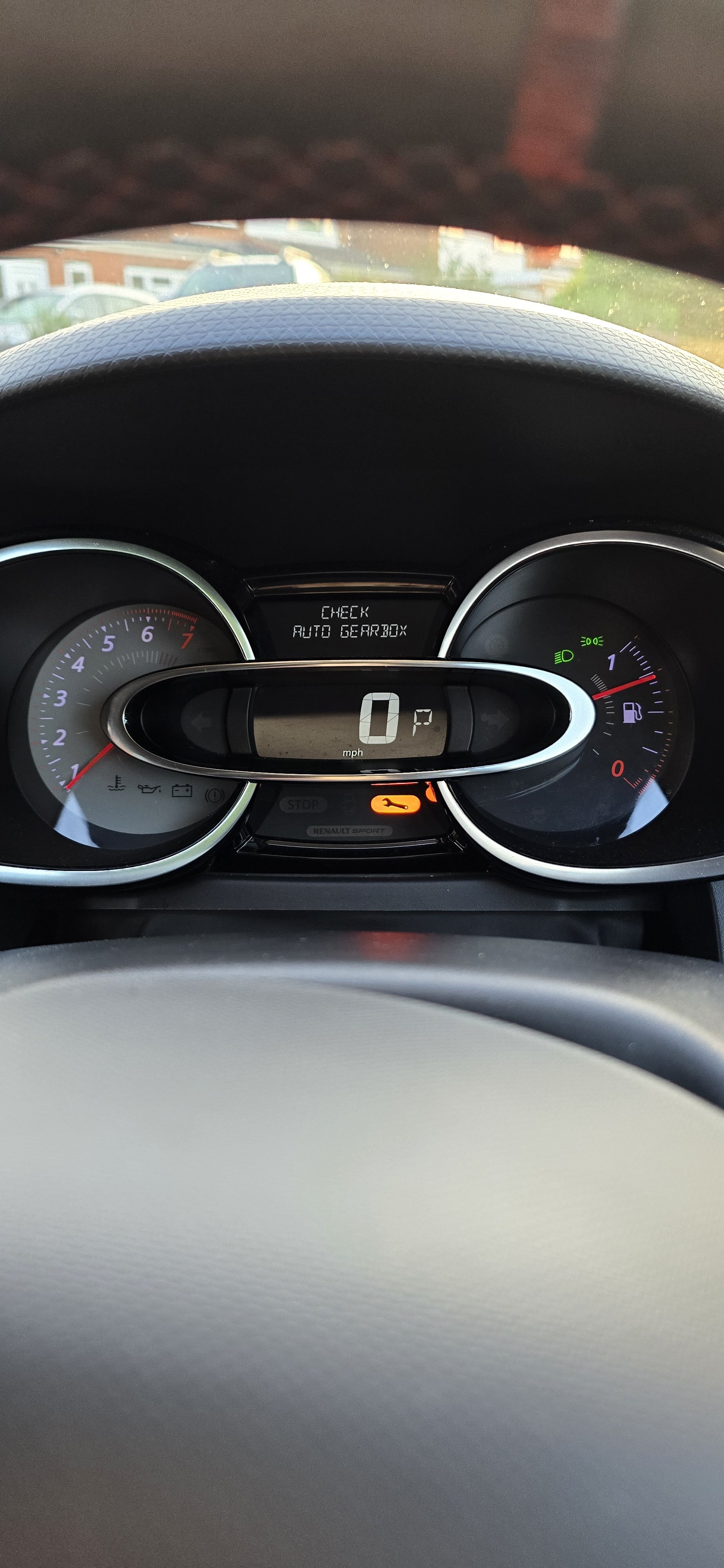

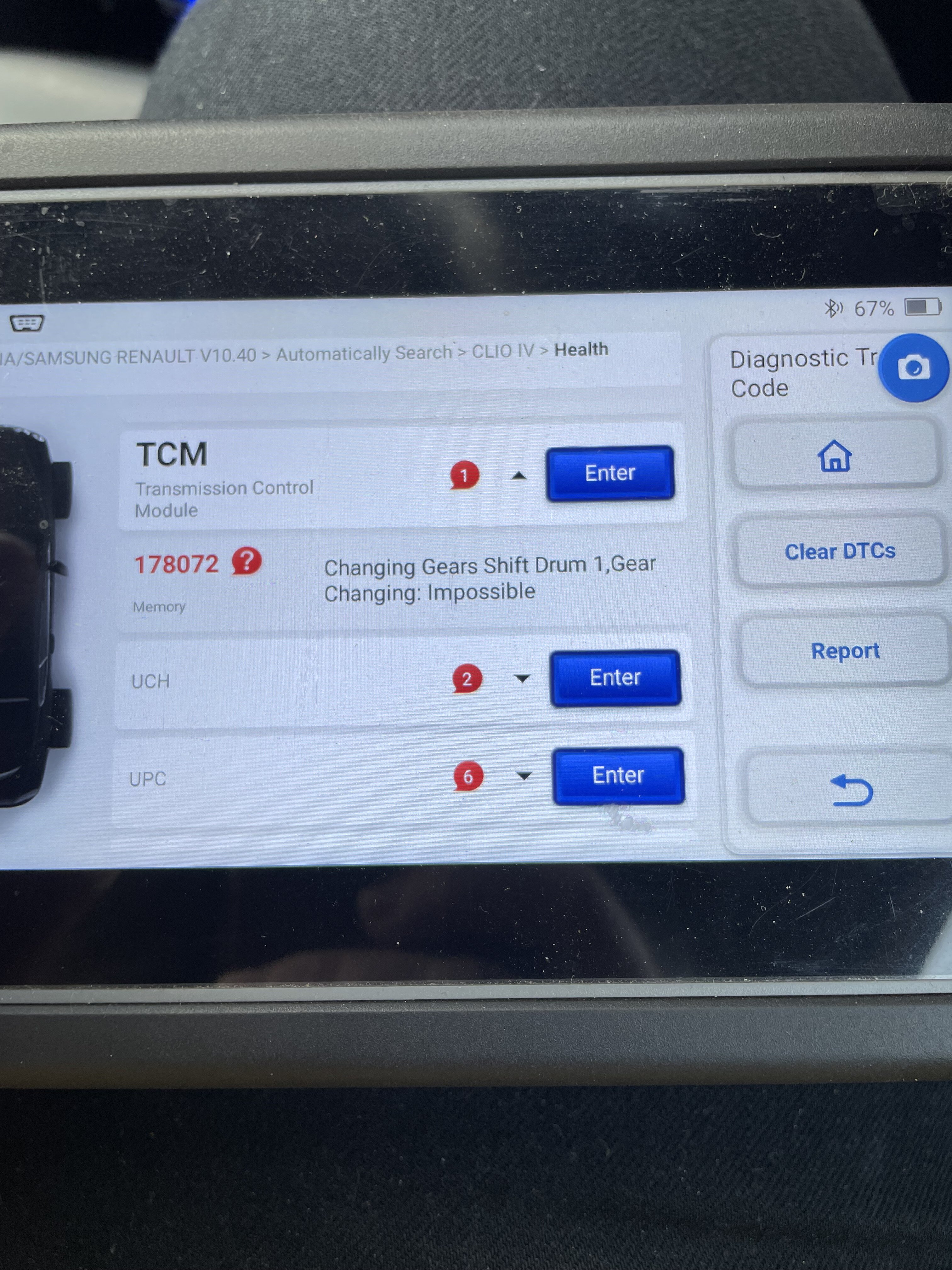

That was until this week. Had a dreaded check gearbox error twice one morning, with one of them requiring a restart to get out of limp mode. Id been expecting it for a while as there's a common issue with battery condition and gearbox hissy fits.
New battery on, and some how It managed to loose some setting for the tpms which then put the dash into an error state. Took about an hour of faffing to find the issue and code it again. Was basically because I'd switched off tpms but that battery reset made the dash think it was there again 🤷
Onto today, made it to work fine now issues. On the way home i spotted what looked like a turbo mx5, a 918 porsch and an astra having a play, why not join in.... hit sports mode and instantly the car dropped into limp. Reset the car an tried again. Was all good so hit sports and same again...
Not sure where to go with this now, I'll see how much it plays up as it's still drivable but a little miffed with it. There is a listed fault that a there initially but searching doesn't yield much.

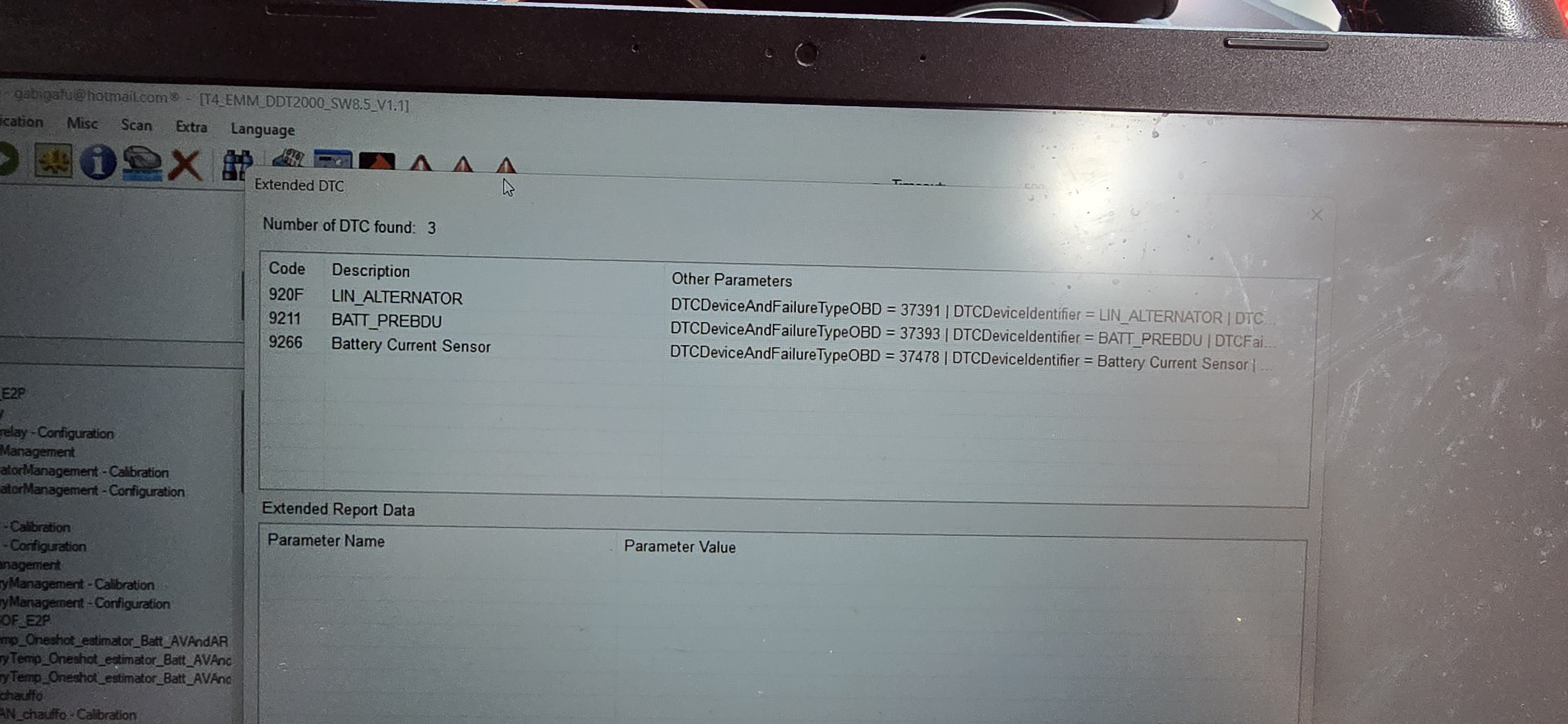

So.... I've driven the car to London this morning 🤦🏻‍♂️ 3 times it did it, i think I've figured if you ask it to shift quickly it does it. But light throttle and slow changes it's seemingly OK.... It did also, on 5 occasions hit me with a quick flash of the stop for a charging issue.
So currently my thought is, the smart charging module thing is failing or the alternator...
Got a 130mile drive back yet to ponder on it.
Wish me luck

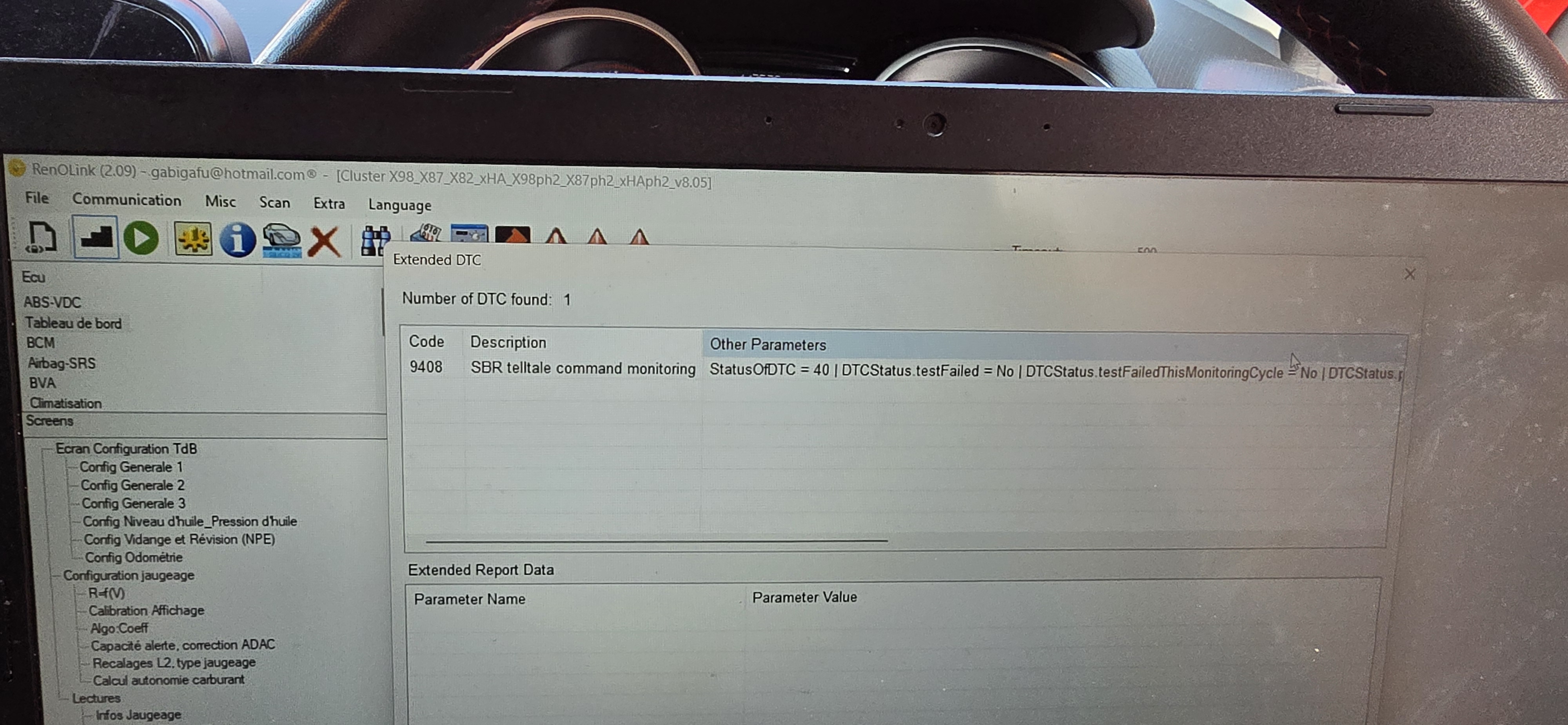

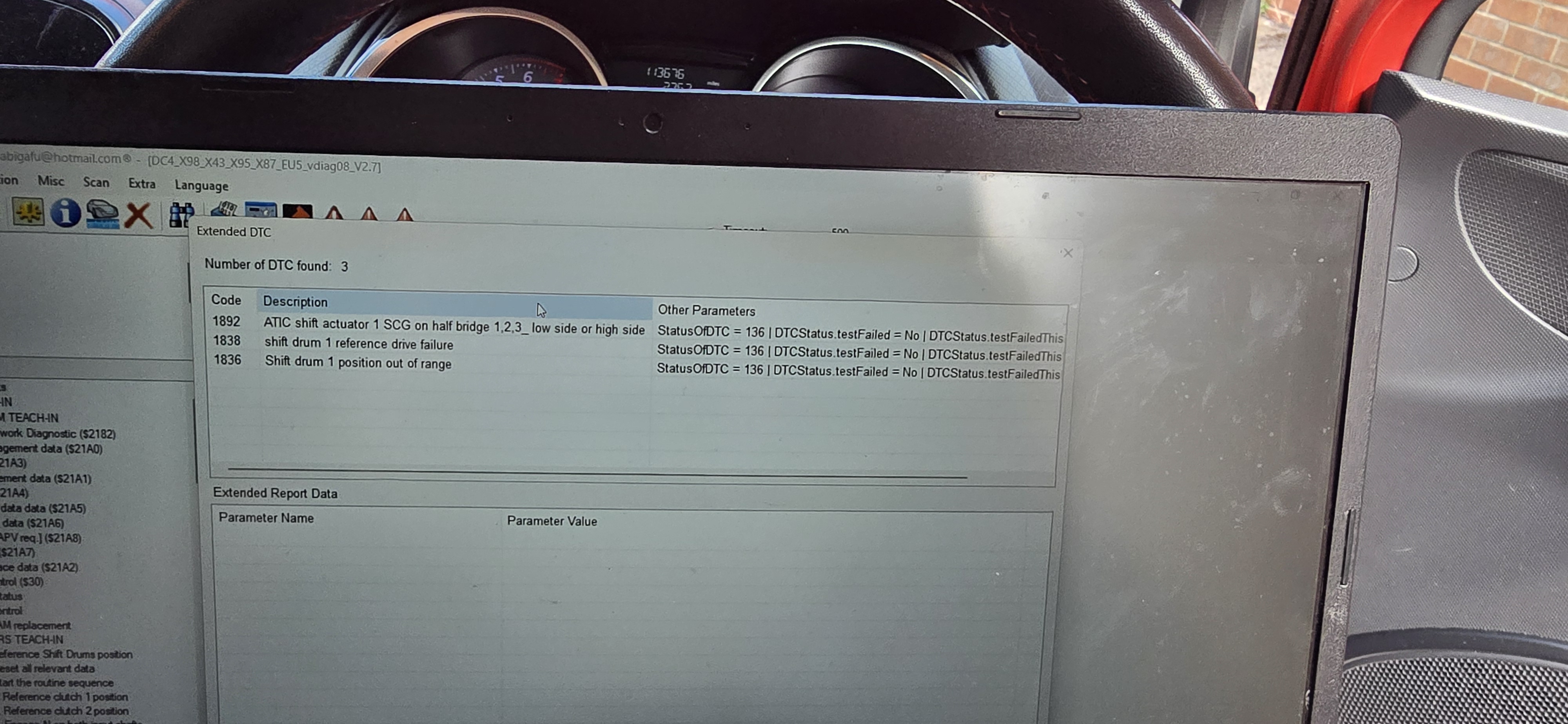

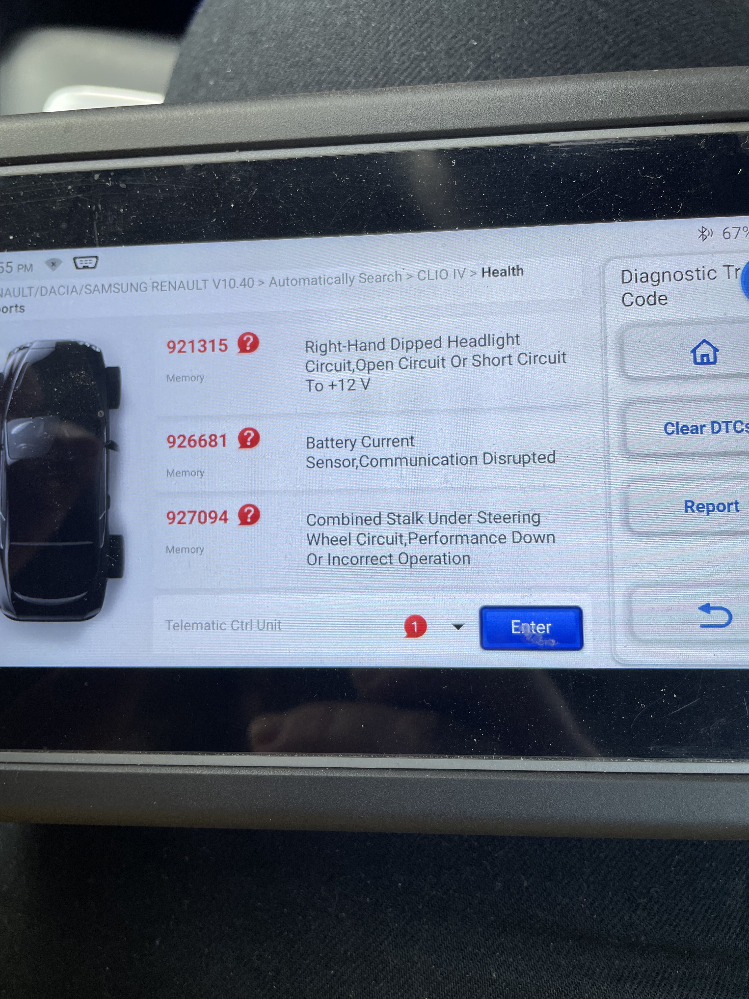

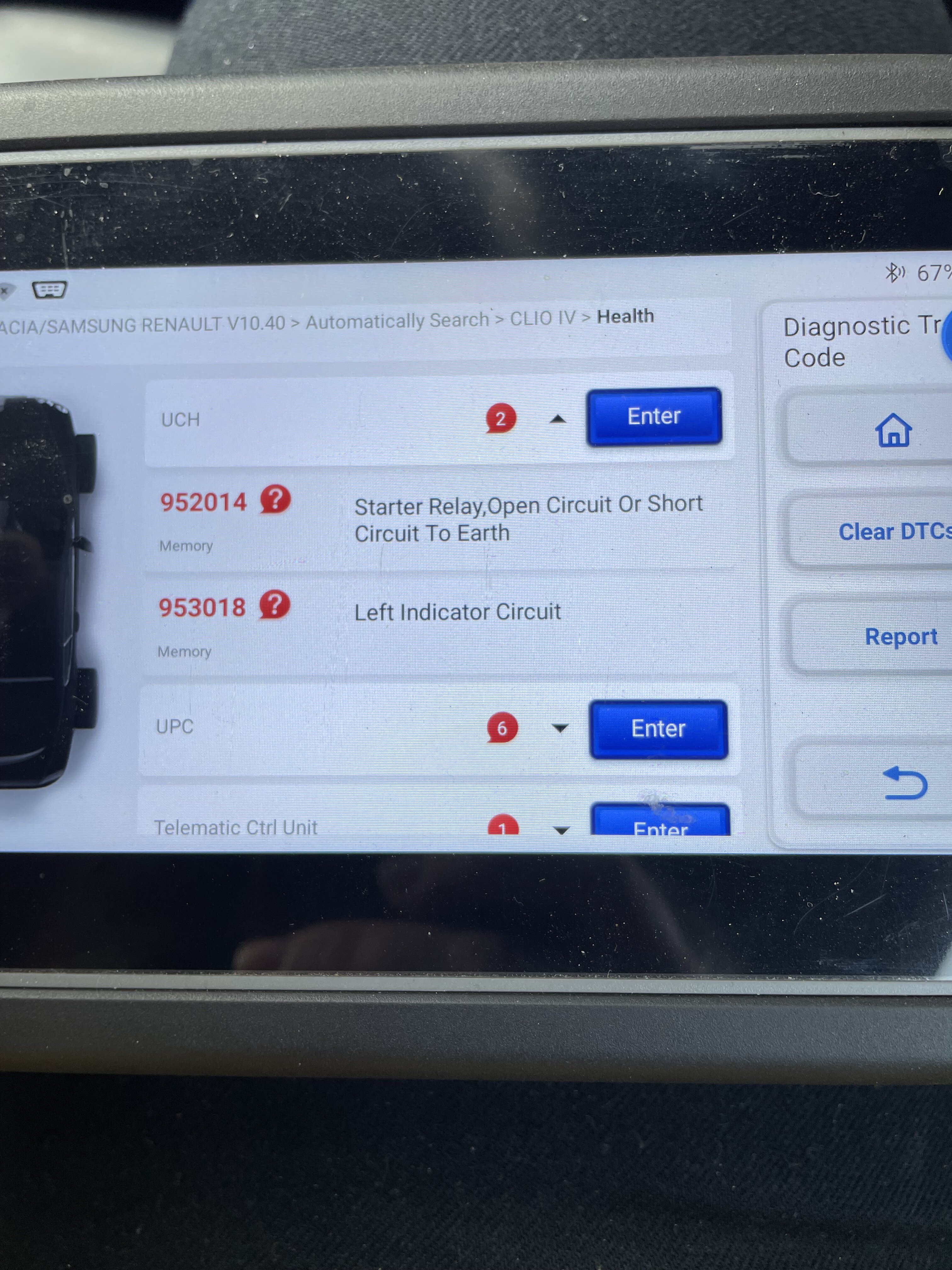

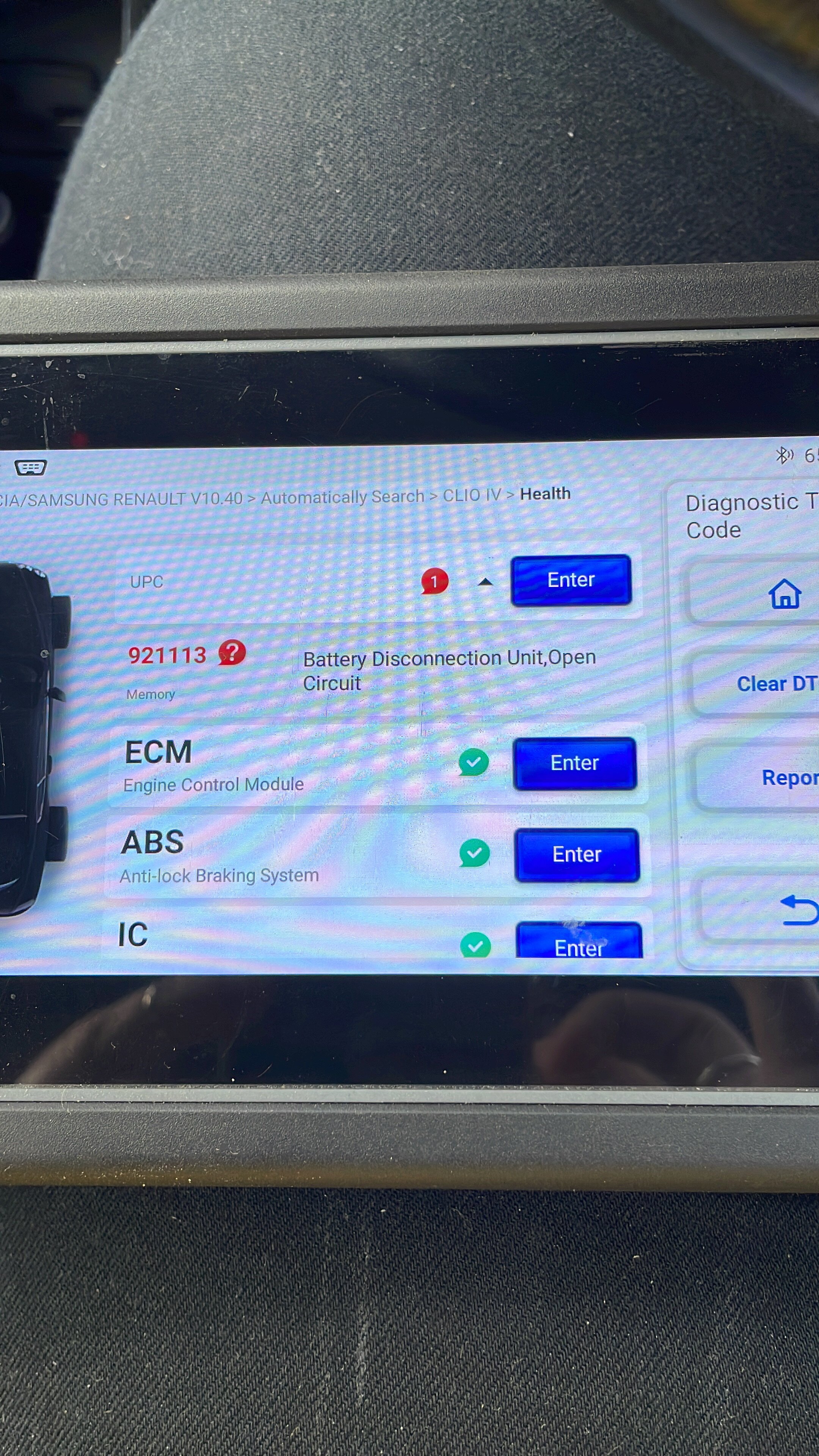

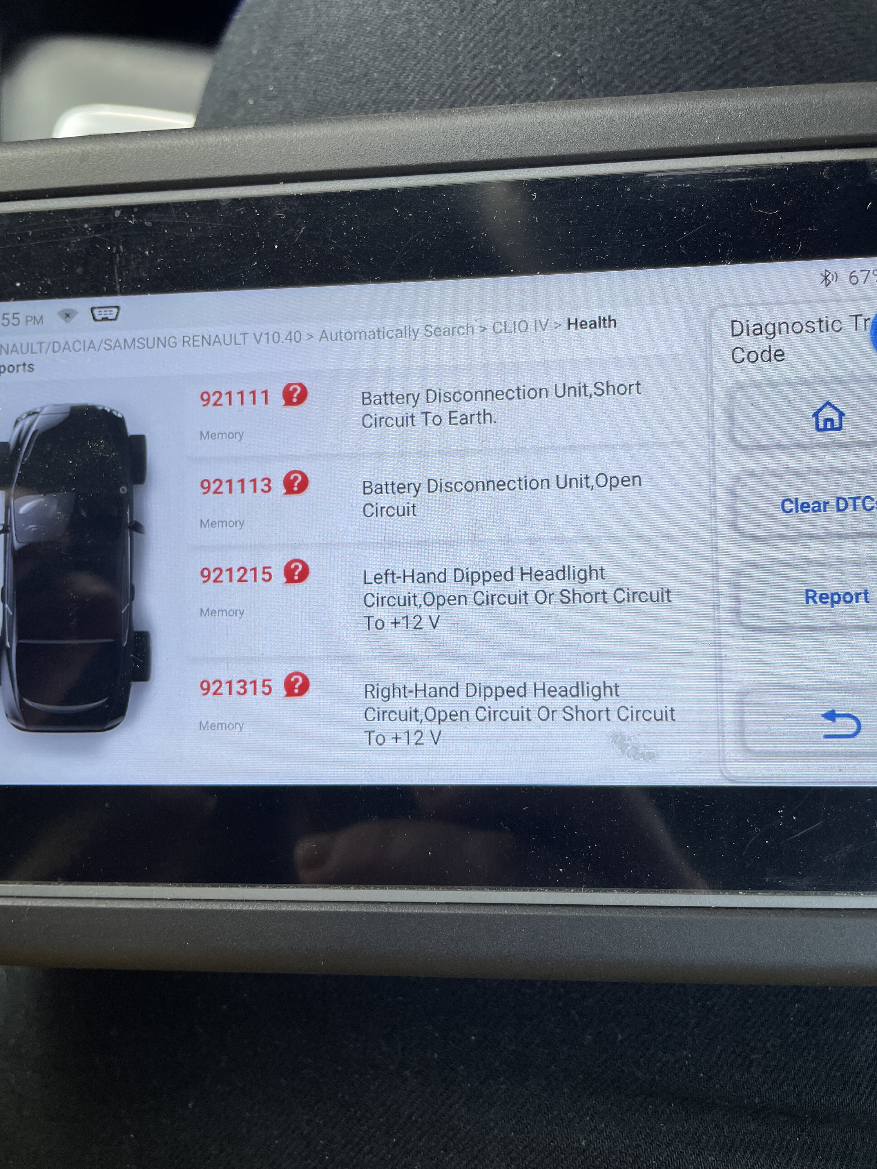

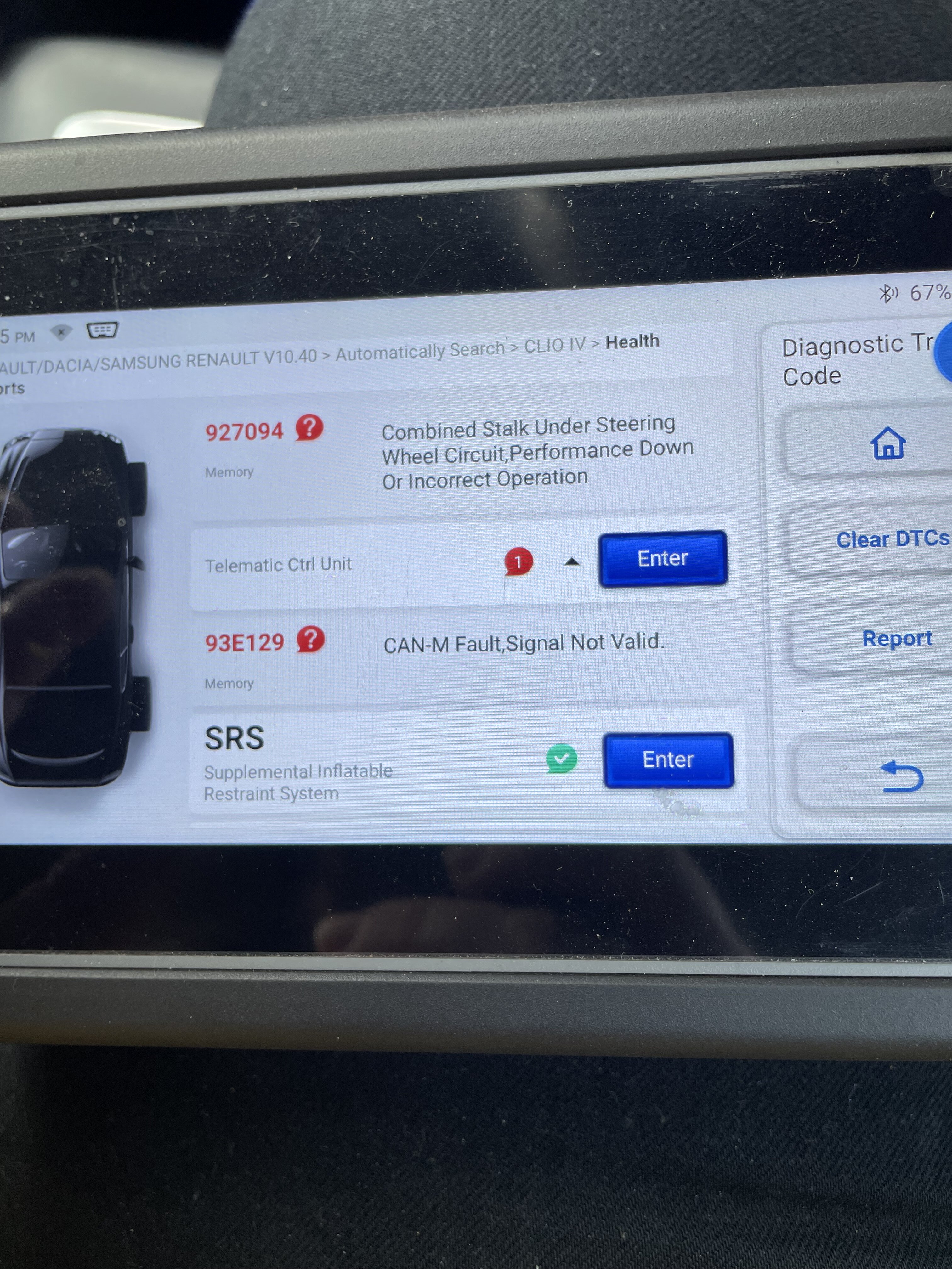

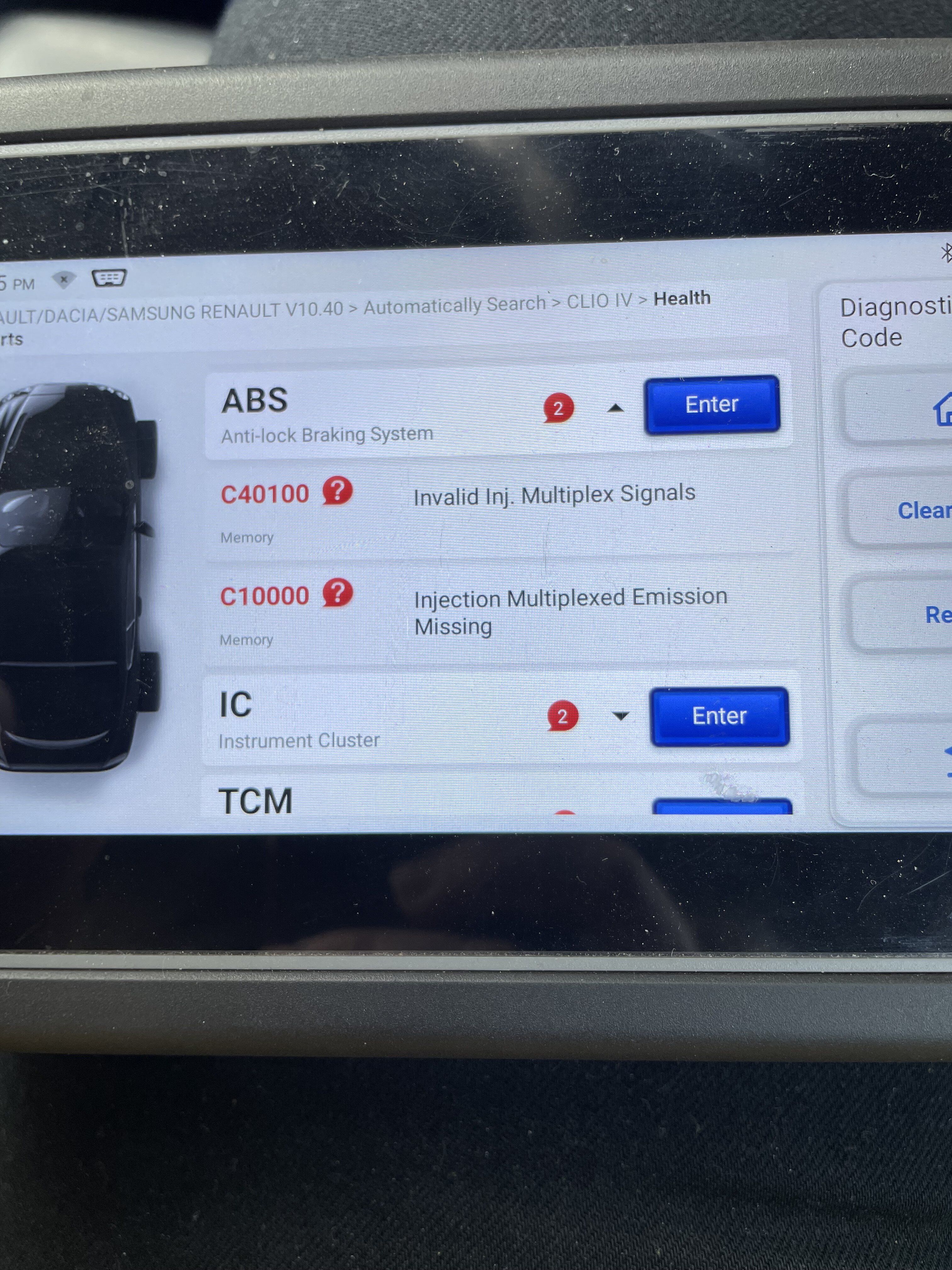

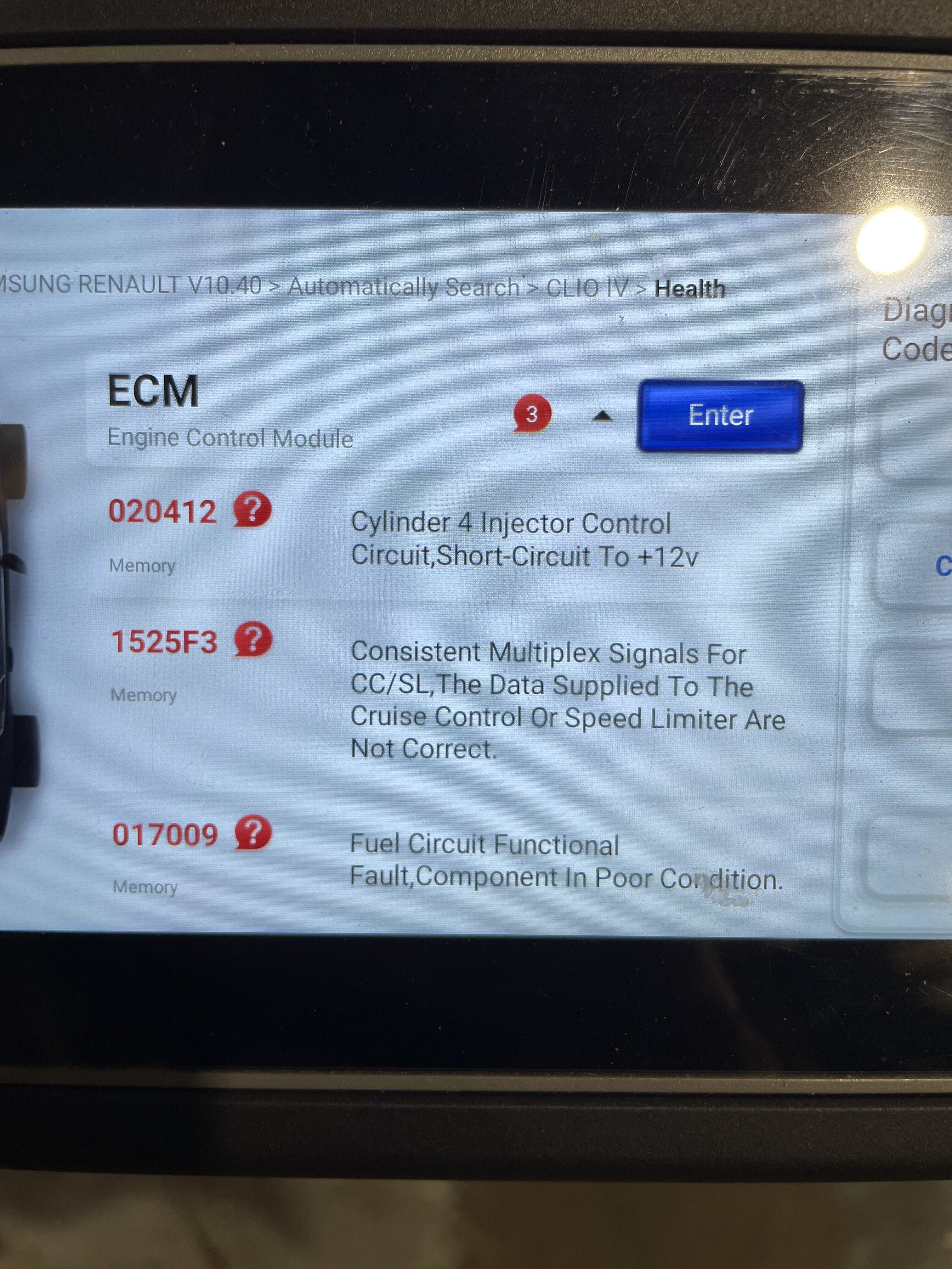

Well I made it back. Whole slew of new fault codes stored.
I've ordered the voltage regulator from rpd so that's the next thing in the parts cannon.
Output when loaded looks OK and sits at 14.4 with the lights on.
Cleared all the codes and went to drive it... got stuck in the middle of my road.
Any input on the faults is appreciated

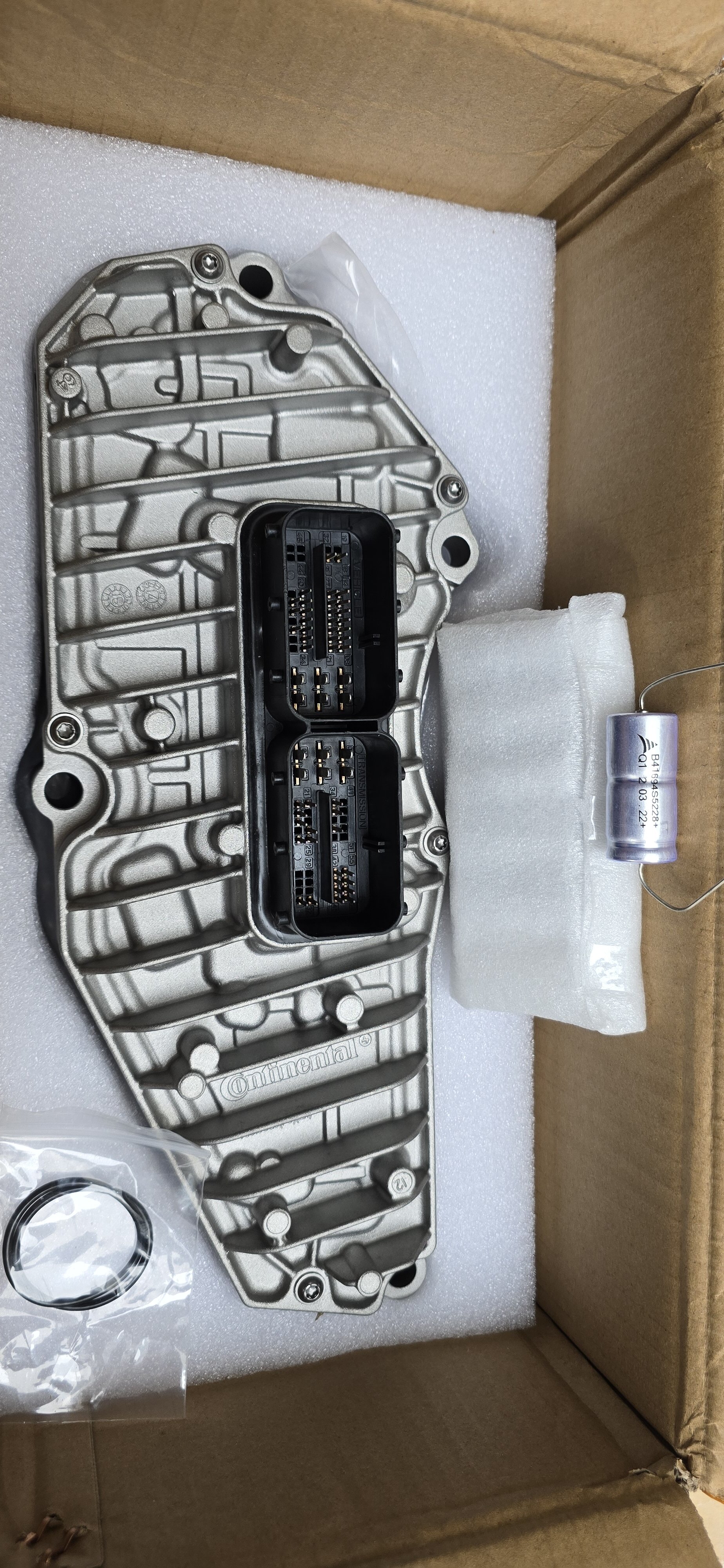

I've managed to track down the original capacitors from the tcu so have ordered a few just incase
The oem items are made by Epcos
40v 2200uf b41694s5228

Had a disconnect of some wiring looms and cleaned them off, could see anything wrong with a light browse. Kicked its head on for a while and just as I was heading home it went into limp mode again. The search continues but I'm leaning toward a failing TCU (or the capacitor in it)
Capacitors are ordered but may take a few weeks to get here (will see if I can get some quicker through work) I'm also conversing with some of the Chinese suppliers to see if I get get a back door TCU at a quarter of the price. Looking around a few have had good success with this. From what I can gather they are all built and assembled over there anyway and you are just buying them before they hit the usual supply chain to Renault.

TCU ordered, and have seen they offer the clutch packs for the Ford variant, wonder if they do a Clio specific one too. What funny is they look like the LUK clutches including the packaging, but you get it "unbranded". for a small fee they will box and brand them as whatever you want lol.

In other news, both the TCU and capacitors arrived today. Ready to swap out if/when the fault comes back. Comes with the replacement seals too, looks very good. I do think its a back door job looking at it vs a moody reproduction. Time will tell.
