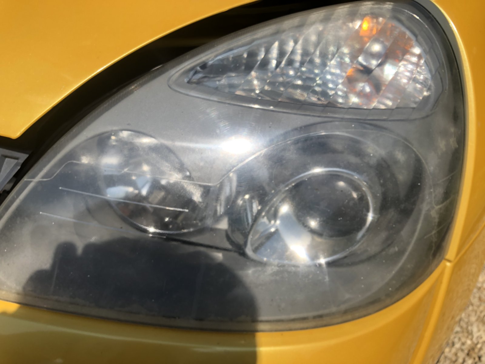

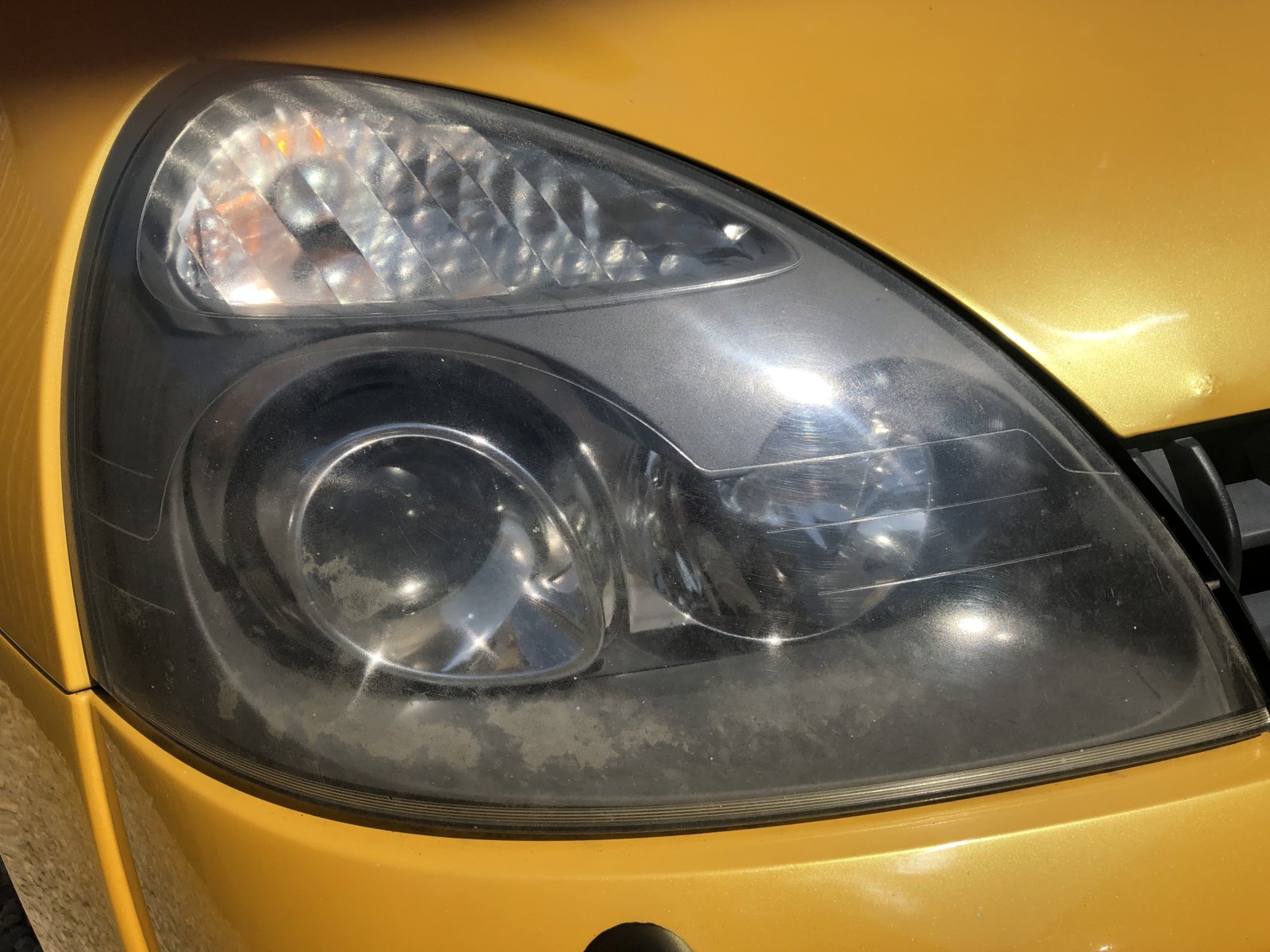

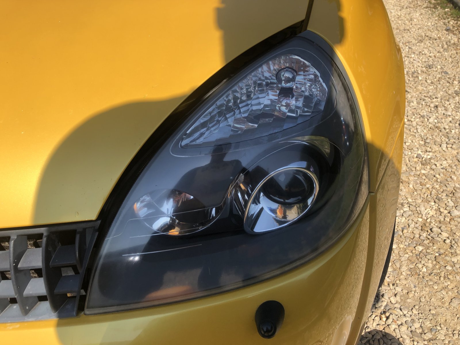

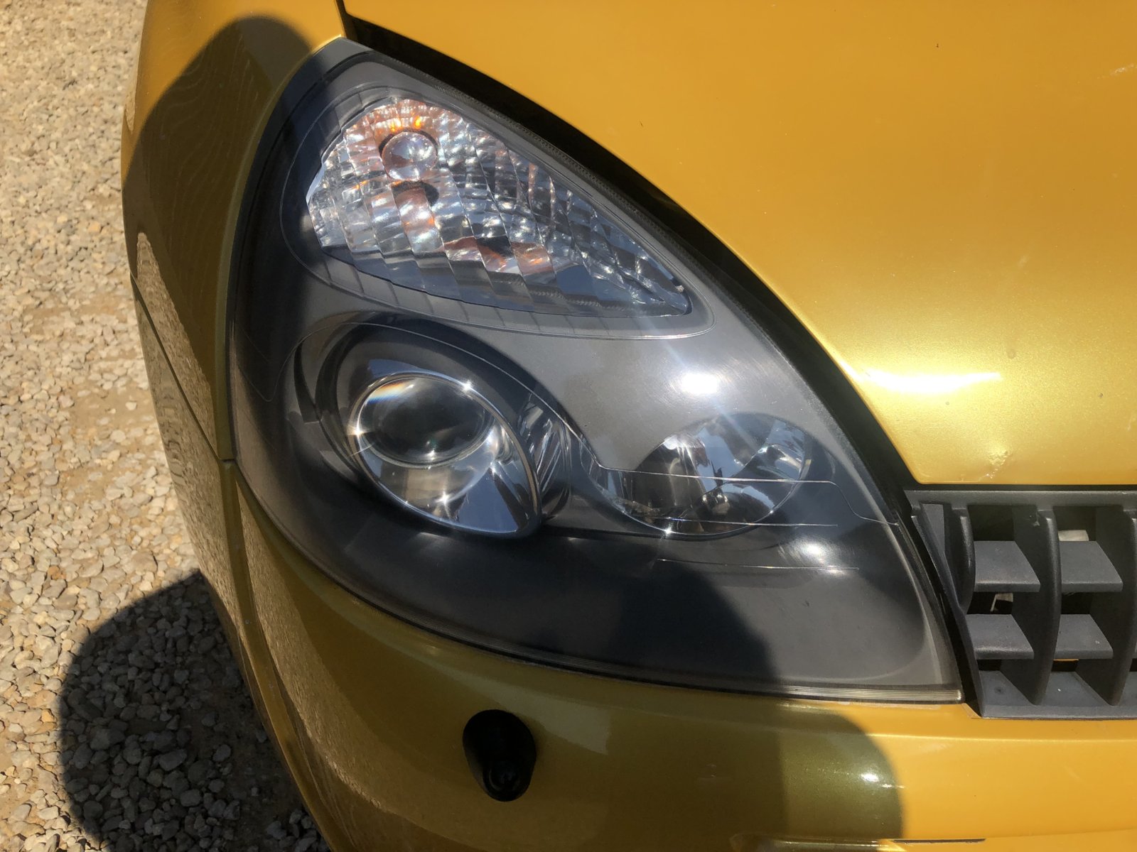

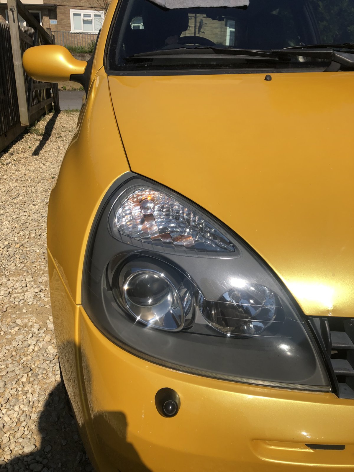

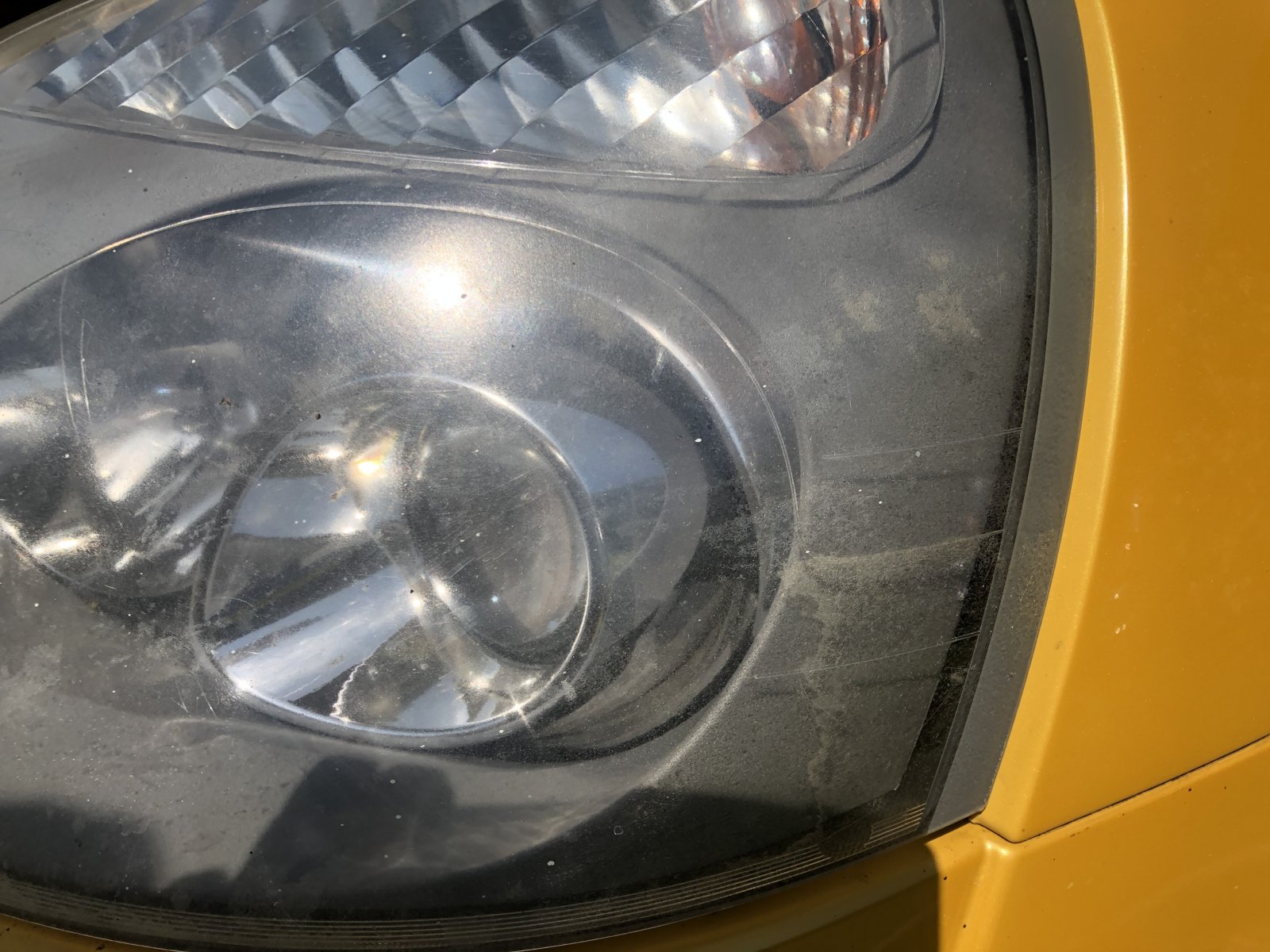

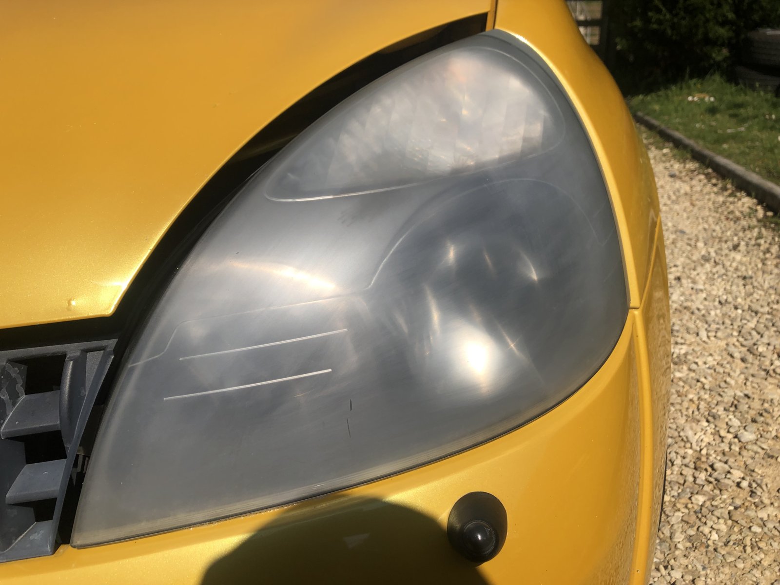

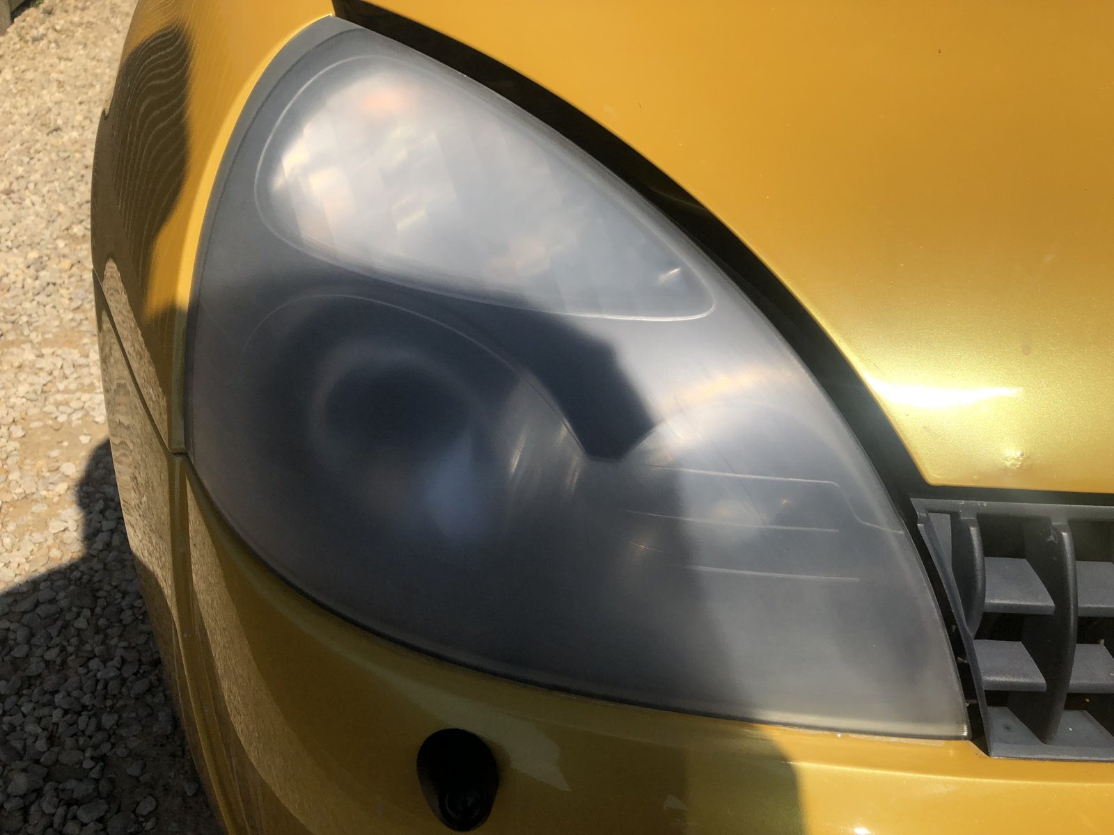

So headlights were doing my nut, spent 1hrs or so on them today and the results speak for them selves.
Before

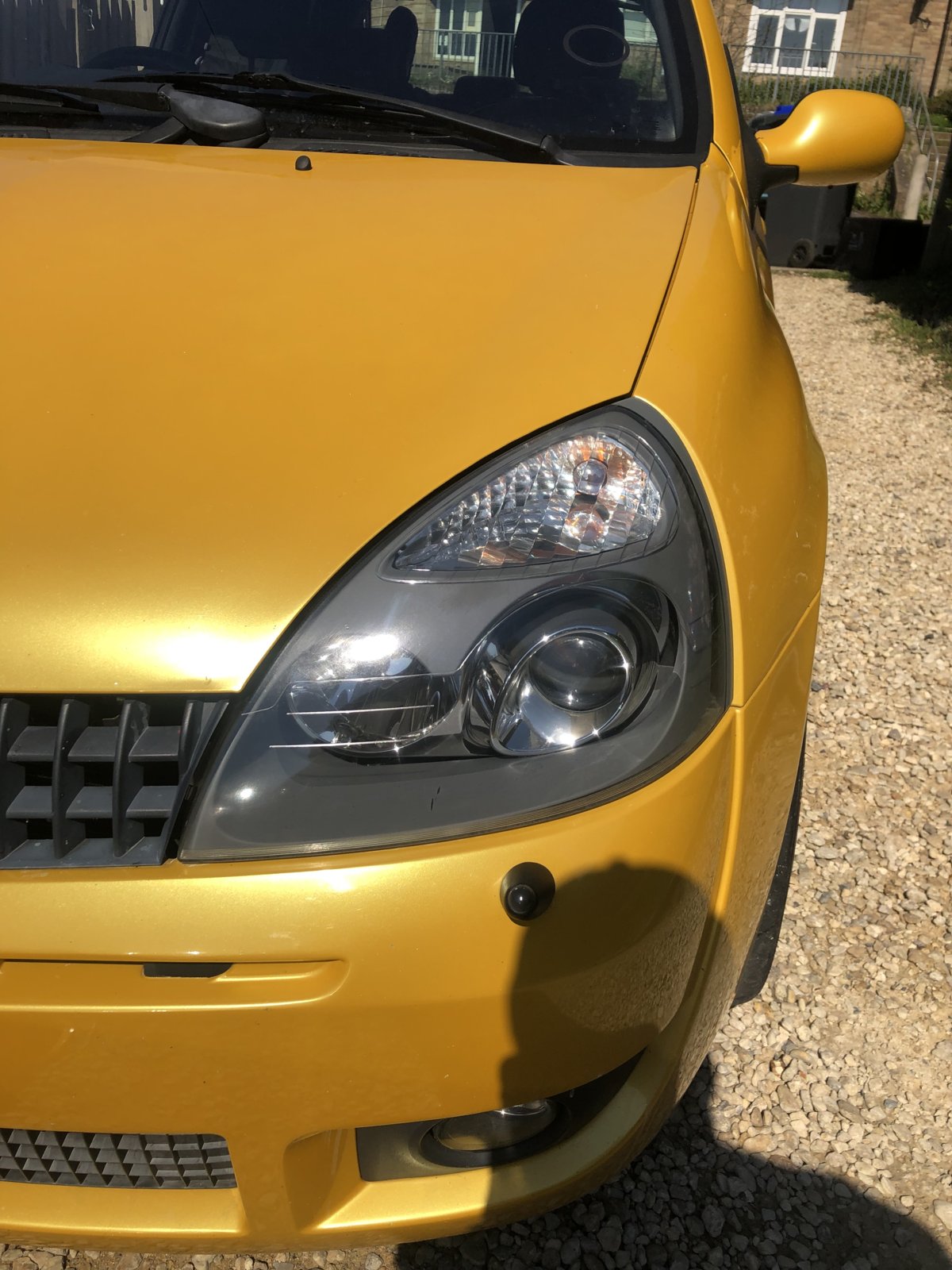

800 grit.
Didn’t take photos of 1200 grit so straight onto orange pad with medium cut compound with DA. 10 passes.
Finally refined and two layers of wax.

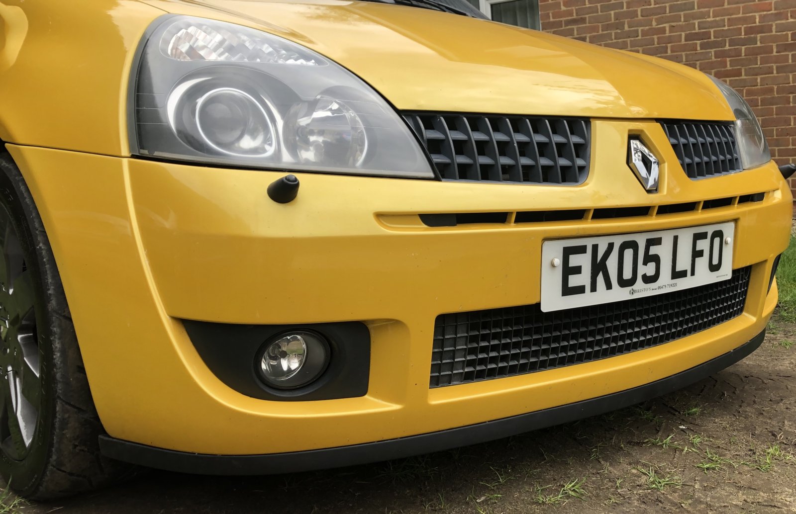

Fabia splitter arrived today, will bash that on tomorrow.
