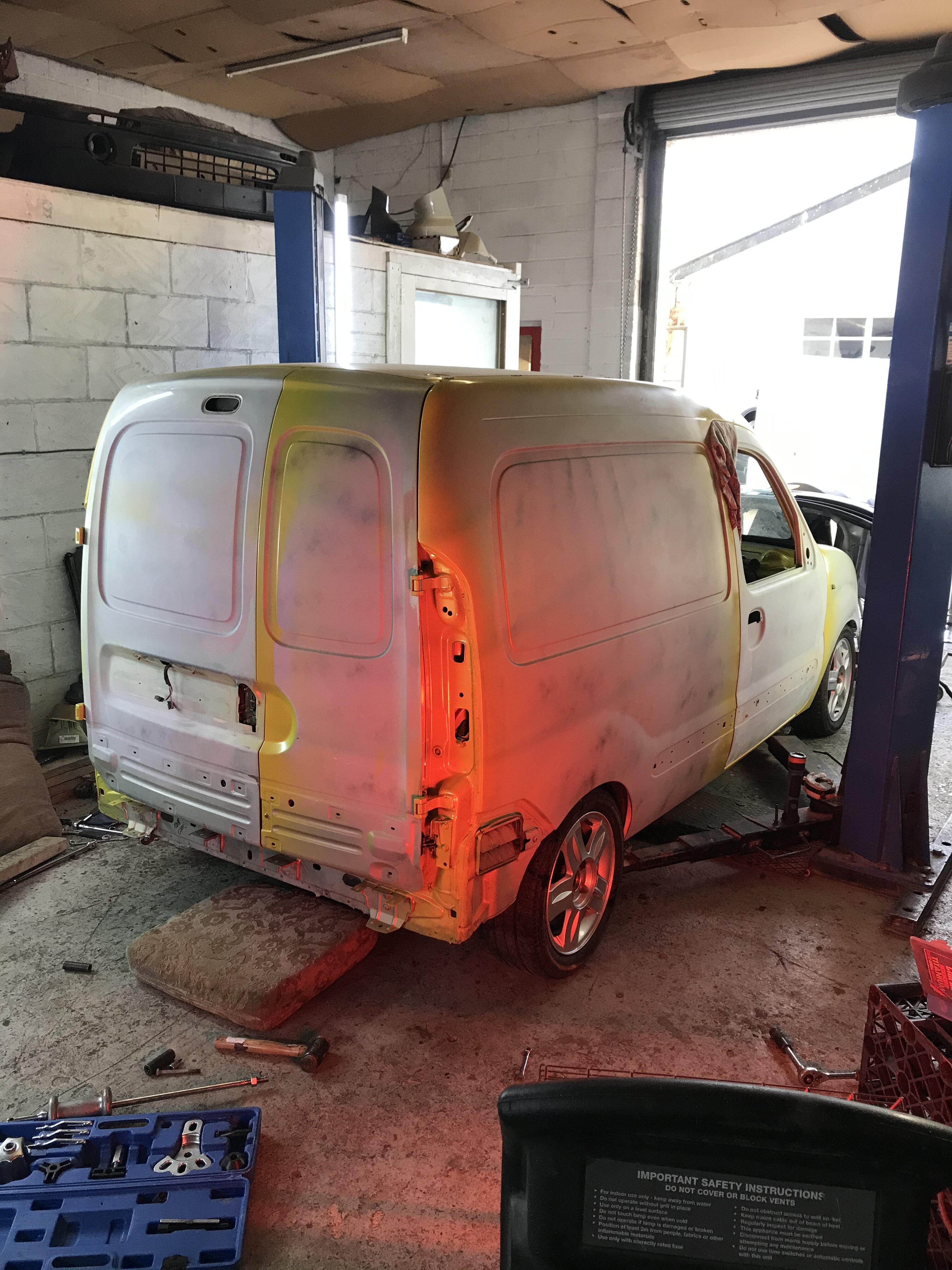

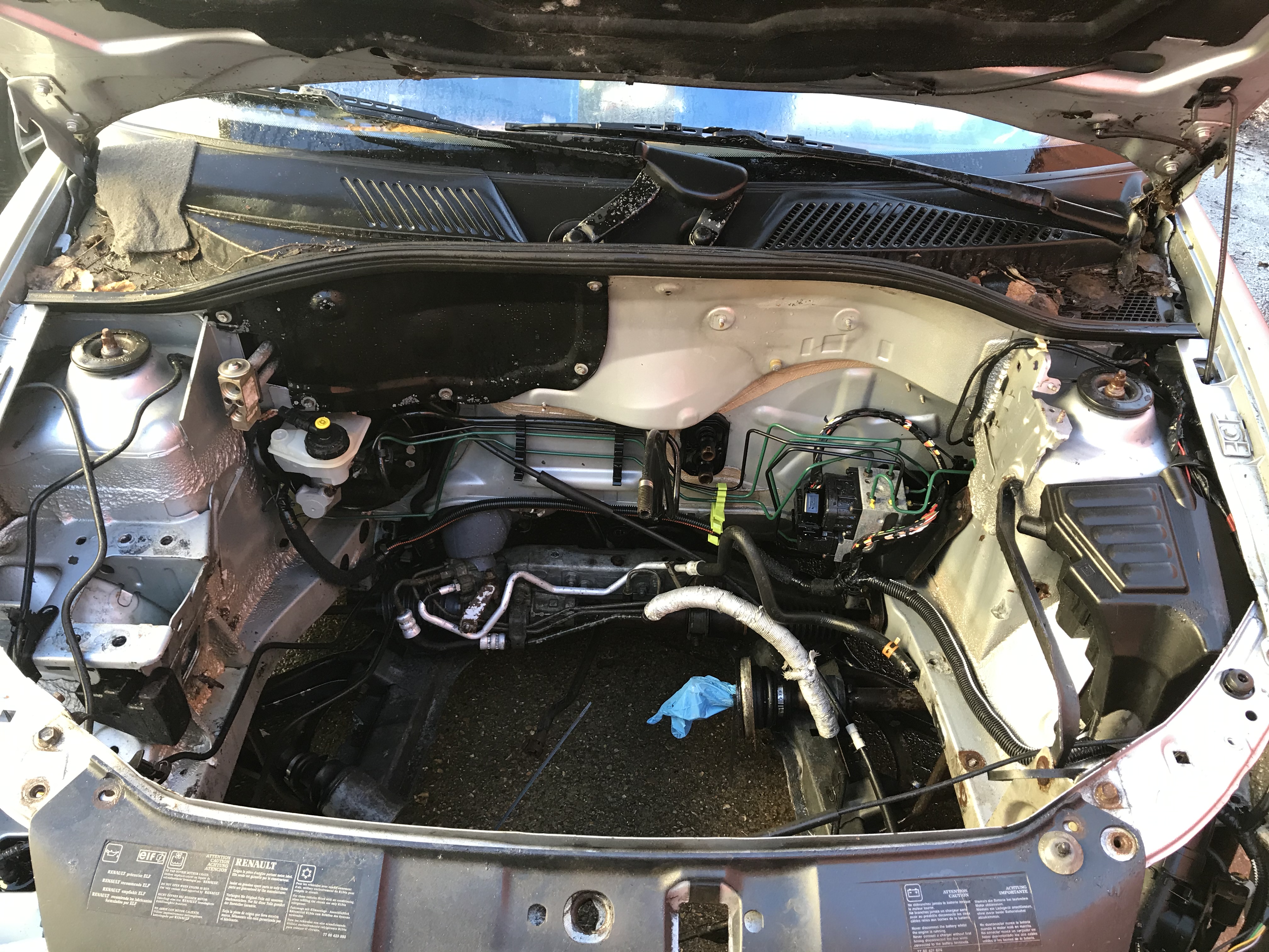

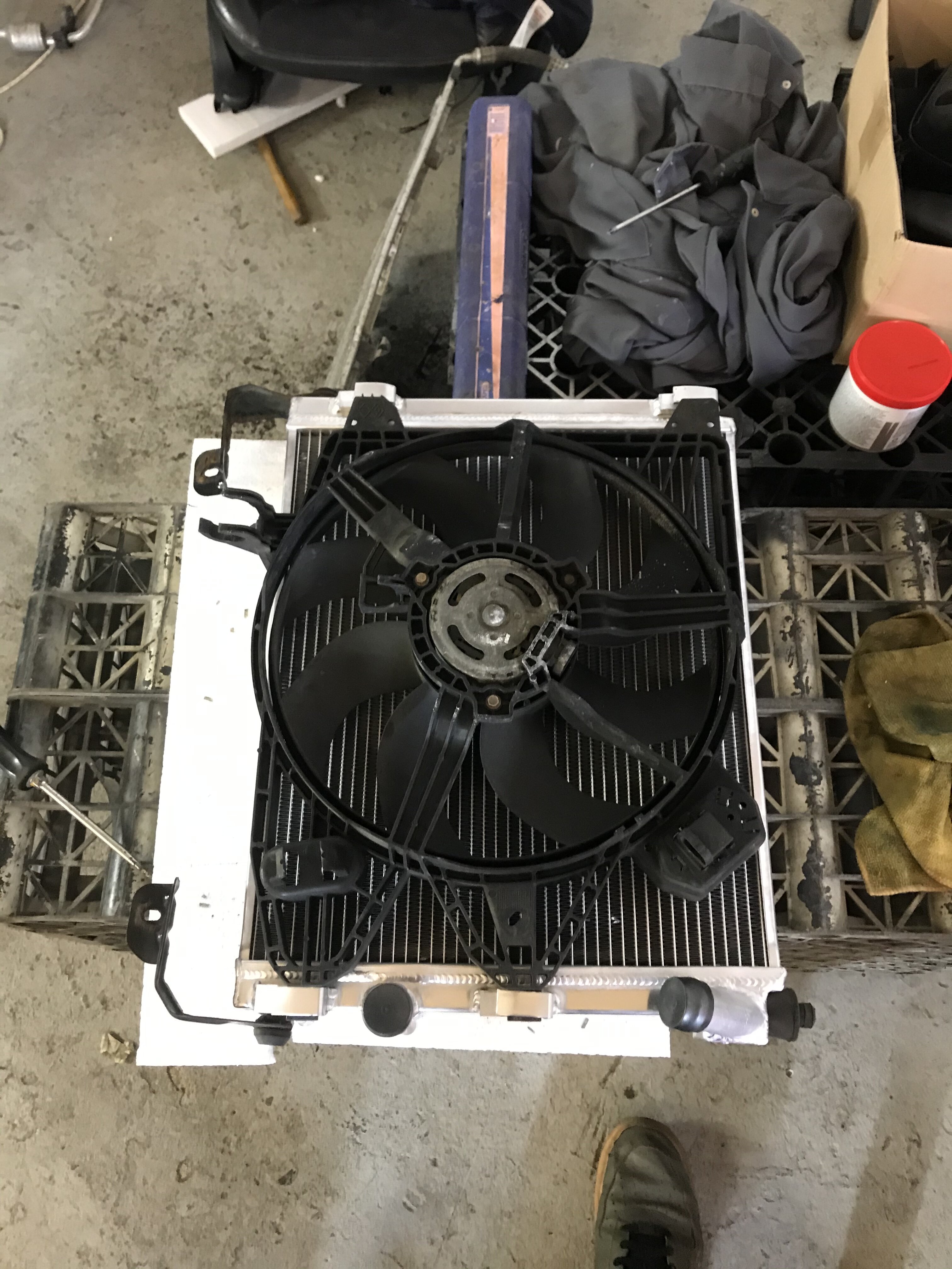

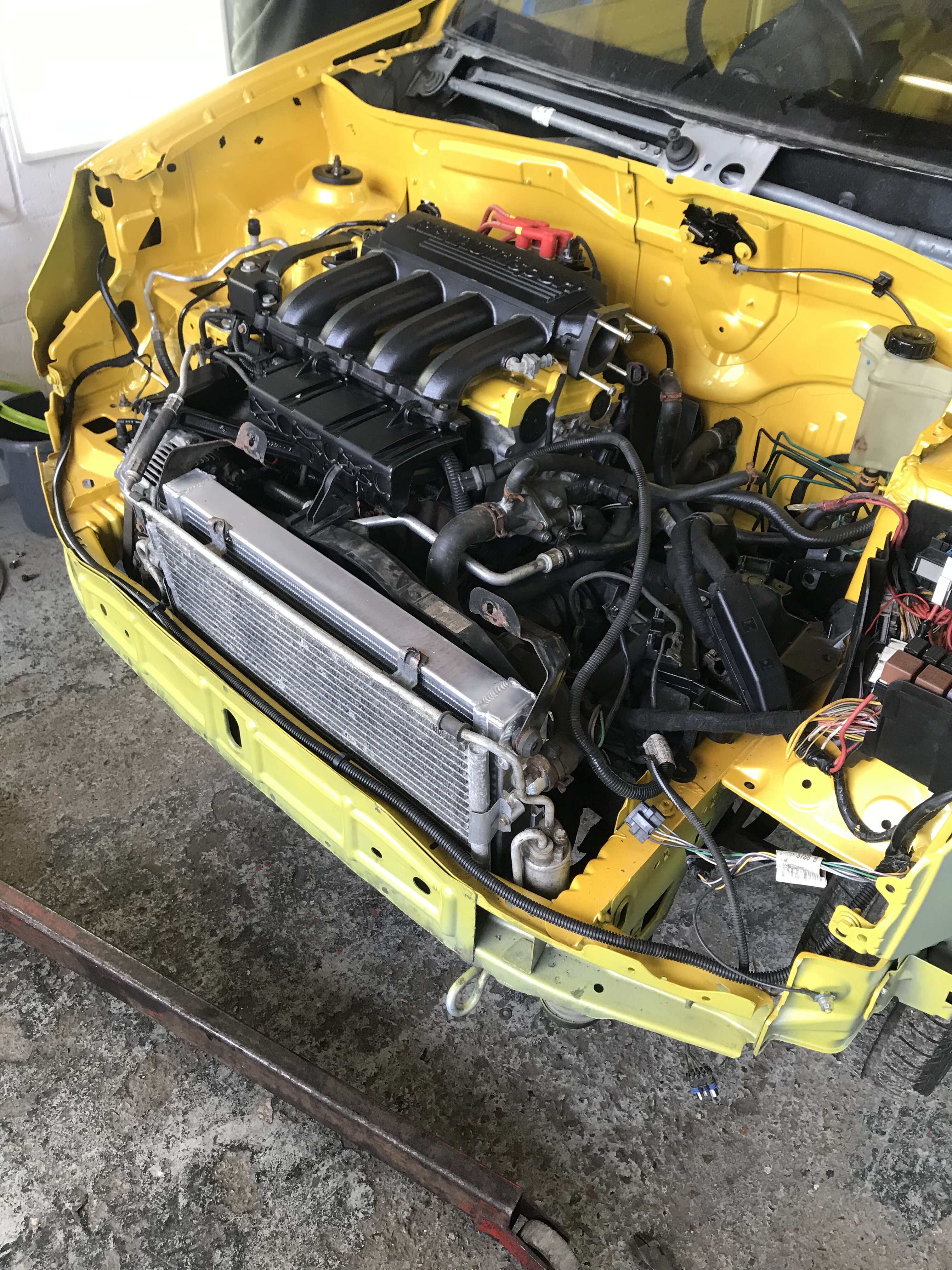

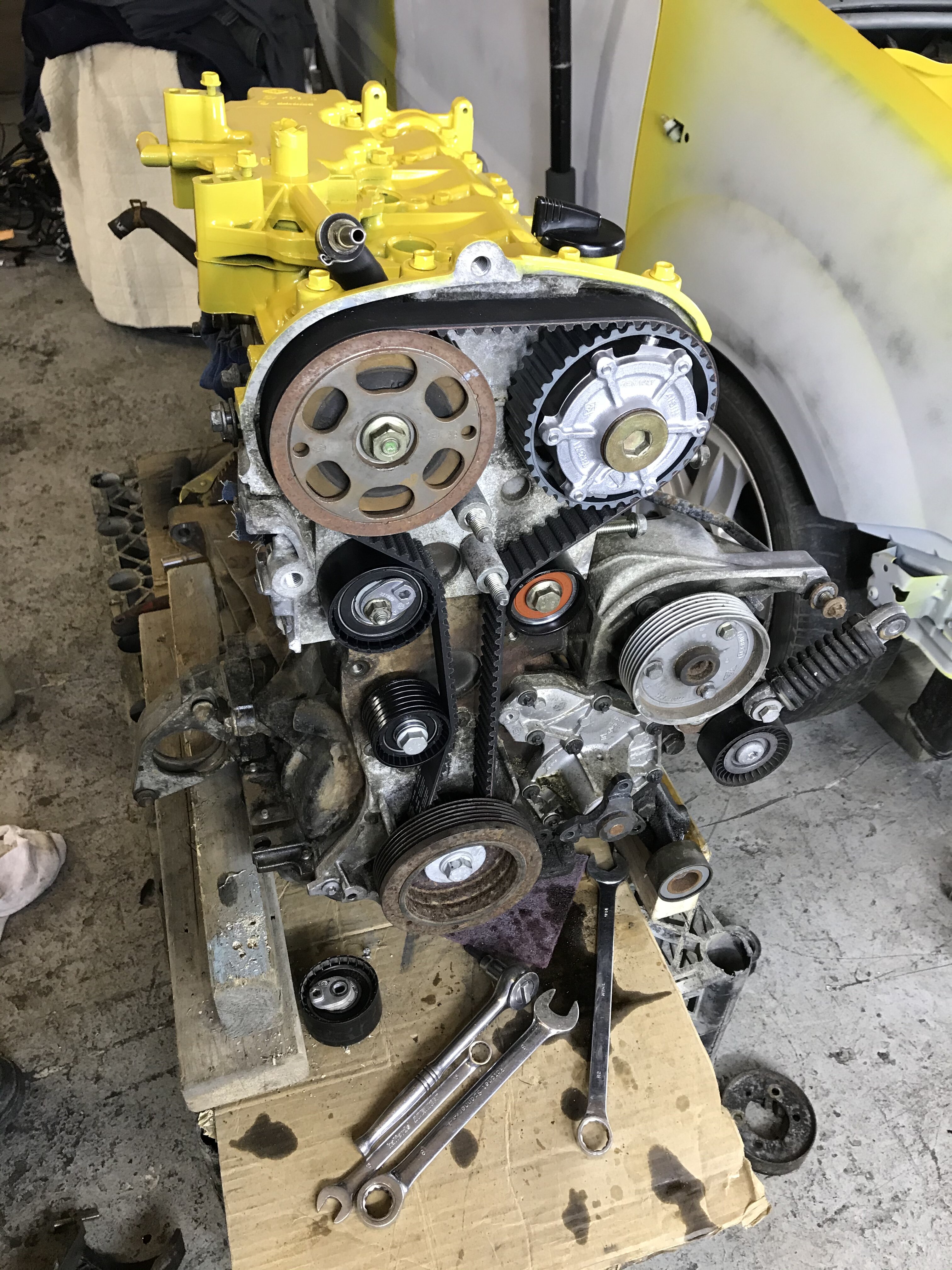

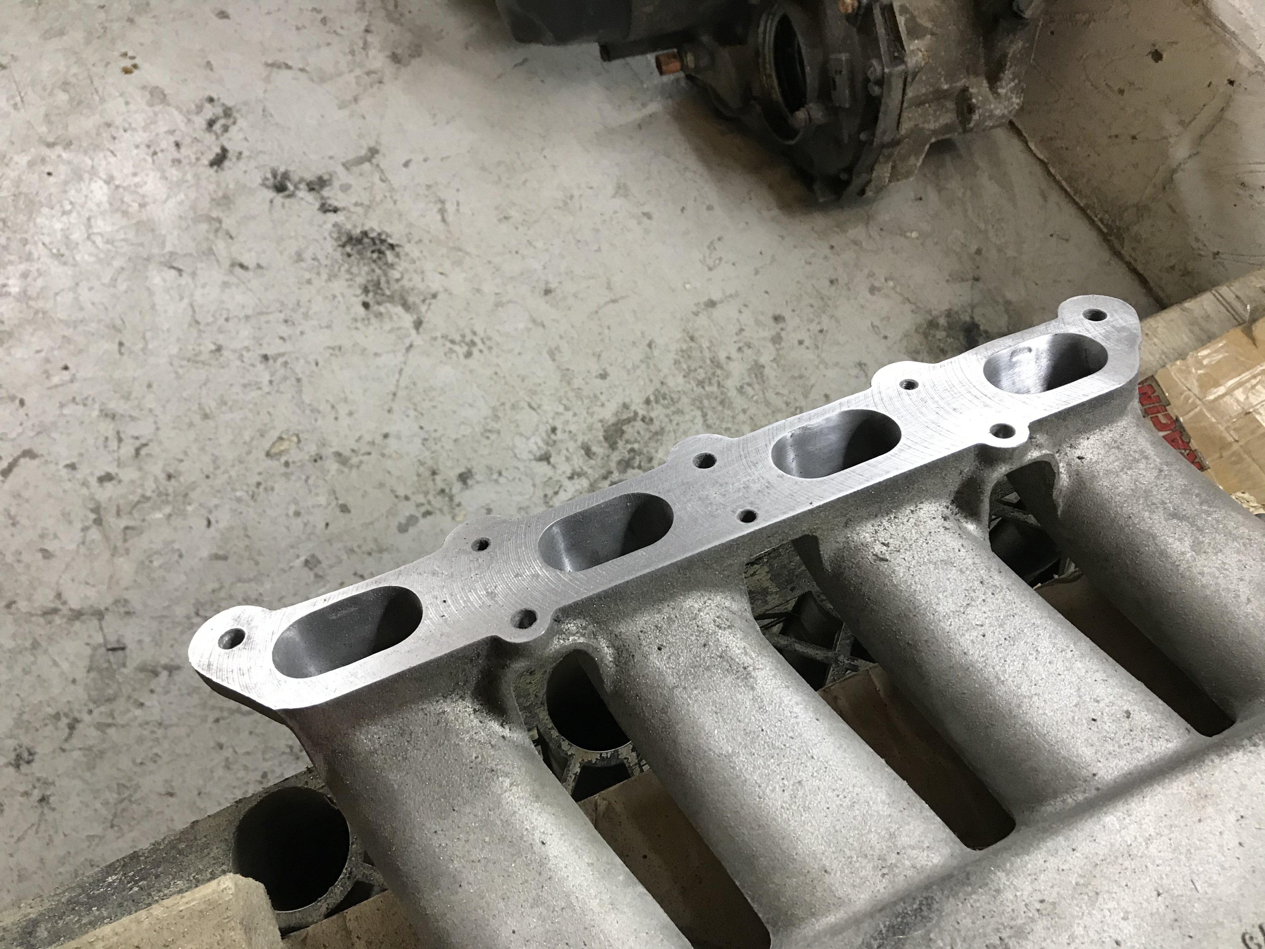

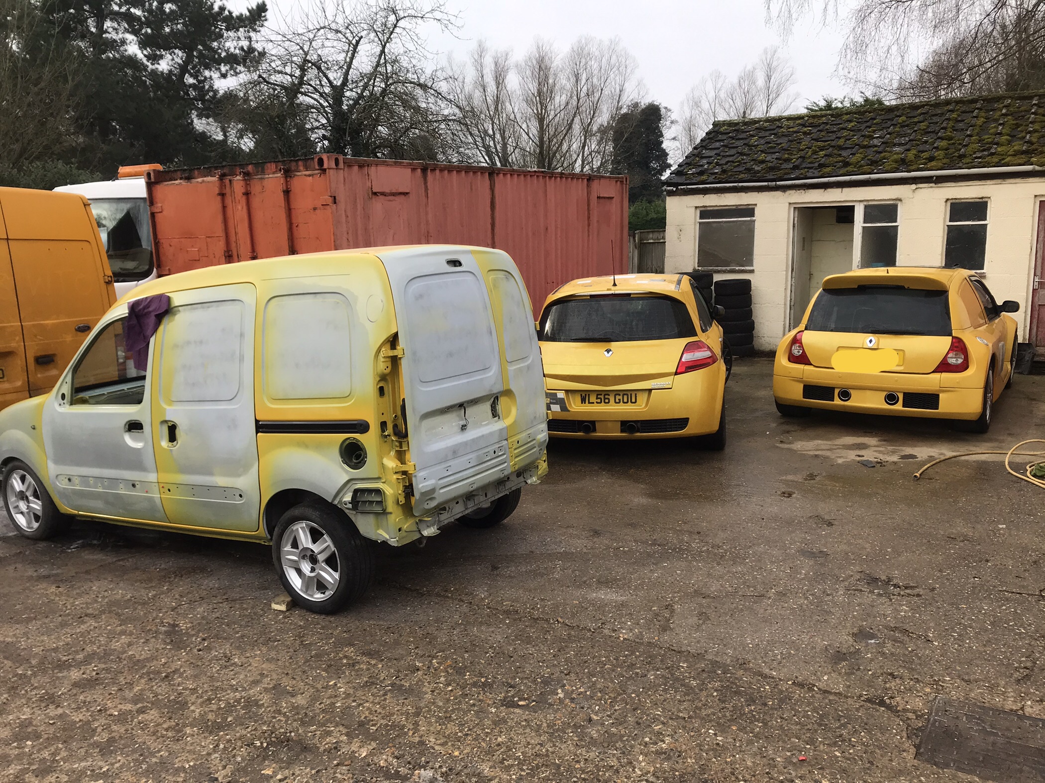

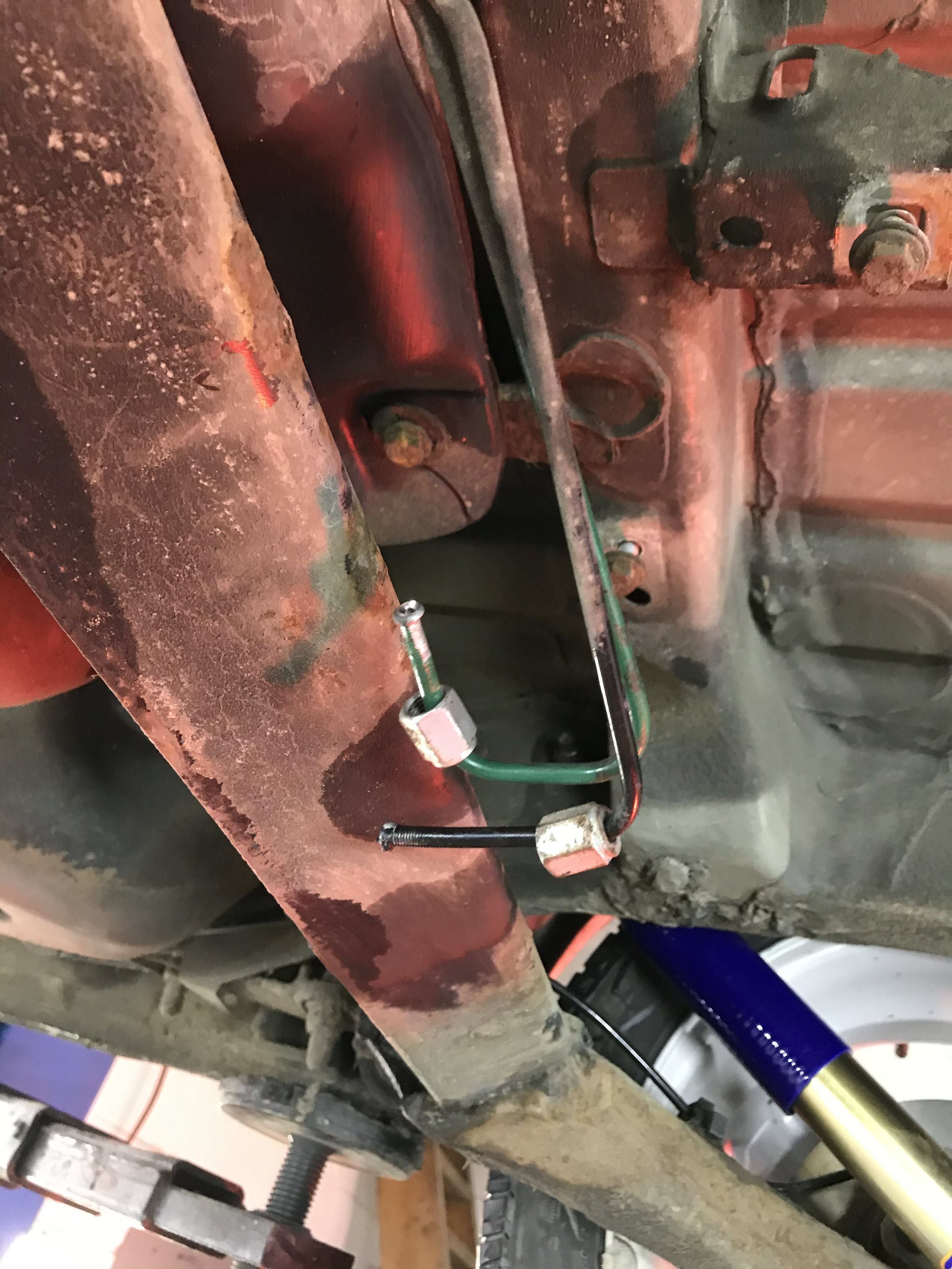

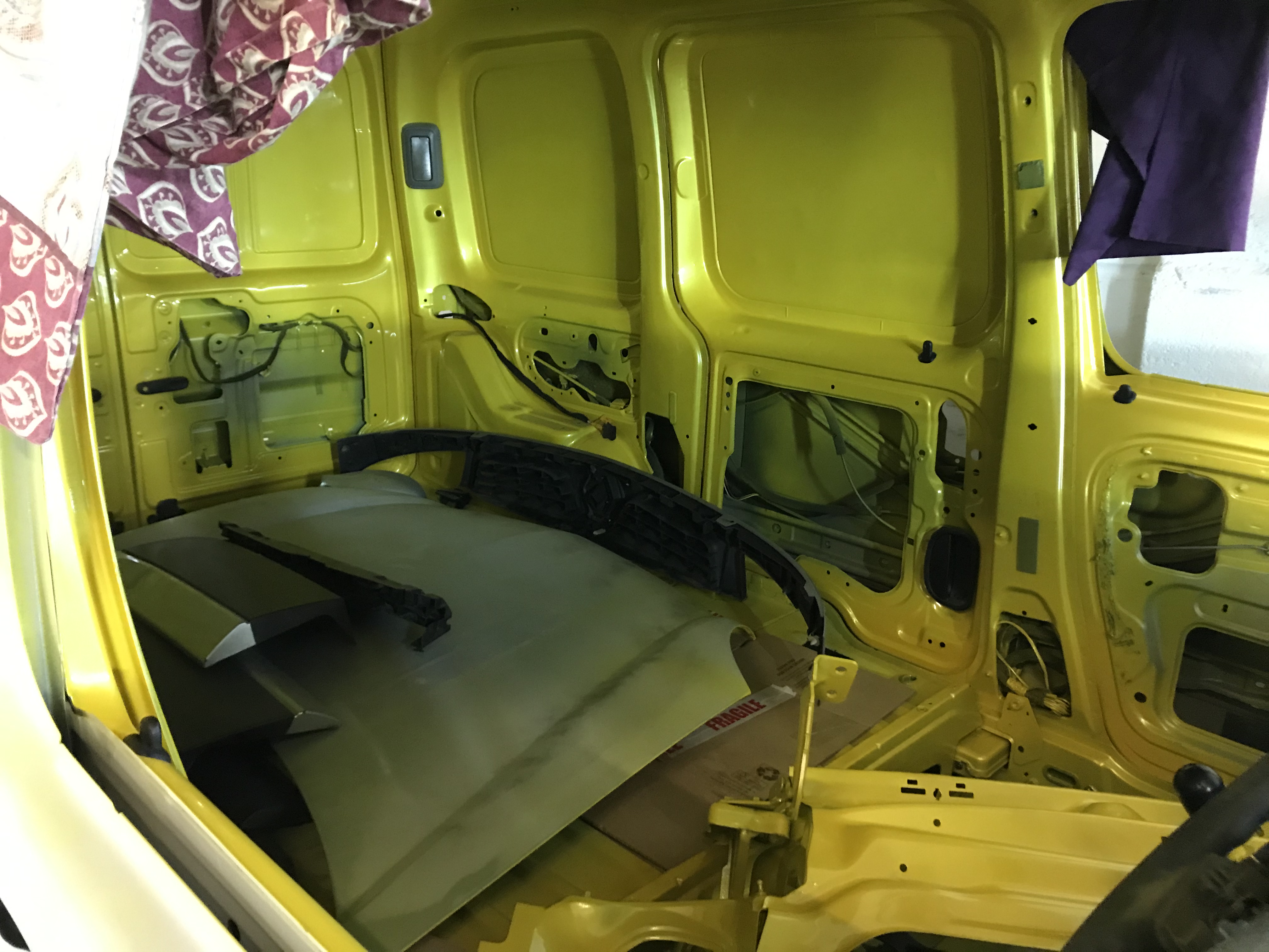

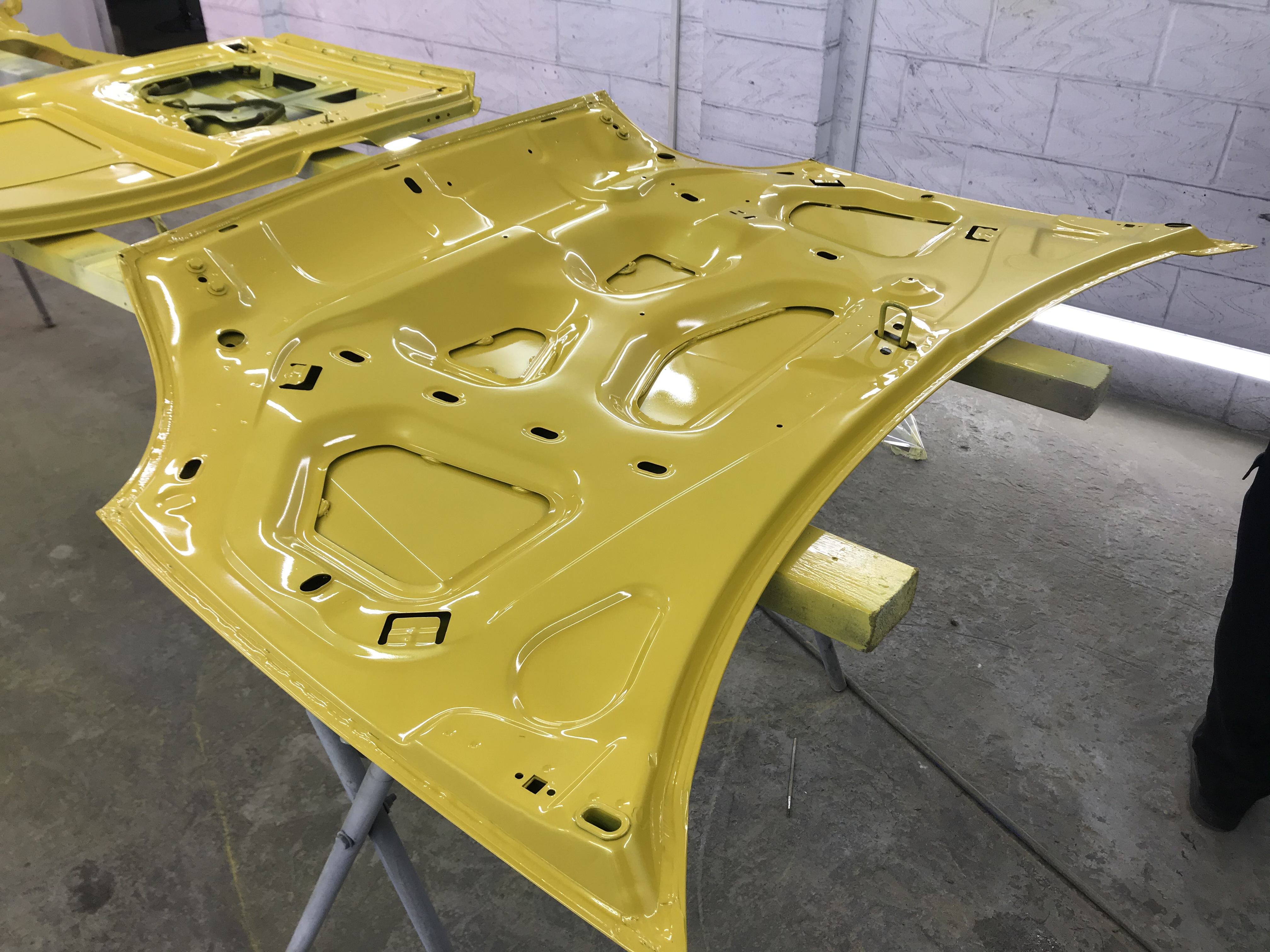

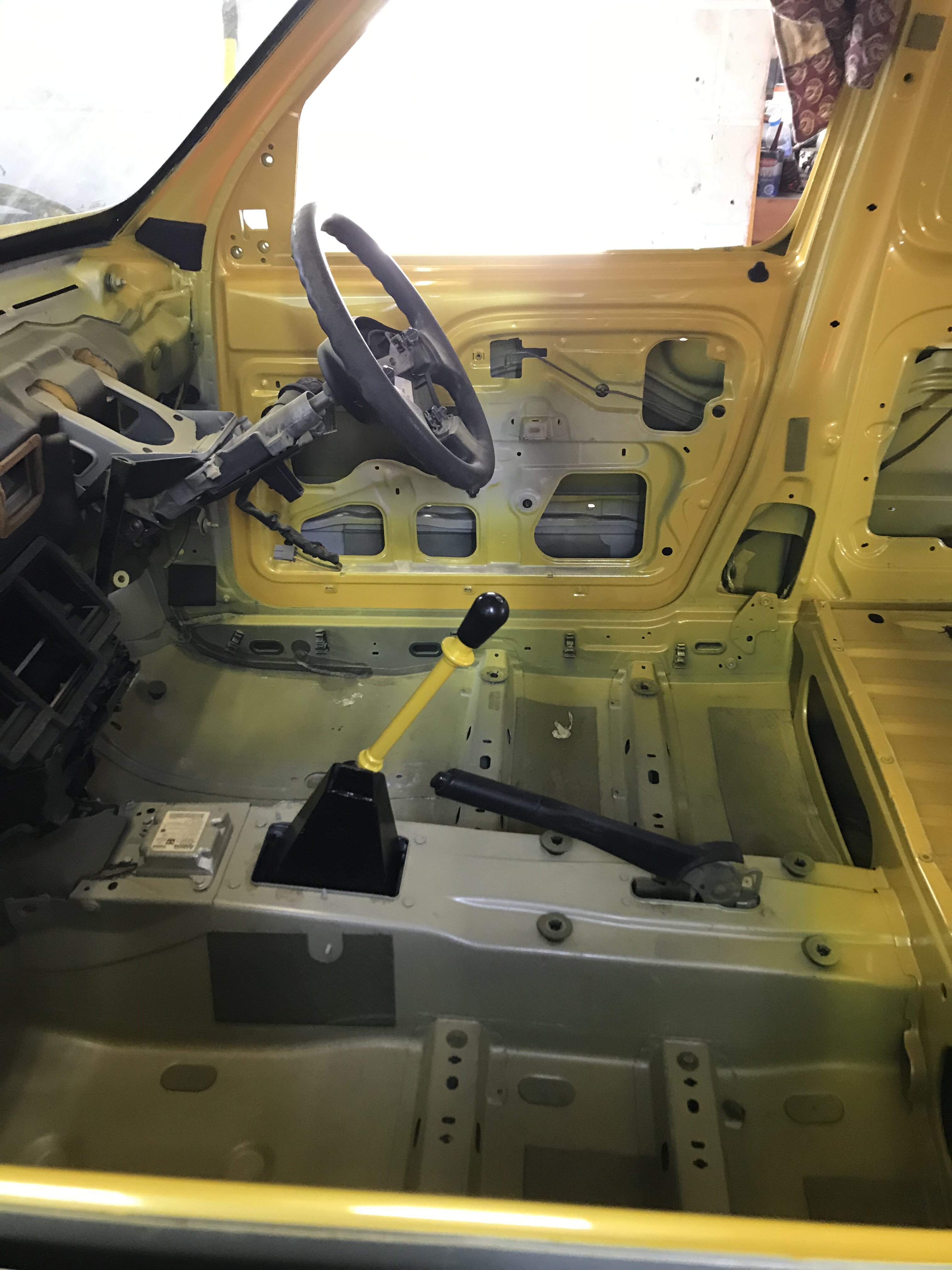

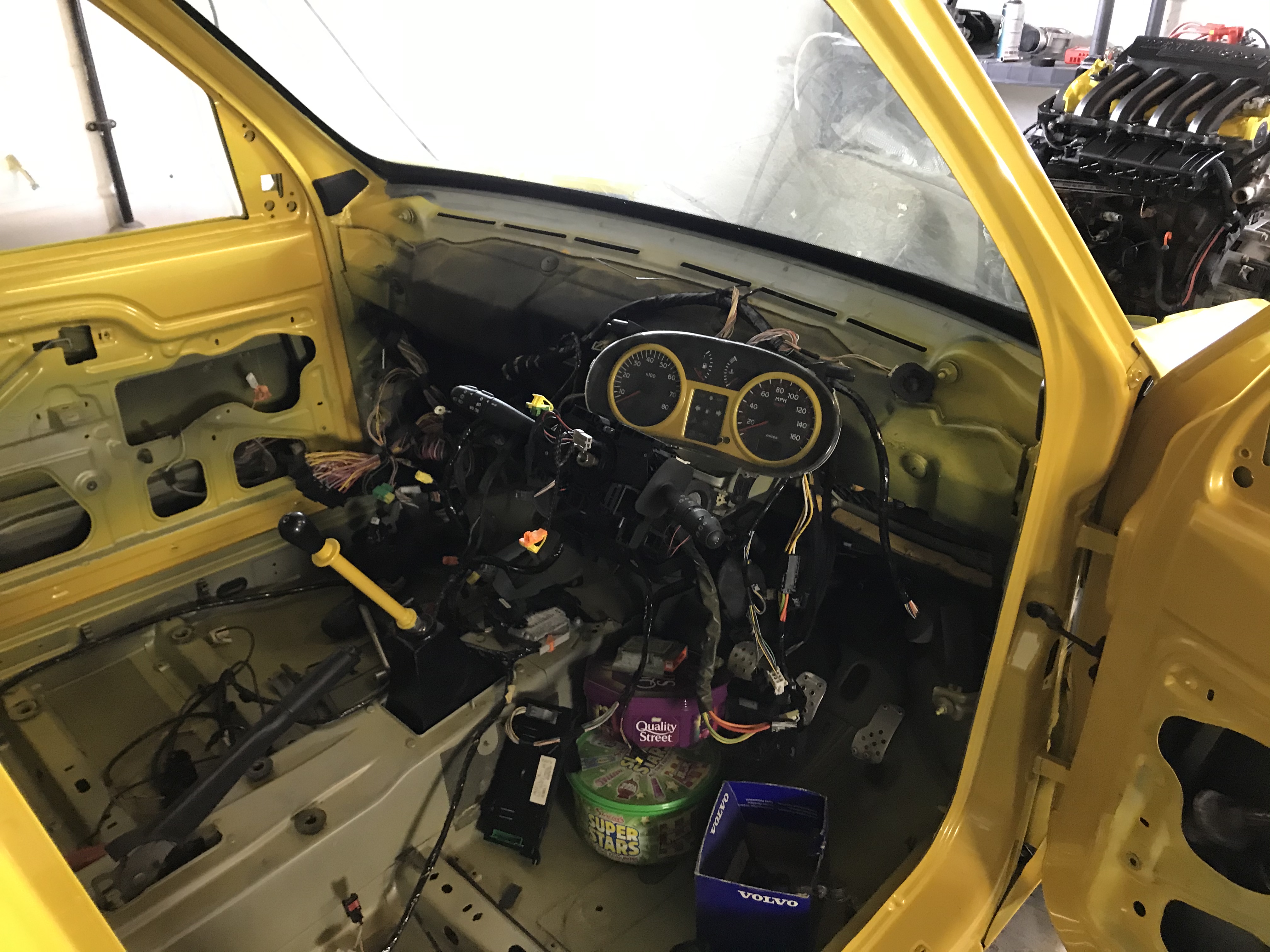

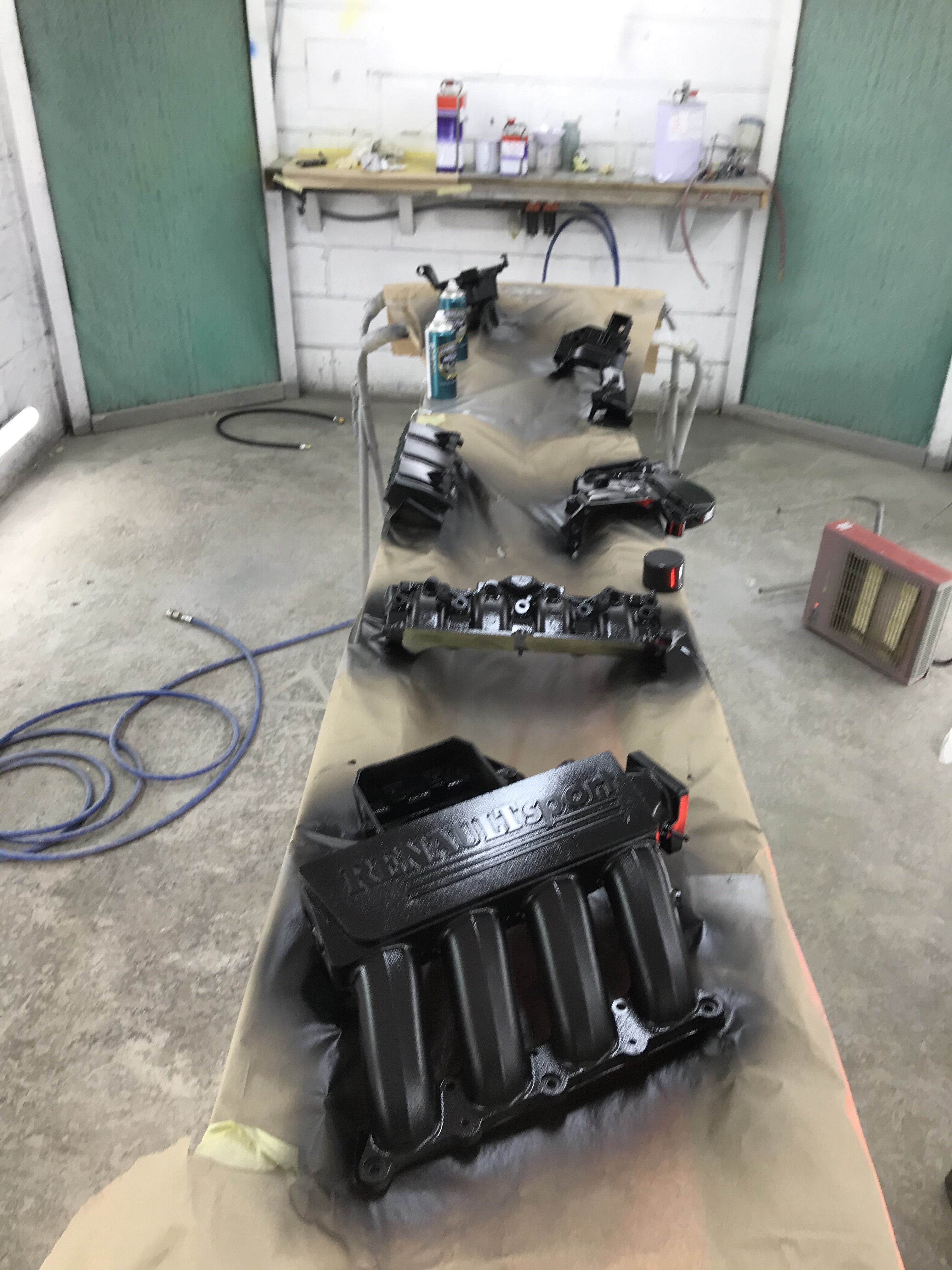

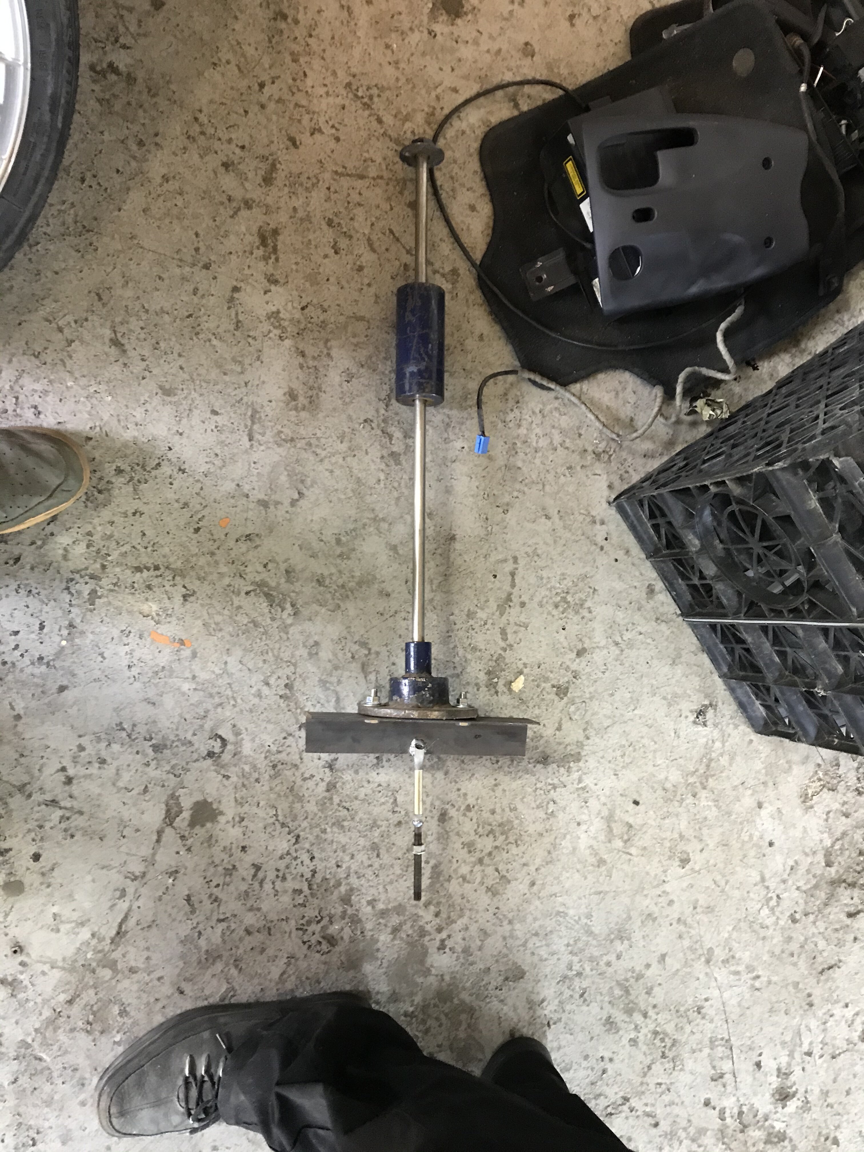

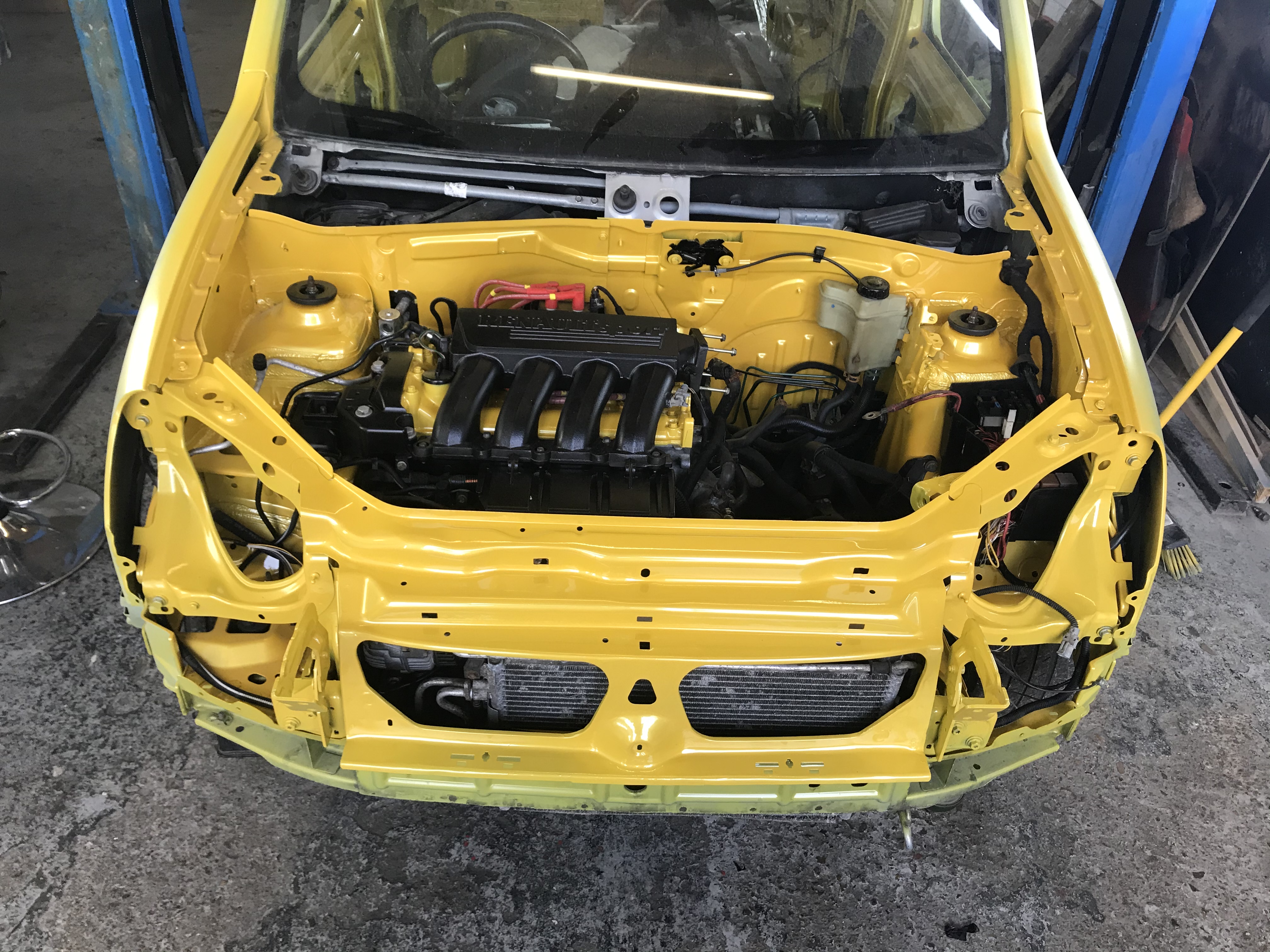

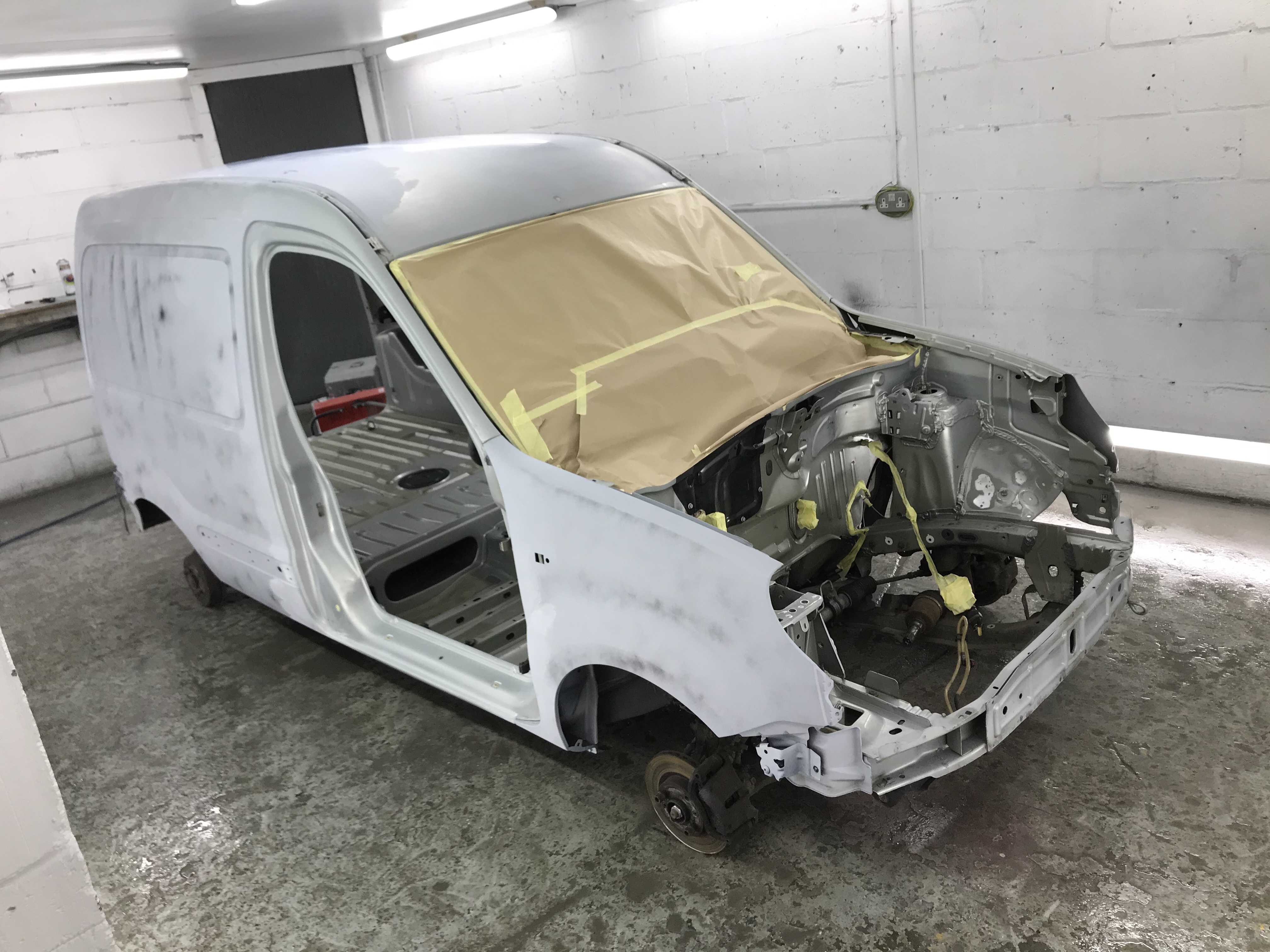

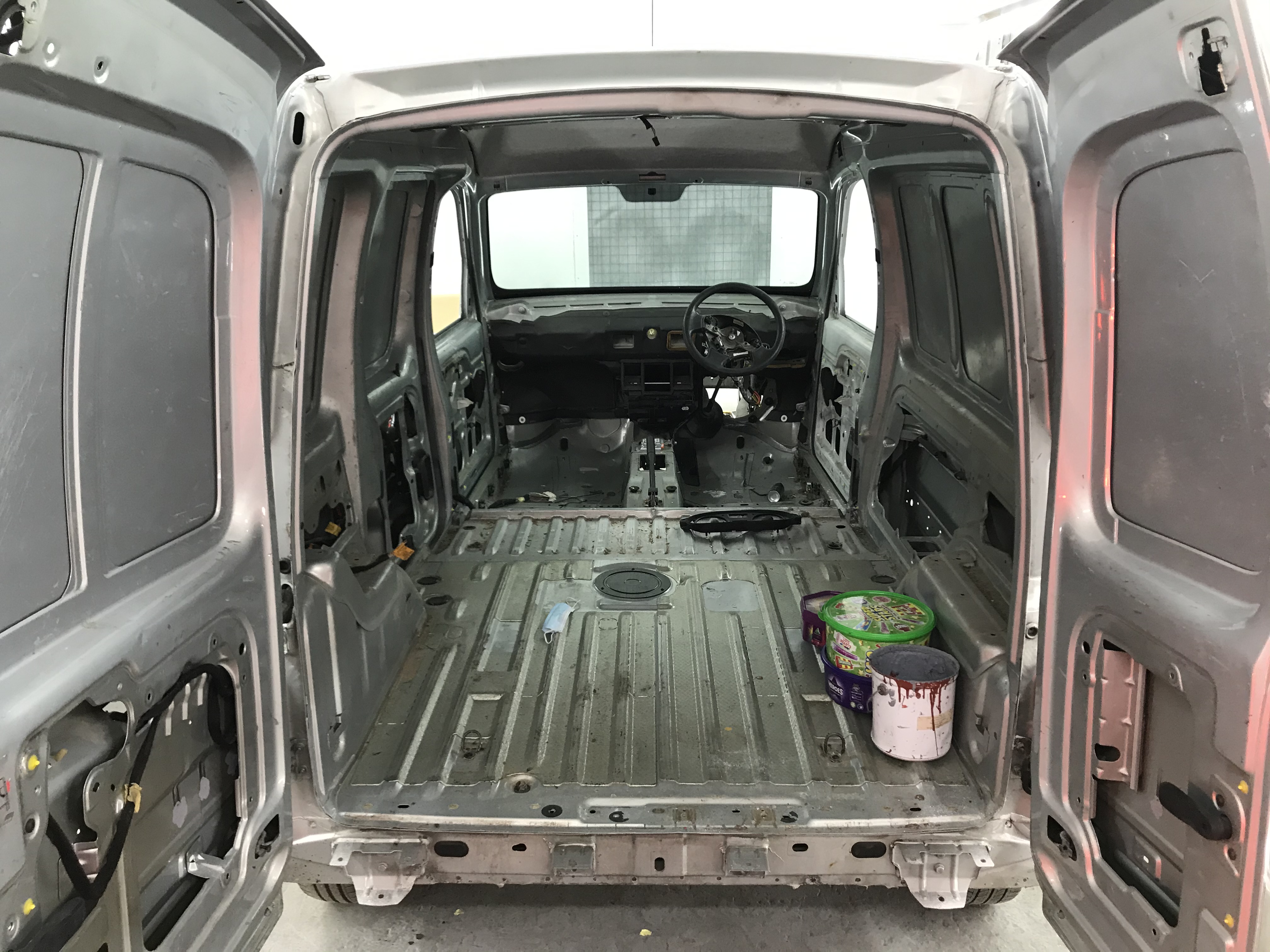

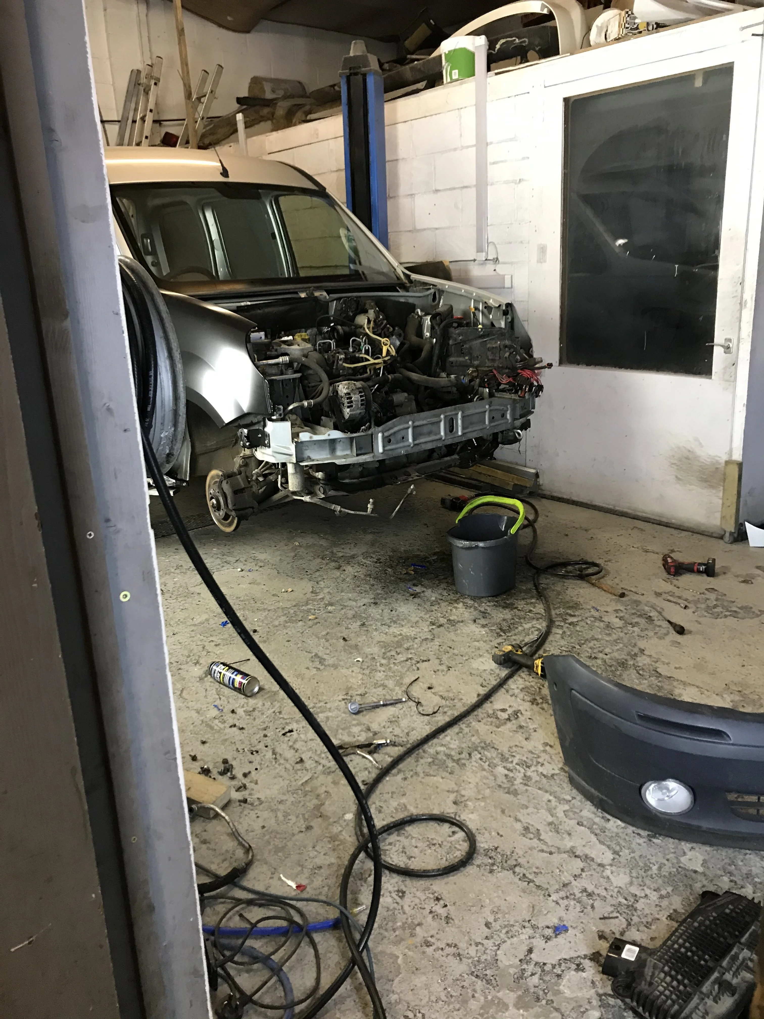

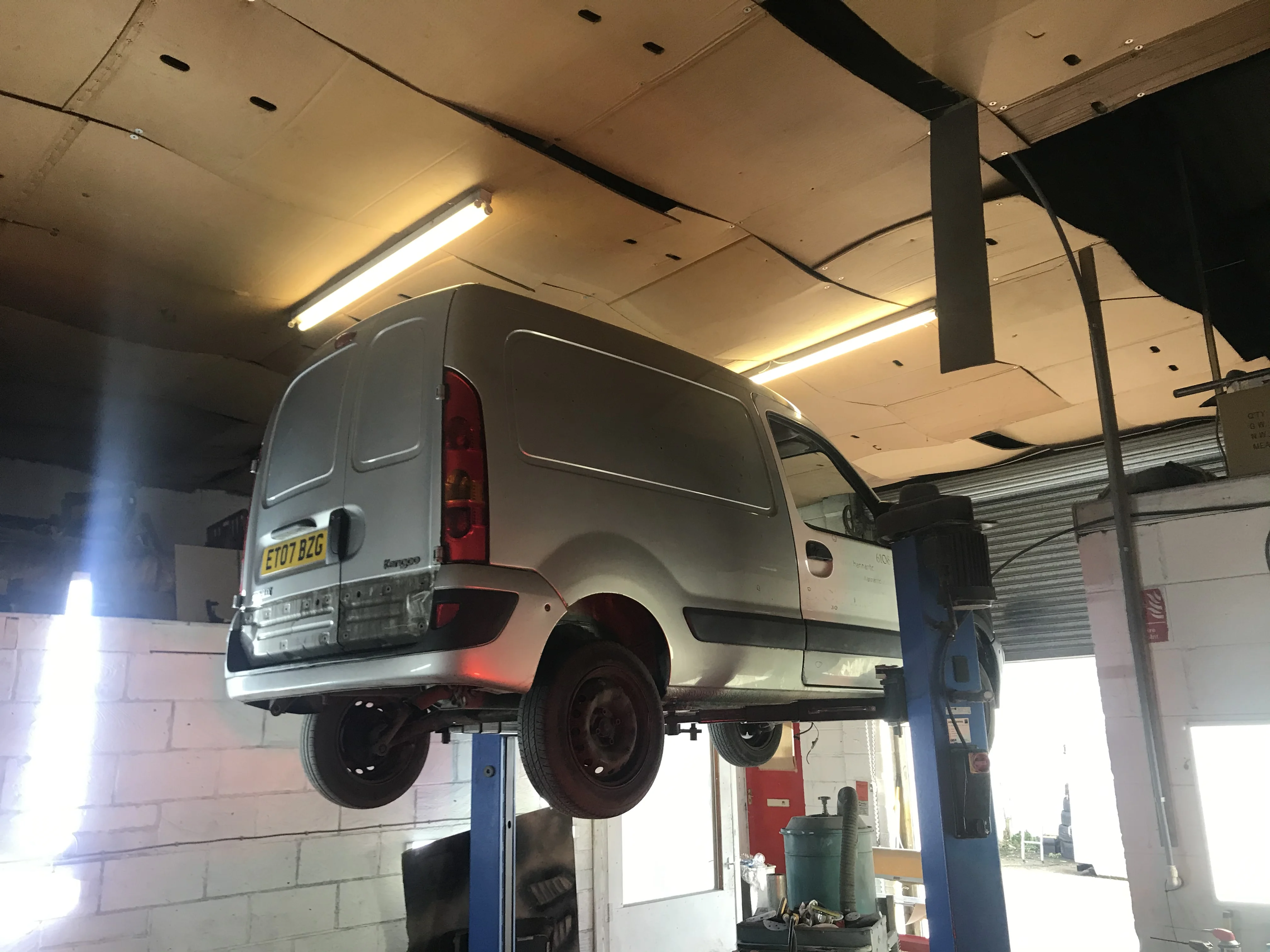

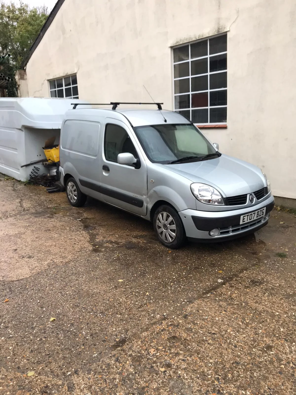

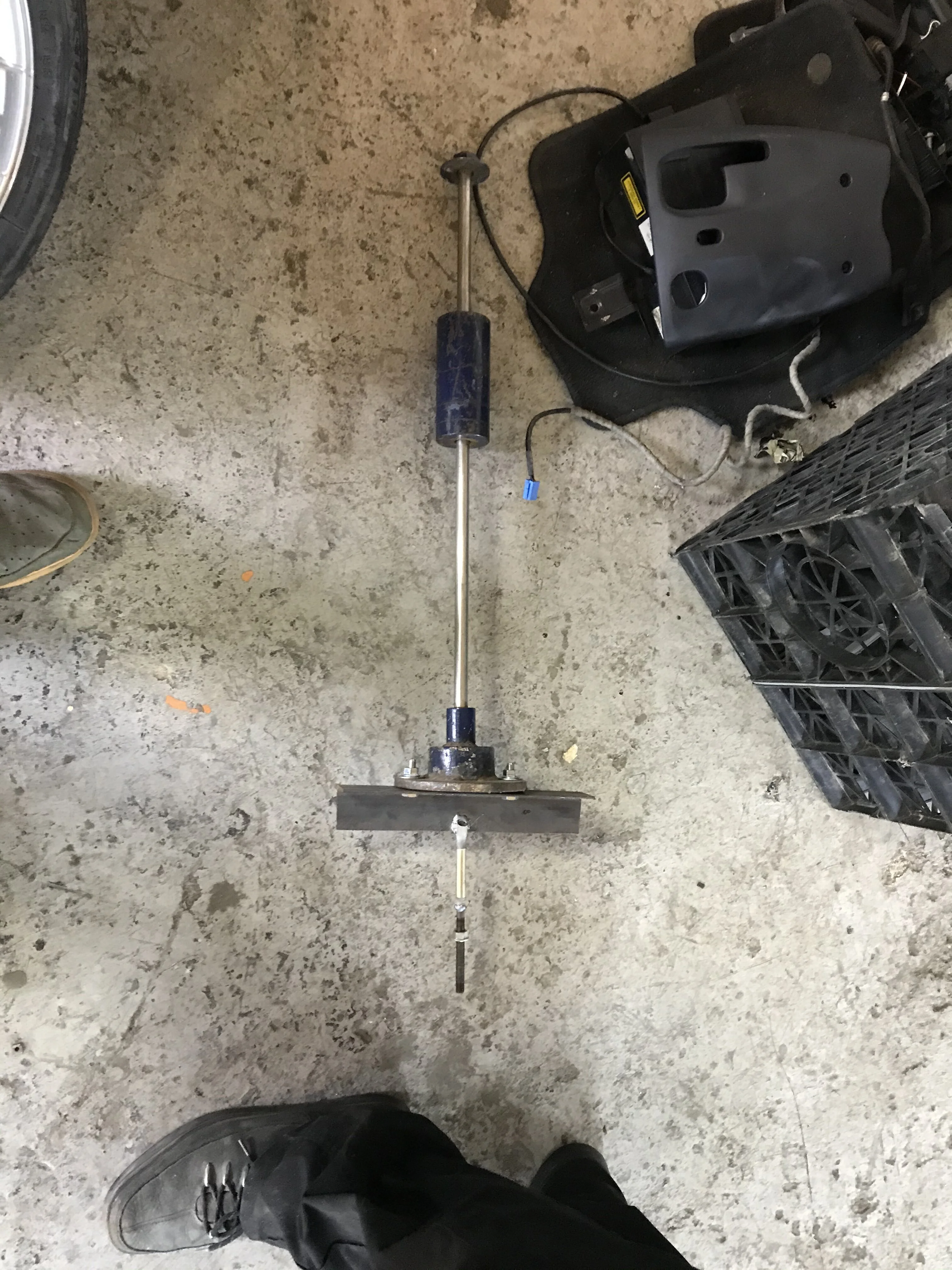

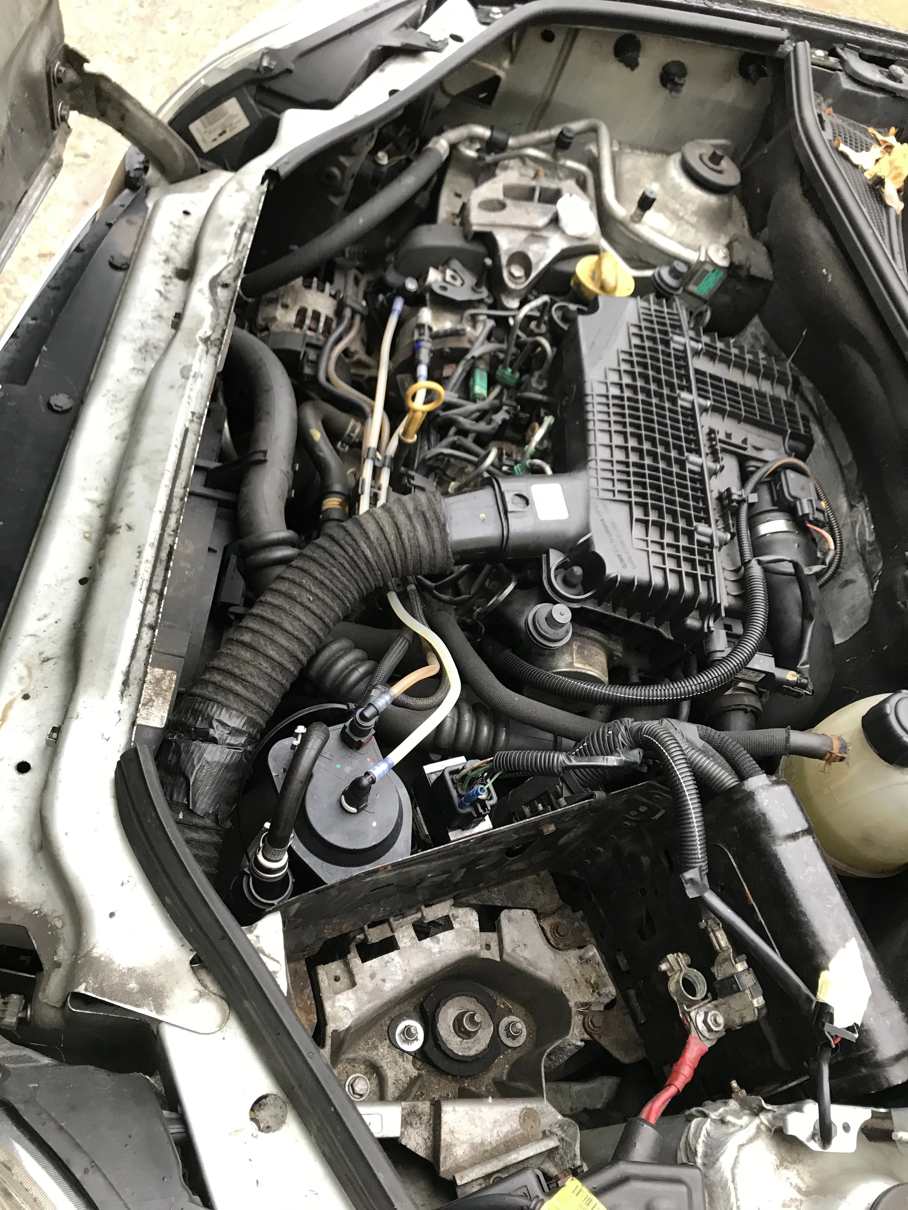

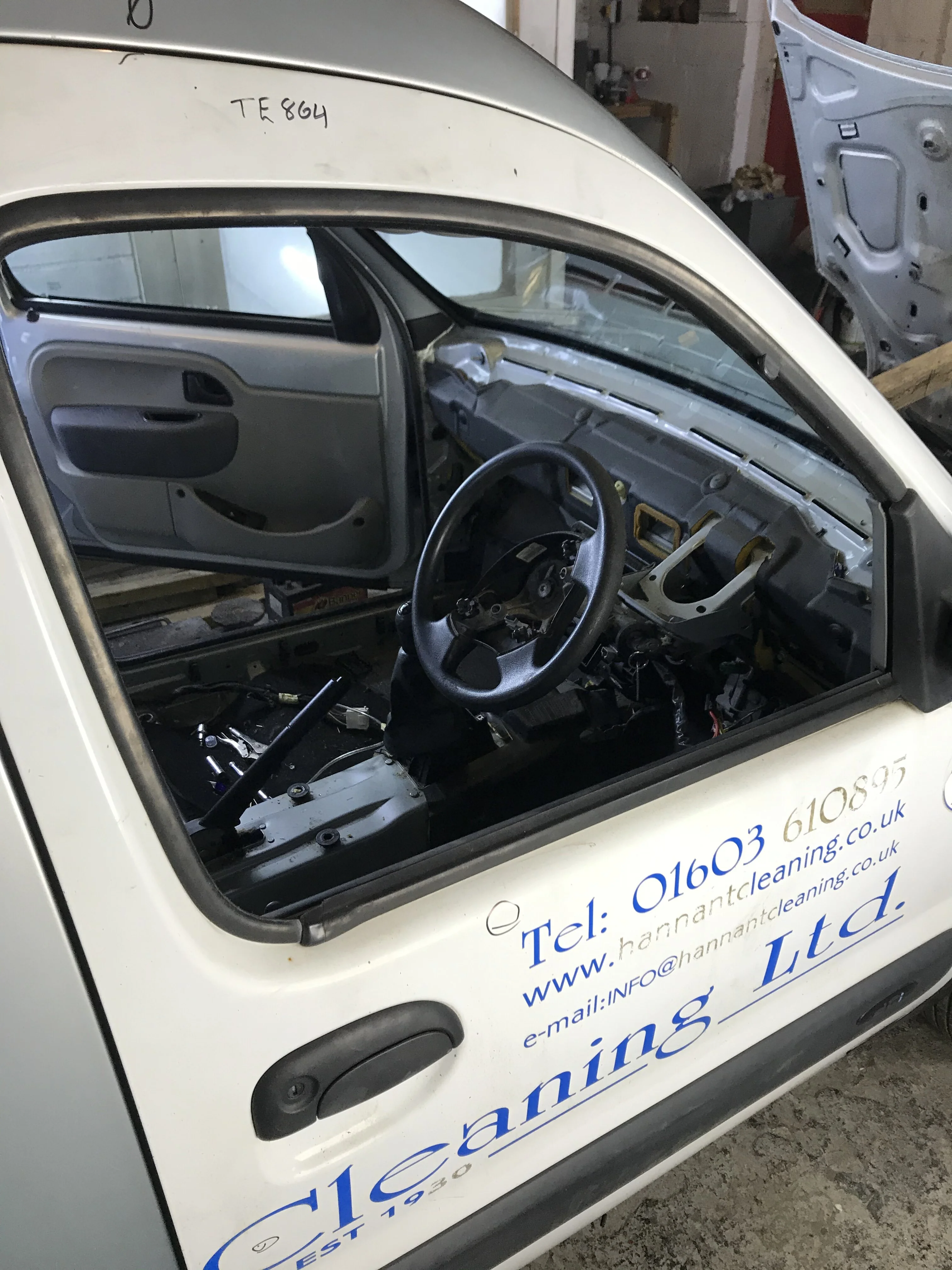

Hi all thought I’d post a few pics of my project so far..

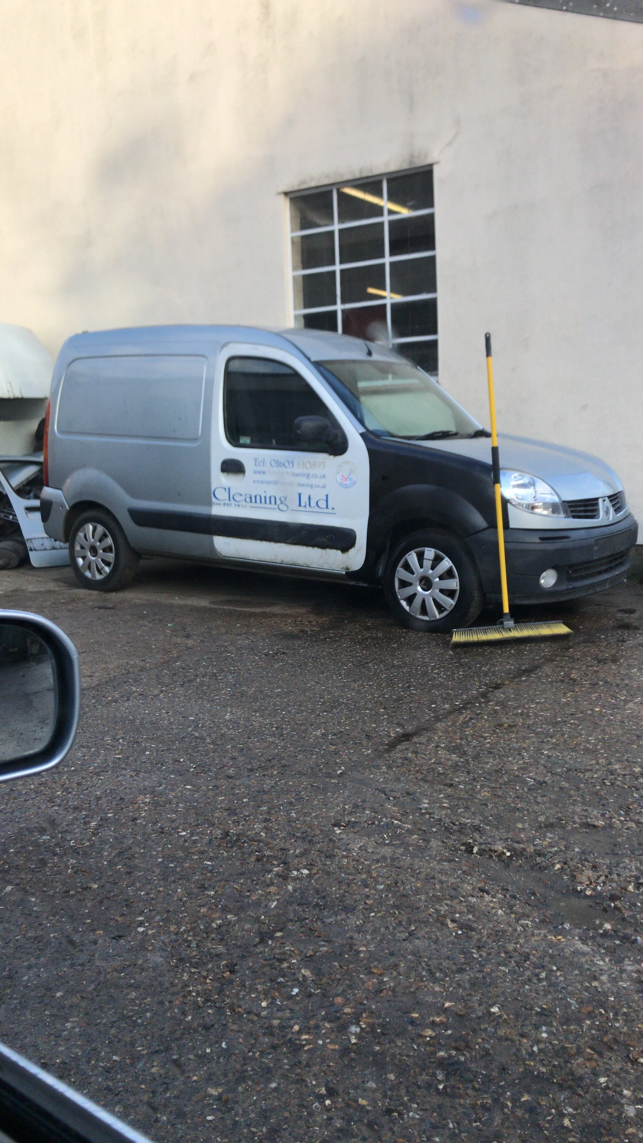

wanted a kangoo f4r couldn’t seem to buy one when I wanted one so I thought I’d make one but my way! got a good spec’ed donor car what was fully Powerflexed up new gaz coilovers new lsd fitted and low ish milage and got a straight van with all the bells and whistles aka aircon and eleccy windows and wheel trims haha and i like liquid yellow haha.

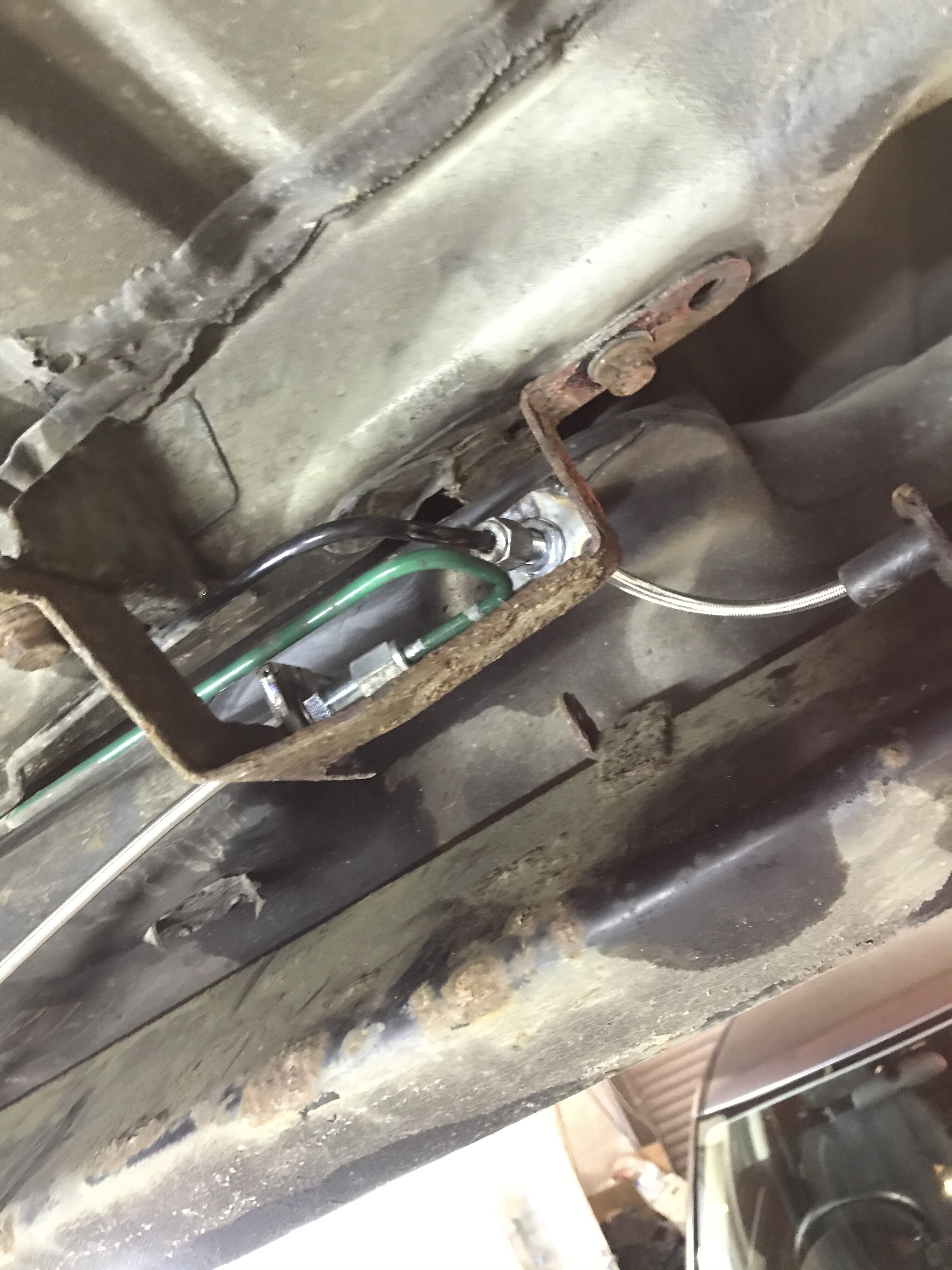

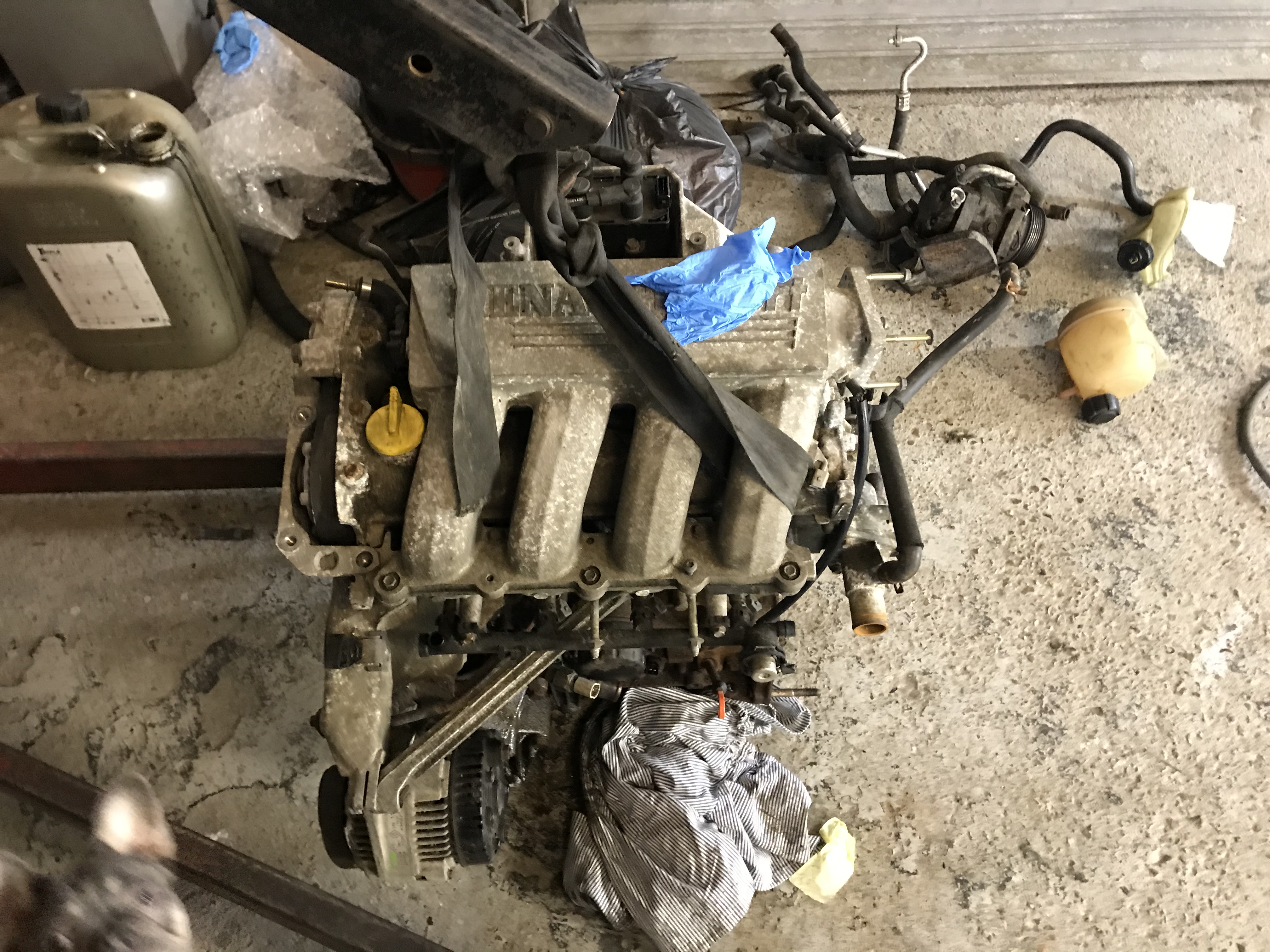

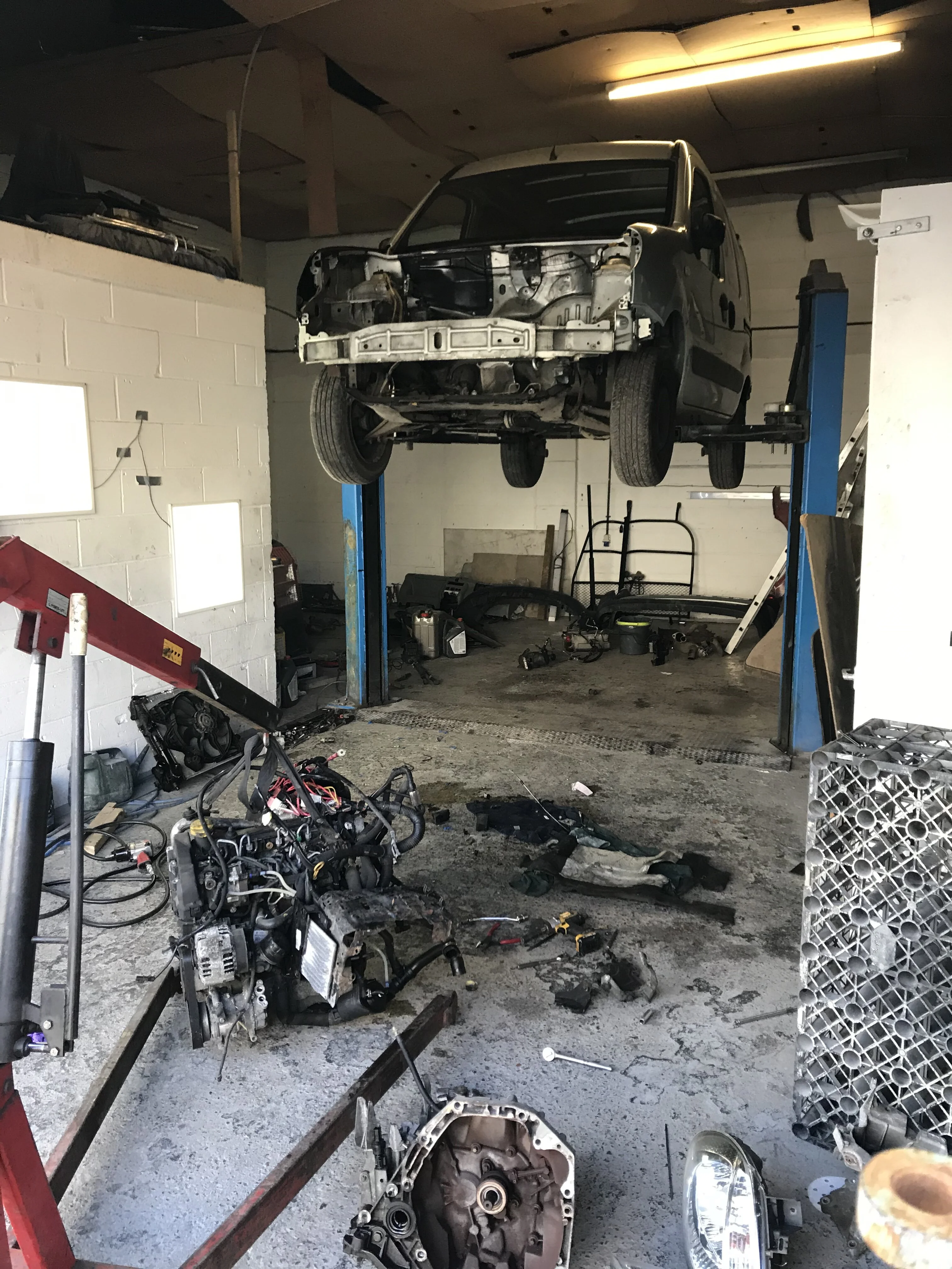

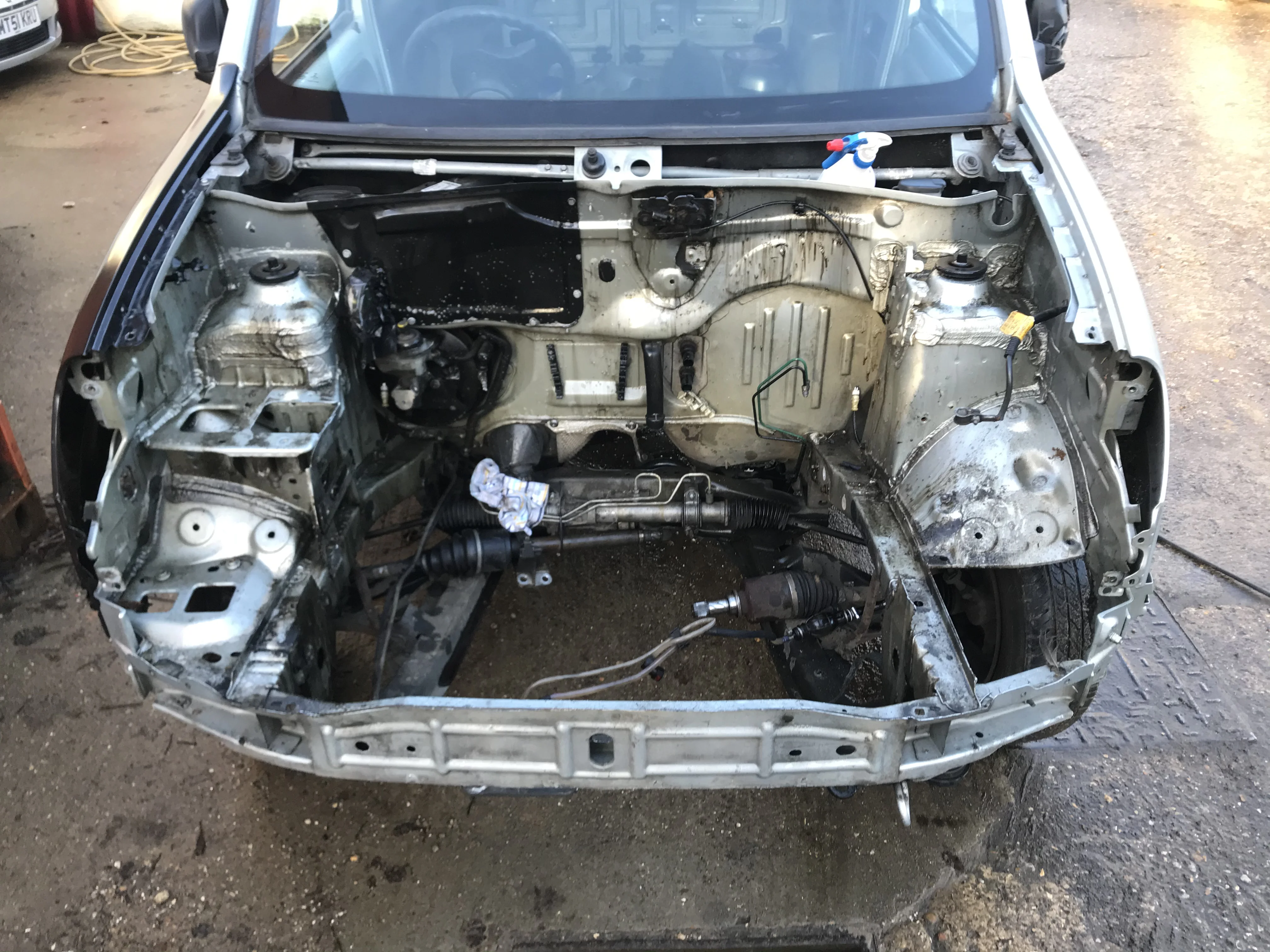

So first is the strip..

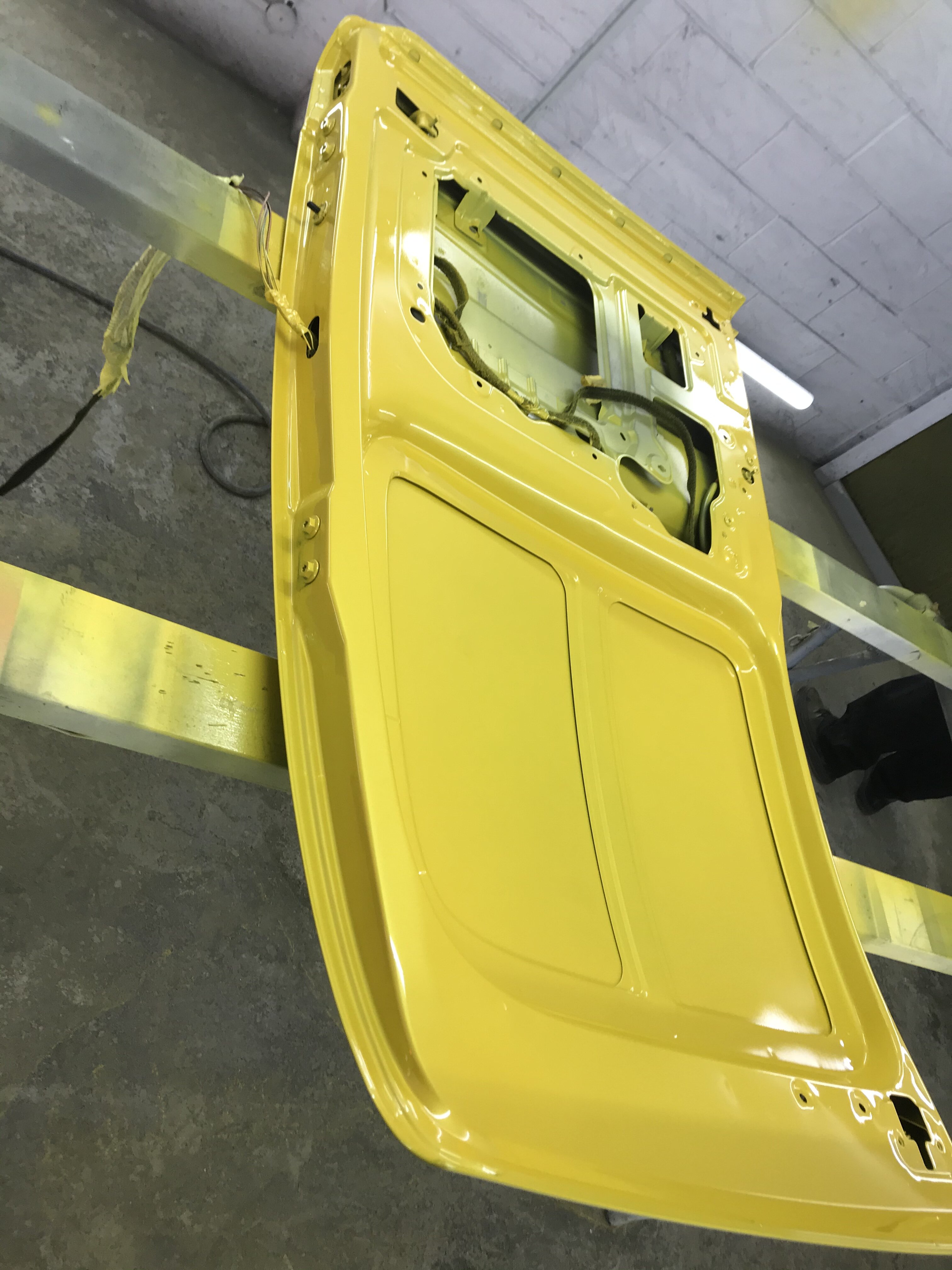

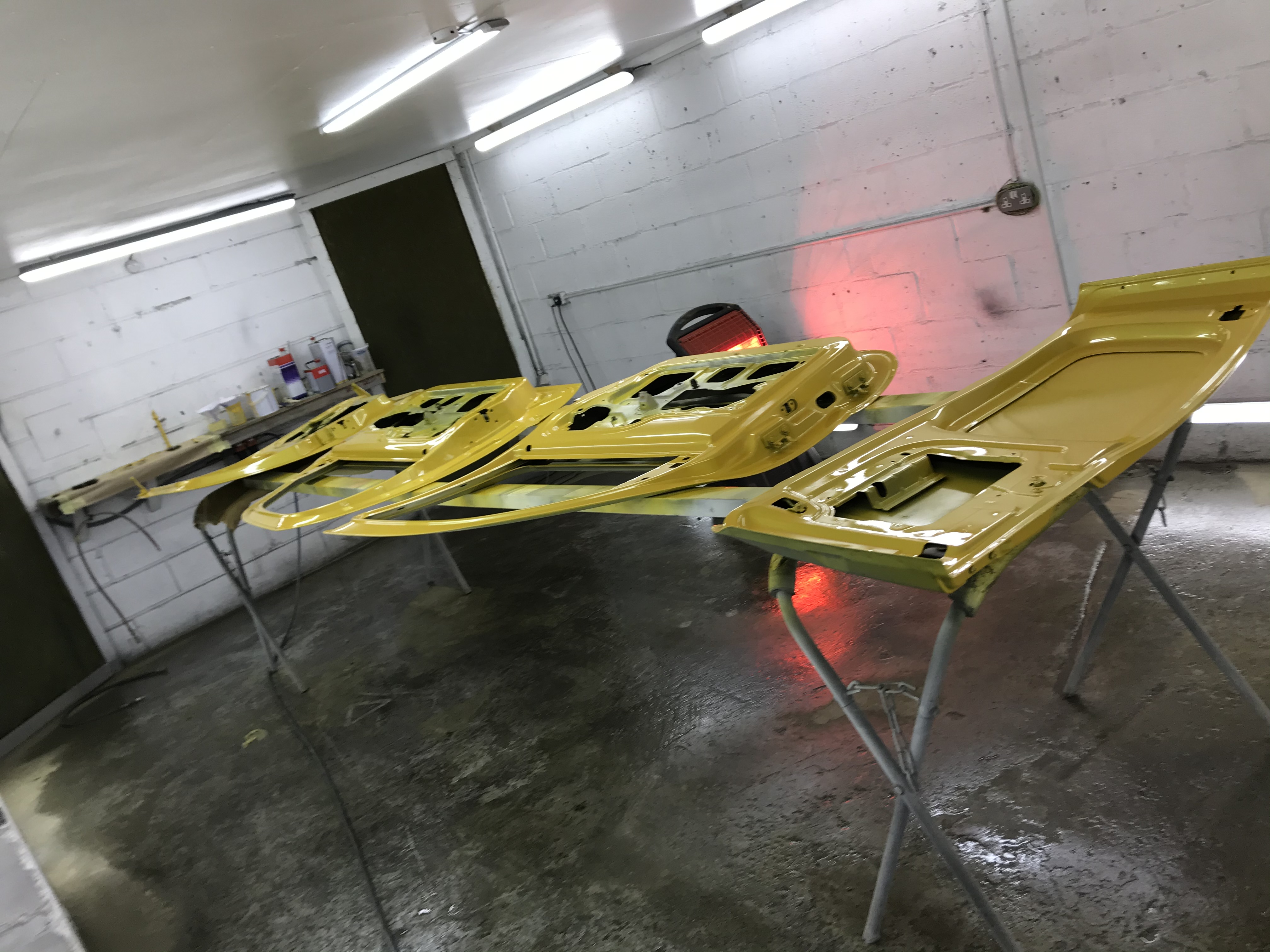

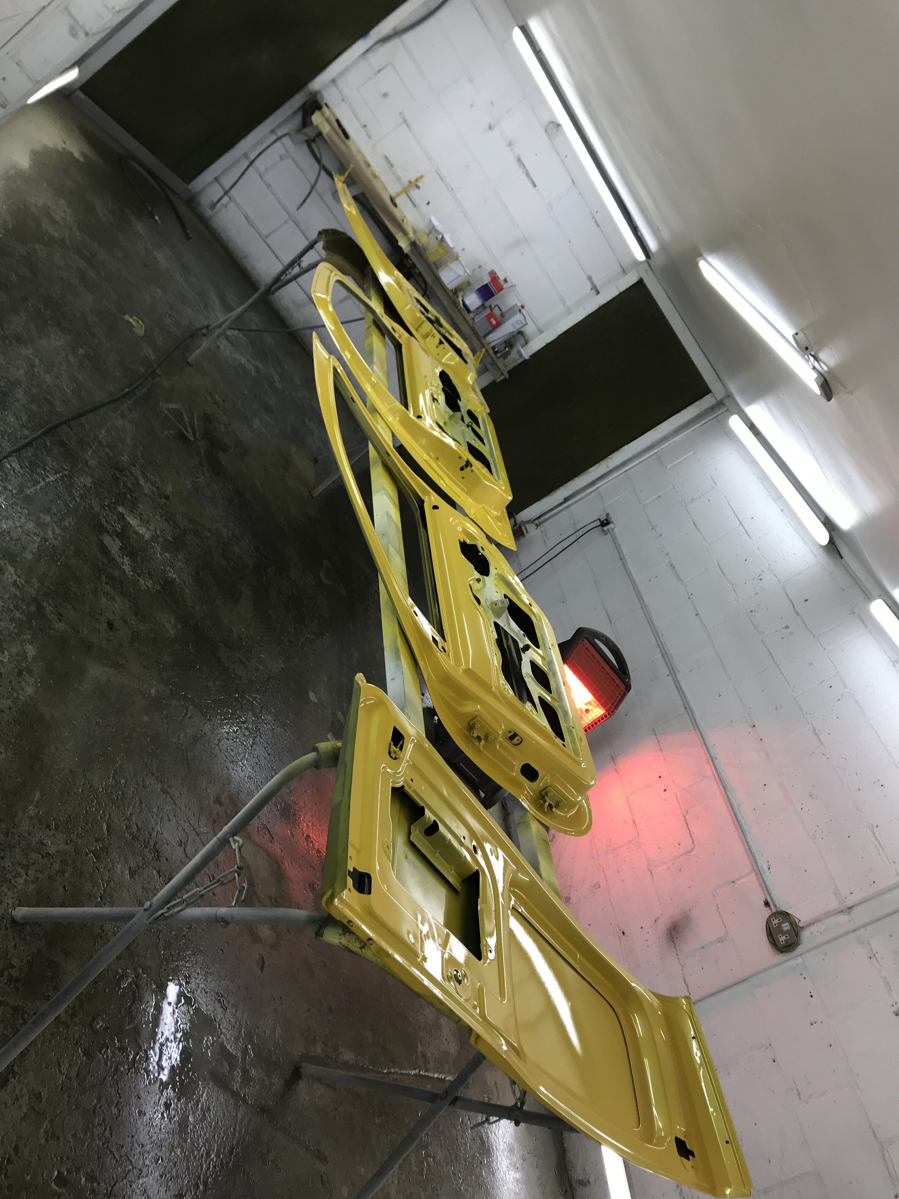

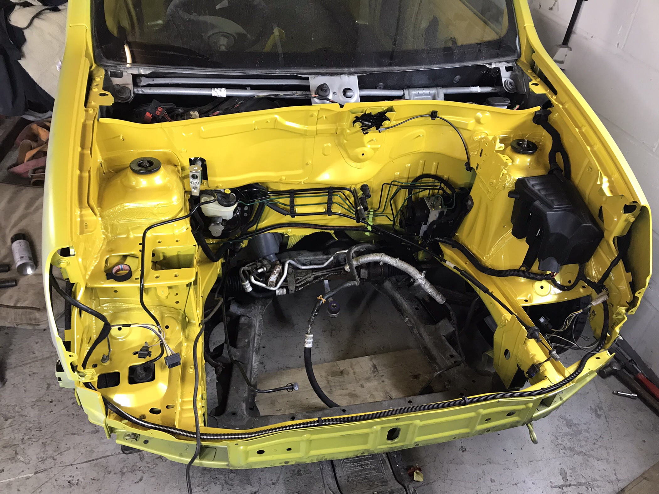

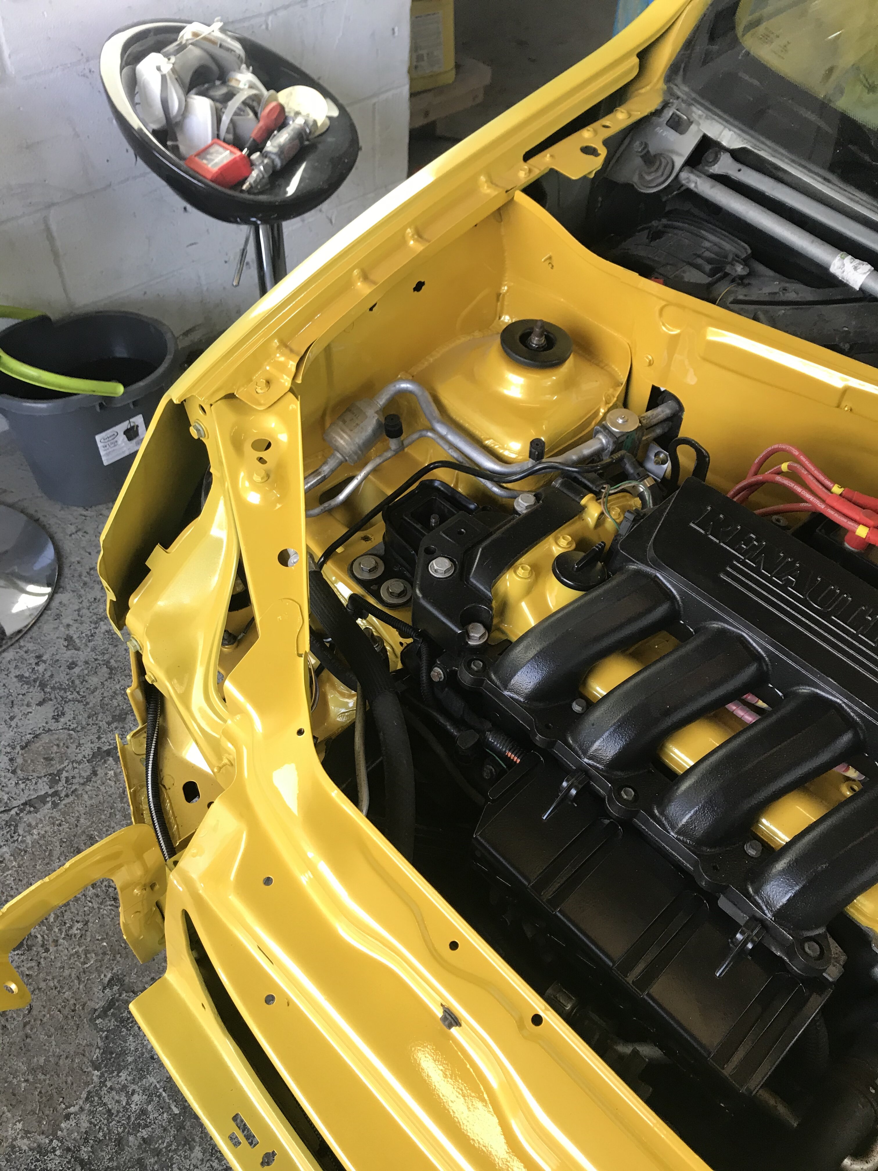

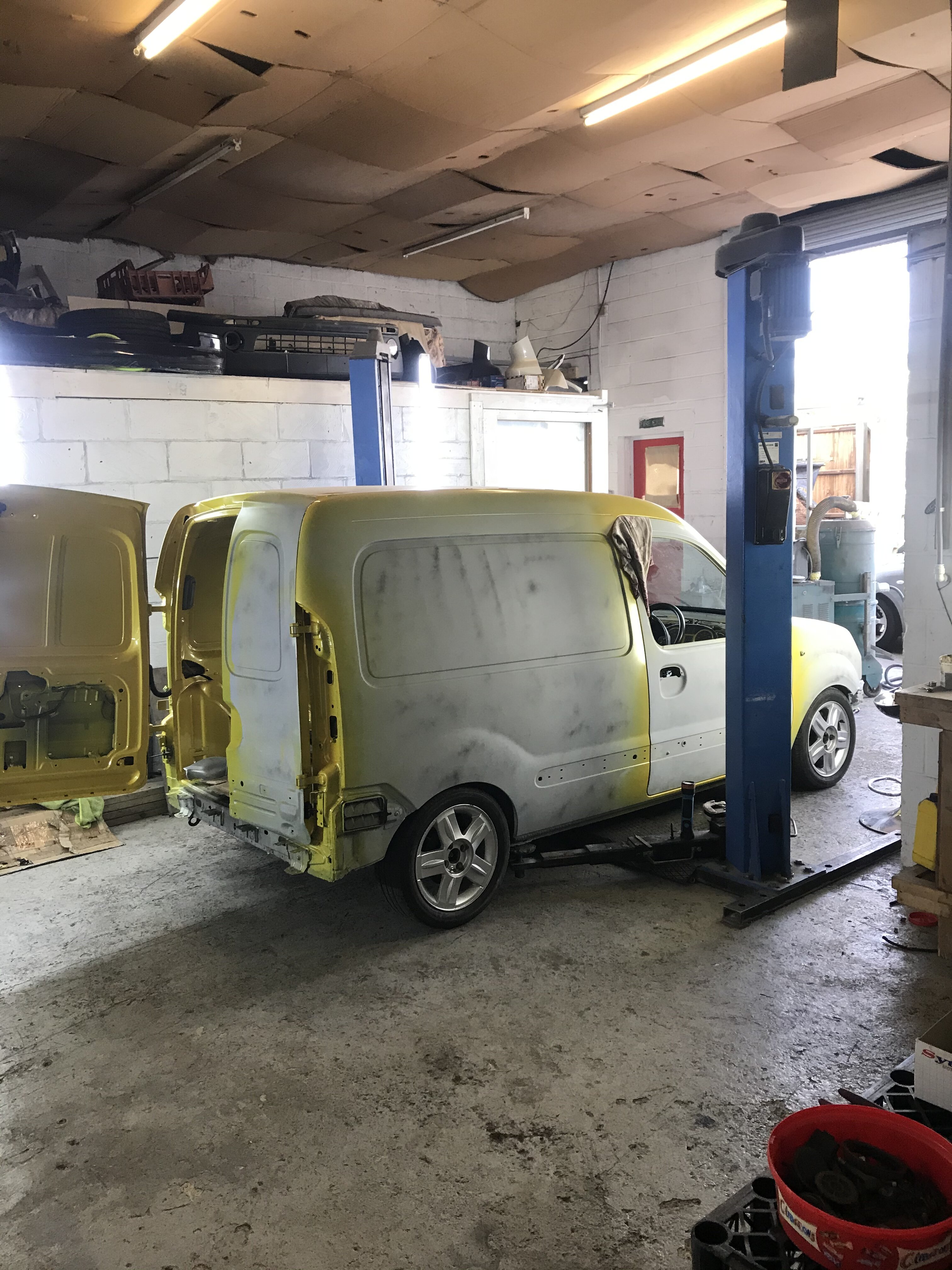

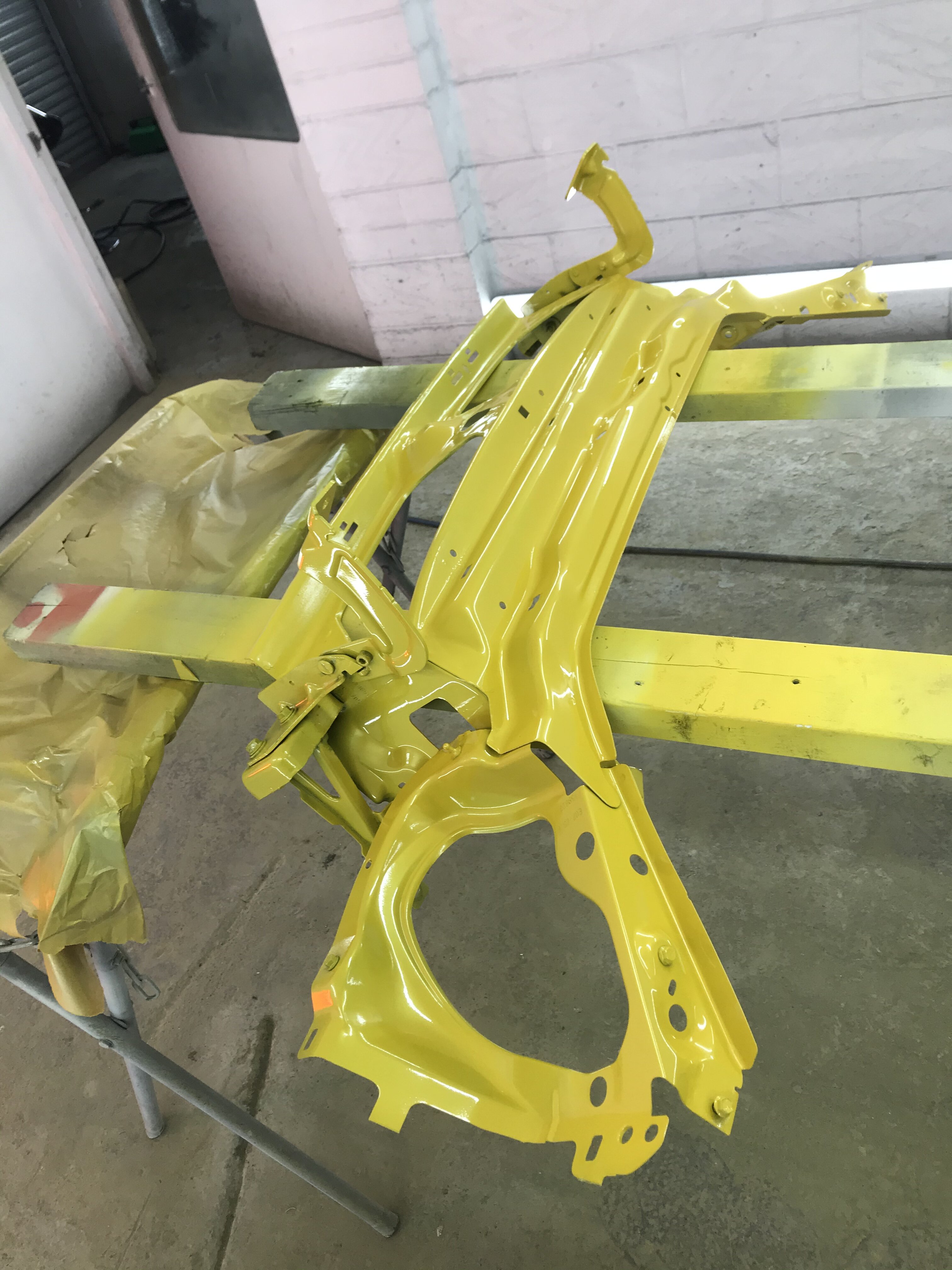

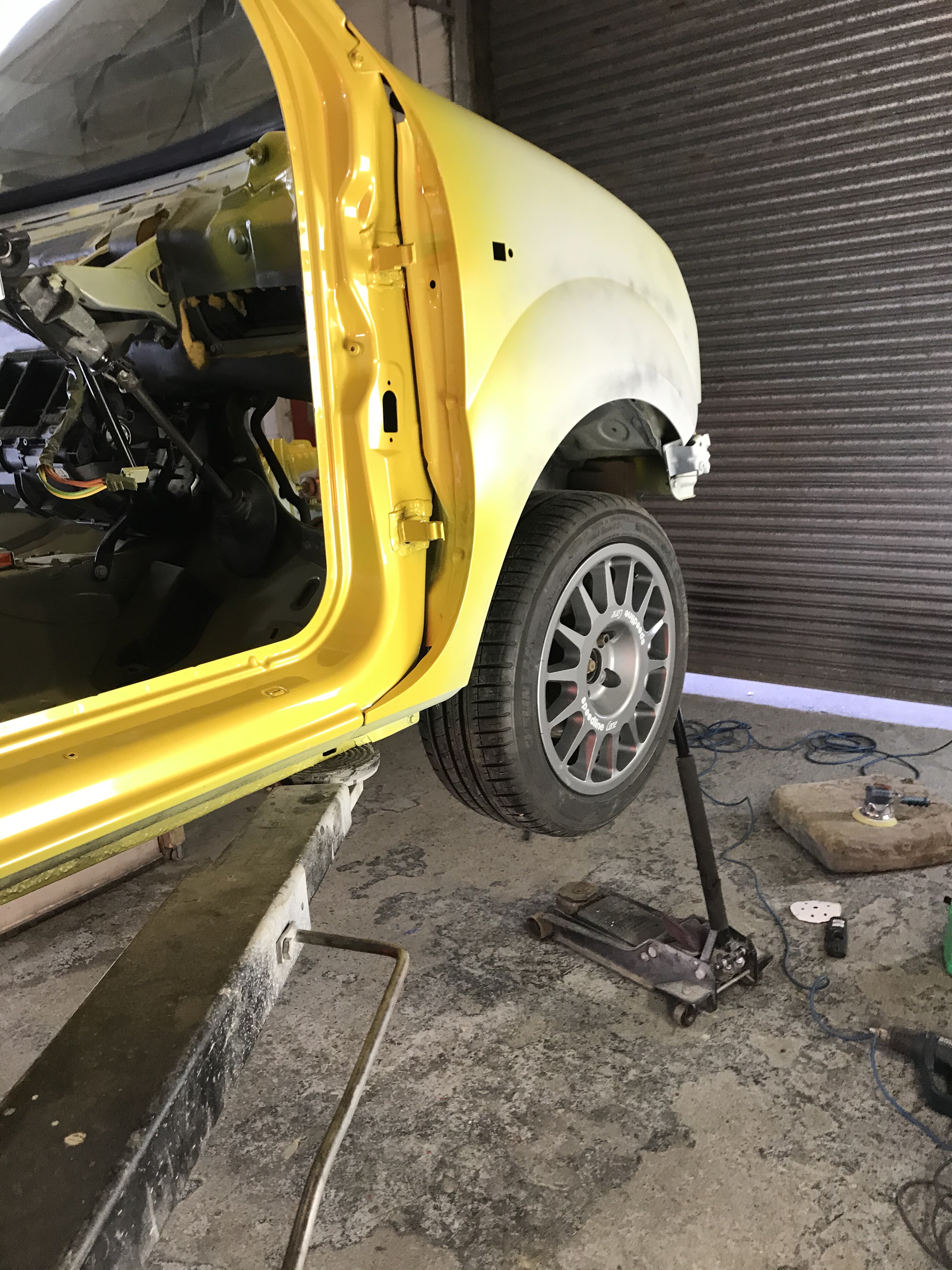

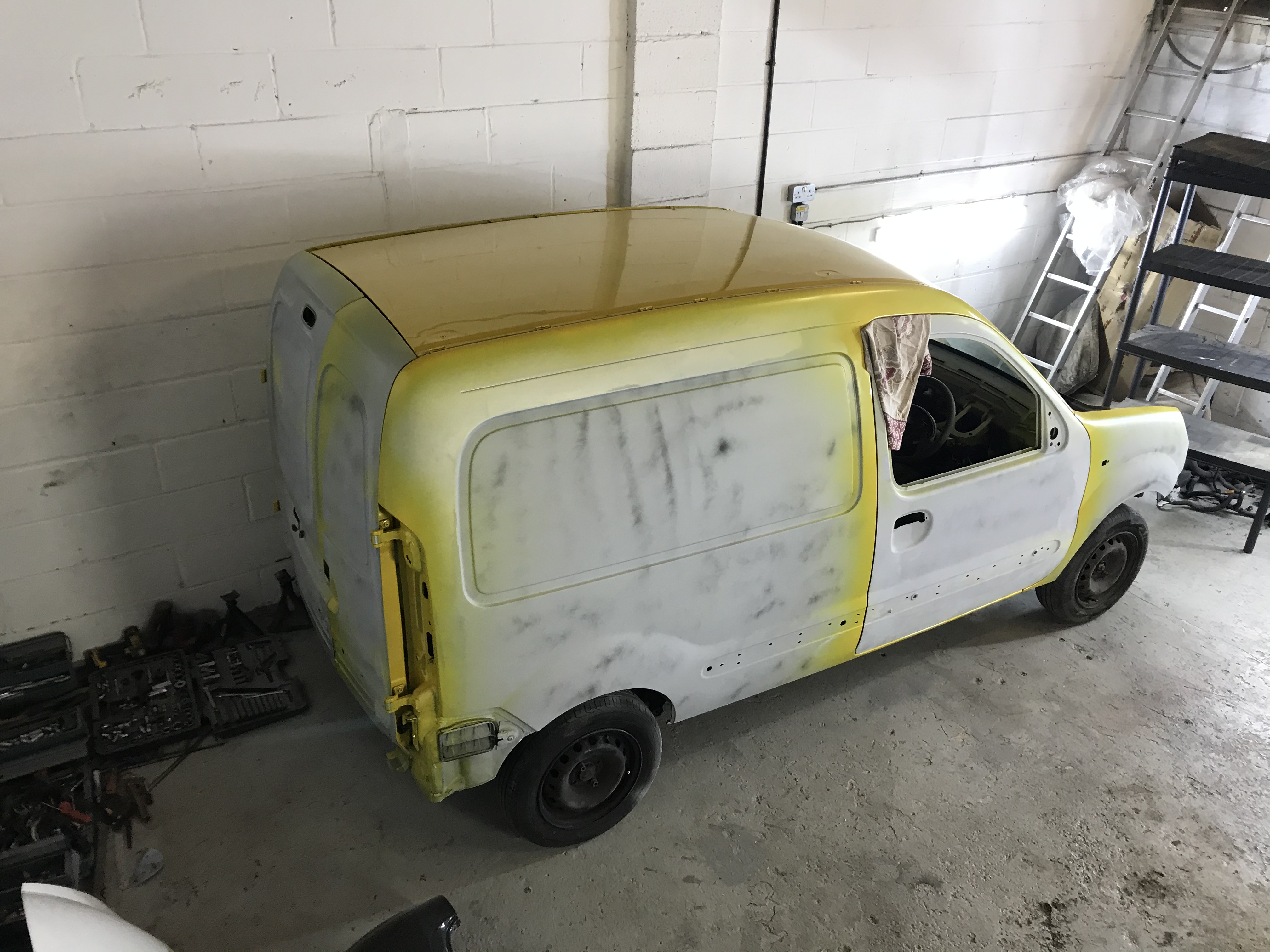

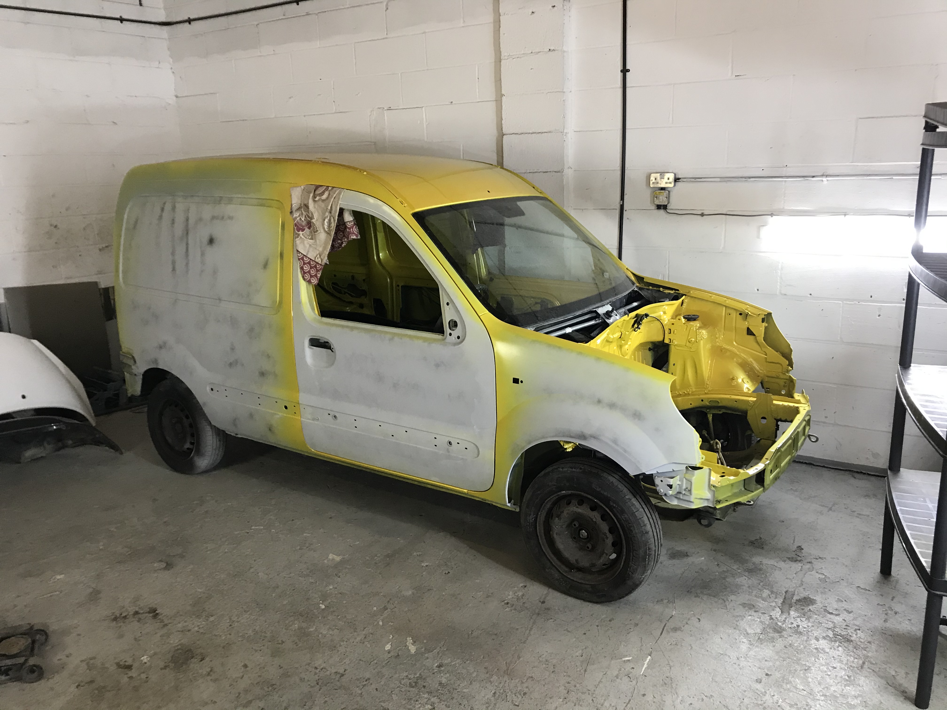

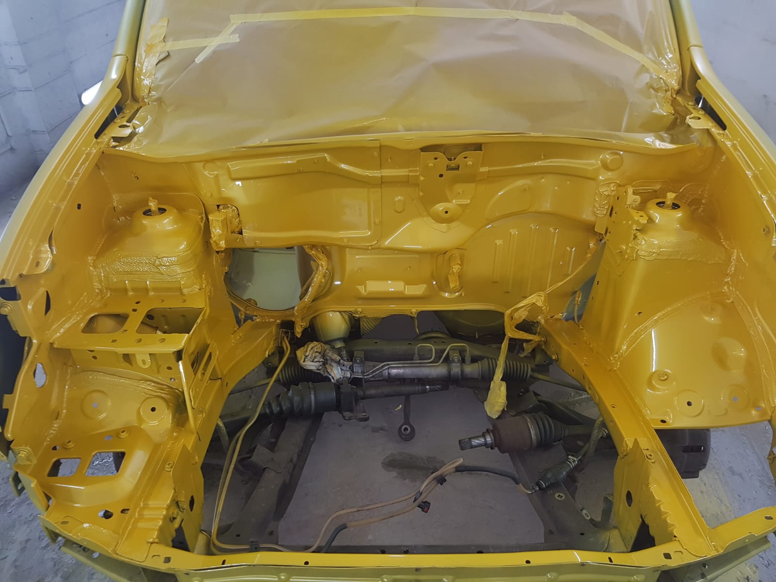

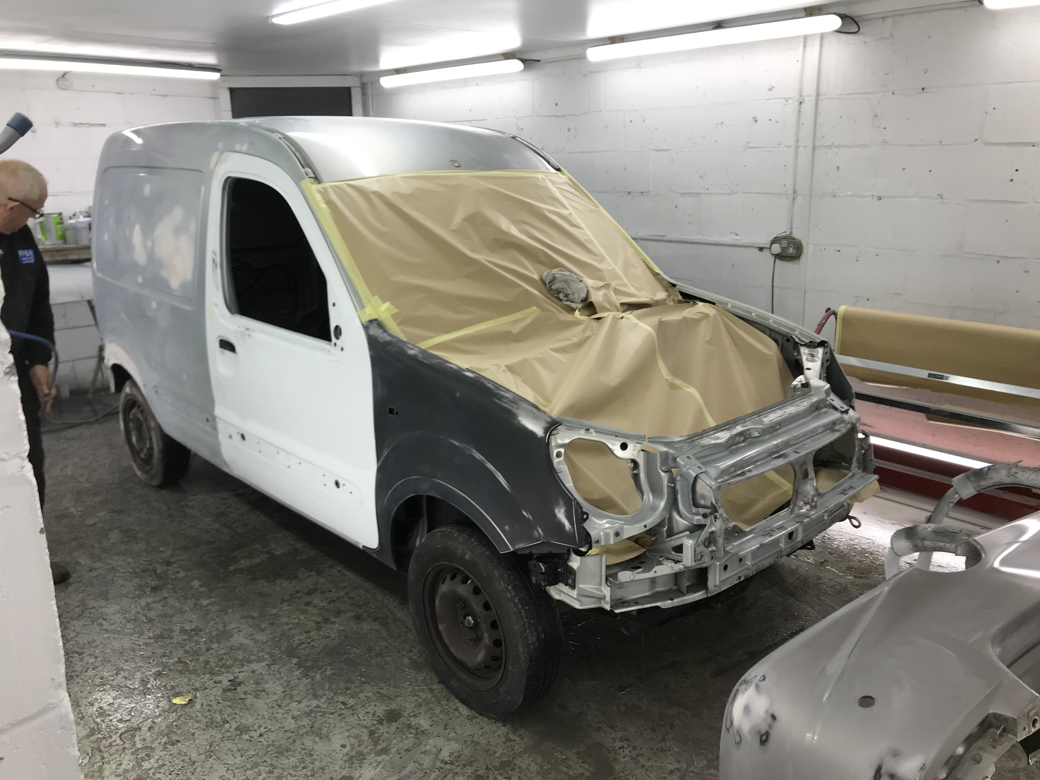

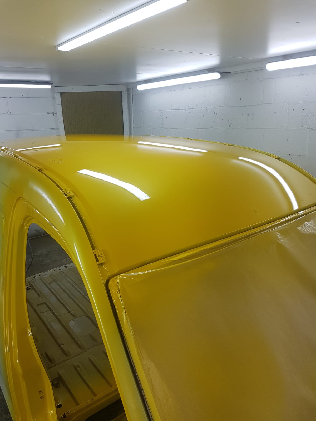

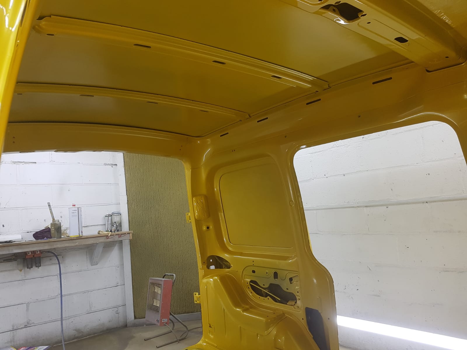

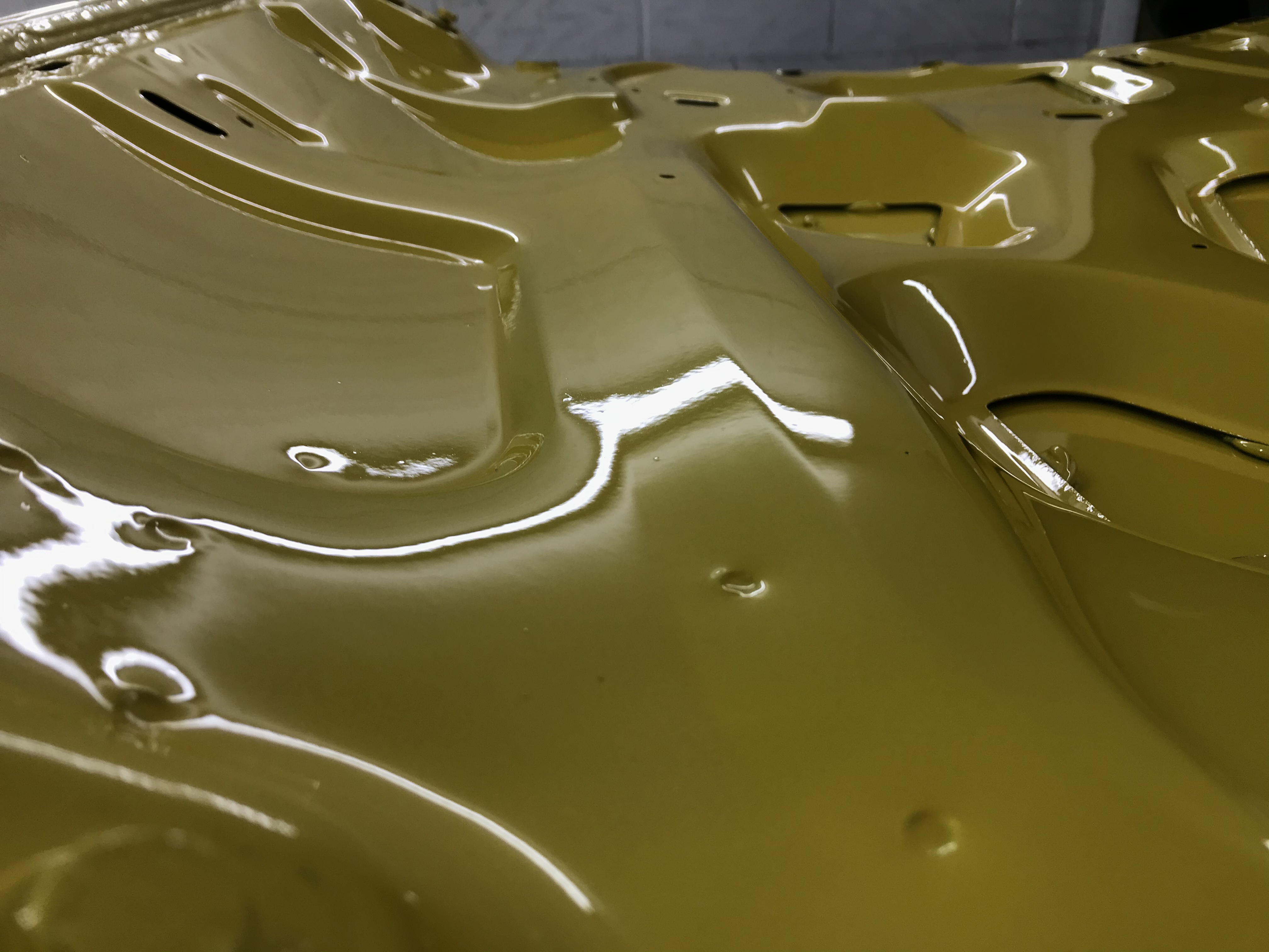

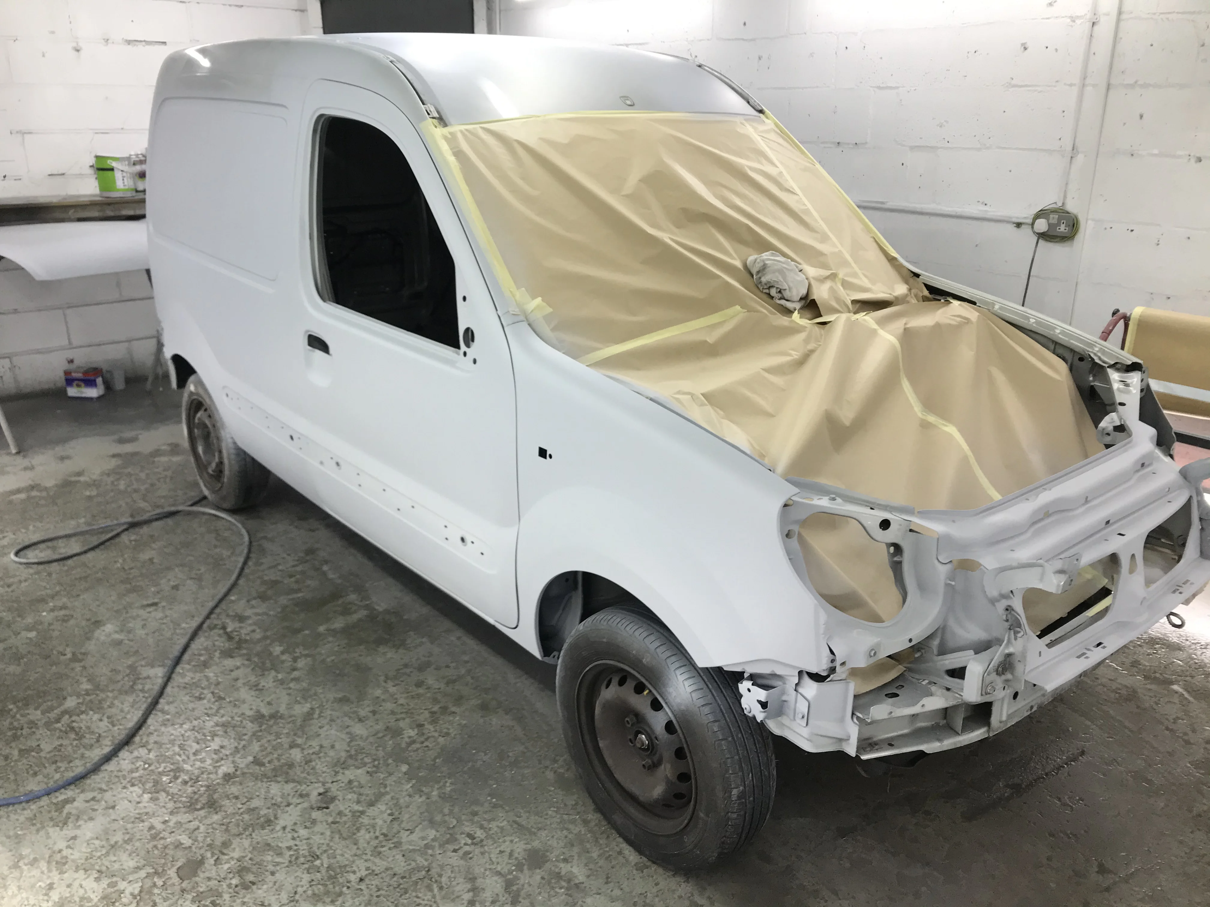

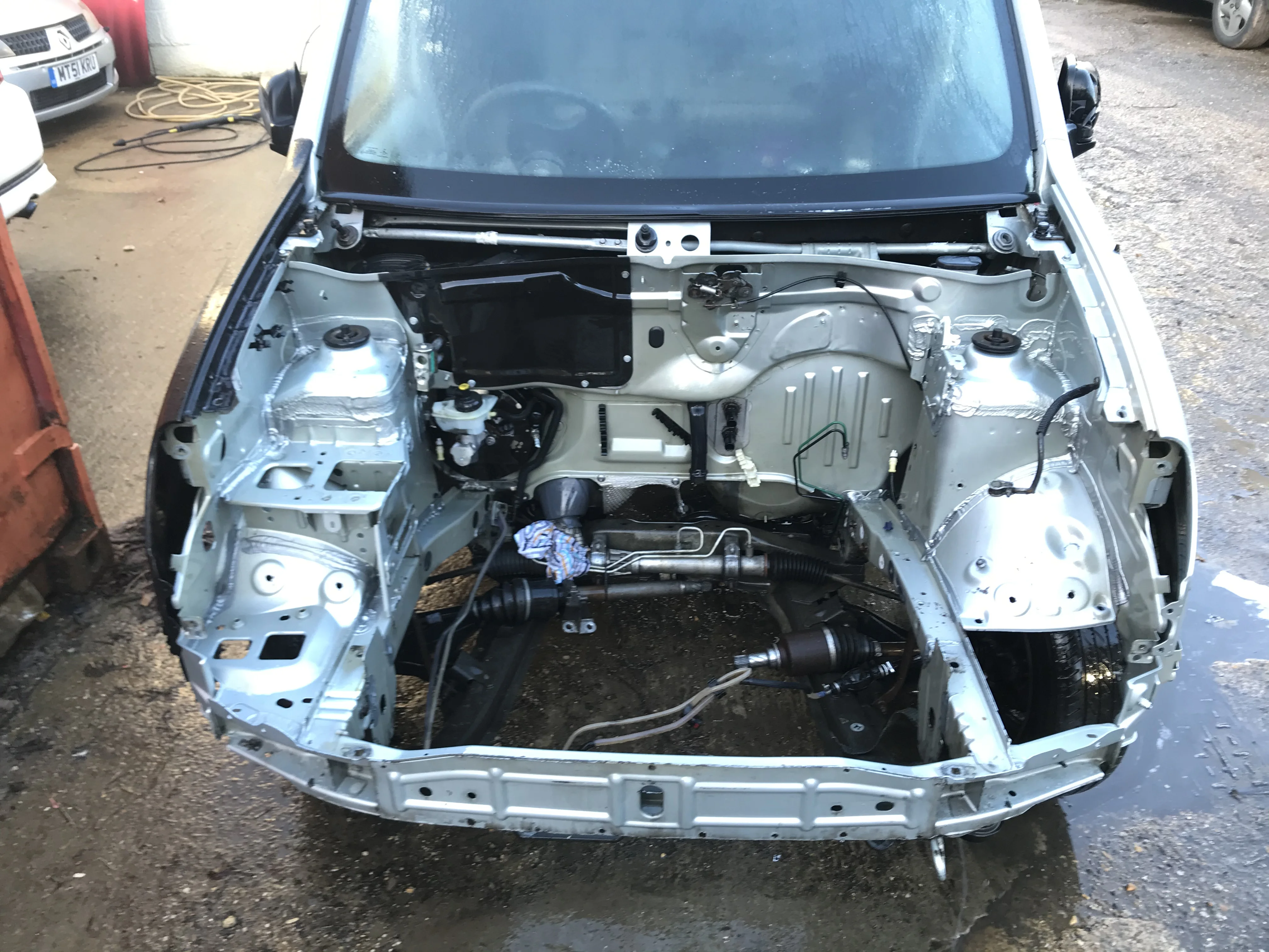

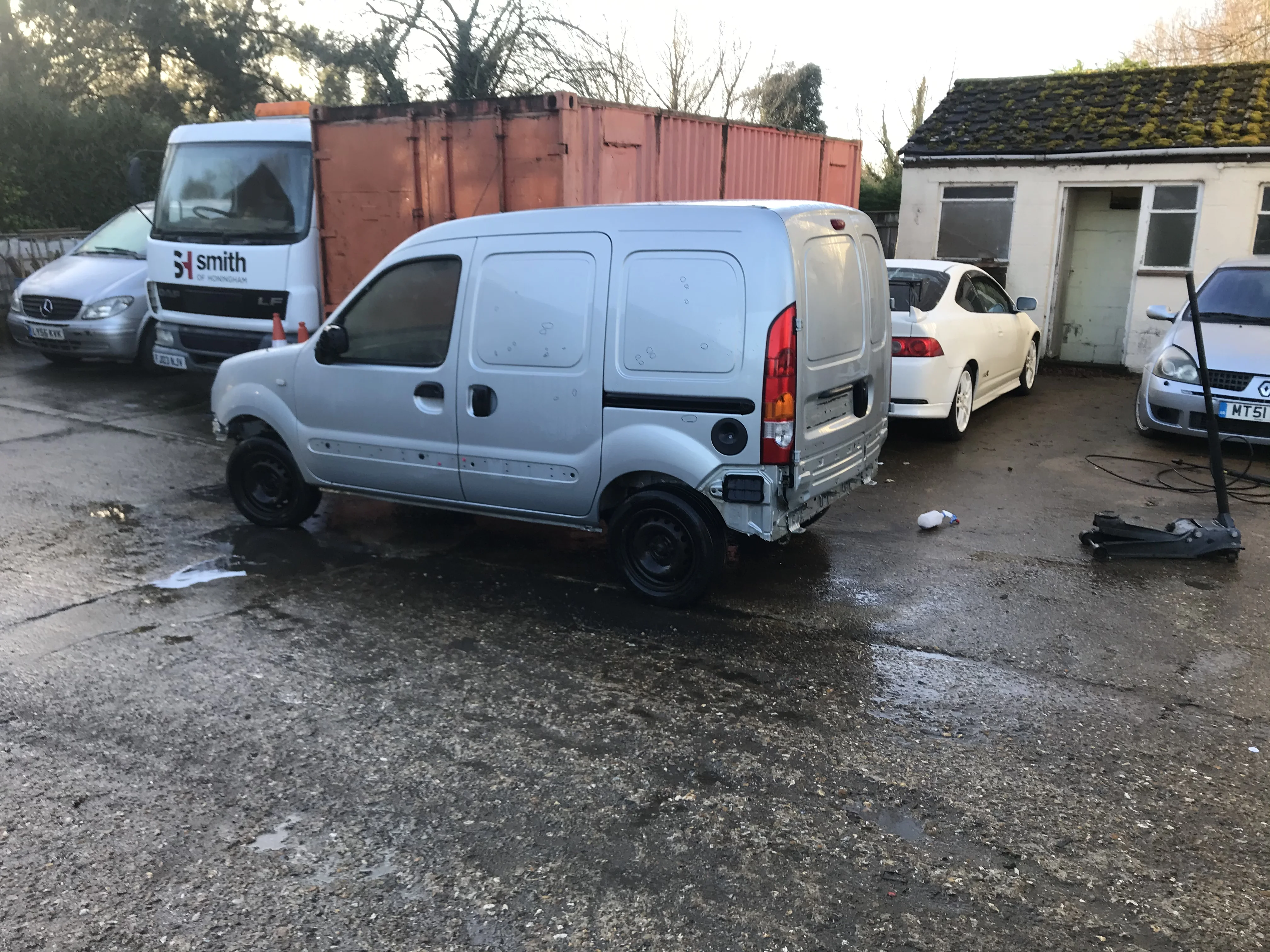

Then I made a start on body work did all the dents and got in primer but I’m only gunner paint inside engine bay atm so it can all go together then paint in one hit as it’s a 3 stage Pearl
(Soz for lots of pics)

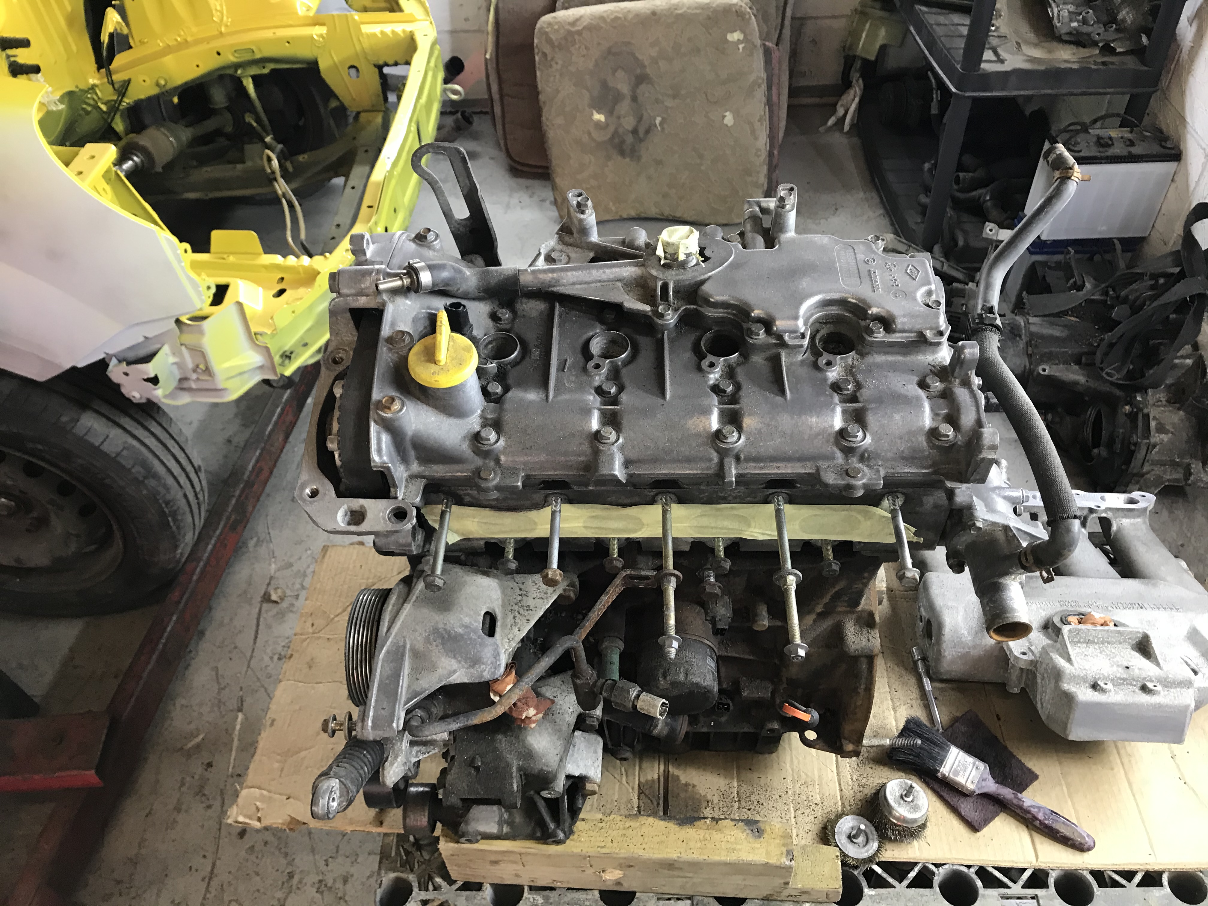

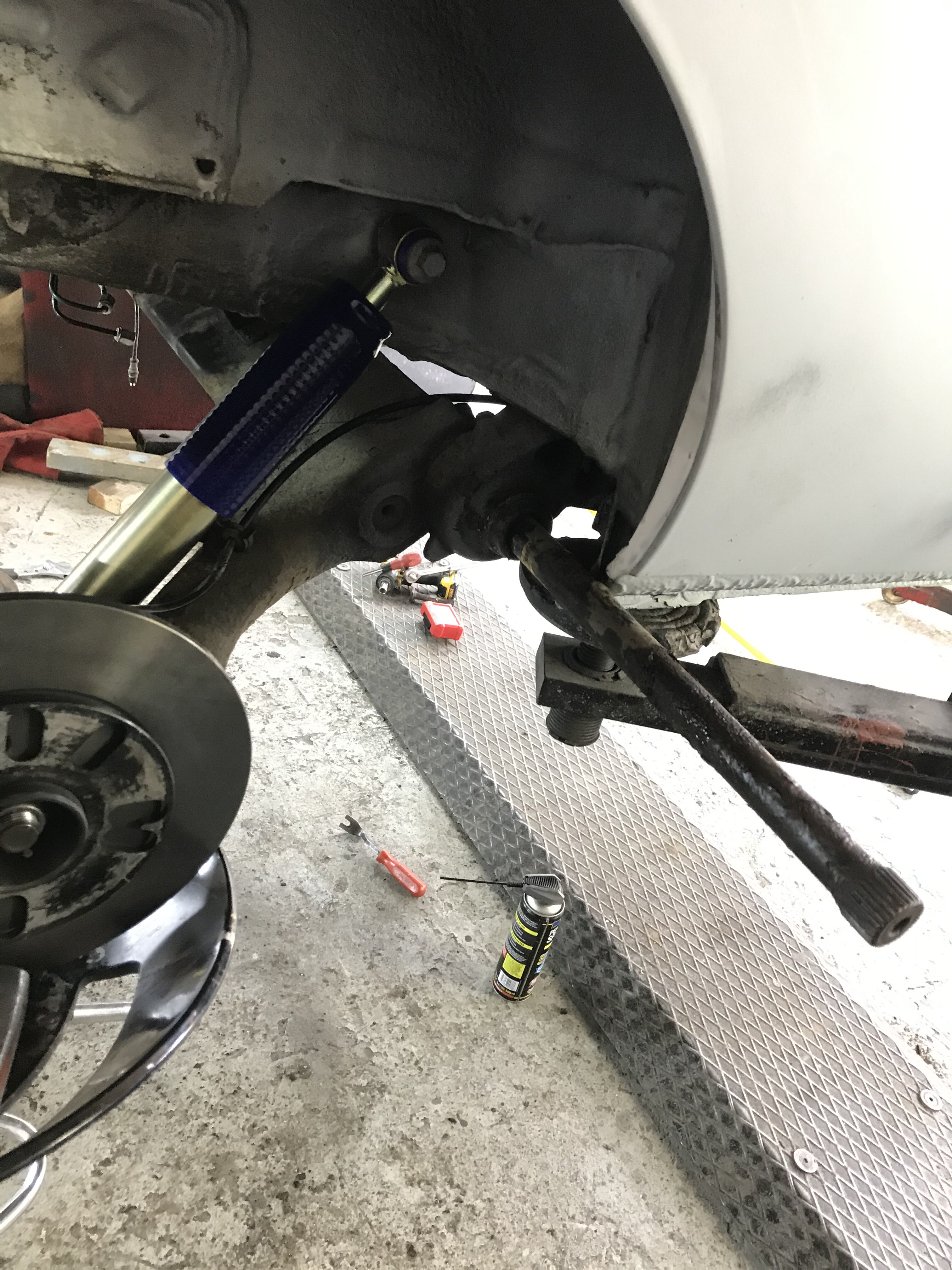

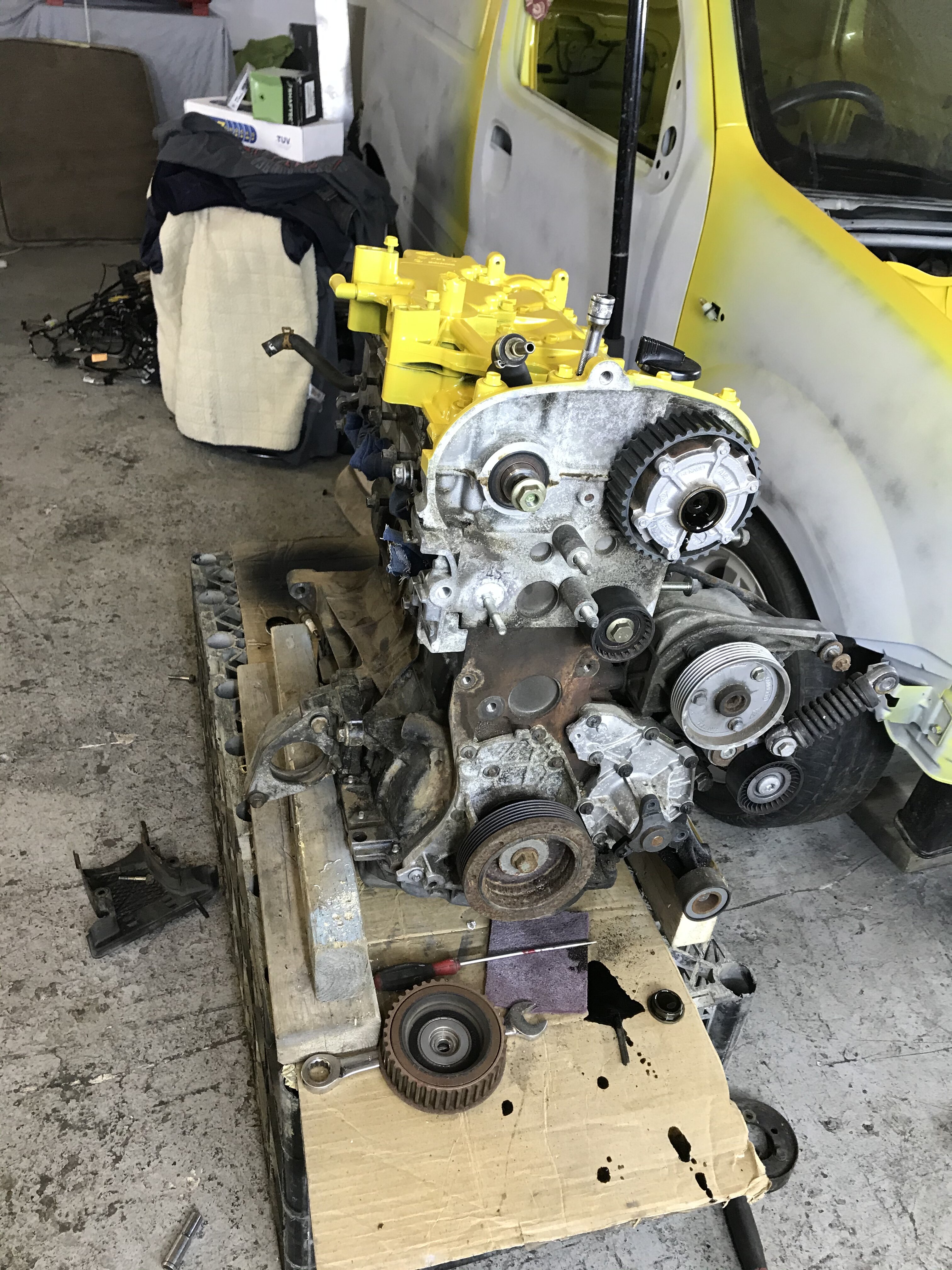

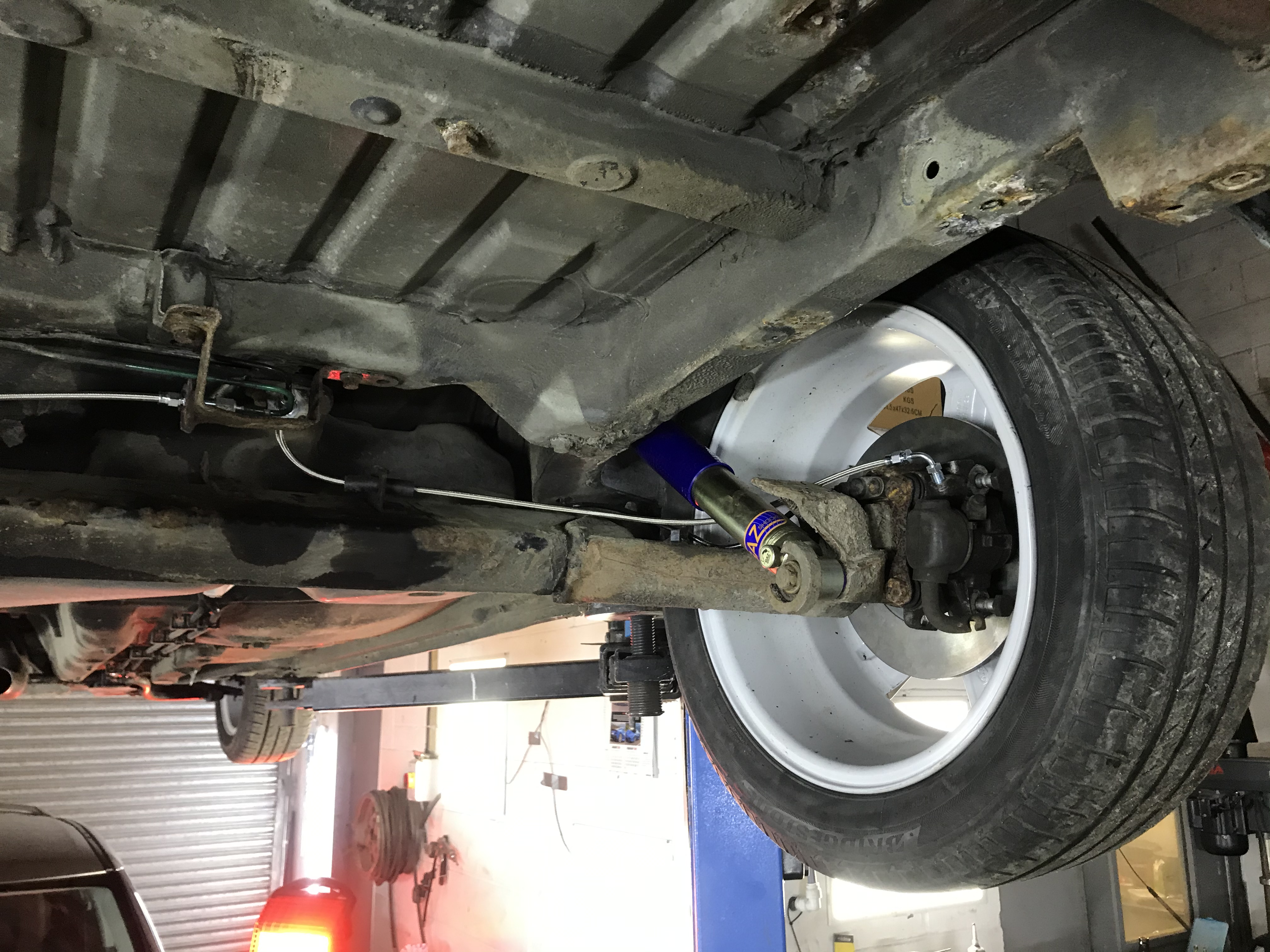

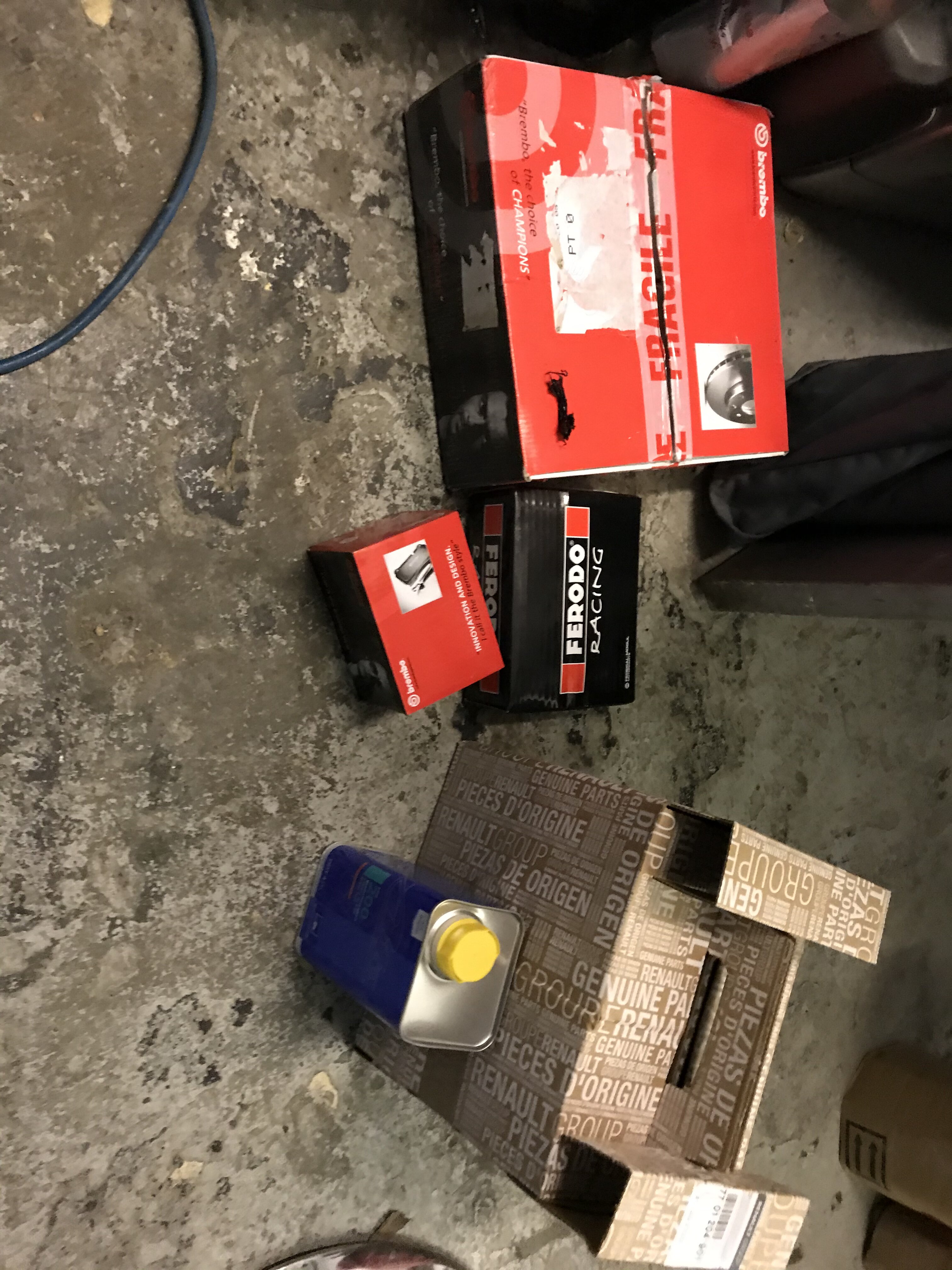

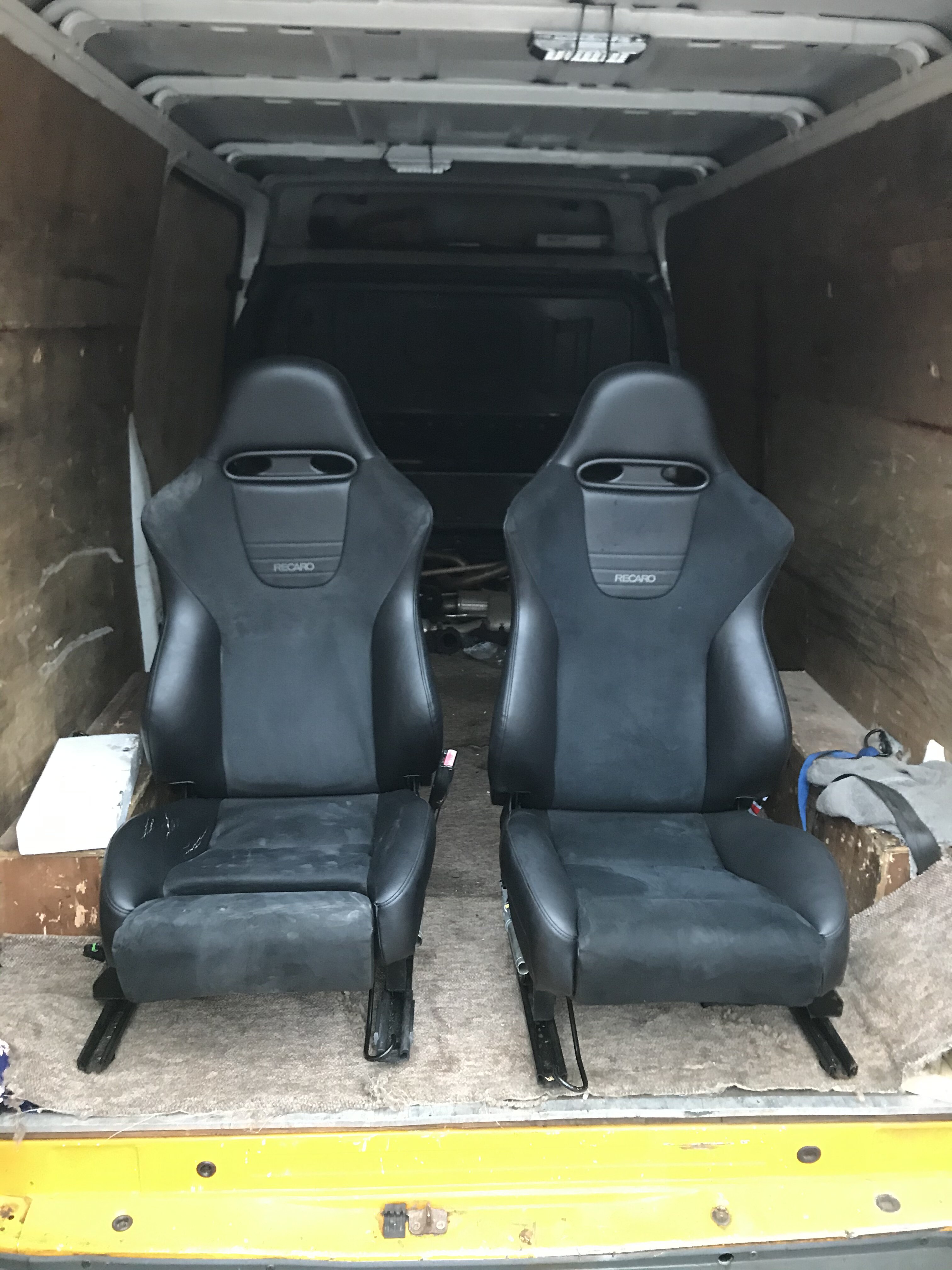

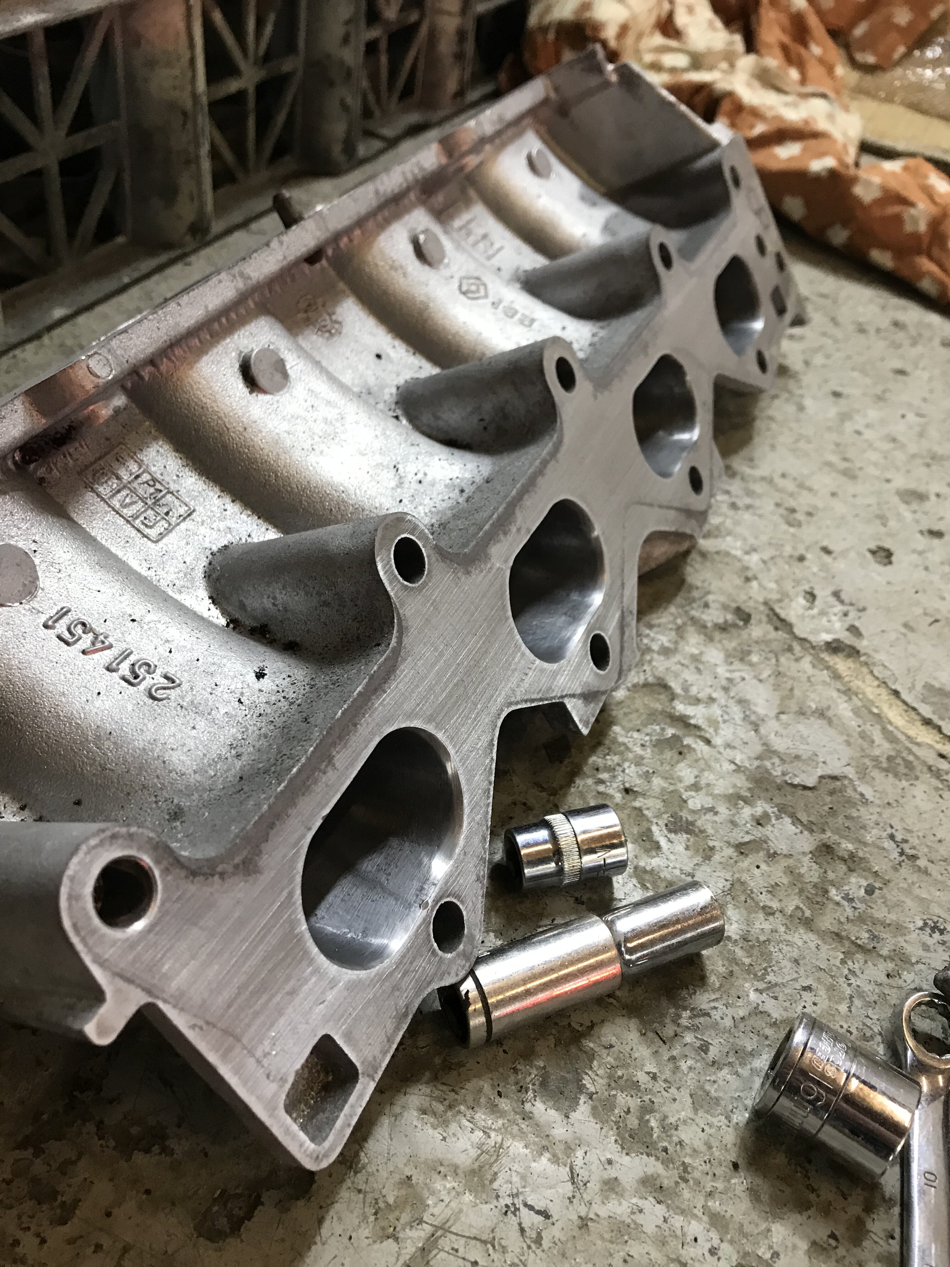

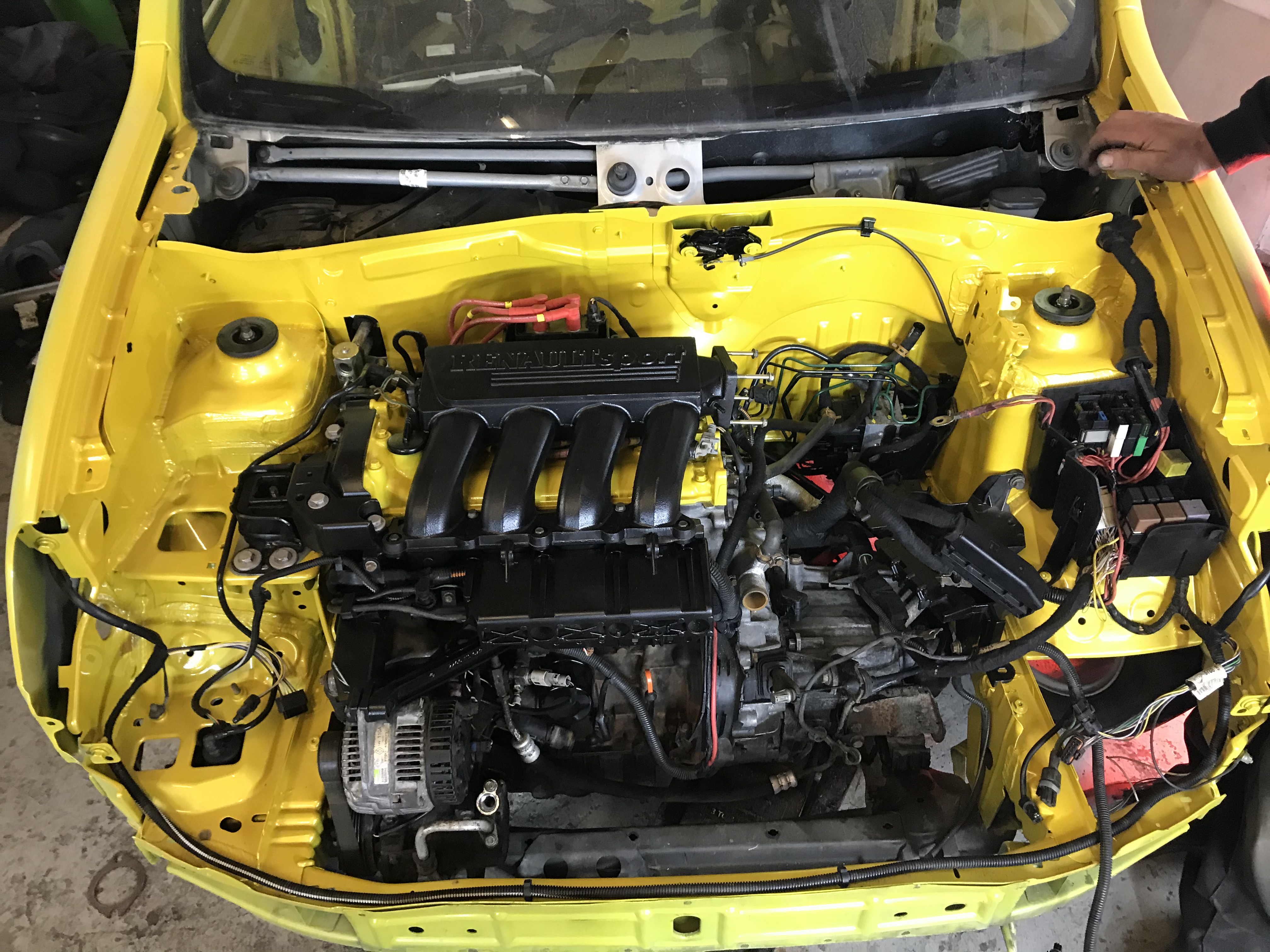

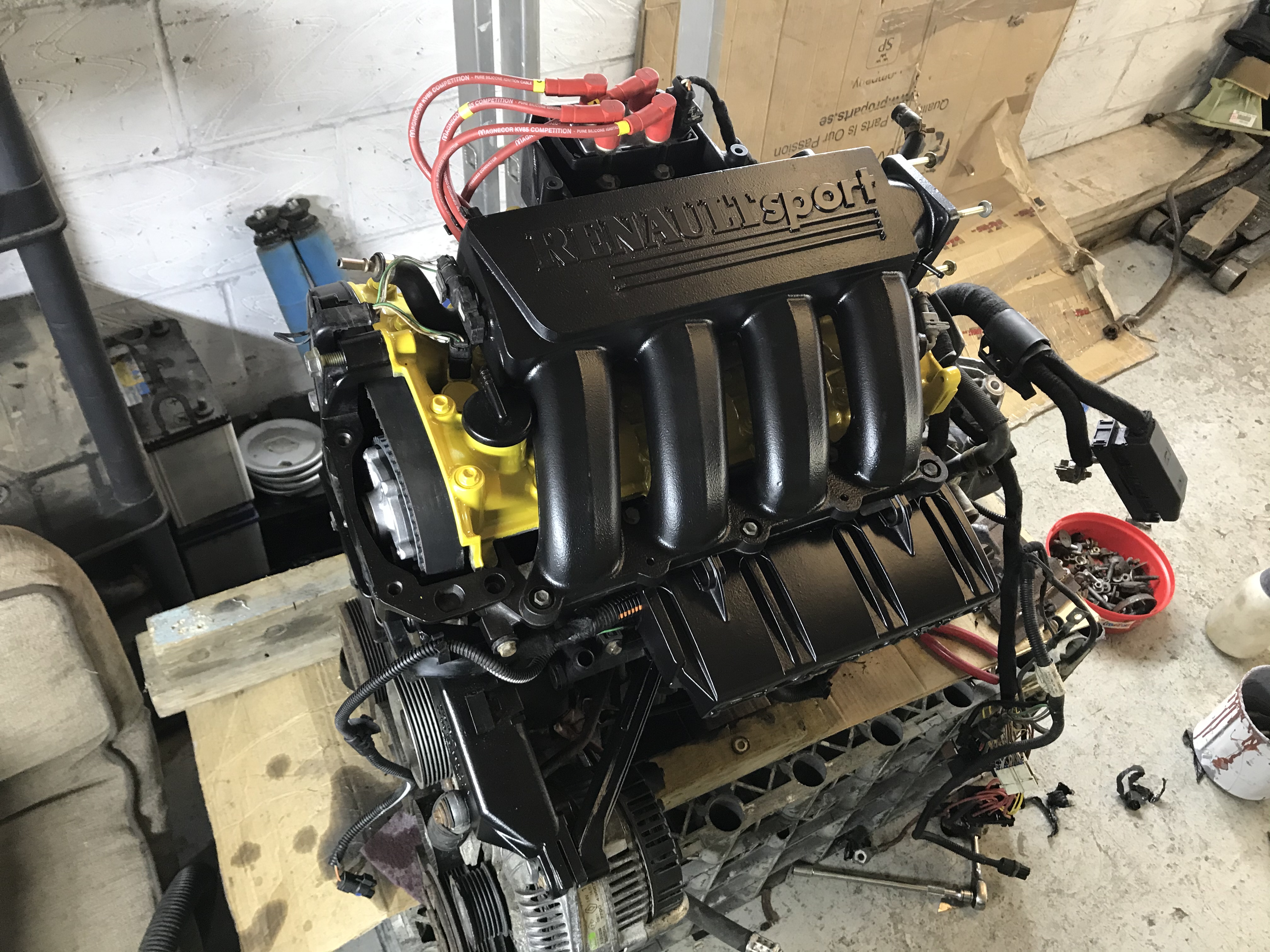

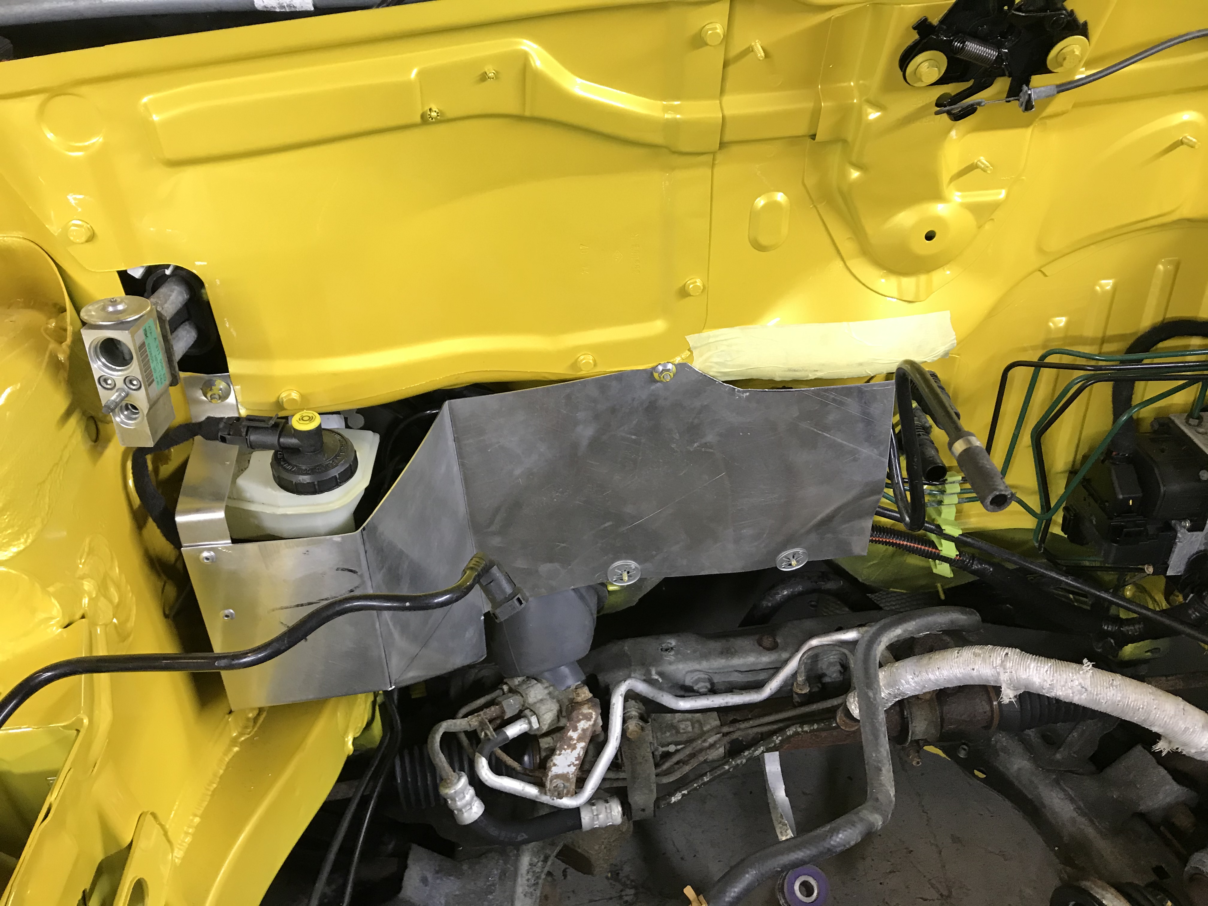

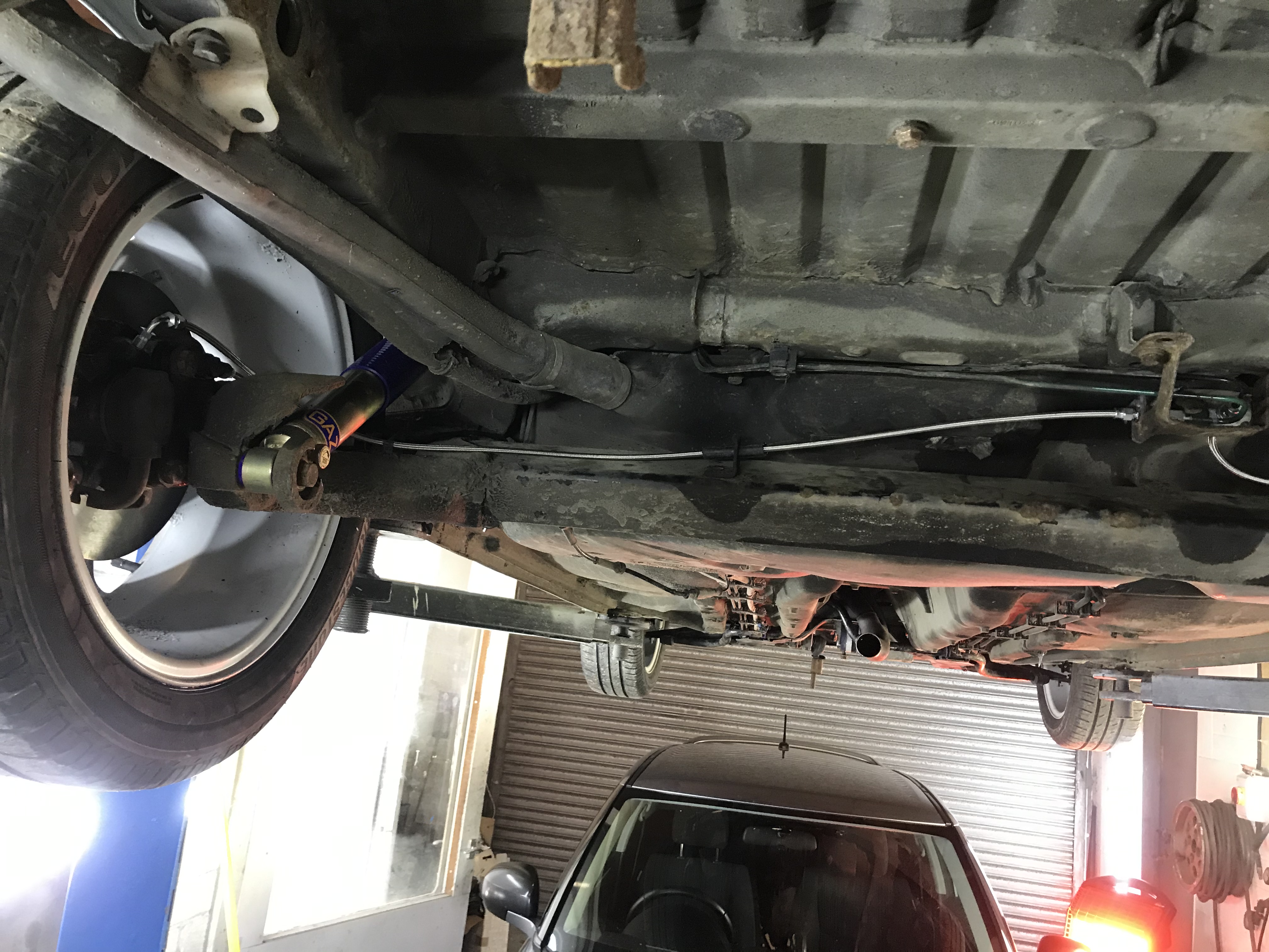

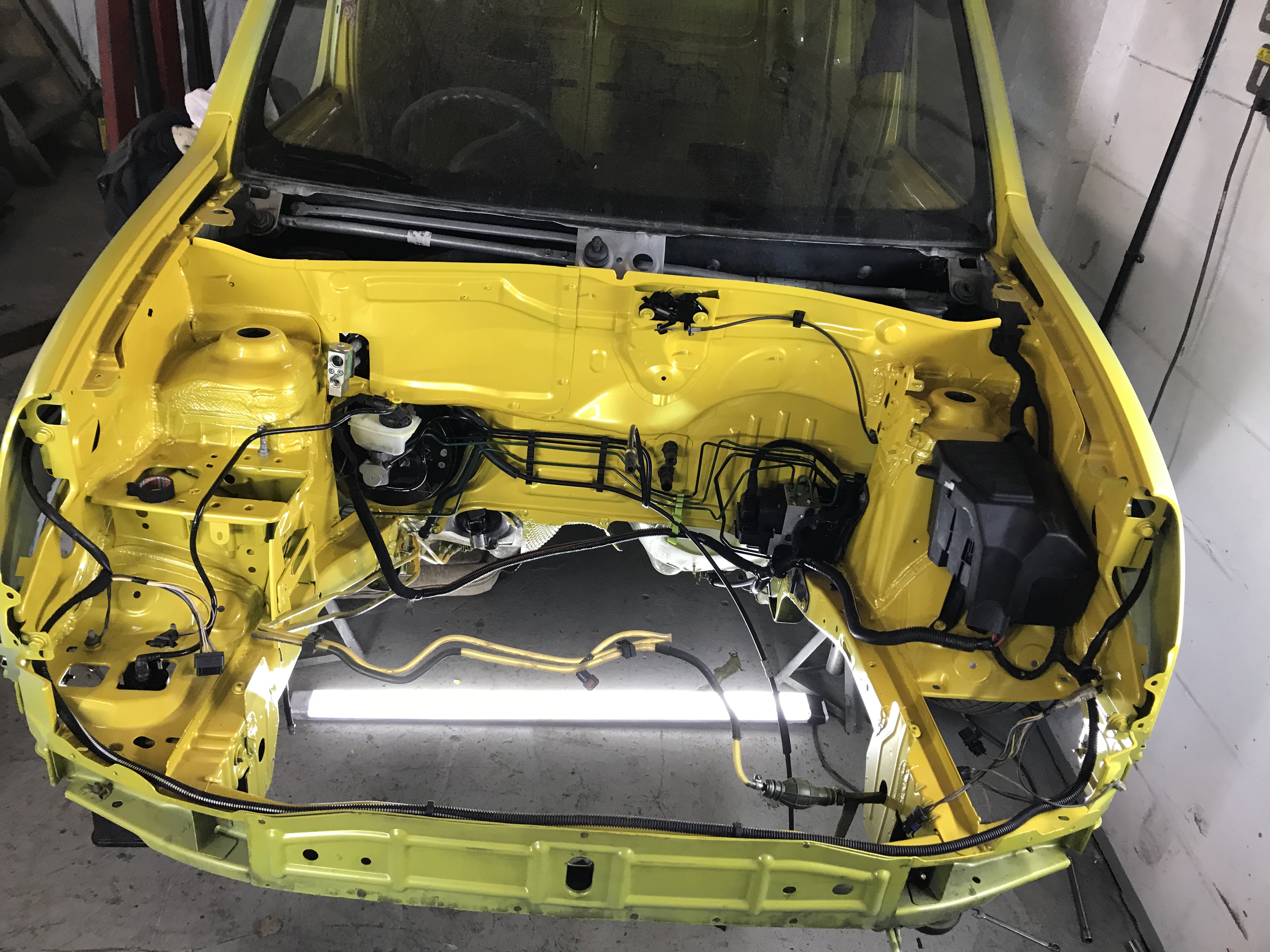

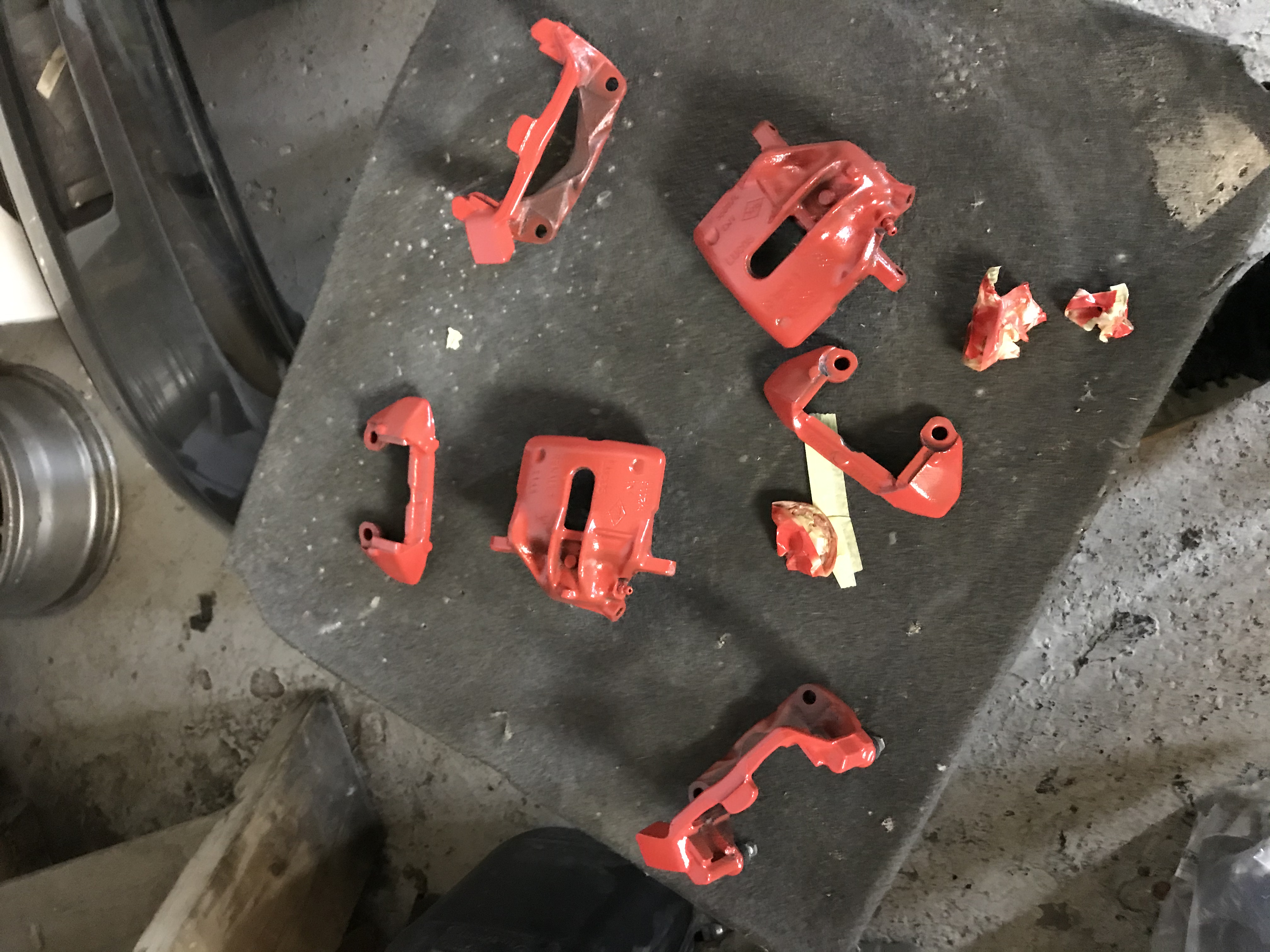

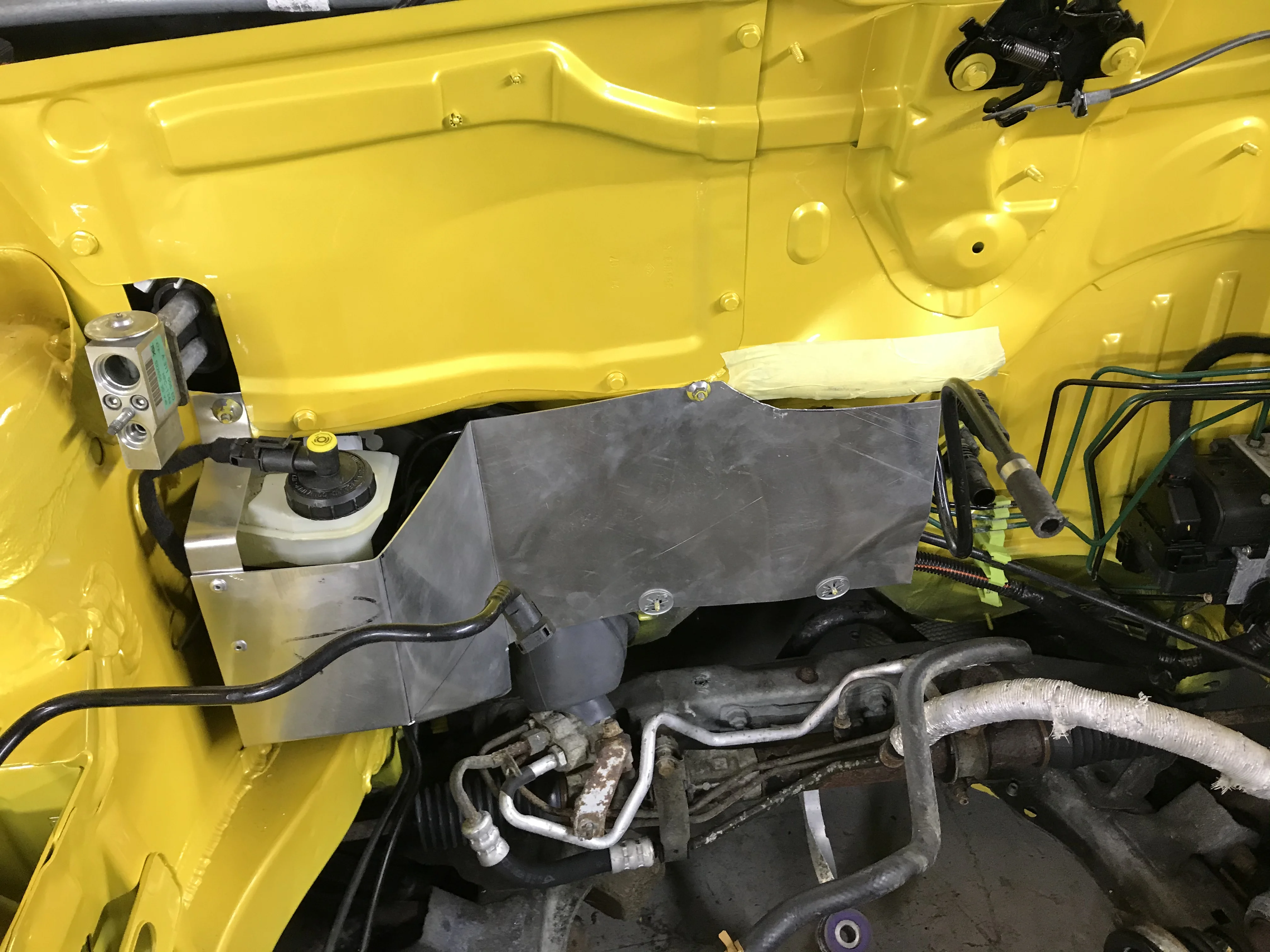

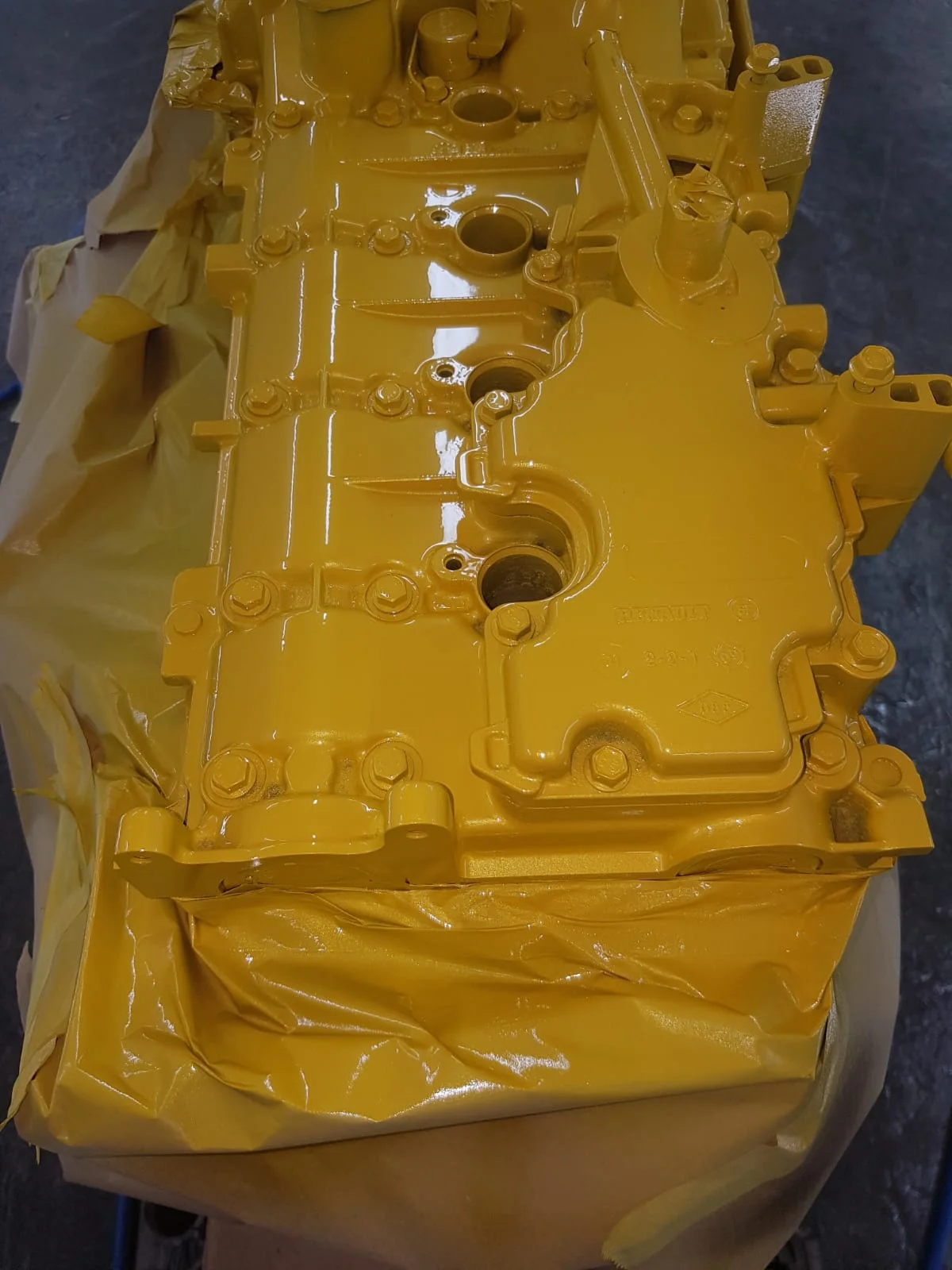

Rebuilt calipers made a heat shield Got a few new goodies got all my brakes off George @ RTR some Trendlines and some gaz shocks for rear and got engine and interior loom hung in I’m affraid this is how far I currently am but I did start xmas eve so hopefully quick updates 🤞

Good choice of wheel. Are you leaving it plain or is there any sign writing going on?
Cheers mate Yeh mate I’ll be sign writing nothing OTT I started a body shop/ fab with my dad so probs just my name

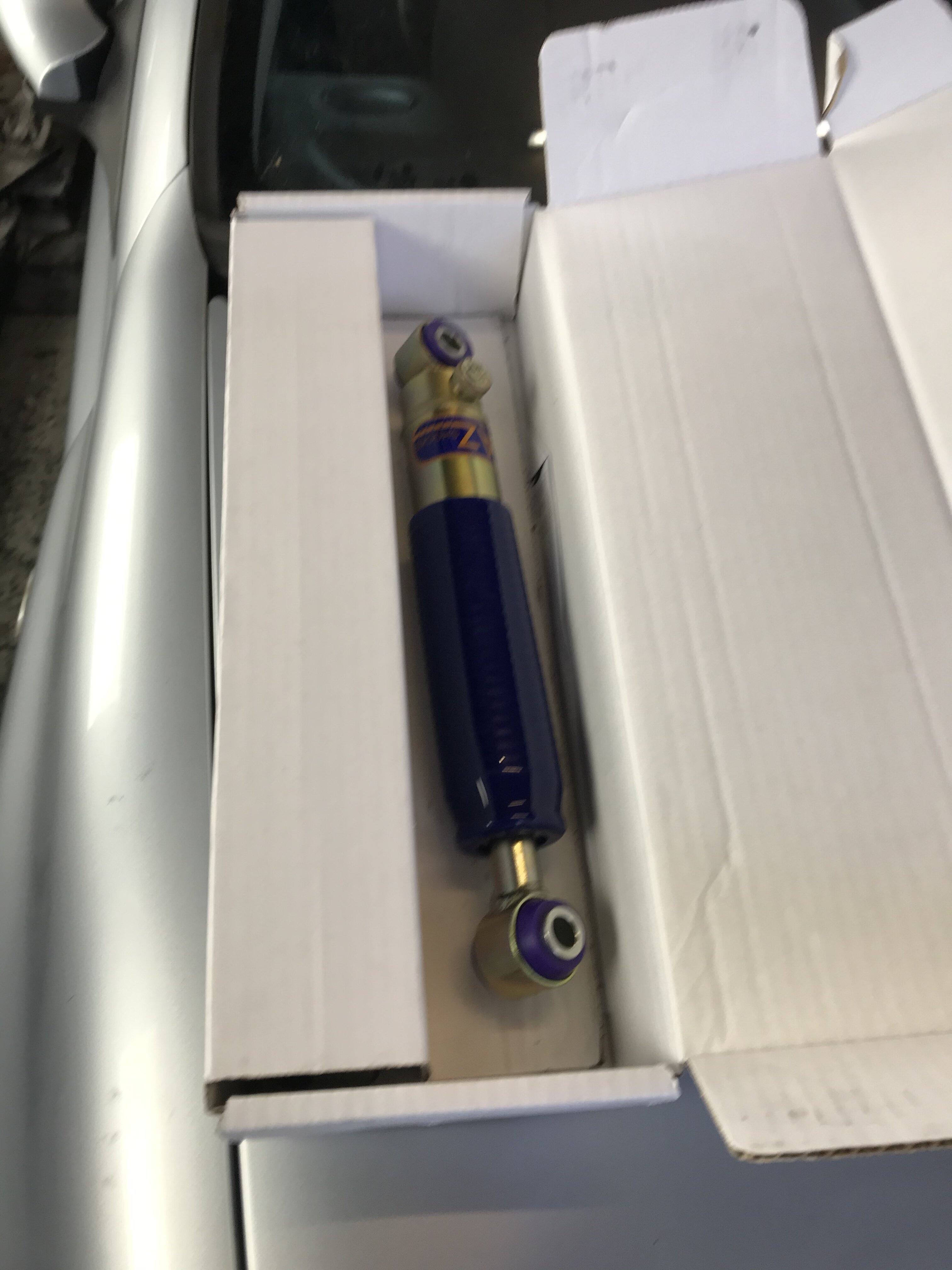

What rear shocks are that? For what model are they?
Since i own megane f7r and rear shocks are a bit hard to find for it, but this ( gaz ) that you've put on look like the same ones for megane.
Ye mk1 clio Williams I think gt r5 are the same
