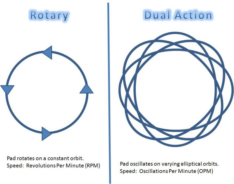

A rotary for a novice would be a mistake imo. You'll be burning through paint in no time.
Go for a Dual Action such as the Megs G220 which are much safer.
That is a rotary polisher, if you are new to machine polishing I would advice you get a DA (Dual-Action/Orbital or something) Basically, a rotary spins like a sander would, which gives better correction, but also more risk of burning through your clearcoat and wrecking your paint. If you do this the only fix is a respray. A DA, moves like a rotary but also side to side and up and down, not as fast at correcting the paint, but much safer.

I have the S1M Rotary, bought it after using the G220 for about 2 years. Huge amount of heat build up with a rotary especially when compounding. Its best you buy a scrap pannel, im all for using rotary over the DA as its far more capable, but you need to know what it can do, use a crap or cheap polishing or compounding pad and deliberately burn through, it takes all of 4 seconds to do, you also need to watch for heatbuildup over the entire pannel, ive warped a bonnet before, fortunately it popped back into place. Rotary will bite and jump a bit compared to the G220, you need to let it do what it wants and keep a firm grip on the machine,its also hard to get a mirror finish without leaving holograms and hazing if you dont know what your doing where as the G220 is fool proof. Good machine, but not as quick or capable as the rotary IMO.
