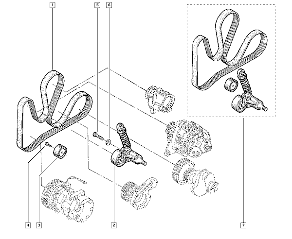

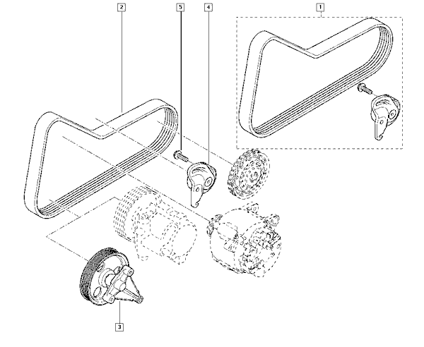

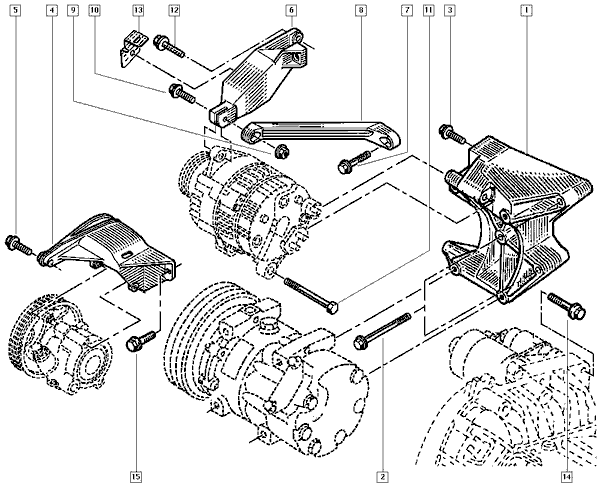

I fitted a standard 1.2 manual rack on my conversion. Just strip the pipes off and the pump + reservoir. You will need to fit an auxilary pulley from a clio 1.5dci were the old PAS pump is meant to go. You will also need a different aux belt as well. You dont have to change the column as it mates up to the 1.2 rack. If you keep the standard 172 rack with no PAS it will be very heavy - the 1.2 rack is superb....it works a treat.

someone told me i could use the Volvo alternator with the adjustment mount? if i use the DCI pulley would i have to use the old mounting brackets from the 172 auz set up to house it?
The aux wheel will bolt in place on the old bracket - you will have to play around with the bolts that hold it in place ( make a spacer ) so the belt that also powers the alternator lines up with the 1.5 dci pulley.

With a standard 1.2 rack the steering is nice and light - a 172 with a PAS rack which isnt working will be heavy
no 3 ...... £25 + vat from me
thats a daft way to do it! just put a shorter belt on!
yes! have you??
belt goes round the crank pulley over the water pump and onto the alternator, no need for a dci pulley at all
