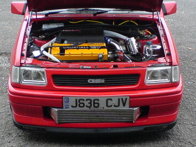

Engine: C20LET 2.0i 16v turbo conversion. EDS phase 2 switchable boost. Gasflowed head.Cometic 1.9mm head gasket. ARP rod bolts. Hybrid kkk turbo. Dash 34 actuator. Collins dump valve. Pipercross filter. Modified pistons. A.H fabrications 9 litre custom intercooler. Near solid engine mounts. Harry Hockley strengthening kit. Fully seam welded. Custom enlarged pipe work. Bailey header tank. J.P
2.5” stainless centre exit exhaust with tunnel though spare wheel well. De-cat. Bosch 909 fuel pump. Gsi petrol tank. Rebuilt myself 2004. New fuel system with fuel lift pump and alloy swirl pot mounted in the boot
Gearbox - Astra GTE 16v F20. Rebuilt using new bearing and syncros. Quaife straight cut gears with custom final drive. Quaife ATB diff.Gearing limited to 160 mph @7250 rpm. Astra inner/outer cv’s Custom made driveshafts. VW passat rear wheel bearing in the front. Custom hubs and flanges. Helix 3 plate paddle clutch.
Suspension: Bilstein/Courtney specially valved 2 litre shocks F/R. lowered 60mm front 80mm rear. Stub axles raised 20mm. Fully poly bushed. No front anti roll bar. Uprated rear bar. Lowered tie bar brackets. Modified Corsa Gsi power steering rally rack 2.4 turns lock to lock. Saxo electric power steering pump. Fiat Cinquecnto track rod ends.
Brakes: Willwood 4 pot 300mm alloy bells with custom brackets fo fit behind 15" wheels. Cavalier 260mm rear discs mounted back to front. Corsa cables. 3/30 rear bias valves. Cavalier 4*4 22.2mm bore master cylinder. Nova Gsi brake servo.

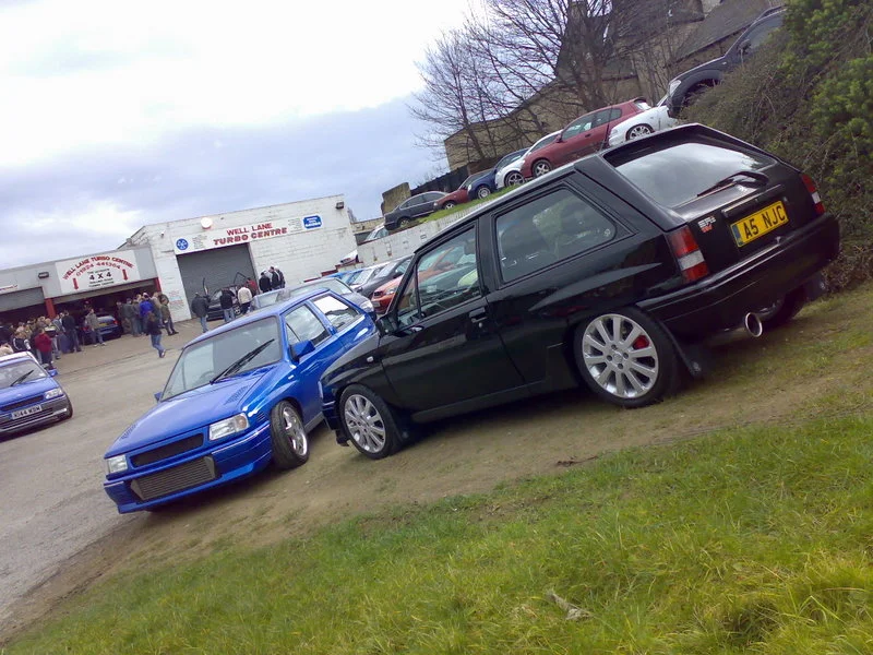

here is the one i saw

I've spanked that blue one with 2l tb numberplate on a trackday at donnington it was quick in a straight line but not so good round the corners....

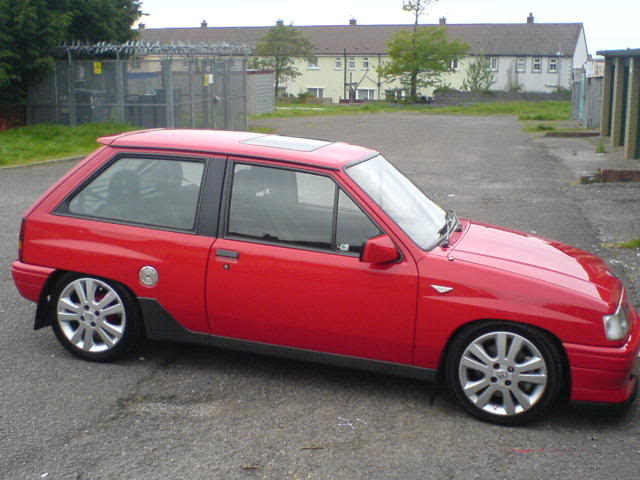

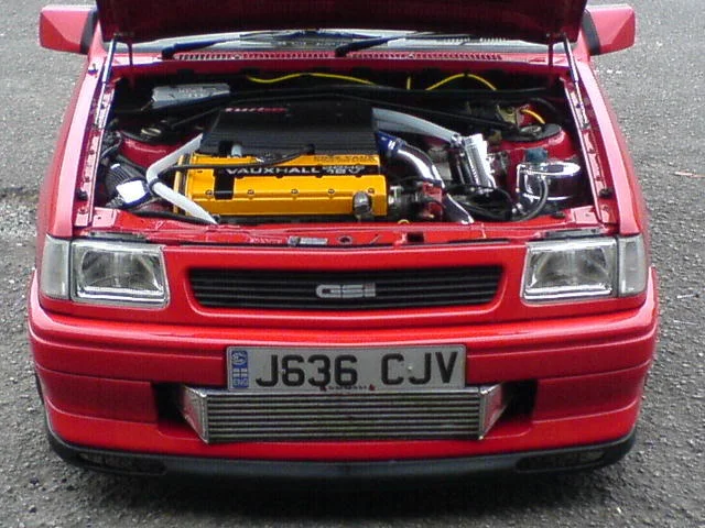

Heres some pics of it from bout 3 years ago. I dont personally know the ad that well just know of him from stoke and the mod'd car scence down our way. Mark Beeseon Gay his name is, after speaking to one of his mates, this lad has built all of this car up him self, bought it in 1998 as a 1.4 Nova SR and the above spec has been done all by himself, obviously he will of had help from others o and he is an Electrican by trade not a mechanic. Any who, the pics of the Nova is beasty's car, and here is a vid of him at the ring.

That Red Nova has 300+ BHP? Still looks like he has standard brakes, Drums on the rear!? :eek:
