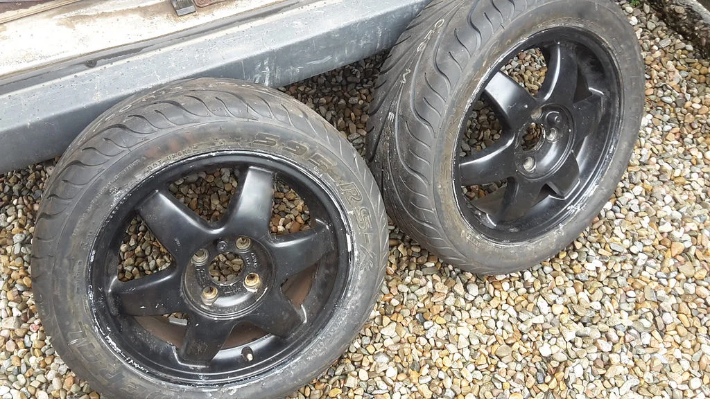

So, still waiting on the brake discs and new wheels that are at the powdercoaters, the track wheels i've got aren't getting powdercoated though they're not too bad plus for track i'm not that bothered about the finish anyways. I've gone for the common Cavalier Cesaros as they look decent, good for brake cooling, cheap and the same offset and width as the fan blades so loads of room for chunky tyres, test fitted not sorted tyres yet -

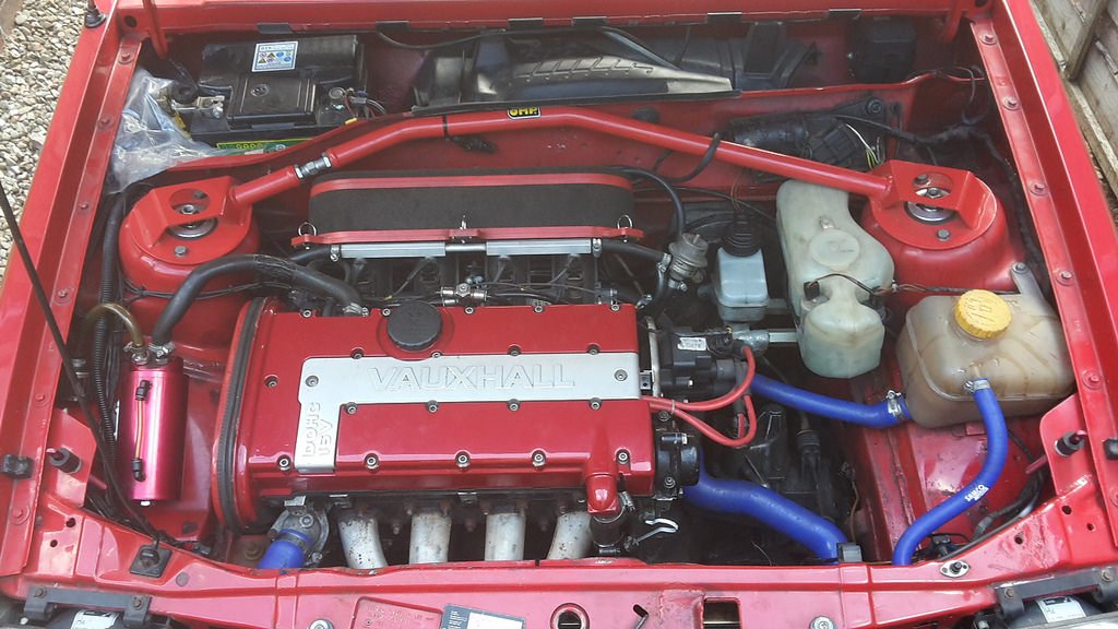

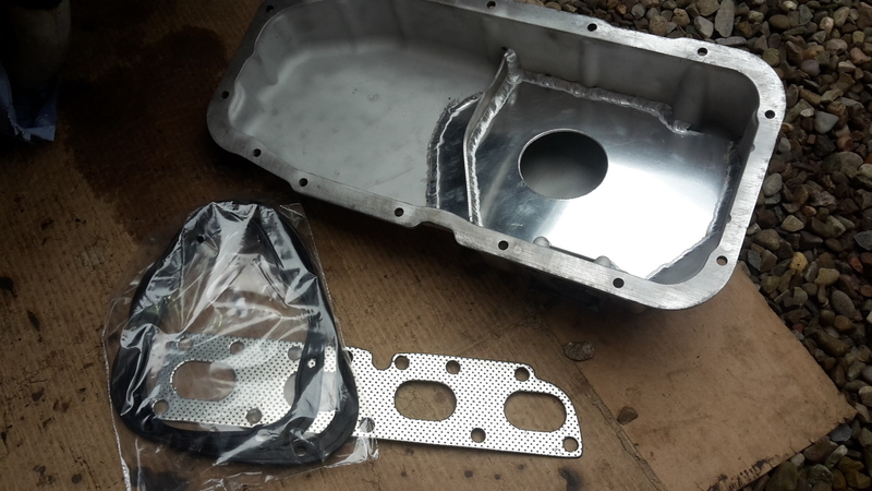

Got a mint condition sump off ebay, sent off to Dewis Motorsport (recommended, off MIGWEB) for baffling, ready to go on with a new sump and exhaust manifold gasket -
Was abit of a mare to swap, vauxhall made plenty of room to get access to one of the sump bolts next to the flywheel but not the other so with help of a mate he brought a 1/4drive socket and extension, was tricky refitting the windage tray and pick-up pipe too so also much easier with some help! Oil in and filter swapped and jobs a goodun -

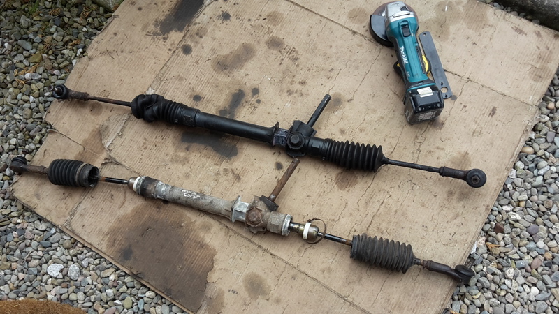

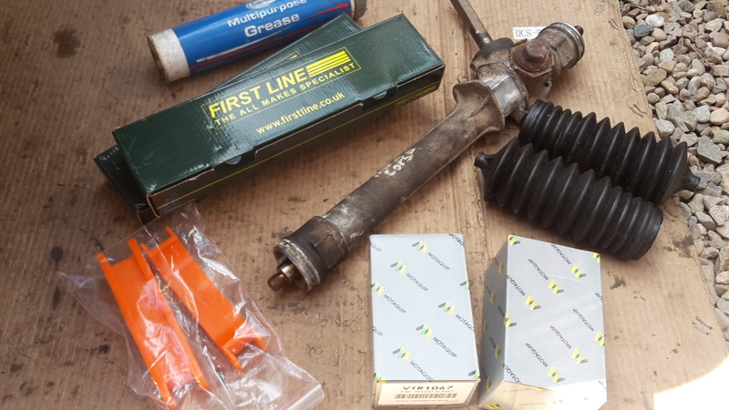

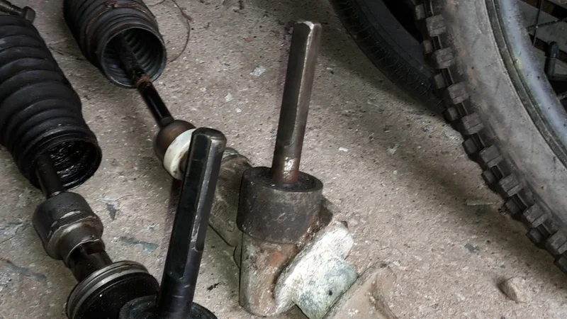

After driving the car for the first time i was shocked at how terrible it felt around corners, not just the far too soft suspension but how much you had to turn the wheel, standard rack is 4 turns lock to lock, so after some research i ordered the rack i needed, for it to turn up and still be 4 turns - Fantastic... so sent that back and found the right one on ebay so i messaged the guy and snapped it up asap, the rack is from an Electric PAS Corsa B which is 2.7 turns L-L, only on certain models as they also do Hydraulic PAS Corsa Bs too god knows why they did both options, anyways rack ready to be attacked with a grinder -
after -
then to swap the track rods and ends as the Corsa has slightly wider track, was planning to use the ones off the nova rack but one randomly rounded off the rack when i removed it and the other was fcuked, so obviously no where stocks Nova track rods so ordered some for the next working day along with new rod ends, picked them up all ready to be built up and fitted along with some FlowFlex rack mount bushes, once i fitted the rods it taken me about an hour n half to just bolt the rack on, the lack of room with the engine in is horrendous as the Gearbox is literally the full depth of the engine bay aha -

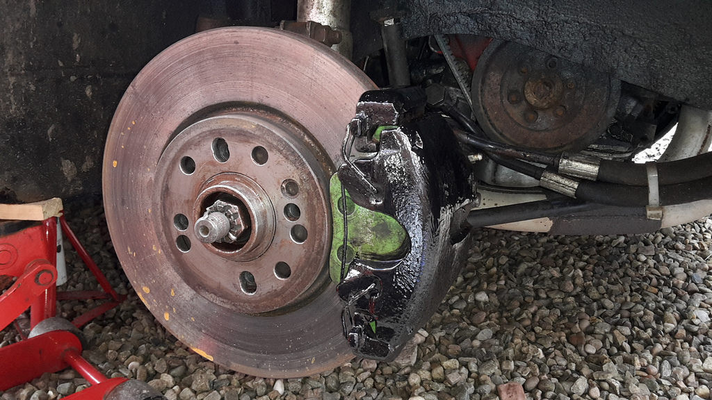

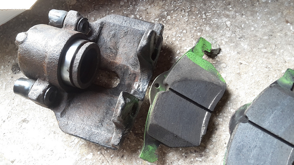

so, the 3rd set of brake discs turned up, not the ones i was expecting lol... so the brakes that came on the car 284x24mm discs unsure what they were off, and the calipers are cav v6, gave them a freshen up with black paint and noticed the dust seal missing, so i just ordered some new calipers from BrakeParts International as i couldnt be bothered swapping seals etc, so old setup -
20170607_111551 by jamie rigby, on Flickr
dust seal missing causing uneven wear -
20170615_172303 by jamie rigby, on Flickr

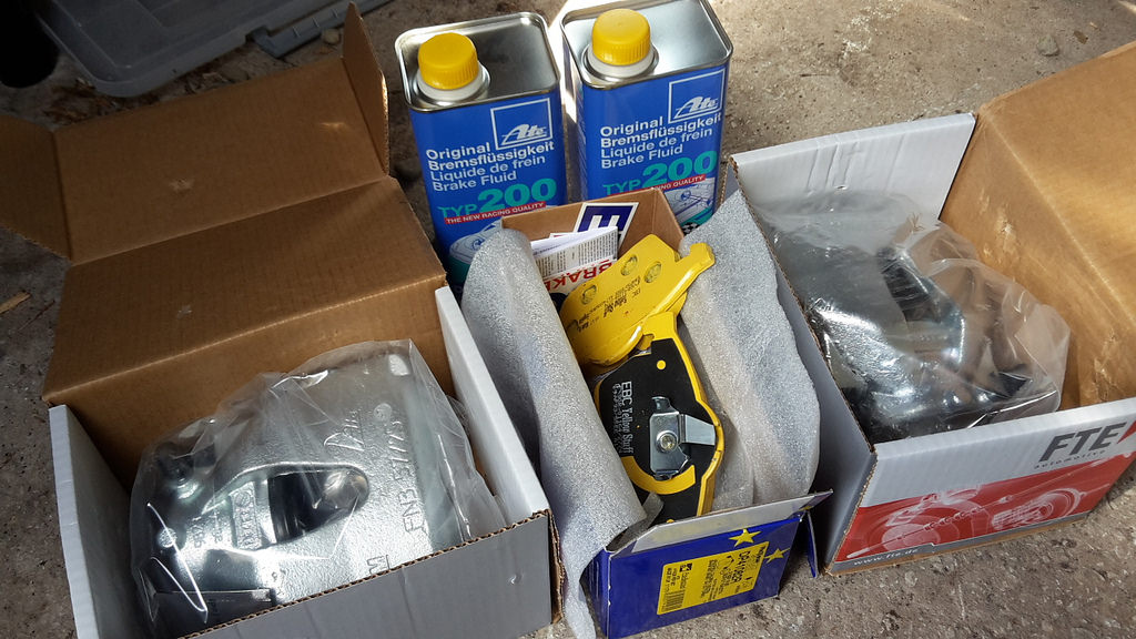

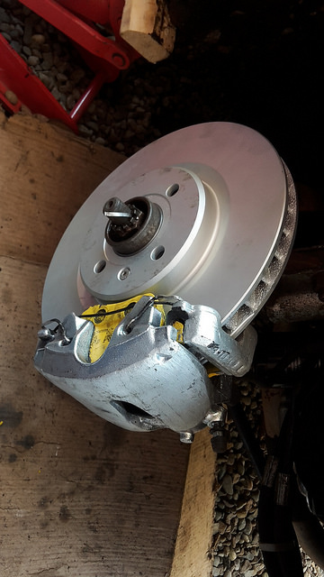

new goodies, late calibra turbo calipers, yellowstuffs, fresh fluid -
20170615_152228 by jamie rigby, on Flickr
Lotus Exige 288x27mm discs, spigot rings made from a local metalshop (56.7-60.2mm), discs fitted and carriers -
20170717_143005 by jamie rigby, on Flickr

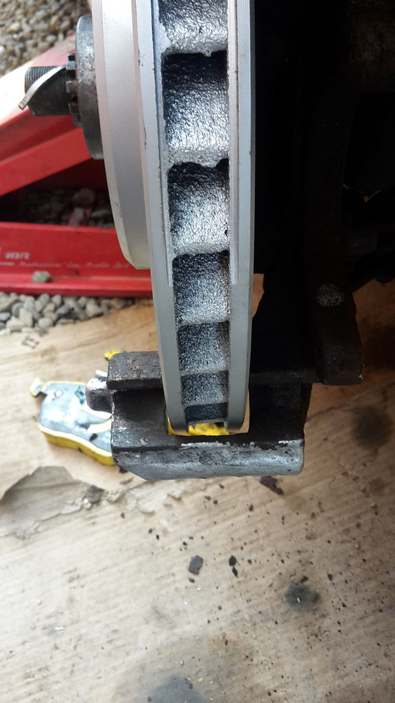

calipers on, shaved a little for clearence on the vauxhall wheels -
20170717_143600 by jamie rigby, on Flickr

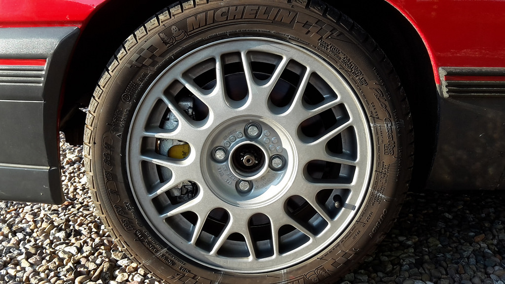

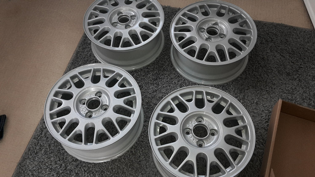

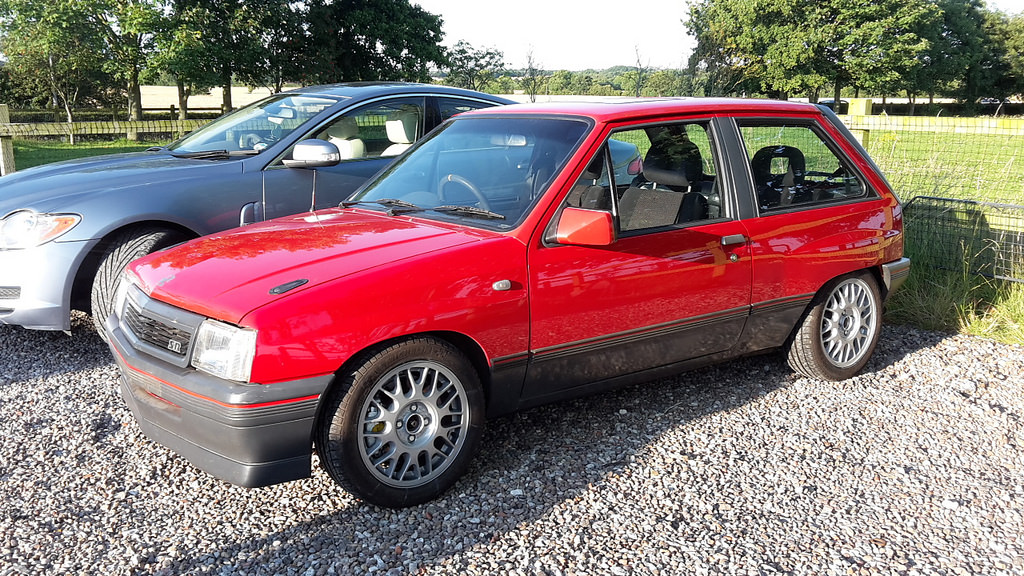

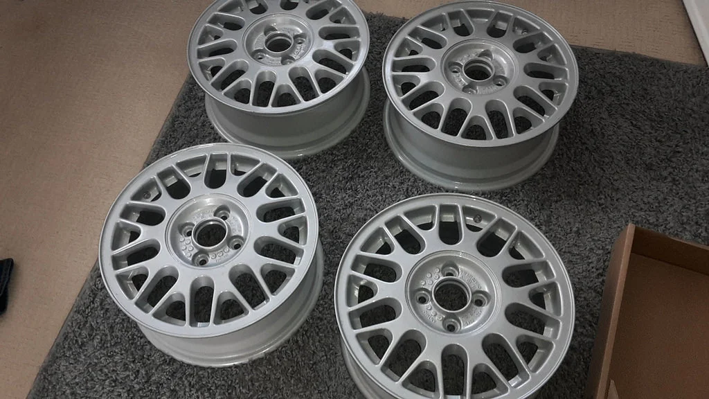

Went for mk3 Golf BBS wheels for road wheels 6j et45, freshly powdercoated -
20170708_161051 by jamie rigby, on Flickr
fitted with new michelin PE2s -
20170717_193529 by jamie rigby, on Flickr
20170717_193747 by jamie rigby, on Flickr

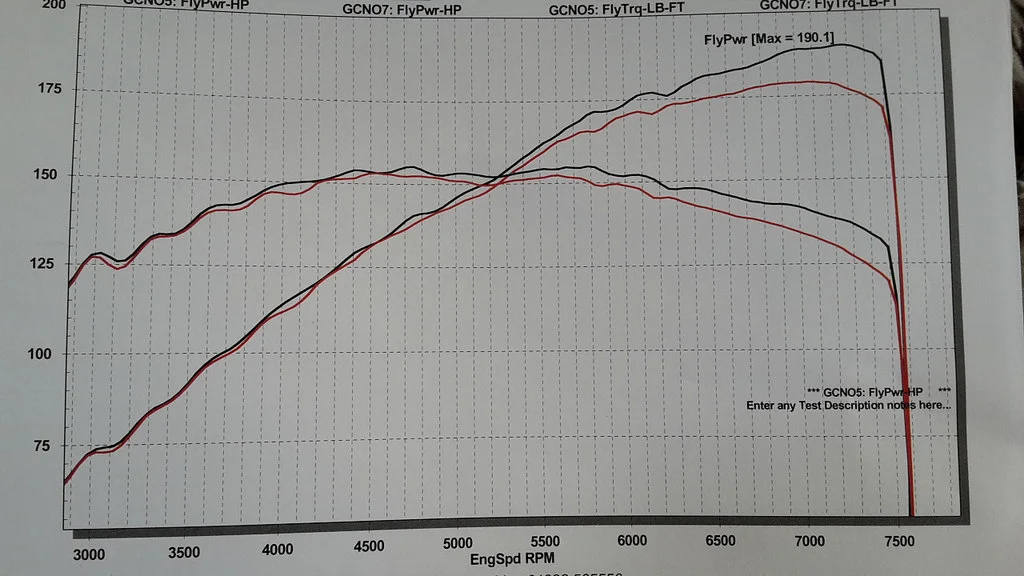

went to see Chris at EFI Parts last sunday, before and after, still needs more work throughout the map but its healthy and safe for now -

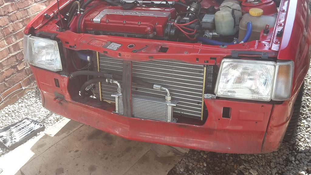

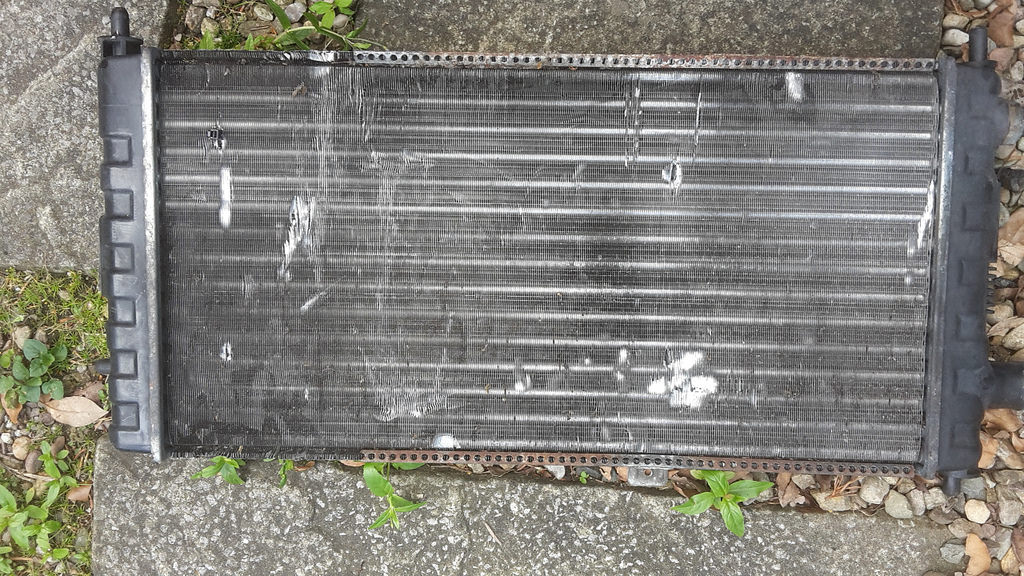

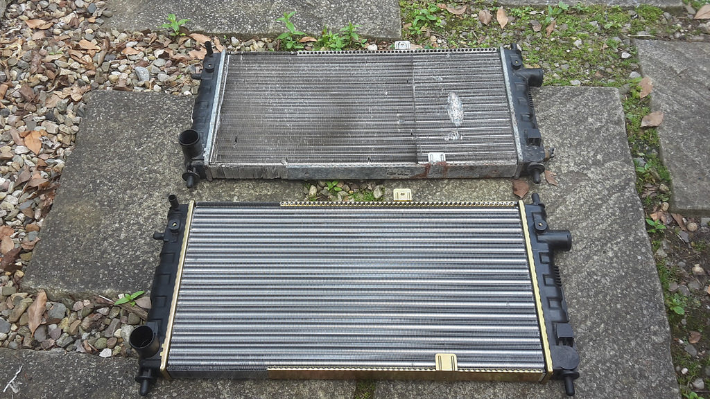

New Nissens radiator vs 10yr old one -
20170712_145622 by jamie rigby, on Flickr
20170712_145551 by jamie rigby, on Flickr
20170712_165726 by jamie rigby, on Flickr

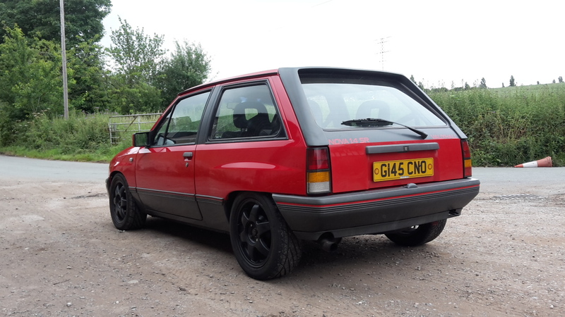

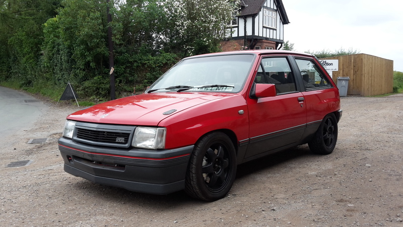

Federal RSRs fitted to the Cesaros -
20170710_153032 by jamie rigby, on Flickr
