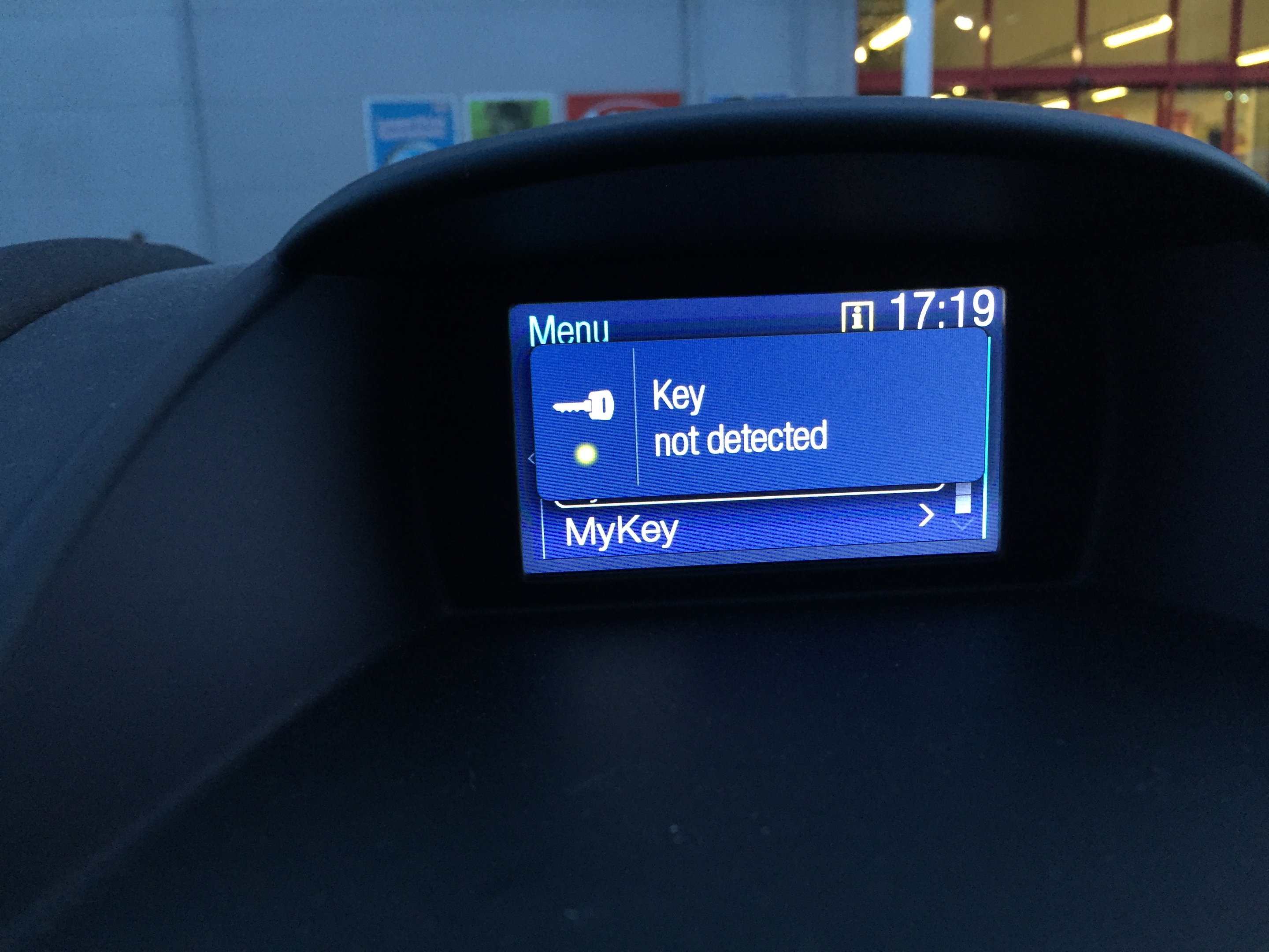

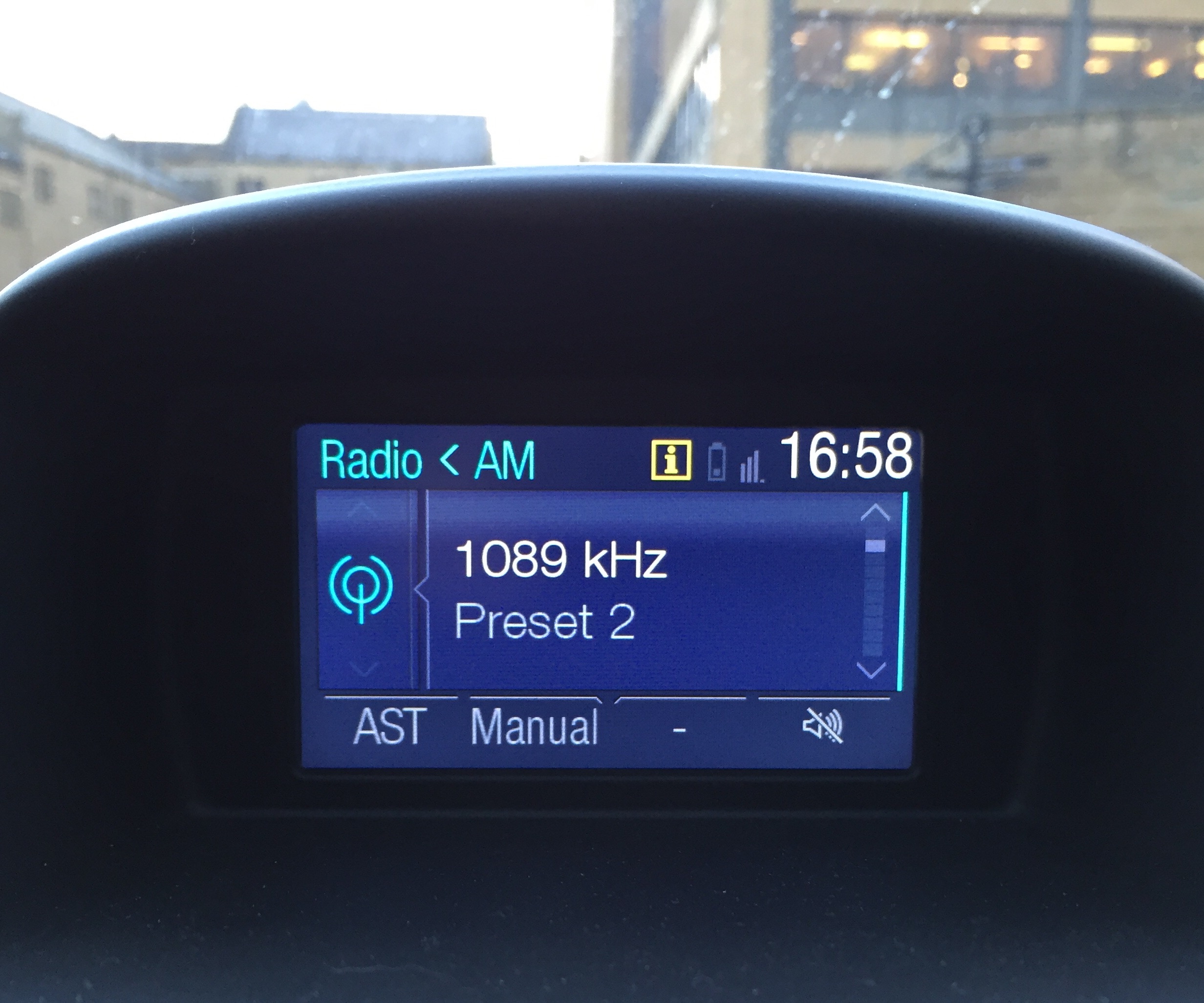

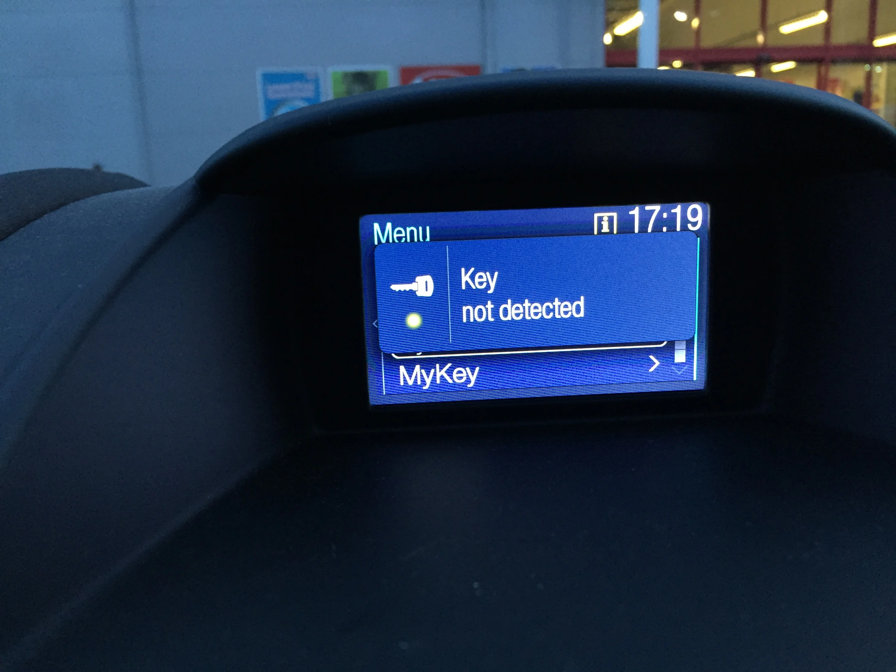

Can someone help me with this question as its doing my head in. I can't get rid of this yellow 'i' and it won't tell me what it's for?
Anyone know what's going on? @MarkCup
It should tell you what that's for as part of the startup when it cycles through "push clutch down and press start" and various other messages etc.
Possibly a door or seat belt or airbag sensor? Or that your TC/ESP is completely turned off!

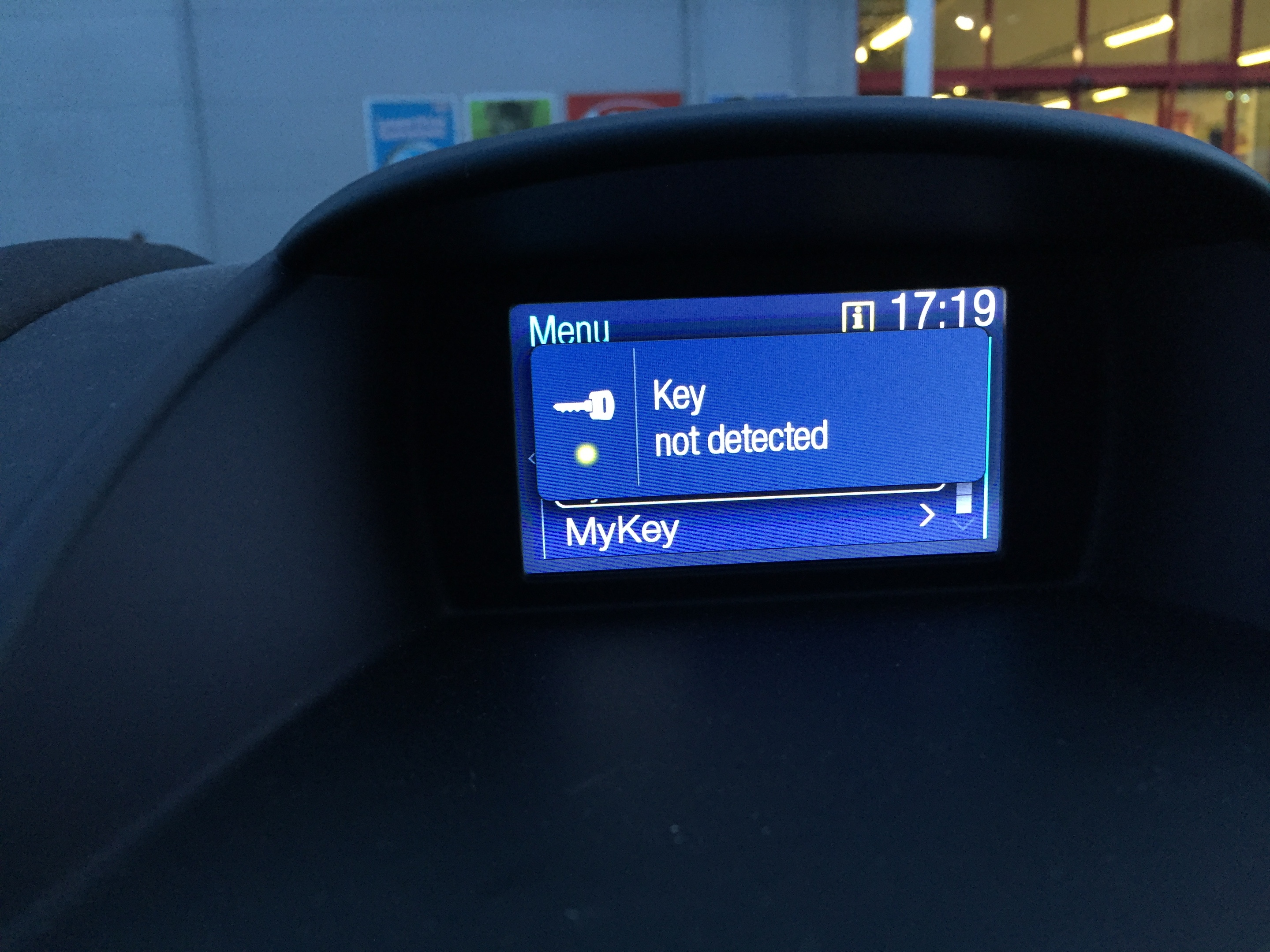

Think it can't detect my keys (despite them unlocking the car and the engine running fine etc)
Wonder if it needs a reset. Can't see anything in the book though about how to do it. Ball ache.
When I had my Focus, this message used to pop up when the battery in the key was running low. Could be the same here.
As for the 'i', it was used for car status alerts in the past. Low washer fluid, tyre pressures etc.
