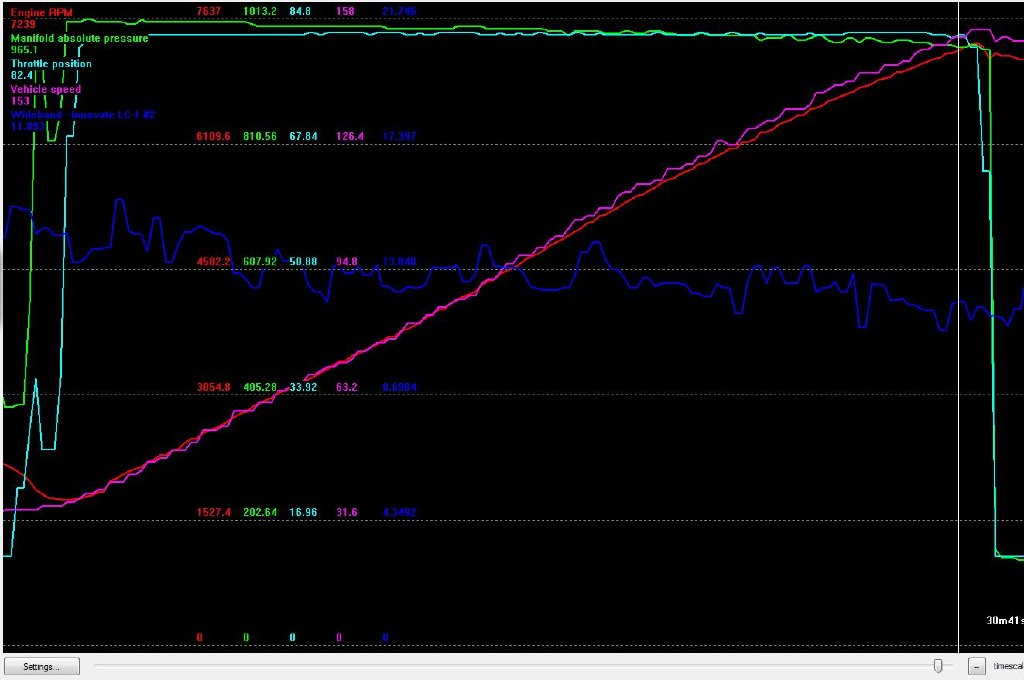

Manifold absolute pressure is what it's all about.
Can You see how the green line drops down between 2000rpm and 7000rpm ?

Are You sure You reading this figures right ?
Check my graph ^ I've got 1005,8 at 2000rpm and 976 at 7000rpm
This is no good :/ You need to make a run on 3 gear from 2000rpm to 7000rpm on WOT (wide open throttle) do not play with acceleration pedal, floor it all the way till red line.
Check it for Yourself. Run RS Tuner, select "load log" and select the log file. Than select the parameters (Engine RPM/Manifold Absolute Pressure/Throttle position/Vehisle Speed) There is nothing like what I posted ^

It's hard to keep it steady on the graph :) But when You flor it it should be relatively steady. I do mine on the way home from work :) Just find the right moment and a piece of road long enough :) and make the WOT run.
Later at home You can easily browse for the piece of graph You want (it will always look similar to mine ^^ :) )
The graph will not show You the actual gear, ECU doesn't know it, RS Tuner doesn't know it. But it's not hard if You know what You were doing on the way (long breaks on idle usually mean traffic lights etc.)
