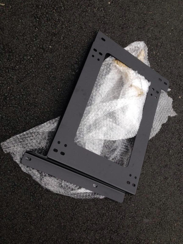

Sounds like you need Clio specific subframes like these;

I don't have them yet, but from what I have seen of them they are OMP fixed bucket seats with sliders and the bit beneath the sliders that connect it to the floor.
