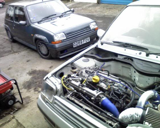

Grey ones mine, white ones a mates.
A
ashy_gtt
So hows the box mated to the BE? some kind of Adaptor plate??
Just made an alignment adaptor to mount the box concentrically onto the crank then Matt drilled and tapped the block and bolted it on. Job done
