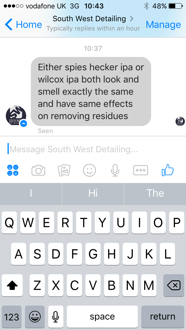

You can't knock his customer service that's for sure! @gally is right though, was there a wipe down procedure? I really hope there was if not it's all going to happen again, that polish will fill a surprising amount of defects and with a proper wipe down to remove the fillers you won't see what correction has been achieved. Also putting any product over any of this without a wipedown will mean the coating will not work, at all!

He spoke about wipe down before coating the car originally. I'll ask the question.

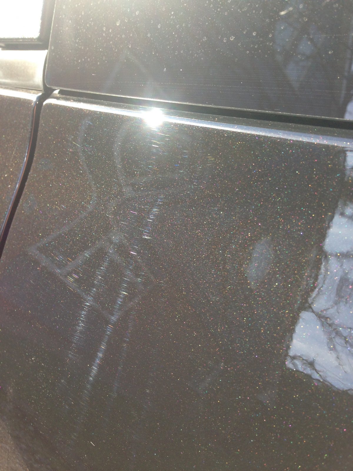

I'm sure others will enjoy saying "I told you so" but I had to give the guy a chance.
Not washed the car, direct sunlight at a angle, can't see it easily head on.

That's a shitter mate. But (and I appreciate how experienced these people are) the people telling you Renault paint is hard are wrong. The black on Renaultsport cars is soft as s**t, the slightest hint of dust and a cloth will Marr it.
And I'm betting that those fine scratches were cause by his 'final wipedown' before you collected it.
Either way, a nightmare for you. ☹️

If the paintwork has a cermaic coating I thought this was supposed to stop marring? That's why I had it done.

I'm probably the worst person you can discuss ceramic coatings with mate! Lol
I'm an atheist when it comes to anyone mentioning it unfortunately.
