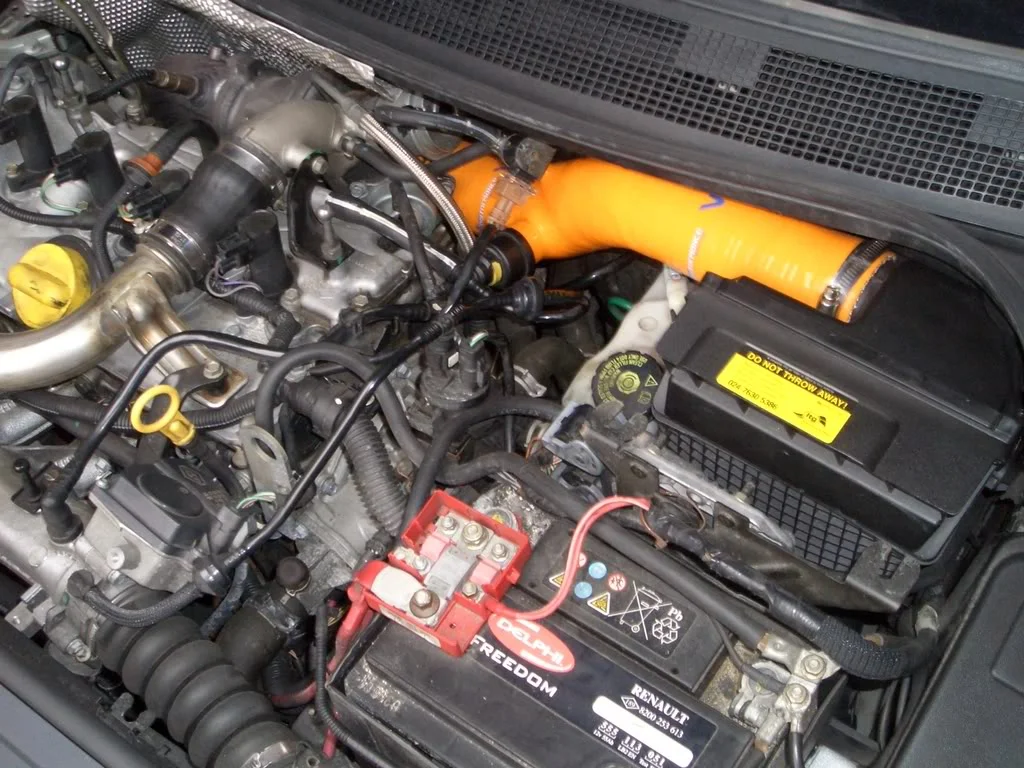

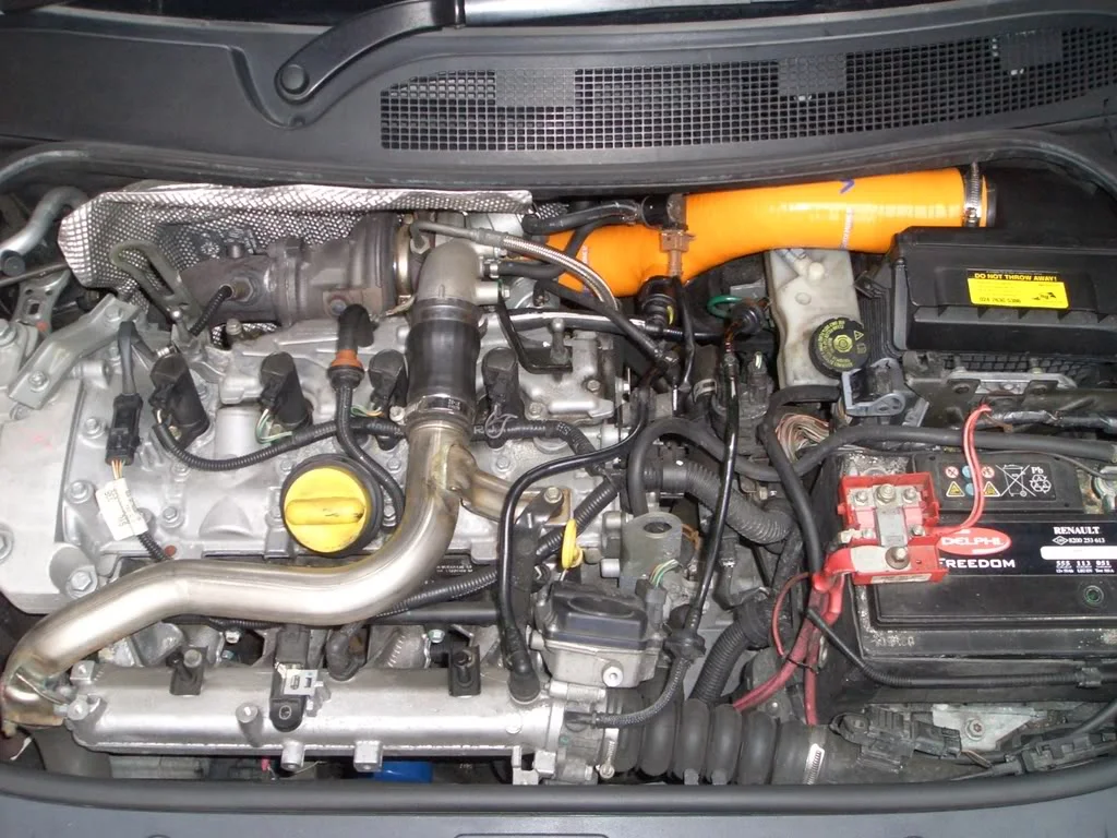

Today I fitted the hose that Viper Performance have created for the megane. The company had the hose created, modelled and tested, then sent to me. the time taken was a full MONTH quicker than originally quoted! A result i'm more than happy with below are some pictures of the pipe and how it sits in the meganes enginebay.
I have kept the engine cover off as i feel it shows the pipe better.
the pipe and work was carried out by myself and sy16v today, it can be done by one person realistically and should take around 45 mins/1 hour.

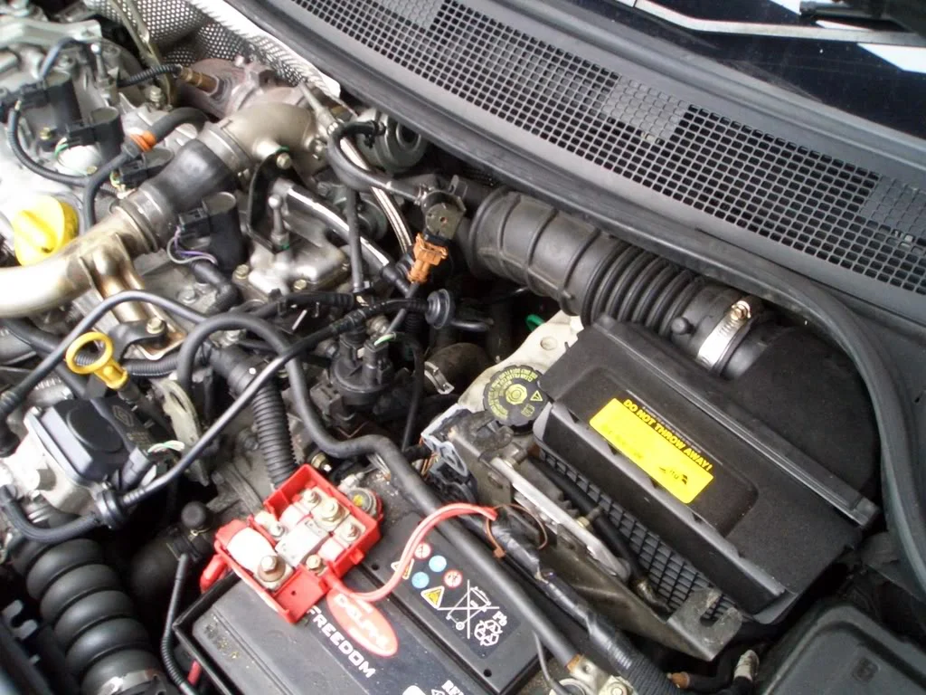

original
the job can only realistically be done when the engine bay, especially the turbo is cool (as one end joins to the turbo and this gets stupidly hot!!!) the hardest part is taking the old pipe off to be honest, bit of a nightmare but a stubby screwdriver and a few cuts sorts it. the good thing is that the original clasps can be kept and that they can be used as direct replacements, the two pipes fit back in with minimal fuss too
The pipe is obviously stronger and lighter than the renault OEM pipe, it also has a wire insert and 5 ply which makes it considerabily stronger than any other pipe offered on the market.
The airbox to turbo pipe increases induction noise considerably, 20% i would say, its not that easy to determine on my car with the exhaust but induction is considerably louder and sharper.

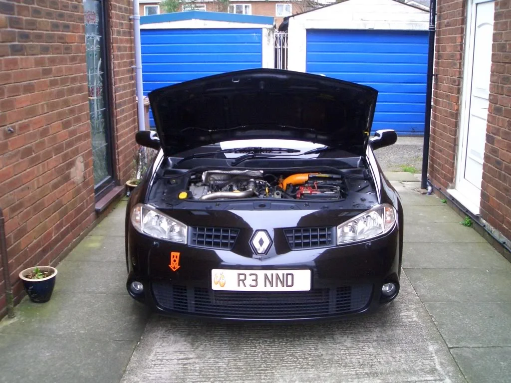

nicceeee naith...very nice. the car looks cleanish from that front picture!?!
cheers guys, tis an ugly bay thats for sure! im getting all the yellow bits done orange and some black bits too, the metal bits i'll try n polish up the best i can for spring/summer
