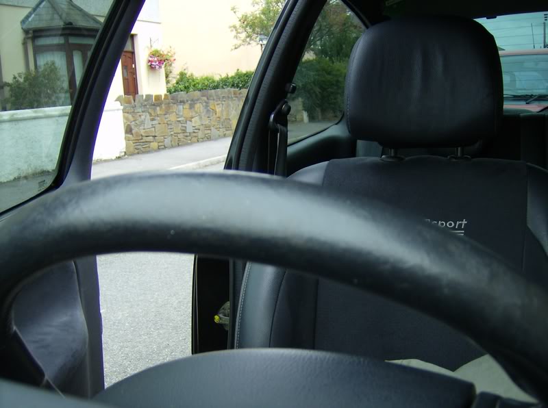

My 182 (04 REG) with 52,000 has a steering wheel which looks like this:
Am I just lucky or can I expect this happening to me soon?

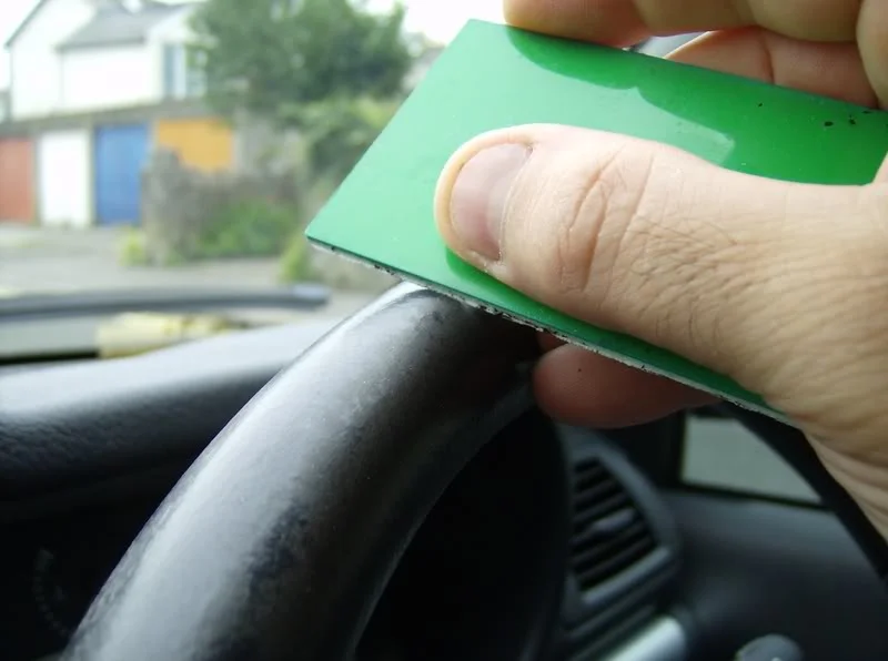

My fix

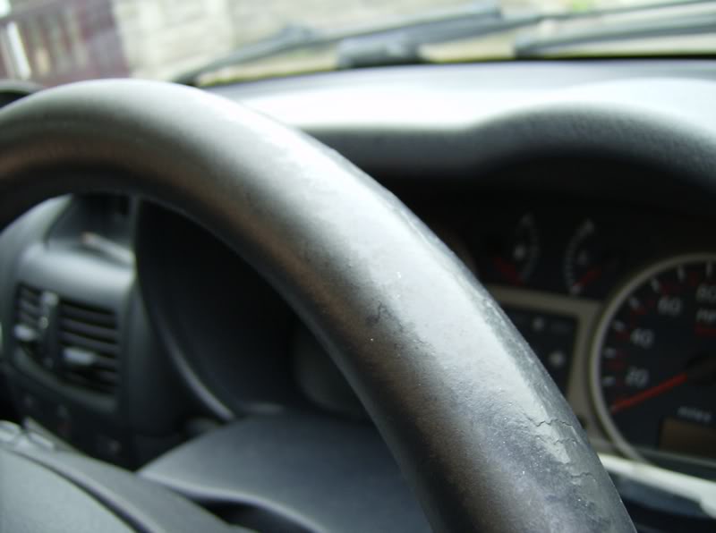

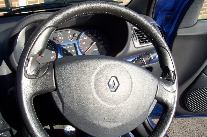

Mine was nearly as bad as the MarkCup wheel in the first pics.
I dont have any before pics.
It was certainly well melted by 20K

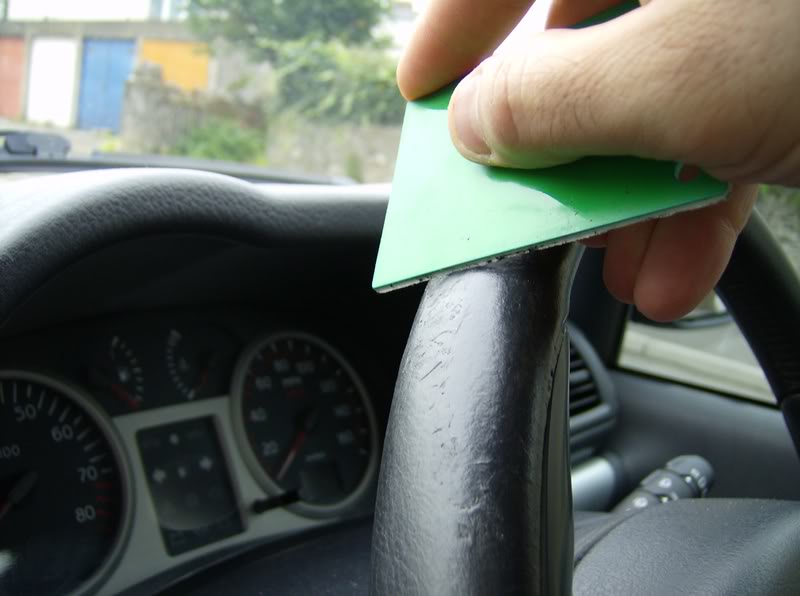

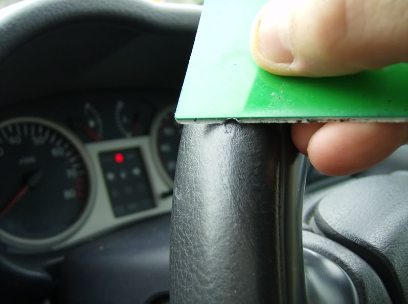

I used a piece of plastic - a credit card should do & just scraped the melty bits off the wheel - i've tried to shoe the technique in the pics - its not perfect but its so much better
just kept scraping & scraping - real smooth now

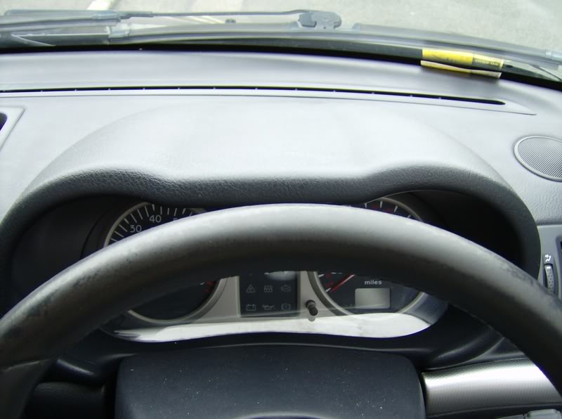

That's tidy for 52k
