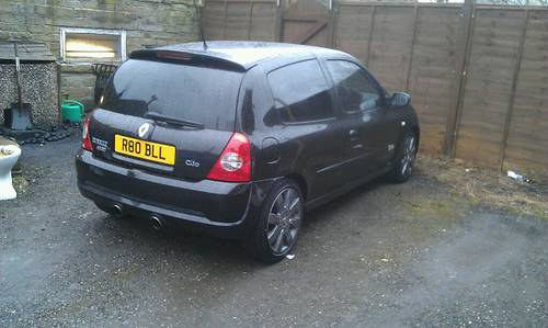

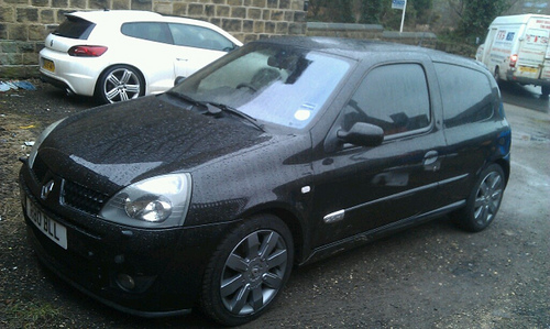

My job takes me all over the world for long periods of time and I couldnt see the sense in having a car on finance sitting on the drive for months on end. I got rid of it and whilst searching the for sale section spotted a 2004 BG 182, cup spoiler and suspension packs, well documented service history and only 42,000 miles on the colck. It had a ktec exhaust and window tints but apart from that it was standard. The plan for the car was to put me on for a couple of years until I bought a place with a garage and then turn it into a dedicated track car. But I would collect parts for the build over the next couple of years ready to be installed when I get my garage. But that was never going to happen!
When picked her up from Rob

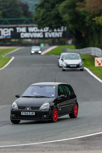

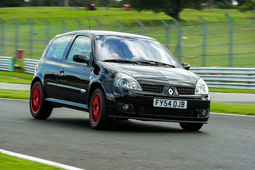

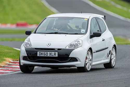

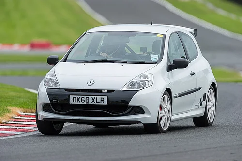

I did my first trackday in it at Oulton Park at this years RS day. I wanted to set a couple of laps and see what I was capable of with the standard car and then put my track wheels on with AO48's and see how it went with them.

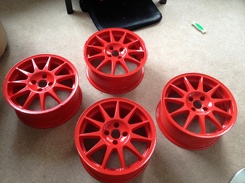

Track wheels when they came back from the coaters
On track with standard wheels
Then on wen the Yoko's
A few area I needed to work on were the brakes which went spongey after a couple of session, the suspension that had too much roll and I could of done with a little extra power.

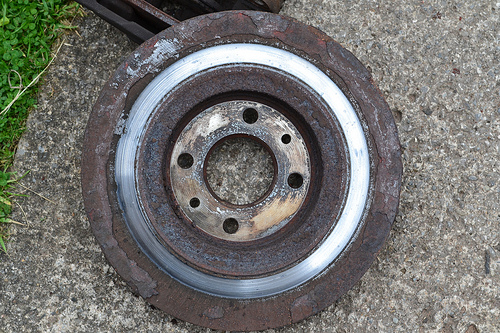

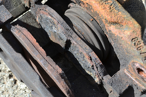

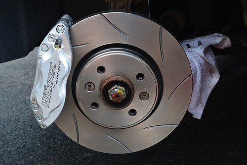

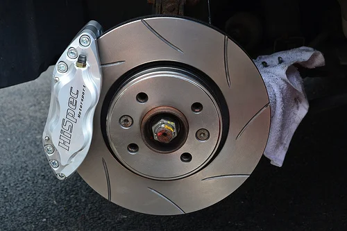

First thing I did was to sort the brakes out as after Oulton, the car was making funny noises from the brakes. Upon removal of the brakes, I was presented with this!
So then on went the new brake settup
That is where to car is at the moment but I do have a few parts that will be on in time for my next trackday!

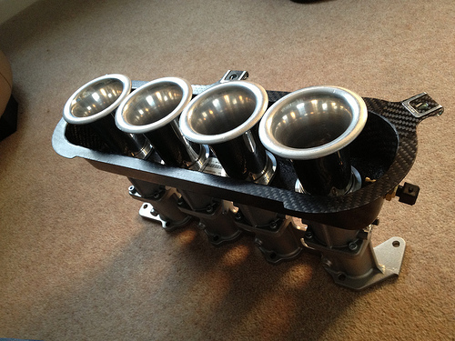

Have the car booked in to fit the Jenveys the week after next. As you can see from the wheels, I have gone for a black and red theme for the car.

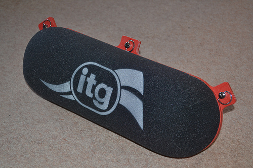

ITG domed filter

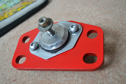

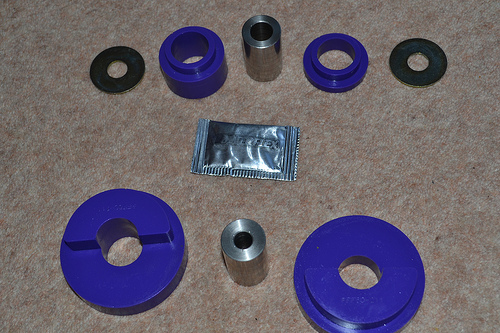

Vibratechnics engine mount

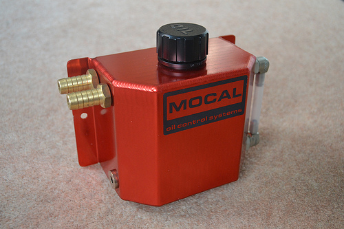

Mocal oil catch tank

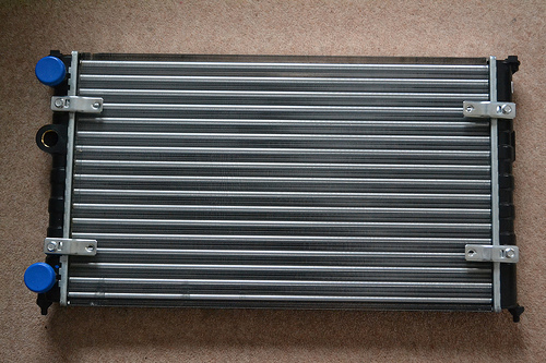

VW Polo rad and slimline fan

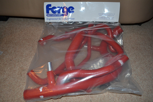

Forge motorsport silicone hoses

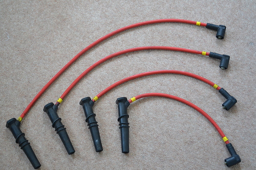

8.5mm Magnecor leads

Who fitting the itbs dude.. You should of give us a call I'm sure we could of got them fitted and balanced. What ecu are you running? Did you get a gen90 in the end.
  182 cup
Thanks chaps.
its booked in with ktec next week for them to supply and fit the Gen90. Thought it would be better to let them map it as its their ecu

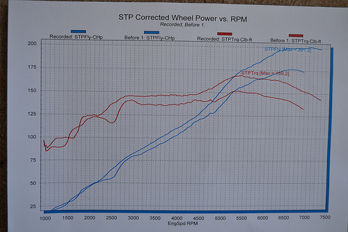

Had the car Dyno'd at Ktec and it made 177bhp. Then the install began....

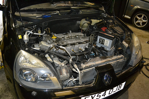

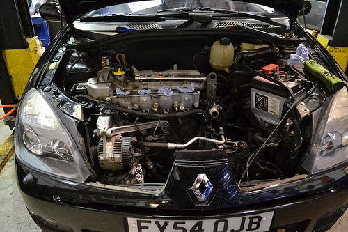

Firstly, the upper inlet and slam panel were removed
Air Con system and radiator removed

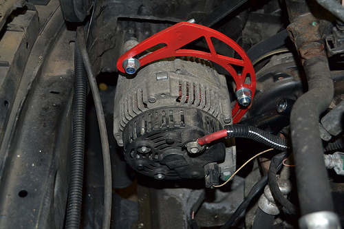

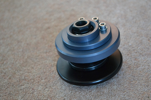

Pure Motorsport AC delete kit fitted with the longer 1310 belt

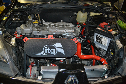

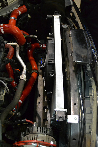

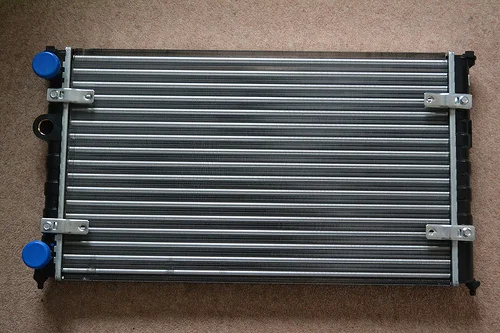

Polo rad and slimline fan fitted. Bracketry made to mount rad to cross member and new hoses on

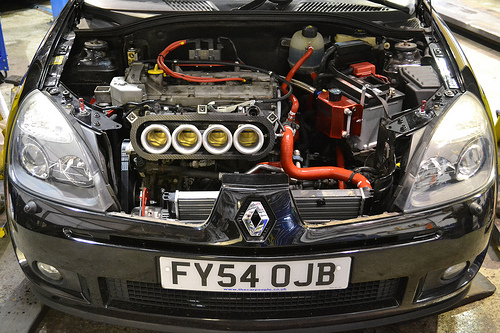

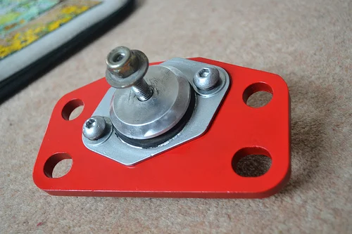

Bodies and filter on. Engine mount on too

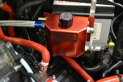

Catch tank mounted to brace bar. The horizontal bracket was mounted to the vertical stay (behind the braided hose)

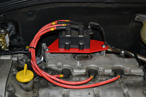

Coil pack mount and leads

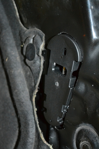

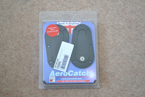

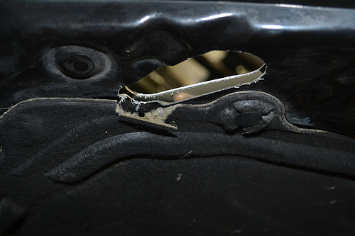

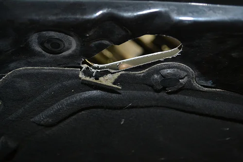

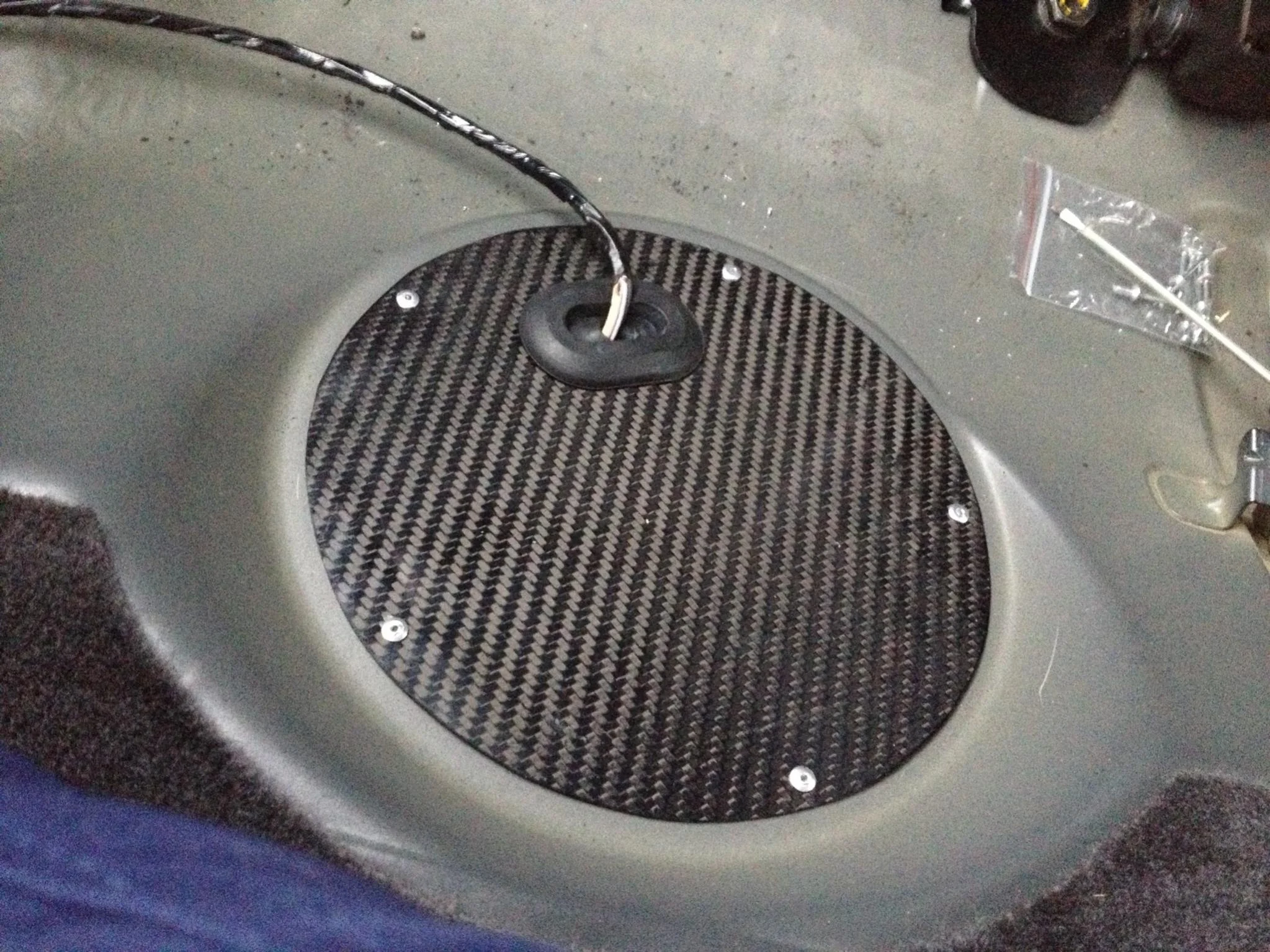

Cut outs for new style aero catches
Hidden anchor nuts and spreader plate

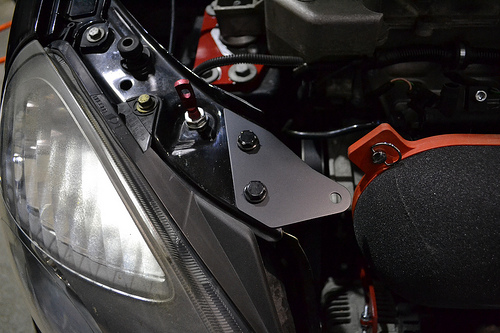

Plates to attatch front grill to
Finished with filter removed after balancing
Final power run 201bhp! Very happy with the 24bhp increase

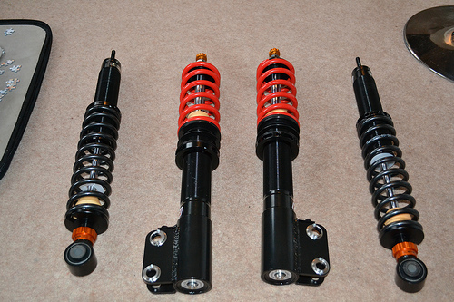

Sportlines are now on and completely transformed the car. Will be looking forward to playing around with settings on track
