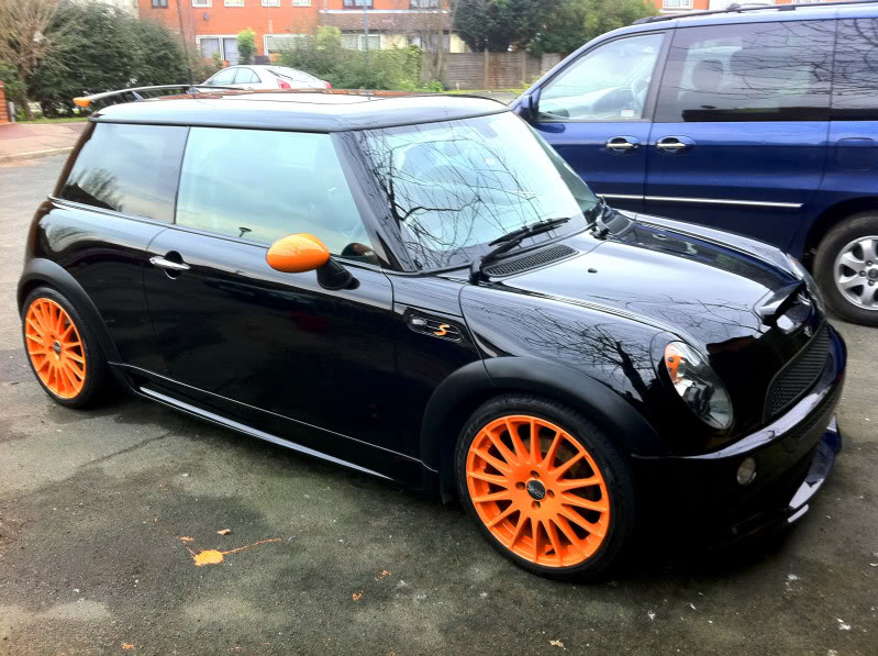

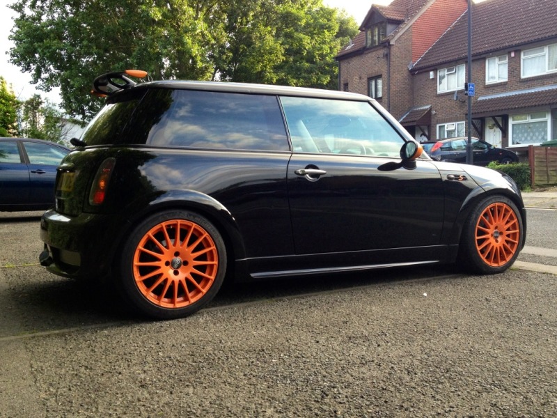

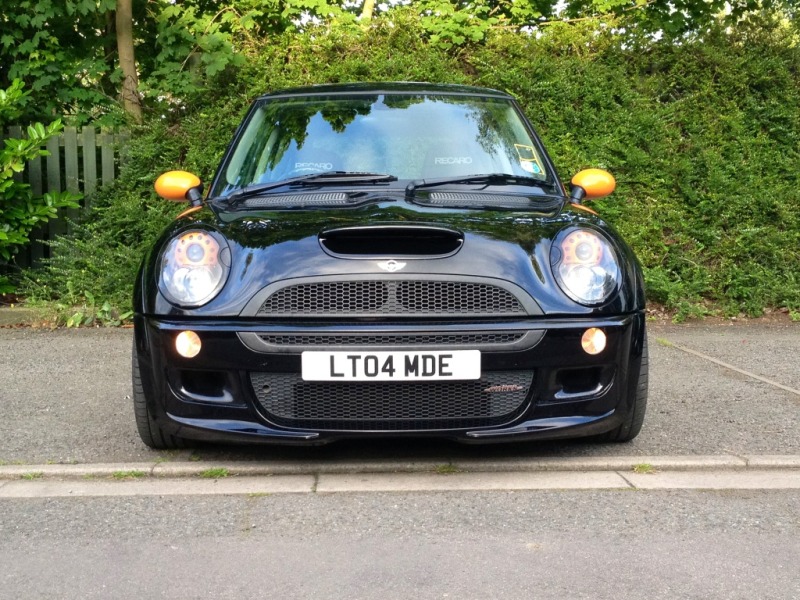

Haven't posted on here in ages but thought I would share some details of my car. Used to have a 182 which I loved immensely but it was stuffed in the rear. My goal was to make this handle better than my 182 and to be fair it has taken a while to get there. The balance through the corners now is immense and turn in unreal. There are still some final tweaks to go but more just for fine tuning the overall balance.
Engine work is on the list, but not an absolute priority. The car is so much fun to drive as it is now and the thing that I best like when compared to my clio is that even though it will be 8 years old next year, it still feels and drives like new!
Spec- stock 210 JCW
KW V1
Eibach 25.4mm front bar 19mm rear bar
New ball joints
Poly wishbone, arb, engine mount, rear arb & rear trail arm bushes

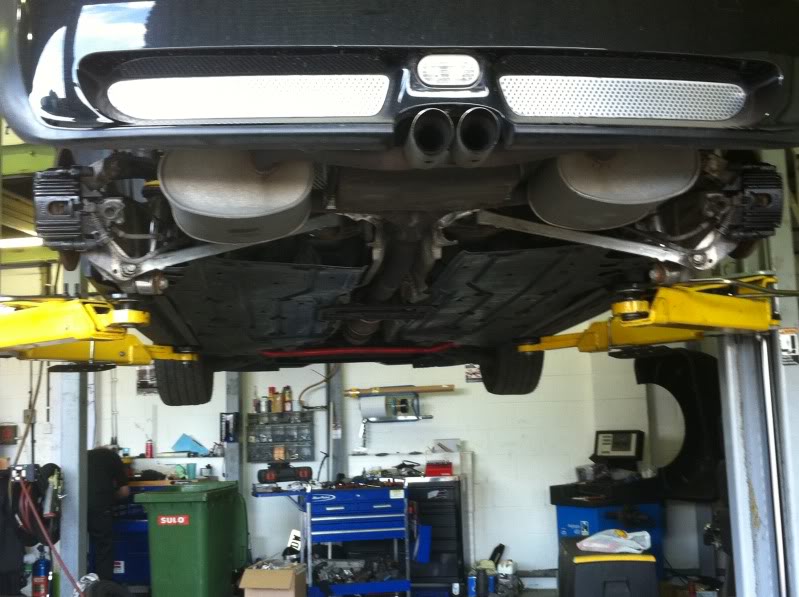

Works GP rear alloy trail arms
Michelin PE2
OZ Super T (not the lightest but designed for the pot holes etc so they dont
Bend)

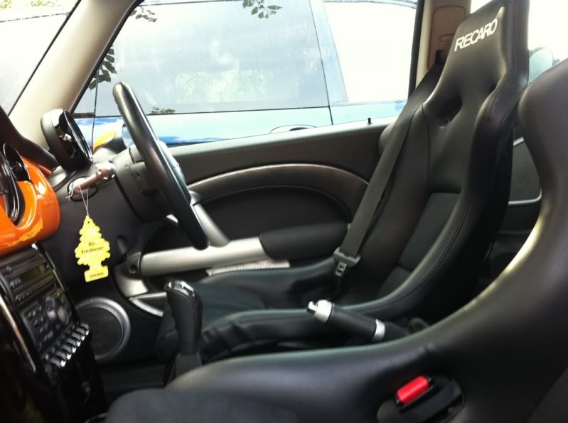

Recaro lightweight seats
Works GP flat undertrays
JCW Roof Spolier
Plans are, adjustable roll bar links, roll centre spacers, lightweight 2 piece BBK.
Some pics

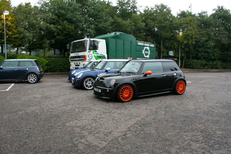

Love that mate. The orange cheapens it though IMO.
Fairplay mate, to be honest its just a bit of fun, I think cars on the road nowadays need it. Too many boring barges floating about and I think the mini just about gets away with it :p
Also with the addition of key parts and the removal of others, there is approx 50kg weight saving.

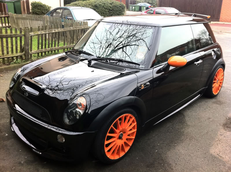

Well when I got this car it had 18" wheels, run flats, heavy sparco seats (think you have the same ones in your FRP) trimmed in leather.
The wheels only saved around 2kg per corner over the JCW GP set up (mine had JCW wheels from new), but this was noticeable in itself. However the heavy alloys had totally ruined the wishbone bushes and ball joints. I didnt know this and just thought the car was s**t as standard lol. It had 40k on the clock when I picked it up.
Through much reading and picking up bargains, it is so sweet now it is unreal. Left right transitions, sweeping bends with ruts etc... it just takes it all in its stride. Losing the back seats and sticking in the poles made a massive difference. these seats weigh like 7kg each compared to the stock which are 25kg or so a side.
The rear arms however... WOW... believe people when they talk about losing unsprung weight. The whole front and rear feels to work in tandem together now. before there was a slight disconnect. This is why the JCW GP must get rated so highly. However I wanted my specification, so I have the harmon kardon, body kit that wont scrape when lowered, panoramic roof, xenons, climate control etc... all this you wont find in a GP.
The GP has better mapping and a larger IC, but this can be added easily. I love them all, but you know how it is when you want something done for to your own spec.

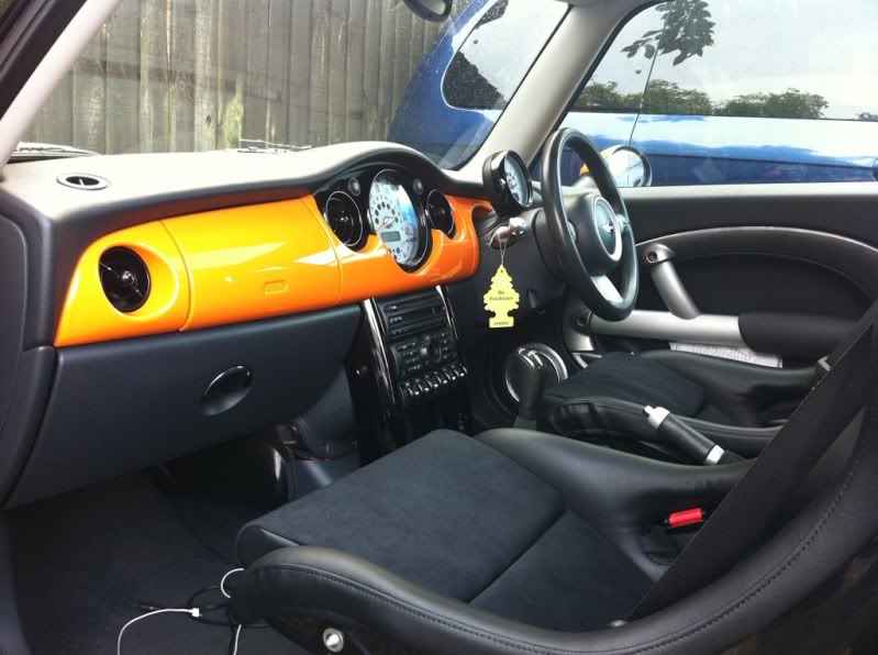

Really like this bar the orange dash. Other than that I love it!!

Not a fan of crazy coloured wheels but it works well on the mini. I would CC the arches and ditch the silver inserts in the rear bumper and be pretty much happy with the exterior :)

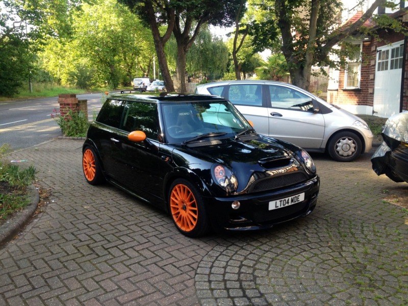

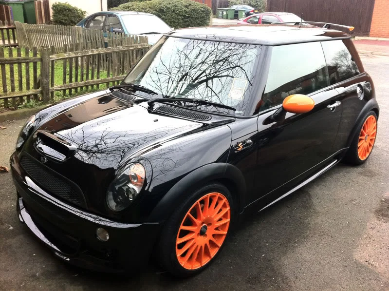

Haven't updated this in a while.
I managed to get the car colour coded to finish the exterior (still need to do the rear bumper inserts). New bonnet scoop that works a lot better than the bbr on there previously. Intercooler is always cold and car more responsive. Camber plates, 4-1 equal length manifold, refurbd kw's and lots more I can't remember just now.
Its just stupid on the bends now. My pe2's are coming to the end of their life so may try conti sc 5 next as its newer technology compared to the michelins.
quick sound of the mani with the stock jcw exhaust, best of both worlds. Silent off throttle and rally esq above 4k. Will hopefully get nice pics and vids with a Dslr when the weather is better.
