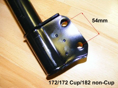

You need to measure the bolt spacing on the front shock absorbers.
Just turn the front wheels and you can get in to measure them. Can't for the life of me remember what this spacing should be though - have a quick search on here.

I think the bolt spacing on the front shocker should be 60mm if you've got cup suspension.
Otherwise you have 54mm.
A little measurement and you're on the safe side.
example with non-cup shocker

As above, get the ruler out and measure the bolt spacing.

If half leather it might have cup packs it might not depending on how it was specced from the dealer to be sure as said measure the hole spacing centre to centre.

Cup or cup packed suspension hubs are 60mm, non cups 54mm.

If your wanting handling then keep it, if it has 54mm spacing coilovers for the non cup model are much easier to be had than the 60mm cup bolt spacing (difference of a choice of about 6-8 kits for the cup to the 20+ kits for the non cup plus much more used item on the cheap!)
