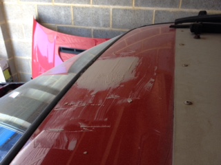

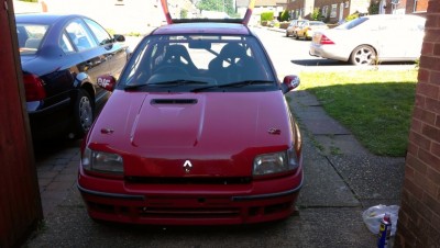

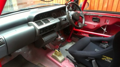

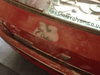

Hi my names Luke and ive had my 16 valver for a year now and progress has been slow but all good things come to those who wait right? maybe! anyway here a few pics to get you started of my project. The shell was in alot worse condition than under first inspection and had a heap of welding done to it, but thats all fixed now, the car is being stripped down and cleaned, painted and modified to suit my needs. Here are some pics showing just some of the bodywork im carrying out at the minute.

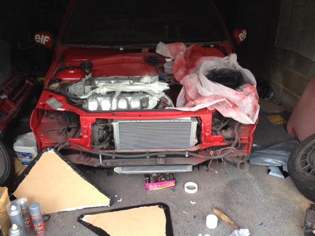

old radiator ripped out and a better new one to go in

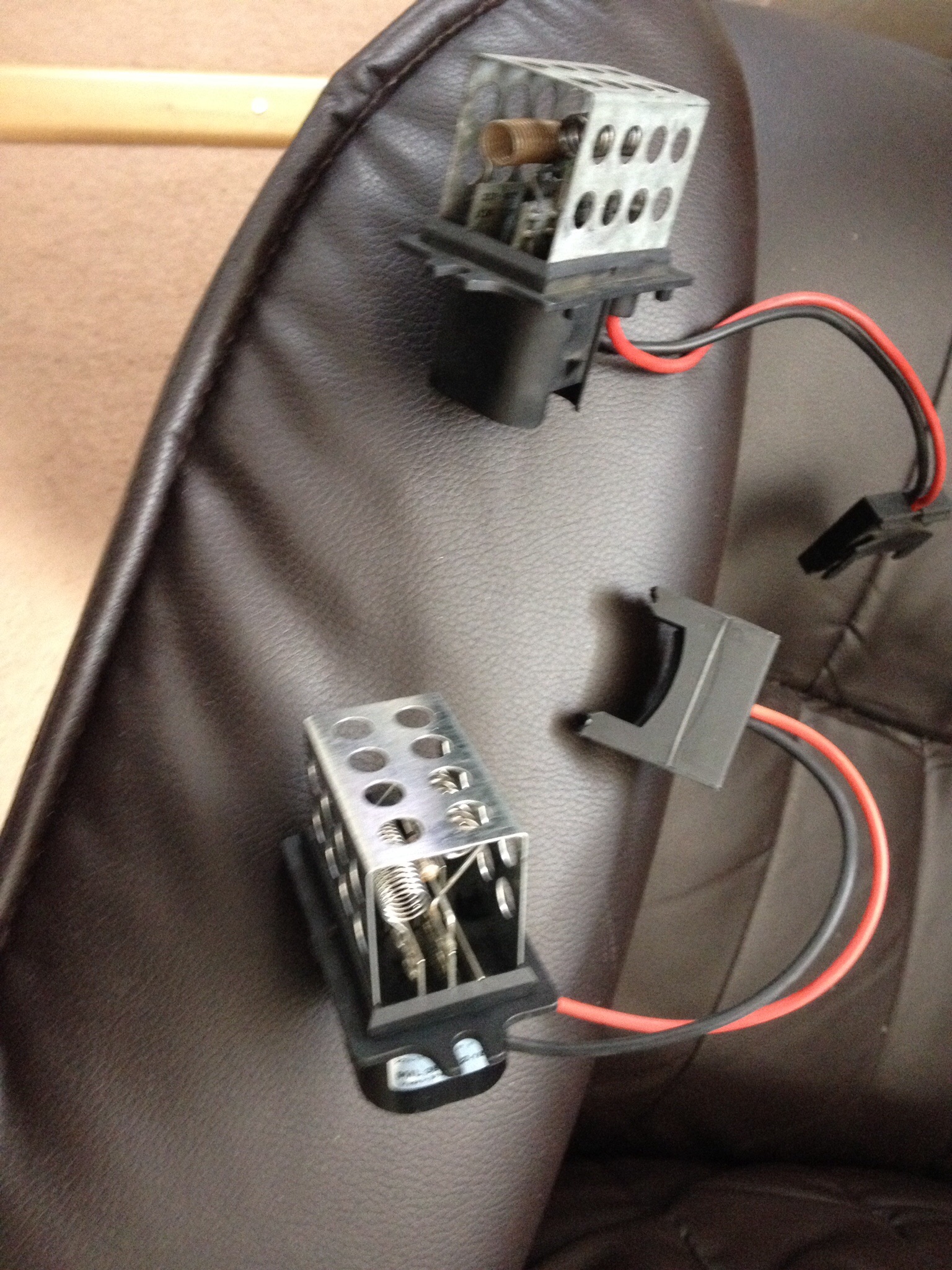

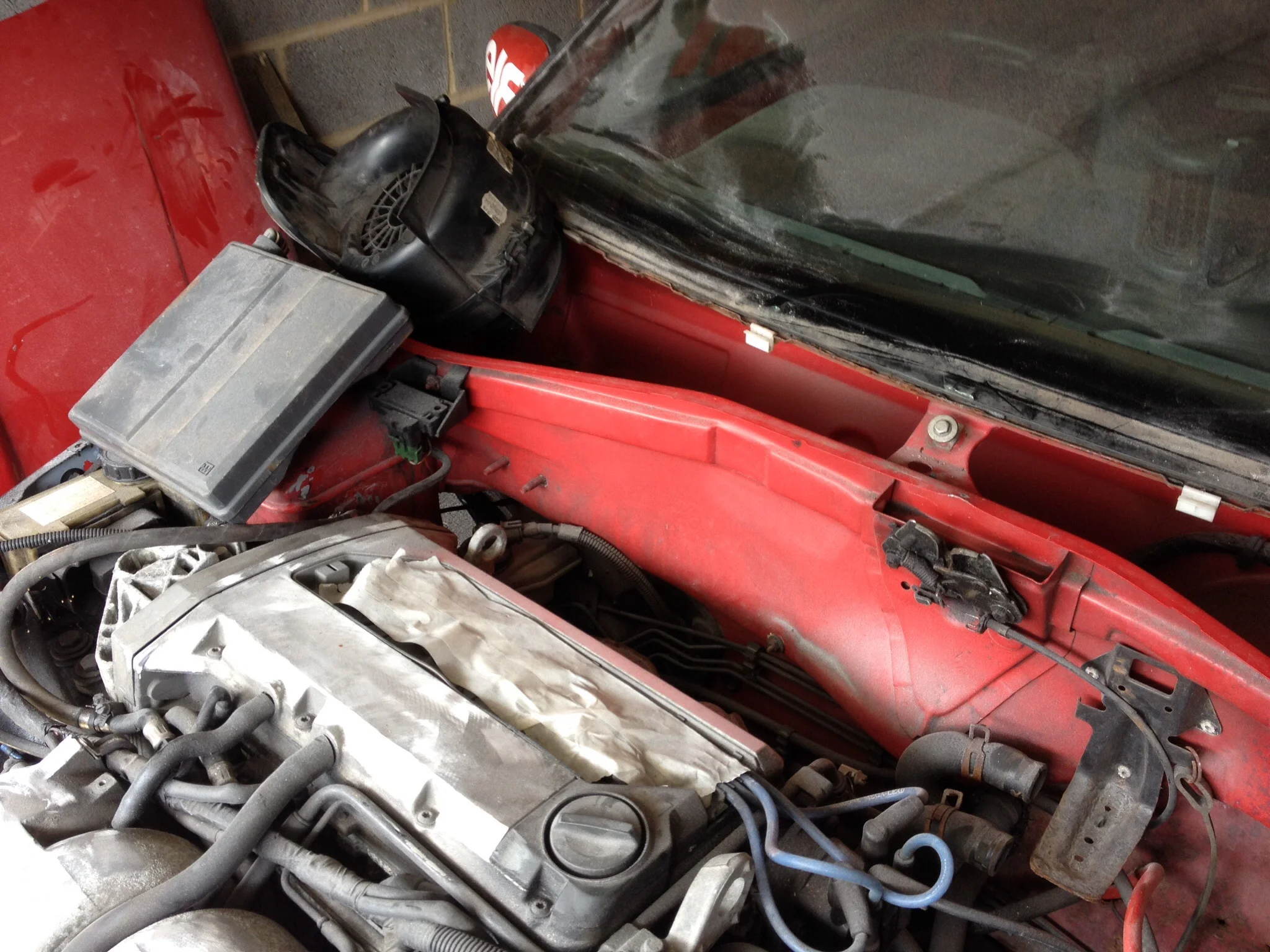

Im after a drivers side scuttle vent, heater blower motor resistor (BEHR version) and grommet on the tailgate for wiring into the cabin, anyone got all this for sale?

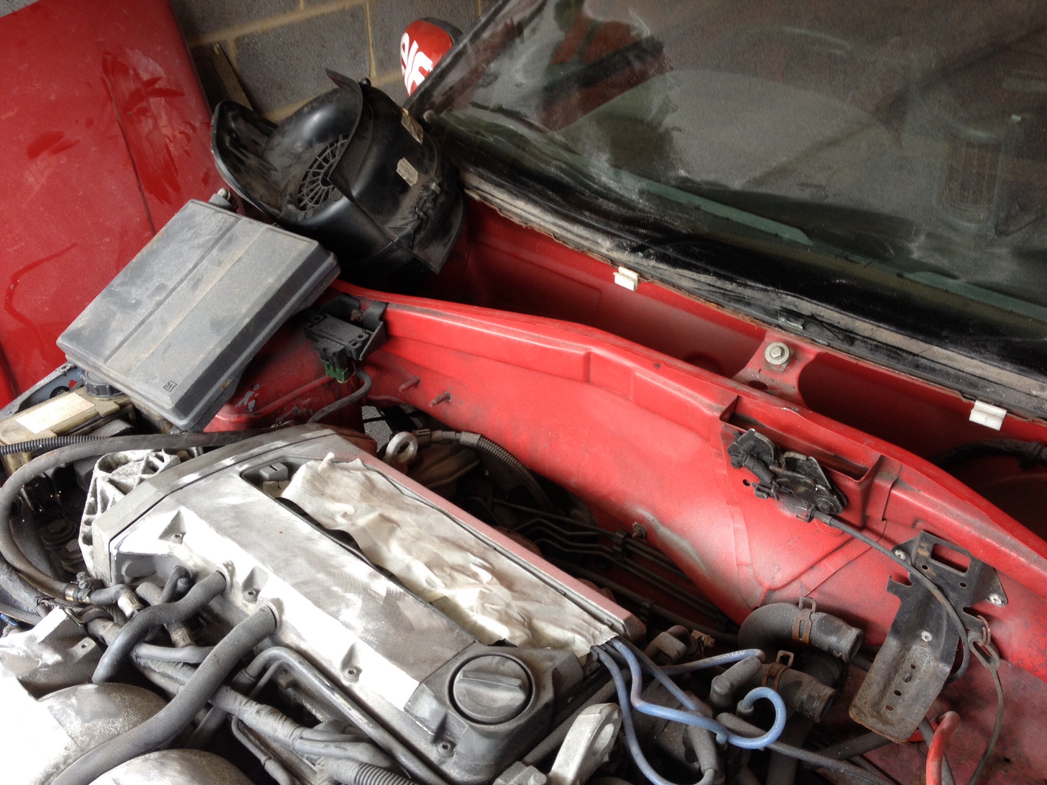

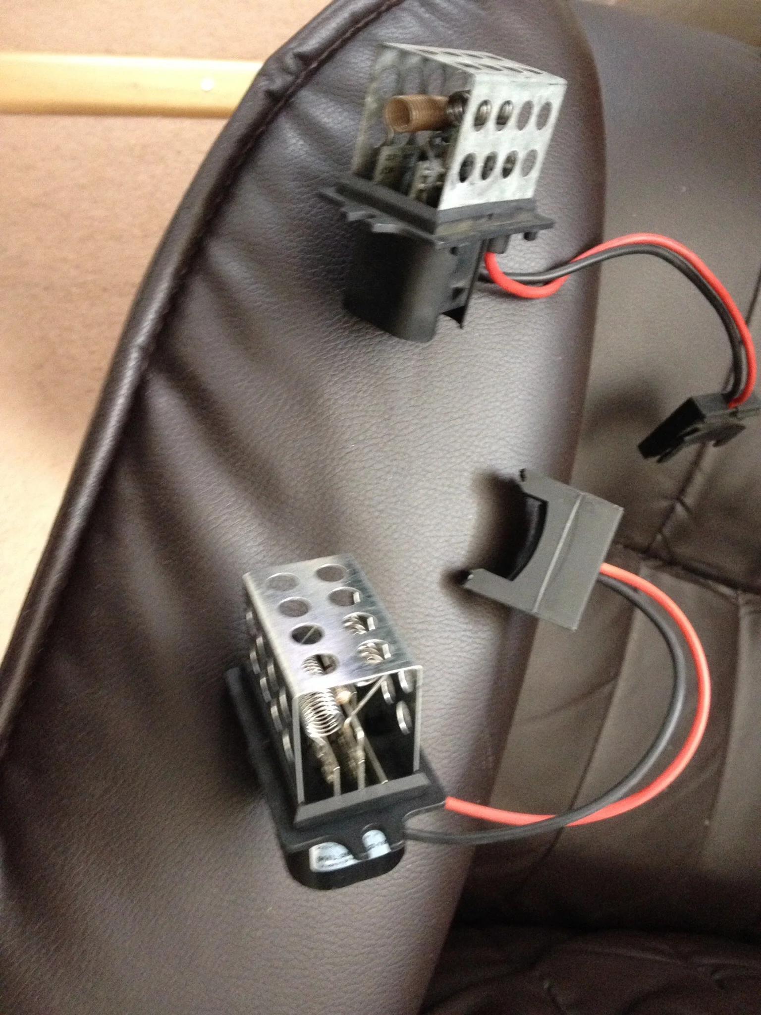

So today I tracked down my new blower motor resistor as it wasn't working at all when I got the car after diagnosing each part to track down the problem we finally found that the fuse box had every fuse in the wrong place and that the heater blower had tried to melt the cables going to the heater panel on the dash.

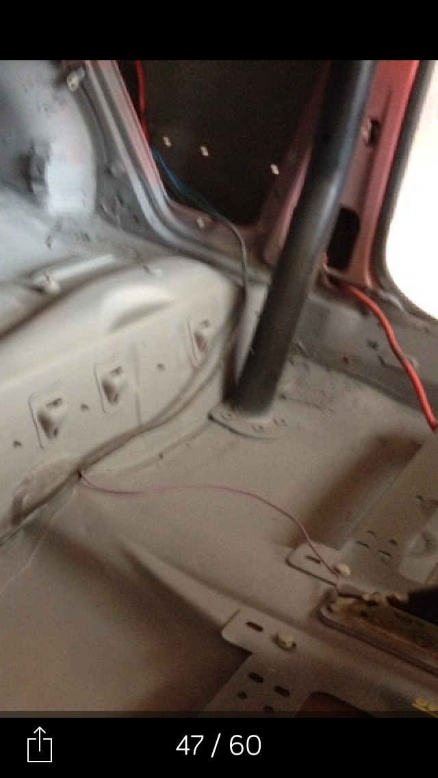

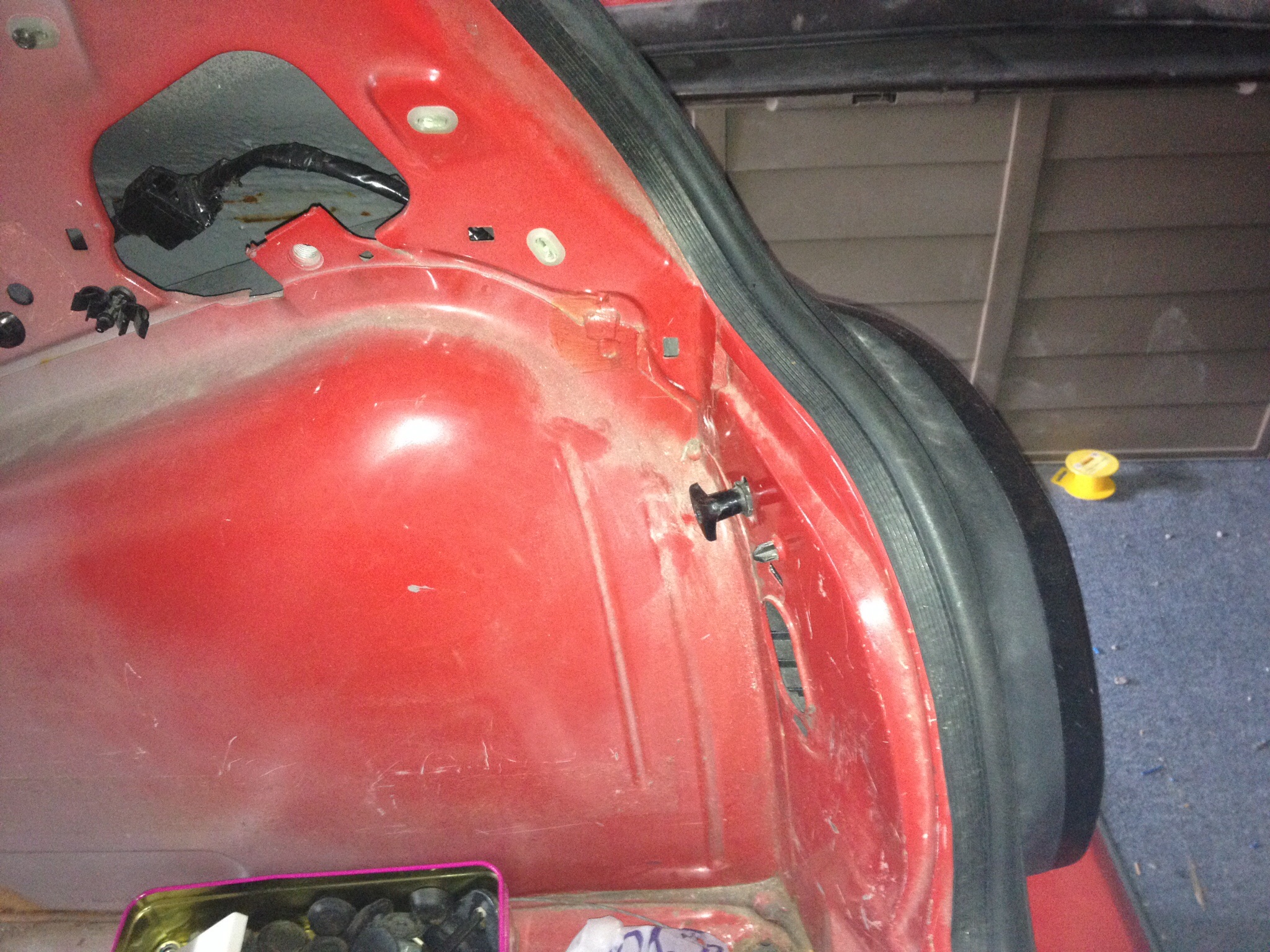

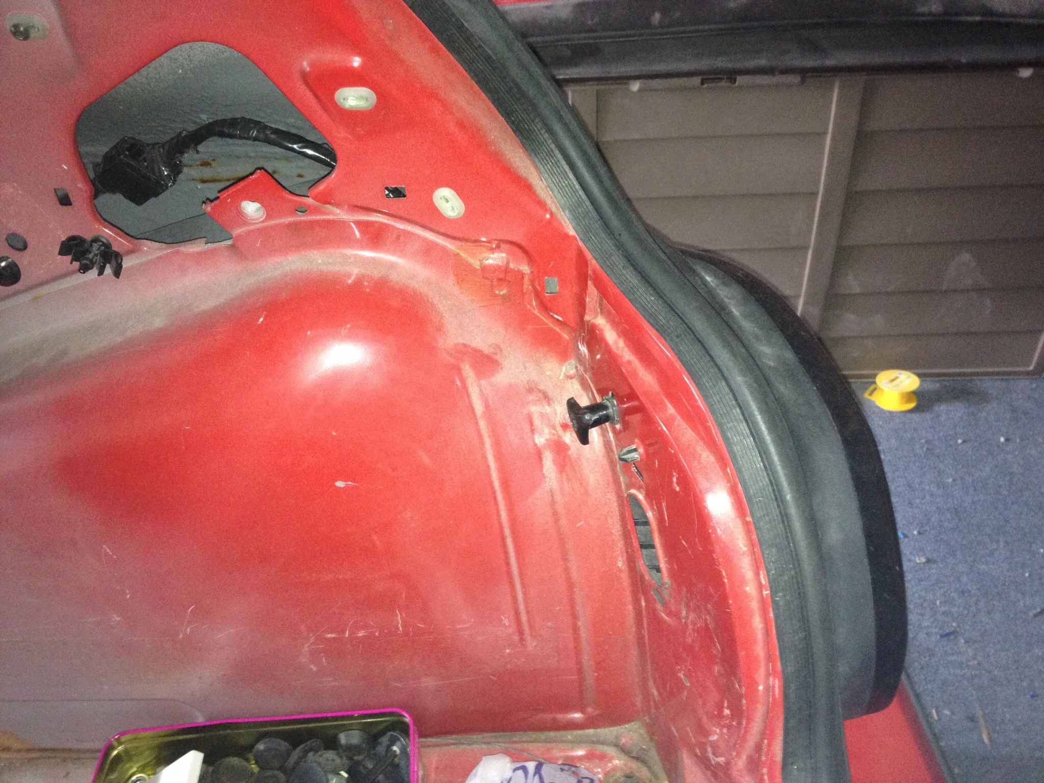

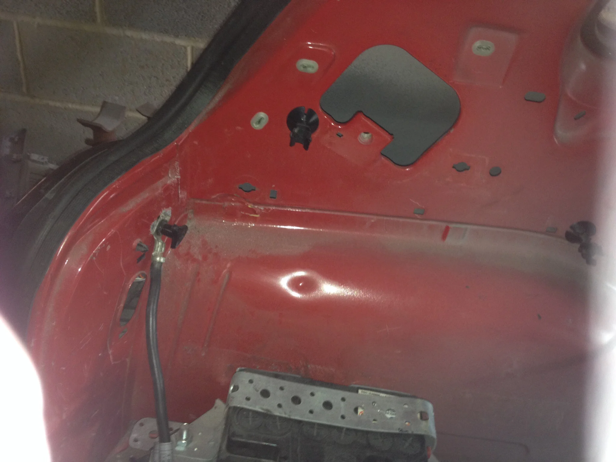

Also the wiring going to the rear lights looked messy and untidy so I relocated the wiring through the quarter panels so they stayed out of sight in the rear of the car.

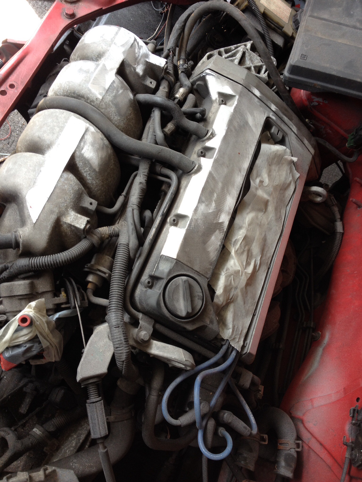

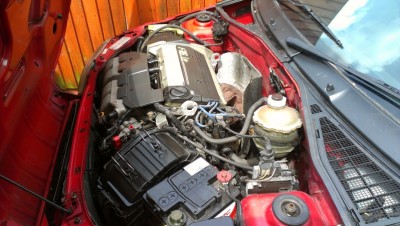

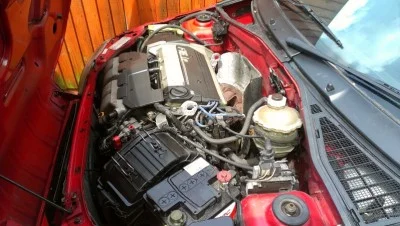

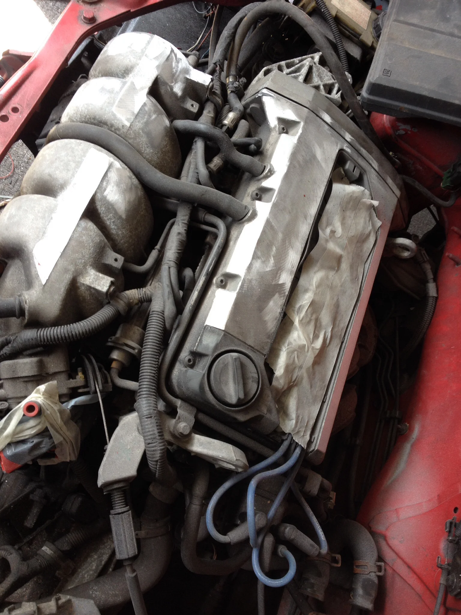

Still working on the bodywork for this which Is taking an age but should be worth it in the end, been working on the inlet manifold and polishing the cam cover with a sanding disc and grinder to get the years of grime off it, will take a while to achieve a nice mirror shine.

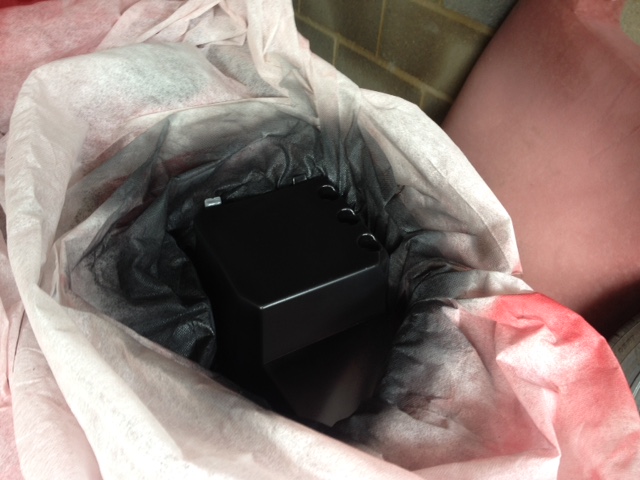

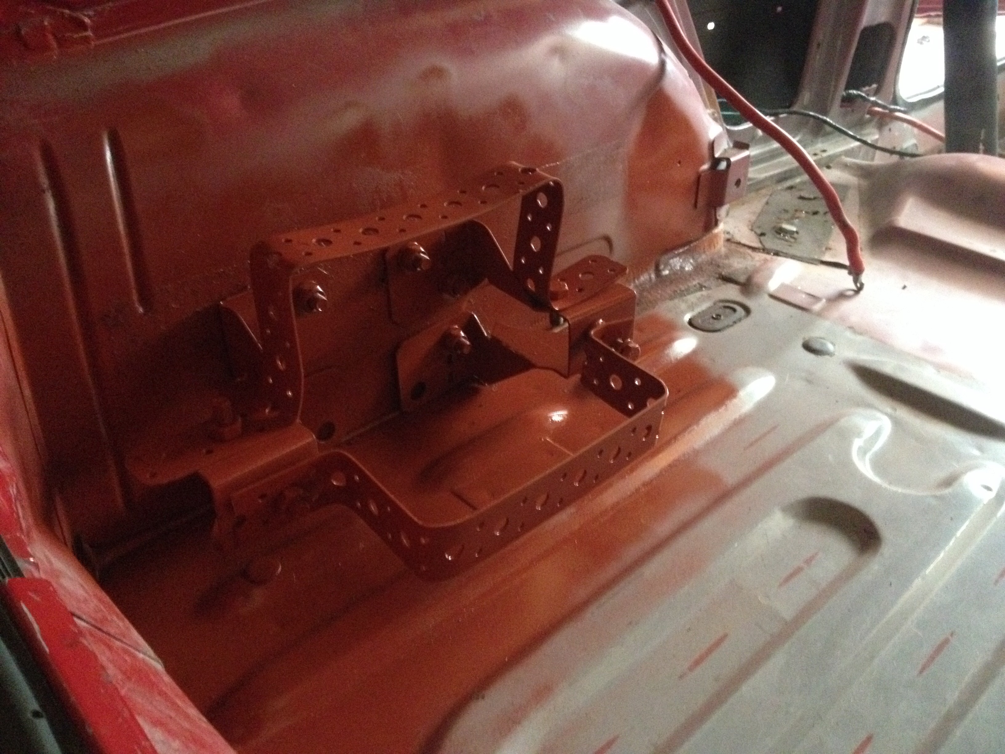

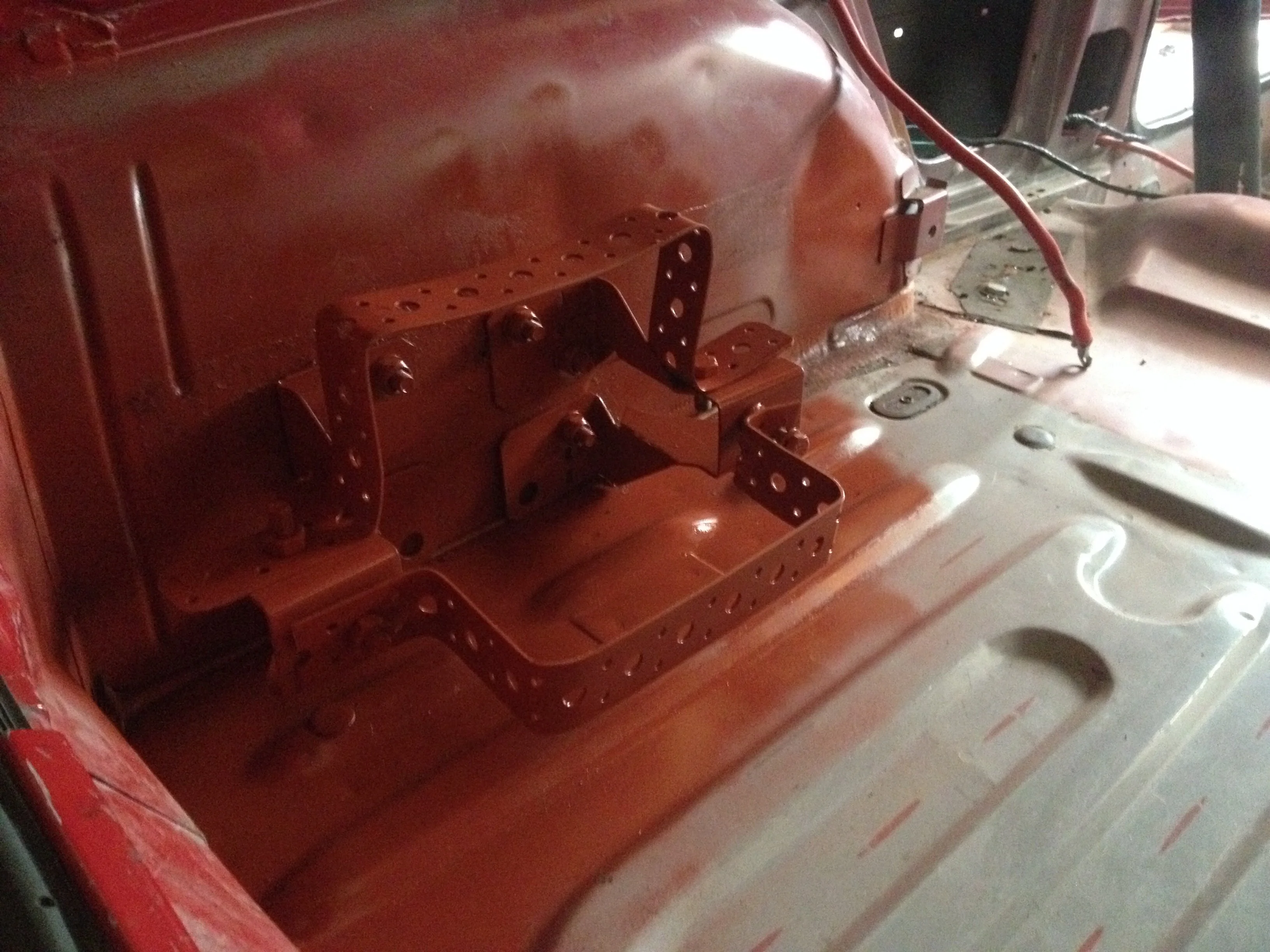

I prepped the battey mount and sprayed it with red oxide primer ready for the full interior respray

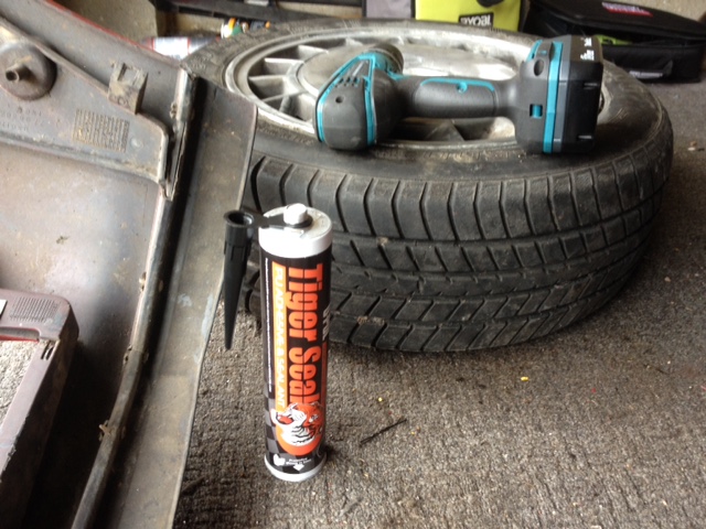

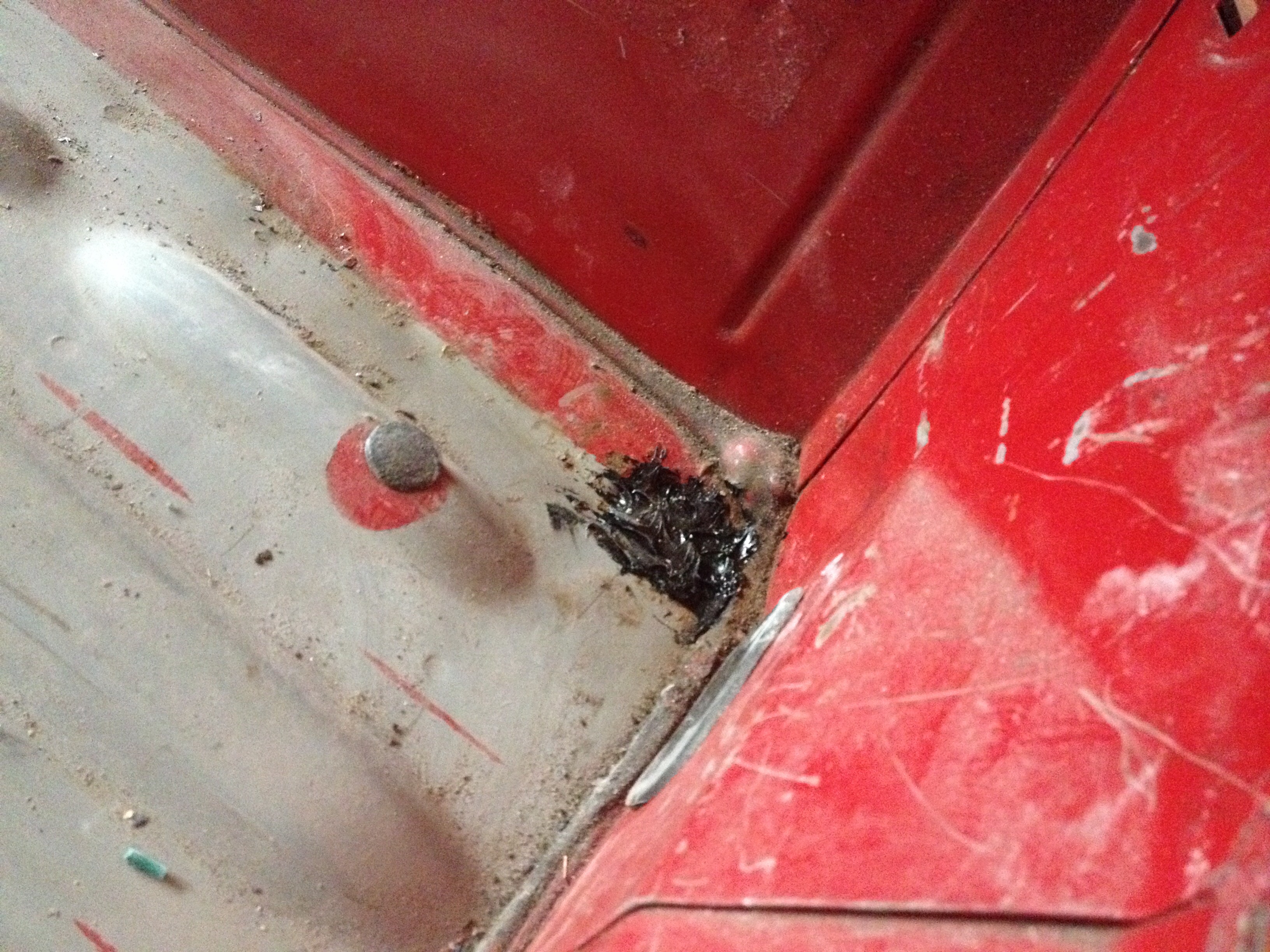

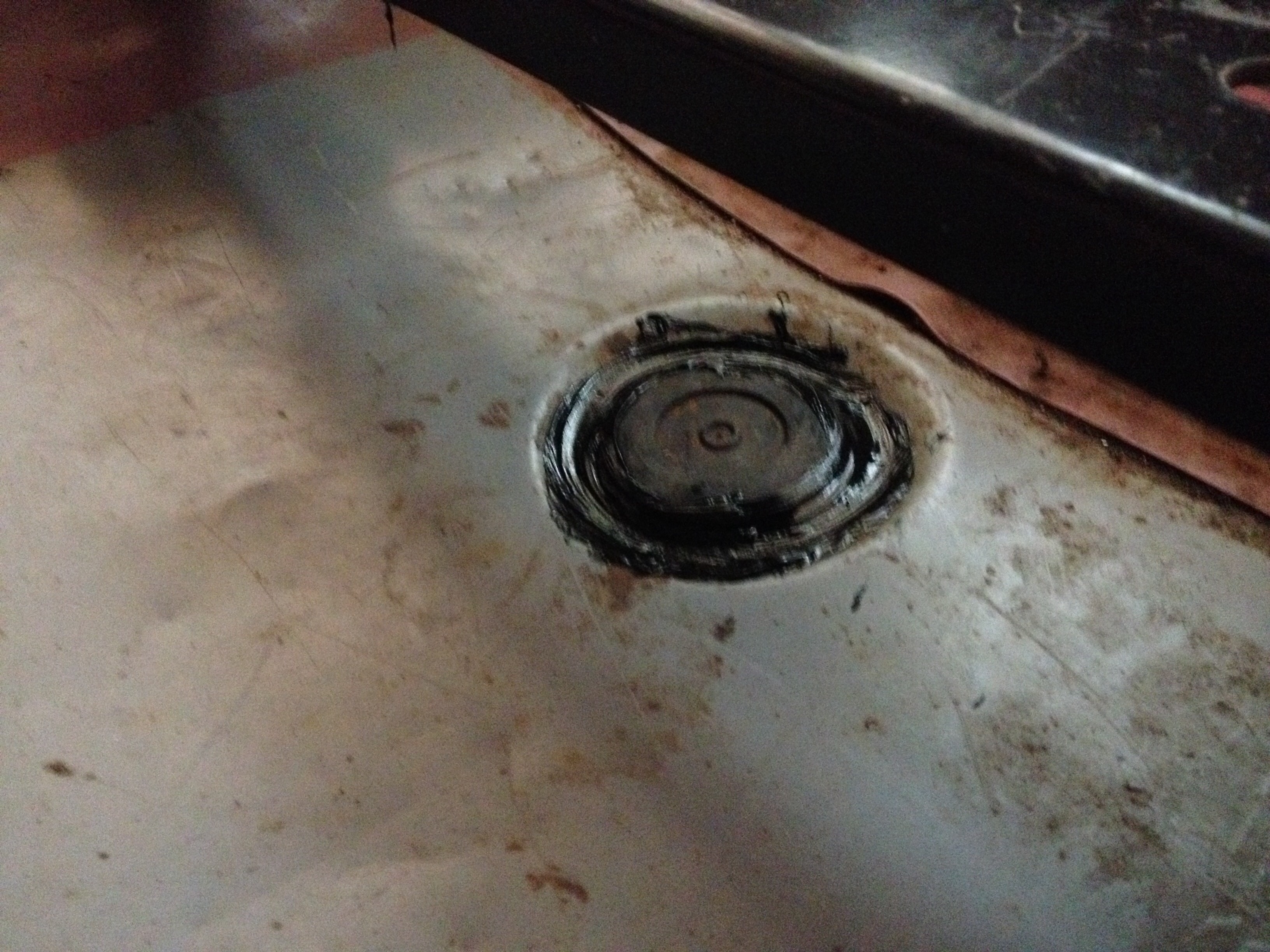

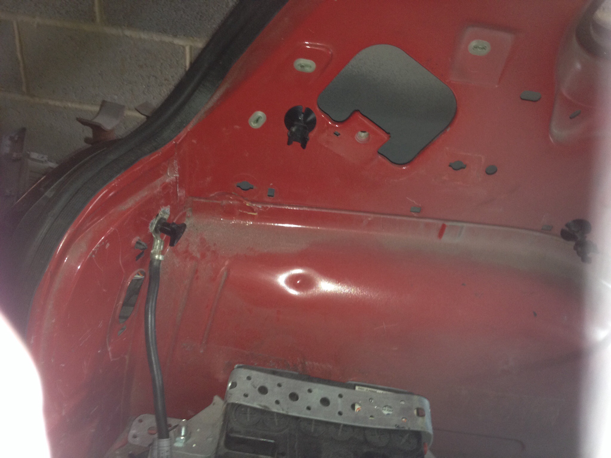

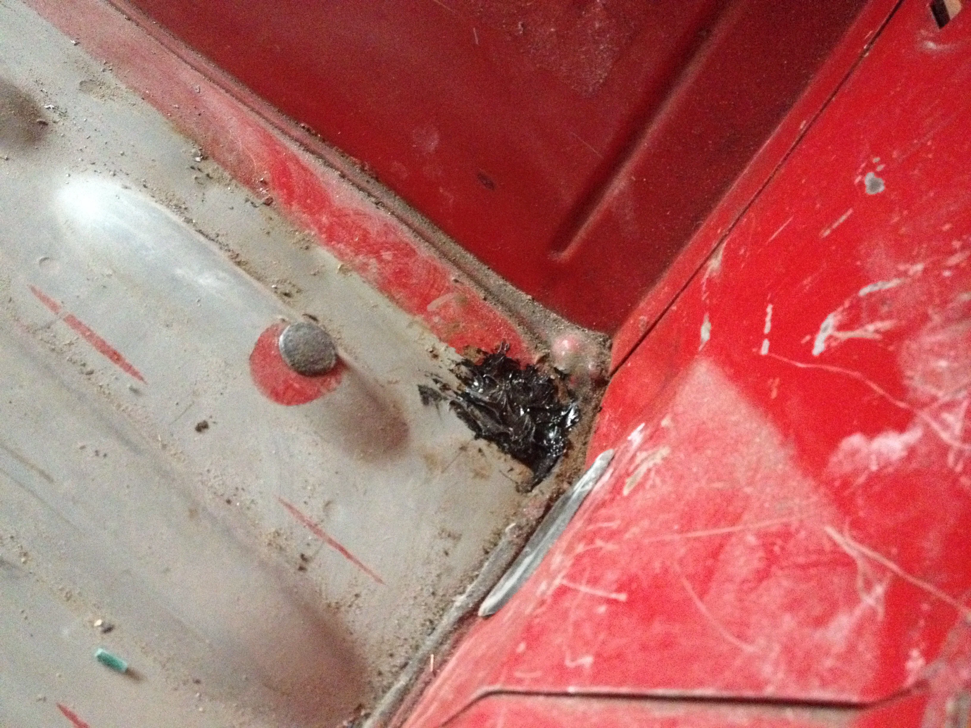

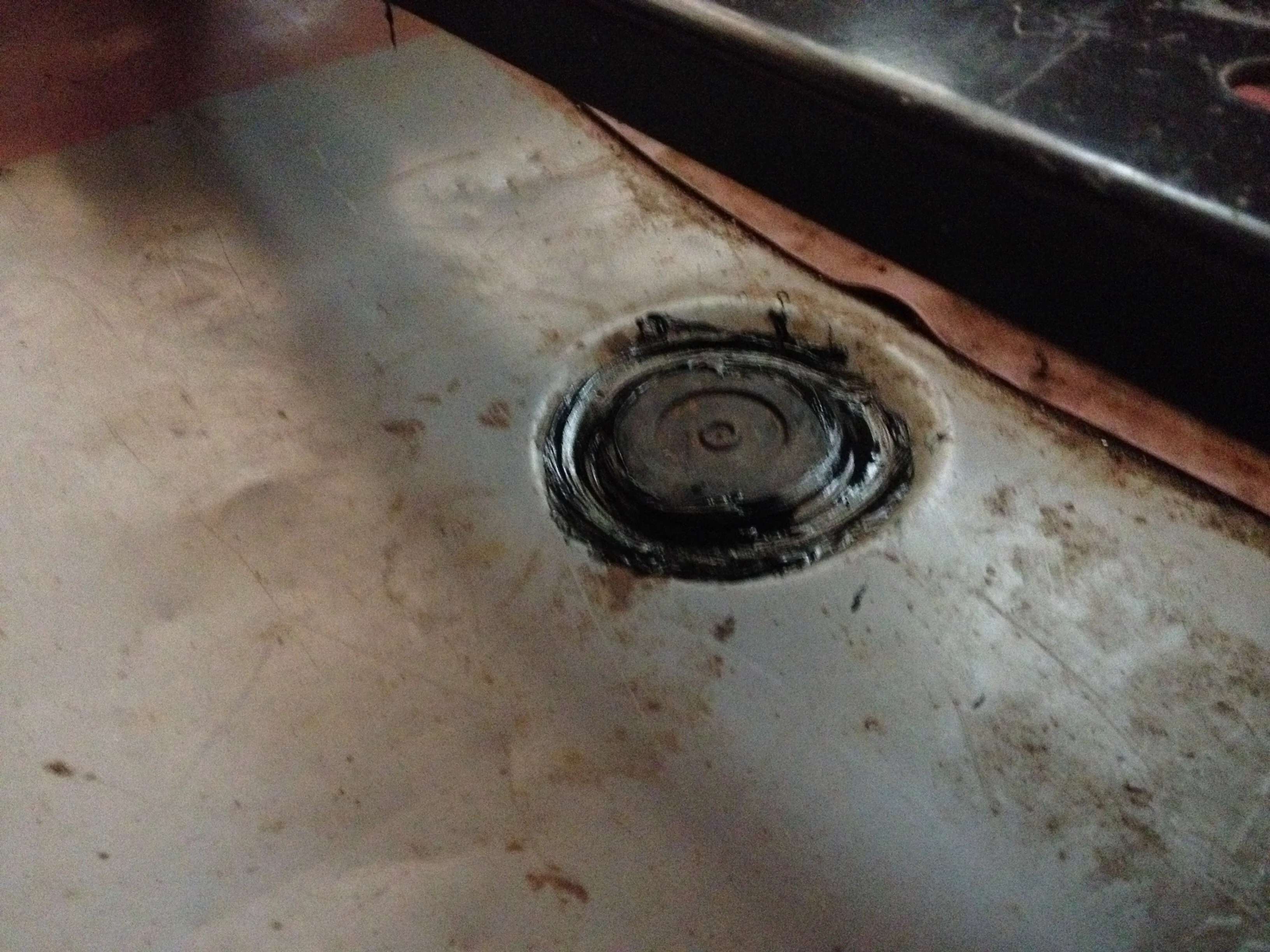

I filled in a small hole I had in the boot floor with aluminium mesh and a blob of tiger seal

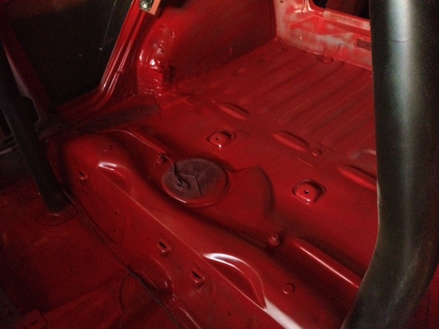

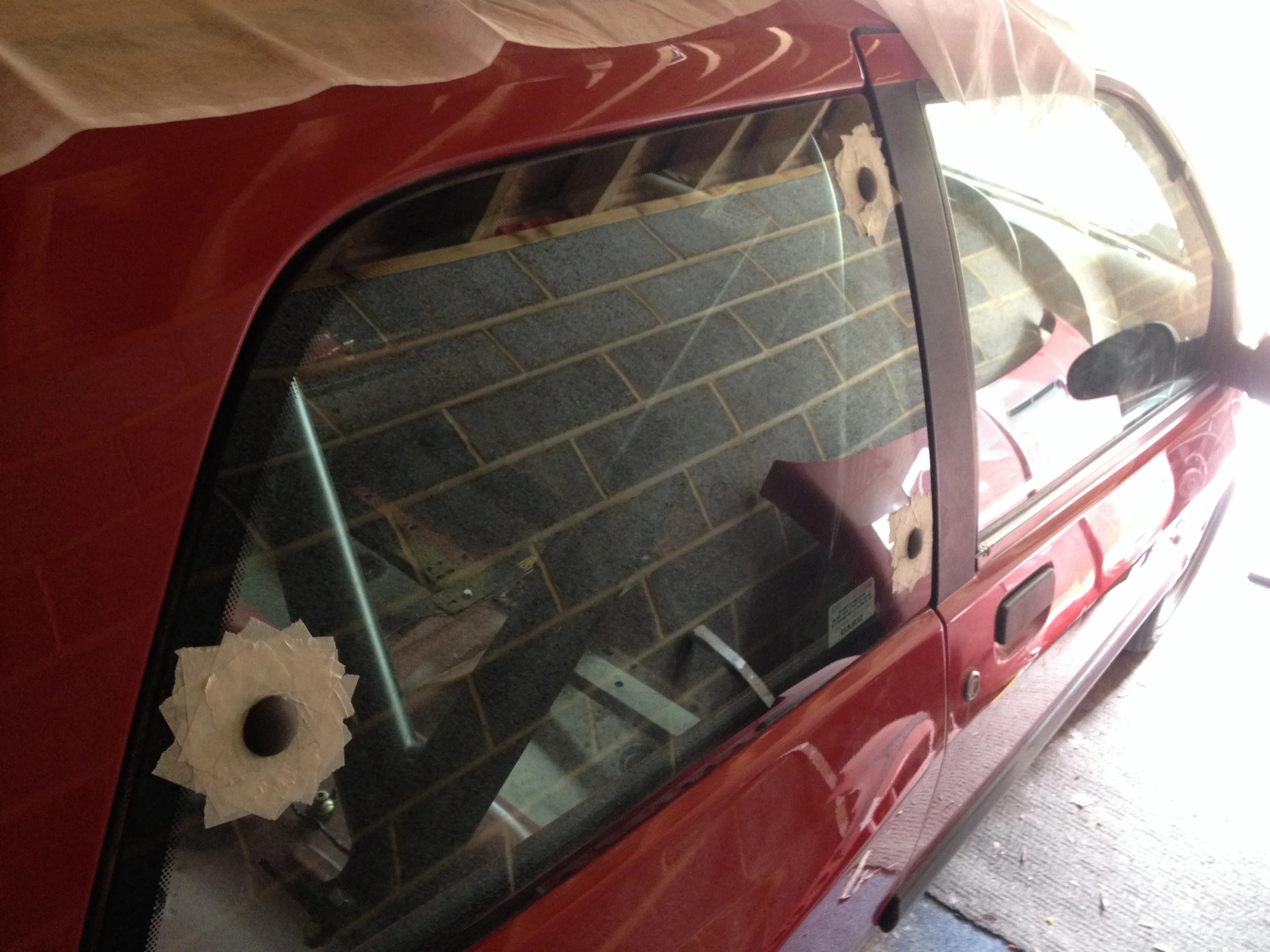

I tiger sealed up the holes from the last owners roll cage with aluminium mesh and tiger seal as well as the floor pan grommets as they were a little loose without it

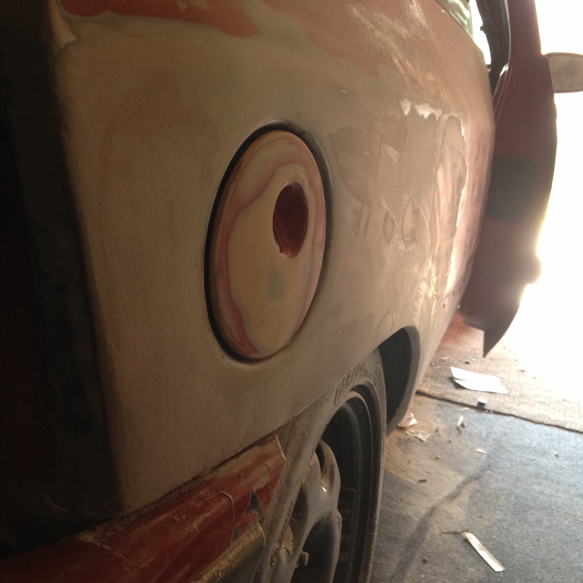

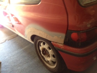

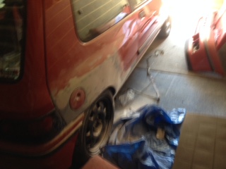

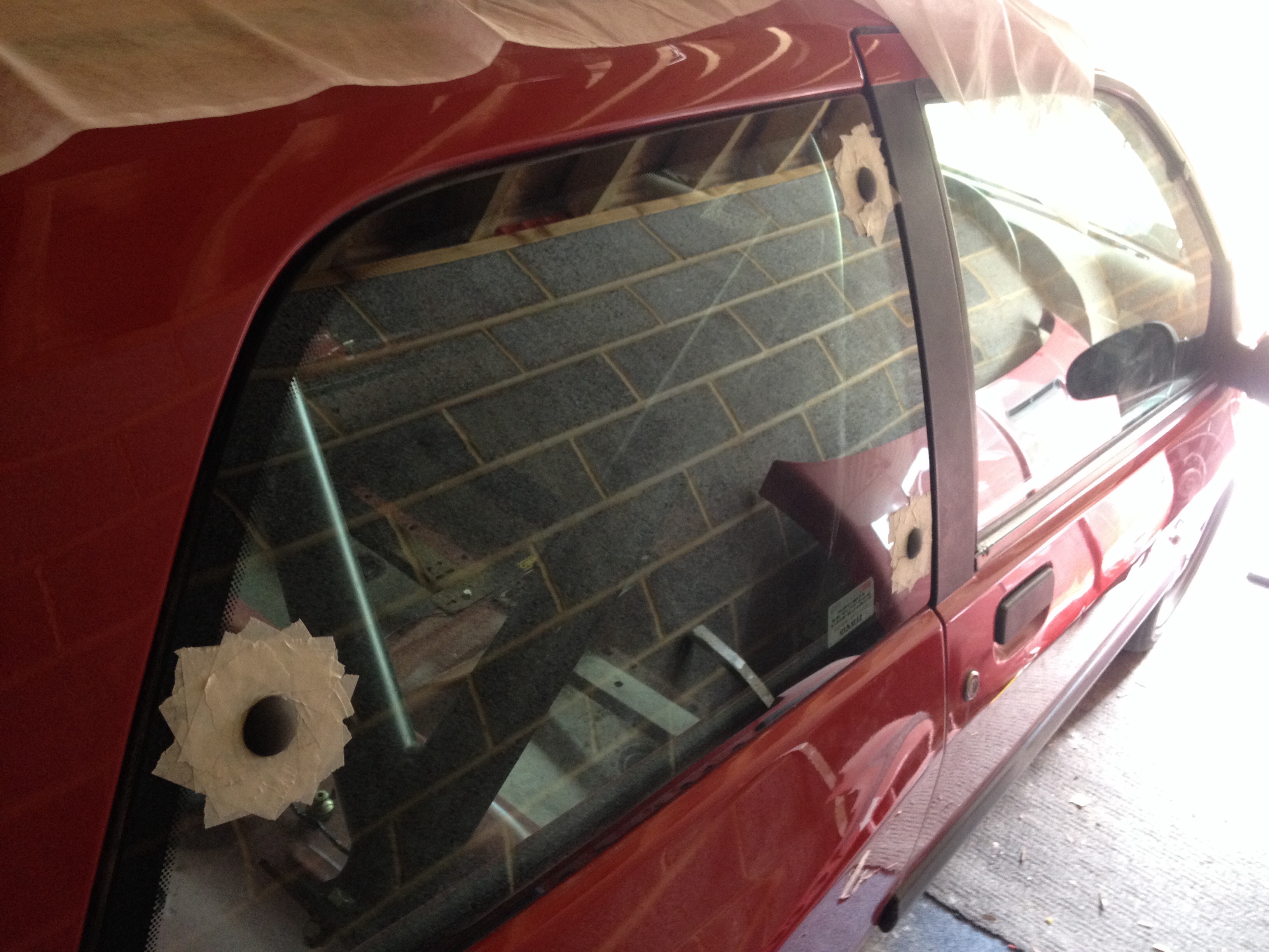

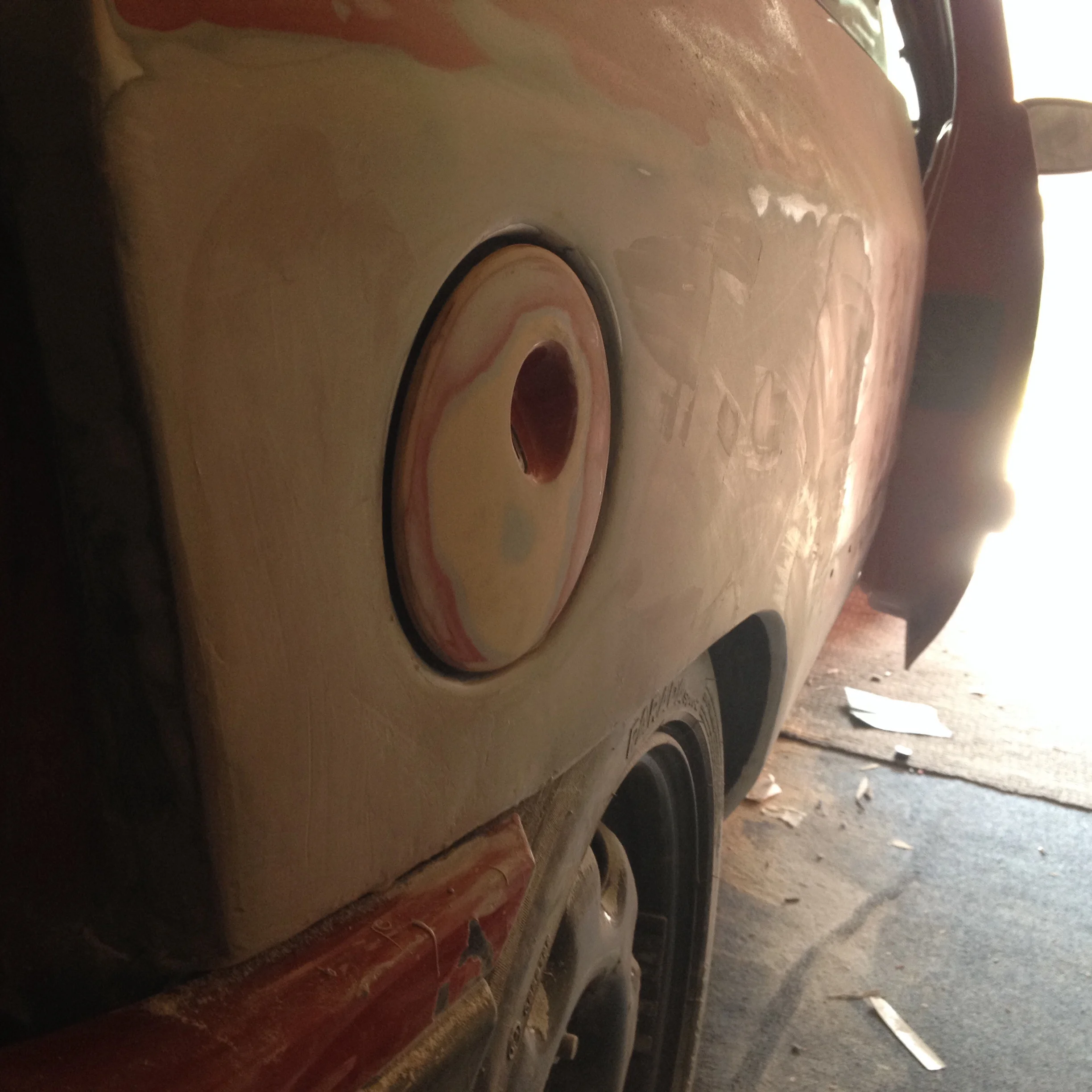

Finally getting to a good stage to where the rear arches are starting to take shape now after many hours sanding and filling, I will be getting my cousin to do a full spray job on the car once he is free and when the car is mechanically ready

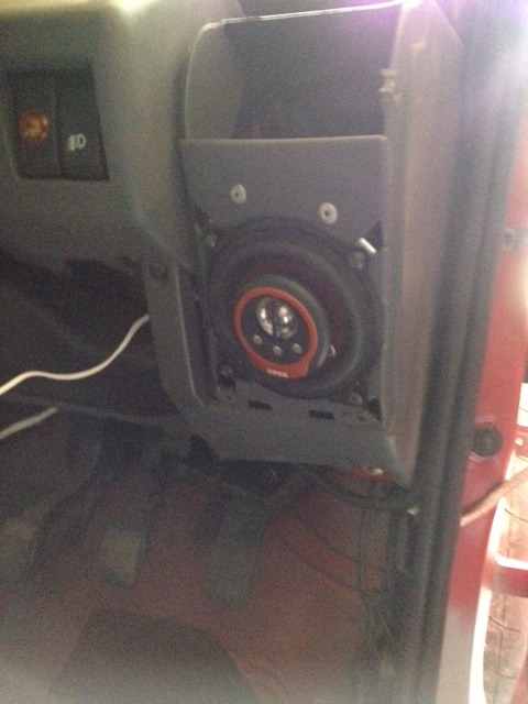

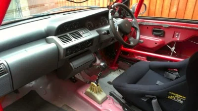

My speaker upgrade going in to replace the rubbish dash items

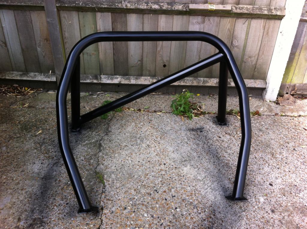

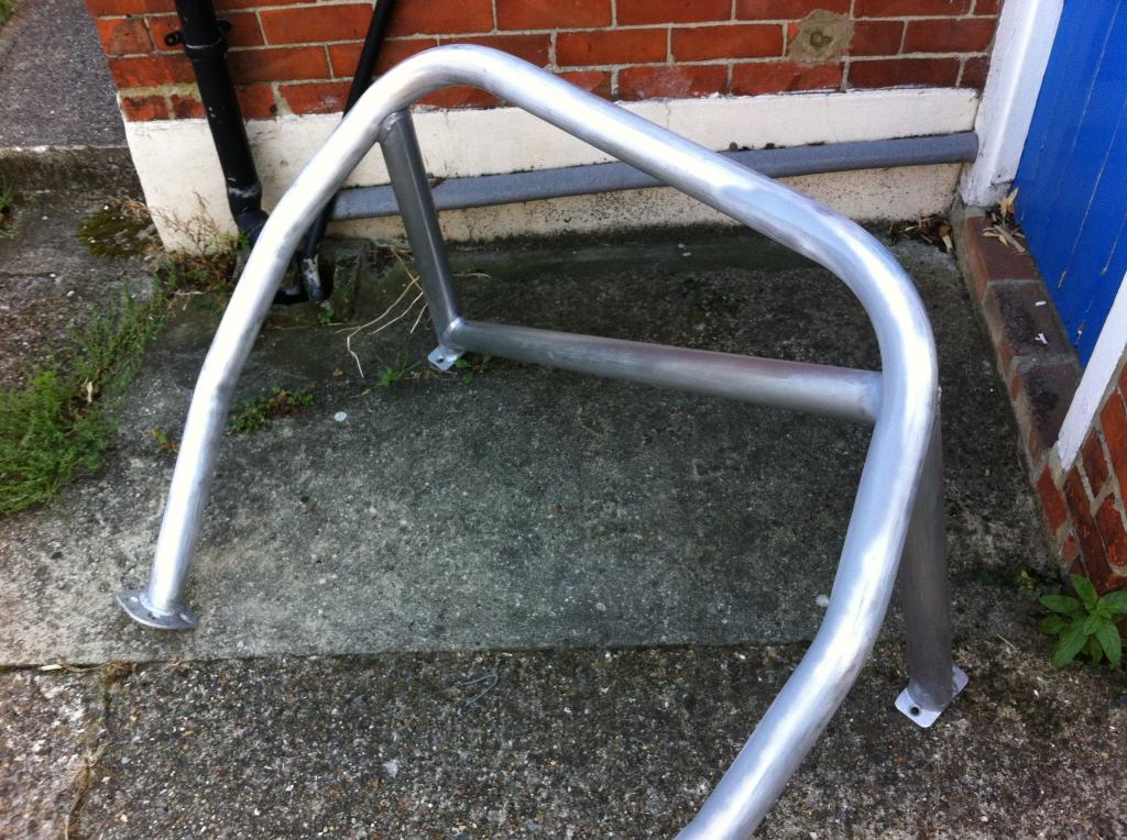

I got my rollcage rubbed down and primered
in primer
in satin paint and laquer

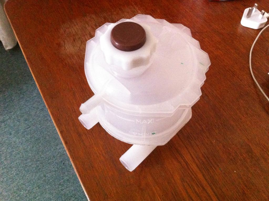

new water tank to replace my faded cracked one

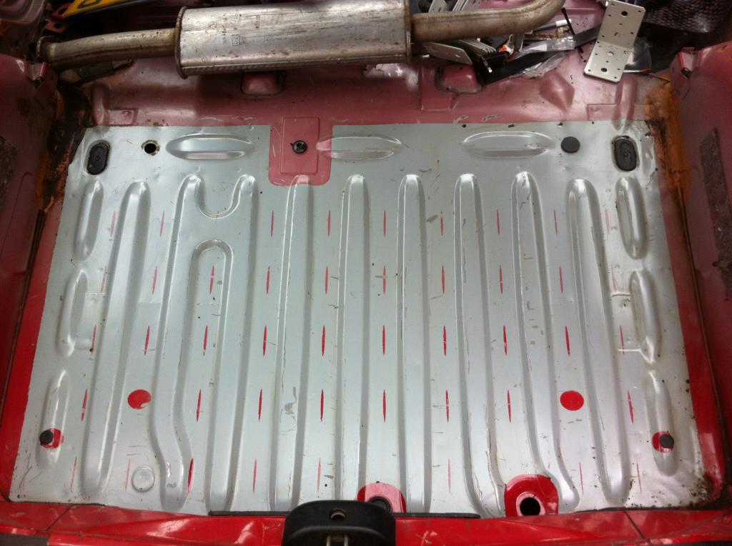

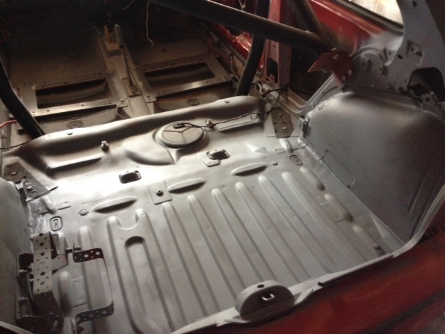

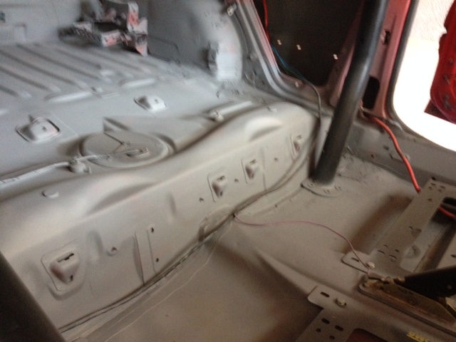

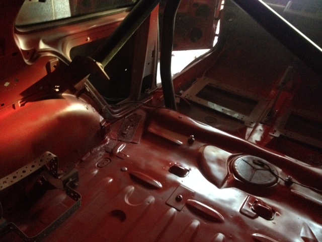

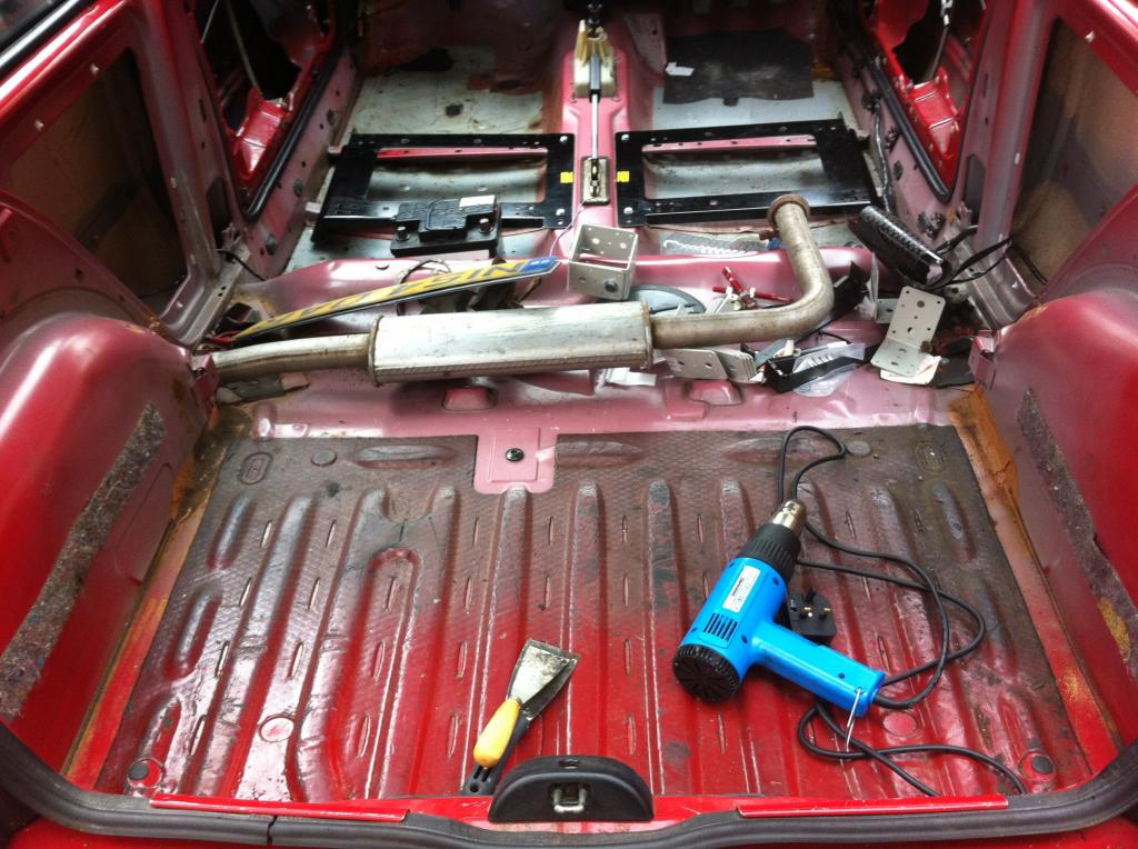

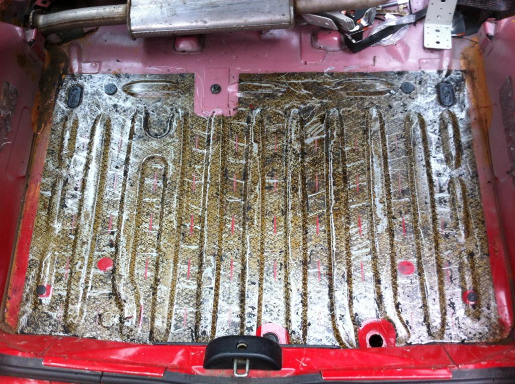

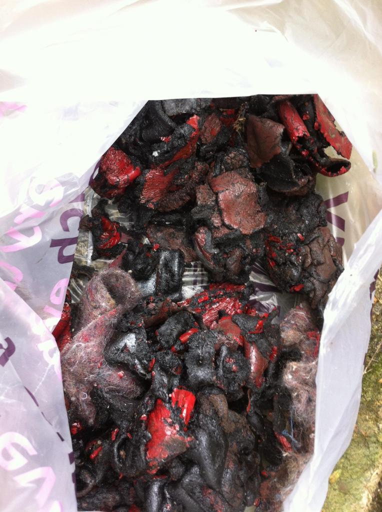

when i detarred the floor, thats a fun job isnt it, especially in the summer :(
all cleaned up with white spirit

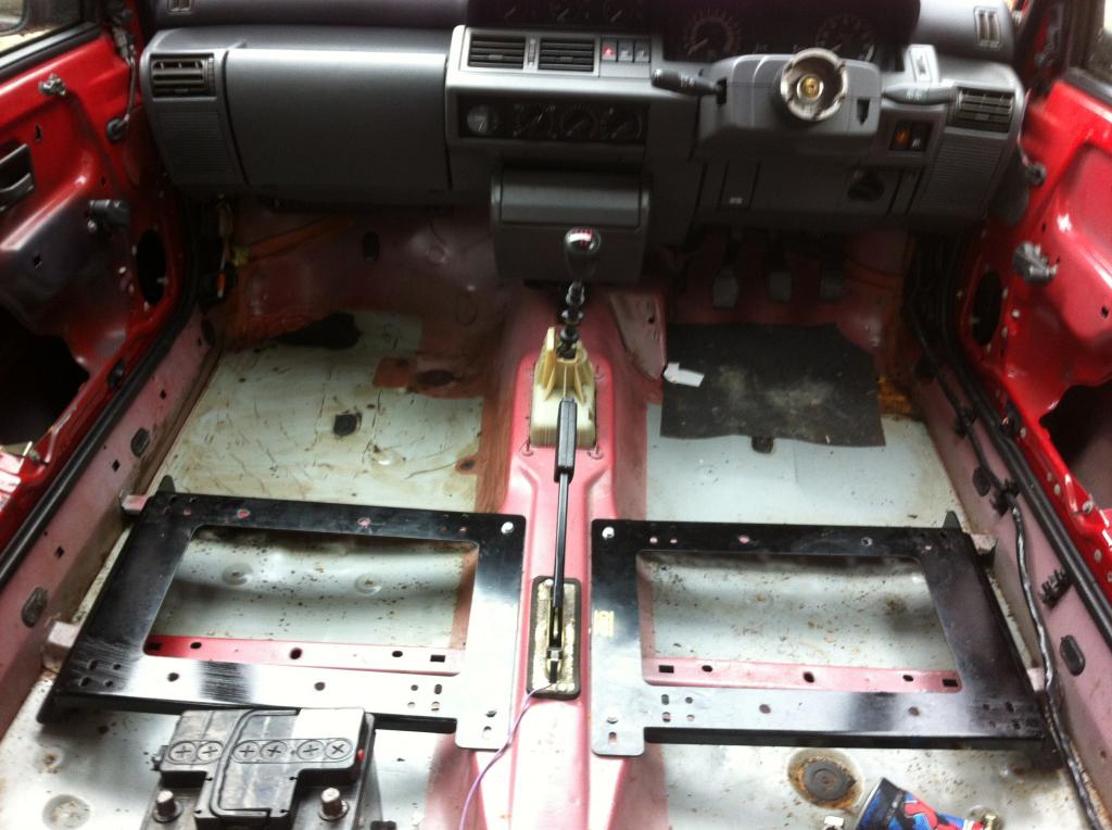

front seat mounts

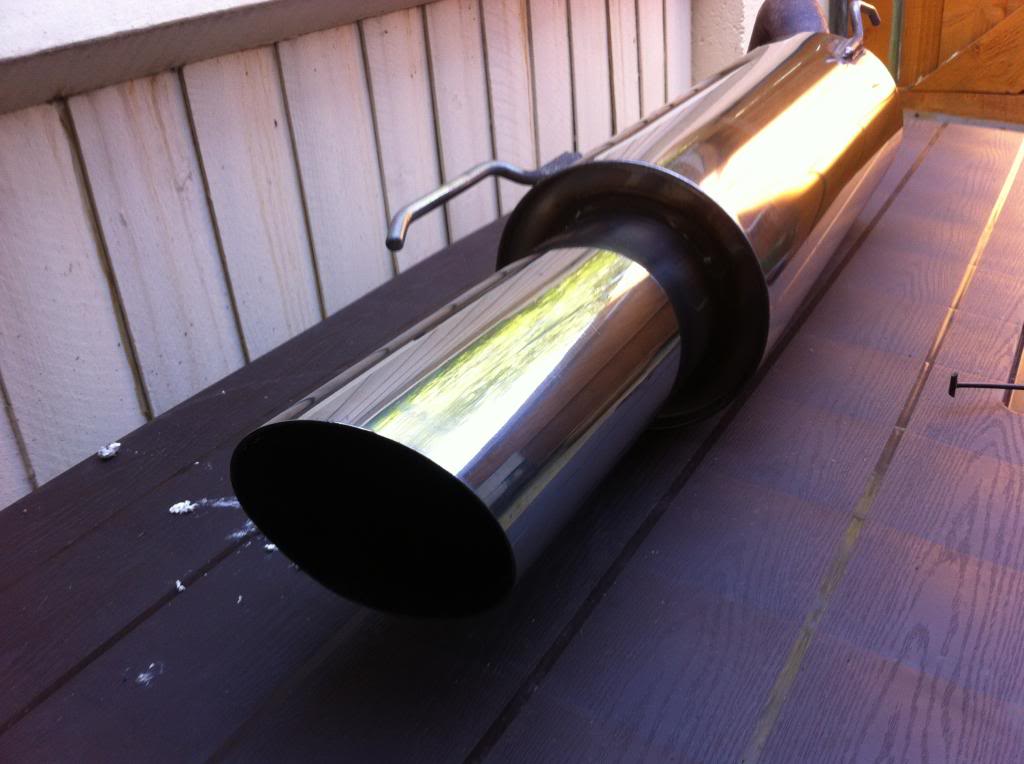

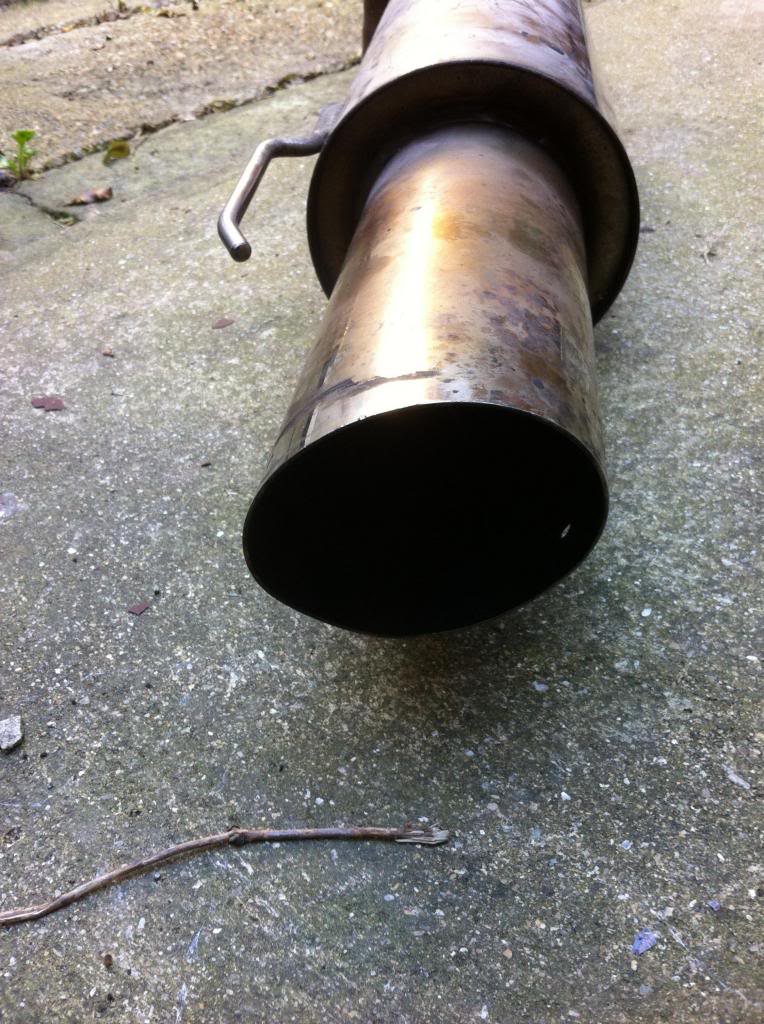

my stainless steel exhaust cat back before:
after

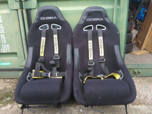

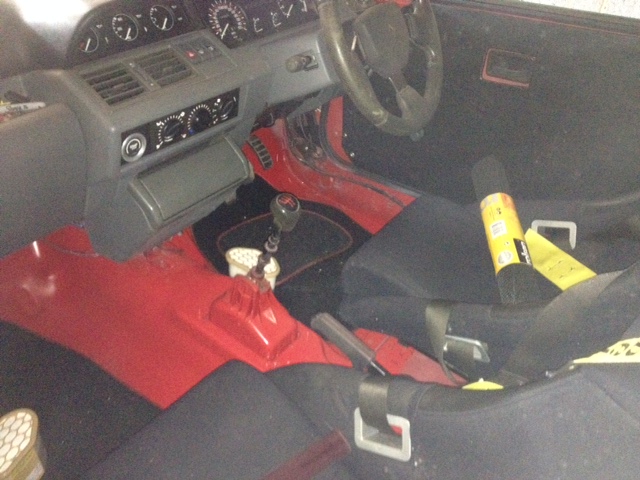

my seats and harnesses going in

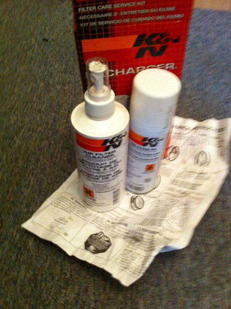

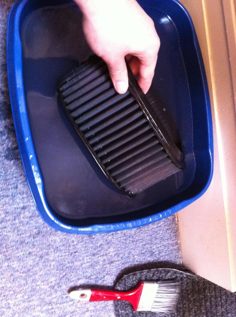

cleaned out the K&N oil filter

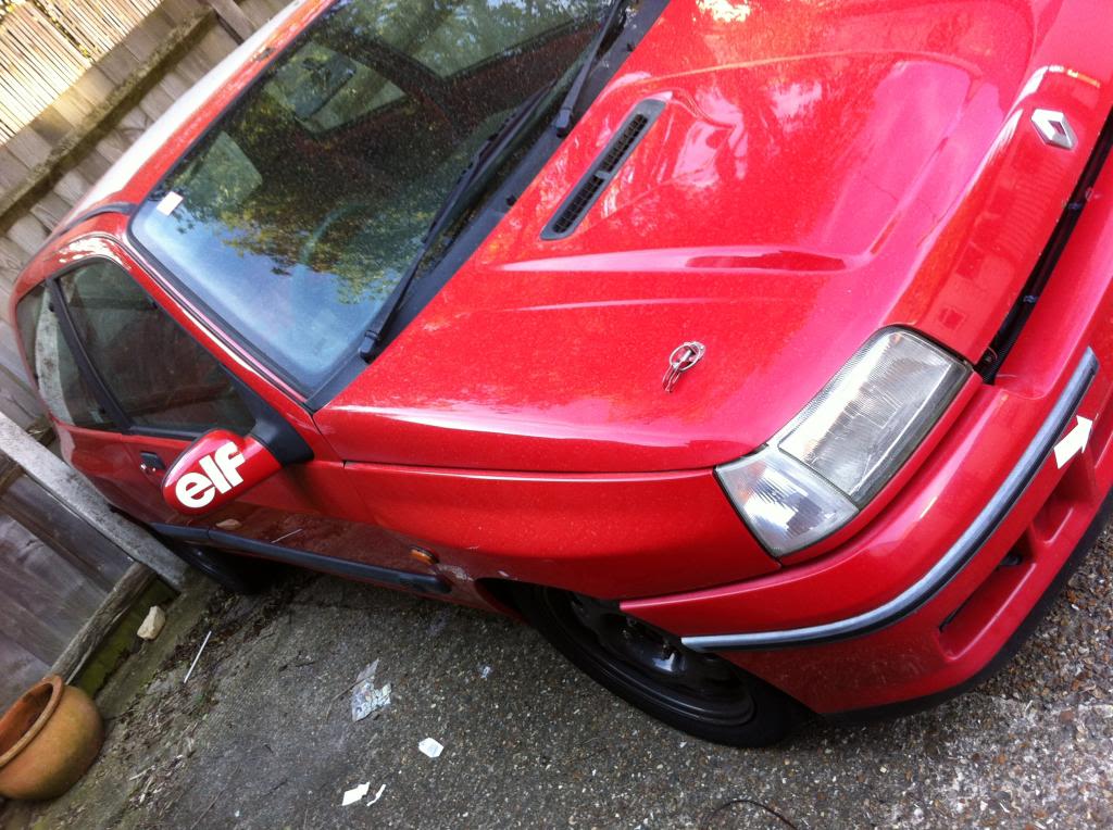

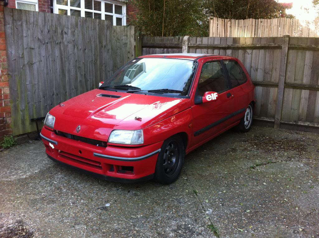

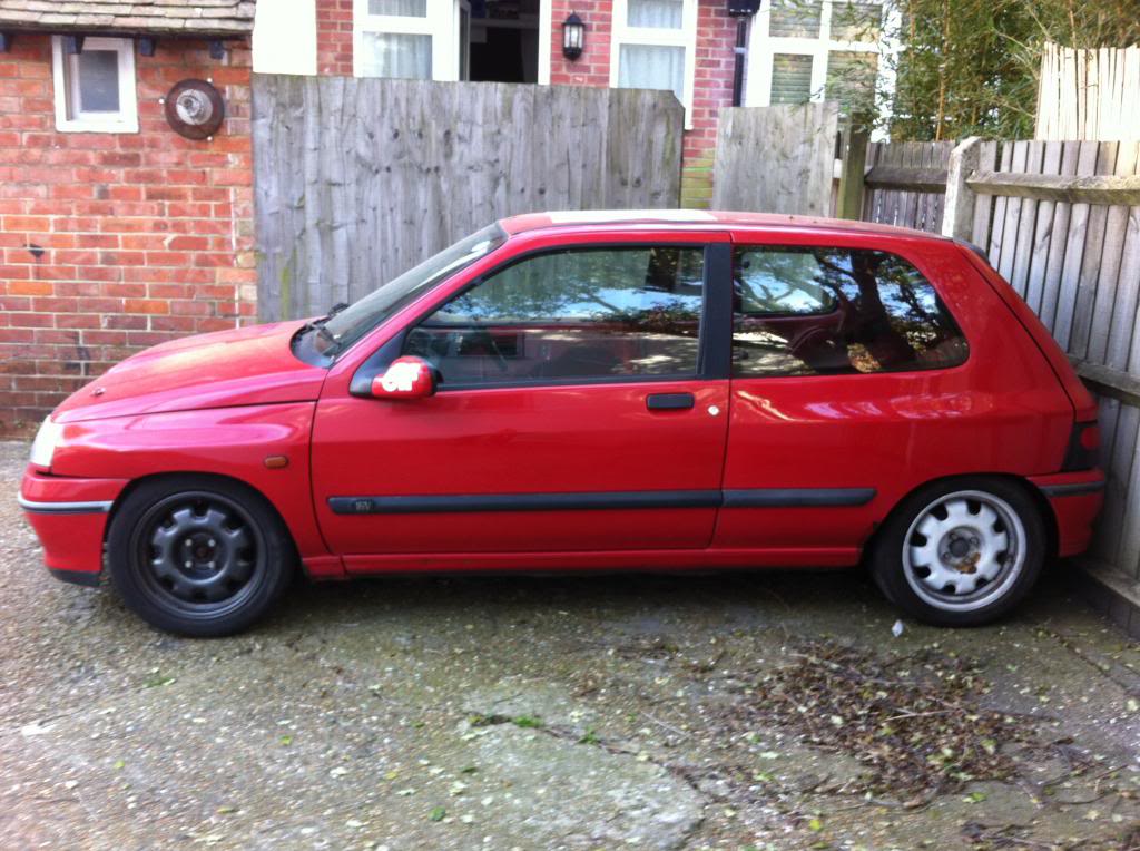

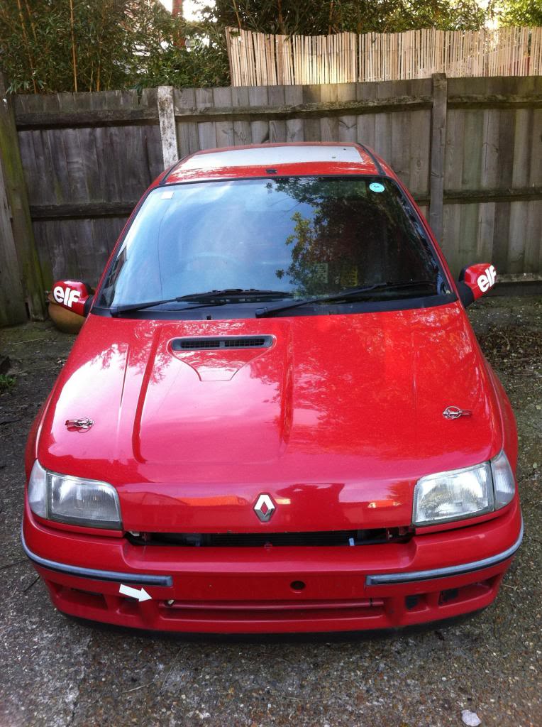

some out side shots of the old girl

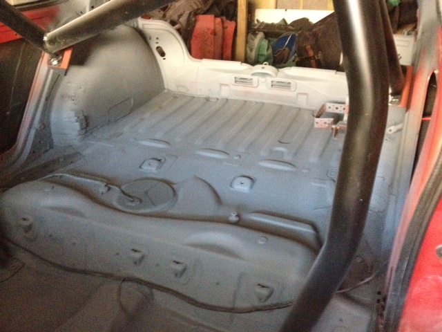

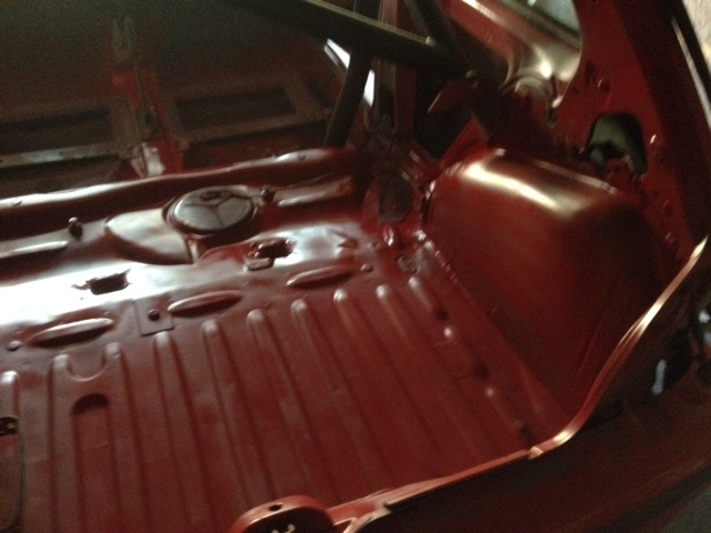

I cleaned up the interior and chucked down a primer layer on the interior
first base coat in capsicum red (renault code 727)
another coat

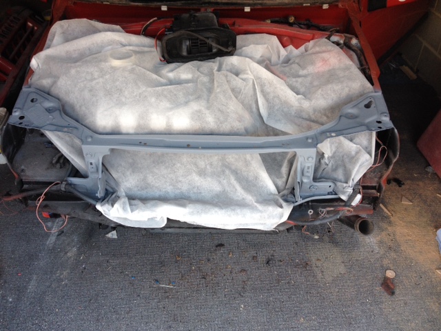

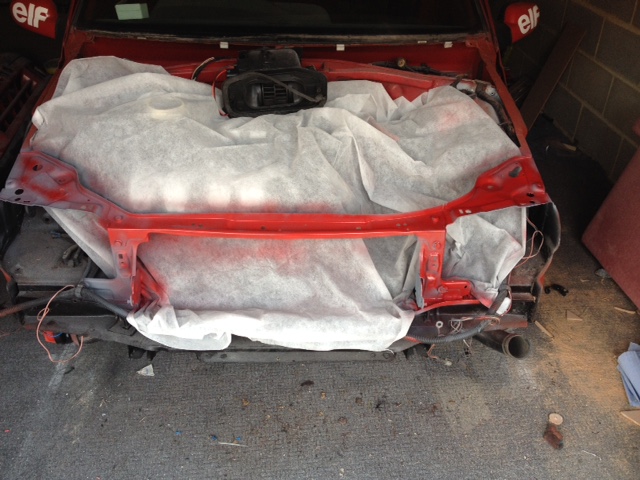

the slam panel in primer
base coat

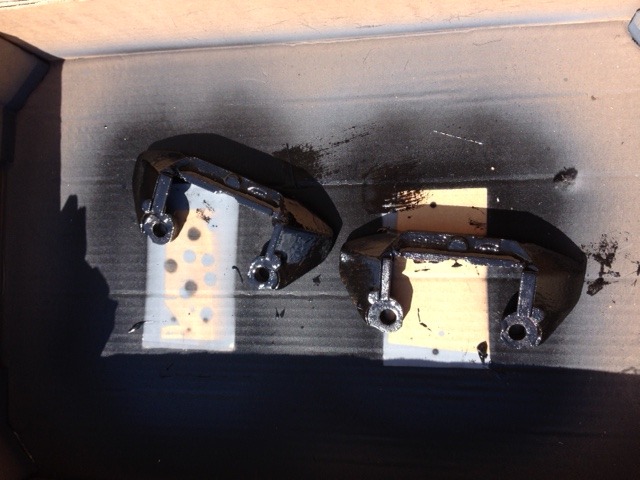

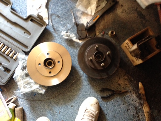

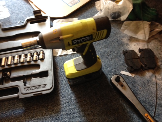

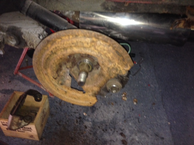

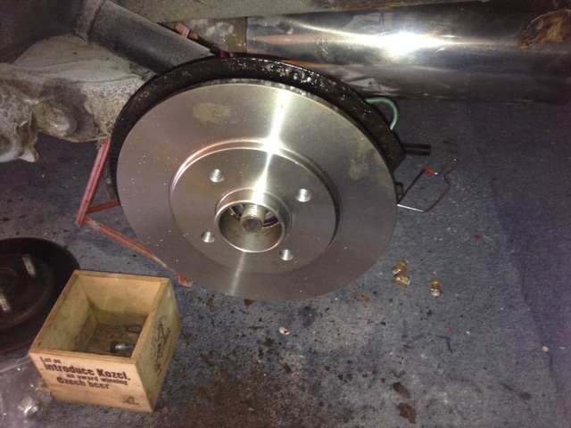

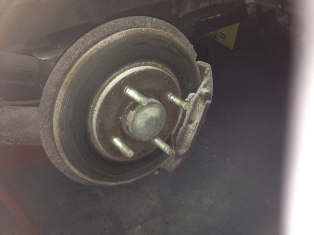

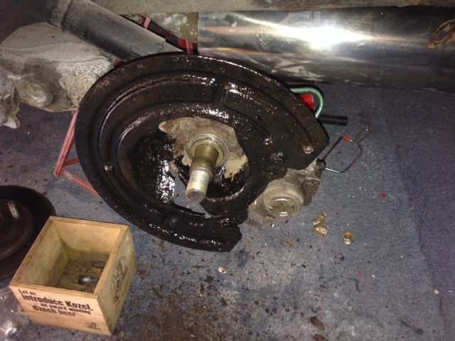

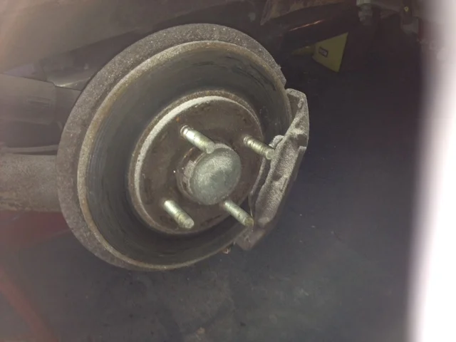

I have stripped down and refitted new rear brakes and with wheel bearings and cleaned and painted the calipers and dust covers. Now I got next week off work some serious work can happen.

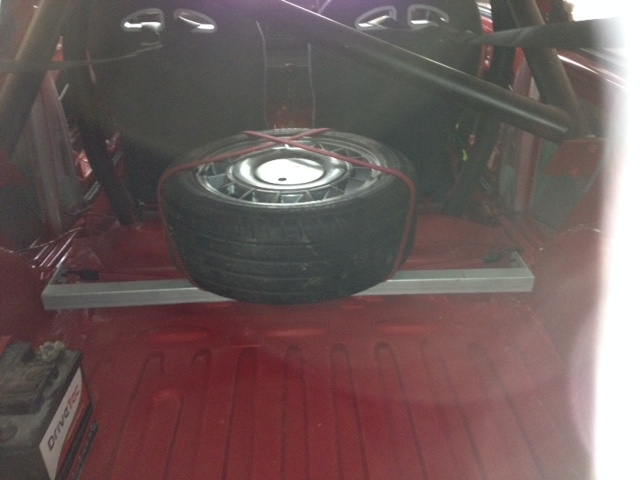

also got made up a custom rear strut brace/spare wheel holder
my rear brakes before:
during
nice new ones v old ones

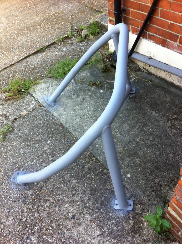

Well im not too sure I bought it off a lad up in Birmingham when he told me it was a cage for my car, got up there checked it out and brought it back and it didnt fit so i had some plates made up to bolt it in to make it fit, I was out of pocket by then and he lied about what car it was for. Its not quite a show cage as it has the correct fixing points, It looks to be out of a rs turbo. But it will do for now and will be replaced in the future with a safety devices one.

first off I finished off and installed my doorcards but I just have to source some grab handles for them and there complete.

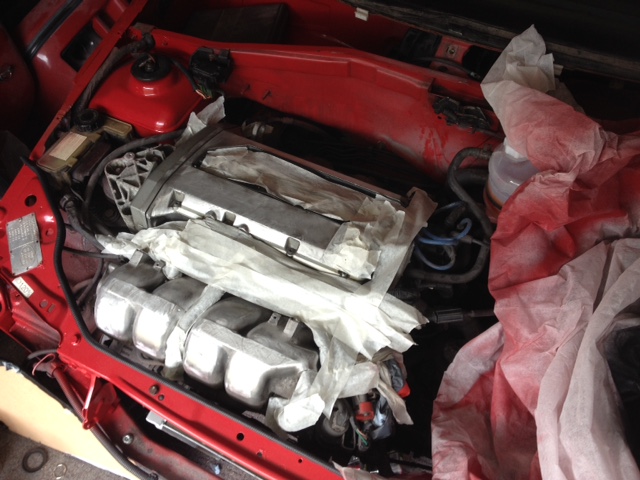

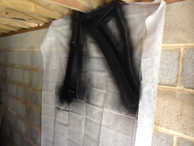

whilst I was waiting for the relay box to dry between coats I prepped the engine and intake manifold ready for painting:
also whilst that was happening I prepared and started to paint my scuttle panels as they were flaking abit:

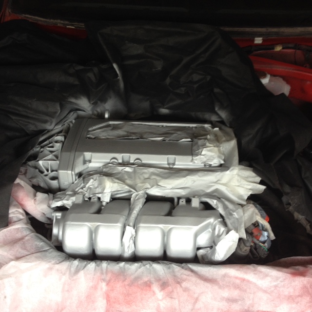

Then I moved onto painting the engine cover and inlet manifold with VHT Aluminium paint:

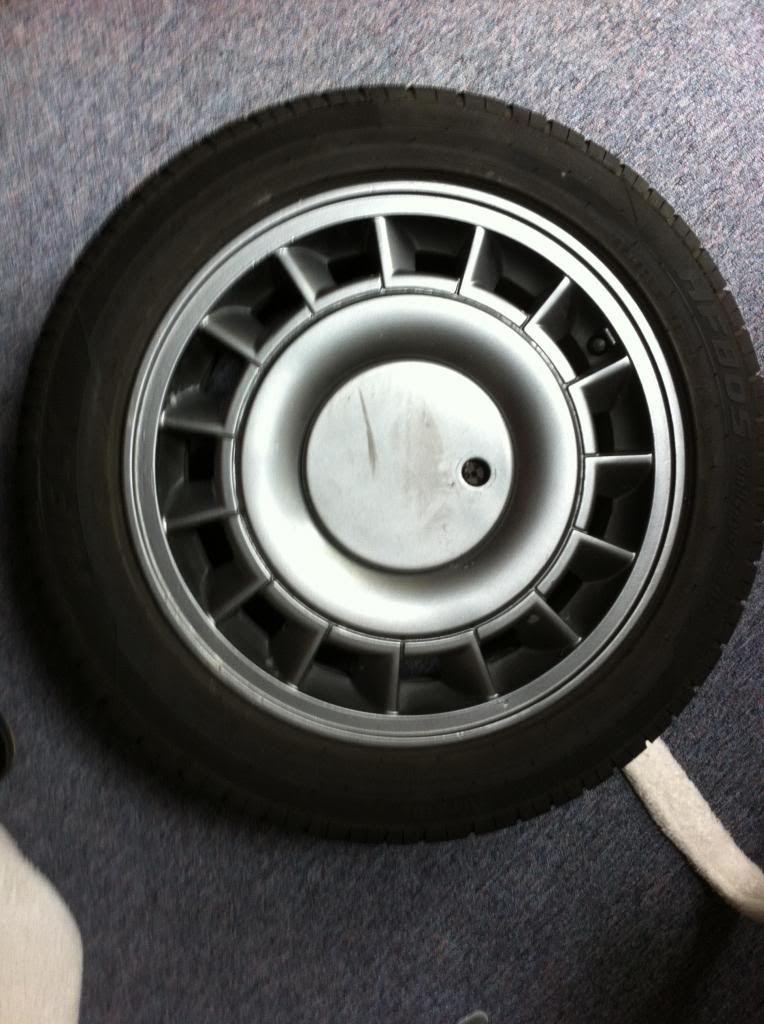

5X RENAULT TURBINES ALLOYS 4 OK CONDITION 1X NEED REFURB (WAS MY SPARE)

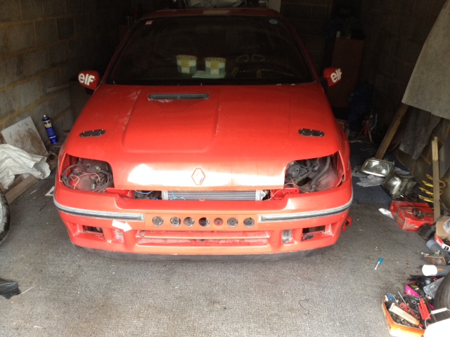

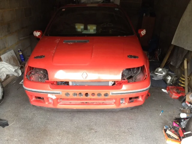

I am now at the stage of having the entire car repainted in the original 727 capsicum red. I am just waiting on the painter to give me the go ahead. whilst in the mean time I am currently tieing up any loose ends and making the changes I want to make to the car before I make it my daily.

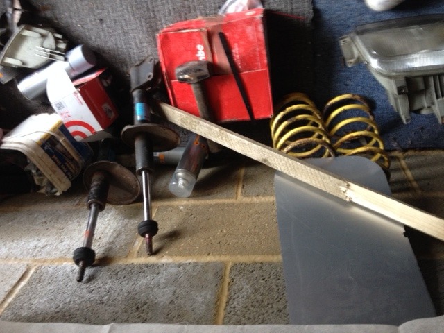

So first off I put some GAZ coilovers on as Ive had these in the past and they a great bit of kit for the money.
and I replaced the poverty spec that was on the car : standard shocks on apex springs

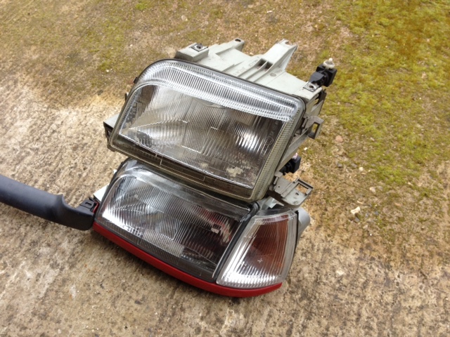

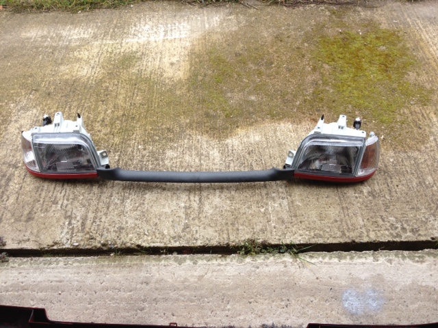

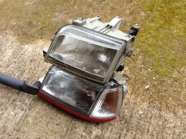

I then Set about sourcing some brand new headlights for the car and after discovering that euro car parts make all the parts I jumped at the chance to have them only to be told after a week of waiting for them they no longer had them even thought their website stated in stock grrrr... so after I re ordered else where I received just the indicators great you think, NOPE they didn't match and one was a tint of green with a pattern to the lens and the other looked clear with no pattern and look like a lexus lens.
after weeks of hunting finally JAYAR car parts really helped me out and I explained the situation and they found me a matching pair finally.
NEW FRONT END SETUP:
also needed a grill as I didn't have one on the car before:
OLD vs NEW
quick interior shot: ignore the damp traps :) lol its been a very wet winter....

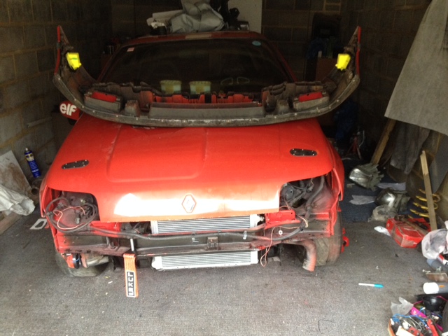

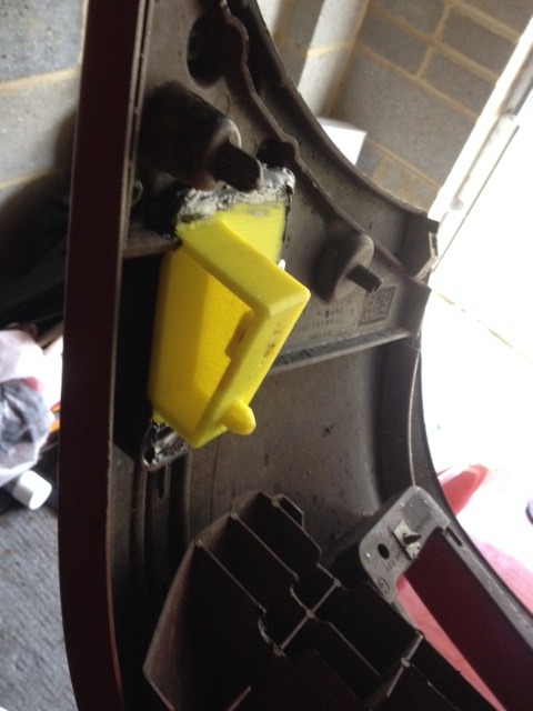

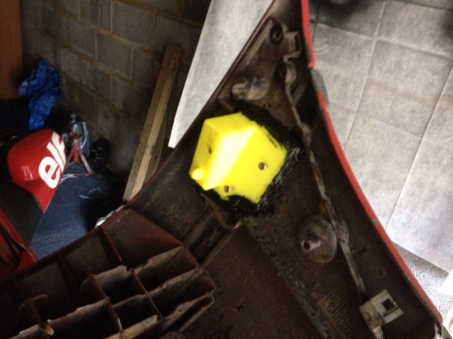

I then went on the hunt for a new front bumper for the car as the original has had a hard life and somehow both the front bumper mounts had been cut clean off:

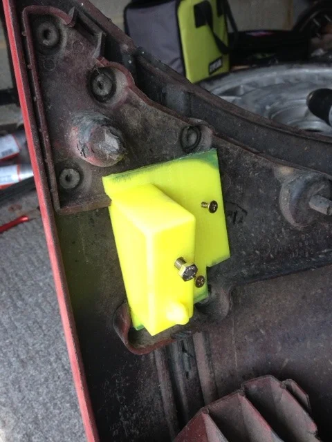

So with the help of my father in law and some 3D magic we designed a new bracked based on the broken one and it works a treat. Its also strong and better made than before. And its bright yellow bonusss :)
Getting it in position and trial fitting before I bond it down for life
and left to dry

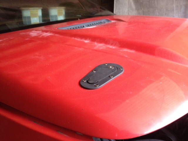

I also got my aero catches fitted and put back on the original hinge brackets and saftey wire stay.

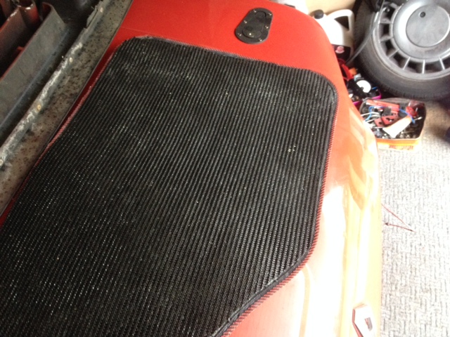

Because the car didnt have any carperts I bought some base black and red piping mats but found that they skid to much on the bare metal so I thought I would Evo stikking some Anti slip mat to the back of the front car mats to help prevent this.

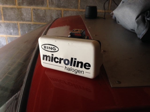

and also while the bumper was off I wanted to get my foglights pre mounted to prevent damage to the paint afterwards and I sourced the only set that would fit in the original holes in the bumper and It was a pair of Ring mircoline halogens with covers that I more importantly wanted to protect them from the elements and stones.
