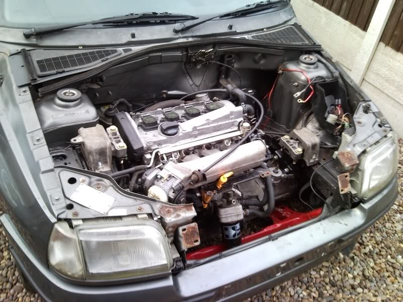

I will update the proper thread later this week, but a sneaky pic of the car now I have picked it up from Mr Flan! He has done a crackin job of the mounts and drive shafts!
I have a Seat Sport 20v Turbo engine here now which I think I am going to swap this one for as it has a load of uprated parts on it, which has also been blueprinted by a proper BTCC tuning company and has covered only 200 miles from new after being run in.
should be around 280-300hp @flywheel with the other engine and K04. the guy I got it from races the Leons, and he has the exact same engine with the K04 and is running 299hp!

Should have fitted steel rods / forged pistons whilst the block was out.
They will run at 300 bhp + but they dont last long
K04's are only good for about 275 bhp

I've bought a blueprinted 20v engine also so this one will be coming out soon. I would be happy with anything around 270+! The guy I got the engine from has the exact same one in his car with the K04 and claims to be running 299hp. He said it gets thrashed within an inch of its life every time its run (as he races leon's in a btcc league of some sort) and its been fine.
Will see what happens once its plumbed in and mapped etc! I'm not looking to run it at its maximum capability, around 270hp would be plenty for the time being!

Should be safe - you will be in for a shock even with that power. A grand would see you with Steel rods + Forged pistons and a 1.9 overbore. This set up will take anything up to 550 bhp.
You will get bored of 270 horses ;)
