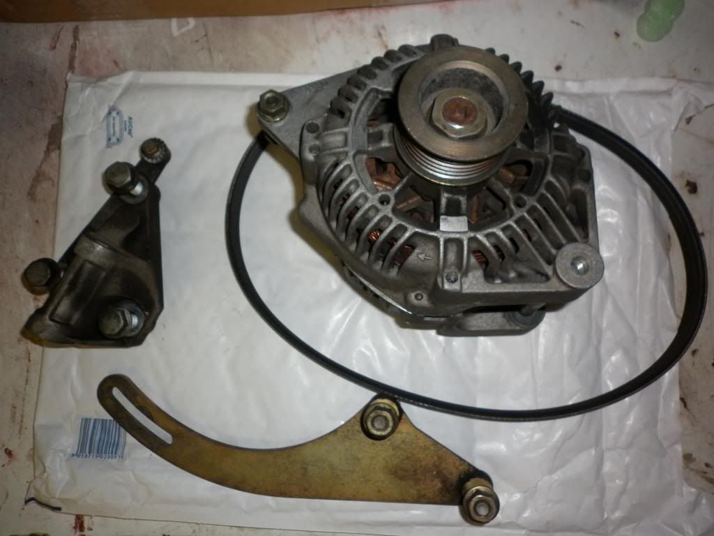

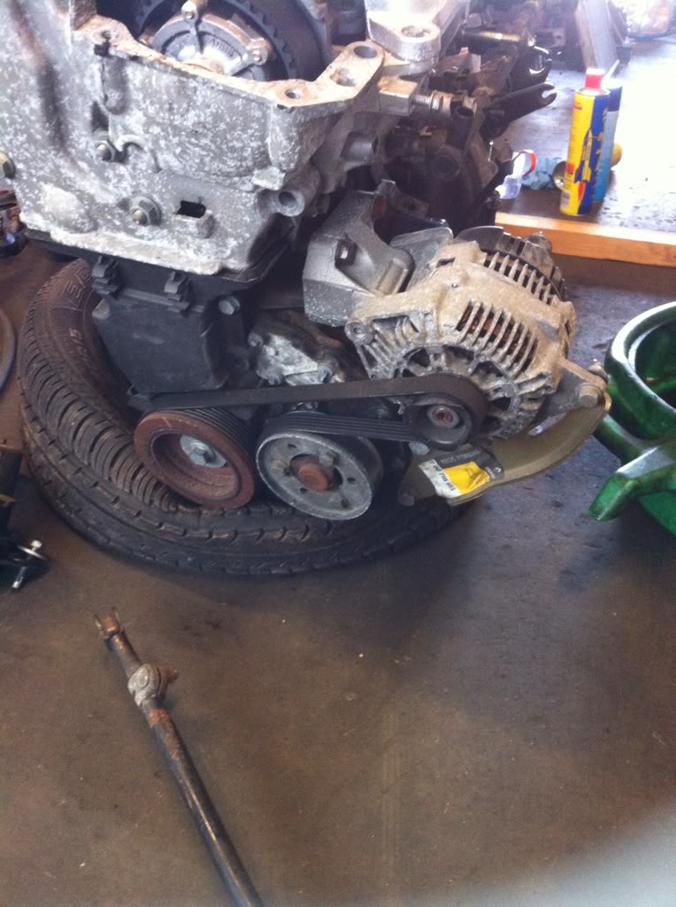

This is my engine with a renault 11 (I think, I can't remember 100%) alternator bracket.
A/c and power steering removed as the engine is in my mk1 like yours.
No, the gold bit (said renault 11 bracket) is slotted, so you tension it and then tighten it.
Ive got a home made setup on my mk1, but thats similar, its just a case of loosening a bolt, move the alternator, do it up. Lots of older cars were like that from the factory anyway, it works just fine.
