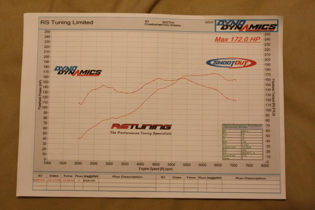

I happen to have a 172 engine'd Mk1 too, now unless I'm mistaken, my completely standard engine makes 172bhp, still never seen an F4R make book power?

He's gonna say the RR print out has been doctor'd!
This is one example of a 172 that might produce the factory power.

standard
filter, matched inlets, exhaust manifold, decat exhaust system
wow.............an f4 running more than book figures.....now theres a 1 in a million. 172 being the ps not bhp, which equates to around 165 bhp iirc.
keep hold of that mate its a good un......diff roller comparisons??
whitely isnt your car running an rtuner(or some other map)? decat? filter?
so not exactly standard!
ive been to a few rr days and never seen a 172 make 172bhp!
Williams engine works just great! saying that if my turbo engine goes pop ill be putting an F4R in my hybrid, why? simply because there is ALOT more off them around!
Naughty naughty Mr Whitely. Telling pork pies about the level of tune hey?
Just to be clear. Standard means 'as the car as it came out of the factory'. Judging by that graph, if you remove the map and decat, and other bits, your below book power.
Yet again Mr Midgley delivers. Thats why they call him 'The Postman'.
think most iv seen a std 172 run is about 165.
and thats pretty much book figure.....a car running 170 with de-cat and remap is just fukkin dire if you ask me....trying to promote it as a std car is even worse in my book.
