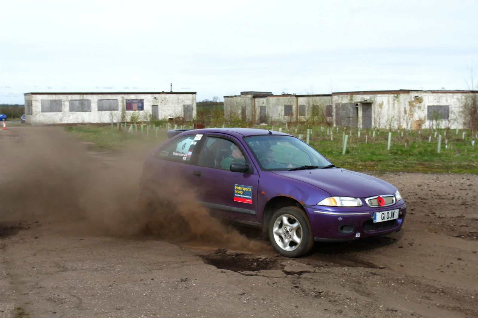

As James said, do you need a cage? It adds weight and you won't be going very fast on an Autosolo or Targa. A cage will weigh a lot more than a rear seat! I don't want you to scrimp on safety, far from it, but again look at the real risk. I have a cage in my Rover as the (now defunct) Endurance Rally Regulations required a rear cage. I still have the rear seat in the Rover as it's required, but as there's no way it can be used with the cage fitted, I have a folded Renault rear seat as it was the lightest we could find! I'm also very aware that a car rolled on the Targa last Sunday, a VERY rare occurrence. Again, just make sure that the car is 100% and get out there.
A pic attached from the Javalin's Jumbo Targa last Sunday.

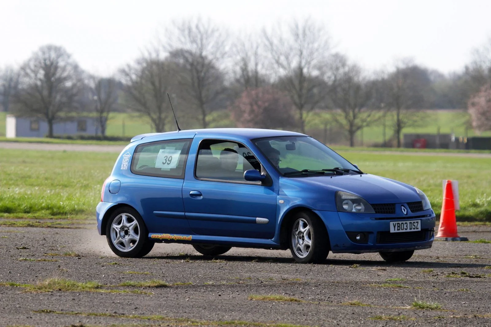

Here's one of mine at the same event

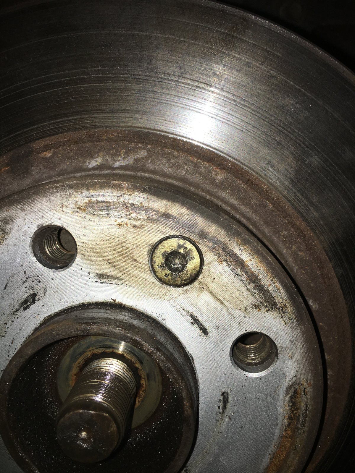

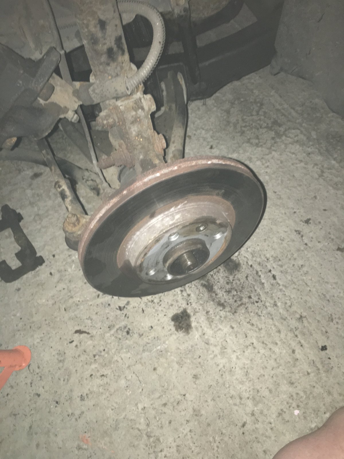

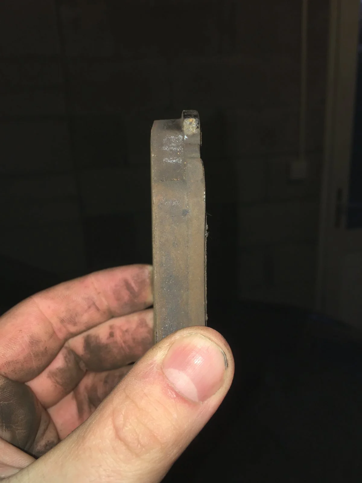

Got working on changing the driveshaft this evening & WD40 has been my best friend!! 😂 But I FINALLY got the fricking hub nut off! Yaaaay! :grin:
So got the calliper off & the pads out, so far so good..
Got to the last torx screw holding the brake disc in aaaaaaannnnnnnndddddd its rounded!! :weary::rage:
Typical!! It's always the last important screw which won't work! Will go at it with a chisel & hammer on the weekend.

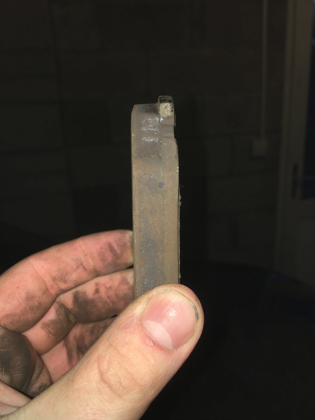

Was well happy with how much meat was left on the pads though!

Nice, as said before give the caliper carrier slides a check. Mine were seized when I bought the car, and I nearly went through the windscreen once I'd fixed them. I drilled the countersunk screws heads off, the screw is only necessary to locate the disc until the wheel bolts are in. That said it probably wouldn't be hard to find another.
  Renault Clio Mk2
Yeah whilst I got it off I'm going to give everything a good wire brush & a good clean (might even give it a paint lol). I'll have a crack at it with the chisel & if that don't work I'll drill it out. I got a Halfords & Euro car parts just down the road which is handy... & expensive! Haha
