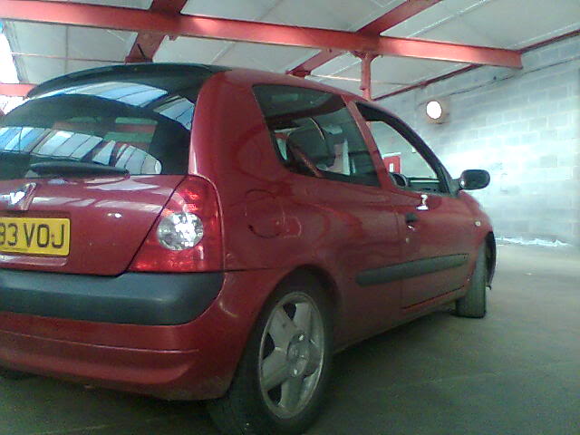

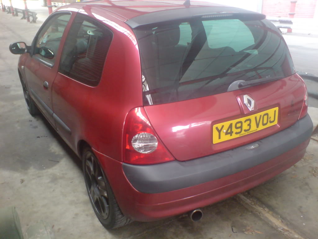

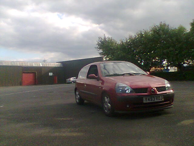

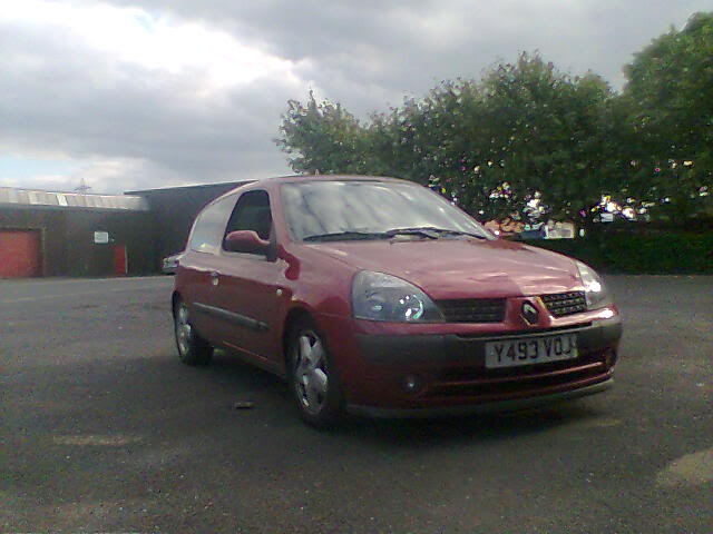

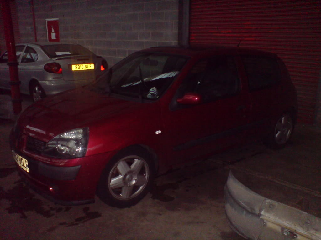

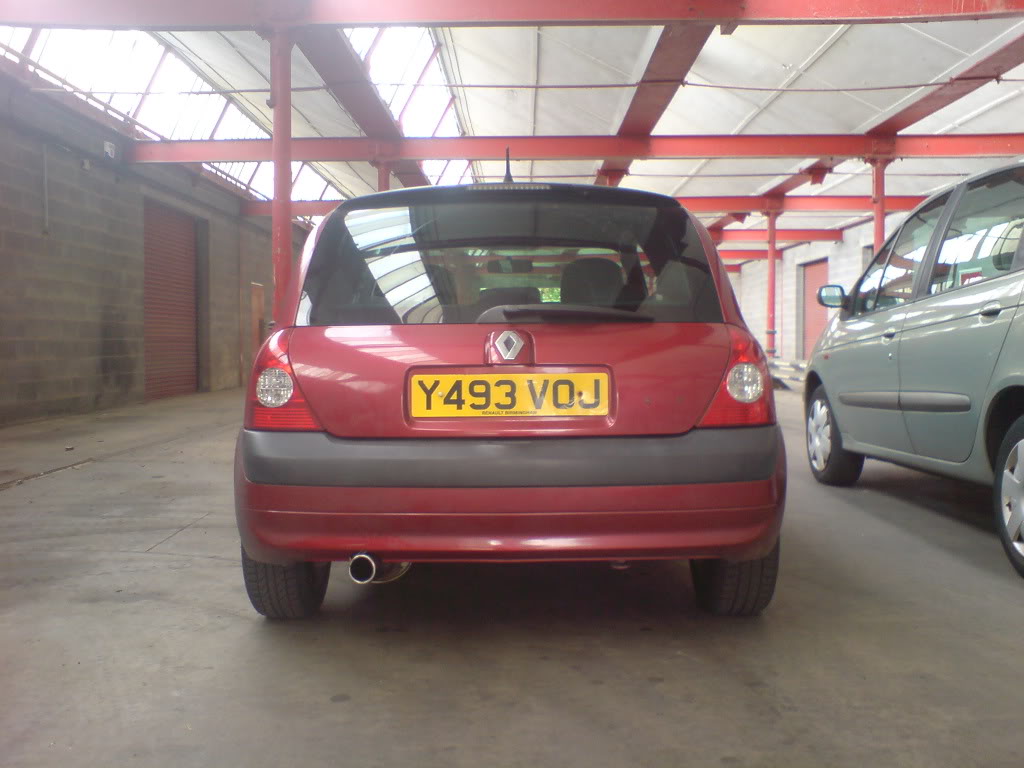

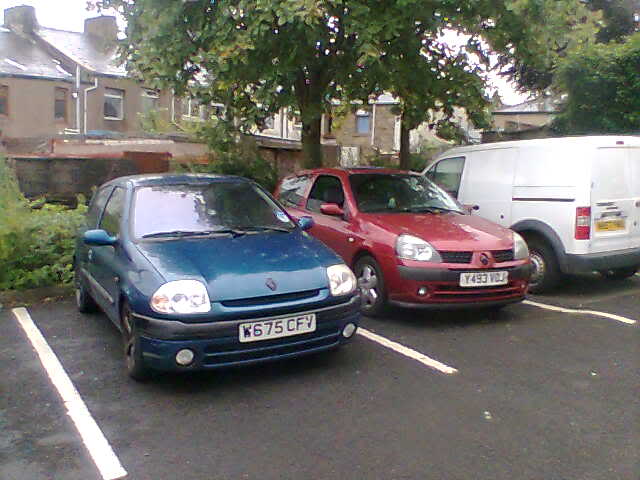

Only had the 16v for 2 weeks, and it needed work in the first place ( see newbies section for full details), so here it is:
Needs a bit of work, some braking issues, the ABS rings on the hubs are both cracked, the clutch is very high so will be changing that, and will be taking the head off to seat the valves in properly and new gaskets all round with a service very soon, along with bushes and a dogbone mount.

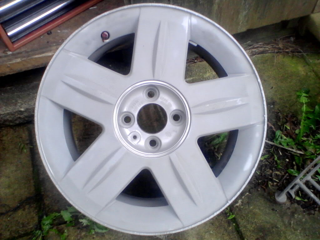

These (sandblasted myself):

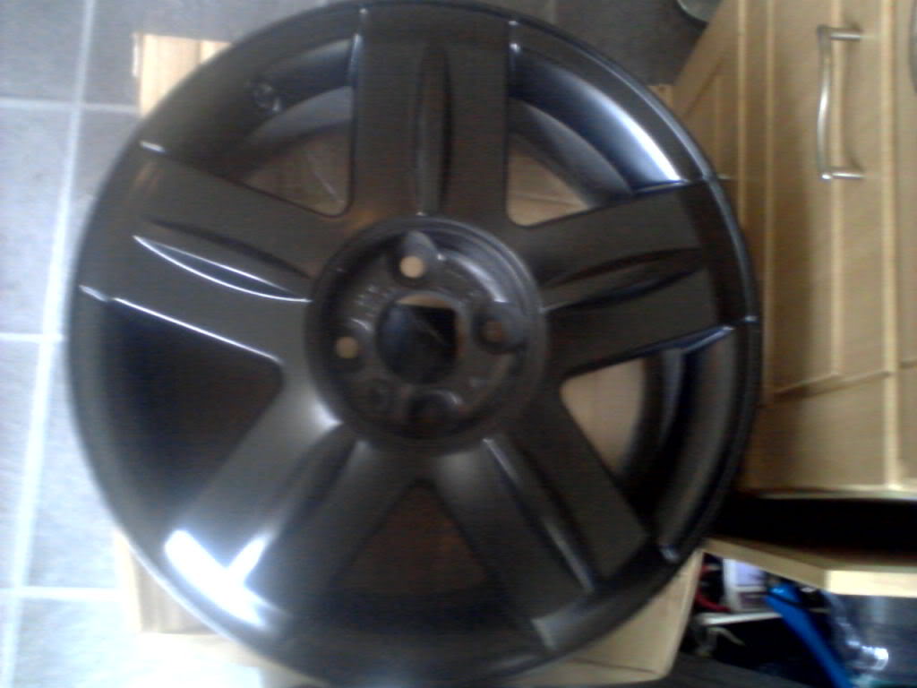

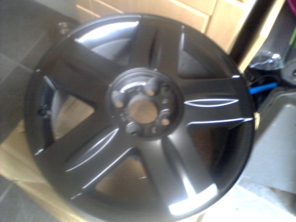

Silvervisions, clear side indicators and parcel shelf fitted last night, got one of the wheels in black aswell, tried to go for satin black but it looks too shiney, so may have to go for matte black instead, anyone got some pics of 172 wheels in matte black?

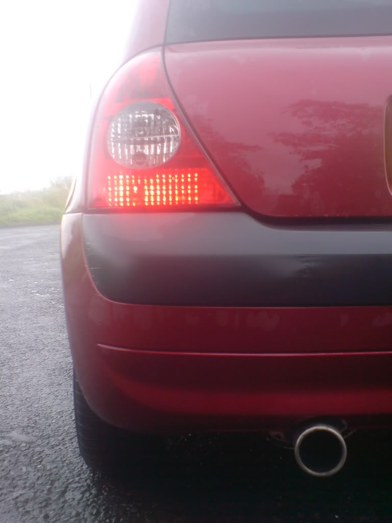

Silvervisions front and back:

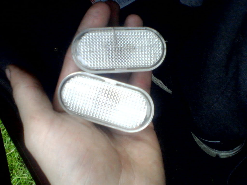

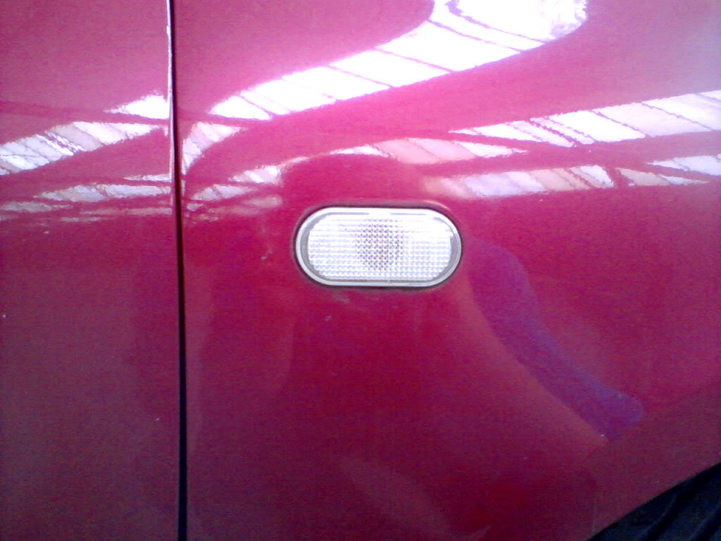

clear side indicators:

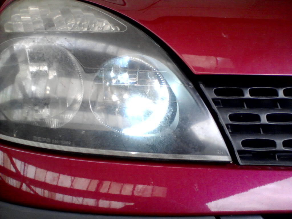

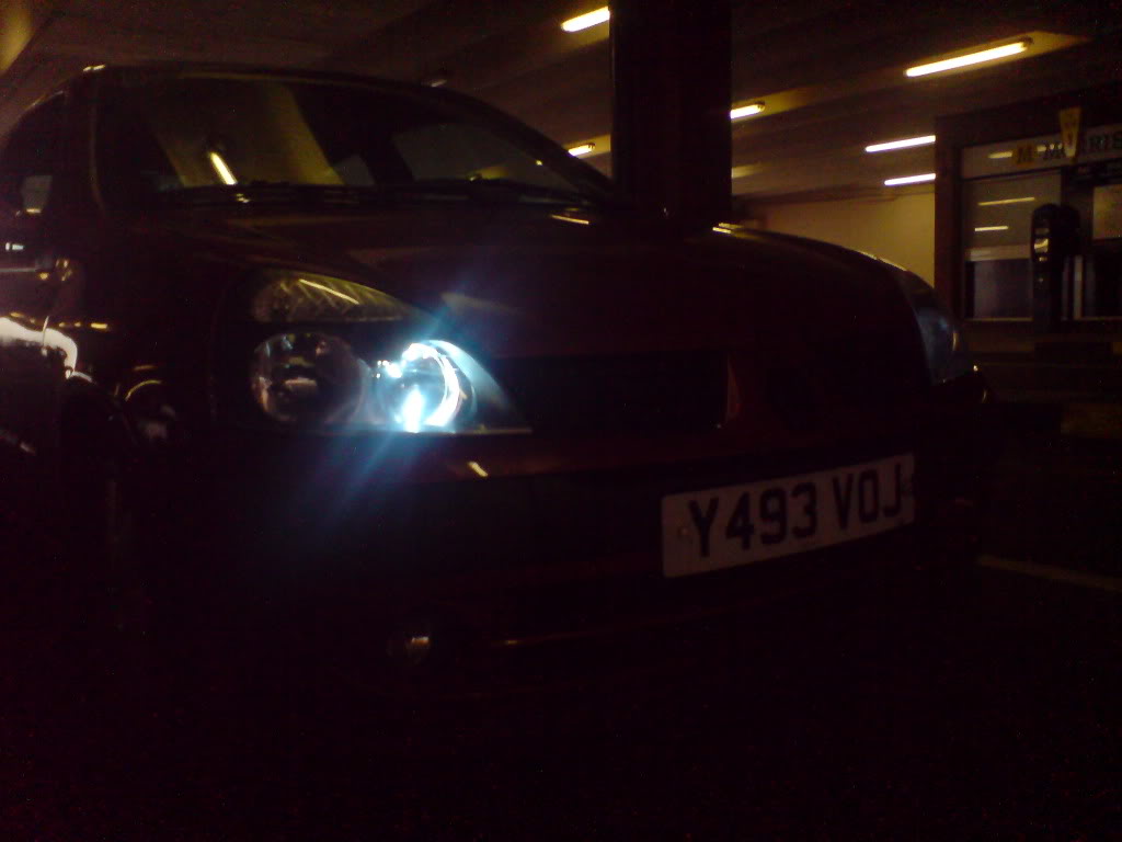

L.E.D sidelights (look better in the dark):

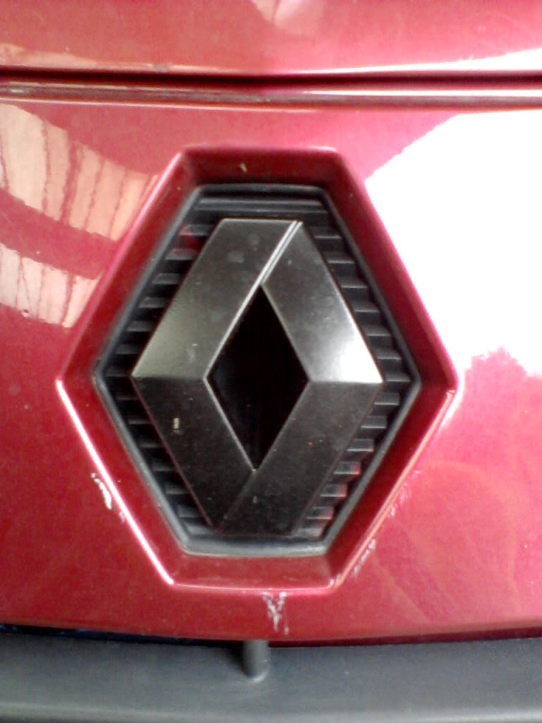

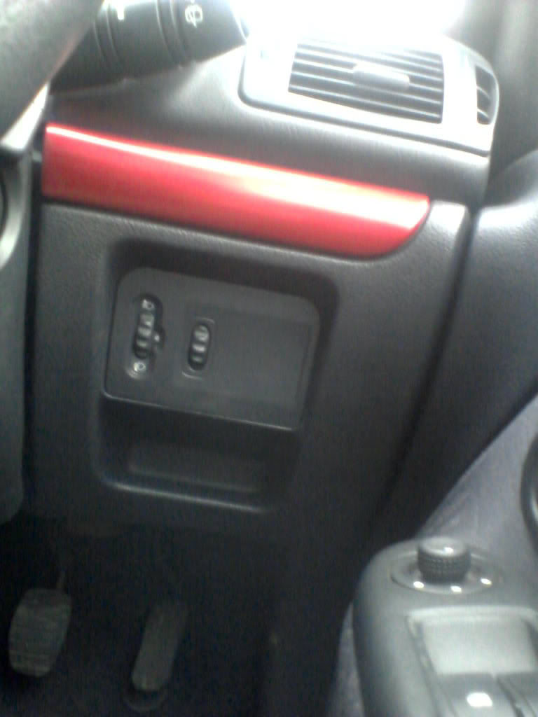

Painted front diamond:

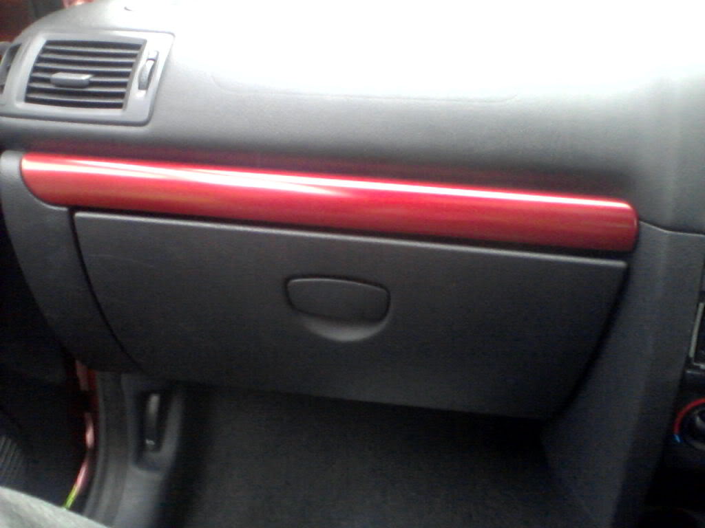

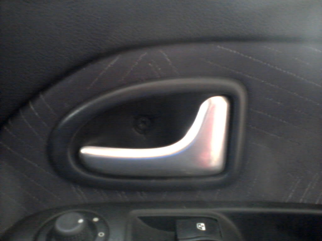

Sport interior door handles:

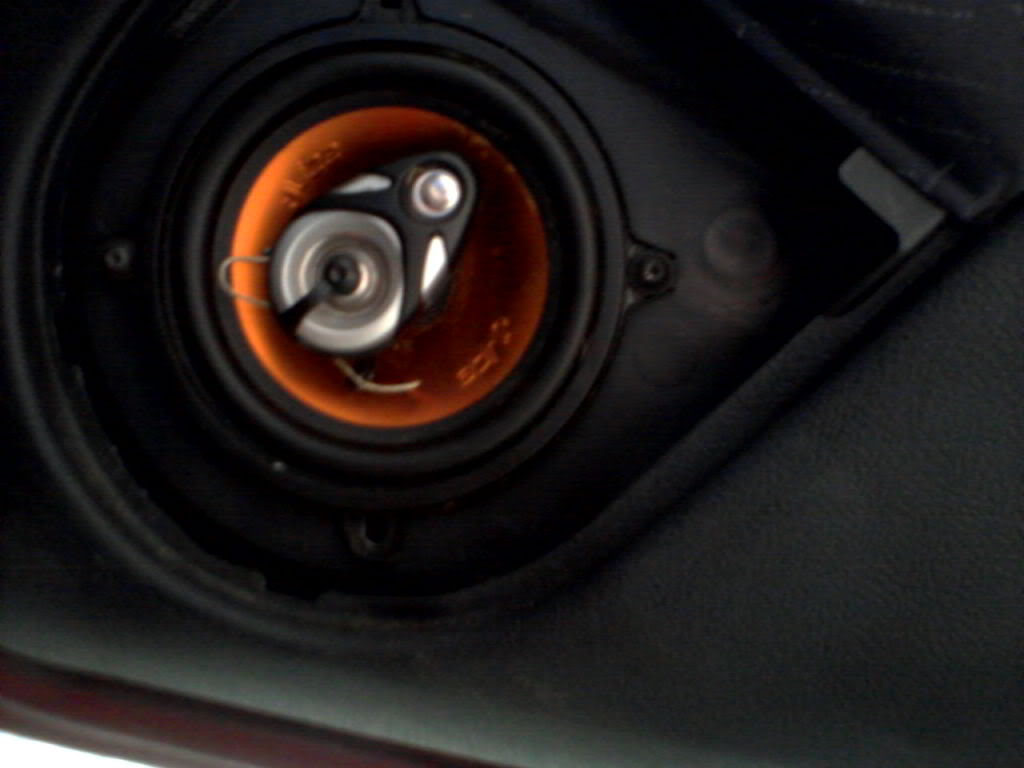

New front door speakers:

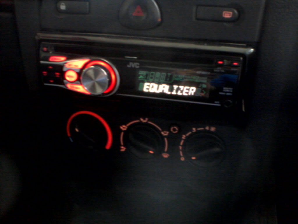

New head unit:

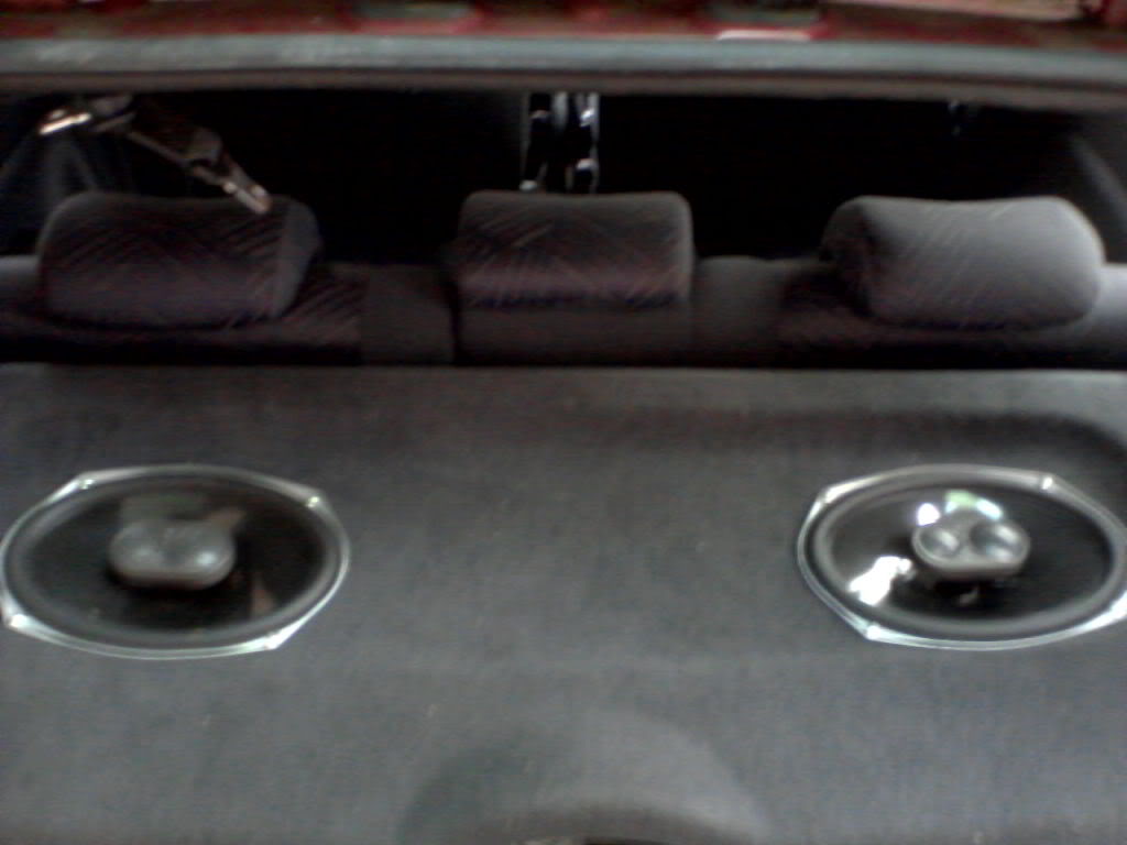

6x9s wired up:

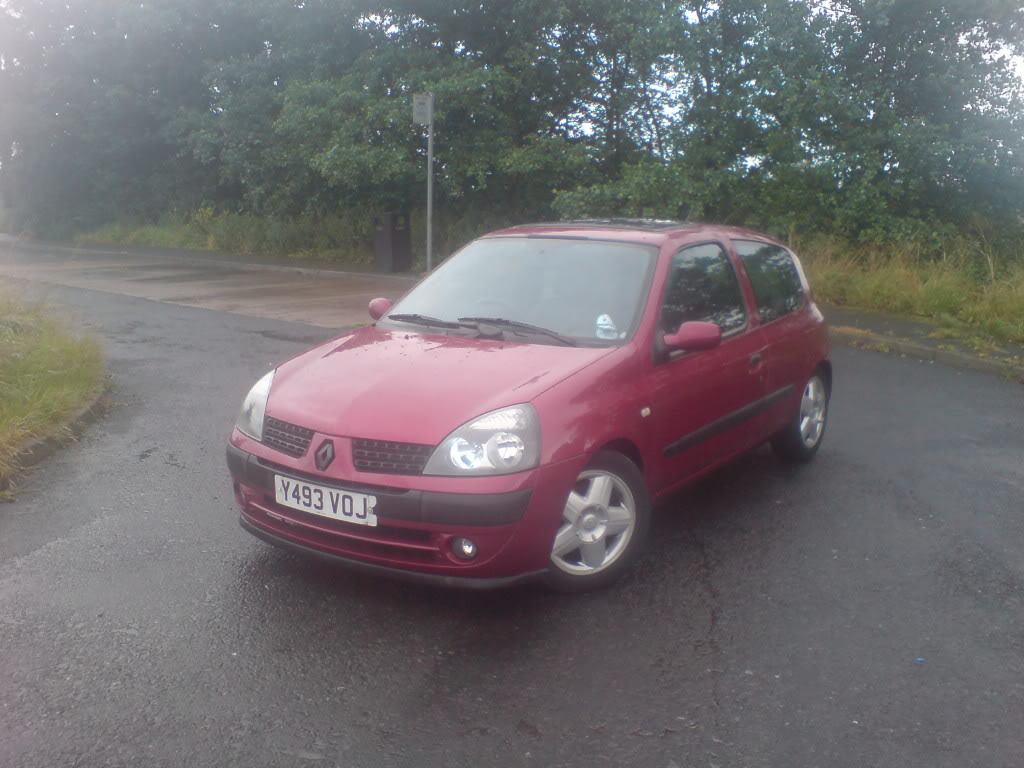

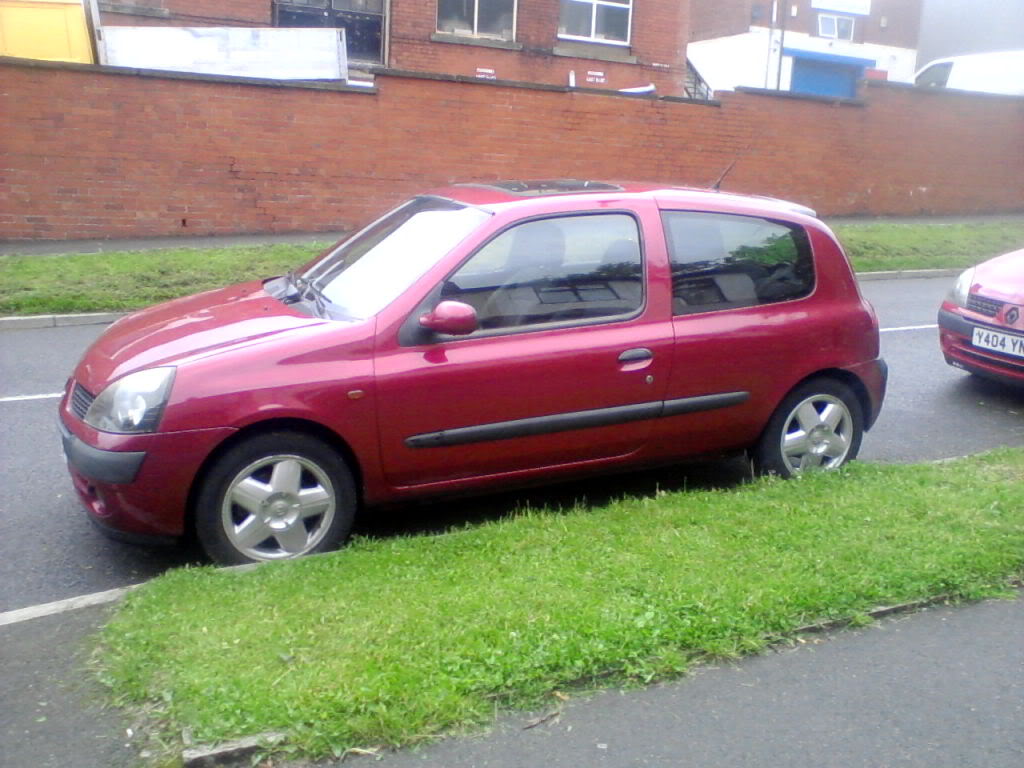

Heres a few pics of how it stands now:
Thanks for looking, any suggestions welcome :D

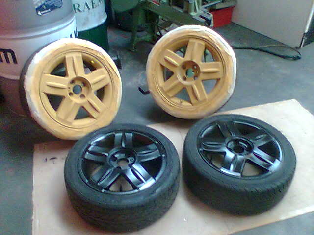

Yeah Iv done them myself, they were a huge pain in the backside to be honest, basically whoever had them before me must of curbed them every single time they parked it, and the rim had sort of mushroomed, so a ran around the inside and outside with a rough half round file, then used a P80 sanding disk to flat it best I could, added some metal filler, then sanded down with various grades. To be honest they arent perfect up close, but a hell of a lot better than what they where.

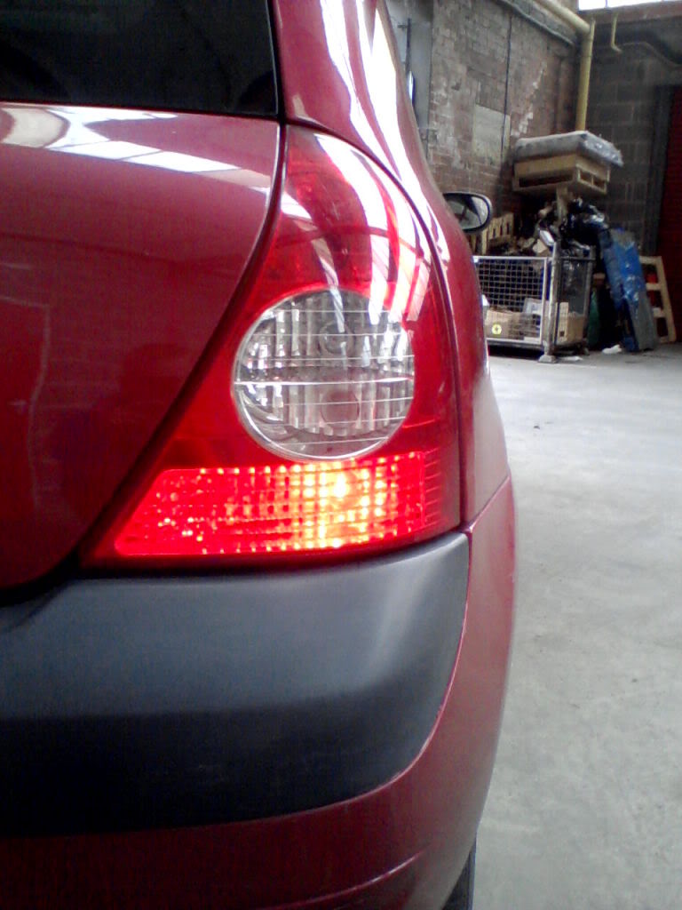

Stubby ariel arrived today, along with smd foglight bulbs, and a new rear number plate light cover as mine was very yellow. Got a megane splitter too, off a mk1 cab. anyone know if its a straight fit of will i need to cut it down? cheers

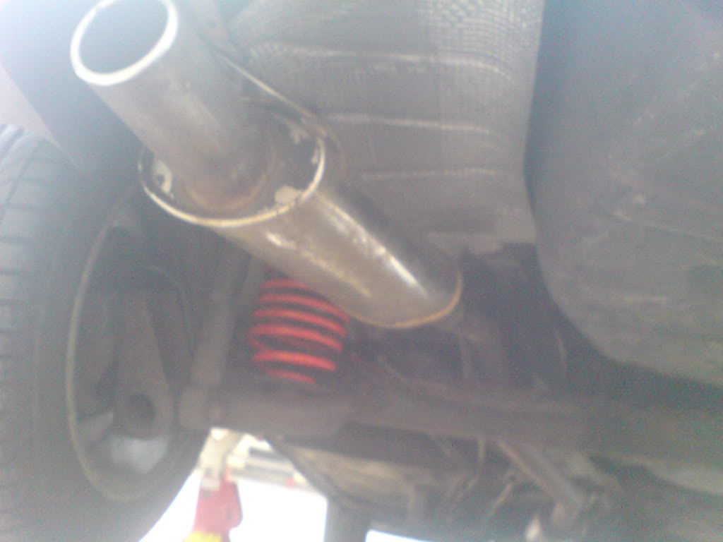

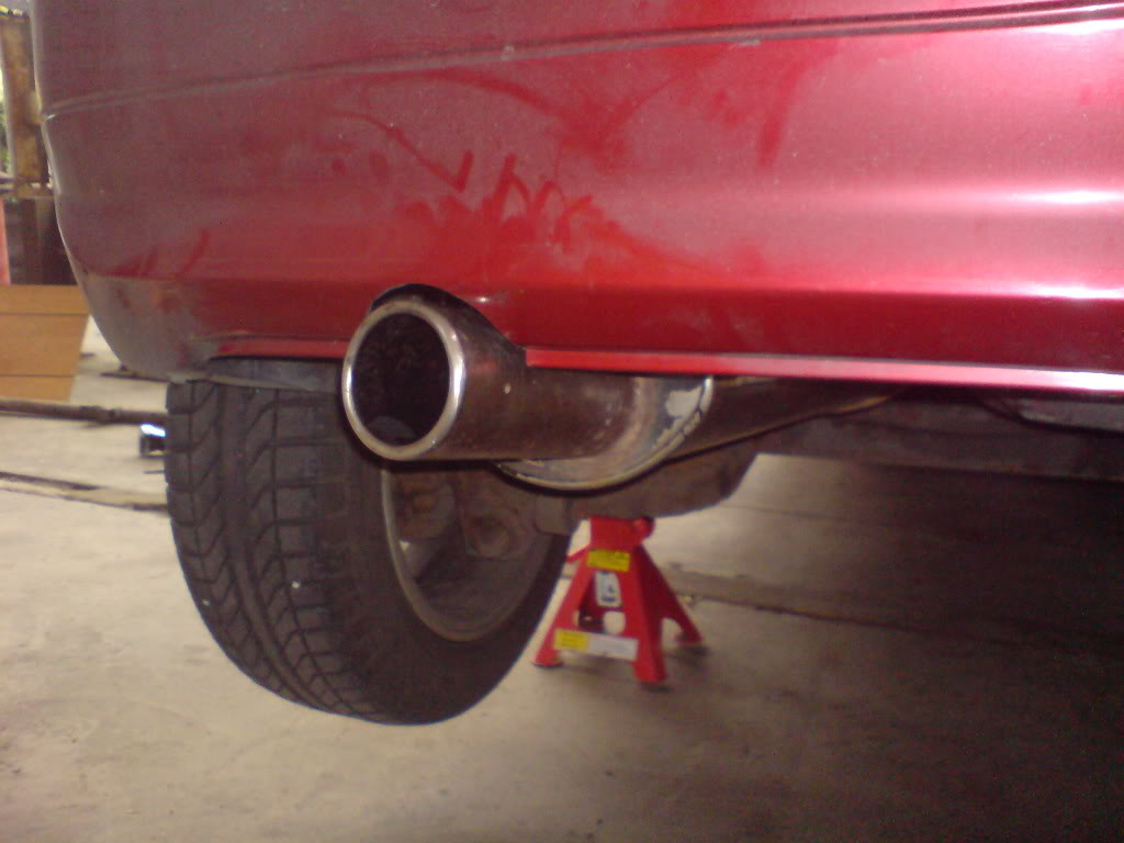

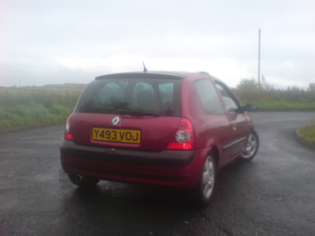

lots has gone on these past few week, il explain and get more pics up tomorrow, but was dying to get a few up, lows and exhaust finally on, just waiting on my spacers being made and then the wheels can go on too!

Hello everyone, apologies on the late thread updates, things have took a massive change these past few weeks, not for the car but for me, so work has been slow, so il just put a few pictures of how its looking at the moment to see what everyone thinks. Still havnt managed to get the 172 wheels on yet, they are all sat there with tyres, just waiting for my boss to get time to make my spacers made. So here it is.....

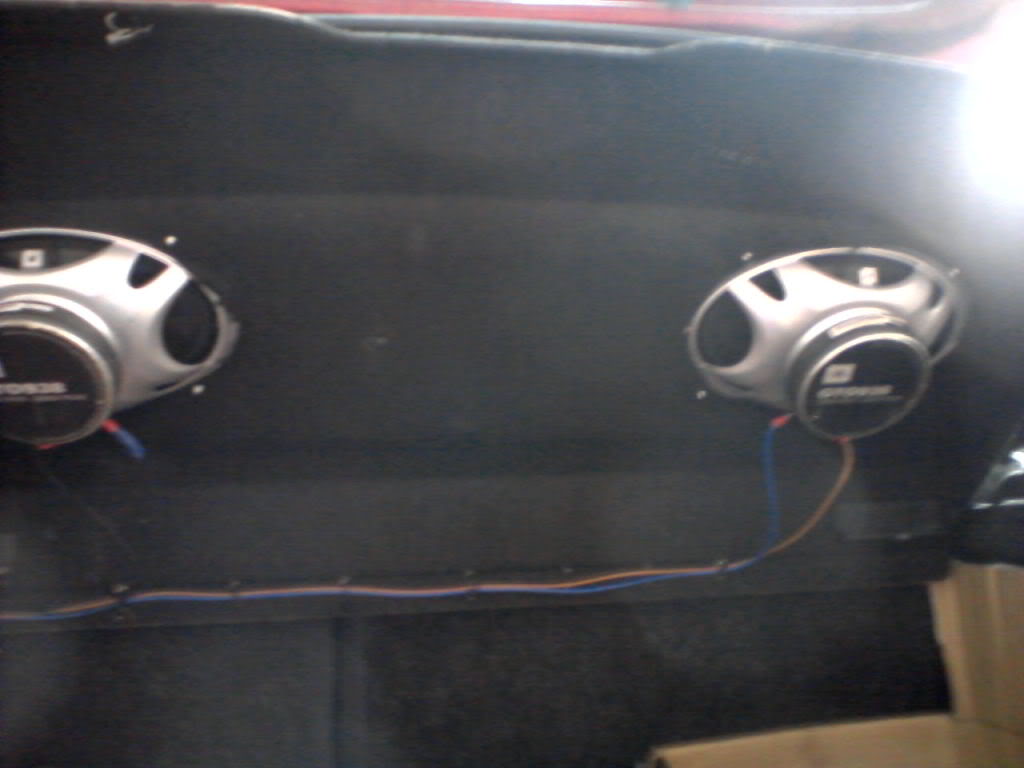

parcel shelf speaker wiring cleaned up:

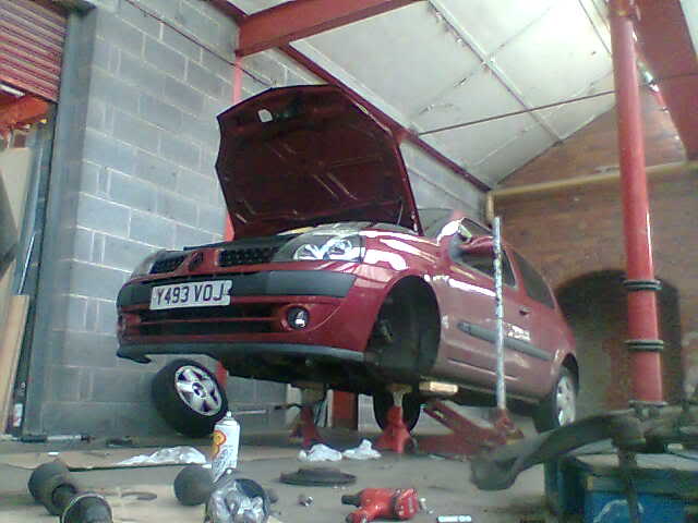

In bits at work having roll bar bushes clutch and a track rod fitted:

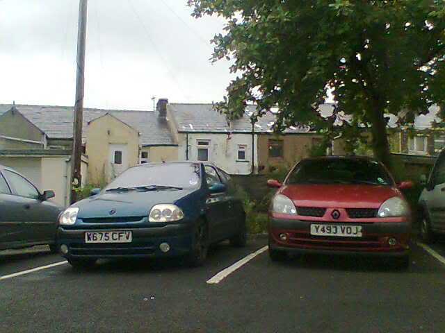

with my mates clio 1.4 sport, mine hasnt been lowered yet in this pic, and he had just done his with the other set of springs i had:
wheels in the process of being painted, all finished now:

exhaust going on, took ages to get it to sit right :

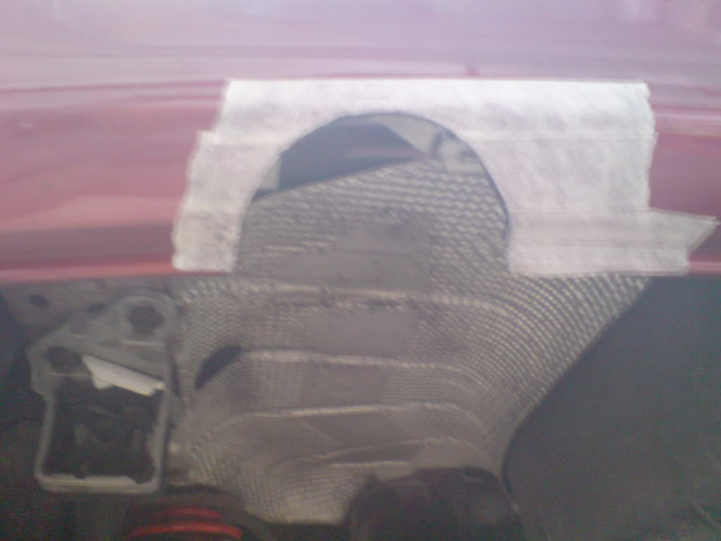

cutting the hole in the bumper :

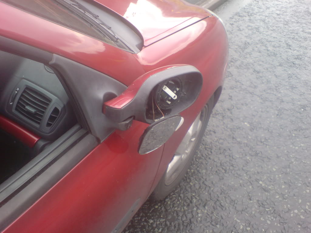

then one day i came out of the shop to find someone had done this and not stopped! :

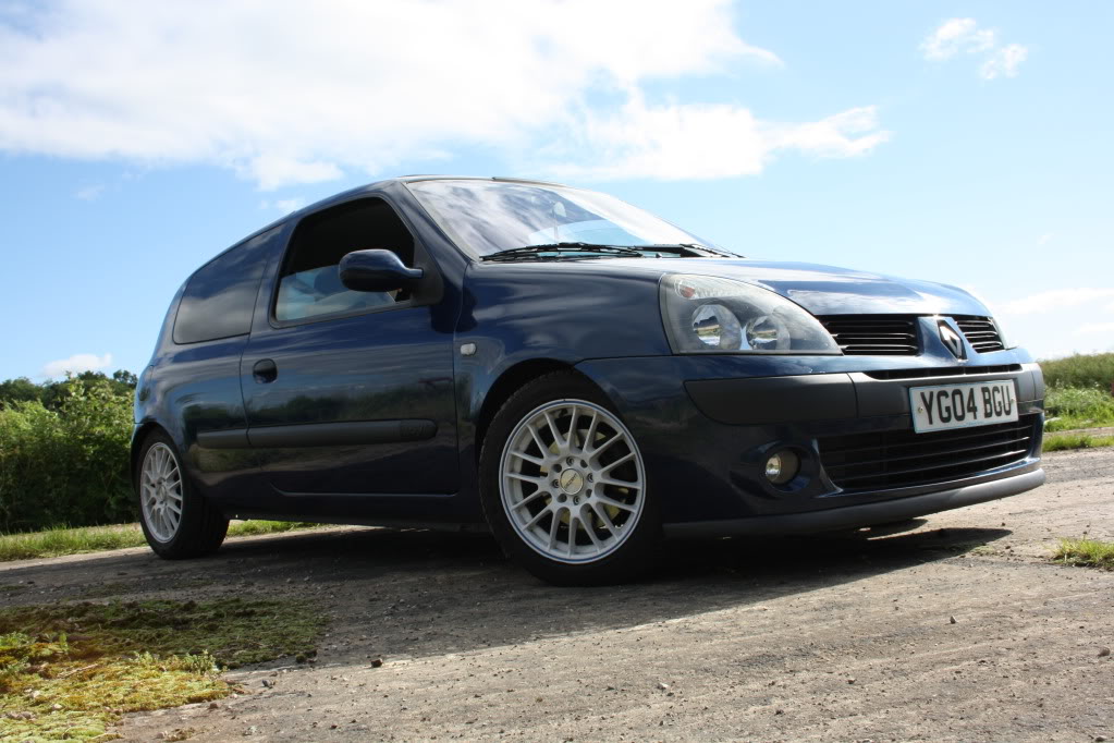

and the other day I gave it a bath so here it is as it stands today:

thanks mate :approve: fixed the mirror in 2 minute, it was just annoying it had happened as it could of been worse. Yeah the wheels look perfect on the car, gunna be a week at least until it happens though :(

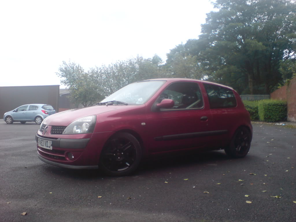

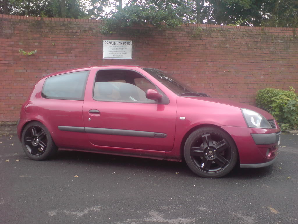

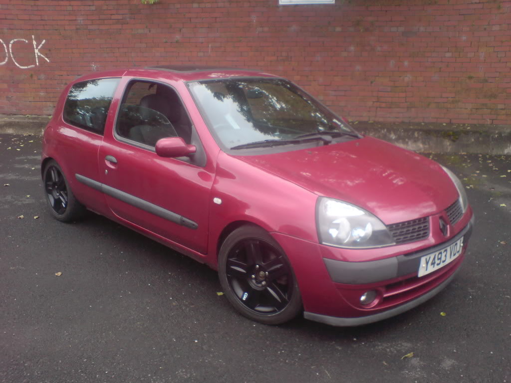

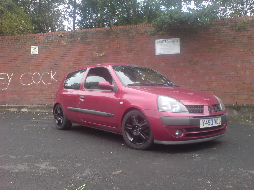

Wheels on finally!!!! il let the pictures do the talking.......
Love how it looks right now, just needs an all round tidy up and finishing touches
