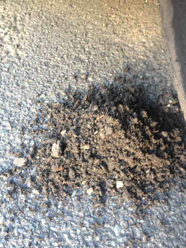

Found it.. And I was wrong! I am only missing the front arch liner. Conveniently someone cut out one side of it, and got all of this out!
That is just one side! Will take the other side apart tomorrow

Didn't fix it :( water flows through both if them fine. Not sure if it's an idea, but the passenger side side skirt isn't an amazing fit, could water be in there?
