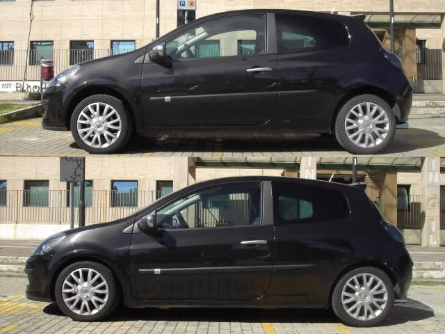

pictures of stock vs H&R

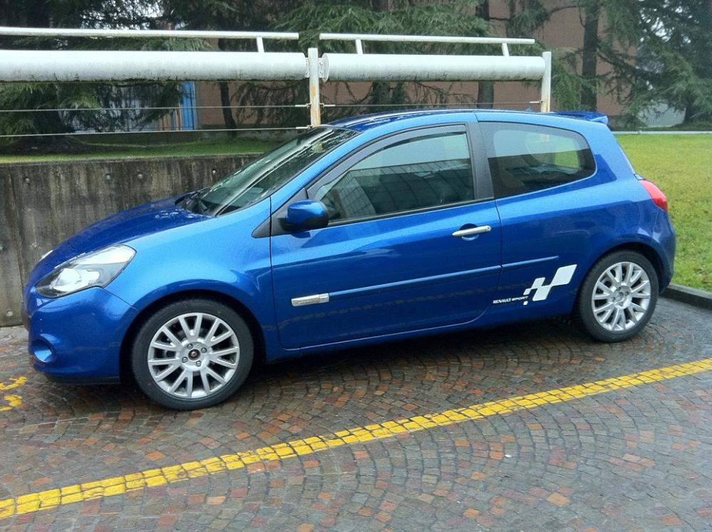

In the end I ordered a kit of Eibach pro-kit, for € 155 is was worth a try...if I can't buy Bilsteins I won't fit coilovers.
With the RS wheels +winter tyres (ordered, Hankook Icebear W300, very cheap) and the springs it'll look like this:
